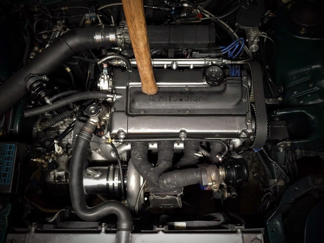

added Jay's racing alt relocation kit to bolt-on mods. I modified the kit to use the 3000GT alternator which is 110amp. Worked well this summer. 14-14.2 volts at any rpm that I tried with the 14b, idle to 6.8k. Not a bad idea for those relocating and want to keep it mitsu in the engine bay with more amperage than the DSM alternator.

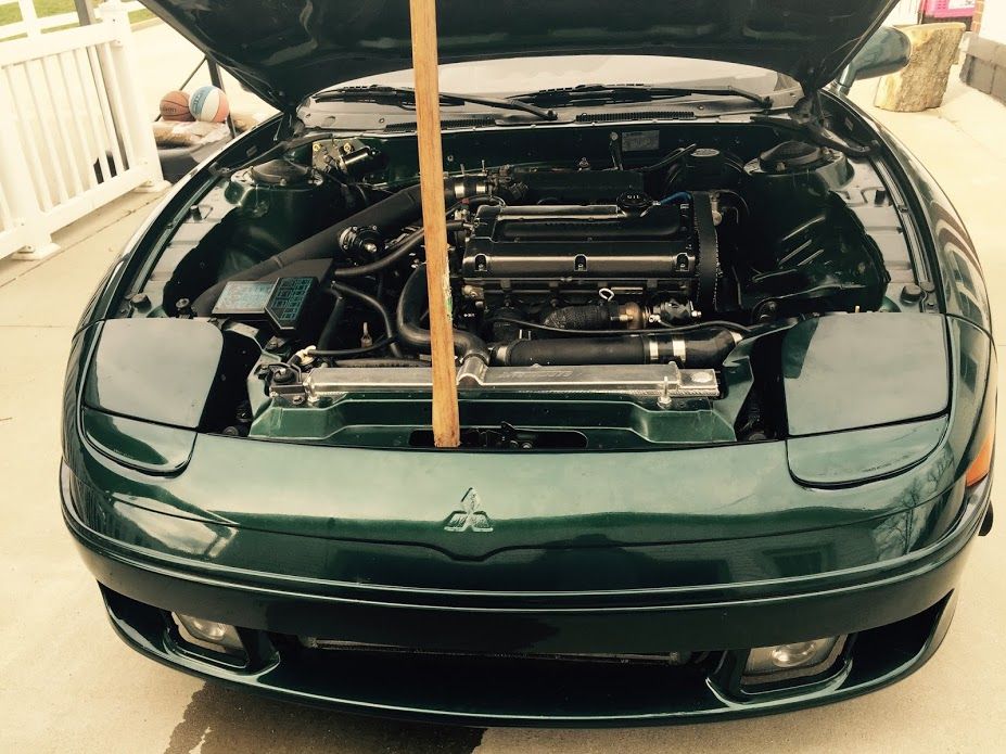

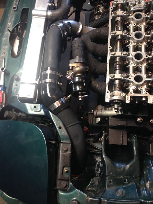

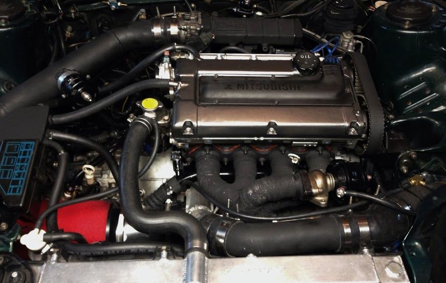

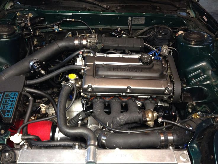

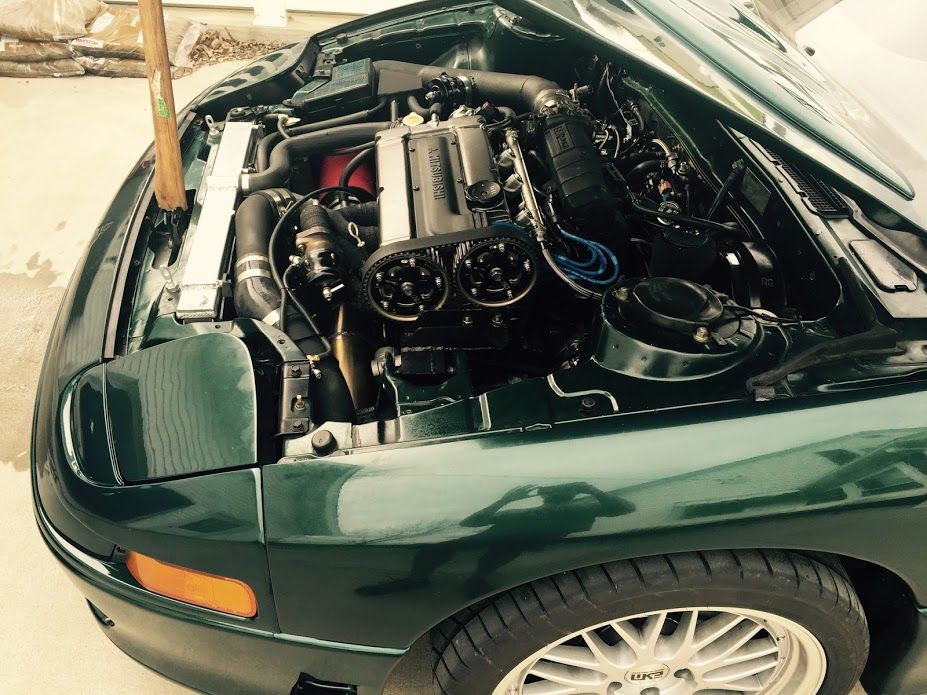

It's somewhat the pics and somewhat my setup. Quite a bit of space between engine and firewall. Upfront my intercooler piping took up a lot of space. If I did the usual DSM routing down below, it would look more spacious. Width wise, it's a hair wider than a 6g72 so no space there.
Well this pretty much settles the on-going argument between me and a former 3S purist friend that the 6G72TT is exactly the same width and length as a 4G63T. Dude still won't admit he's wrong publicly but deep down he'll know. :p
It's not "exactly". Length, (crank end to end) is about .5" longer on the 4g than 6g (can't remember exactly now; measured it when I was putting it together originally). Width, obviously the 6g is wider with a V and two heads.

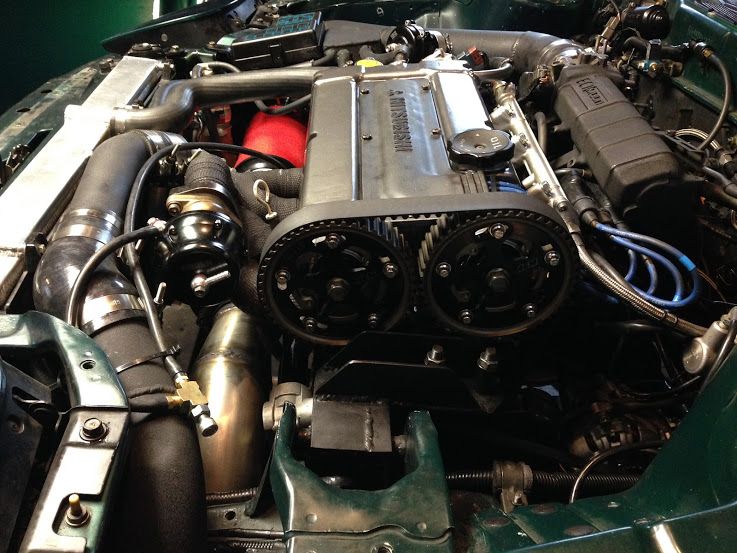

I love the first pic. I drove my talon around for about 3 months with no bumper or crash bar without being pulled over, I suppose a front mount provides some kind of impact absorption right? How's it running with the new setup? Driving - tuning it yet?
Trans mount is stock 3000. Rear is custom. Front I built a chromoly crossmember mount.

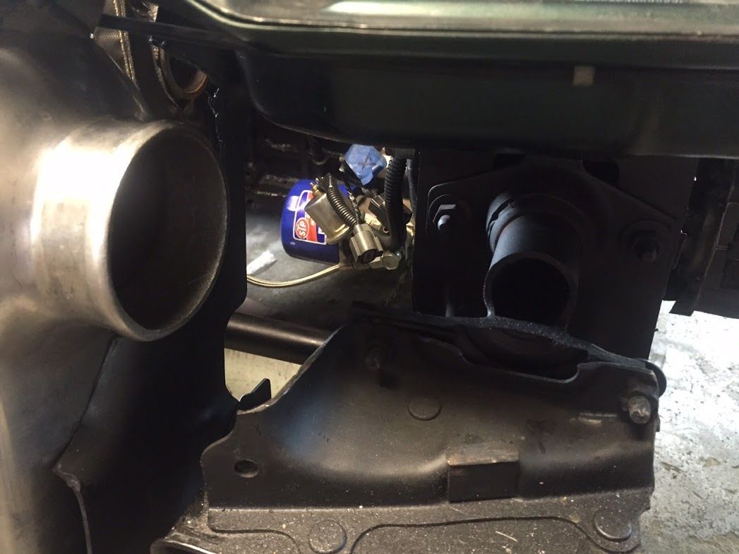

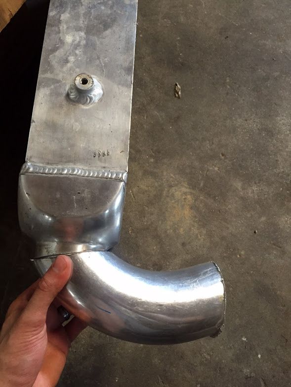

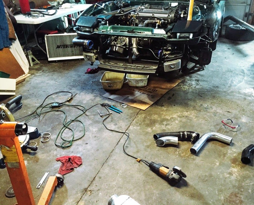

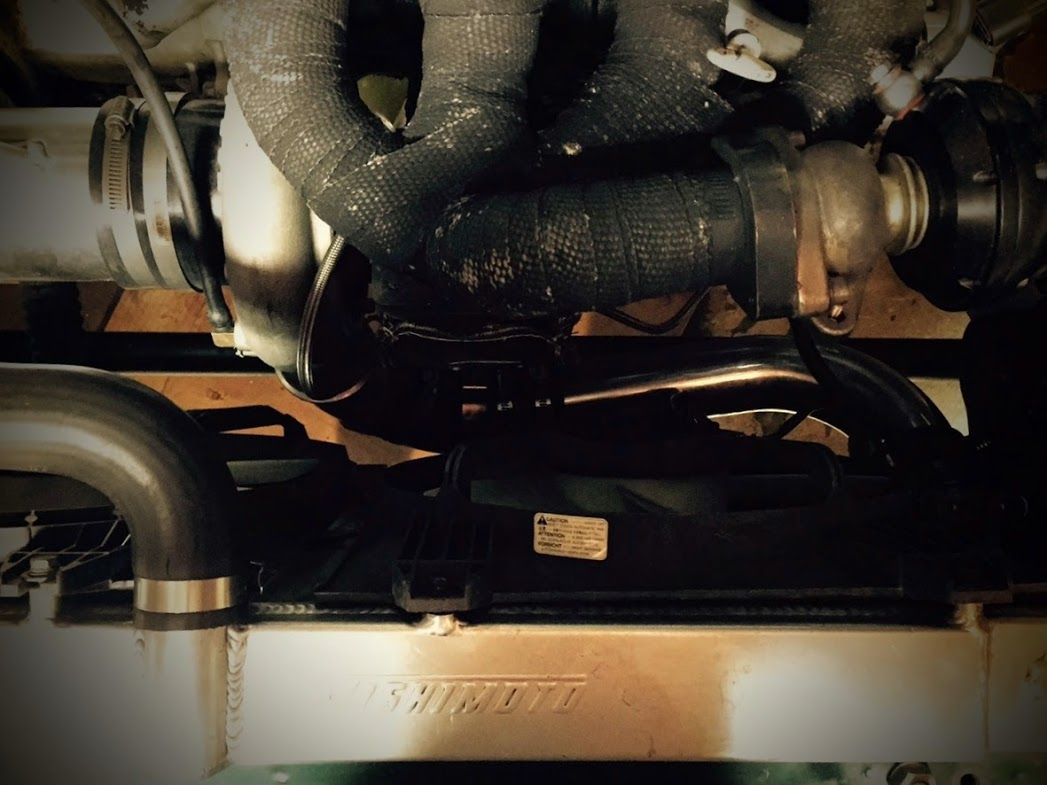

Joining the fun at the Shootout and planning on running Max Effort, so the lazy manual dsm steering rack isn't going to cut it for autocross. Making room for PS pump for a 3000 power rack which required clocking the compressor housing and re-routing the hot side piping including chopping up the FMIC inlet.
Piping had to go through here....
with something like this...
Made a bit of a mess....
