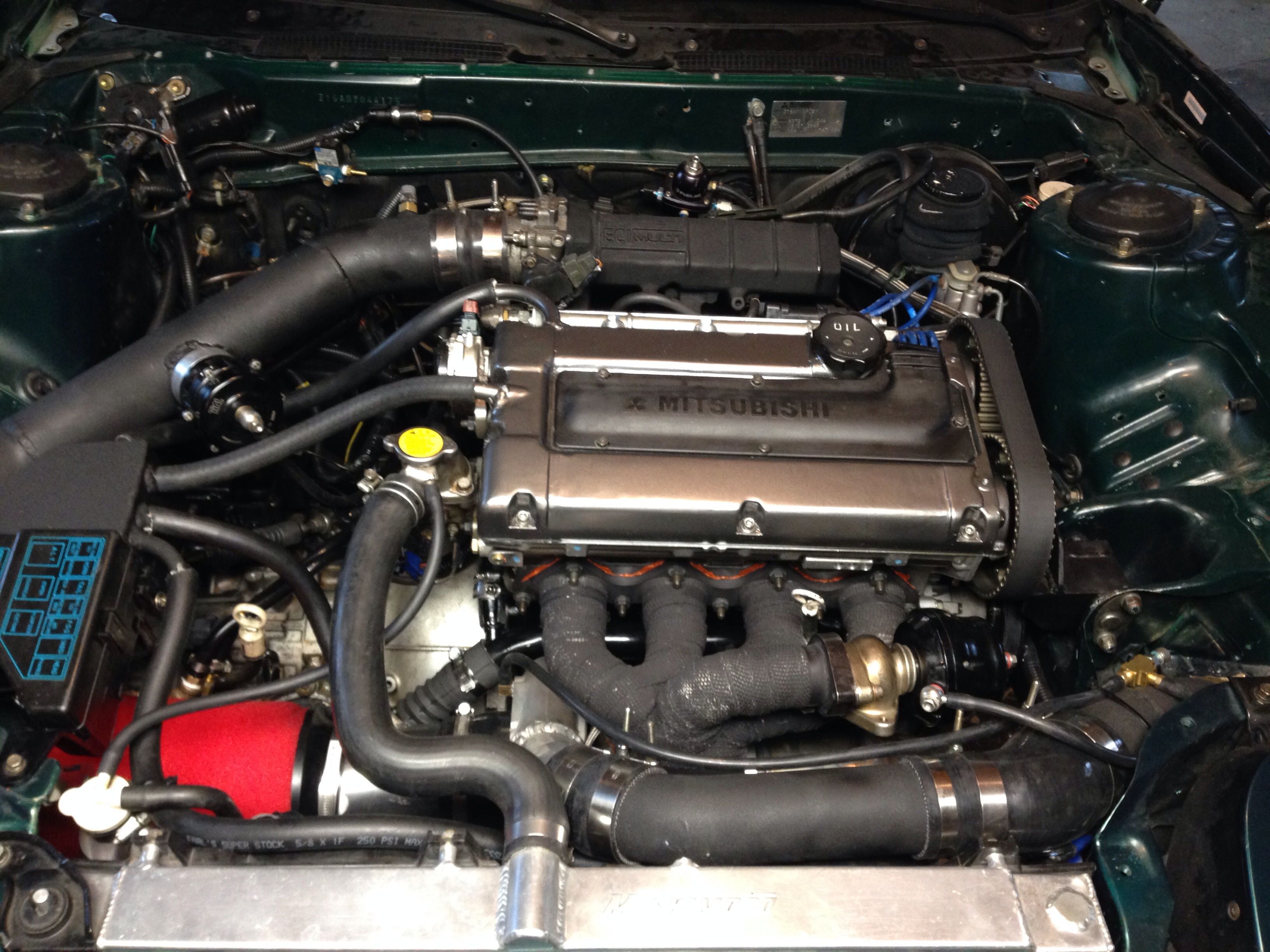

Been awhile since I updated. Tore it apart for winter upgrades and just waiting for final parts to come in to begin assembly.
Changes....
Engine...
  • 2.0 long rod with HD2 pistons and R&R 156mm aluminum rods
  • Half fill. Stock water pump
Fuel
  • Magnus hex drive mechanical pump bracket
  • aeromotive pump and FPR
  • custom front surge tank fed by stock tank and lift pump (still need to build)
  • adding 1650's as primary injectors and moving 2150's as secondary
Induction
  • Magnus v3 intake with second rail
  • equal length exhaust mani to replace ERL cast. (still bottom mount)
  • Still using FP Super99
Chassis
  • Nothing major, but finding hidden weight to remove. Goal of 3100 race weight
Trans
  • Just adding Jeff Bush front LSD insert.

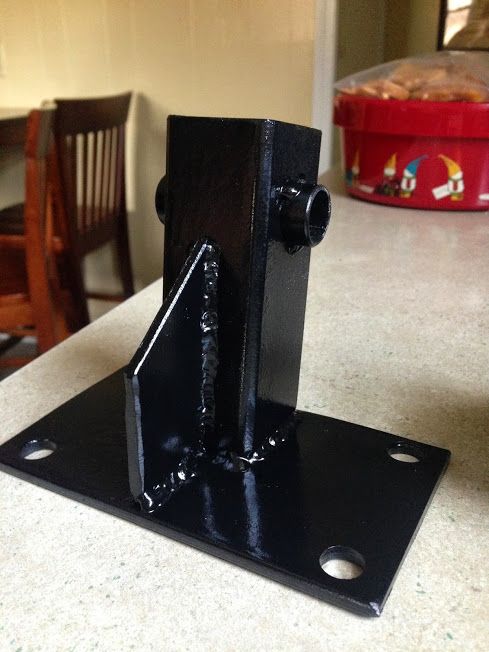

Shipped quite a few 4Gswap mounts over the winter. 3000GT 4Gswap guys will love the room in the engine bay. After working on my daughters 2g talon tsi, I'd rather swap it into a 3000 chassis also. LOL.
