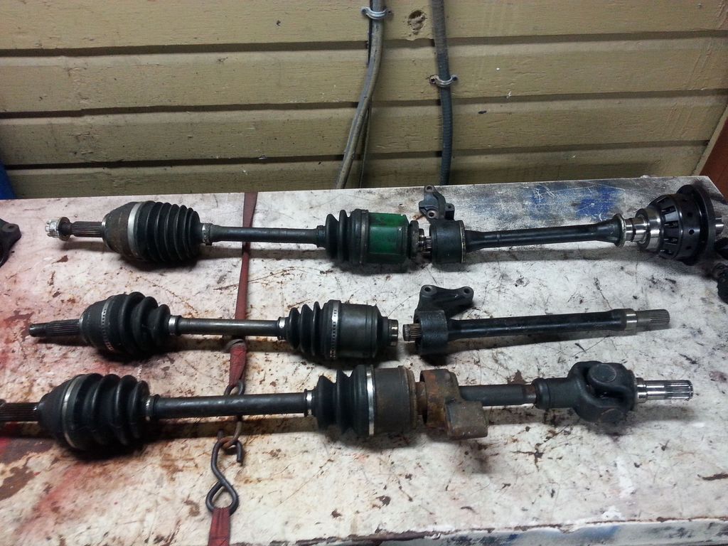

I'm using a 3000gt fwd auto passenger axle but I'm auto. 4g auto intermediate shaft. Stock driver side 3000gt VR4 was approx an inch too long so I used a passenger side axle (which is shorter) and swapped the inner cups so that it would slip into the intermediate shaft.
Here's a pic of stock 6g72 turbo axles. Top is a stock passenger side. Bottom is driver side. I swapped the cups (male/female) and ended up using two passenger axles.

From my testing some parts interchange and some don't, as familyman has pointed out one of the nice interchanges is the splined connection between the intermediate shaft and the outer driver side axle just after the carrier bearing. The 3s and 4g are the same and you can mix and match the 2 piece axle inners and outers. I am planning to run the 3s intermediate on a 4g block, it's not much different than the 4g shaft length wise, the mount itself is different but you can press the 3s off and press the 4g carrier bearing bracket on. it does not match exactly though distance wise. I am planning to cut the bracket and mock everything up with the intermediate shaft in place and bracket bolted to the block and reweld it where it needs to be. The offset is not large. I cannot see any nicer way to go about this other than like you already said a custom intermediate, which I also priced at the driveshaft shop. Honestly I think the big stock 3s shafts and larger outer cv joints and splines at the outer hubs are stronger than most of the aftermarket dsm stuff. And you can find the 3s stuff in salvage yards for spares still. A custom bracket and control arms seems like a better solution than custom axles. What if you do break one? With that said you may not need to alter the control arm length, I did some testing with different axle combos and none of it worked out directly for me with the colt but it has a narrower track width than the dsm and yet a 3rd style of outer hub spline. It could be too short but I would bolt up the 3s intermediate and the dsm outer driver side axle combo with the inner boot off and see how far out the tripod bearings move. I think it will be close, if you have a lower ride height and never have too much droop in the front it might never be an issue about trying to pull out. If mine works out ok and you want I could probably make you a 2nd carrier bearing bracket.

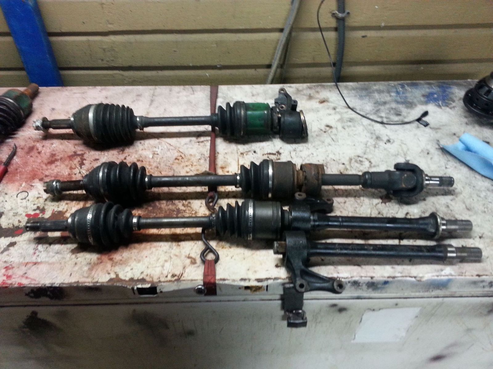

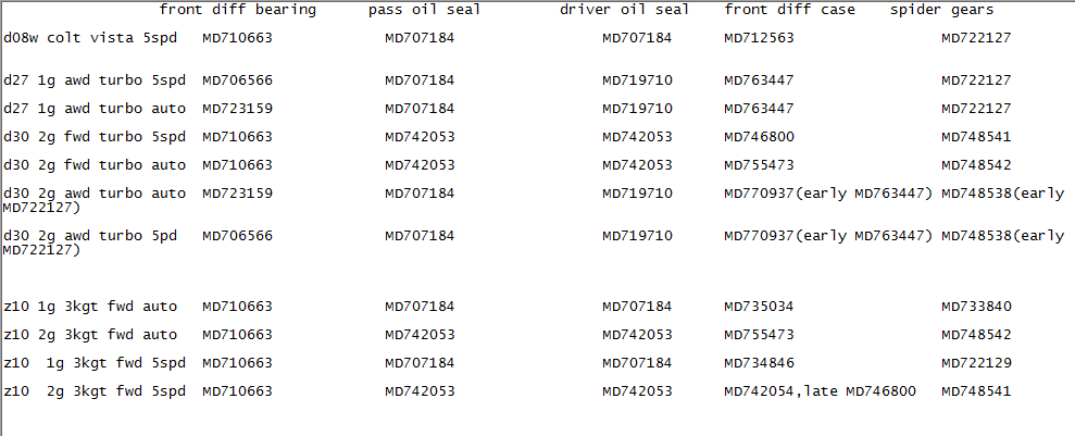

Heres some pics of the axle testing and a chart I made to cross reference 3s and dsm front diff and axle stuff with my colt.
top to bottom
Stock 3s, fwd, 2g axle in a 2g dsm wavetrac. Notice the carrier bearing bracket for the 6g
stock 1g dsm awd auto outer axle plucked off
stock 90 colt vista , different carrier bearing bracket but the 4g block is the same and the dsm bracket bolts on fine, also YES your eyes don't deceive you, that axle for the 90hp sohc is nearly as big as the 3s, makes the dsm look like a toy and there is a goddam u joint in the intermediate, I have no idea why.
top to bottom
same 3s, carrier bearing bracket pressed off
stock colt
dsm awd auto outer driver on 3s intermediate with dsm carrier bearing bracket. damn close to the colt but no go.
dsm awd auto intermediate showing length difference vs 3s. Familyman this is likely why the 3s driver didn't work for you, nice save with the passenger axle btw.

For me the 2g wavetrac should fit my km182 (stock colt 5spd trans) as it uses the same bearings already MD710663, and the 3s axles fit the diff at least and will clear my tcase and all for the auto swap. km182 is awd too but the tcase is ABOVE the steering rack like an evo so the equal length halfshafts are to clear the future w4a33 swap. I believe the MD707184 seal for the smaller 25 spline inner axles can be directly swapped for the bigger MD742053 seals on my km182 now. I am not sure about the w4a33 for bigger seals yet, the driver and passenger dsm awd transmissions use different small seals.
Bastardsm, if you look for a 3s intermediate shaft look for 92+, if you look a the axle seal and spider gear part #s you can see the axle interchange. The 3s stuff before 92 used the similar dsm small 25 spline inners. This may also be a solution for the awd auto big axles, if the 3s awd uses both different and similar seals for driver and passenger side small axles prior to 92 maybe they have unequal size larger seals for the 92+ that will fit the w4a33.

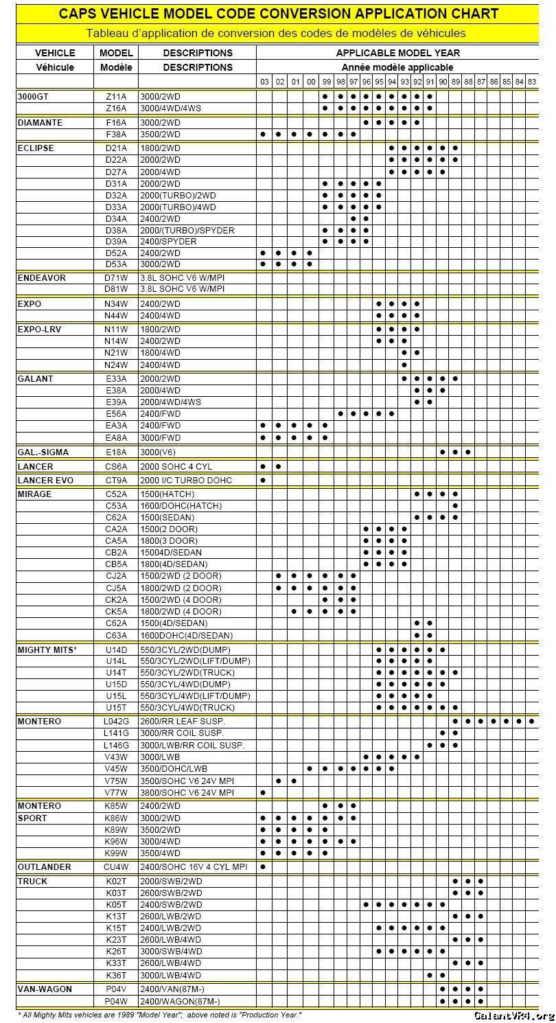

http://mitsubishi-motors.kiev.ua/1/# if you are using chrome sometimes google translate will work. Otherwise the 3rd column is usdm, which my colt kindly is not in.
Here is a chassis code cheat sheet, once again no D08W listed. I should just call it a space wagon ala euro, they can't even run my vin at a mitsu dealership in this country.
