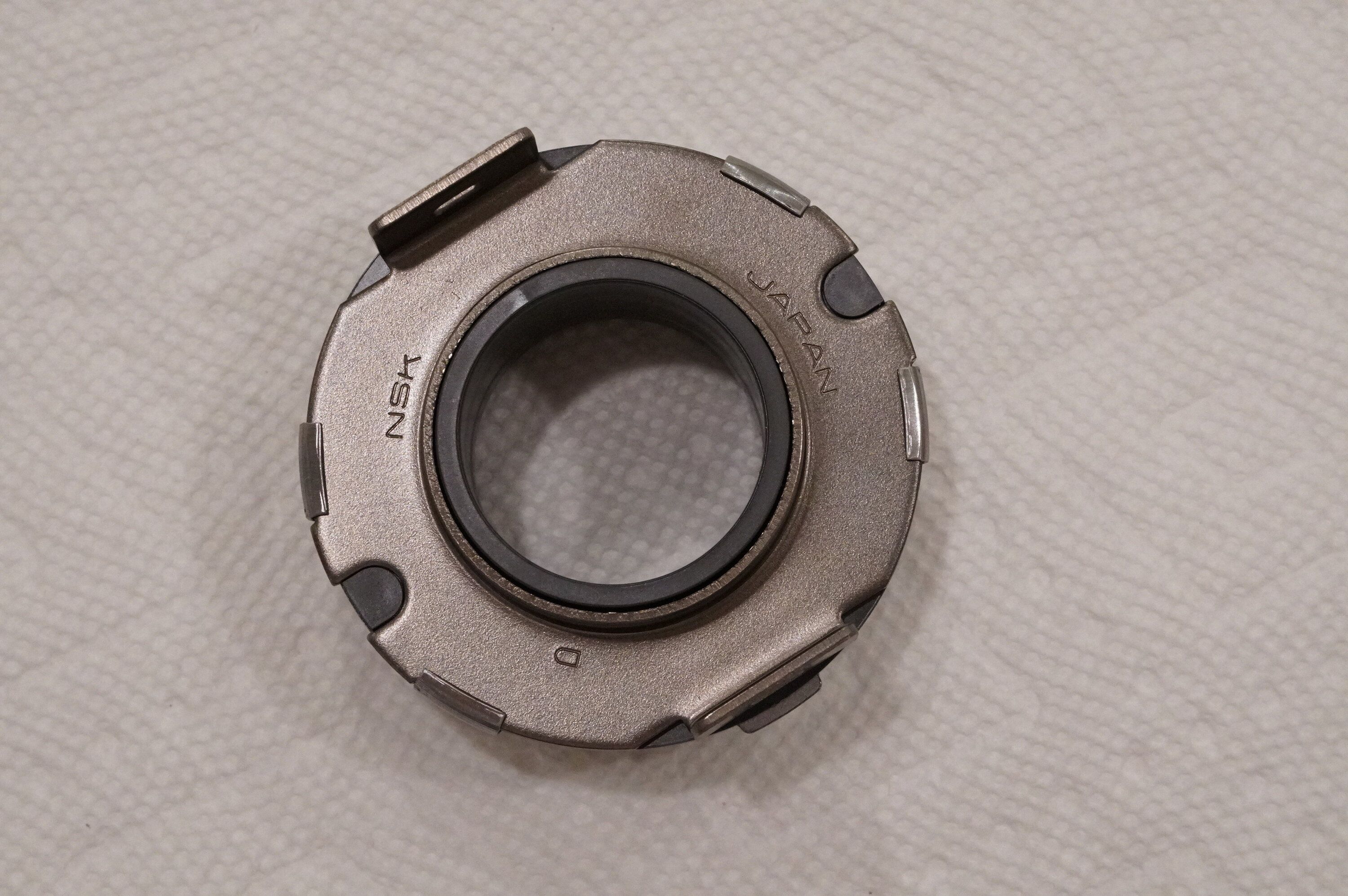

Fyi: the t.o. bearing in my Exedy stock-replacement clutch kit #05048 is made by NSK. Unless it looks much different than the original one that will be coming out with my current clutch, I’m likely to use it.
That's interesting. The construction of it on the back side does look different, and it doesn't have the polymer material inner sleeve like the OEM one does.
Here's my pic of a new OEM MD749998 that I posted in XC92's thread in January:
throw-out-bearing-for-talon-resized-jpg.620969
