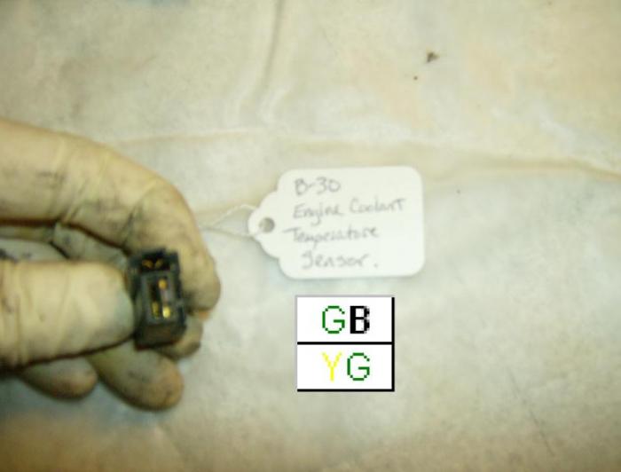

I had to re-wire my coolant temp sensor on my 90. Can’t get the picture to load but black wire goes on the left vertical post and the red wire goes on the horizontal post.

Thanks Robert that's almost exactly what I needed except you have new wire does the green/black wire go on the left! I have the bliss screw adjusted about 3 turns out im sitting at 1000rpm idle warm. It's a rough idle though I wouldn't drive this car 150miles I'm probably going to have to tow this there. It has to be related to my ecu settings. I'm gonna rewire the coolant temp sensor because mine was backwards, install a new radiator and try driving it around the block and go from there. Is there a link to base tunes for e85?
Had to peel back the loom and electrical tape but I found this:
green with black stripe = the black wire = vertical post
orange with green stripe = the red wire = horizontal post

Thanks so much for your help! I got them wired that way now. It's too late to start the car up. I'll have to wait til tomorrow morning. A friend told me they aren't polar so they don't matter what goes where. Not sure if that's true.[DOUBLEPOST=1416094137][/DOUBLEPOST]Not sure if the coolant temp sensor had a bad connection or not but the car runs a little better. still have the throttle cable adjusted to about 3% at 1200rpms. Anything lower and it wants to stall. Going around the block i could feel it want to stall upon deceleration and the throttle cable seems stiff. Here's the log
