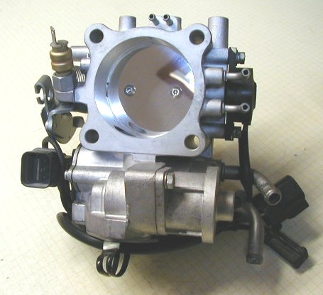

got a 2g MAF for $20 at a junk yard but im running short route intercooler with an HX35 with a turbo guard so i don't think there is a way to add the 2g MAF to my current set up. Im going to order a new X series AEM wideband kit and get it running right. So i starting looking around my TPS and i found this which 2 things that have me concerned is the messed up pin and the wrong color wires for the TPS? i ordered a new harness for the TPS.
Noticed this replacment plug has only 3 pins in it ? but OEM one in picture has 4?
