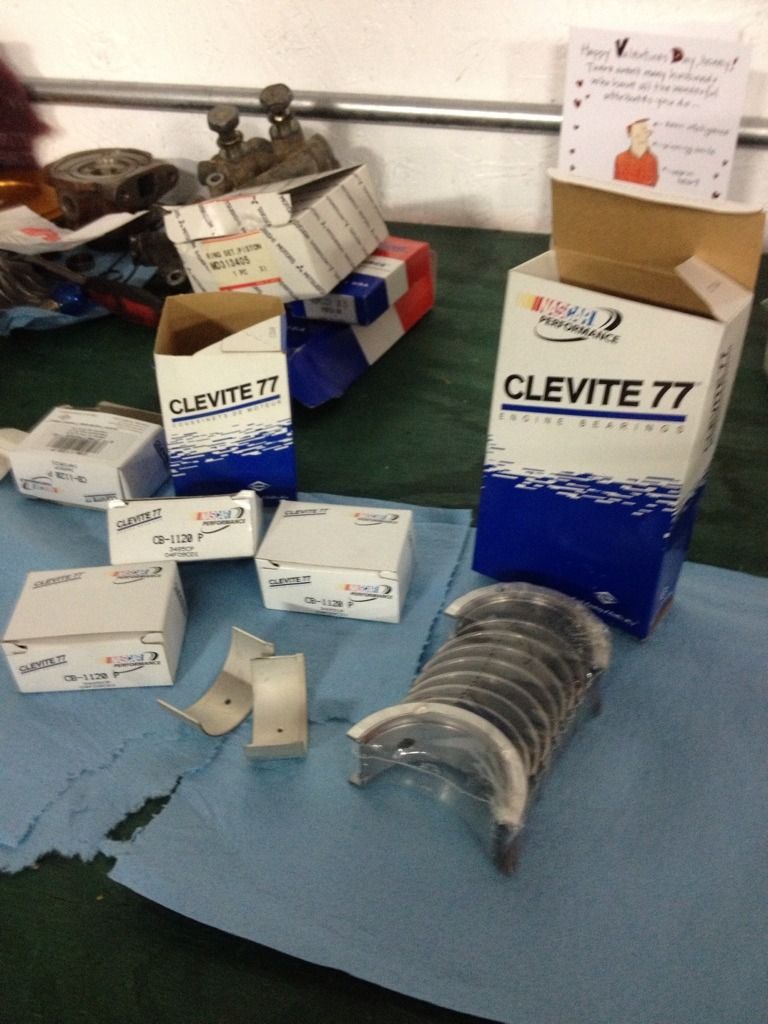

Clevite 77 main bearings

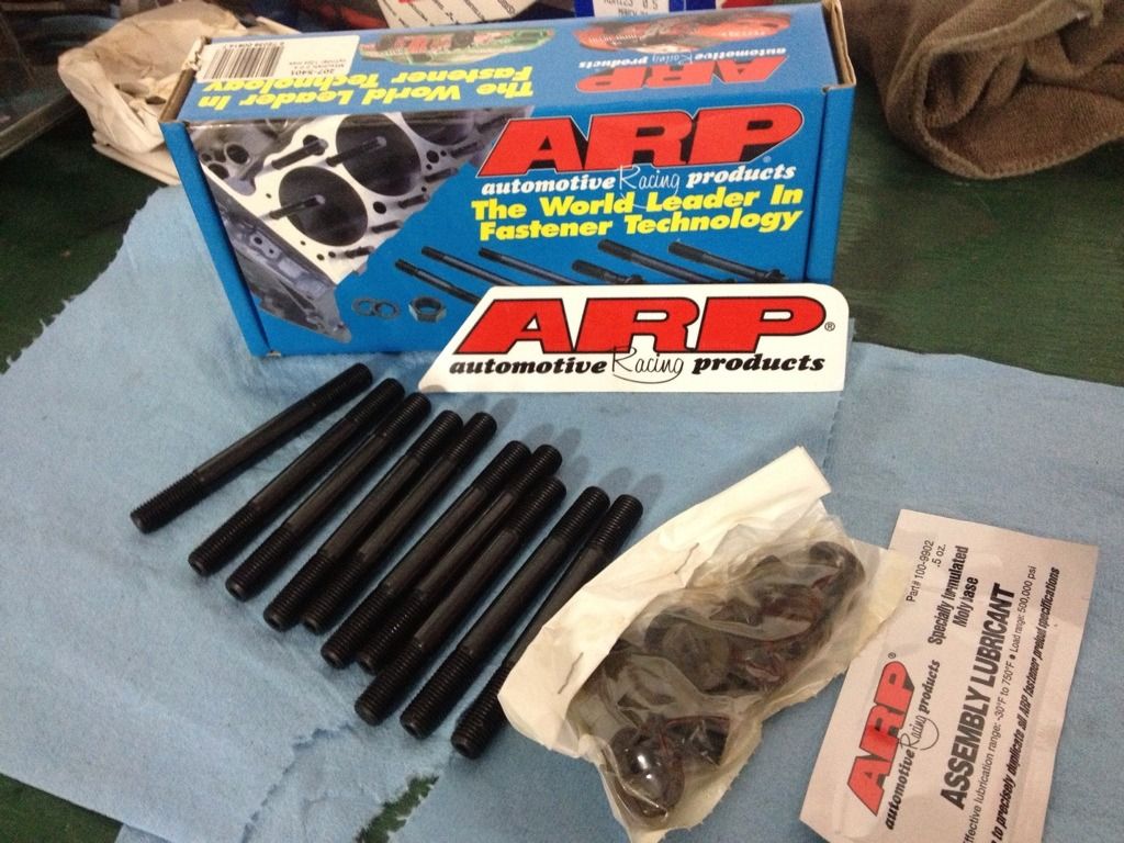

ARP head studs

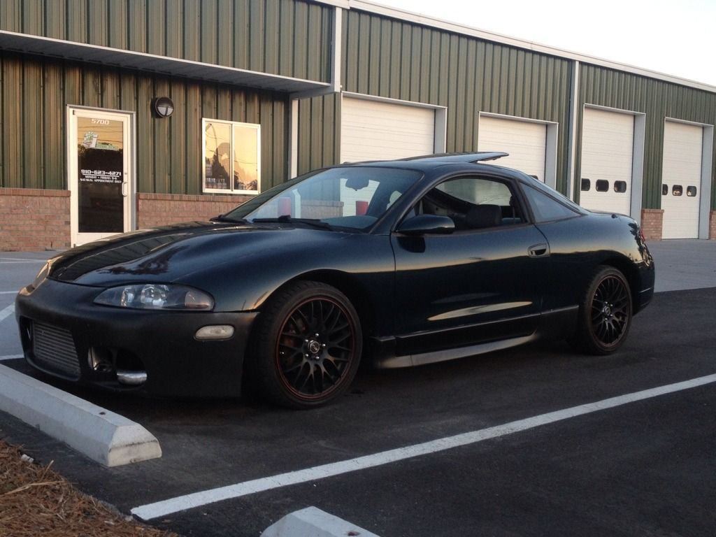

The car:

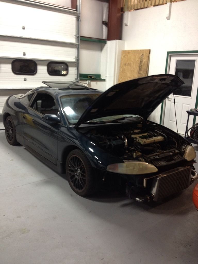

The bay: (I am going to be painting the bay, along with the car when I am doing the swap as well. It pays to work at a shop that does paint and body too :) )

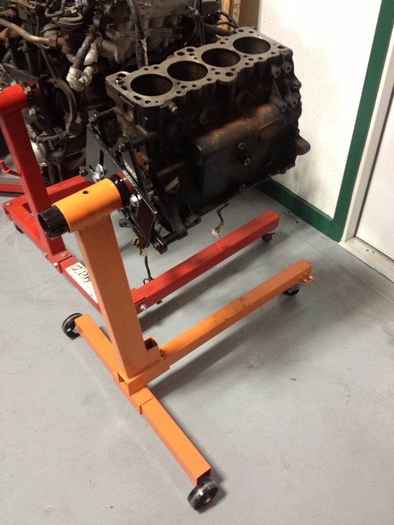

The block:

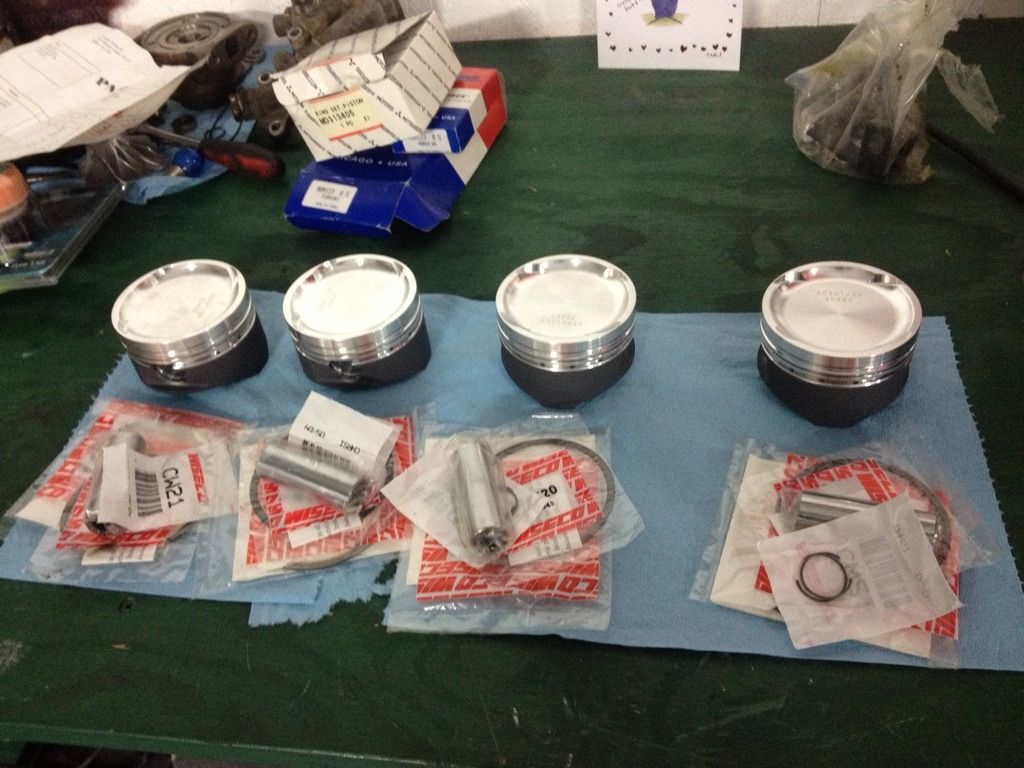

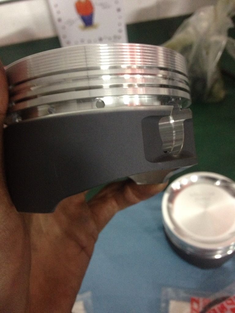

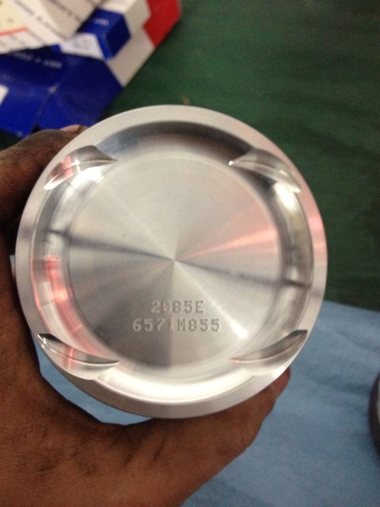

Pistons:
Bearings & Studs:

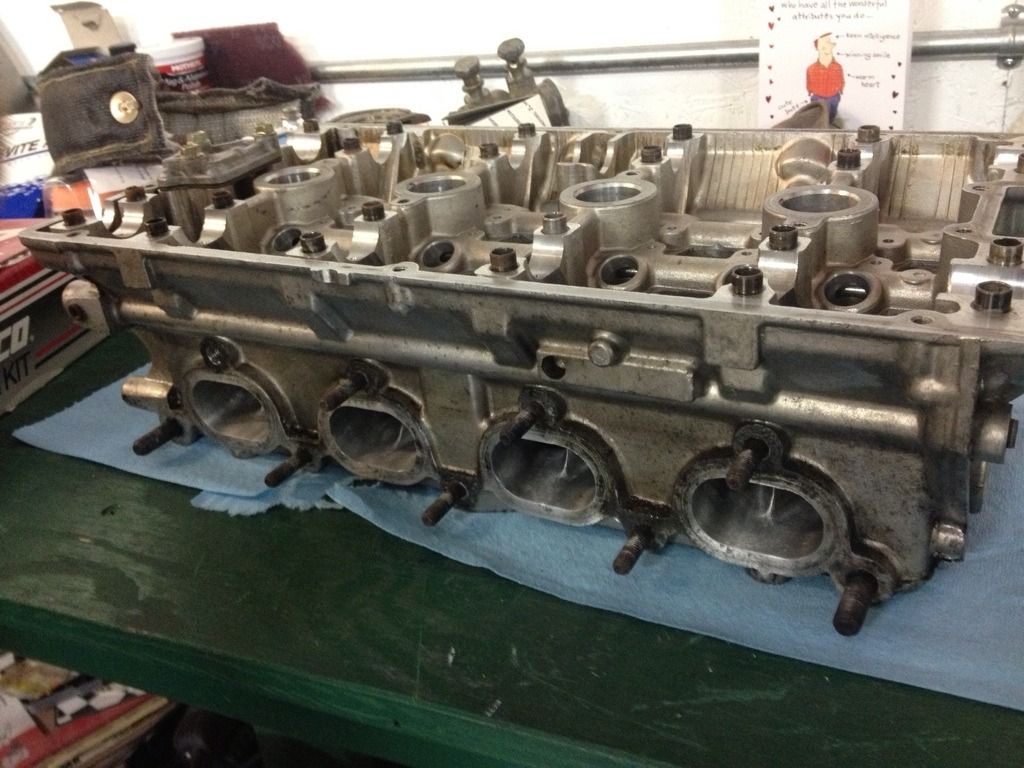

Head&Cams:

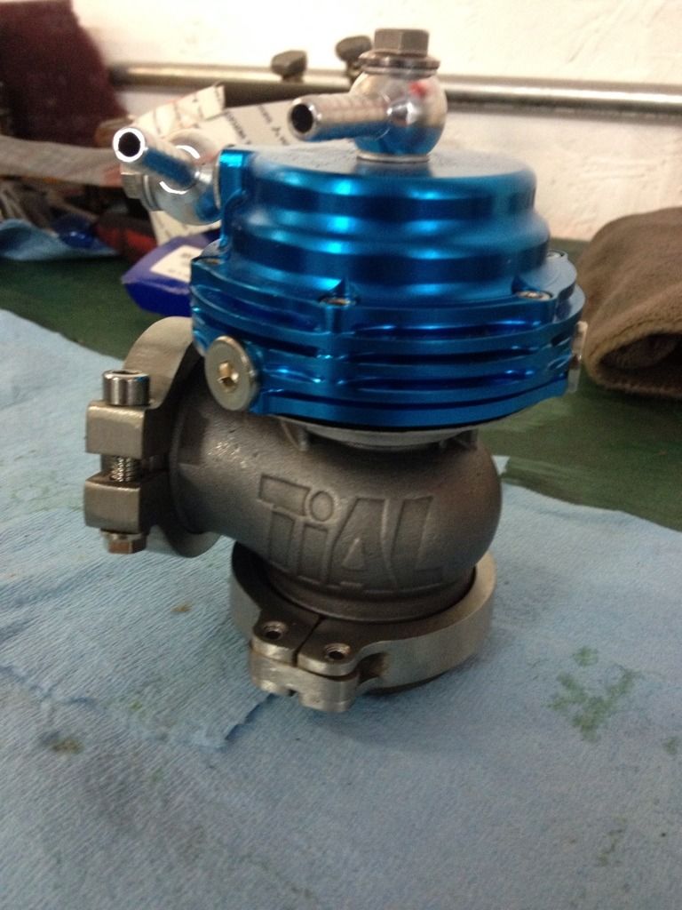

Waste gate:

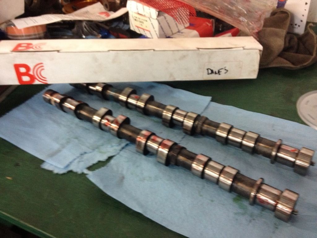

Well, keep in mind, I'm a full time college student. So the funds are limited. I got those cams for a steal! I would like to trade them or find a set of 280's though :)

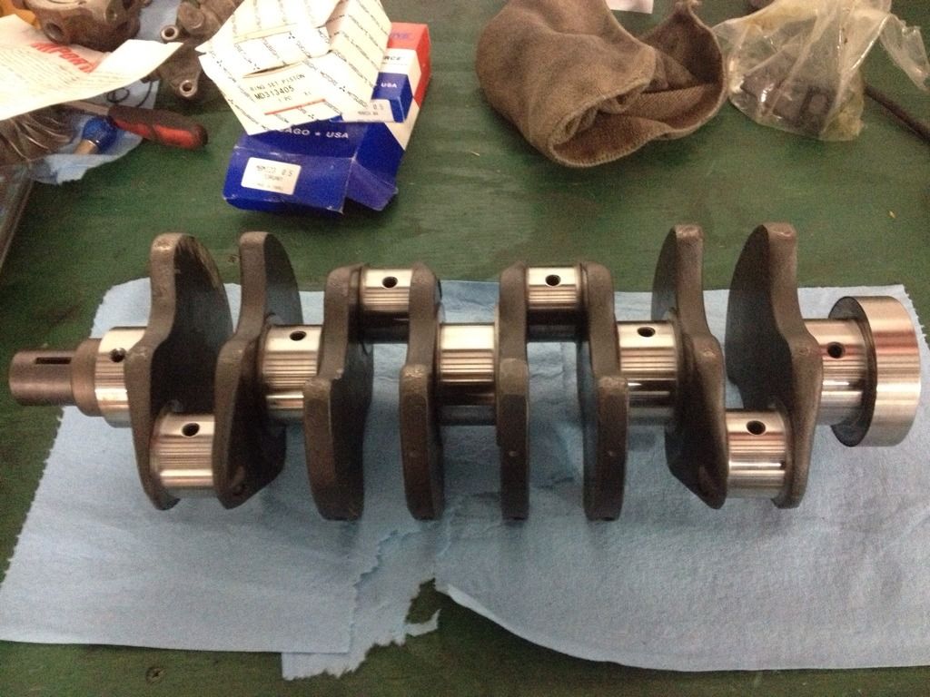

Forgot to add pictures of the crank:

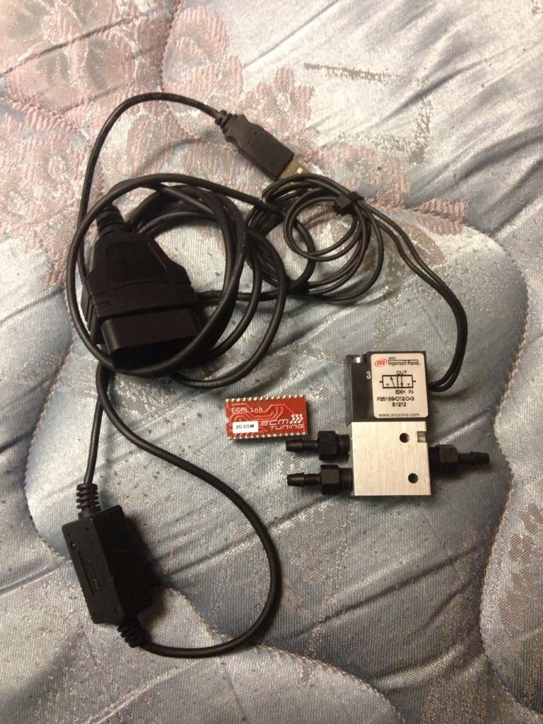

Got some more goodies in today! ECU Controlled boost solenoid, and ECMlink V3 :)

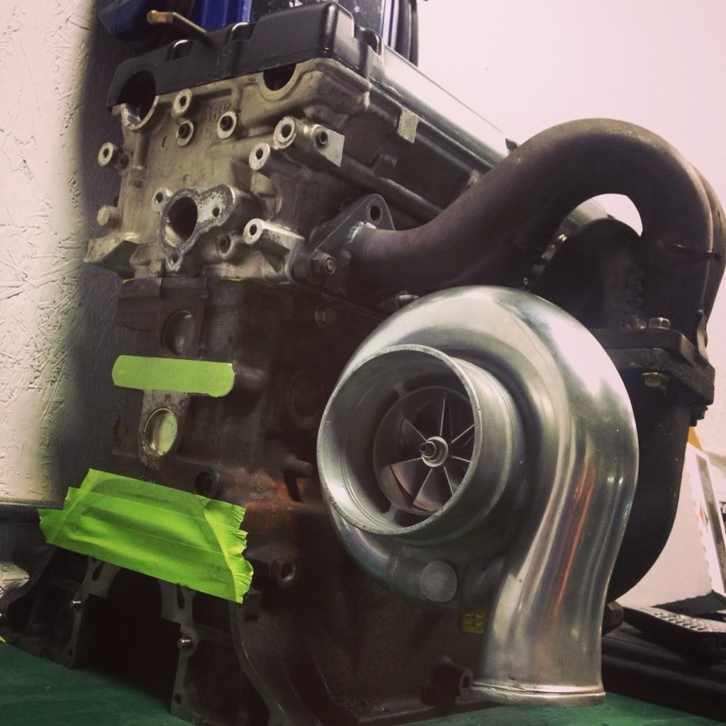

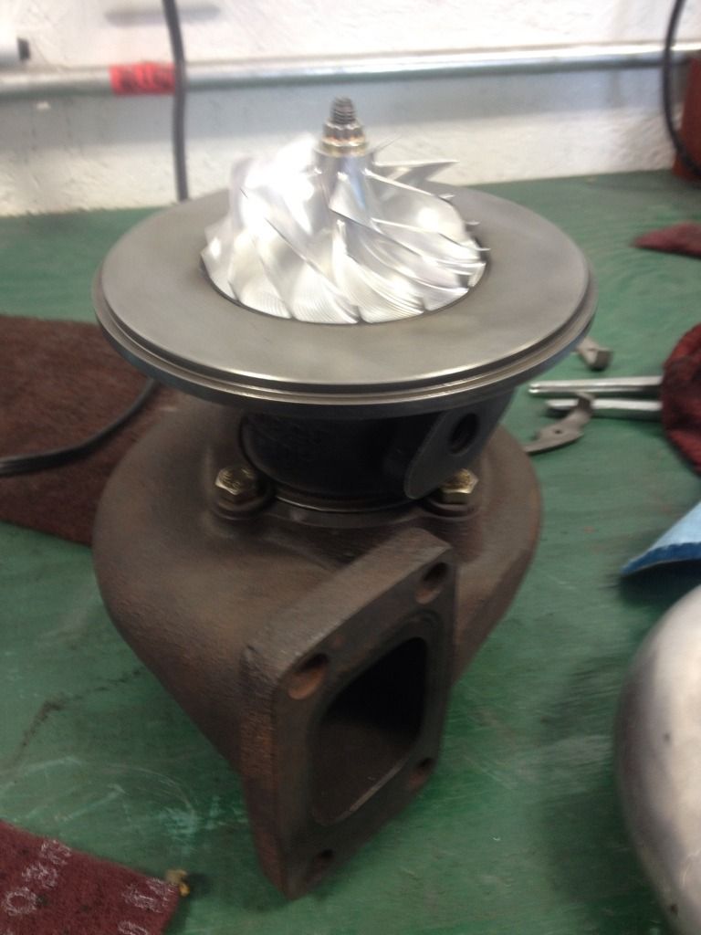

Austin got my turbo built! He posted this picture of it on the TurboLab Facebook group. Ohhhh man I'm stupid excited! Here's the measurements:
Holset HX40
6666. 66x84 compressor and 66 x 78 turbine.

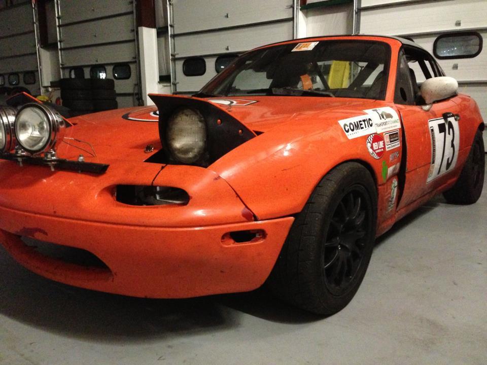

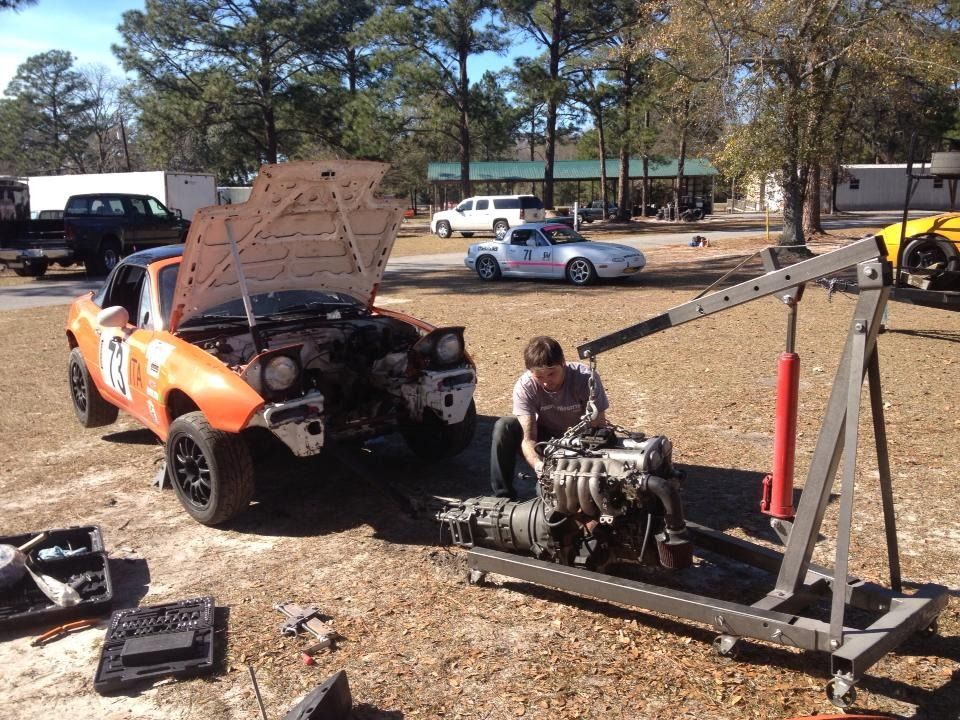

Well, this is a little update. Things have been nuts lately at the shop getting things set up and working on the race car. We were at Road Atlanta for the past Chumpcar race. We were holding a solid 6th position when the CAS fell out (DOH!!), and the wrecker that came and picked the car up decided to hook up to the front bumper and ripped the front end off the car. So we finished 32nd out of 64. Still not bad for said conditions, and we got hit a couple times, raced for about 7 hours with a broken control arm. We've been working and got all those problems fixed, and I've been assembling the spare motor to break in before we go to VIR on March 30th. But we finally got a very key part installed at the shop this past weekend...A LIFT! This will make life so much easier, I'm so excited! Also, I have decided that I'm going to go with Manly H beam rods. I can get them for a great price new through the shop, so I'm going to do that, then the block goes off to the machine shop! My turbo will hopefully be here this week, and when it gets here, I'll definitely shed some pictures :) But, here's a couple snap shots of the car, and the lift!
The race car: Built 1990 Miata. It's slow as molasses, but fun as hell to drive!
Clutch went boom at Roebling Road SCCA School. We had the motor and trans out in 20 min:
Heading to Road Atlanta:
Road Atlanta aftermath:

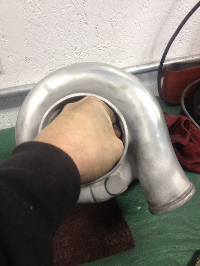

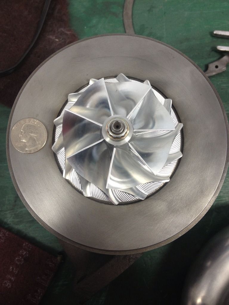

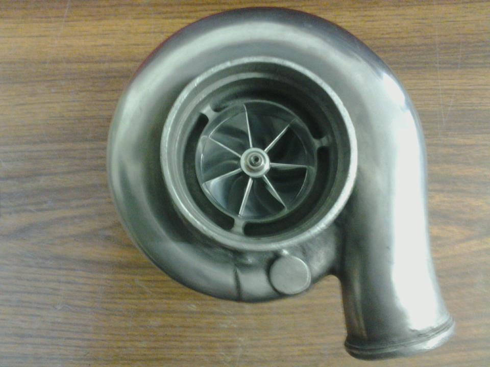

Turbo came in :)

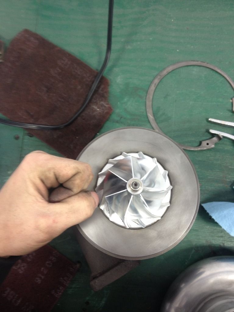

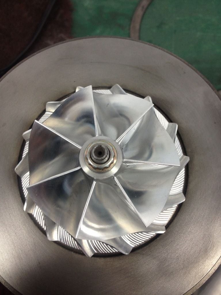

This thing is HUGE. For those of you who don't know me, or haven't met me. I'm a big dude. 6'3 200lbs. I played football and yadda yadda yadda, basically where I'm getting at, is the size of this thing. I can fit my entire fist in the inlet. It's gonna make some serious power!
Billet goodness :)
And yes this is a quarter. Just for size comparison.
It's a billet wheel that Austin supplied from Turbo Lab.

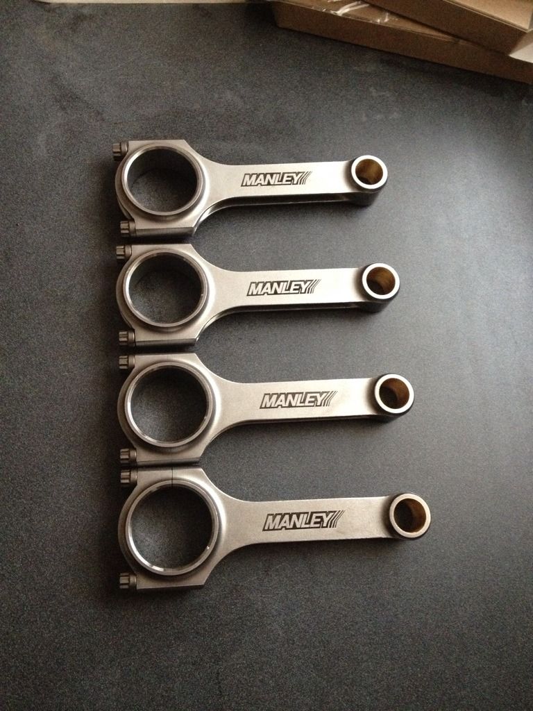

I have decided I am going to go with the Manley Turbo Tough H beam rods. Now, the only thing I need to do to get them, is get the money! I will go with used rods, but I am going to do things right and get good rods so nothing will go boom (knock on wood) when everything gets underway.

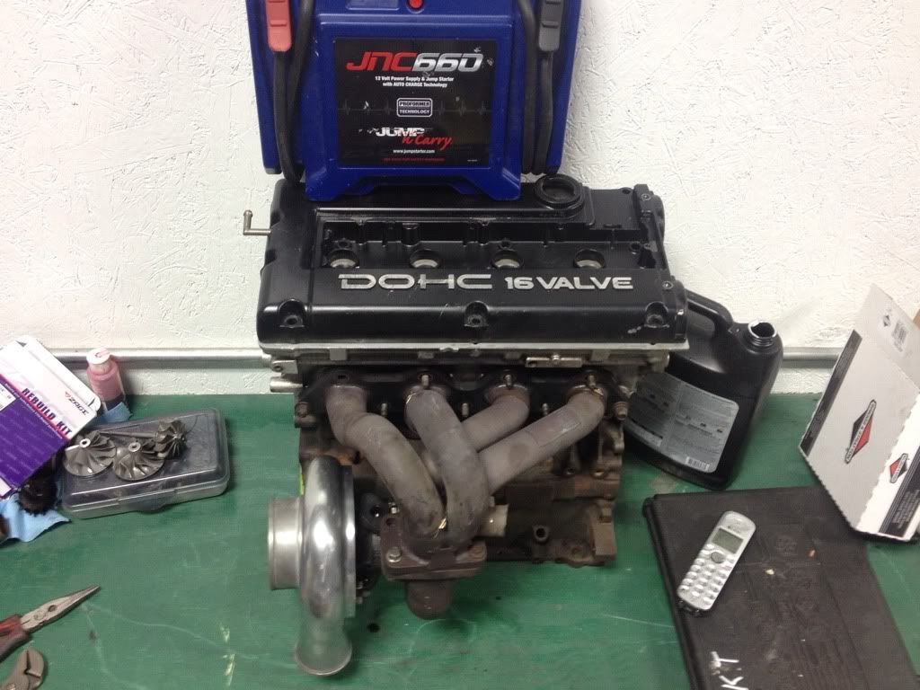

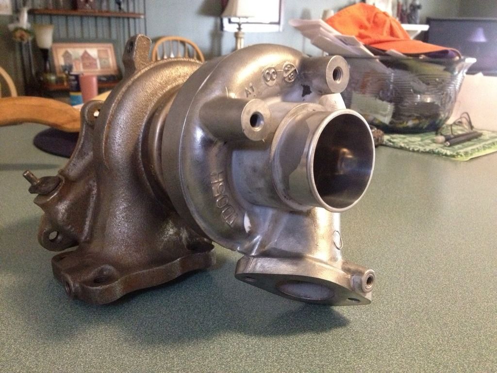

This past week was UNCW's spring break, so that was nice. I got a chance to go home, and I headed up to Stuart, VA. This is where Austin and Ian live (owners and machinists of Turbo Lab). I went and checked out their shop, shot the shit and hung out for a while. Really cool dudes. I also picked up some parts and built a new Evo III 16g.

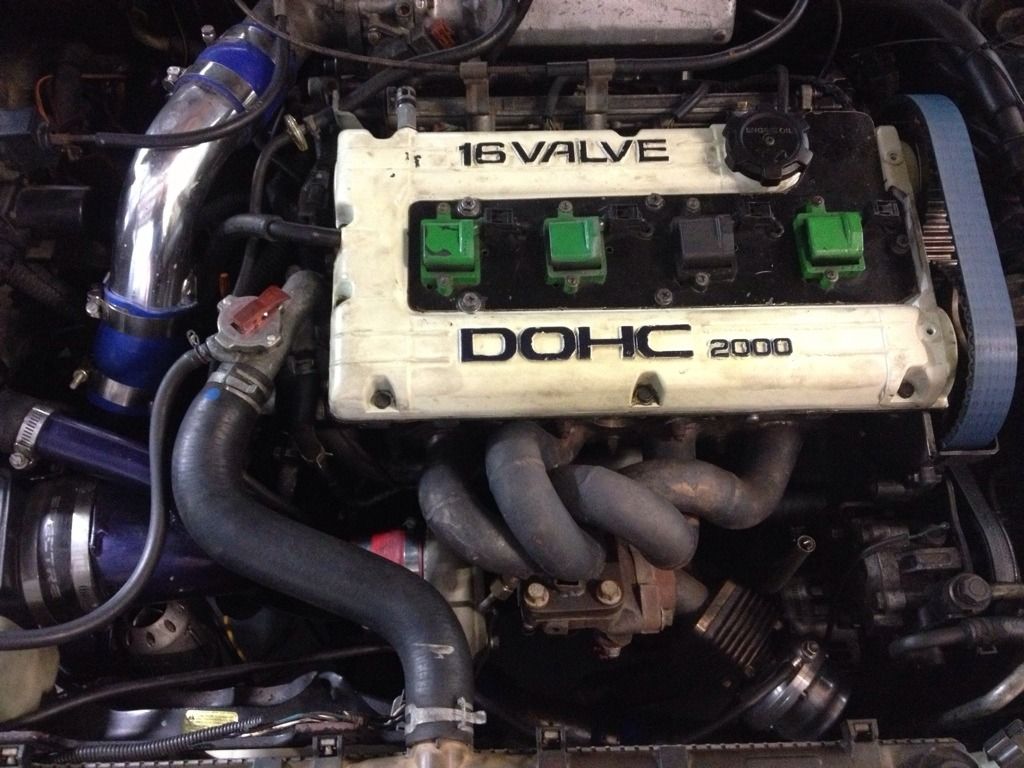

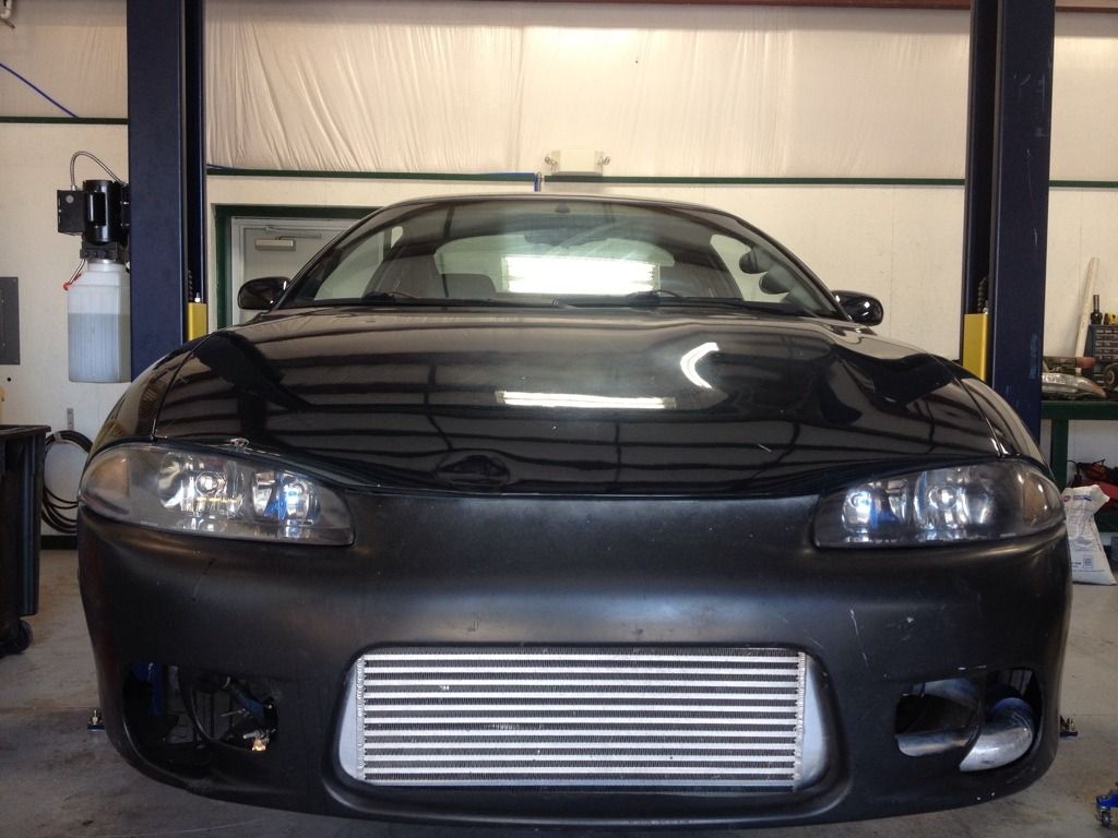

I did do a few things to the car though. I put in a slim fan (I cannot for the life of me figure out how to wire in the slim fan wires (red (+) and black (-) ) to the passenger side fan connector wires. I looked on here to see what all there was, and I found some threads with a ton of great info, but nothing works on my car? Haha I'm stumped. I HATE wiring, but I'll figure it out eventually.
I also got a killer deal on a shaved black powder coated valve cover, along with stripping that shitty green off my COP coils. And I got a killer deal on a set of 2gb headlights so I can finally mount my 2gb front bumper :) Here are some update picjas:
16g I just built:

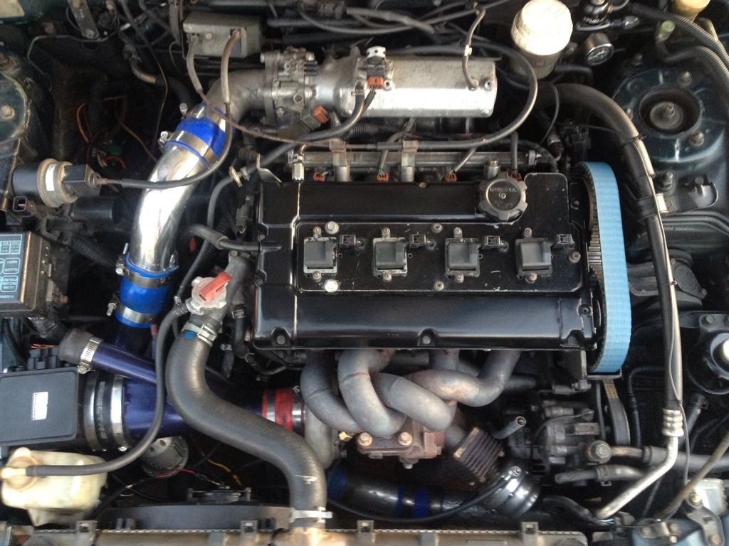

New engine bay shot:
New front end:
Woohoo update time! Got a couple goodies in the mail today, along with word I'm getting my block back soon :)

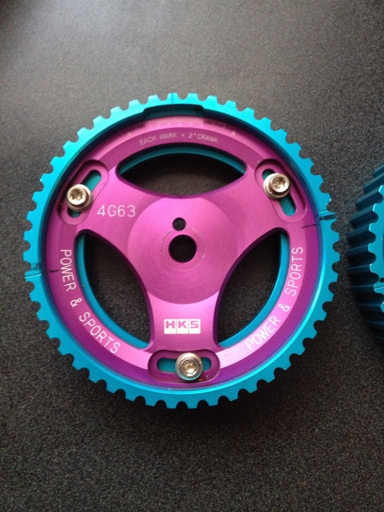

HKS Adjustable Cam Gears: (Thank you Turbo Monk3y!)
Manley H-Beam rods with ARP 2000 rod bolts!

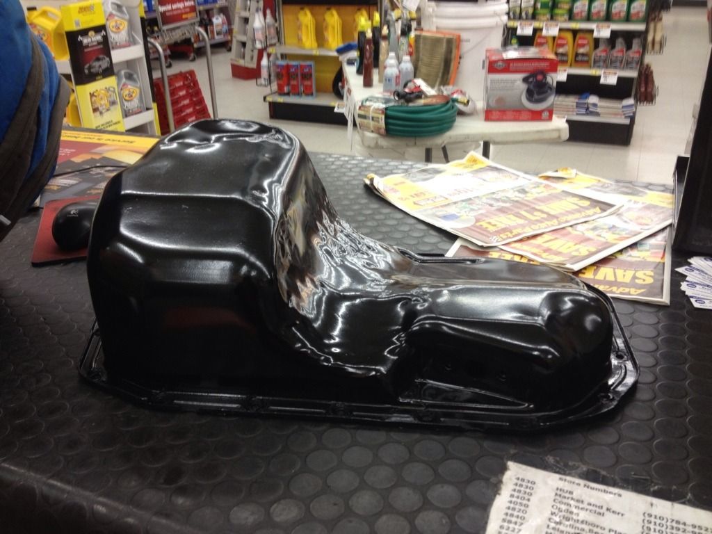

And I took my hand at fixing the dents in the oil pan from the block when I bought it. It looks like someone shot it repetedely with a BB gun. So, I un-dented it as much as possible and put some fresh paint on it.
If anyone has one in better shape, I'll probably try to pick it up from them. But for now, I'll work with what I have. I'm going to pick up my block later this week, or at the beginning of the week. I had it hot tanked, bored .20 over, honed, and had the crank journals line honed with the new ARP studs. So, that's all for now till I get the block back. Then, I'm going to paint it and assemble it!

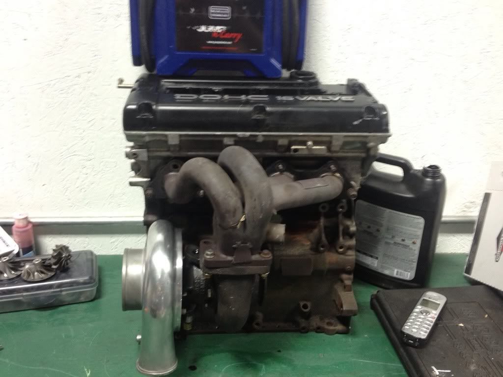

Not much really going on lately. I had to re-sell my rods and v3 because I'm moving soon and need the cash! But, I did get my hands on an old school Apexi T3 manifold. It's cracked in a few spots but I think it's fixable. I'm going to have to do some finangeling to get the hotside on my HX40 to fit. In the picture I'm about to post, the turbine housing hits the block, and the cylinder head is moved forwards so it will clear it and look cool for the shop when customers walk in.
