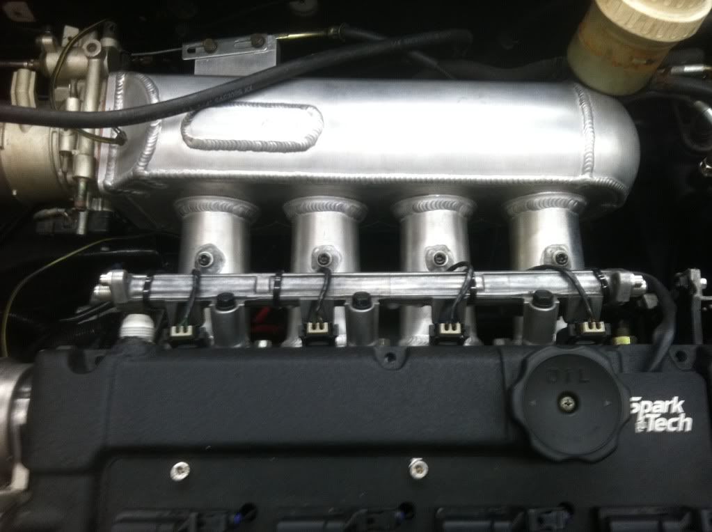

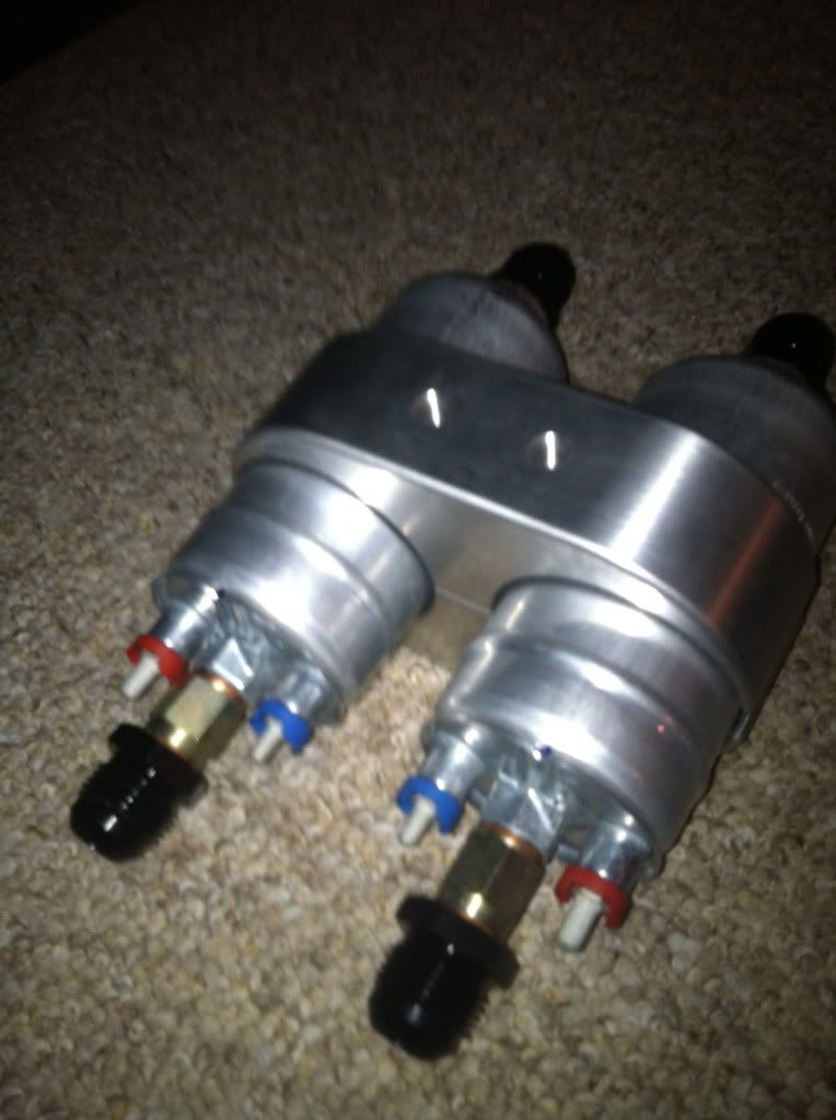

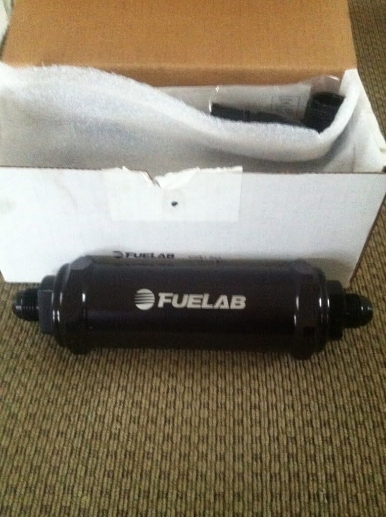

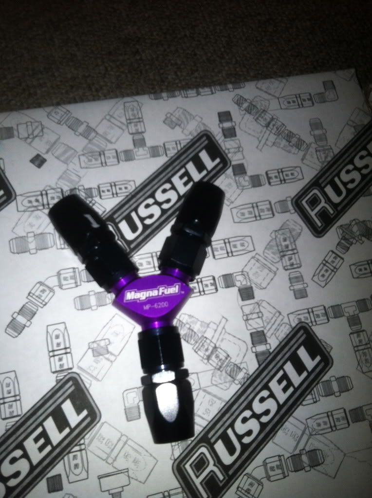

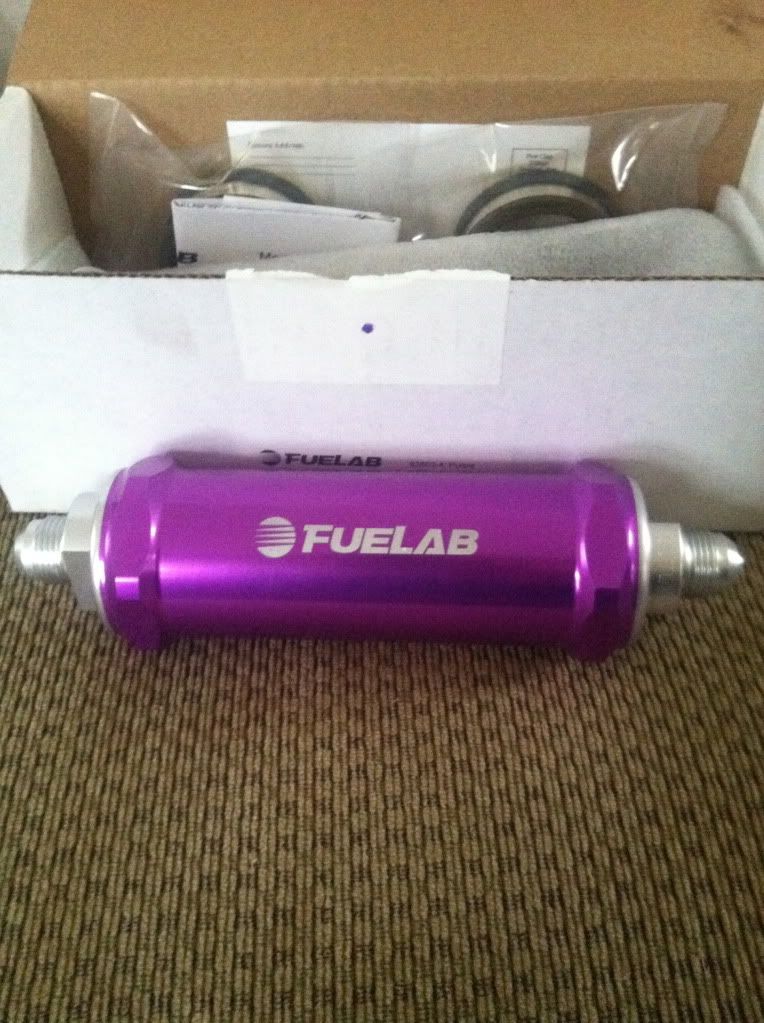

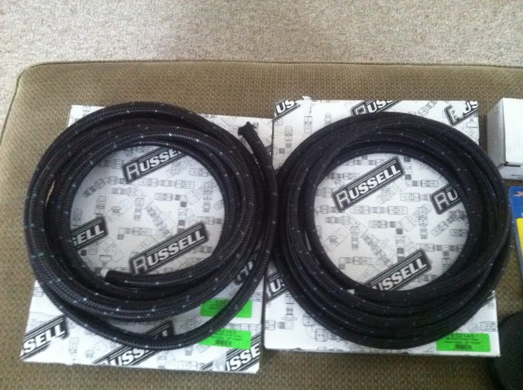

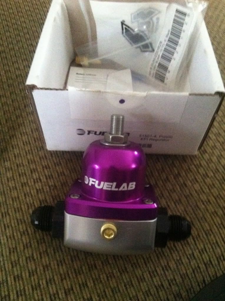

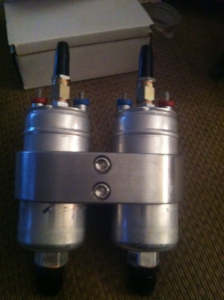

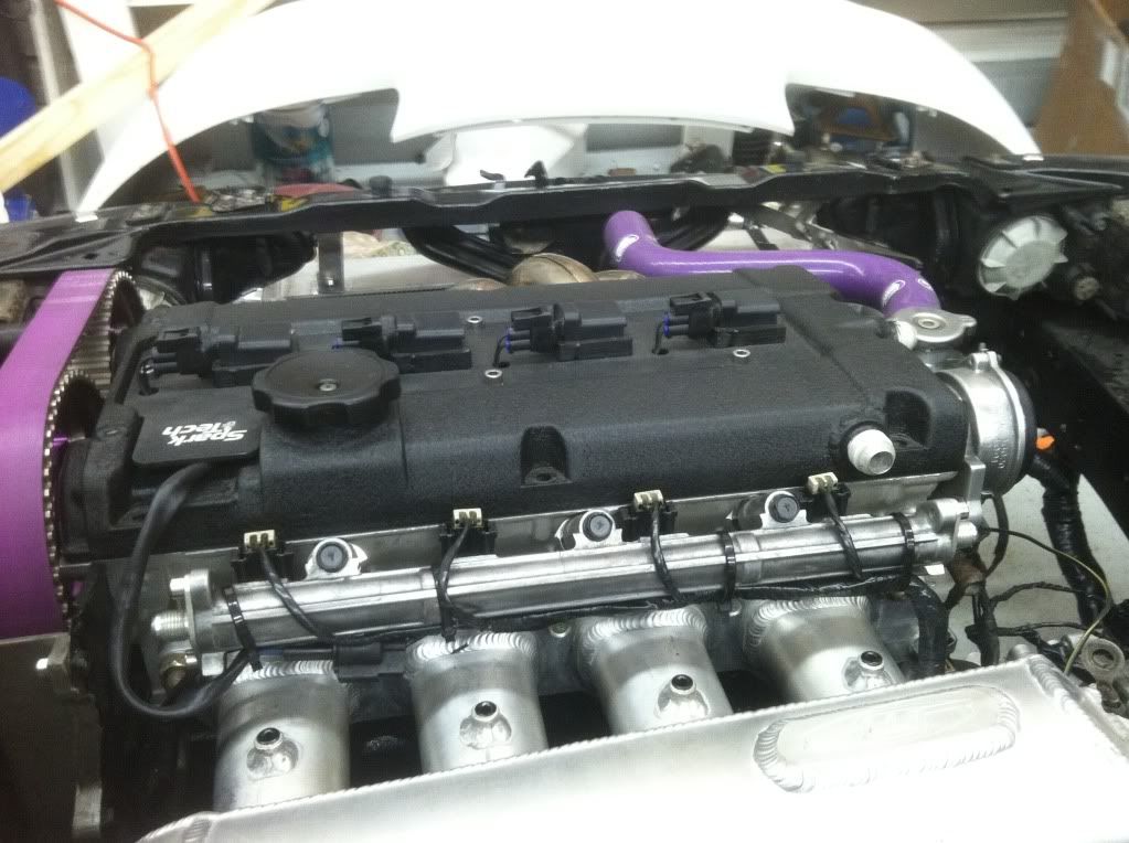

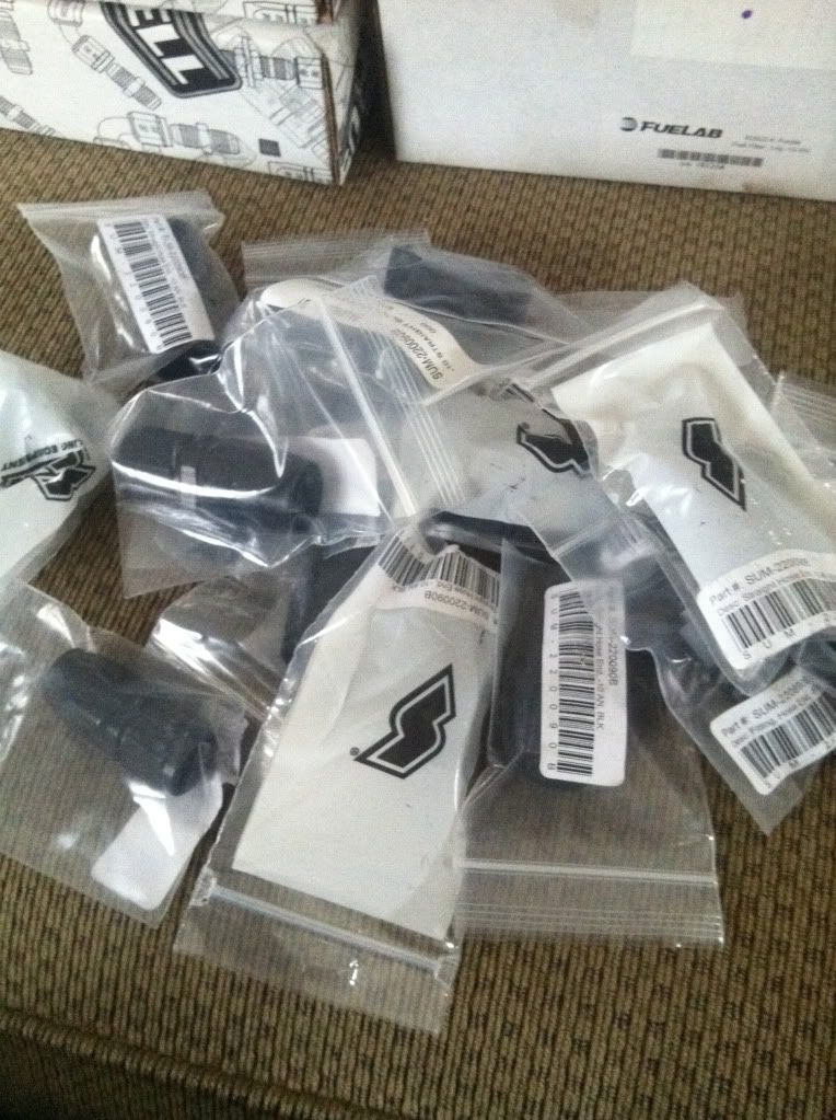

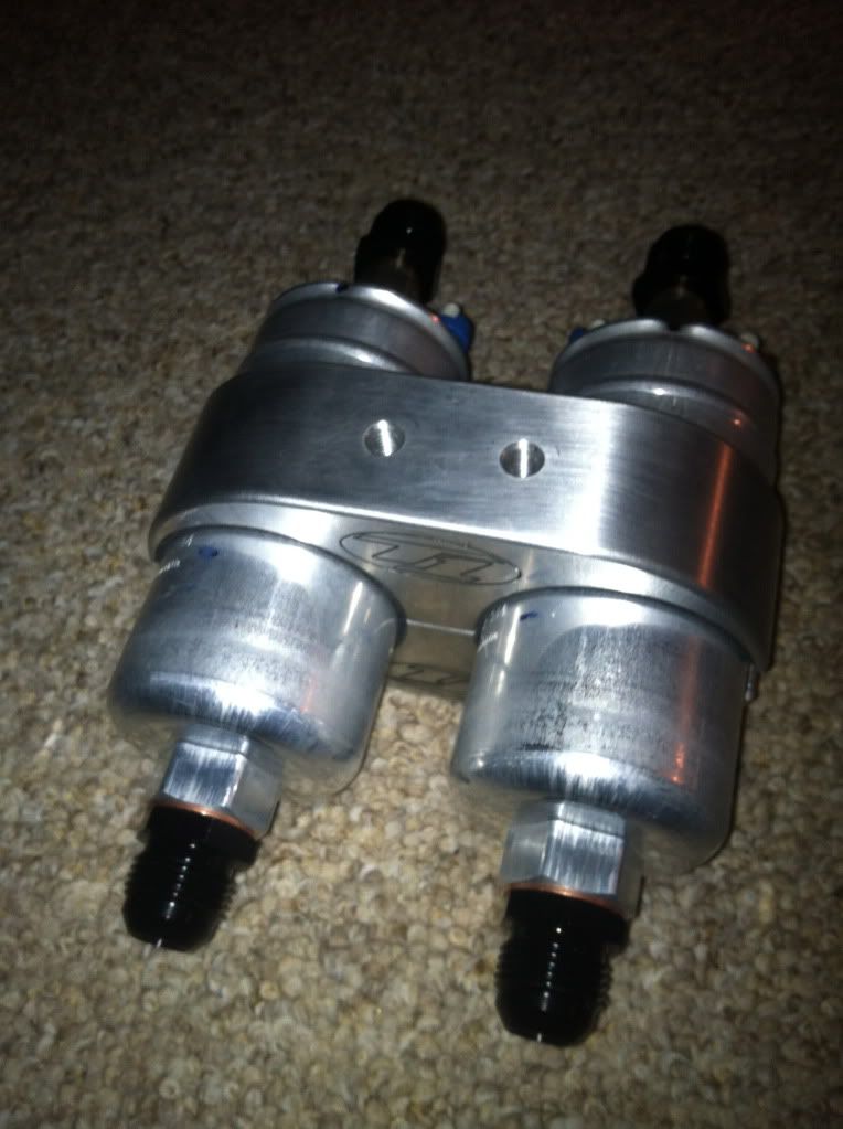

Alright well tonight I broke down and spend some more money on this gold digging bi*** I call my car. Ordered my entire new fuel setup dual Bosch 044 pumps, Russell pro classic nylon hose, AN fittings, FIC 1850cc injectors, Fuel lab FPR, Dual Fuel lab filters, Frontline Fab tank.

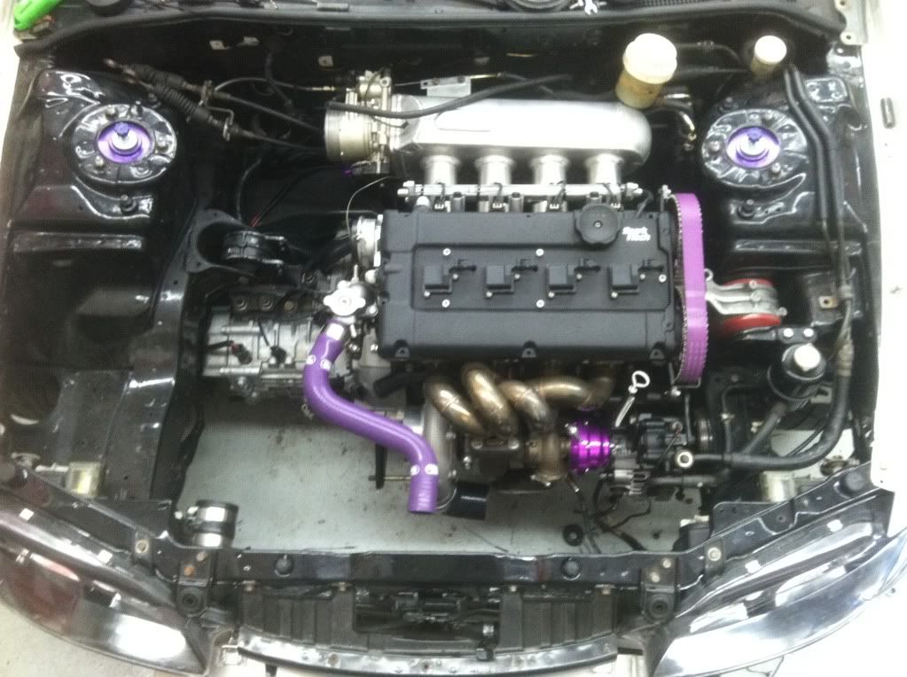

Here are some pictures of how the car looks as of tonight
You should run those injector wires under the rail to hide them better.

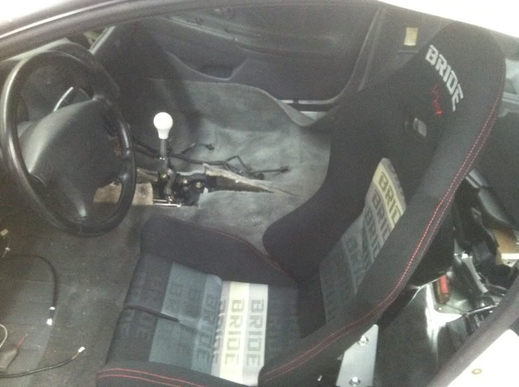

Build looks badass man, never saw those style brides in an eclipse yet, mostly ive seen them in acura rsx's for some reason.. LOL never liked them. But seeing in the eclipse gives me a whole new vision. love it man. :hellyeah:
Amazing build, I love really like the white with bronze look, Also great choice on the rpf1's

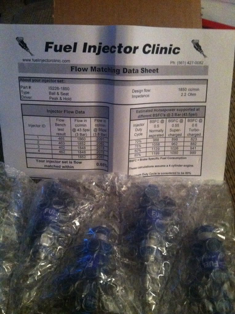

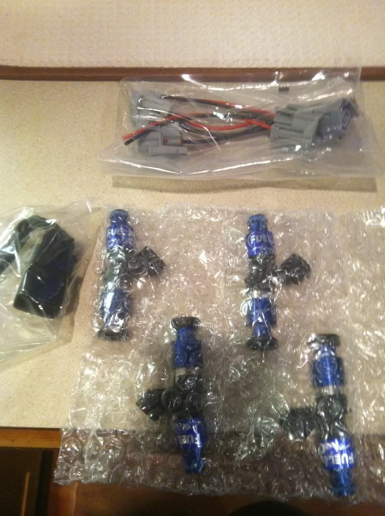

With the FIC BlueMAX 1850cc's, are you using the FIC EasyTune box with it?

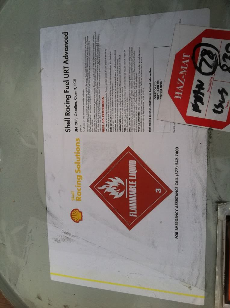

I sent the injectors back today after deciding the fuel I am going to be running. I got the 1850's because of the oxygenated gas issue with the high z injectors. I found Shell urt advanced race gas unleaded(ordered a 55gal drum), so now I am going to run the high z 2150's should be here by the end of the week. I am hoping to have the car running and tuned in the next 2-3 weeks.

Yeah, I think you will like the high-Z 2150cc's better. The only fuels you cannot use will be VP Q16 and VP Import due to being oxygenated. If you have that covered, I don't think you will be running out of fuel anytime with those 2150's unless you are running E98 in the future. E85 or non-oxygenated race fuels will be fine with those 2150's for your goals.

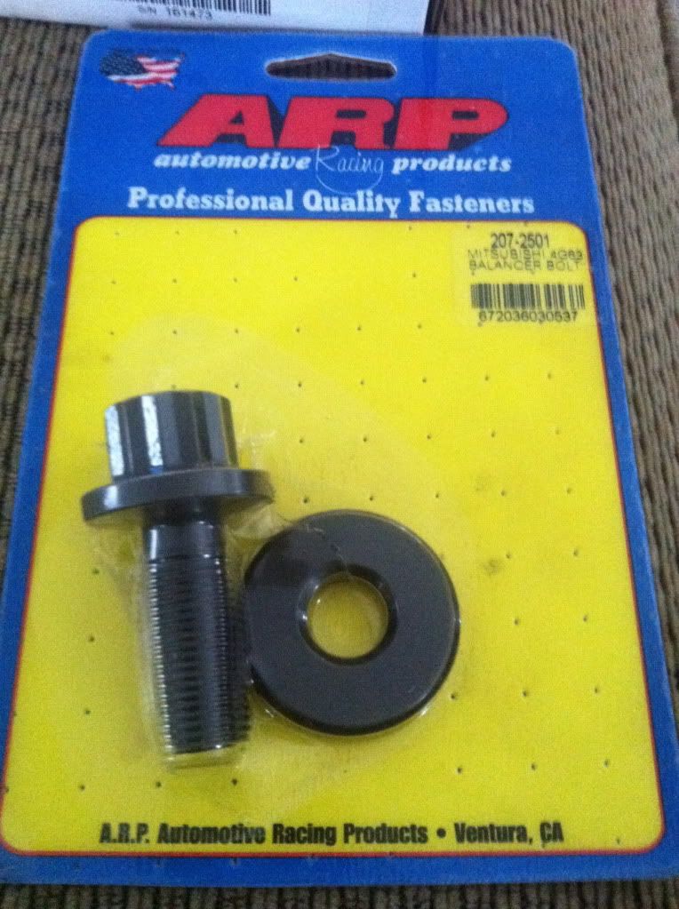

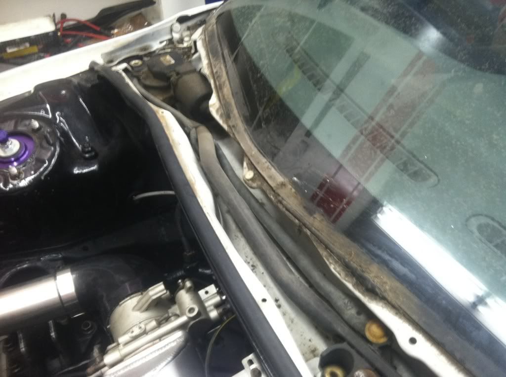

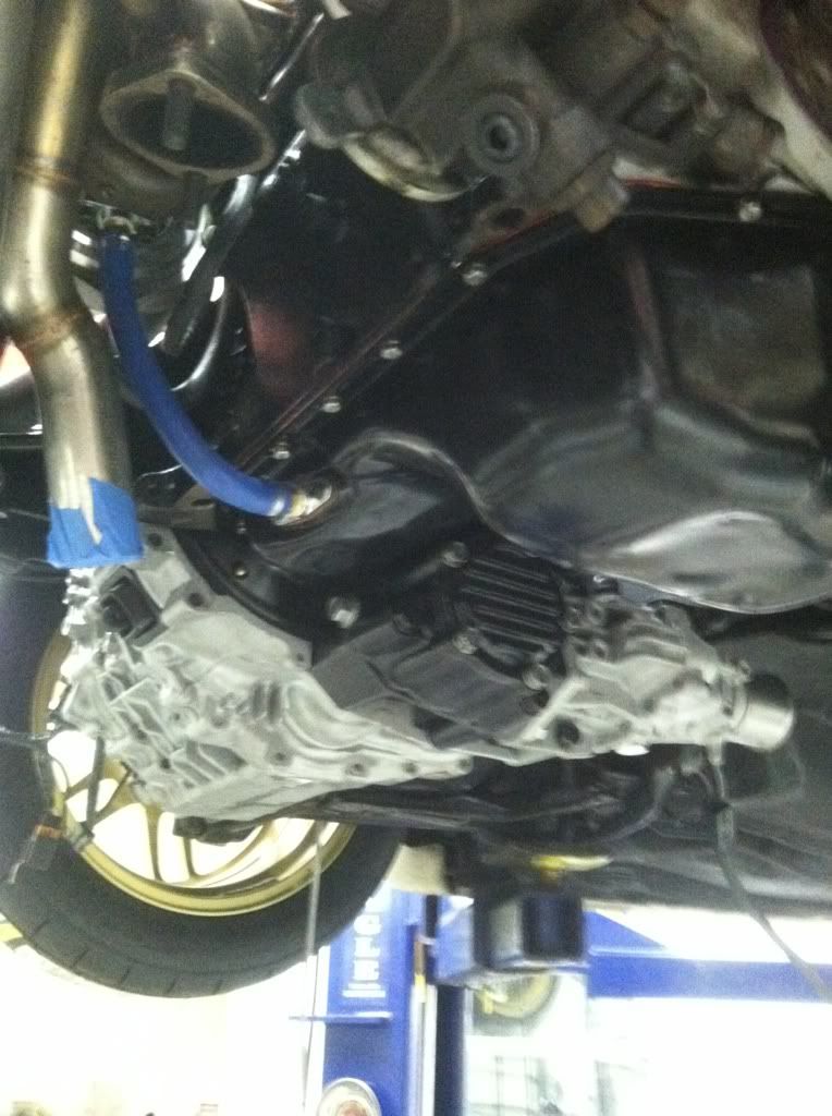

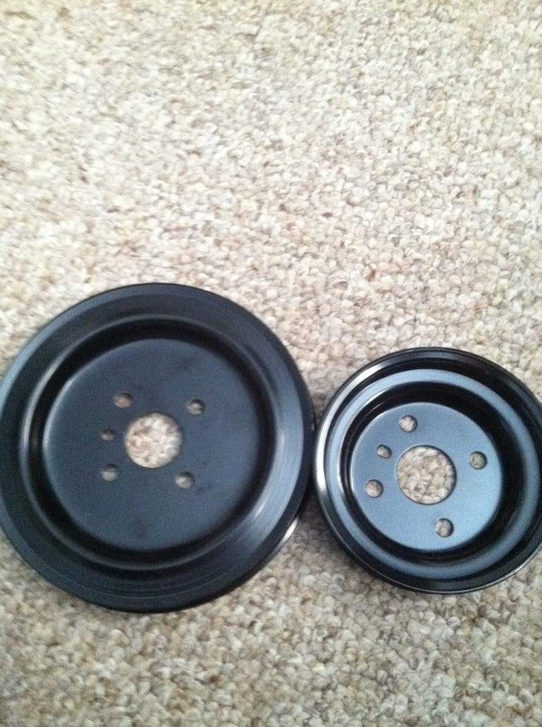

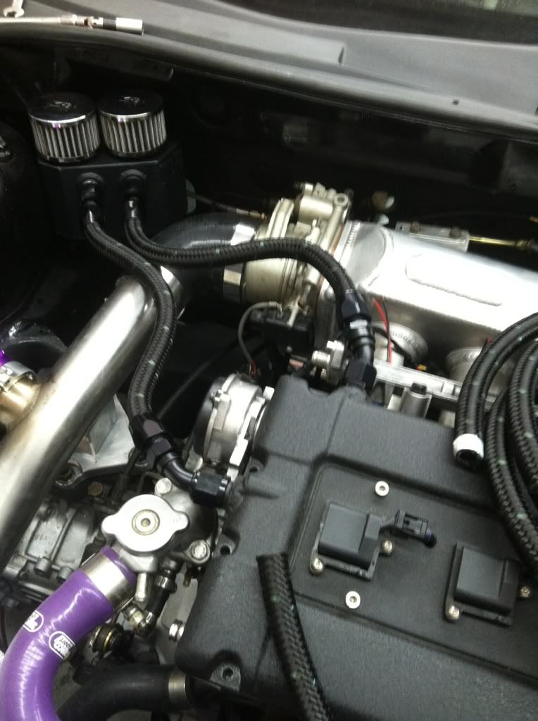

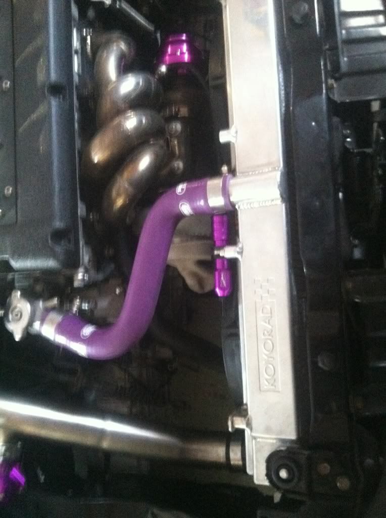

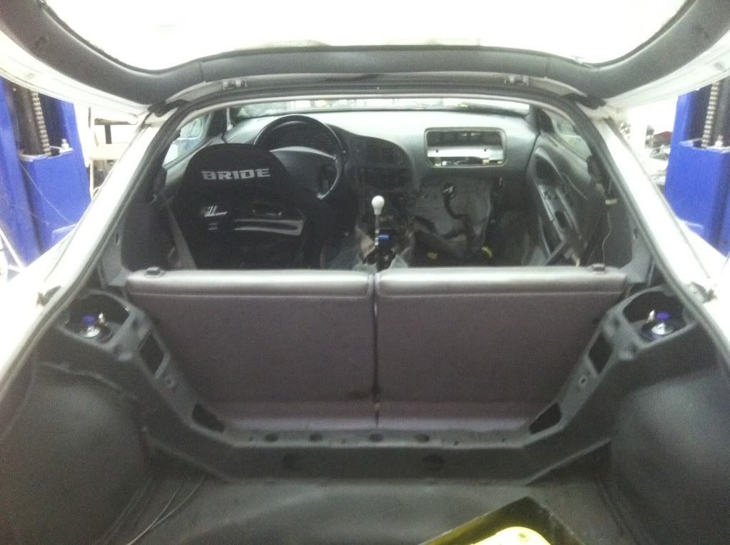

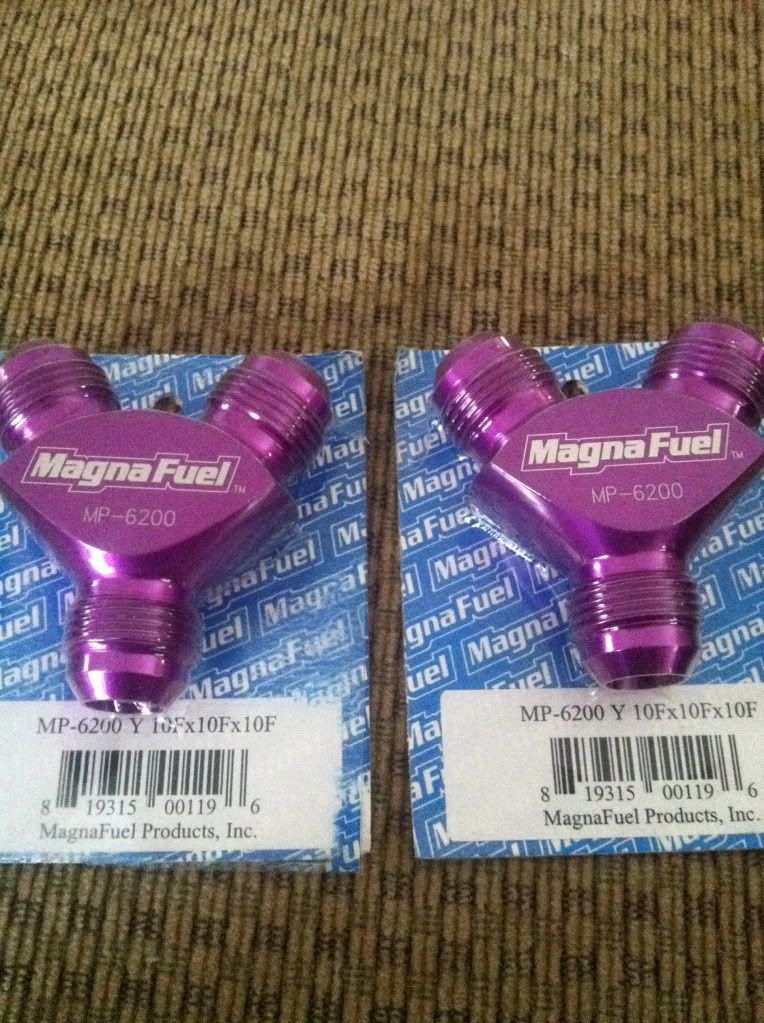

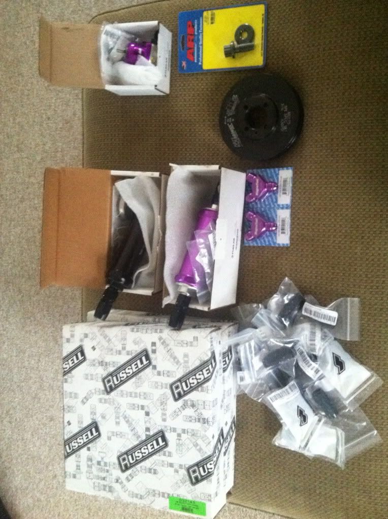

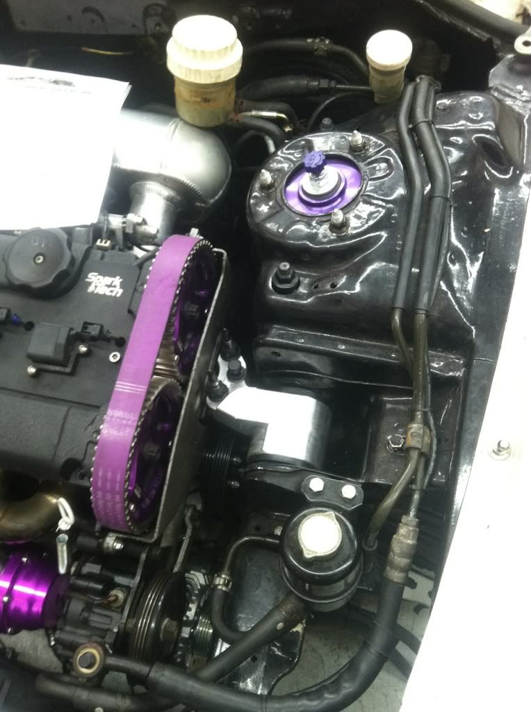

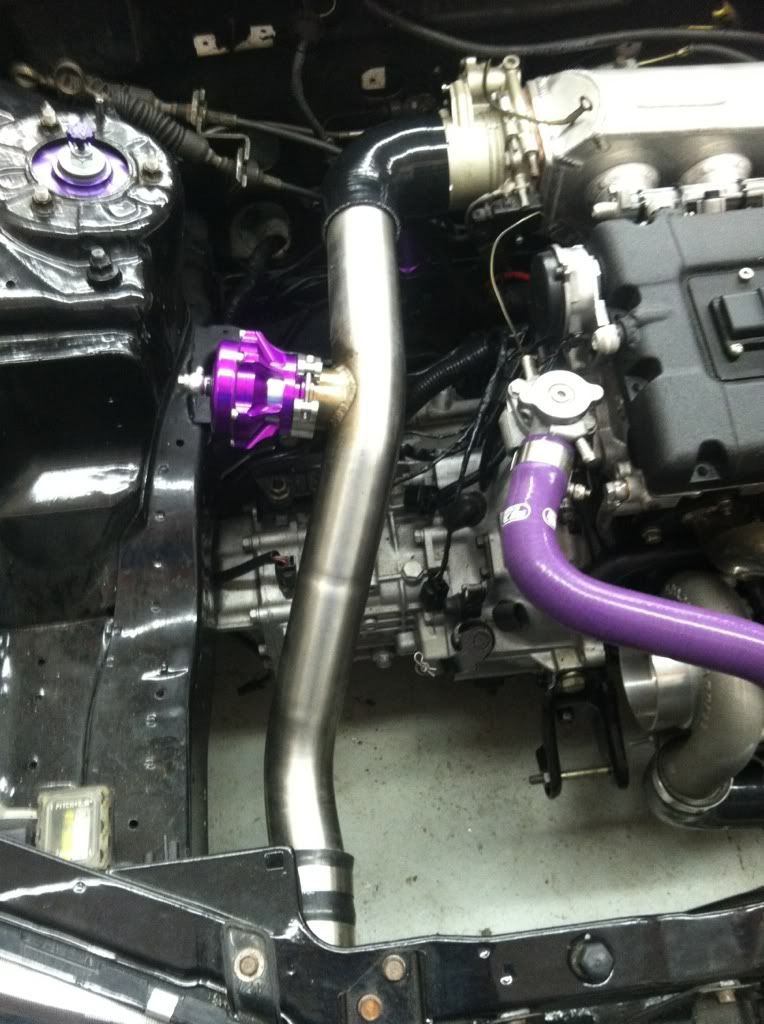

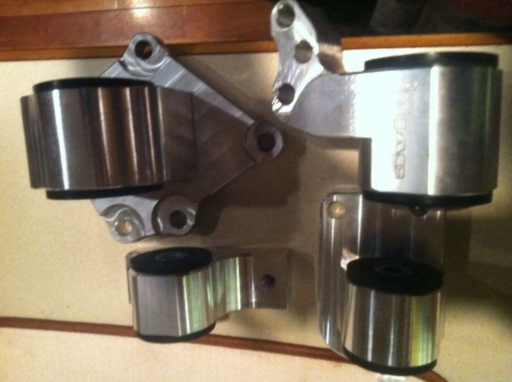

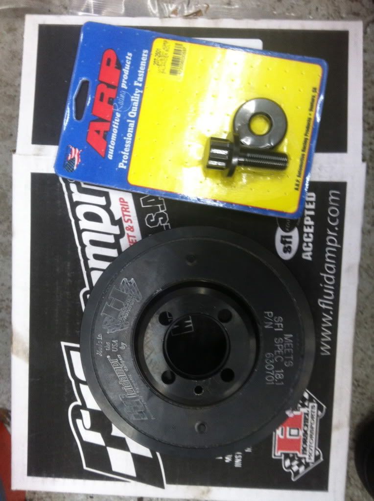

Yes I will be making videos and traveling to every event I can make it to also. I have some more parts to order and I am hoping to be done by april. :pray:. Well anyways here are some more pictures of some little things I have been doing and new parts that have come in.

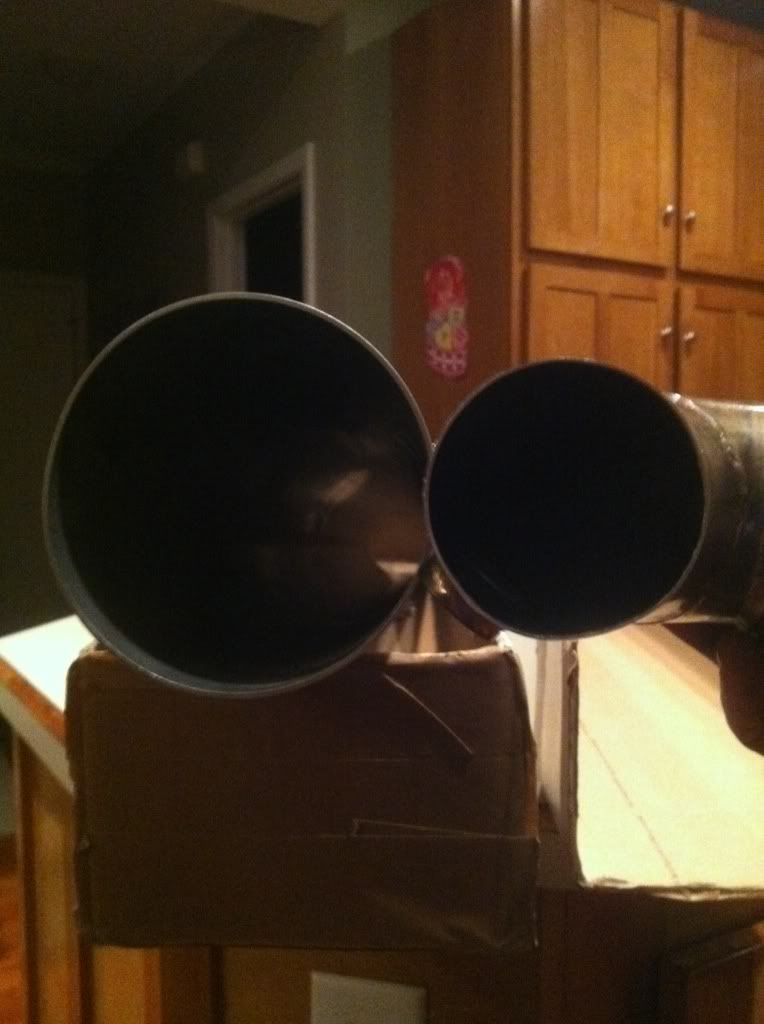

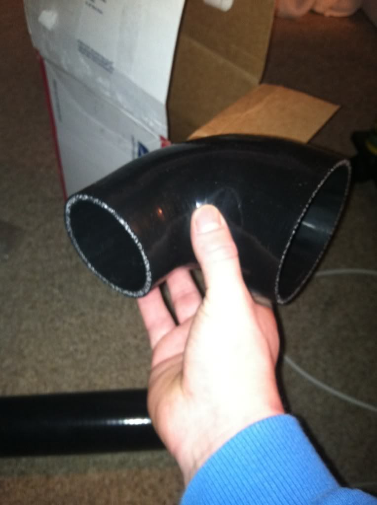

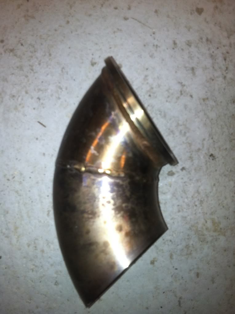

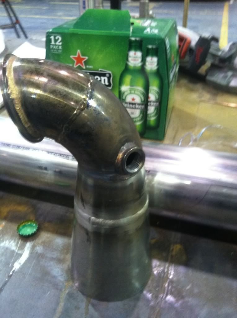

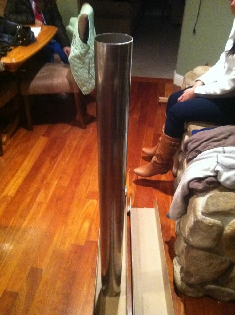

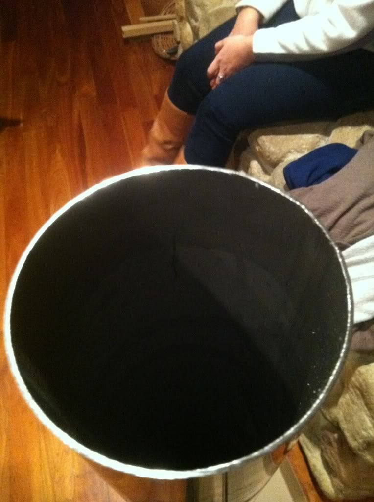

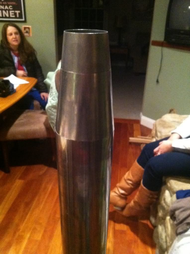

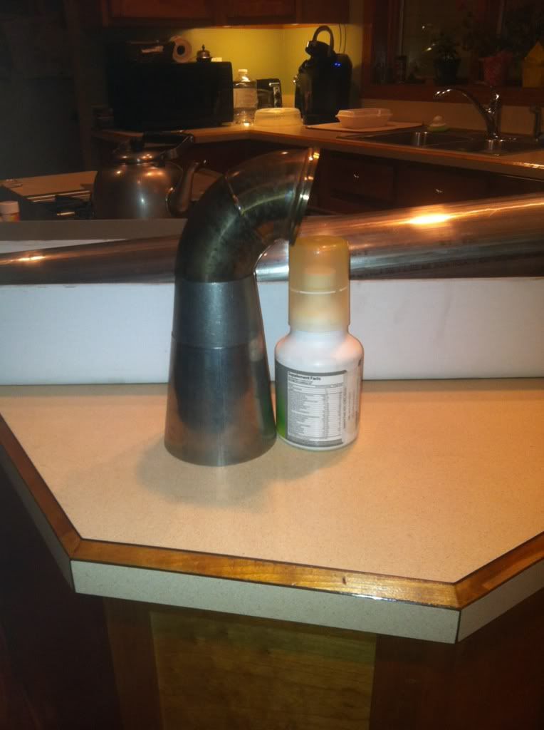

I am building my exhaust today here are some pictures of it before.

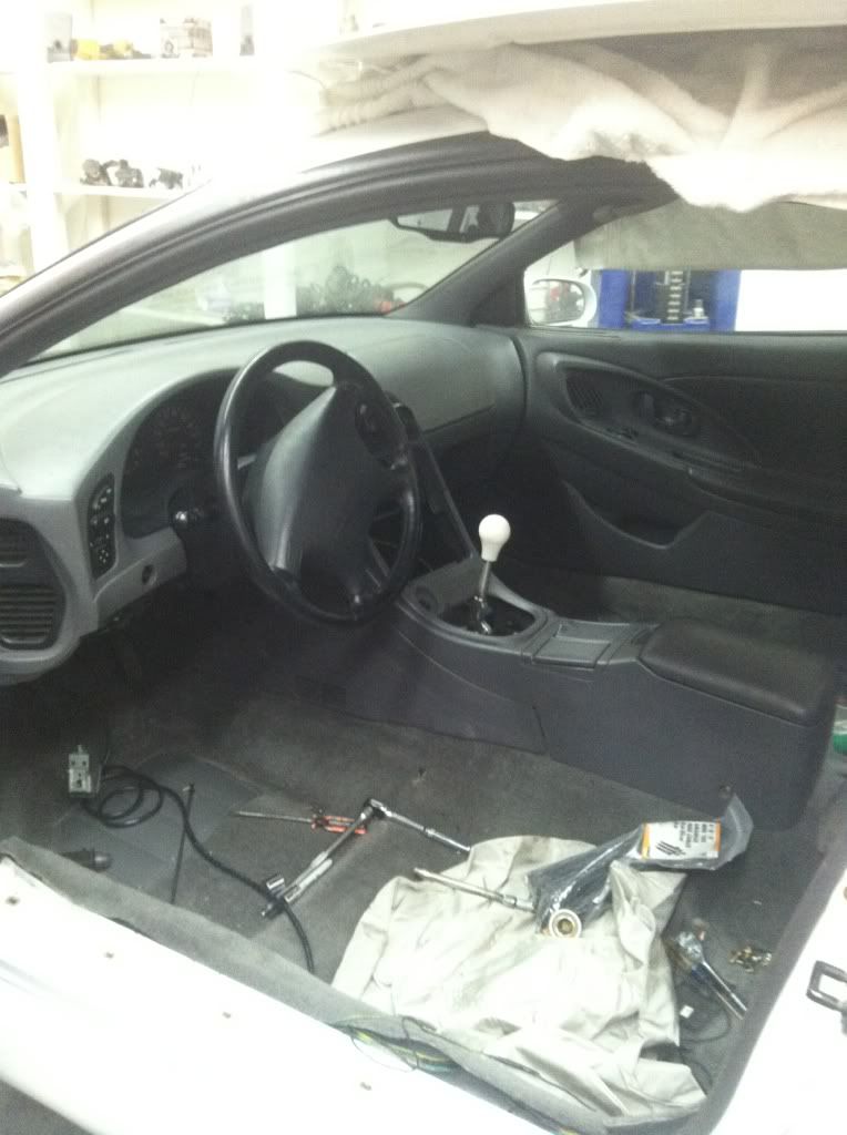

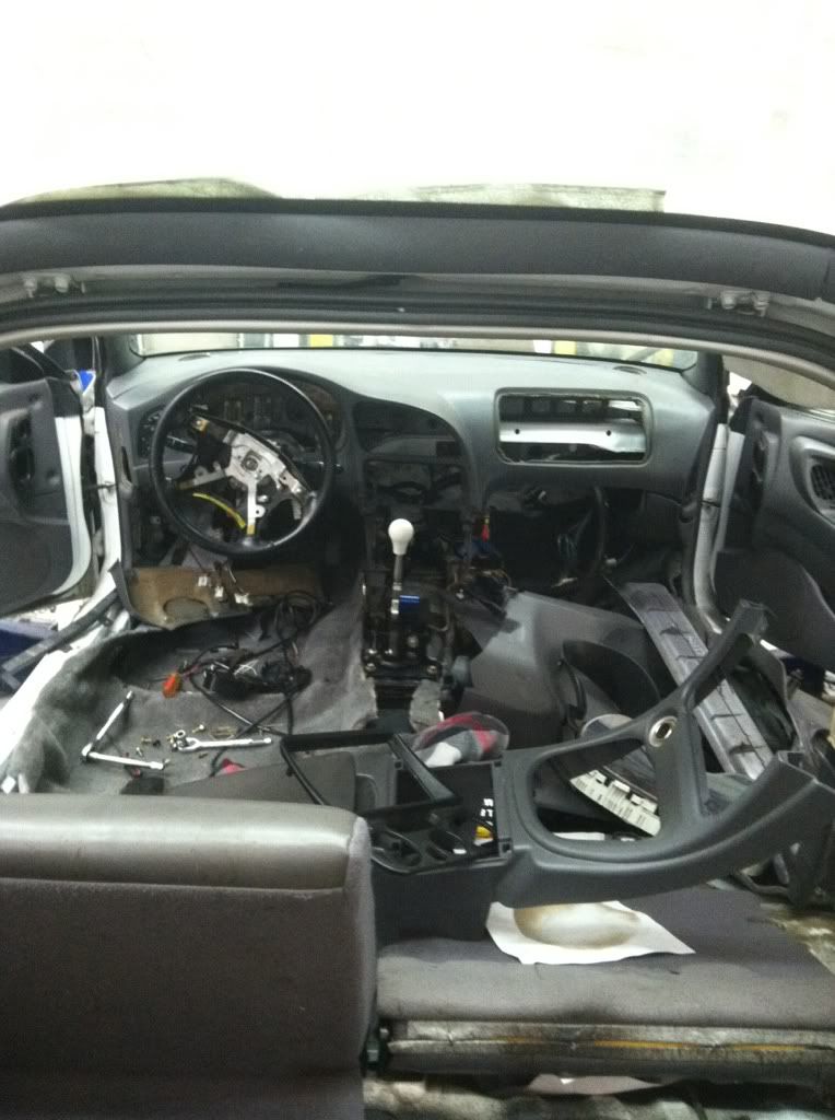

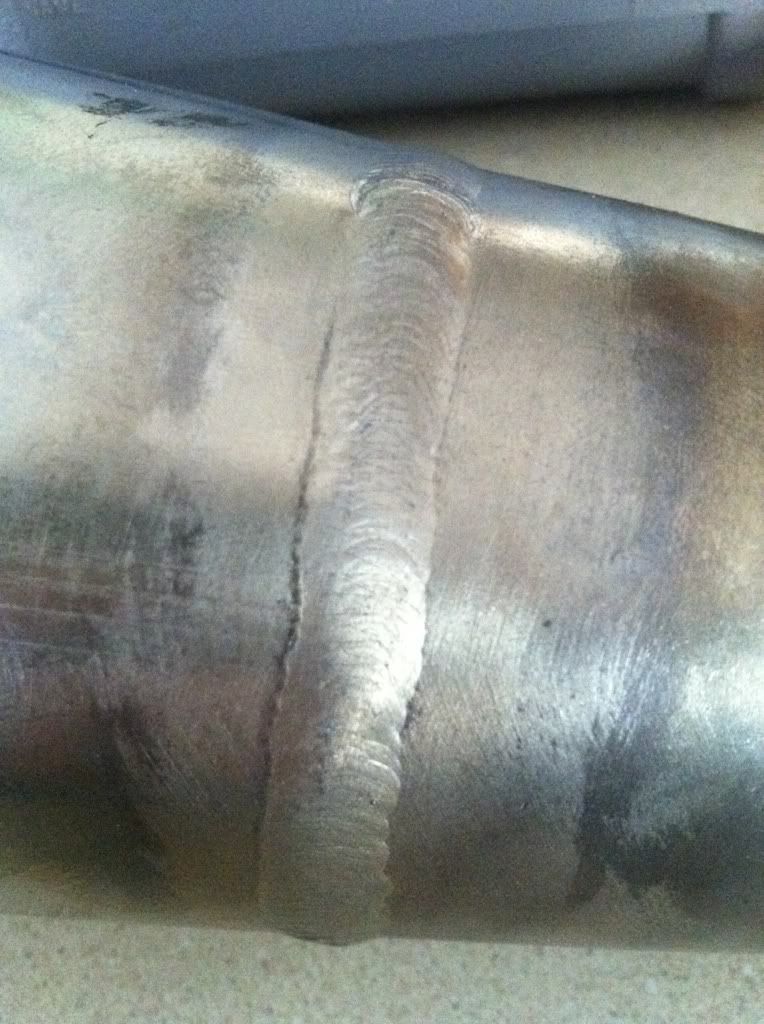

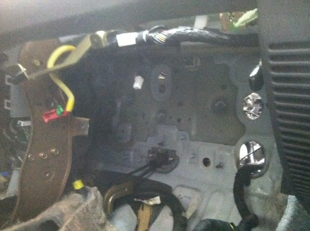

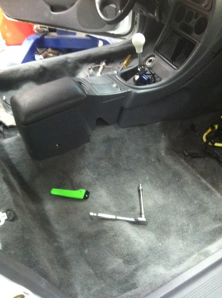

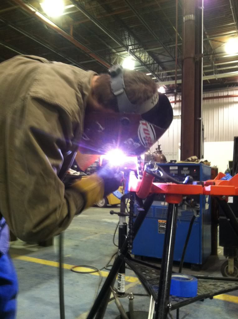

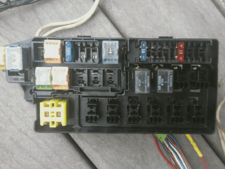

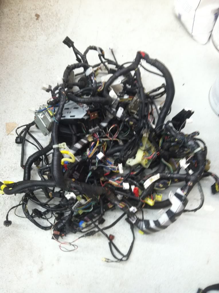

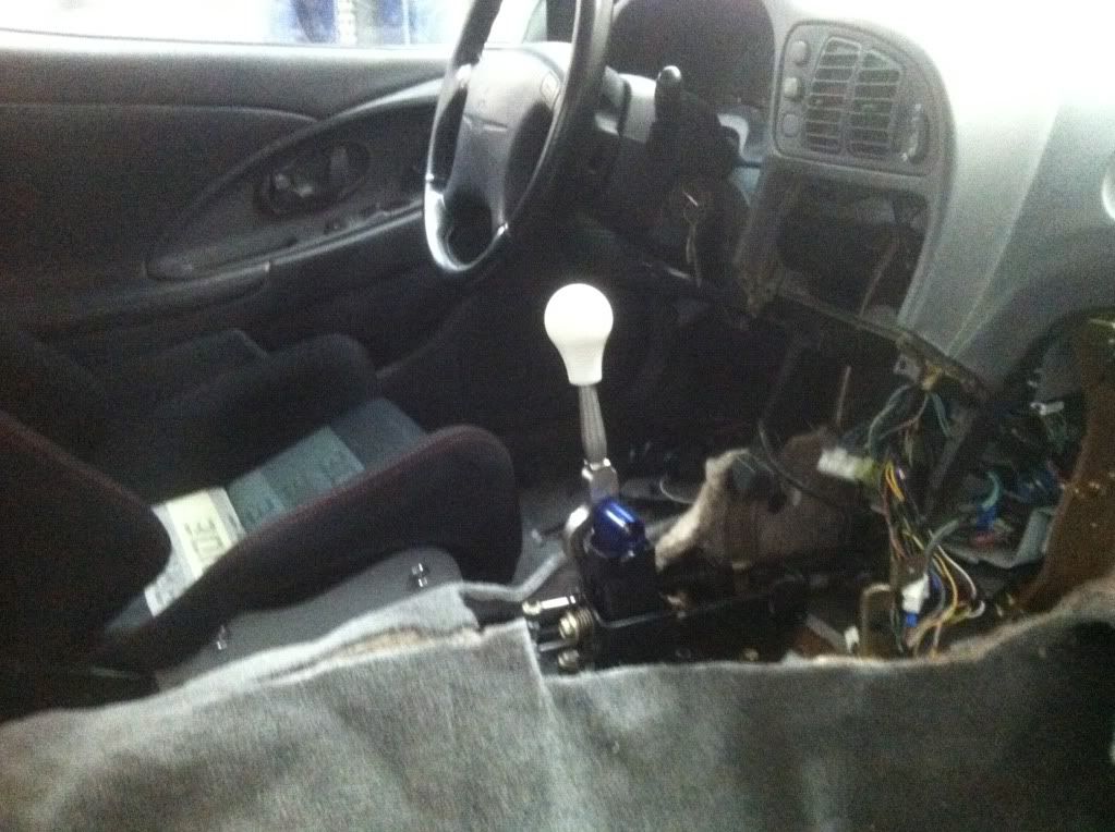

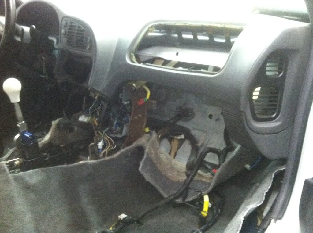

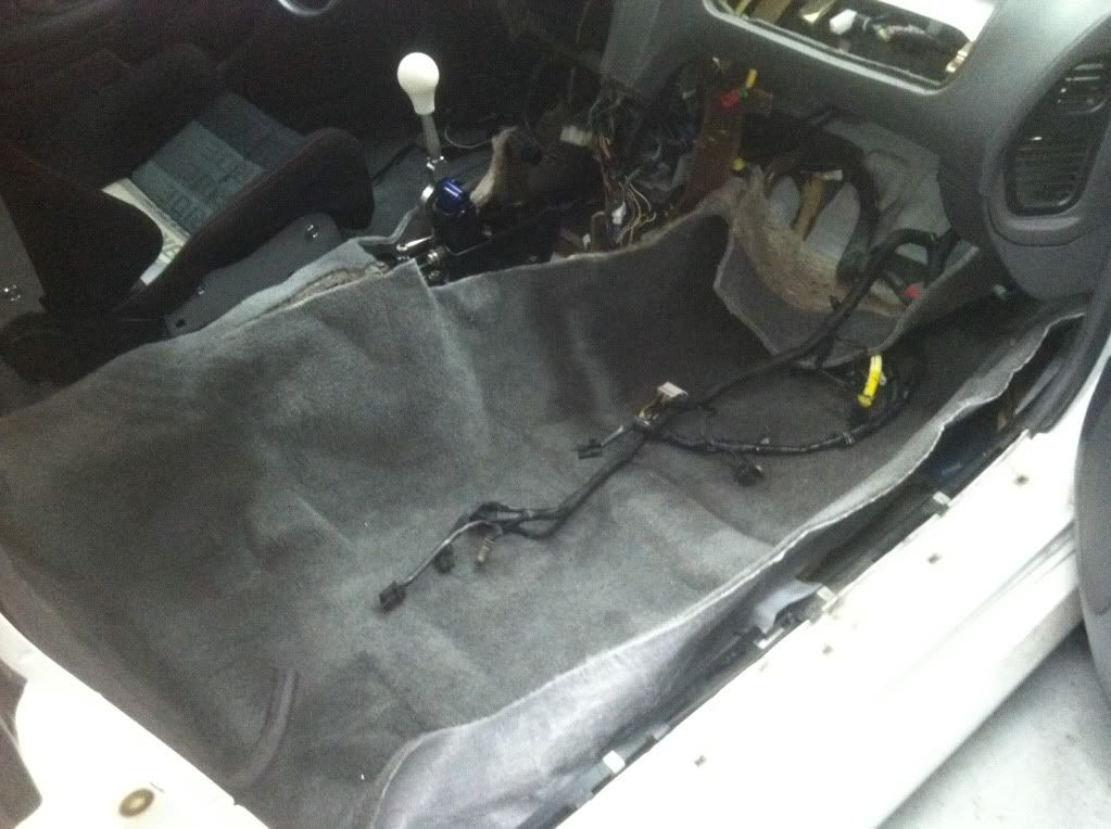

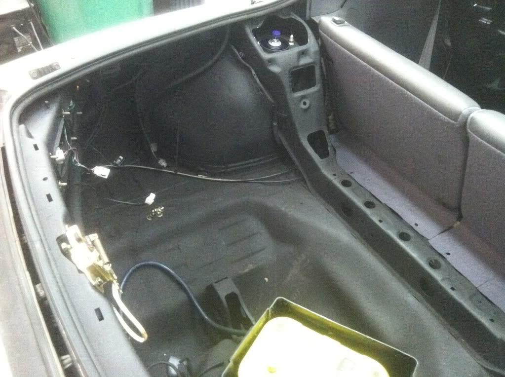

Well I had my interior almost completed. Then I started talking to cory at bbfab and decided to send my harness to him to be stripped down. I would rather not deal with the headache and take the time do it. Sadly I don't have a welder so I brought part of my exhaust to my buddy's house and got some of it welded up waiting on a 90 bend to come in so we can finish it. I also the race gas I ordered came in today.

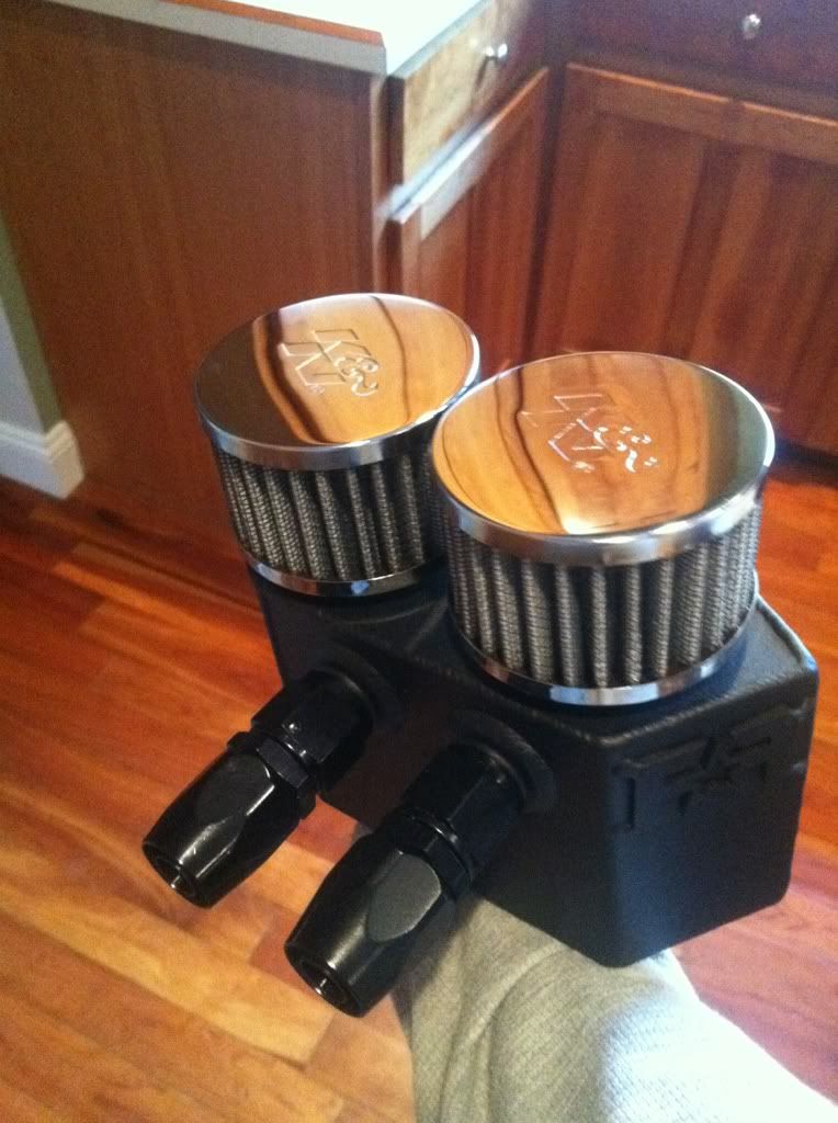

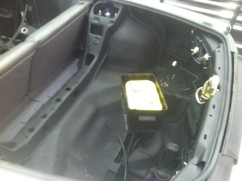

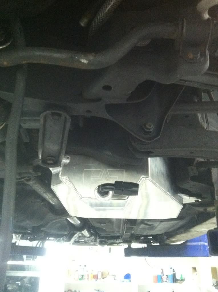

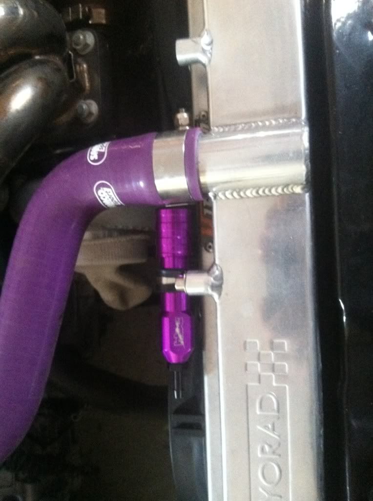

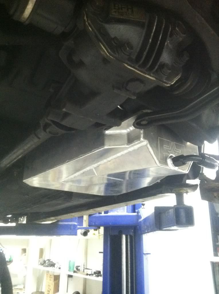

It has been awhile since I have got on here but heres a little update. My tank finally came in from frontline fab and catch can. Tank is -10 feed -8 return so fuel wont be a problem. I am going to be doing a 10pt cage and a full aluminum exhaust soon. 2150cc injectors came in and I just order an RCI fuel rail -8.
Lost over 20lbs off my harness. Cory bbfab
