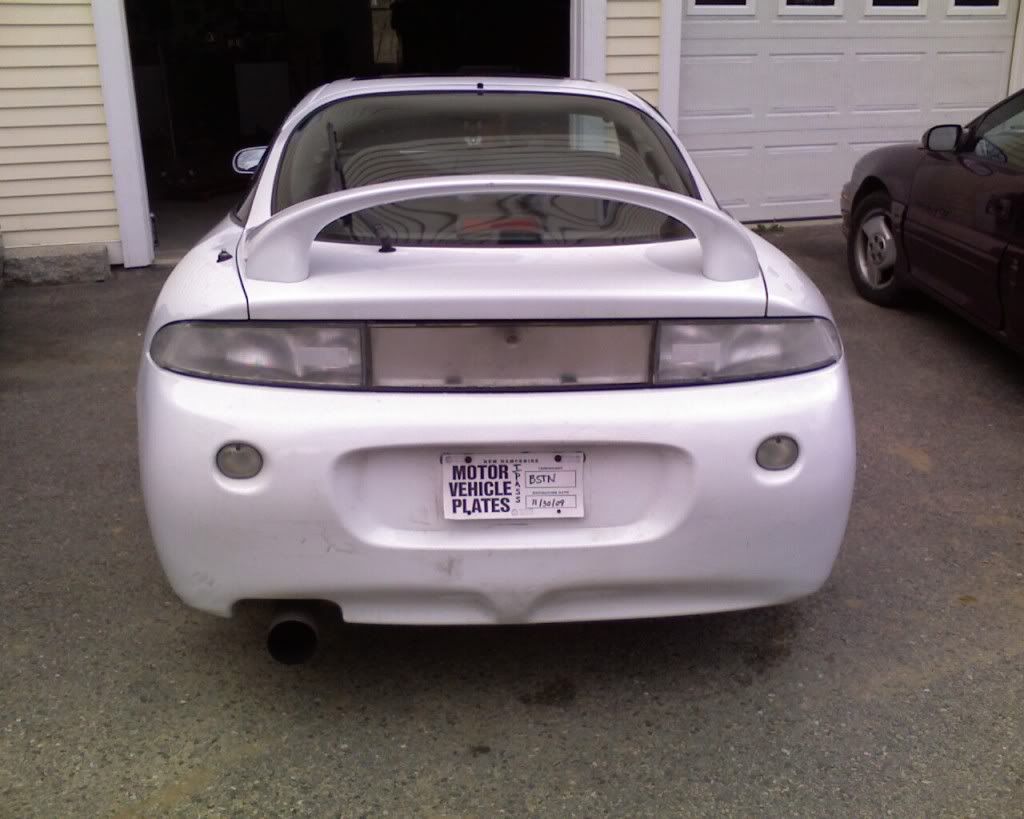

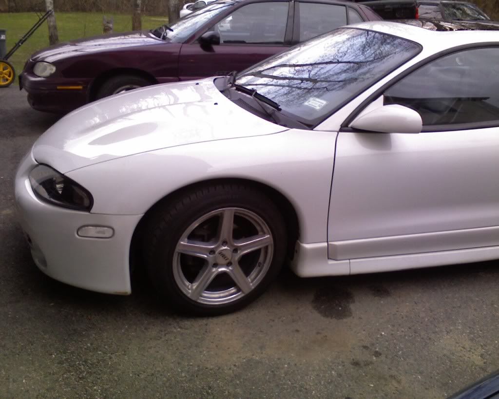

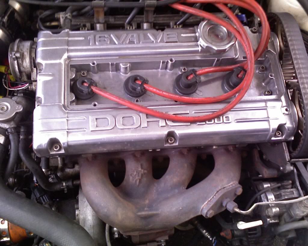

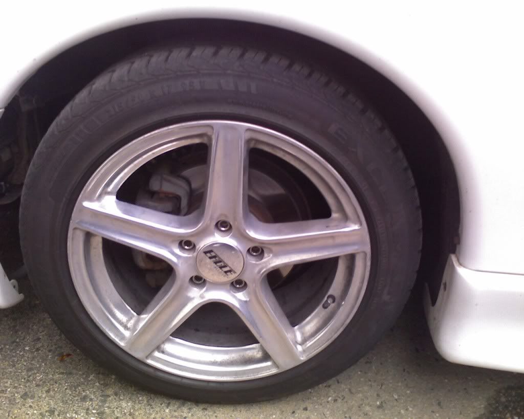

Bought the car in Albany, NY for $5200. Car had Hanh 20G, Hanh FMIC, dsmlink v.1, 550cc injectors, and sweet clear tail lights. ROFL
A few picture of the car when I first bought it, and the haggard mods the previous owner did to it...

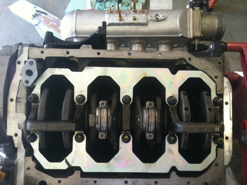

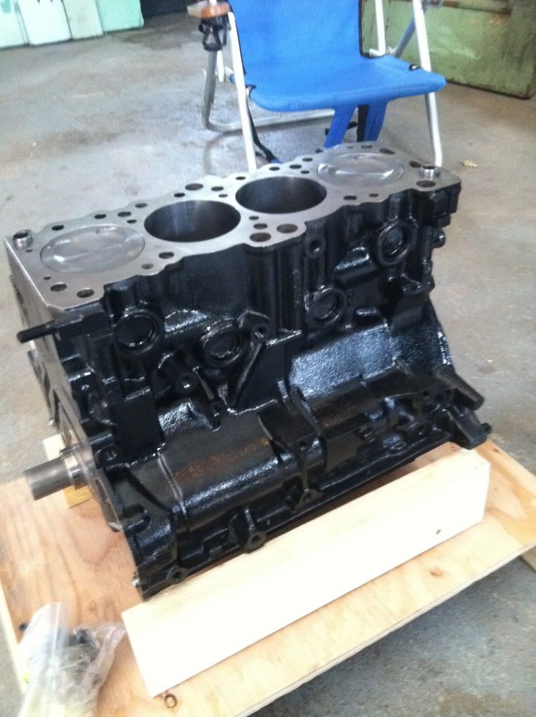

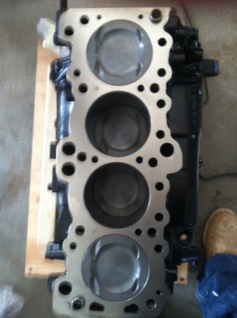

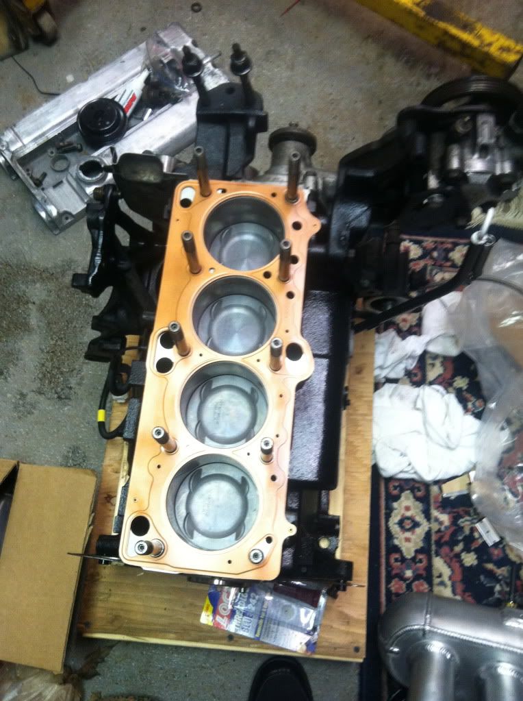

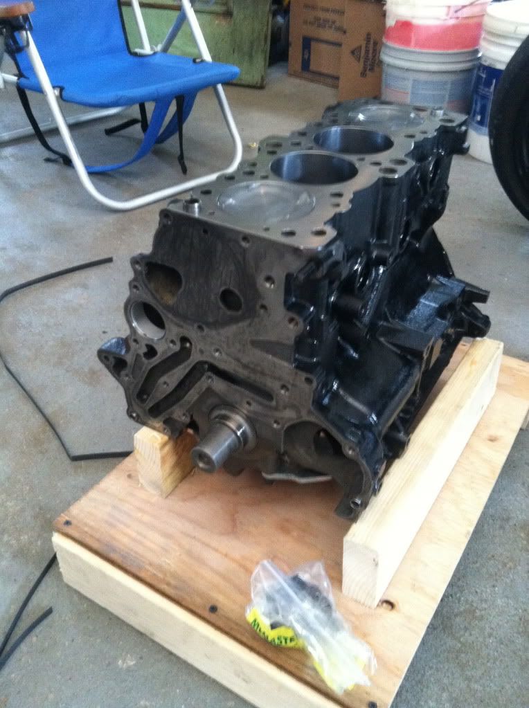

First things first, pulled the motor and had the block sent off to R&L Racing out of Dover, NH. Here's the list of what I had done;
JET WASH/FINAL CLEAN CYLINDER BLOCK
RESIZE CYLINDERS - 3.387
MAGNAFLUX CYLINDER BLOCK
SQUARE & DECK CYLINDER BLOCK
R PISTON/ROD
CHECK RING GAP
ALIGN HONE CYLINDER BLOCK
INSTALL/FIT MAIN GIRDLE
MAGNAFLUX CRANKSHAFT
CHECK/ RADIUS/MICROPOLISH CRANKSHAFT
RESIZE CONNECTING ROD

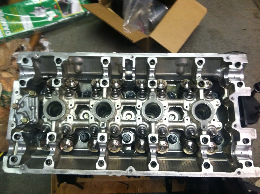

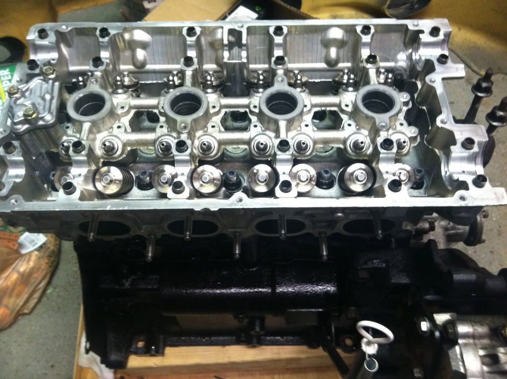

Also sent the head out to R&L Racing to have my Crower valves, springs and retainers installed. New seats and guides were also installed. Also had the head decked, ported and polished and vacuum tested.
Power Enterprise head gasket and ARP L19 head studs.

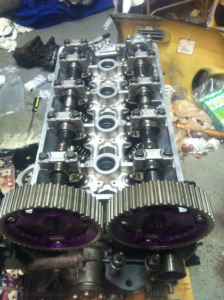

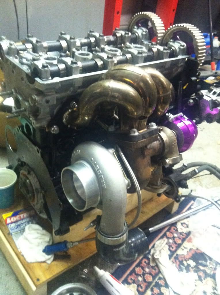

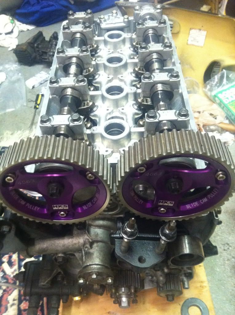

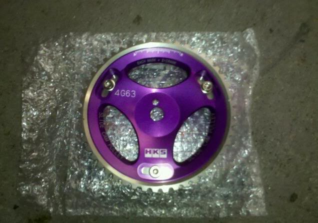

Few pictures with my HKS 272 cams being installed with my HKS adjustable cam gears.

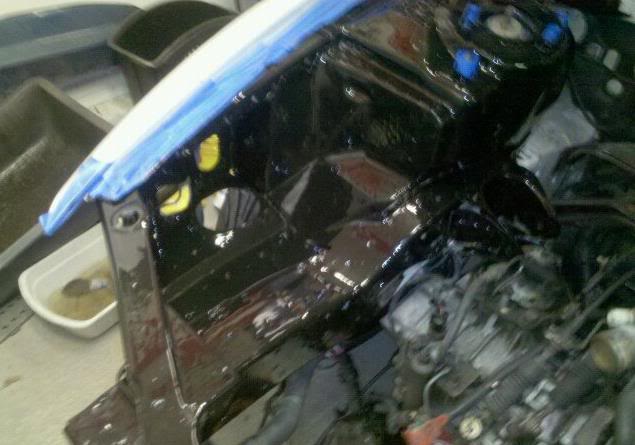

While the motor was out I painted my entire engine bay gloss black - hand brushed.

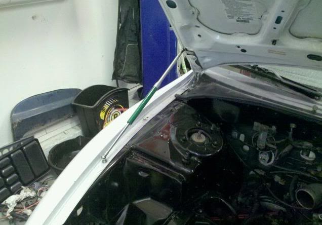

Black bay and Tein hood struts.

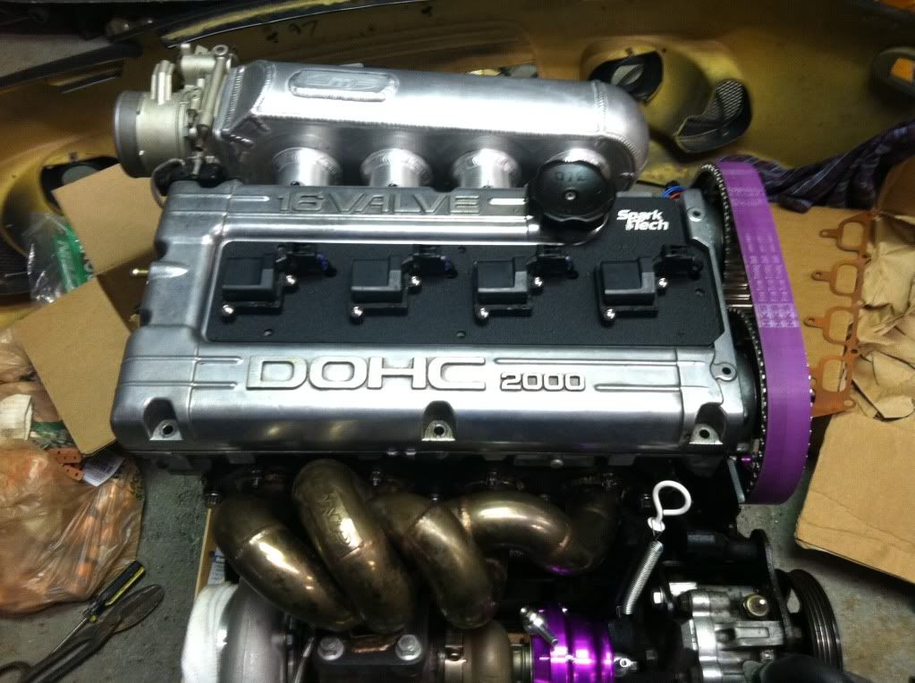

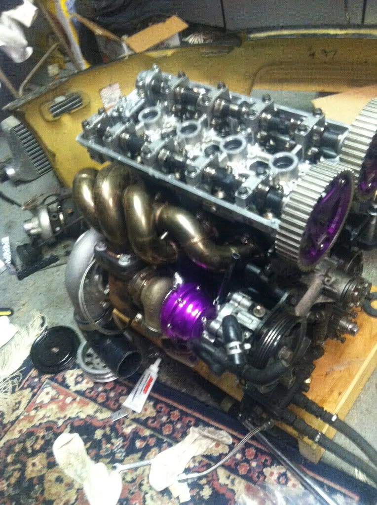

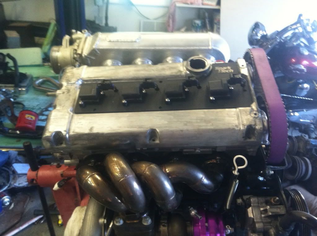

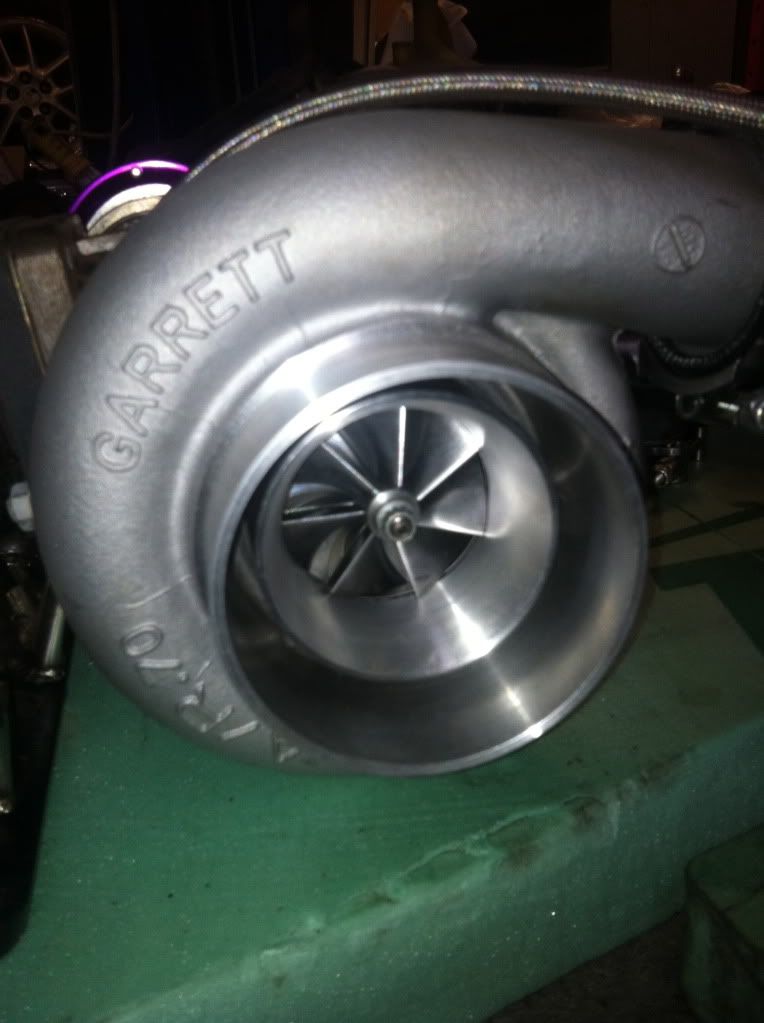

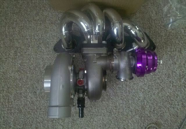

My turbo from FP...and DNP manifold, Tial 44mm WG

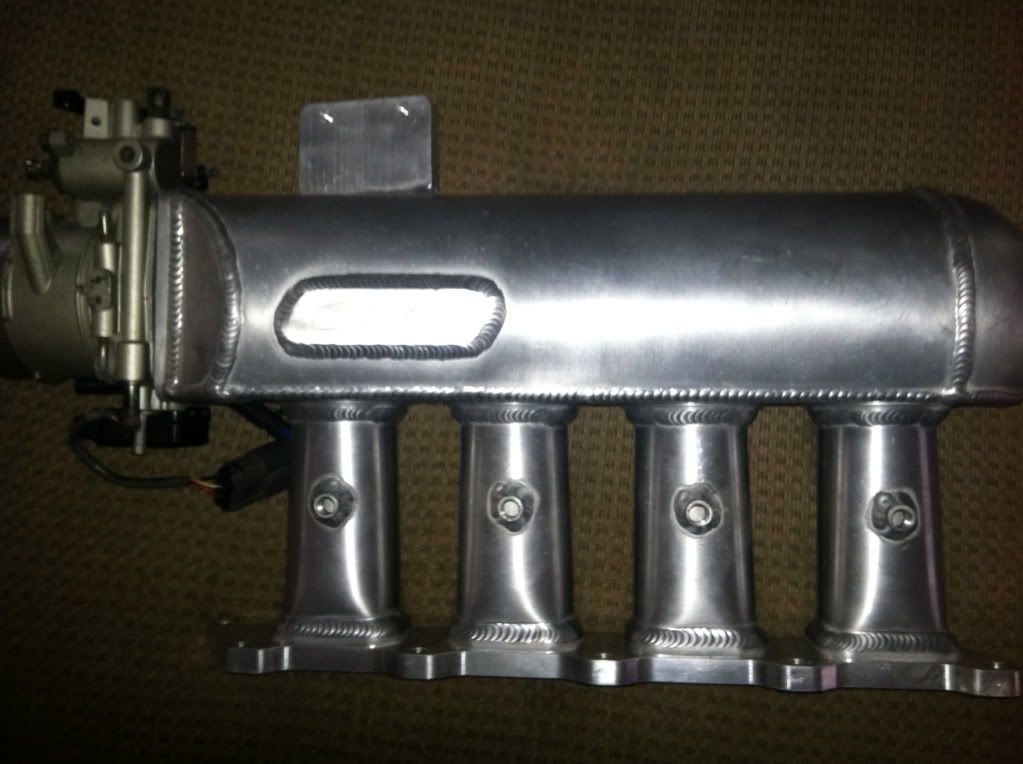

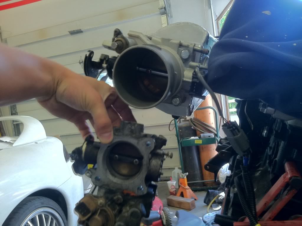

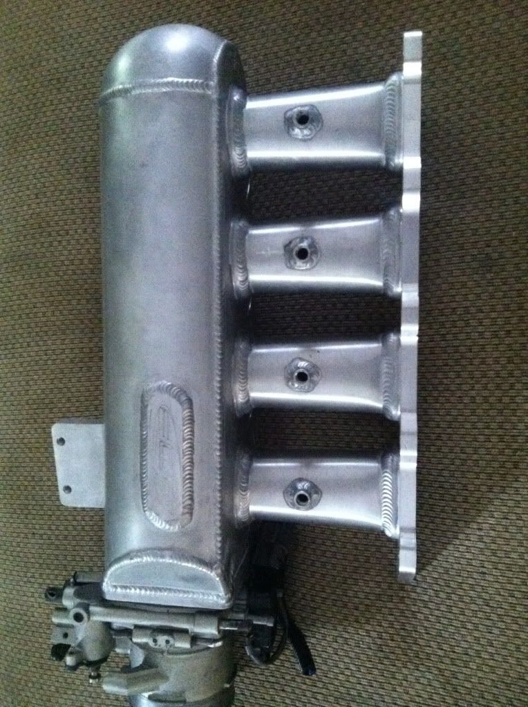

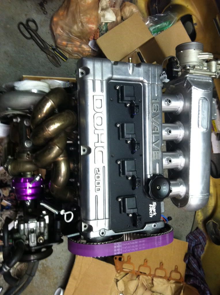

JM Fab Drag Manifold with Q45 throttle body, with JM Fab MAP Sensor Bung
Q45 vs. OEM
SparkTech COP setup

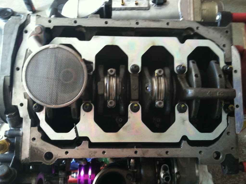

Kiggley Main Girdle and new OEM oil pickup

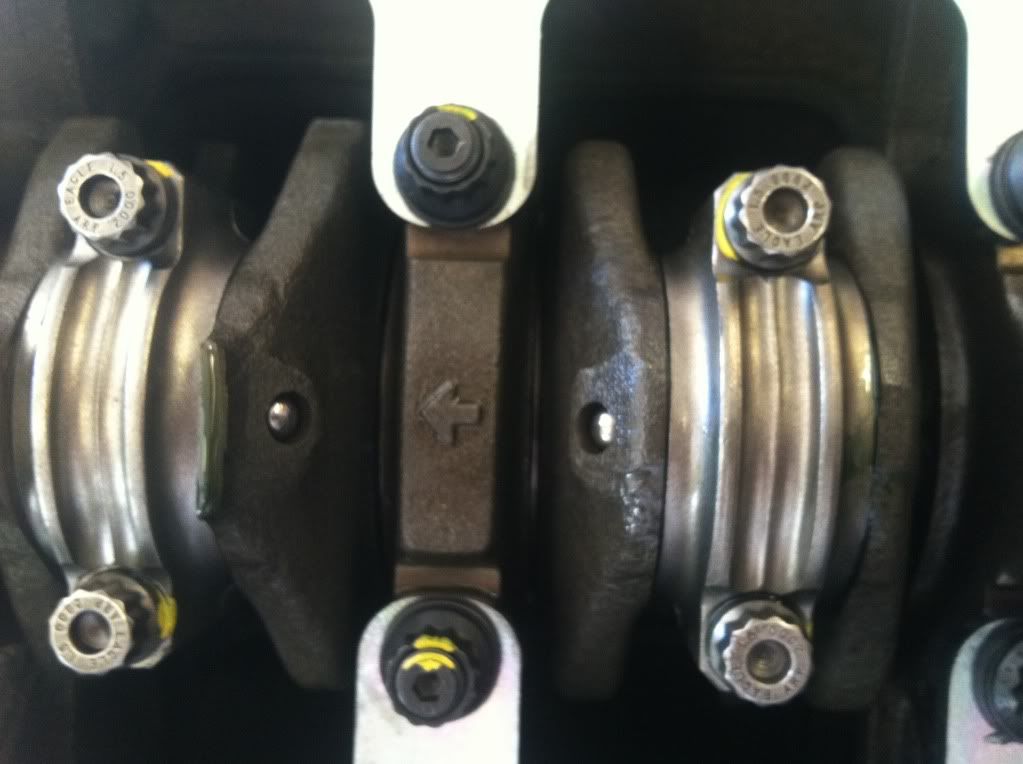

Eagle H beam rods and ARP main studs and rod studs.

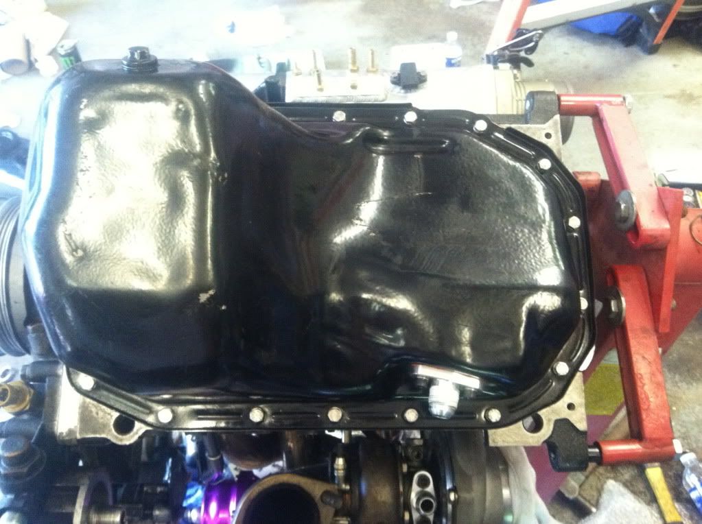

New OEM oil pan and AN fittings

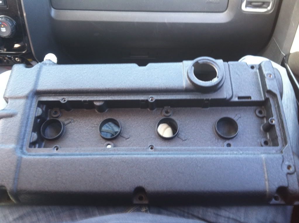

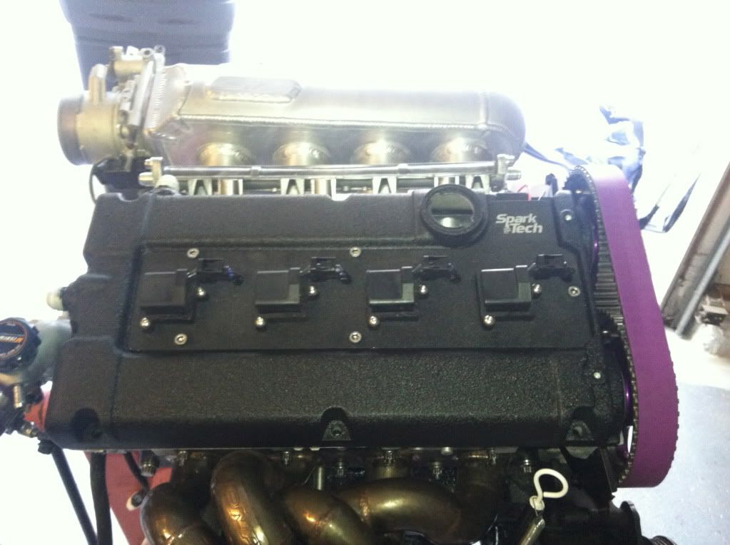

Shaved the valve cover to prep it for powdercoating. Had it PC'd wrinkle black. Also had -10 an fittings welded on by Ballistic Motorsports in Bow, NH.

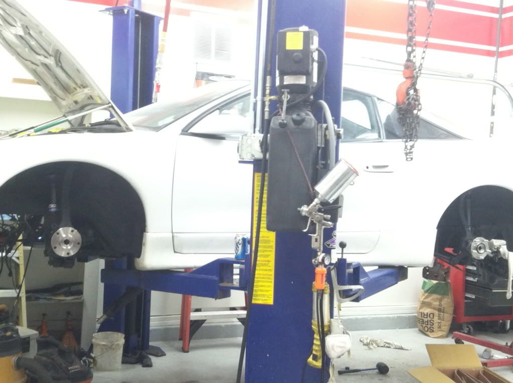

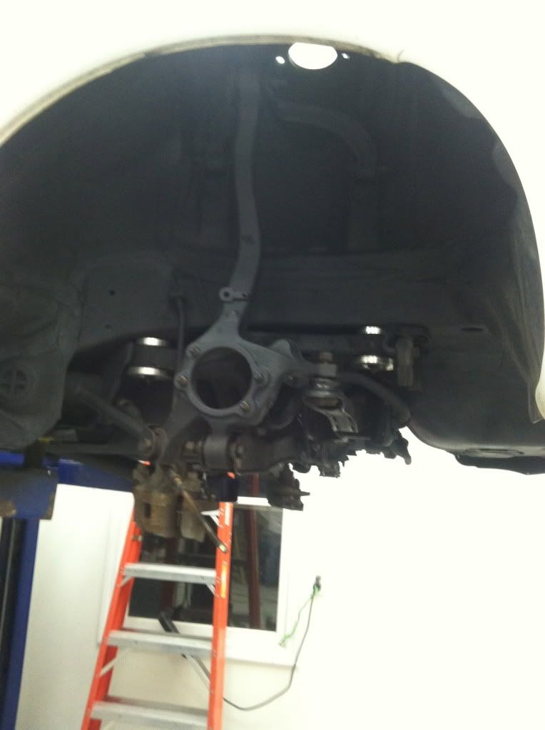

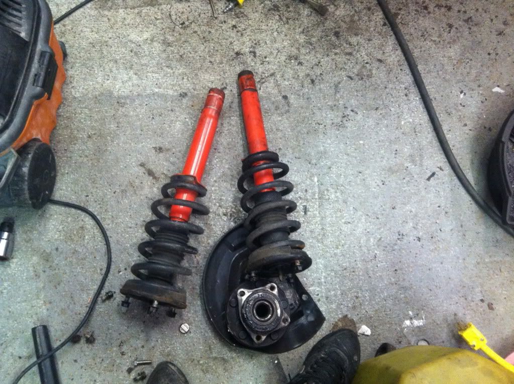

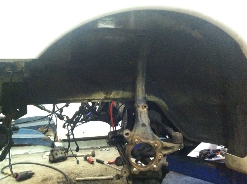

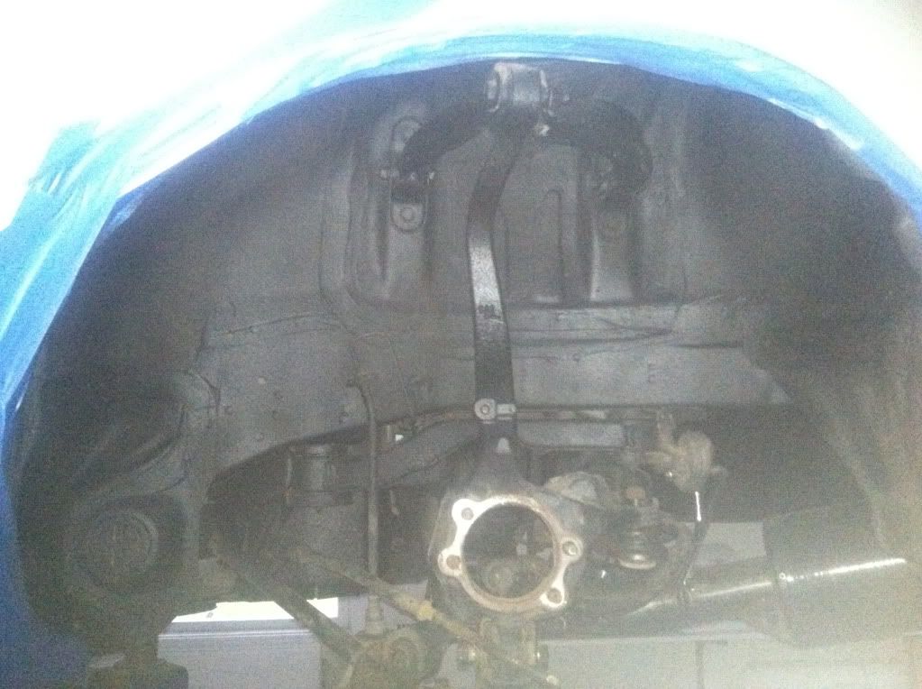

Out with the old shitty hubs and suspension...

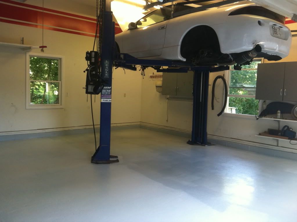

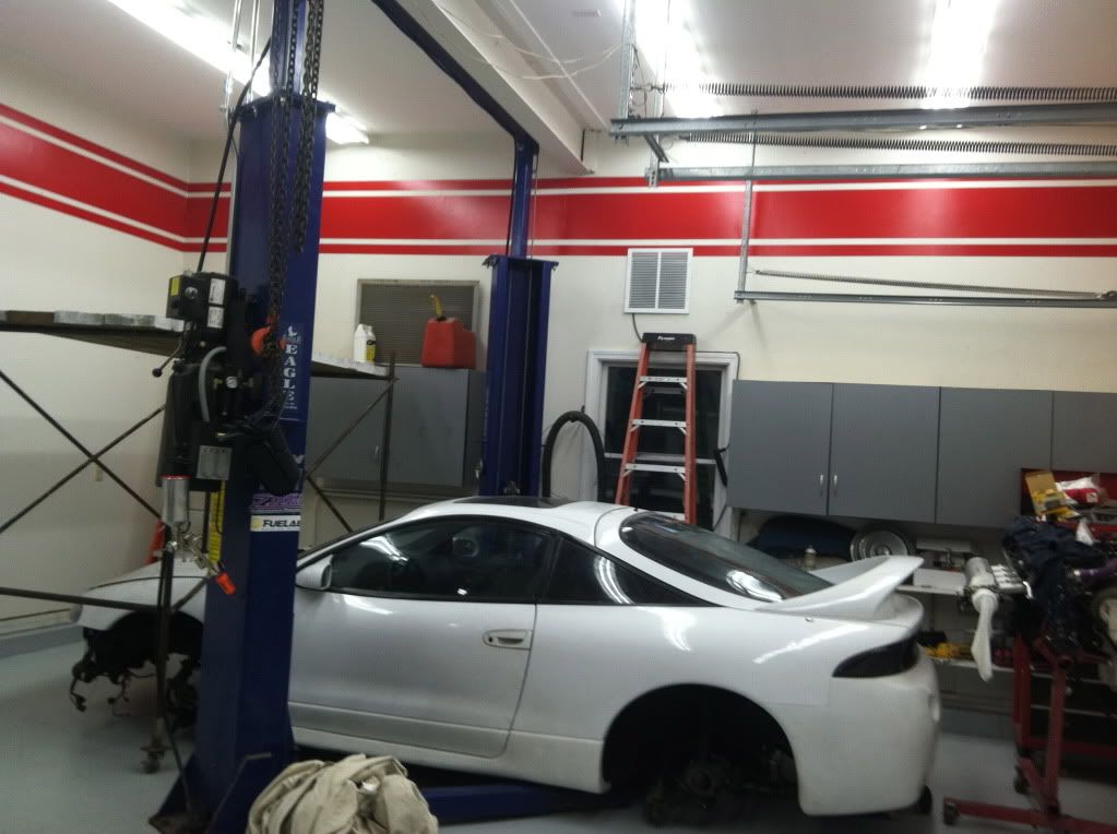

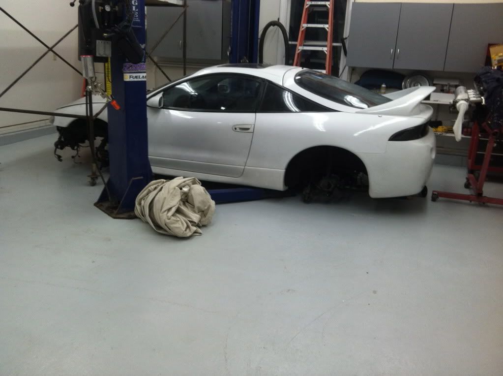

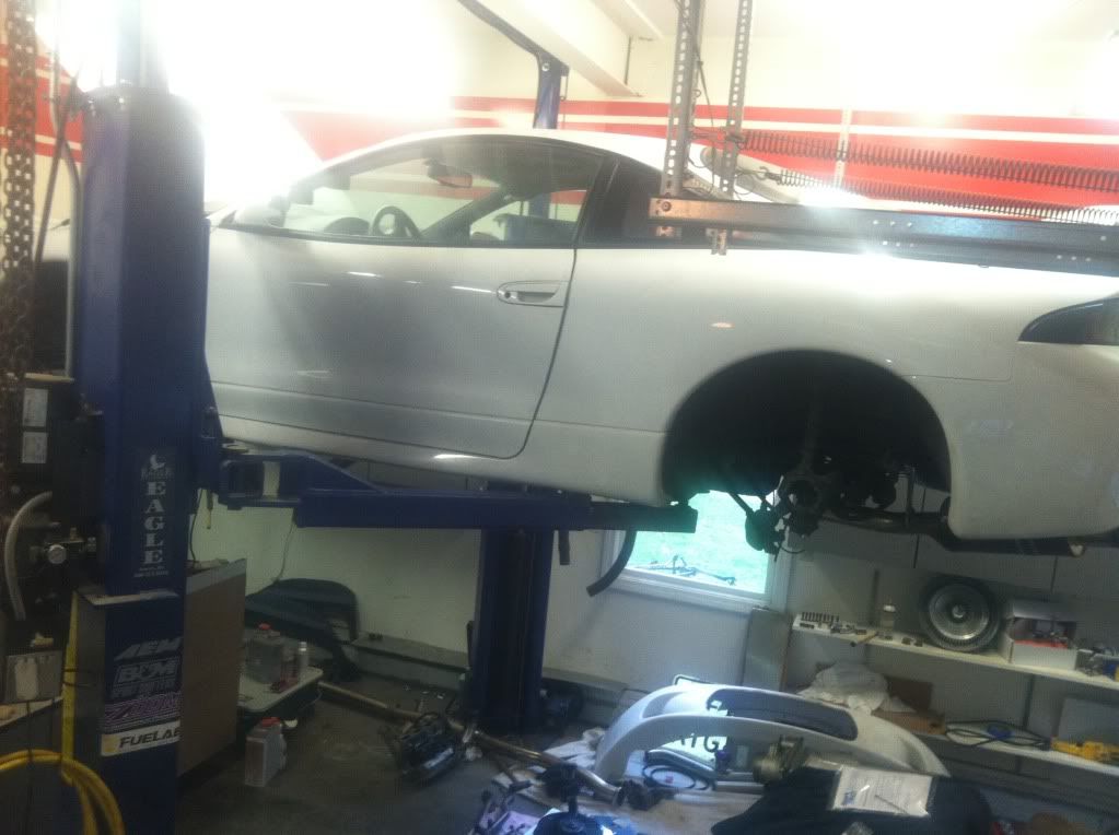

As it sat on my lift...

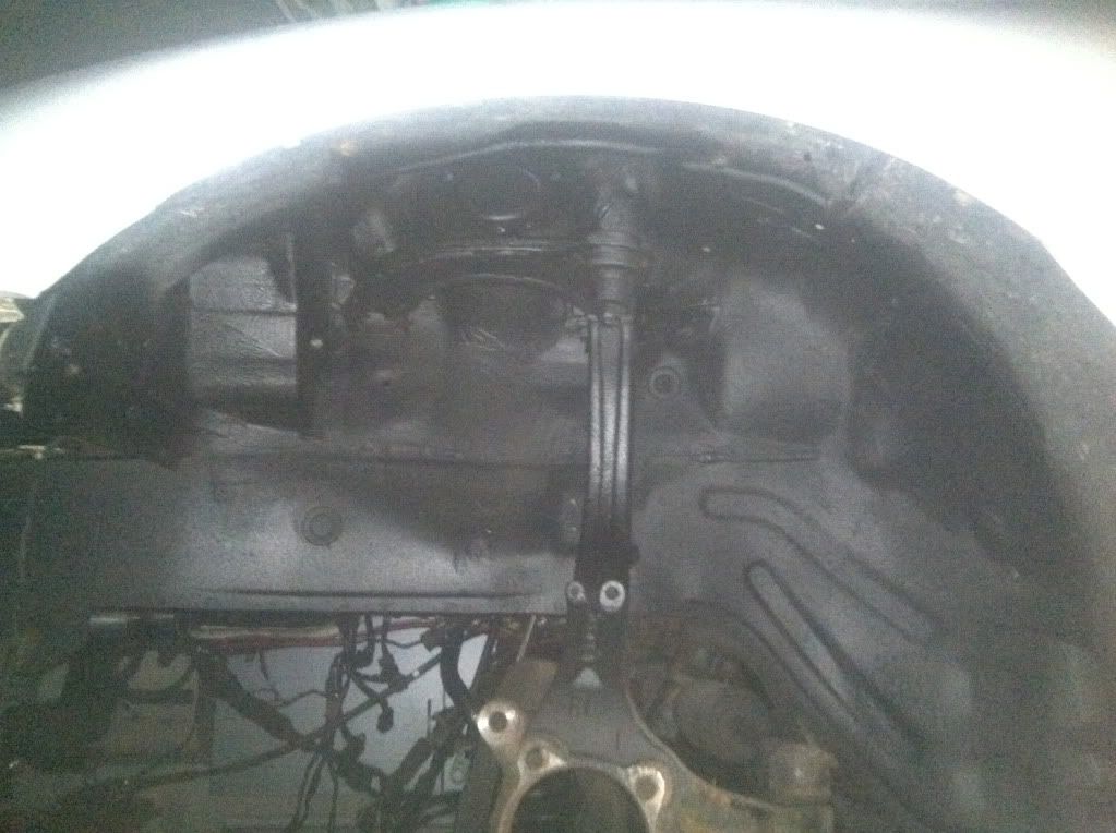

Undercoated every wheel well/the entire underbody of the car.
Cleaned out the garage and freshened up the floor.

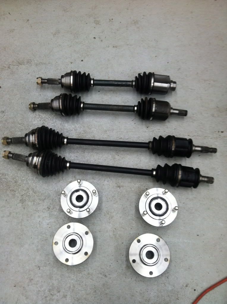

Fresh OEM front axles (with lifetime warranty), DSM Graveyard Stage 2 Hardened Rear Axles, new Hubs all around..

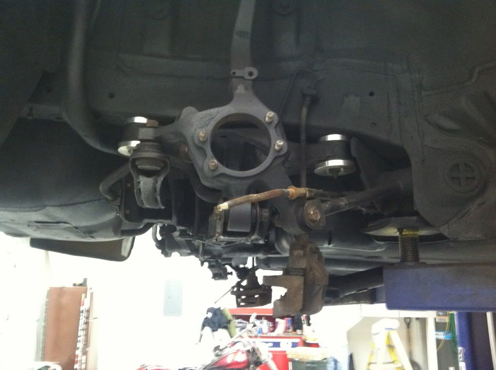

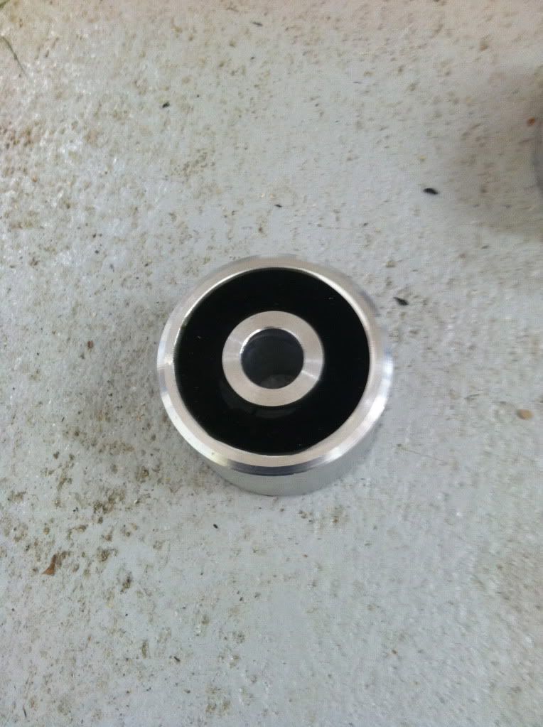

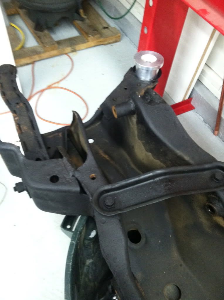

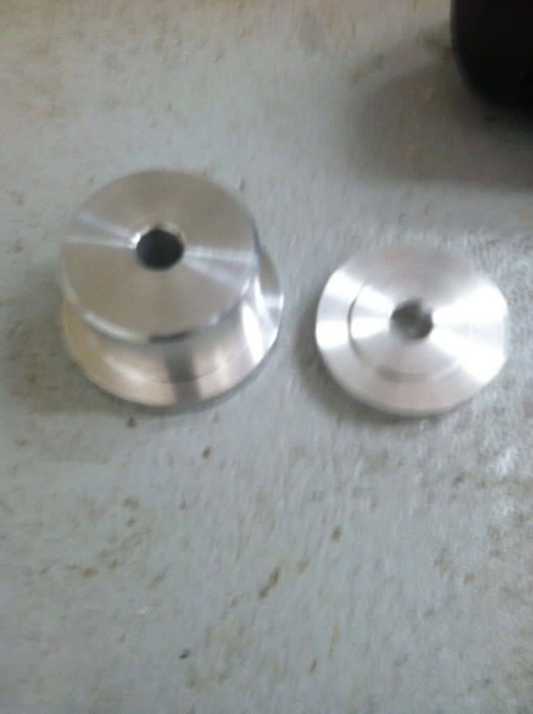

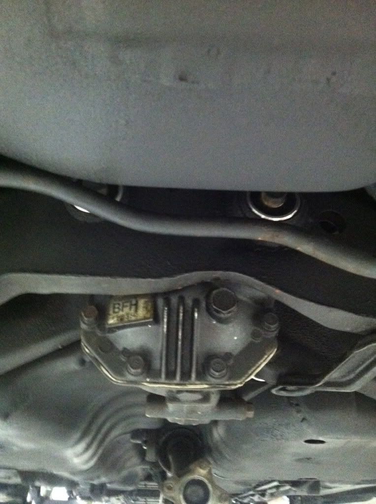

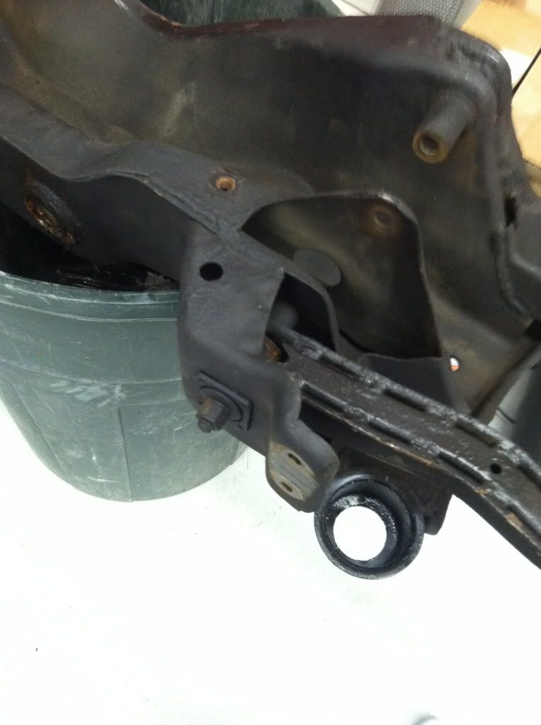

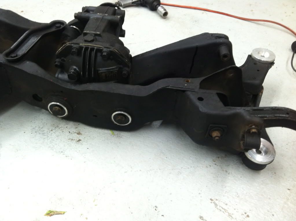

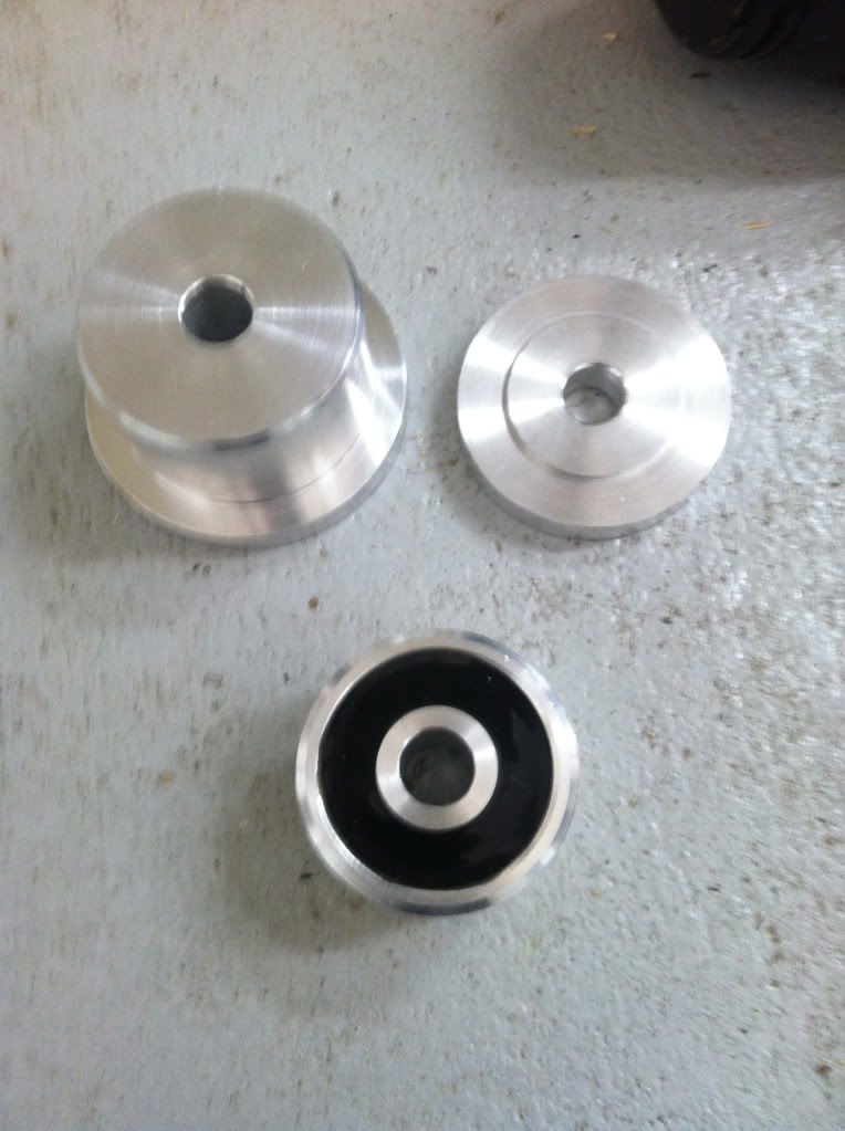

Dropped the rear subframe to install solid subframe bushings and hardened poly rear diff bushings...

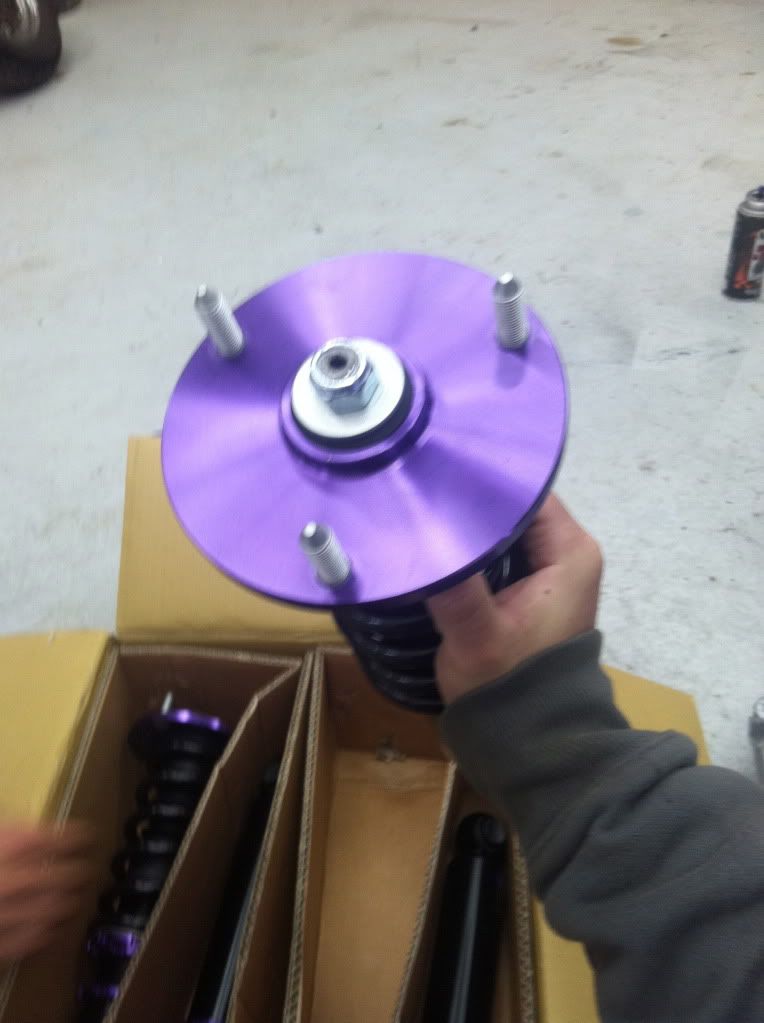

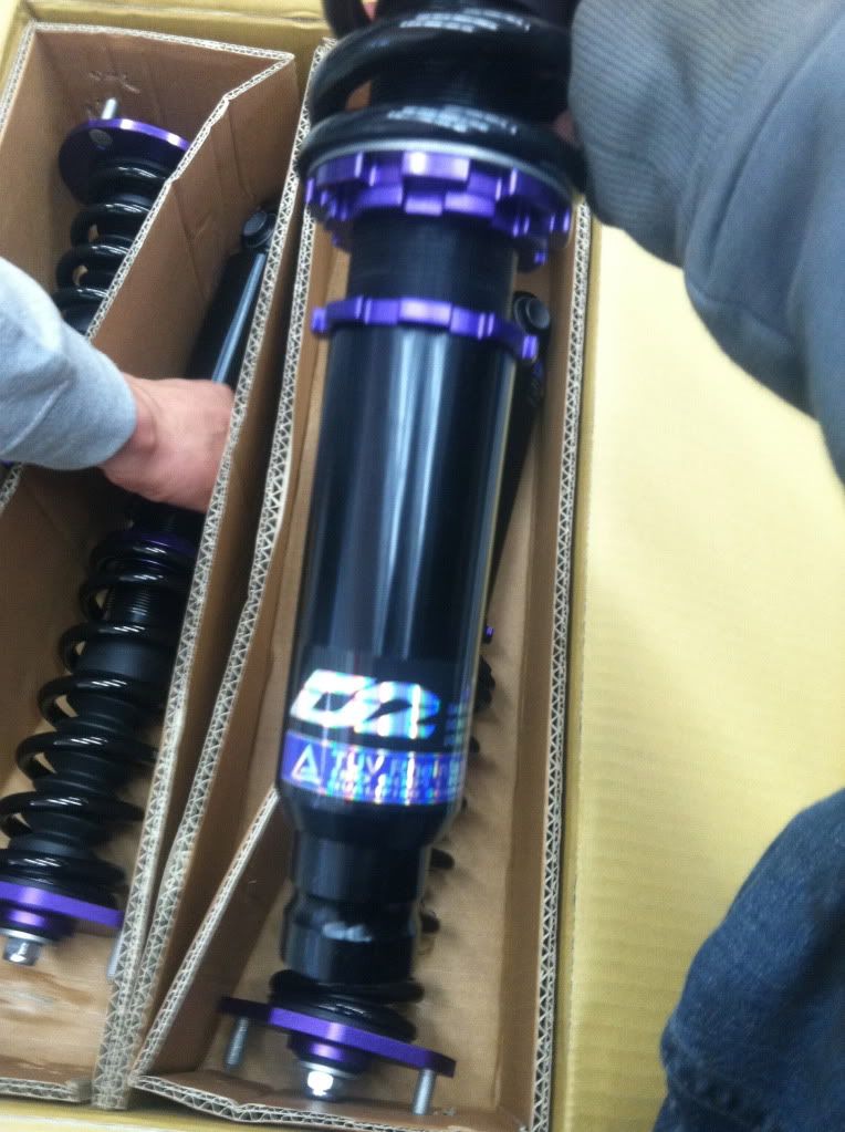

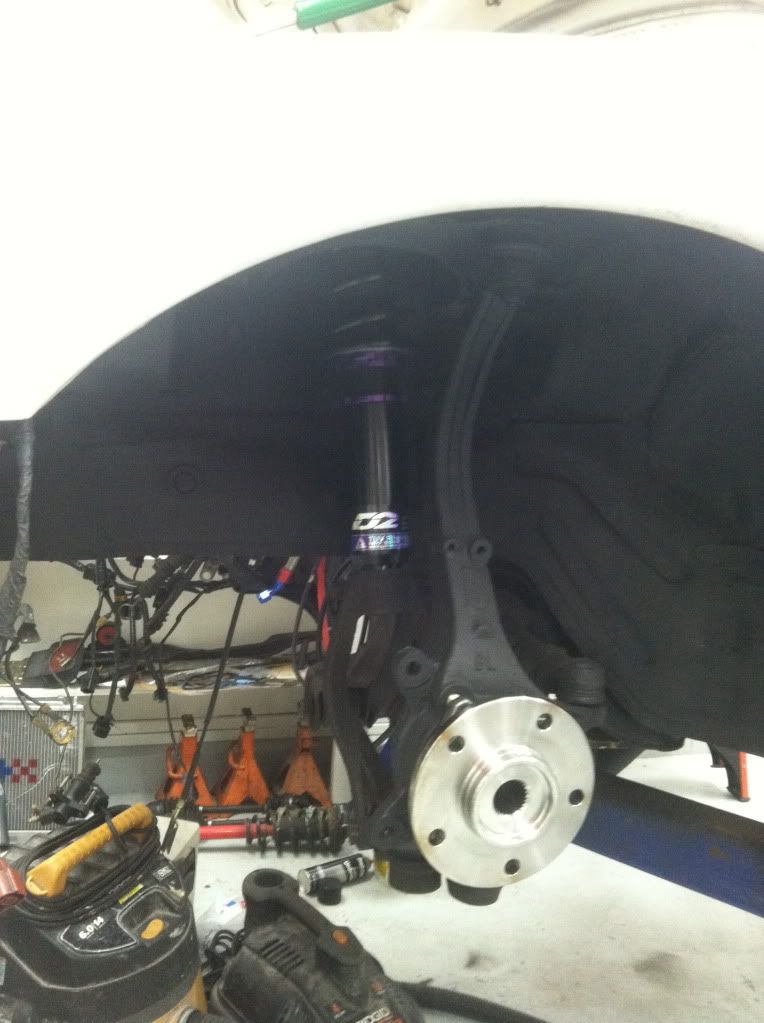

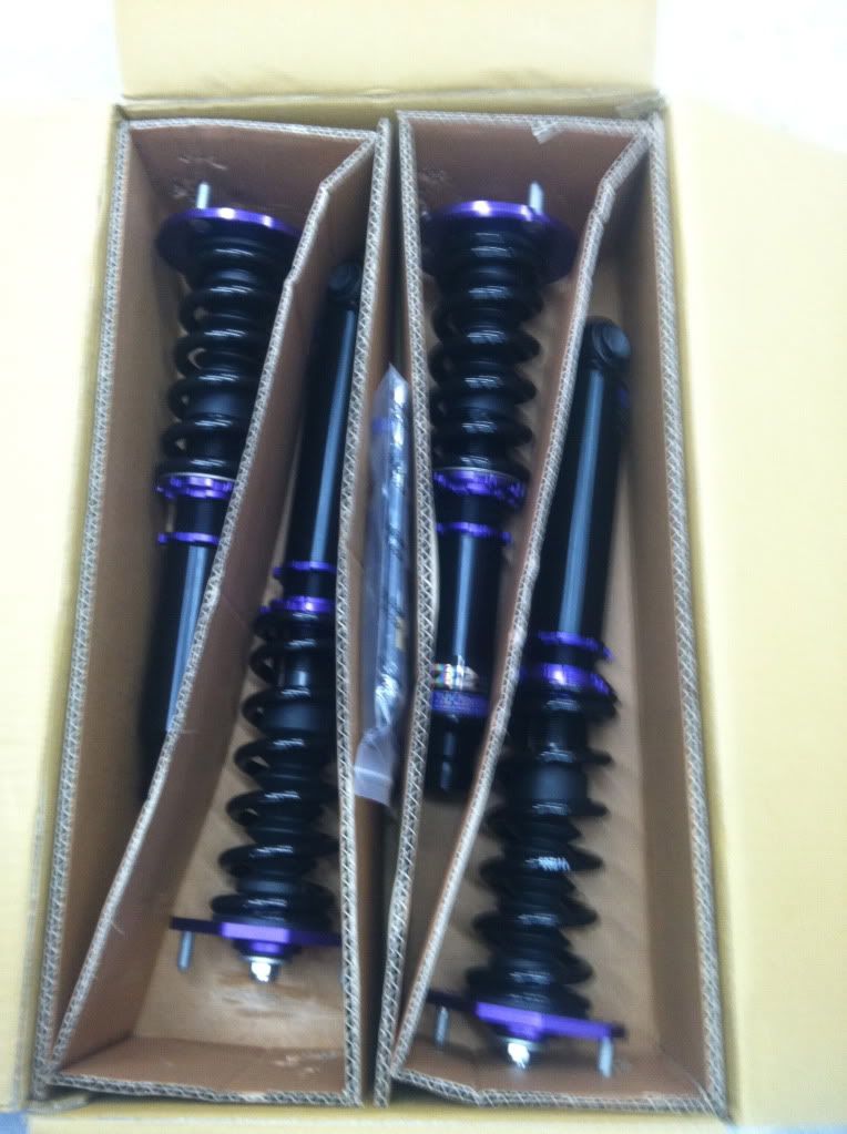

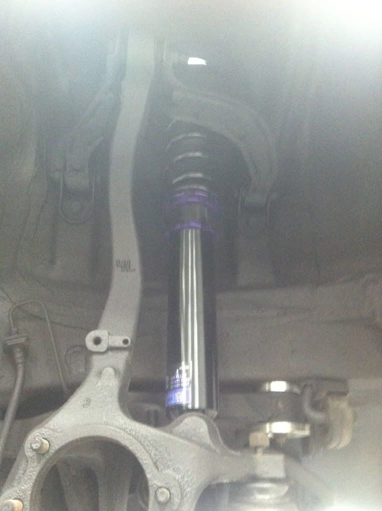

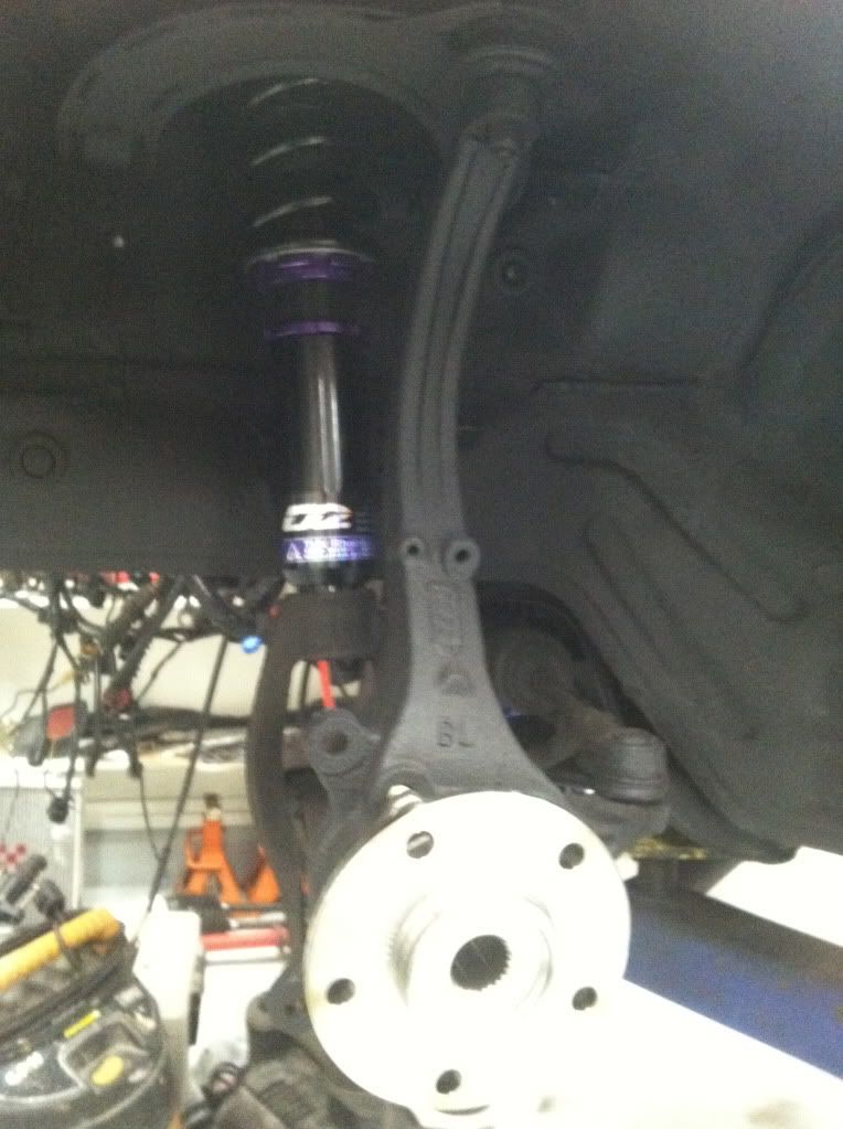

New D2 Coilovers arrived..
Installed with solid subframe bushings and new hubs in the background..

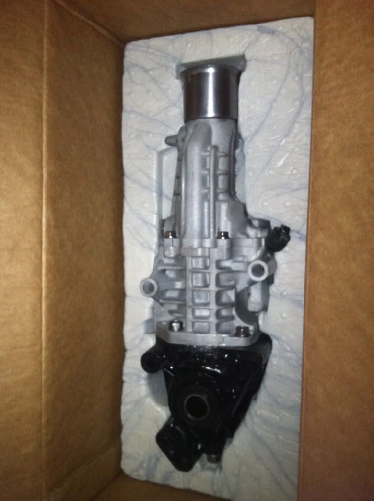

Sent out my transfercase to Jack's Transmission in Colorado for a fresh rebuild.

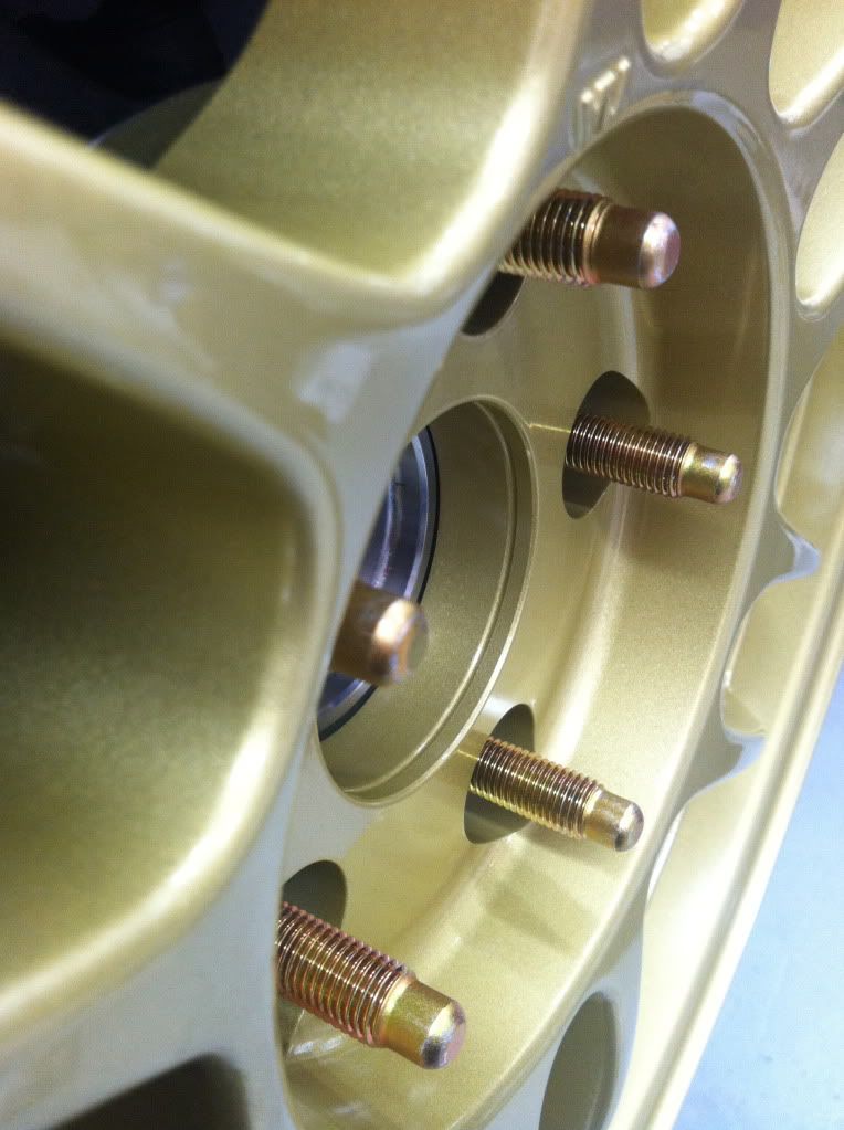

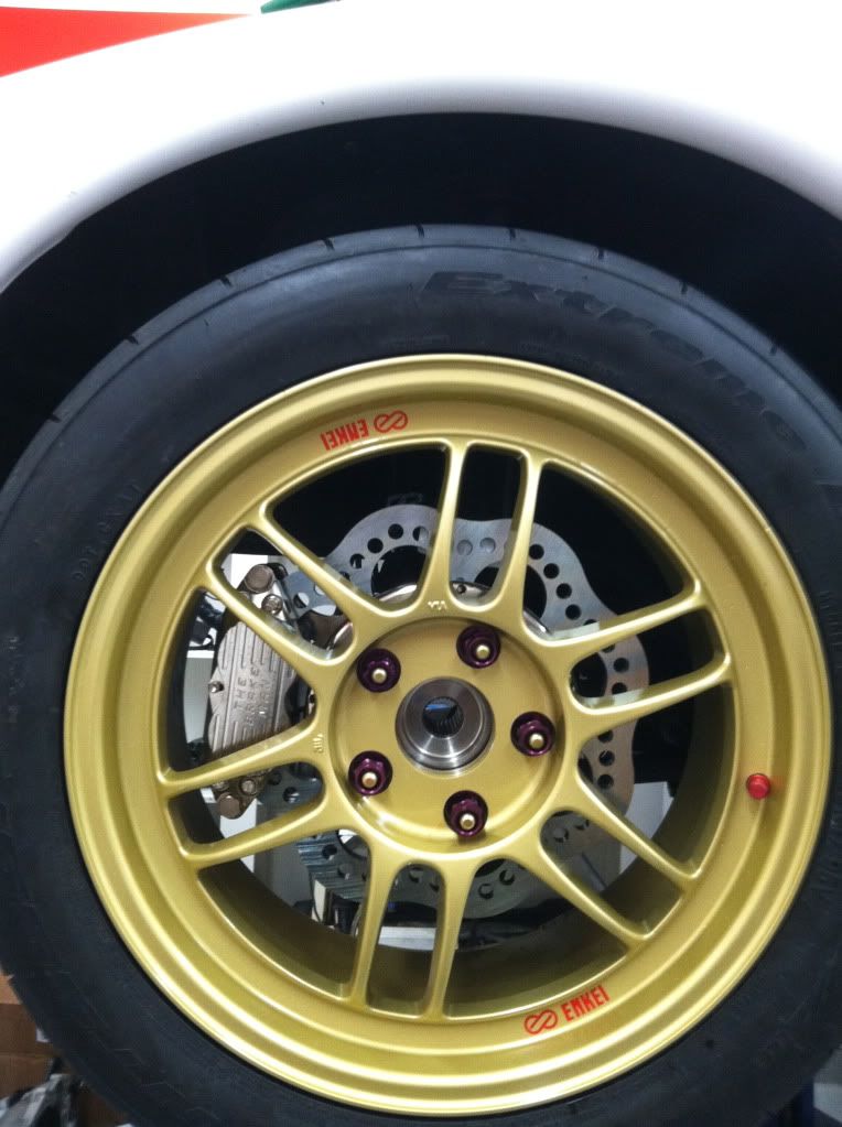

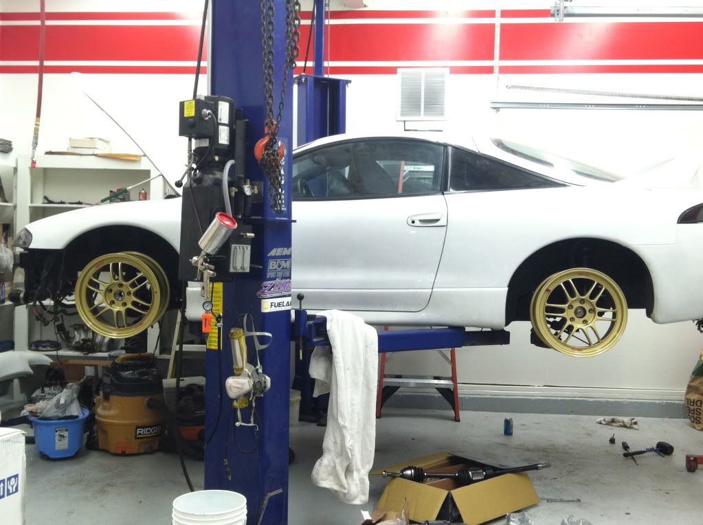

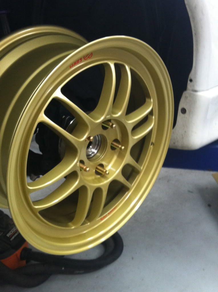

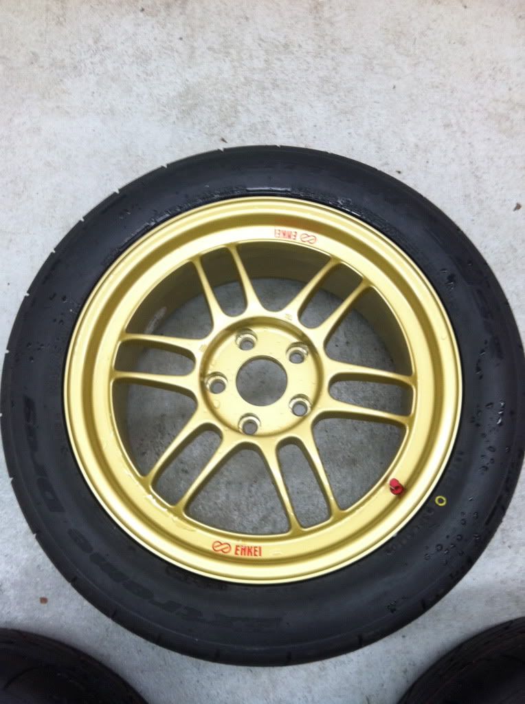

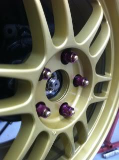

And then the new wheels and wheel studs arrived. Enkei RPF1's 17x8 +45, and ARP wheel studs. Just waiting for my Nitto 555R DR's to arrive so I can get them mounted.
Hey! A build thread and not a blog! That's a big win right there!

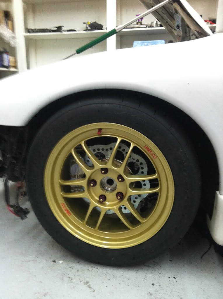

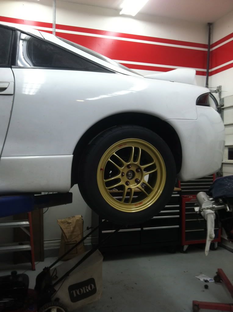

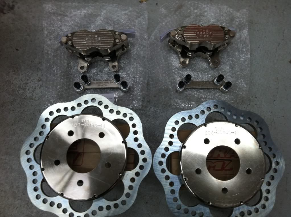

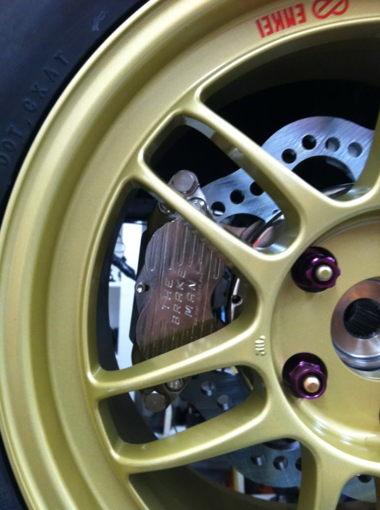

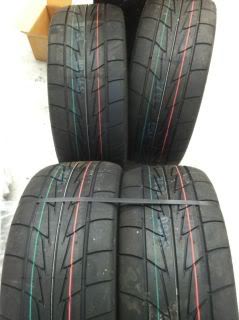

Well I got the tires mounted today. Had to go to 5 different tire places, nobody would touch them "to much of a liability" sounds stupid to me! Also my new brake man brake kit came in looks awesome cant wait to put these master pieces to work at the track! heres some pictures....

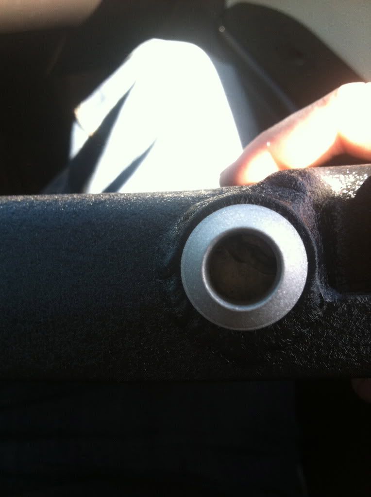

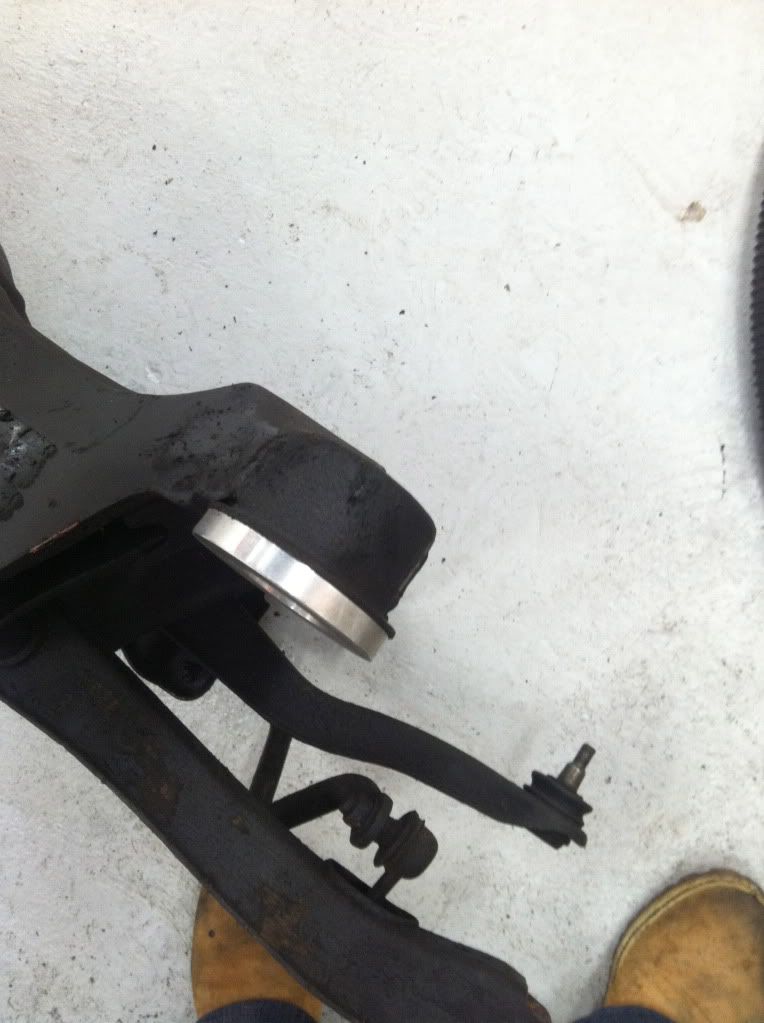

Post #4, pic 10 from the top. Is just the picture angle or there's something wrong with the subframe? It almost look like the welding came apart if you compare it wit the other side on the very next picture.

Just got home from work and inspected the weld nothing is wrong with it, its just the picture you had me scared there for a second thanks for pointing it out though...
