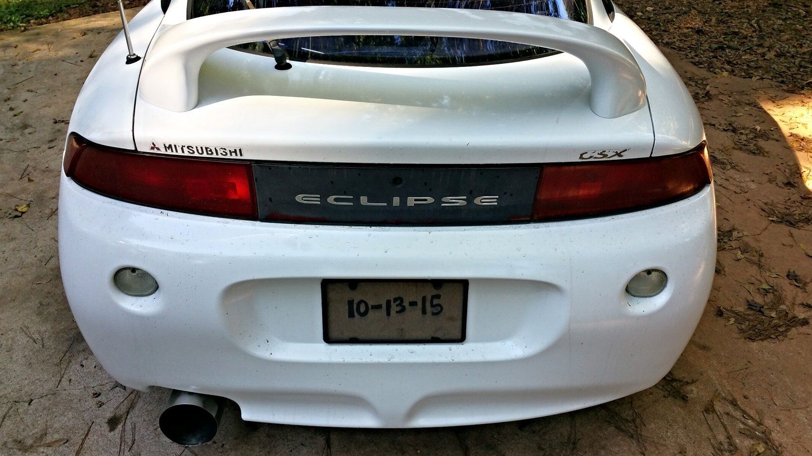

drove the car to have it cleaned and for the time being put the first items from the fwd project on the wheels.
I
Thanks fellas!
The official photo.
I think you meant 9-13-15
LOL

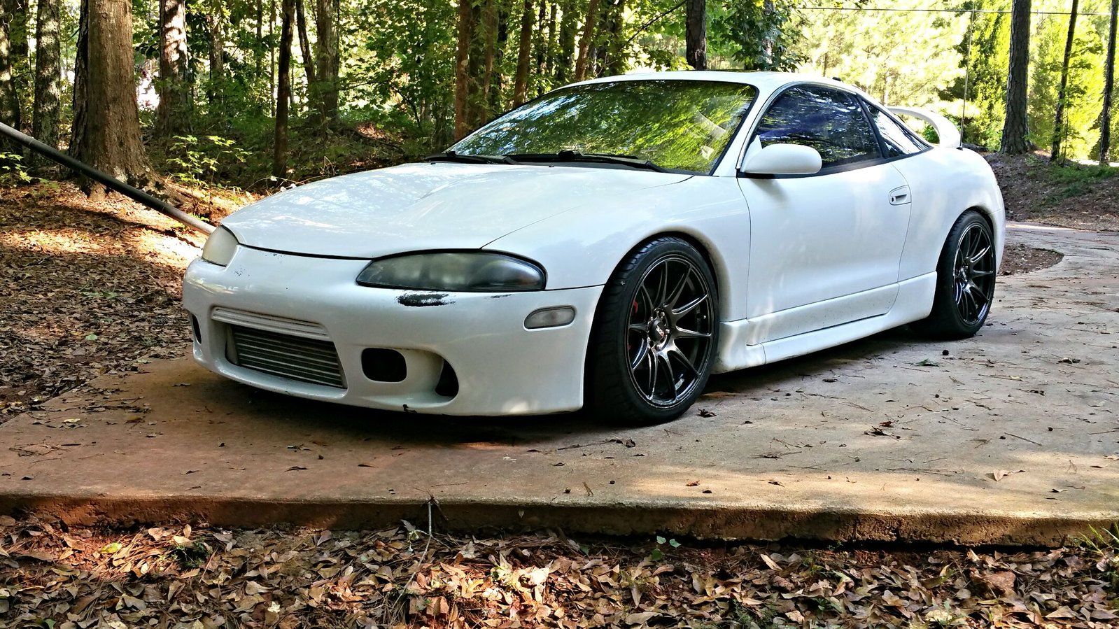

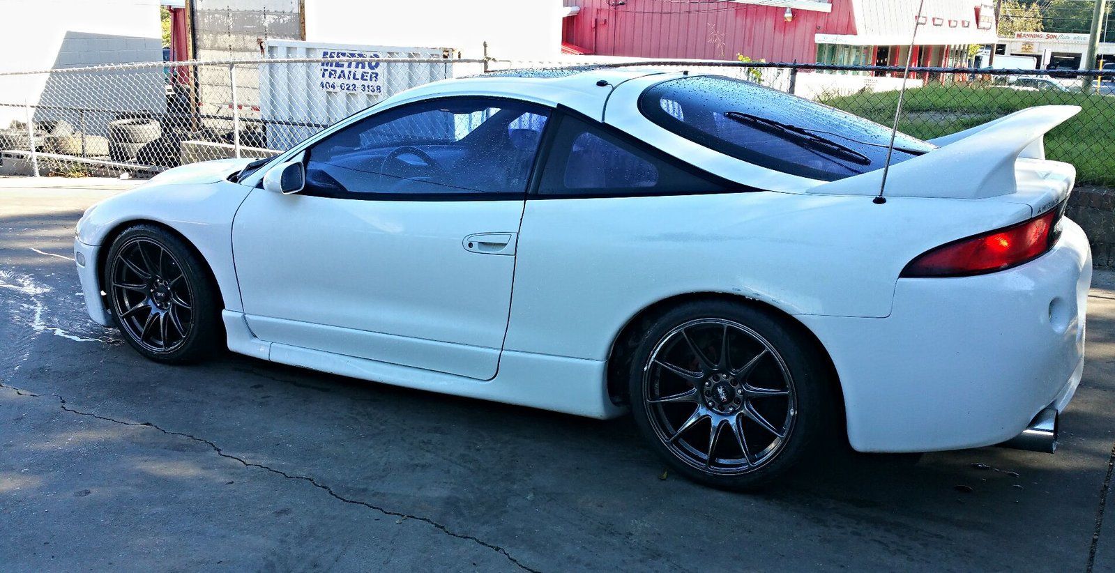

Thanks! Cleaned her up and swapped the Megan easy street coil over from the fwd fits like a charm
It looks, from the pic, like the rear is sitting at the right height. I wonder if the spring rates are different and how it'll affect driving?
I kept my TEIN coilovers from my gst during the swap to awd. I've yet to see it sitting on the ground. I have rims similar to yours. 18s right?
I read about rear spring rate and though the rear would be at a different height myself but to my surprise I didn't have to adjust them. Took the megan's off the gst and installed them on the gsx perfect fit.. Some have said that this will not be the case with stock springs they fit but the rear sits higher spring rate difference between awd and fwd.
If they sit the same height? I wouldn't worry. Hell, i would think a softer spring rate in the rear would actually be better for launching it. For cornering? That's a different story.
