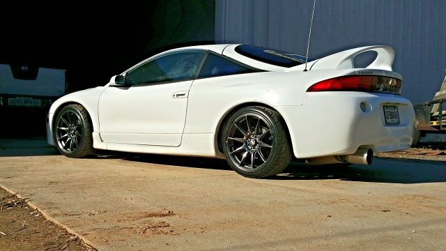

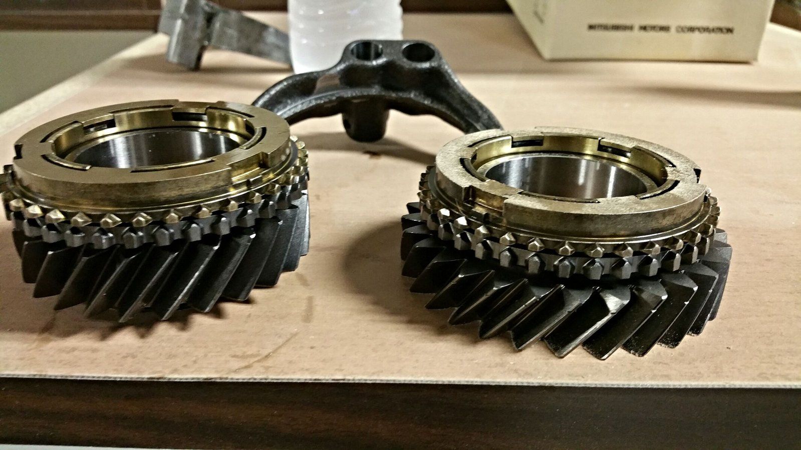

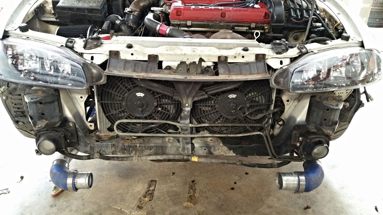

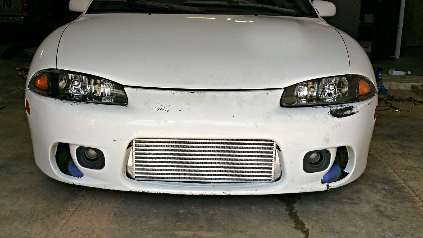

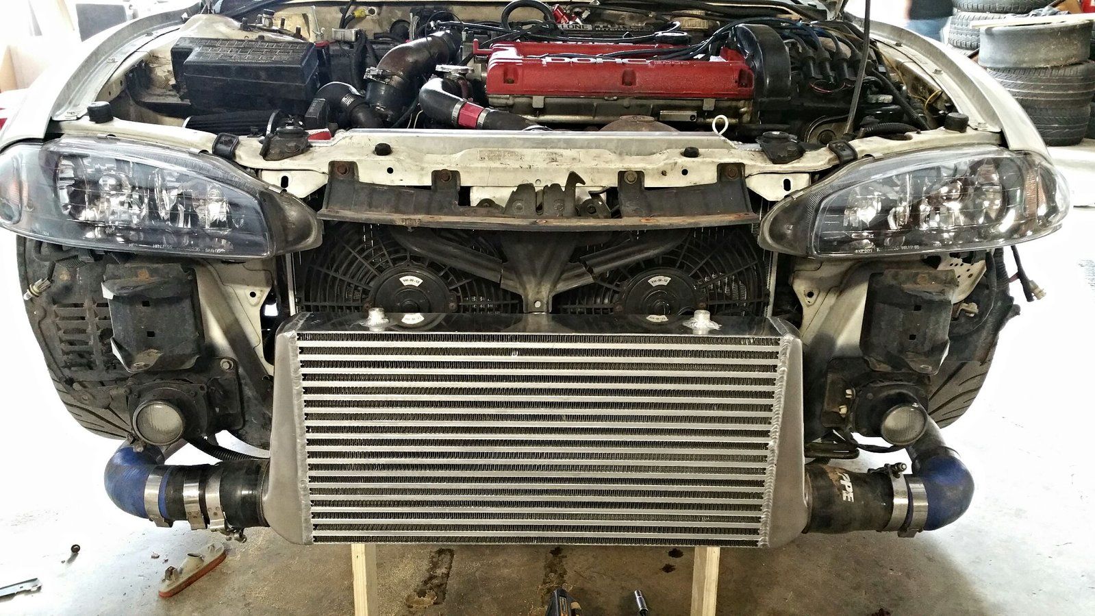

Update, cleaned the car up before pulling the transmission , next I will pull the engine out of the awd project. the engine is out of the fwd and ready to go in. The transmission has been taken apart and is currently being built and upgraded by me, The gears will be ready for pick up from the cryo shop Wednesday and some will be sent to be wpc treated on top of the rem and cryo. All the fuel lines and pumps are switched over. Intercooler has been installed. All gauges from fwd has been installed, Megan easy street coil overs has been swapped. over. the project is coming alone.

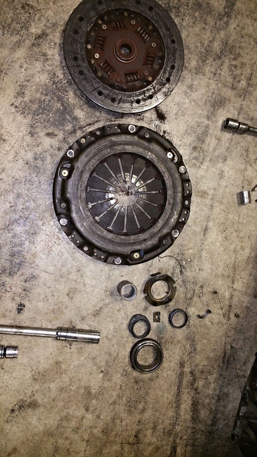

Took her to the track trying to break into the 13s with the ebay 16g kept having a lot of problems out of the hole. come to find out the clutch was slipping and got worse , so after 3 or 4 runs called it a day and this is what lead to the pulling of the transmission.

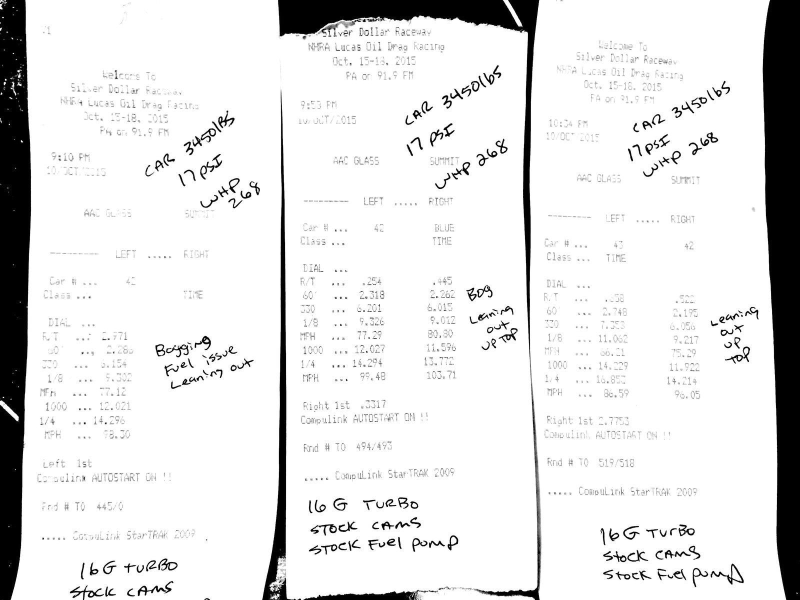

Here's the run with stock fuel set up before switching the fuel pump over.
