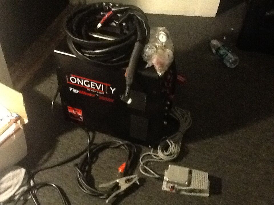

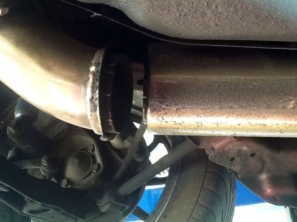

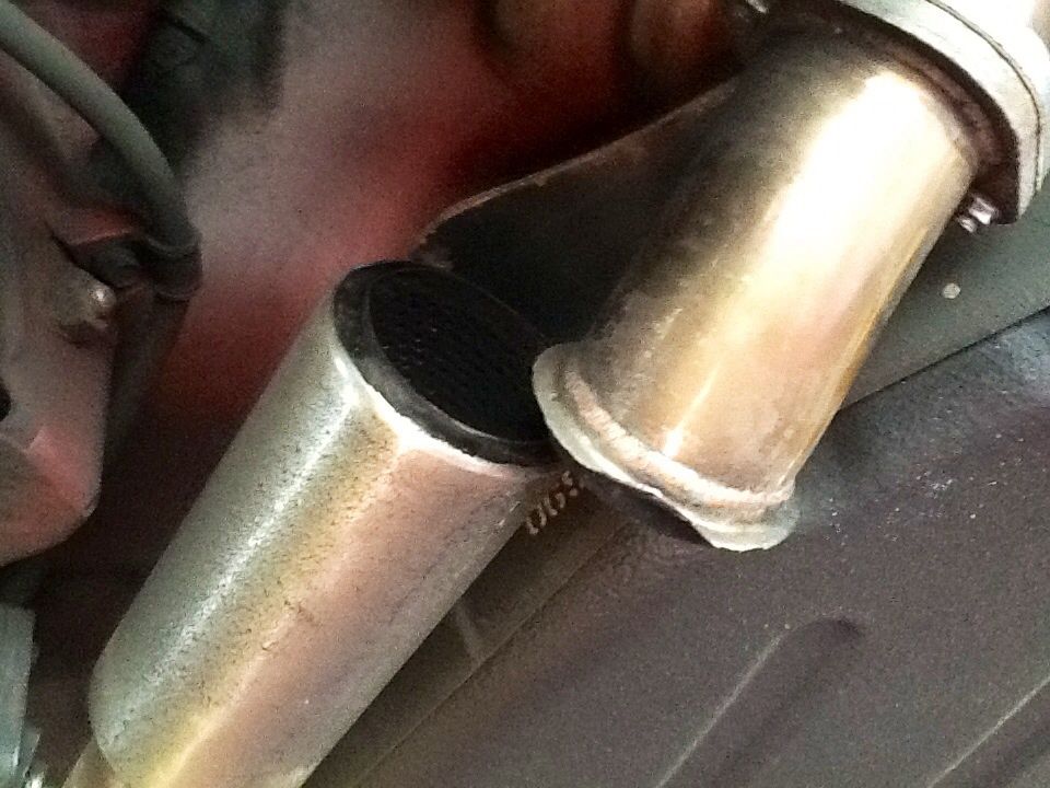

I'm driving home from pick n pull and I hear a loud boom and something starts scraping under the car. I also notice my exhaust feels and sounds a lot louder. I get home and it park, leave the car idling and it is ridiculously loud. I look under the car to find my exhaust broke. Yes, it broke in half right at the part that goes over the rear cross member. I don't know how this happened because my AFRs were good and nothing else happened to the car, wired. I take the car to the exhaust shop and have them make me a new exhaust from the mid pipe back with no resonators for better breathing. Came out nice. I went home and decided I wanted to start my hand in welding because he mig welded it and I purchased a mig off ebay. Big mistake. I get it a few days later and don't like it, I instantly get on amazon and order a 200amp AC/DC tig welder.

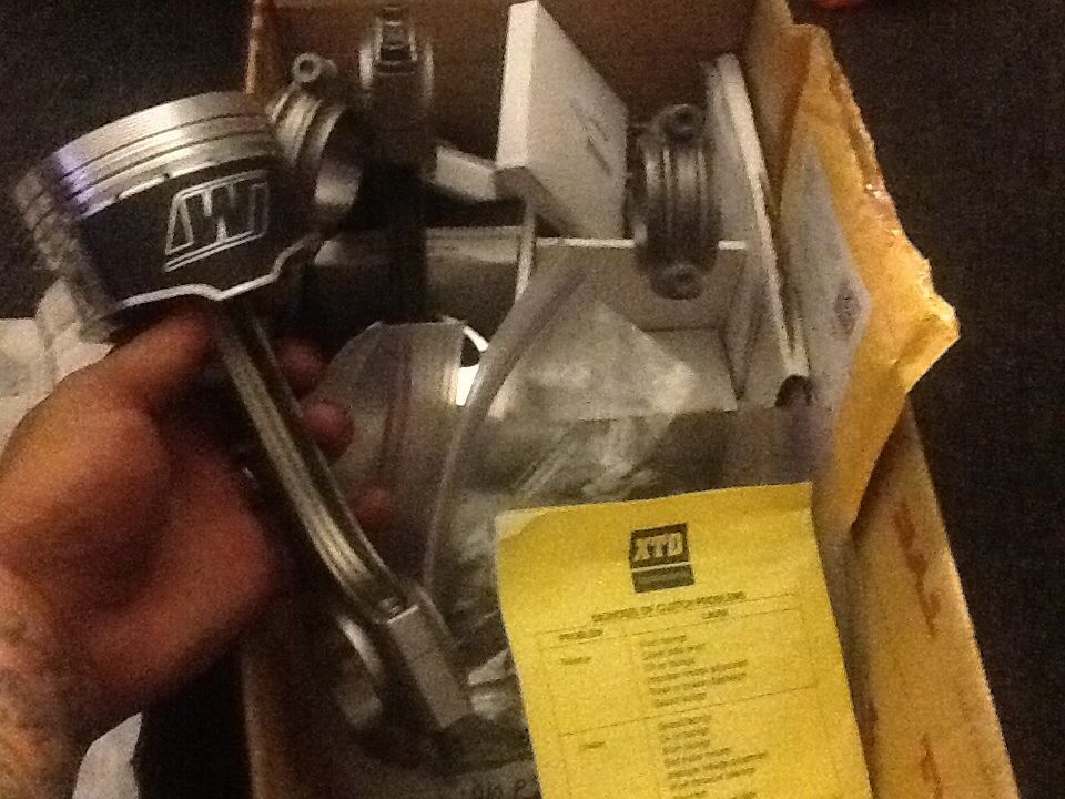

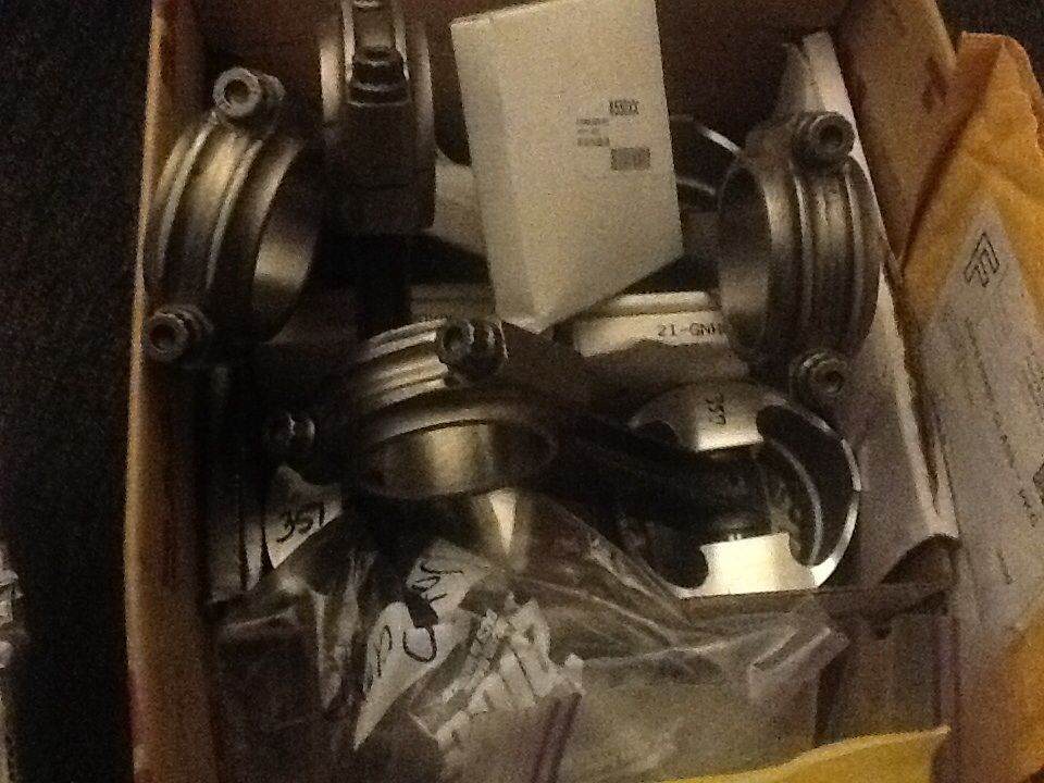

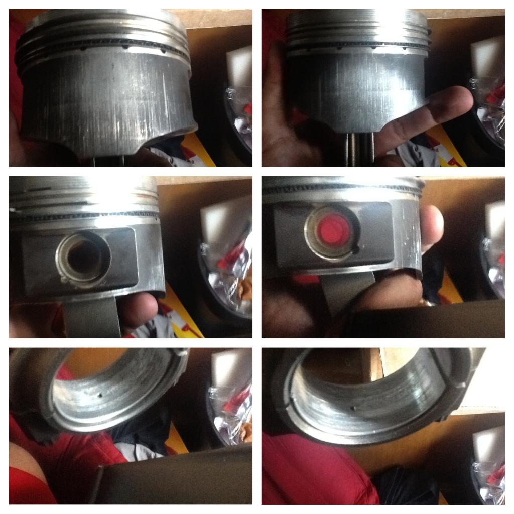

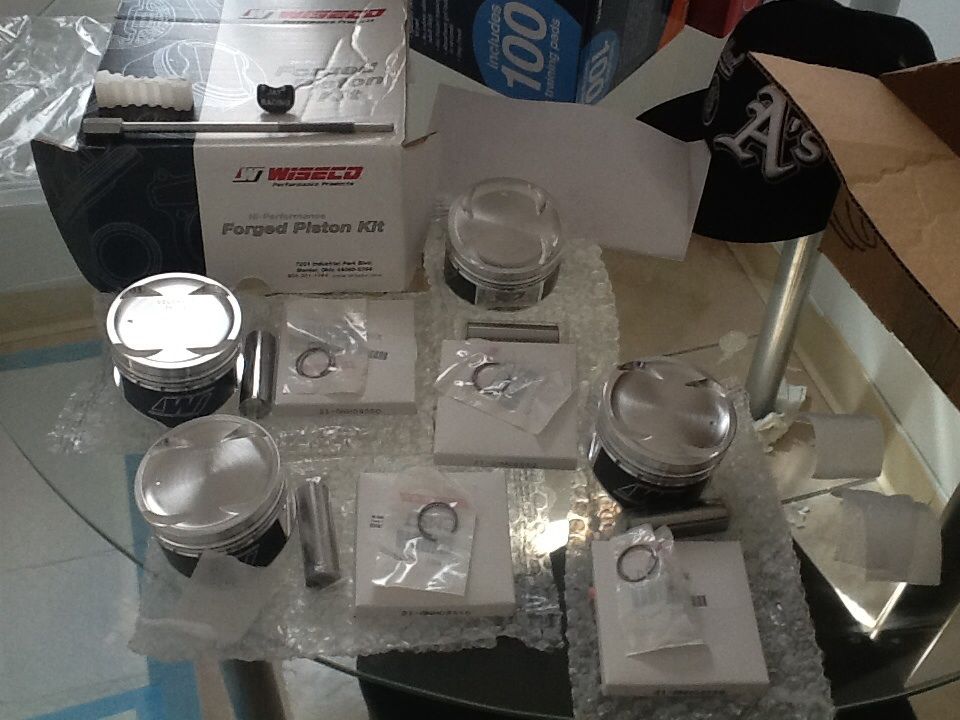

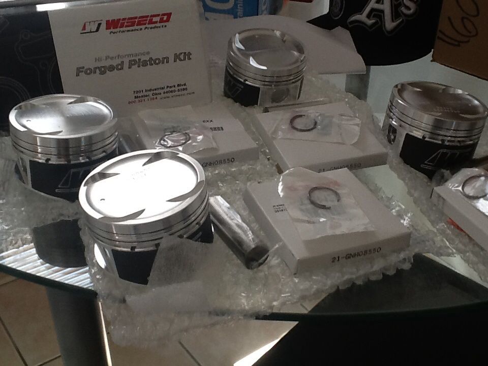

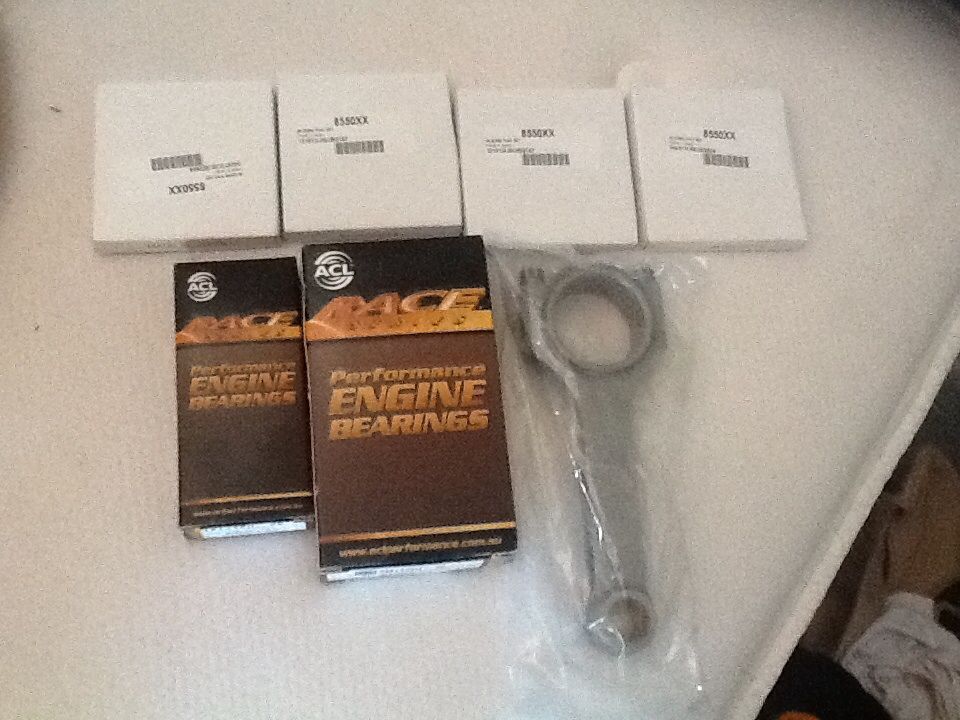

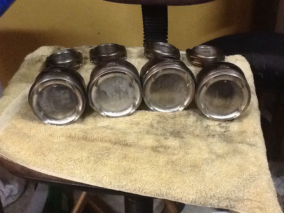

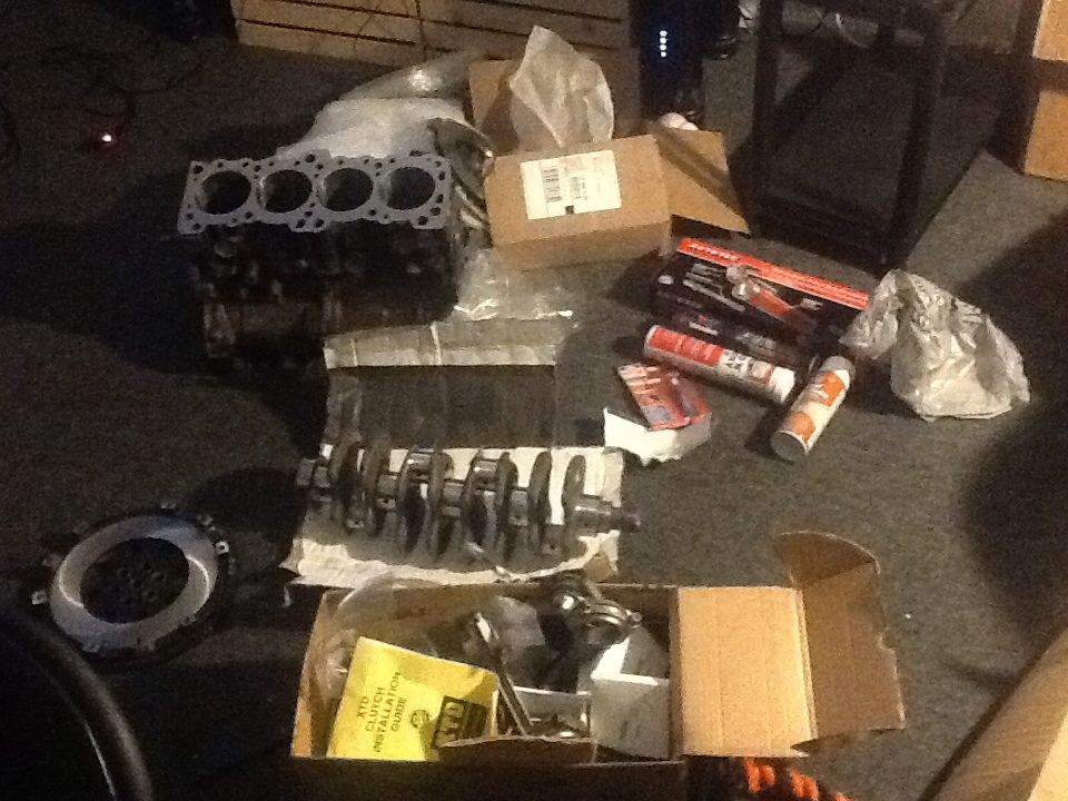

I get the pistons and rods I ordered finally. A couple days prior I ordered one eagle h beam, ACL race series main and rod bearings, and wiseco pistons rings all from extreme psi. I get them cleaned and polished because they are really dirty and look pretty worn. The guy said they were to good to go and only needed new rings, one rod because one was burnt and new bearings. I'm not building the block yet I'm just getting stuff for when I do build it. I take them to my machinist to get checked out. He mics them and tells me they're crap. They were off by a lot. None of them were even close to being the same size. They also had small cracking on the sides. And the guy didn't want to give me a refund so I file a claim. Long story short, month or so goes by before I get my money back. He had the nerve to say I broke them. Extremepsi was nice enough to give a refund for the one eagle rod and (4) piston ring sets. Later that night I order some rc1200cc.

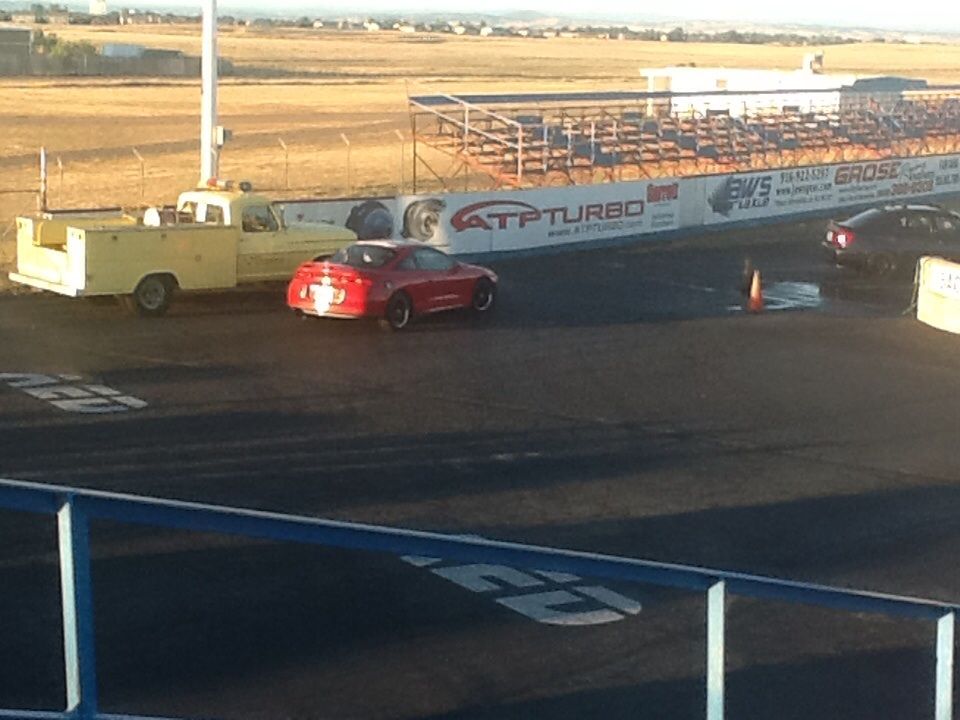

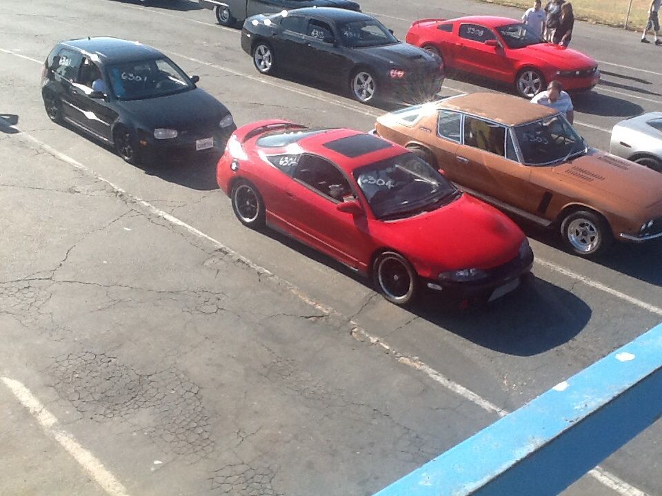

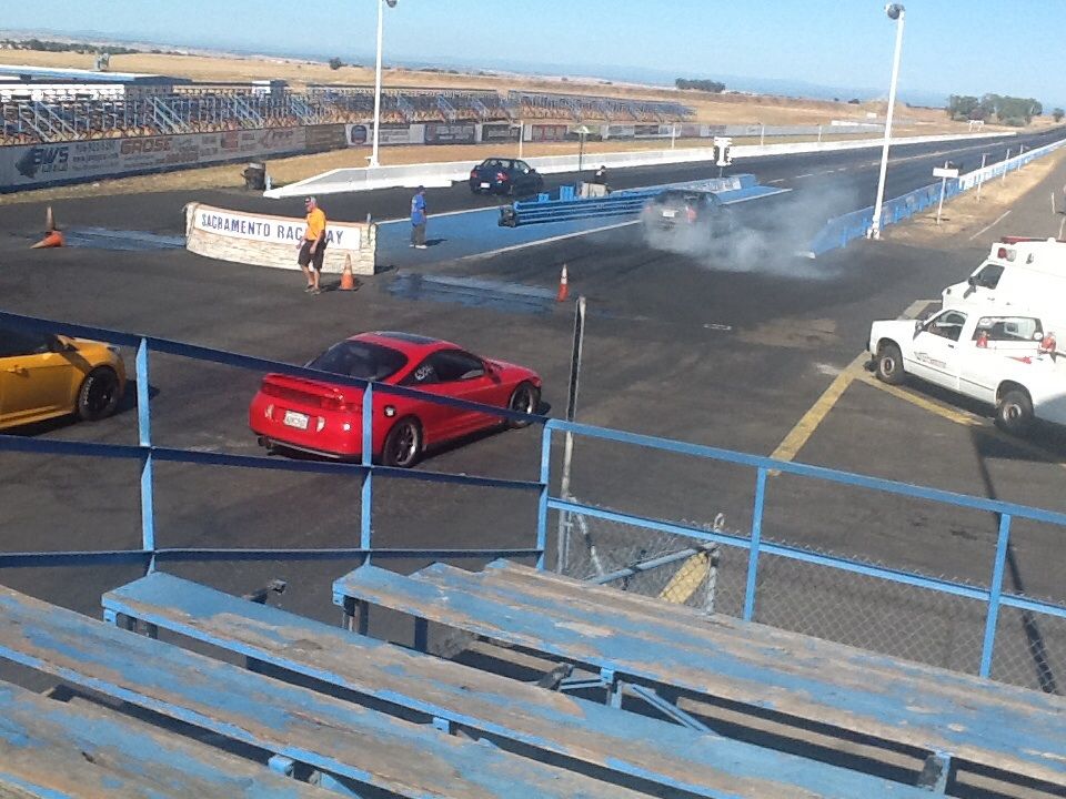

Get up early to take the trip to FFTECH. I get the gasket and check out there cars while I'm there. 1000rwhp gtr, 8sec evos, some type of worlds fastest BMW something, and some dsm's. I hurry up home, out the gasket on and get trendy to leave to take the trip up to Sacramento raceway for the drags. I grab the drag radials and leave the r1s on the car for the drive up there. I grab my jack, stands, and tools, and our dog and we leave. Get there a little early and I park in the lanes and take out the tools, jack, and stands. Check the tune and first run I'm up against a fair lady Z. He ran 14 something I ran 13.6 at 111. I couldn't get the car to hook at all. I run a few more runs against that z turbo civic, turbo integra, 350Z and a Wrx. I win all of them except the Wrx, car bogged off the launch and I miss shifted twice. The last run of the night I finally out in the drag radials. I also change the tune a little because I was getting some knock on the top end. I run a 12.5 at 115. The I pad was dead for the last two runs so I don't have a clip. And between the track and the 1hr drive home we loose the dam tickets. We stopped to air up the tires at a gas station and my wife threw away some trash and I think that's when it happened. Anyhow I had the 13.4 in my pocket and i out that one up on the forums because I didn't want to post the 12.5 without the video or ticket. No biggy.

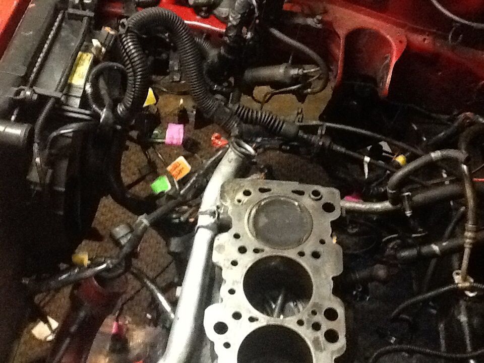

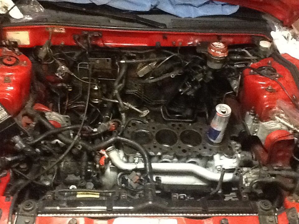

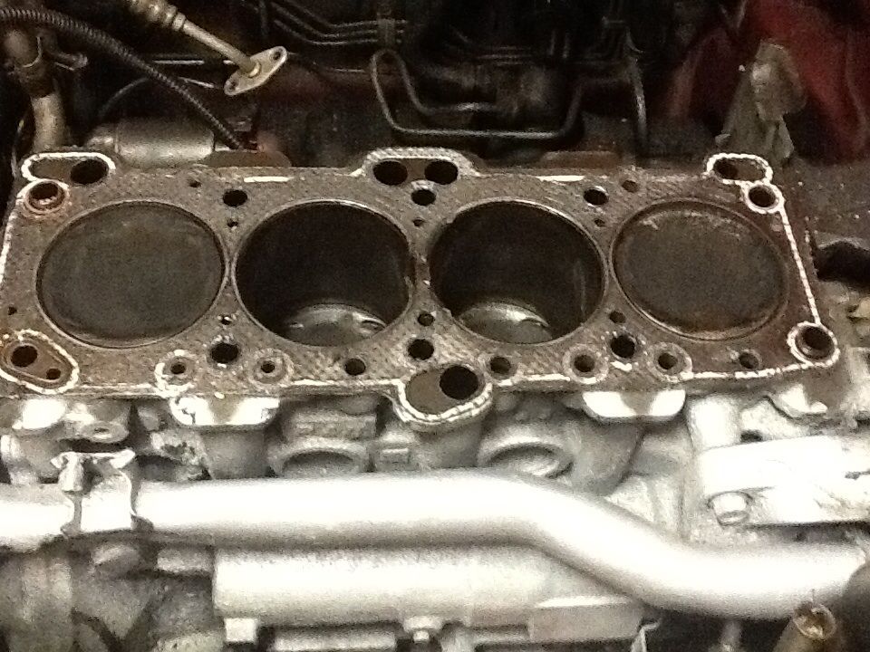

Upon tear down I found it was only a bad head gasket and I was pretty upset because I already ordered a bunch of stuff and started the tear down, when I could've changed the gasket and got back to the track.
