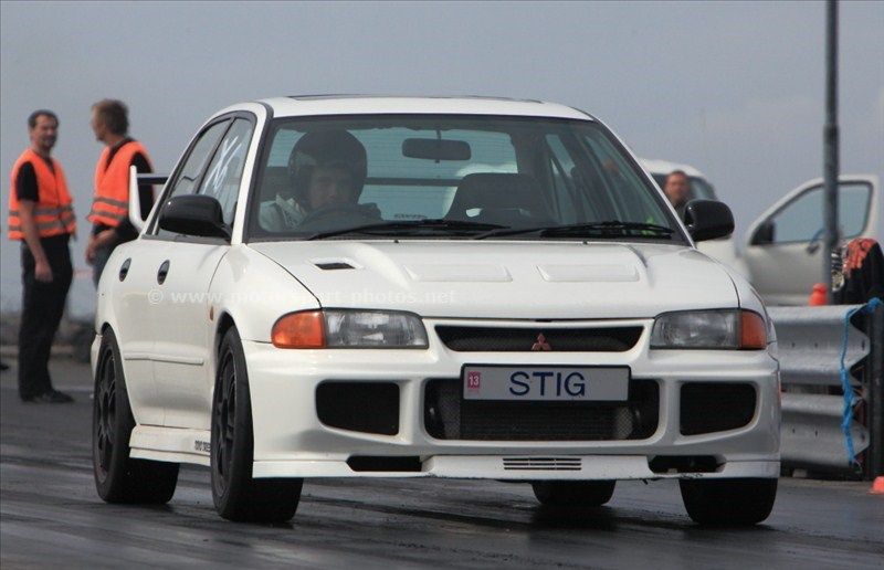

Now the drag racing.
Btw it has stock turbo 16g evo III, stock cams, stock ecu, stock ic, stock ic pipes, stock intake
i ran 11.72@115mph
