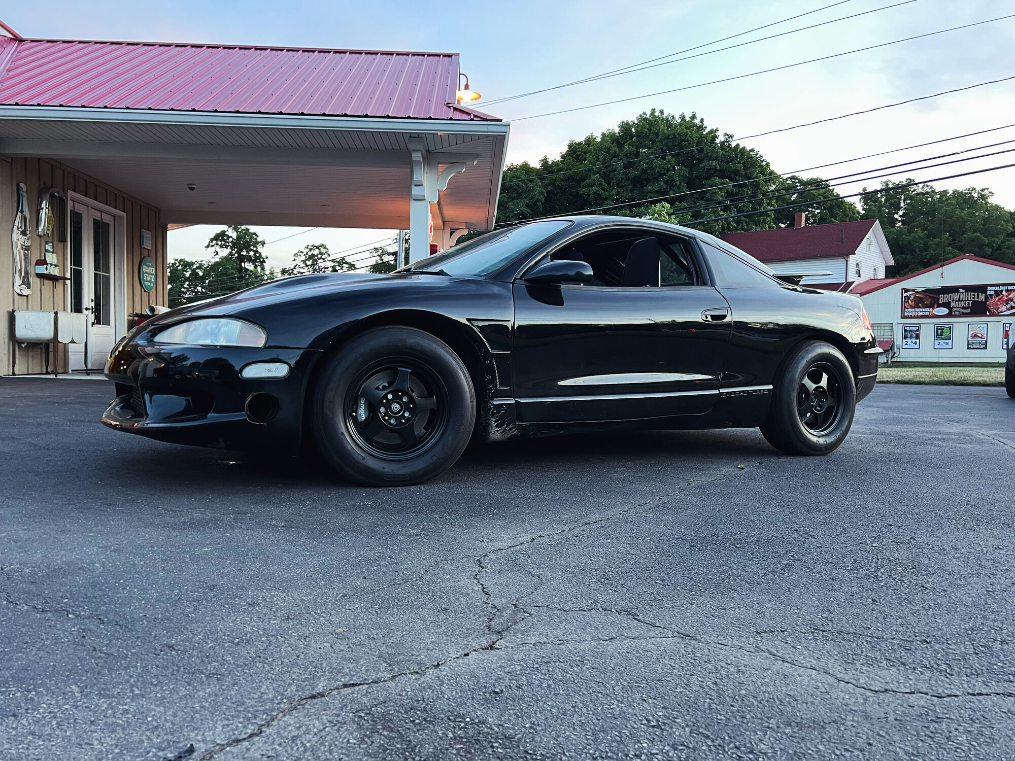

The failure points on the car in 2024 were the stock rear axles and the stock box transmission. After having a terrible time reliably sourcing stock rear axles, it was time to get DSS axles. So over the winter, along with the axles I added a Frontline Fabrication Girdled Diff Cover, All of Volks rear suspension upgrades, upgraded the tail section of the driveshaft to a 1310, a Rear Driveshaft Loop and a Parachute.

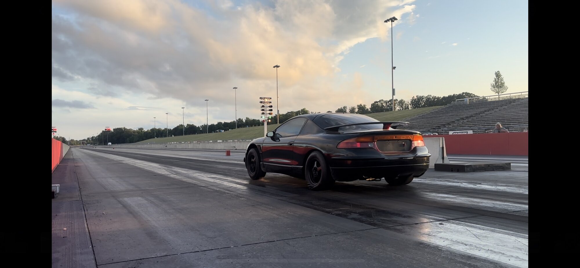

Got another transfer case in the car and made it back out in June. On gate, the car went 10.3 at 144, Turned it up some and it went 9.60 at 144 letting out at the 1000' because the car felt unstable.

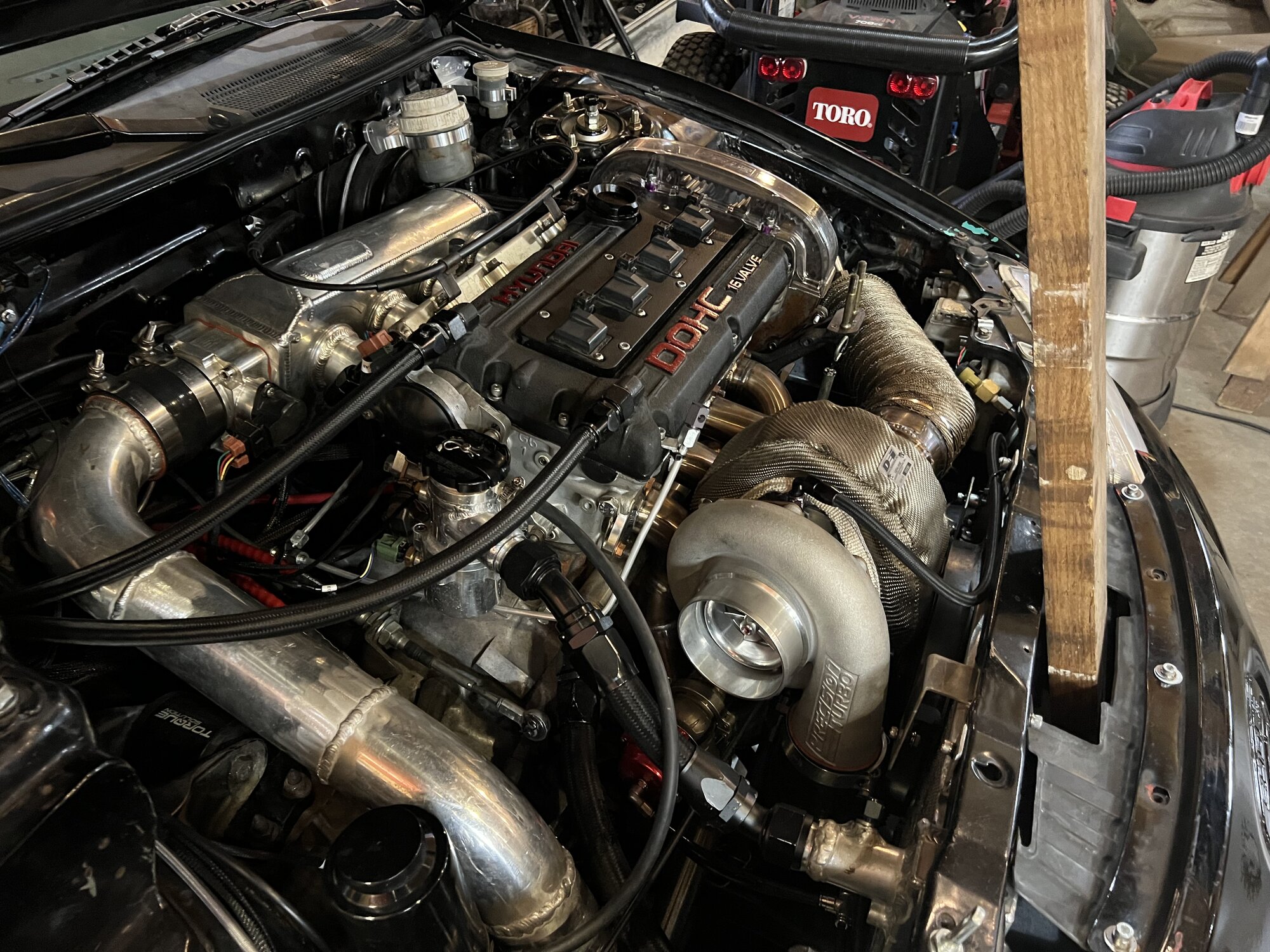

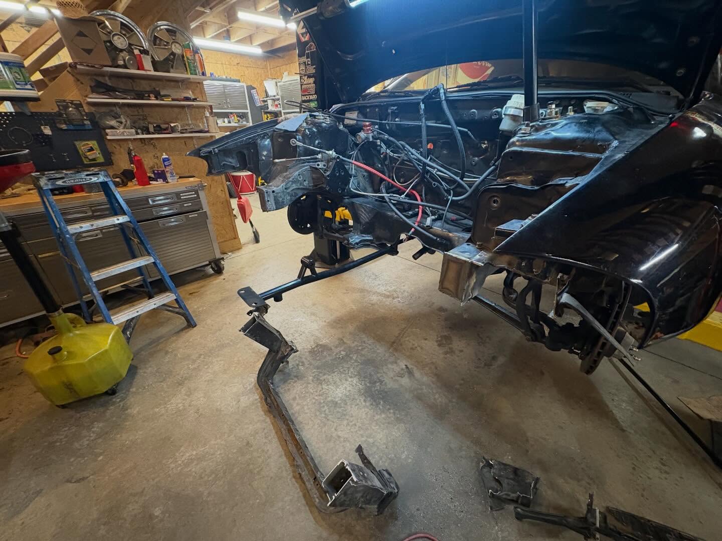

Over the winter I cut the front end off and welded a chromoly front end on the car and upgraded the front suspension to all of Volks front suspension parts and upgraded the T case to a Boostin Built case with a 300m Output shaft, Billet Mid section and Billet Magnus side cover.

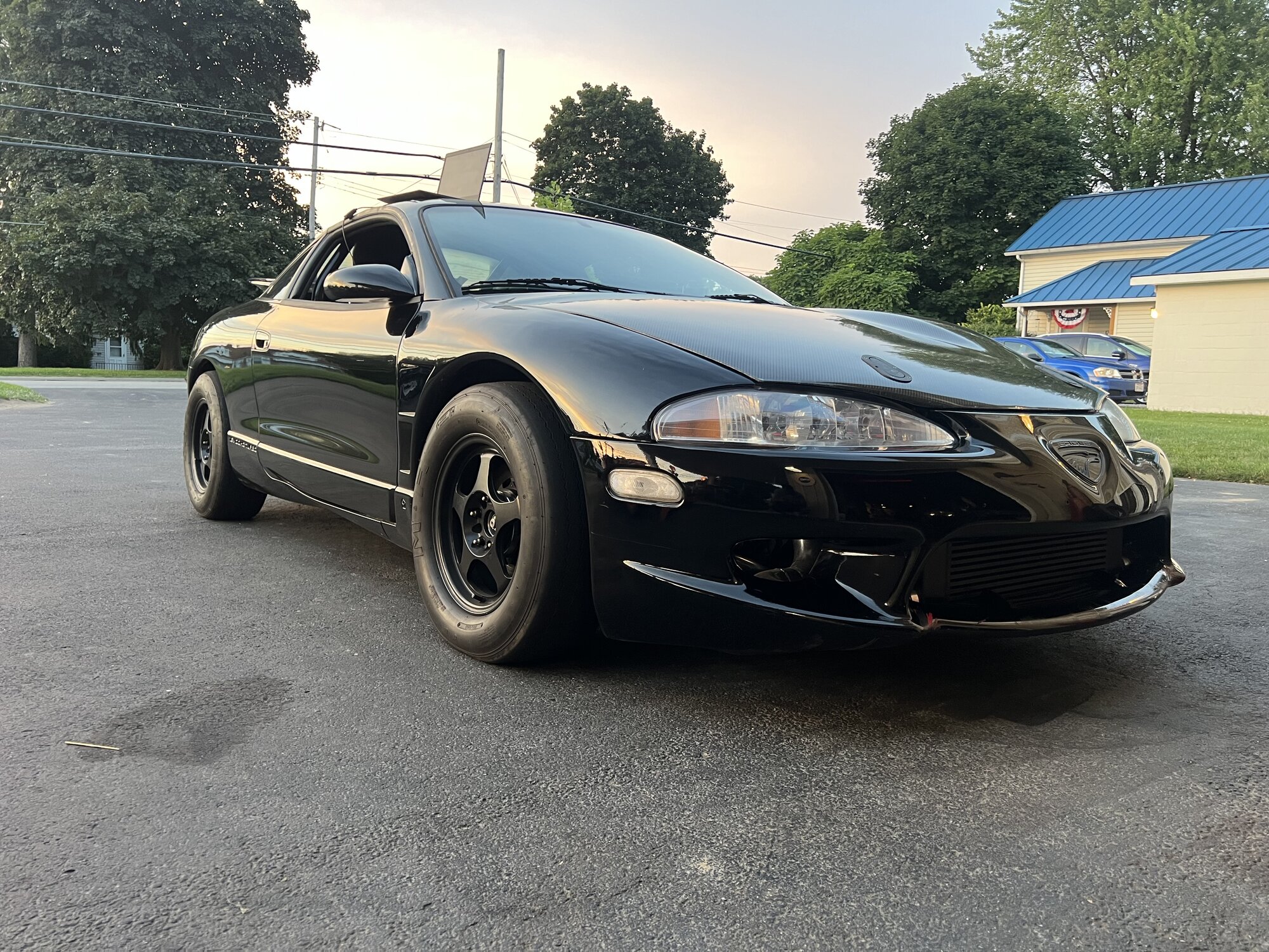

The beginning of 2026 we (Oskim Performance) Hosted a Car show at a Local bar that was a great time.
View attachment 802369View attachment 802368View attachment 802367View attachment 802366

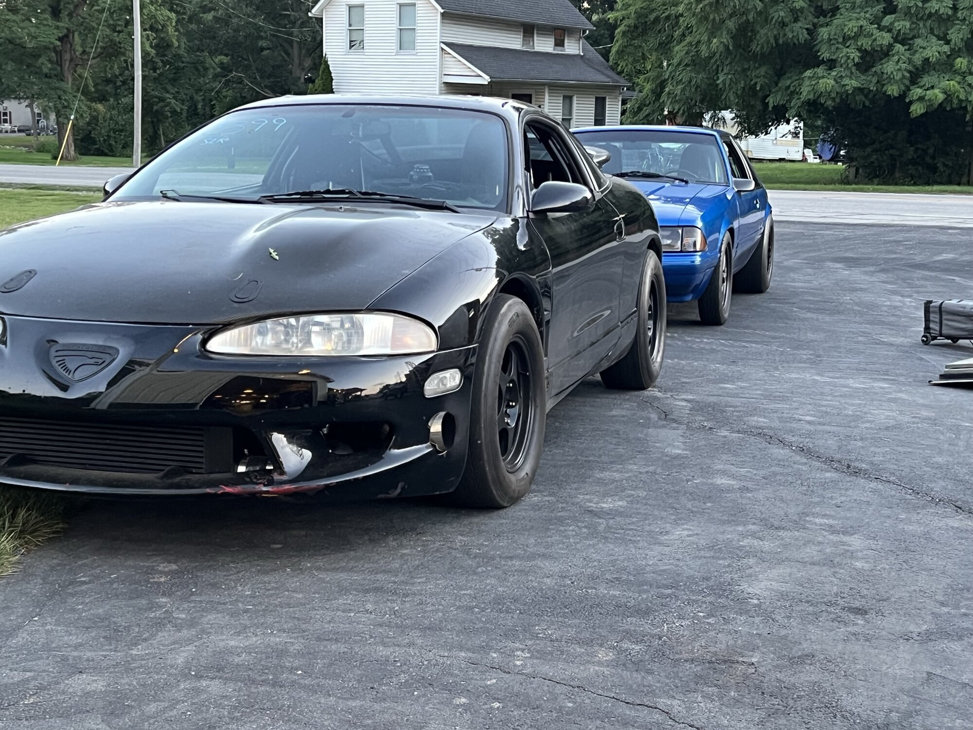

(When I went tube front end, I ordered new headlights and the only headlights they make are for Eclipse bumpers and that leaves a 3 inch gap due to the bumper differences so I had my 3D printing guy print out ducting that takes up the hole and routes air to the Radiator.)
Got the car to the Track in June. With the new T Case I can finally start bringing power in down low and focus more on my short track. Went 9.45 at 163 with a 1.64 60' Made some adjustments to the tune, second pass I cut a 1.57 60' Missed 3rd and still managed to crack off a 9.99 at 5.69
The shootout this year was one of my favorites to date. I competed in the 9.50 Class. Q1 I went a New Personal best of 9.31 at 164. Q2 my vacuum line blew off my BOV mid 3rd gear so I coasted to a 10.8 at like 95 mph. E1 I was up against Andrew Garibaldi in his dialed 1g (in test and tune earlier Sunday he cracked of a 9.50 pass) I got the tree and blew the tires off. He got the 60' and 330'. My car is insane in the back half and somewhere between the 660 and 1000 I came around him with a ridiculous amount of MPH, threw the Chute at the 1000, got on the brakes and still broke out with a 9.4
