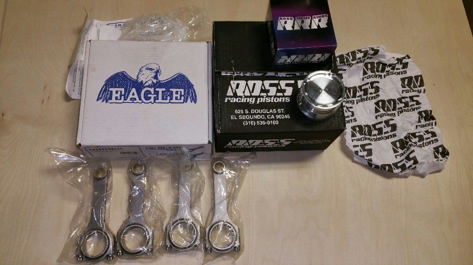

Here are some more goodies that came with the car from previous owner they will be used in future fwd colt project.

Thats the combo i was considering for my next build but I'm now stuck between manley turbo tuff, or magnus steel rods
I have the turbo tuff in the fwd. They are some beefy looking rods.
Eagle/Ross is what I'm wanting to using for my Talon tsi build! Once the gvr4 and gst are done I'll be moving on to that one. Looking to match kels 800hp fwd fun :)
How did you like them? Would you have felt comfortable on your rods making an extra 200whp
Ive currently got scat rods which use the same blank as eagle, but it comes with an extra oil hole
Yeah the turbo tuff are still in the 800whp engine. The rods are rated to handle 300hp each that's a 1200hp total now I don' know if the rating is at the flywheel or tires, more than likely flywheel. So even at my power levels I still have some room for more power on the rods, Not like I want more power just saying LOL LOL.
