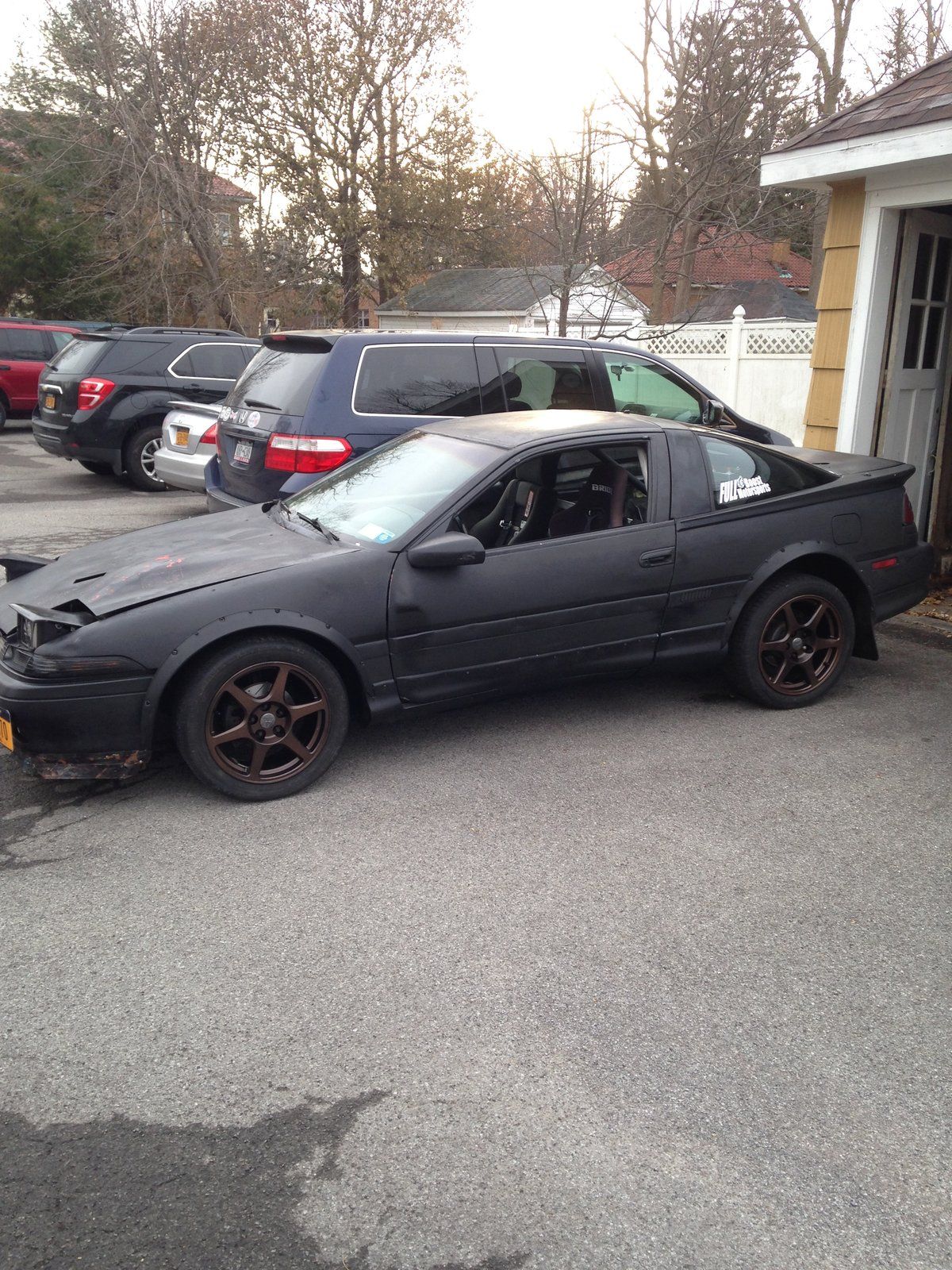

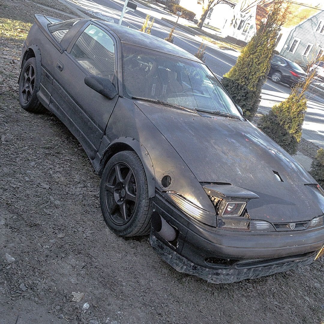

Picked up some evo 8 rims

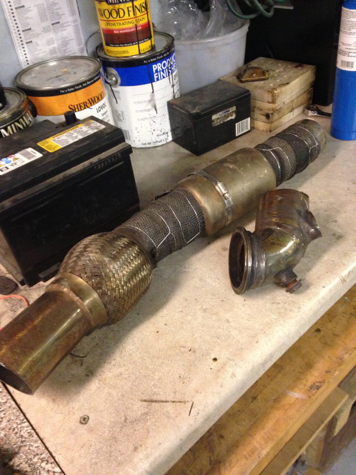

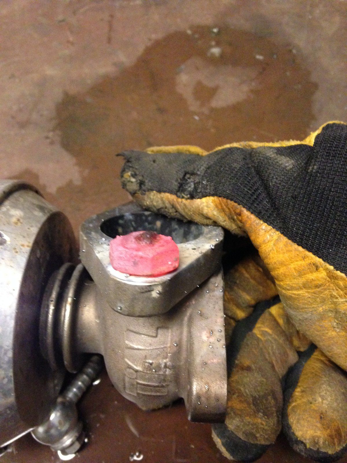

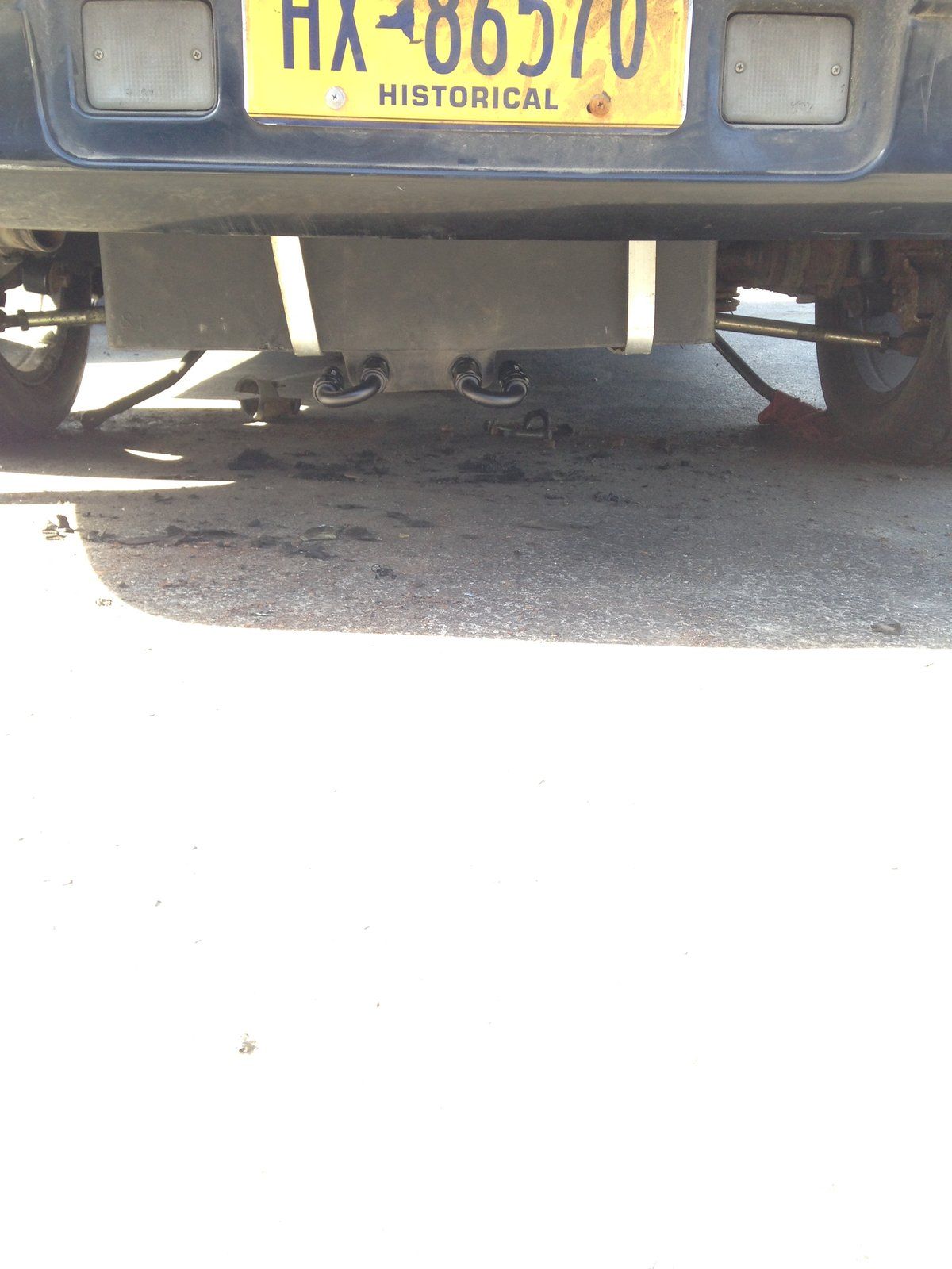

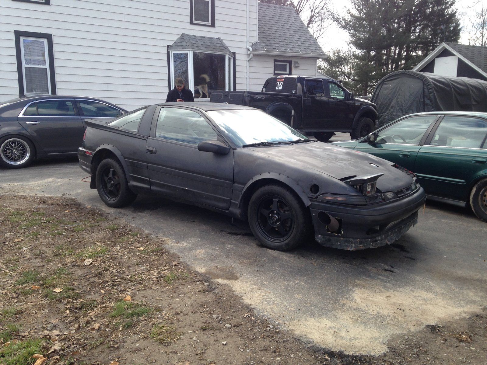

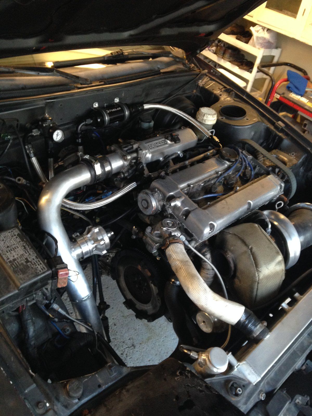

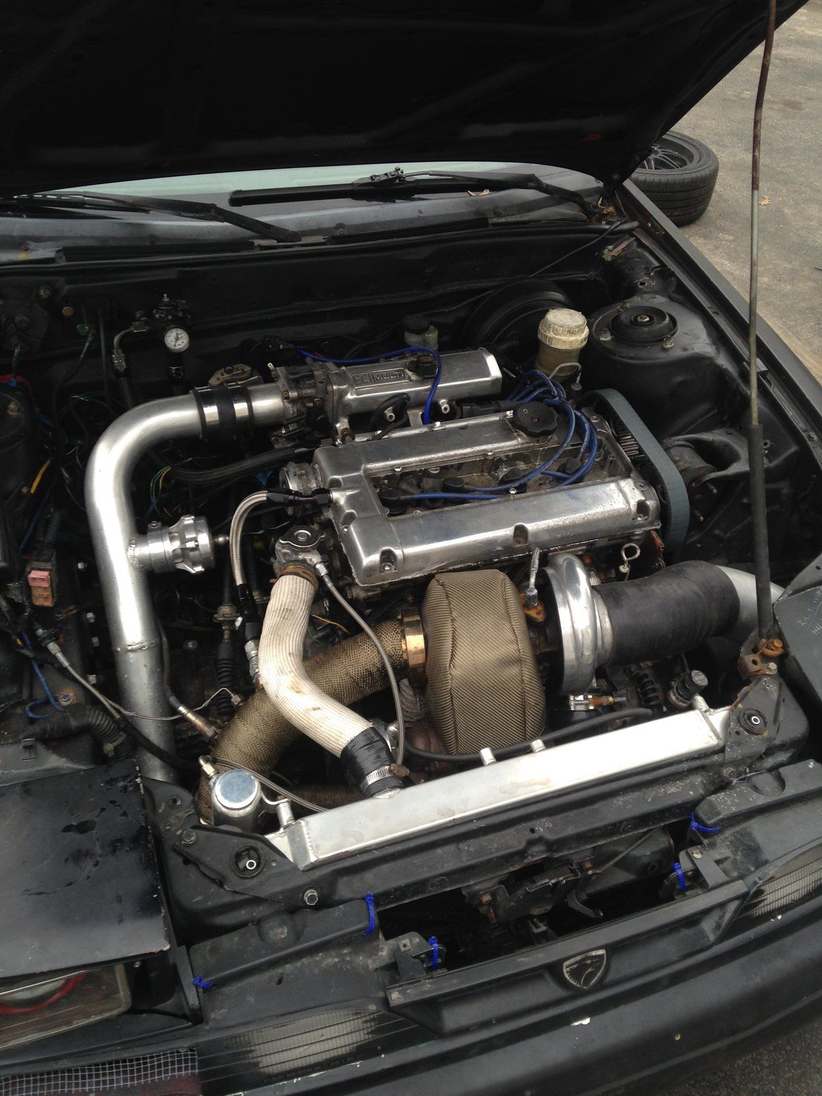

Ditching the bumper exit, its way to lound cant even drive the car without glareing looks and worry of getting pulled over every second. Managed to snap a bolt off in my tial too.

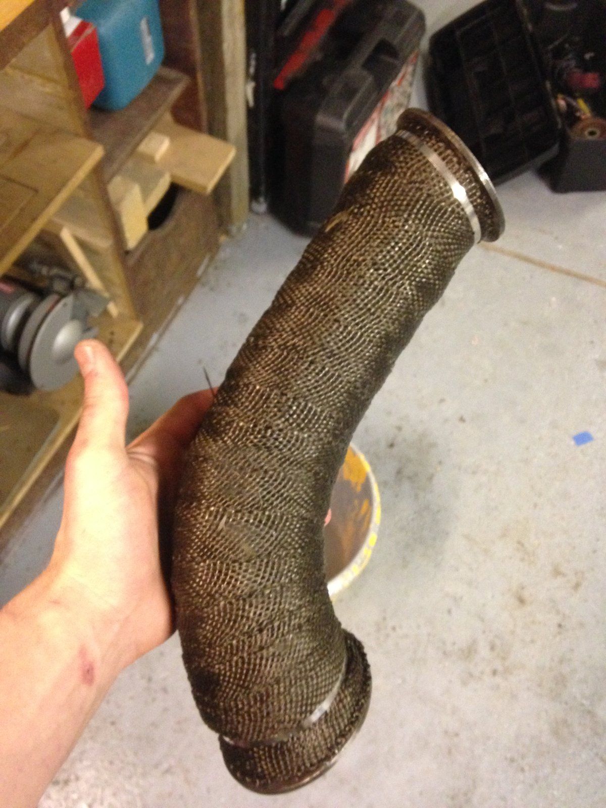

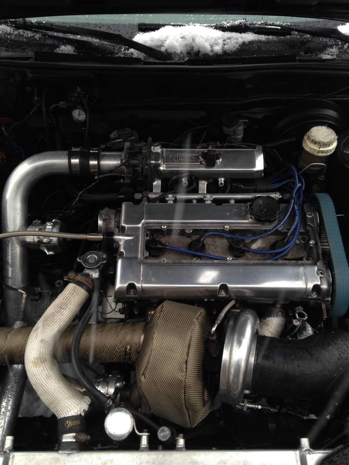

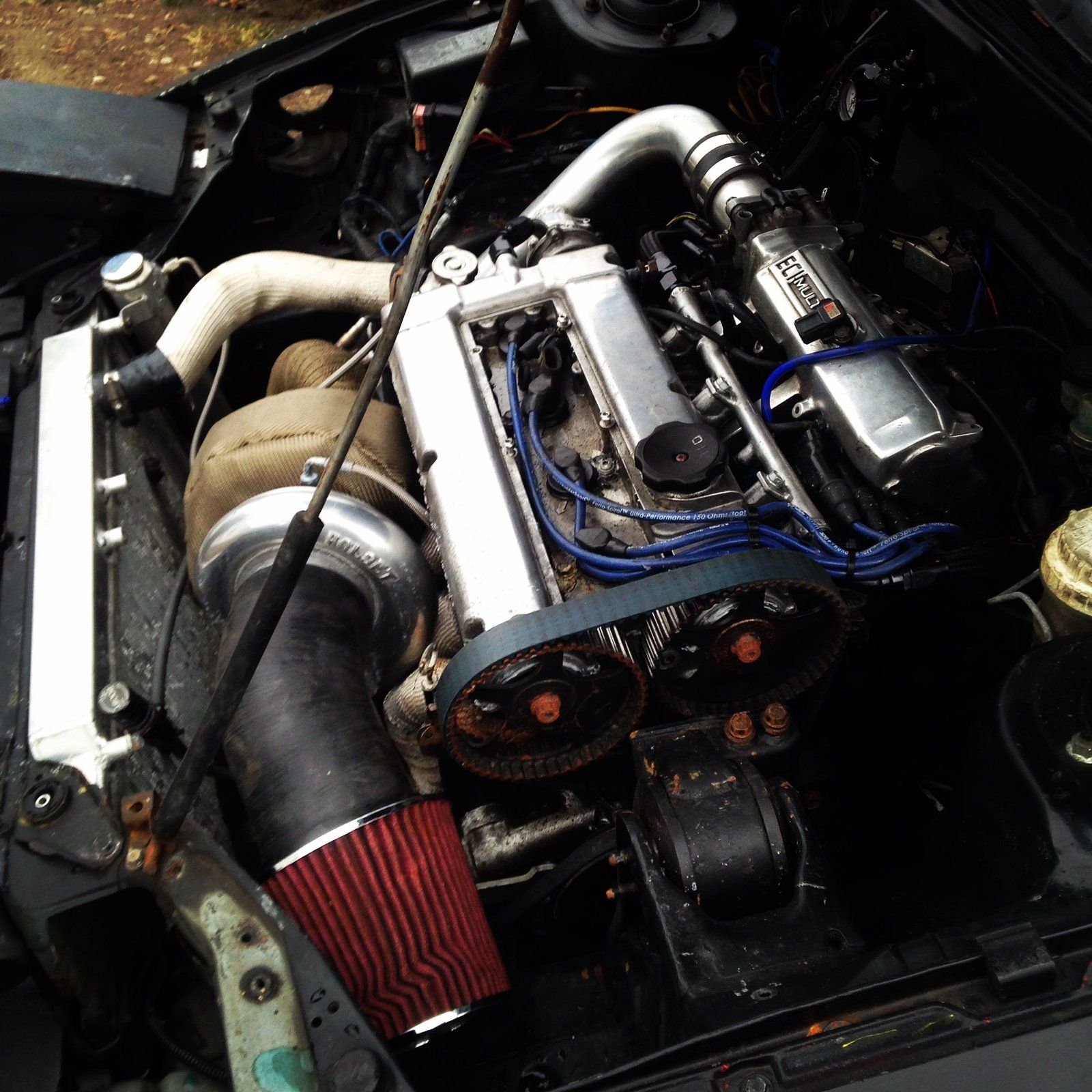

My buddy bought a hx setup off the classifieds came with a v band exhaust setup. He changed his mind and is now going bep so i bought the stainless v band sections off of him. Started to chop it up to make it work. Feel a lot better with an actual v band vs the steel welded to cast like i had.

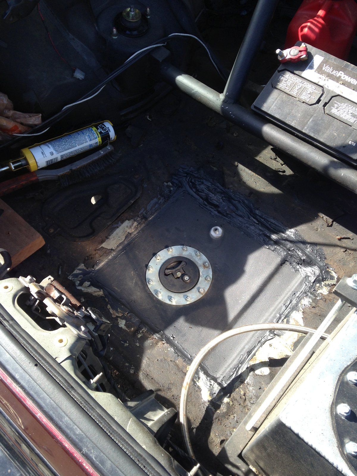

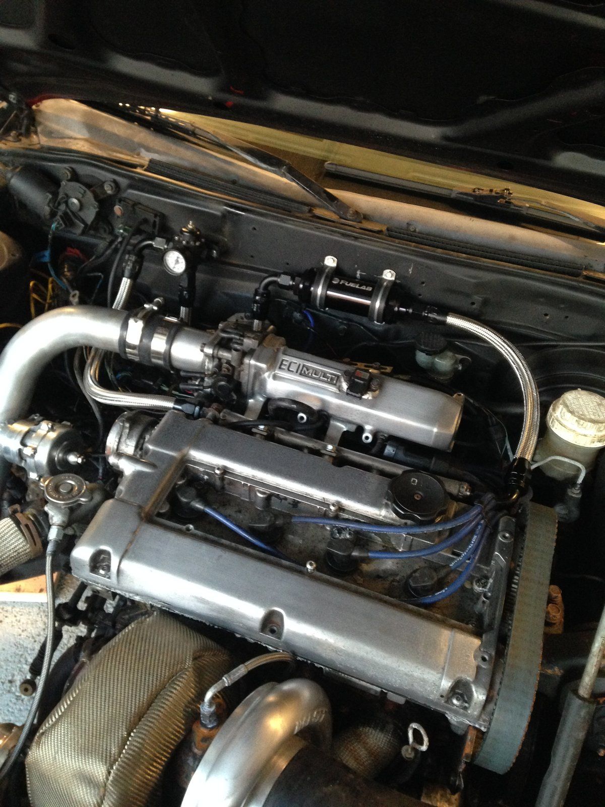

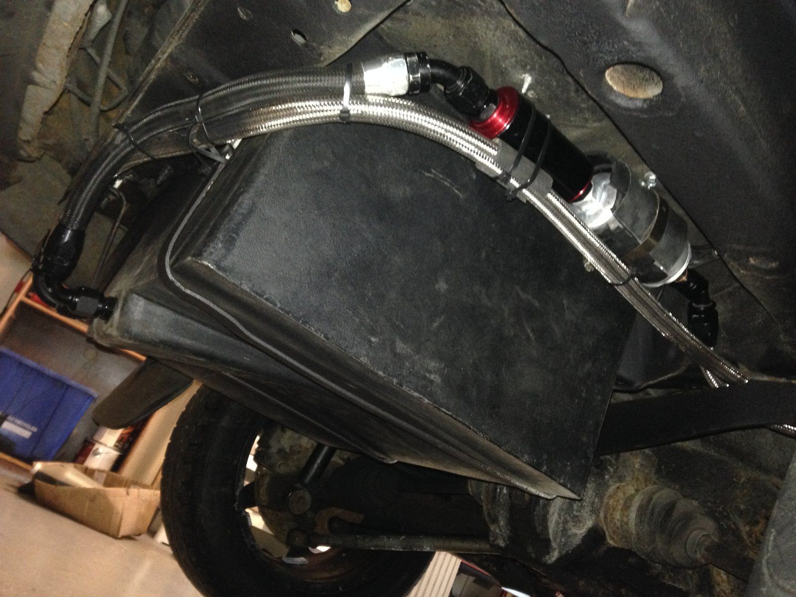

Well my tank started leaking so picked up a fuel cell, two inline e85 filter 100 micron and 9, an line+ fittings,
bosh 004 inline pump

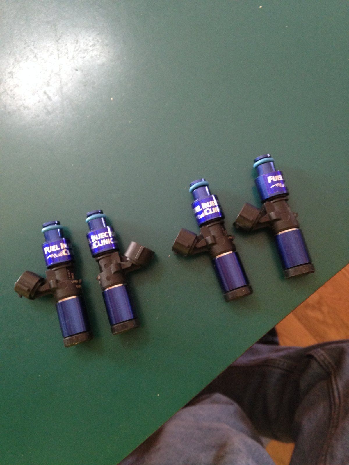

Also some FIC 2150cc high z's

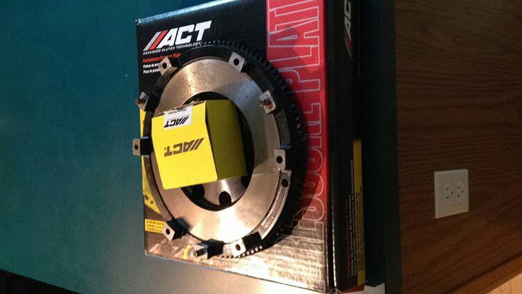

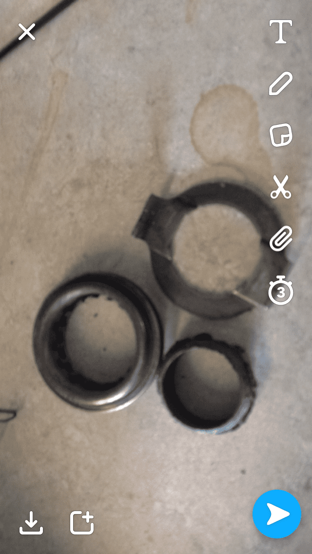

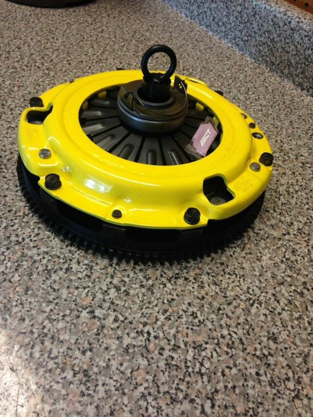

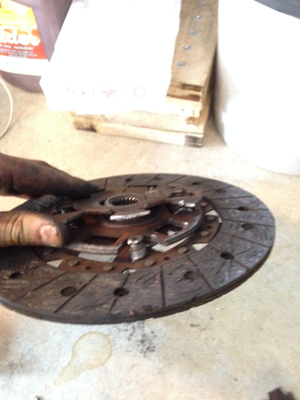

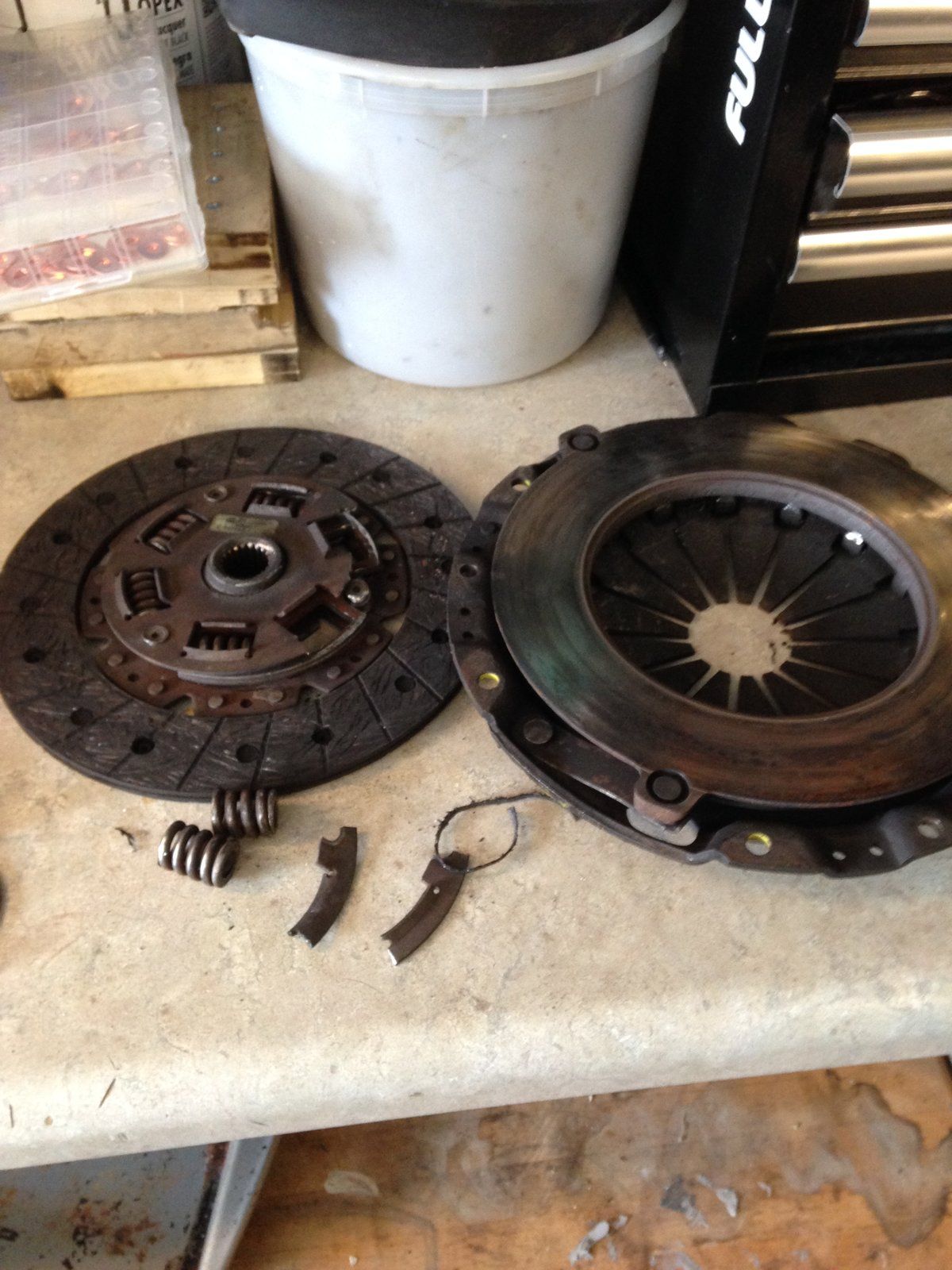

My car is still undriveable from the clutch issue going to be replaceing it the coming weeks just trying to get the fuel system buttoned up.
Definitely a cool little build. Looks like you're having o2 sensor issues?
assuming you saw my post on facebook. My last sensor broke it lasted about 5 months throws a 04 code. replaced it two weeks ago with a new one just got the 08 code on Saturday. I'm really hoping pepboys will replace it these $55 sensors add up

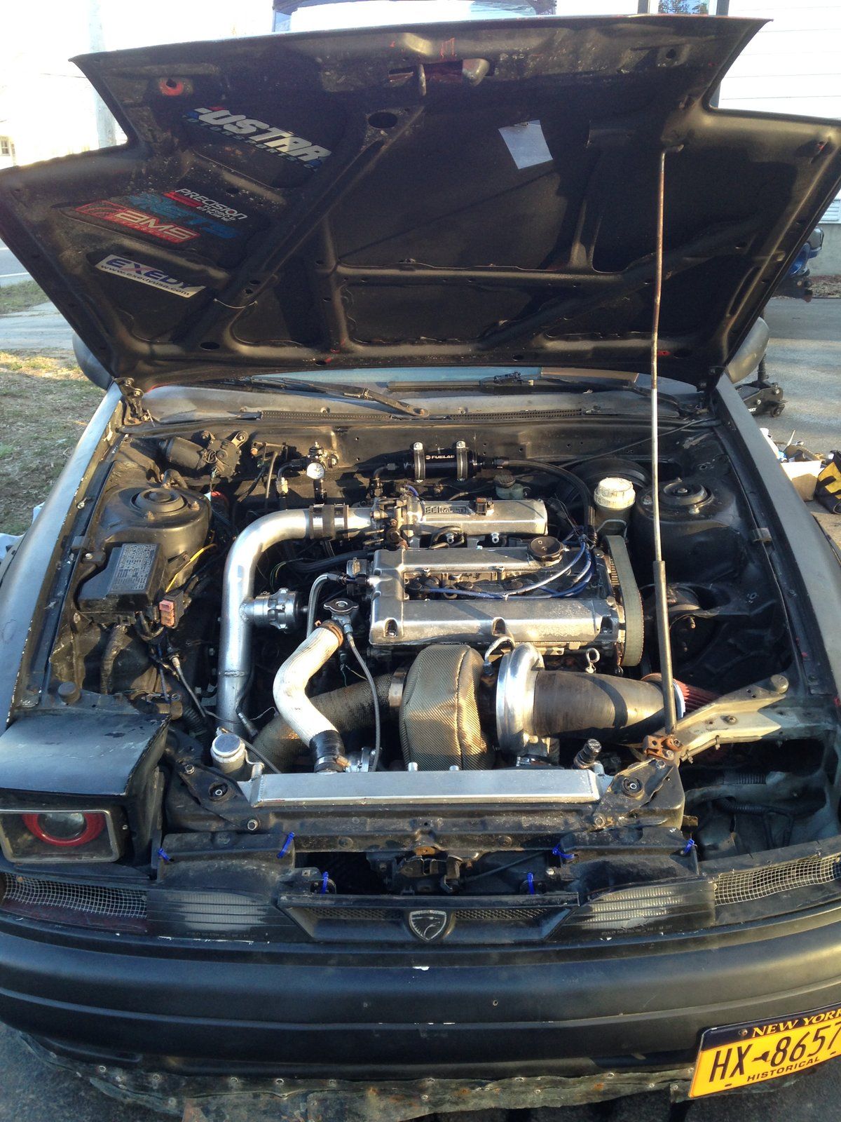

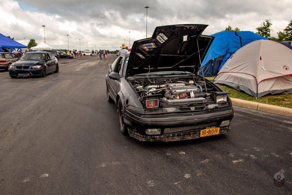

well i made it to the shootout 2018 ran a 11.46 @125
added a 02 spacer a month back seemed to have fixed my or overheating.
also did the tail shaft recall kit. My transfer case leak is finally fixed. Scored a sweet deal on a smim manifold at the shootout hoping to brake into the 10's
