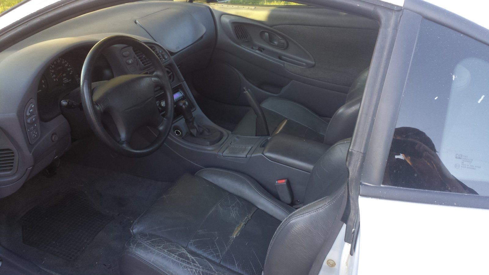

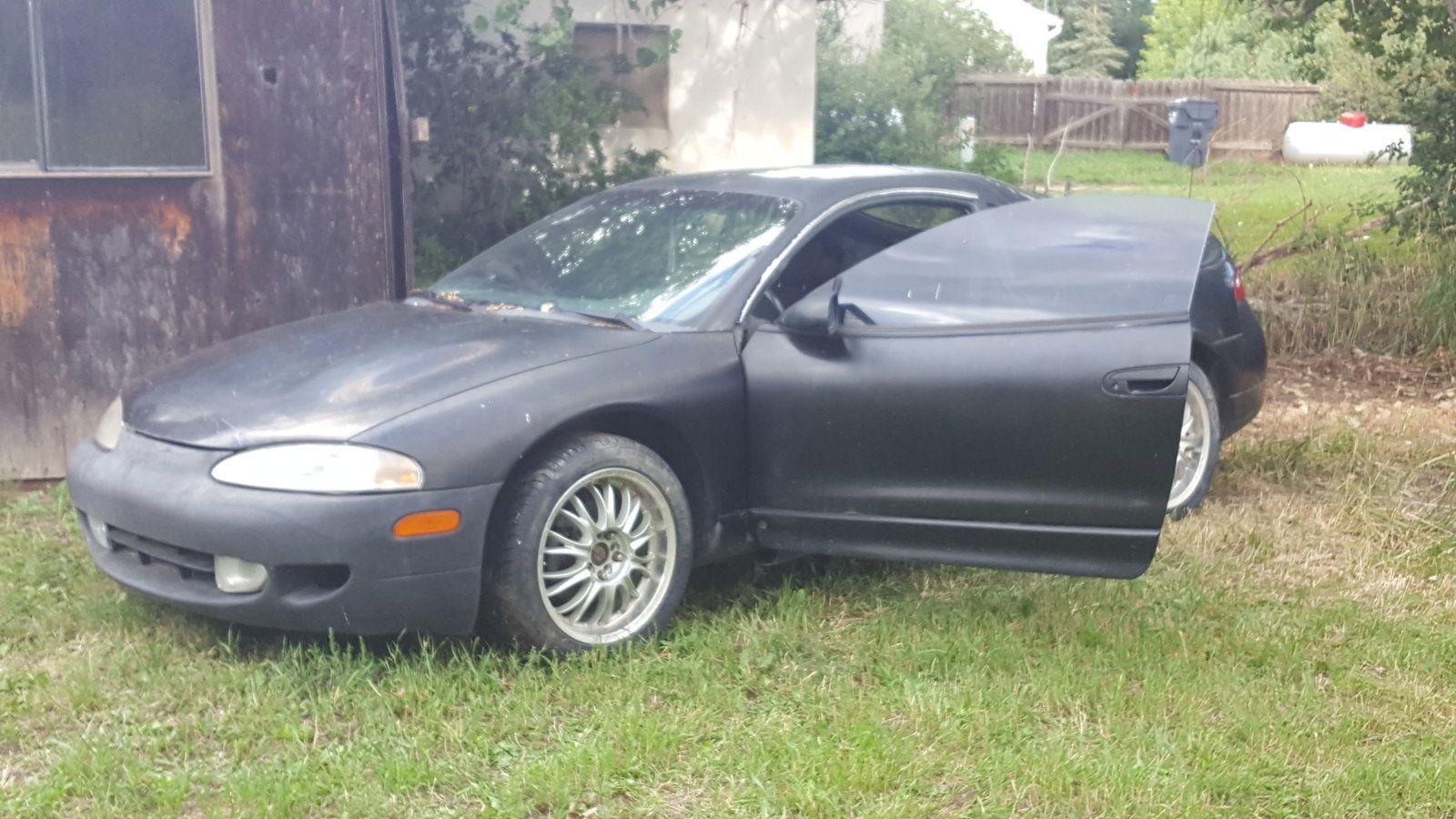

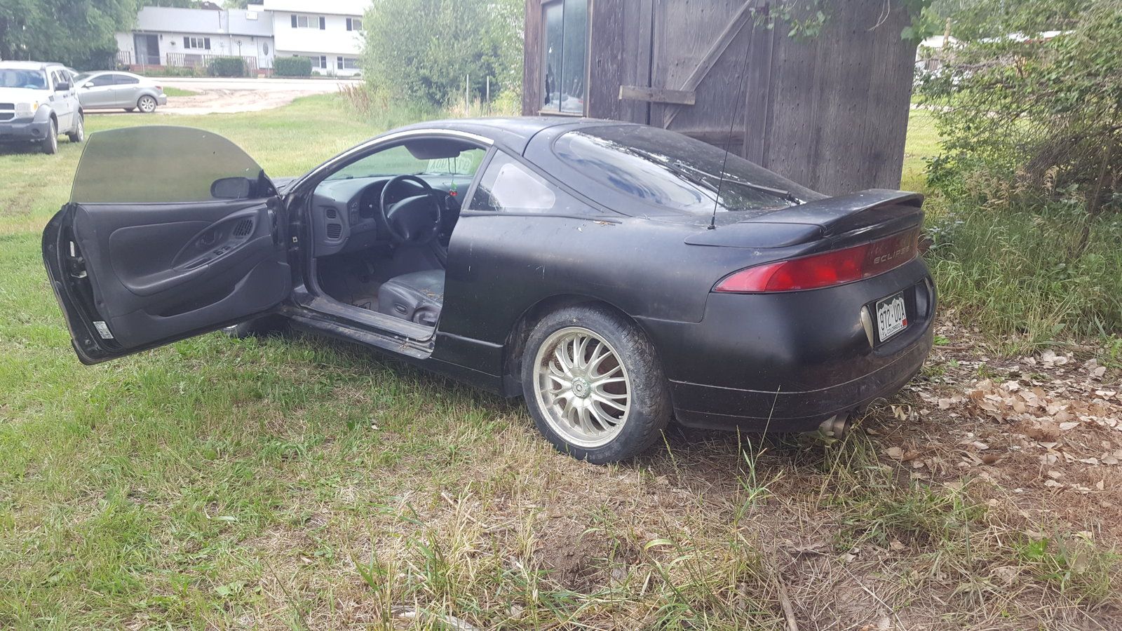

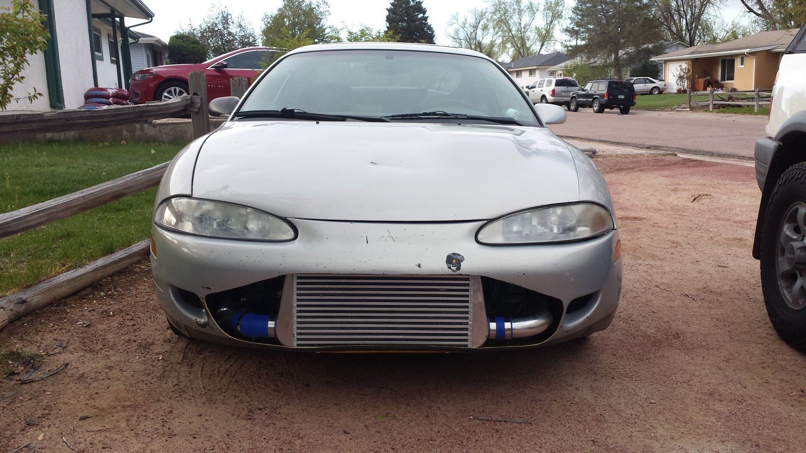

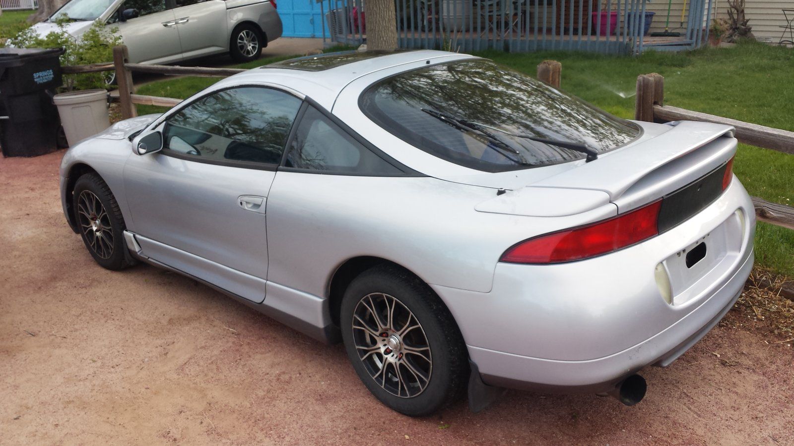

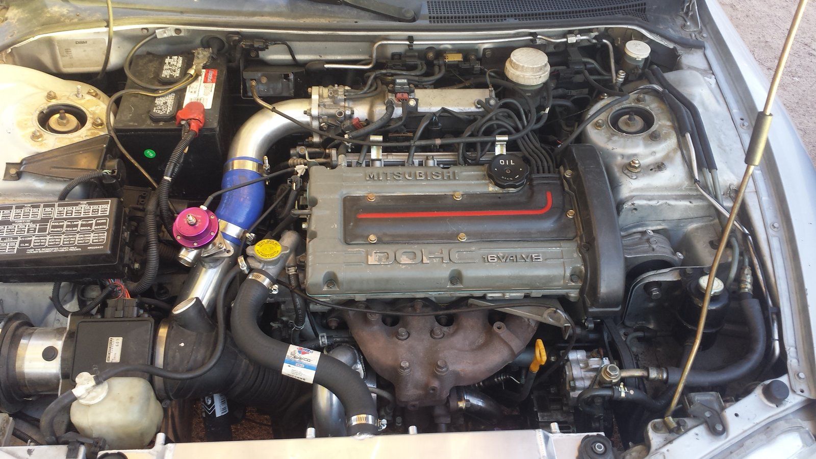

A few months back, I purchased my 2nd DSM, a 1995 Eclipse GS-T, for $1000. It did not run, the owner thought that maybe a piston skirt had broken off, so he shut it down as soon as it started making bad noises. Anyway, I towed it home, and this is what it was when I bought it:

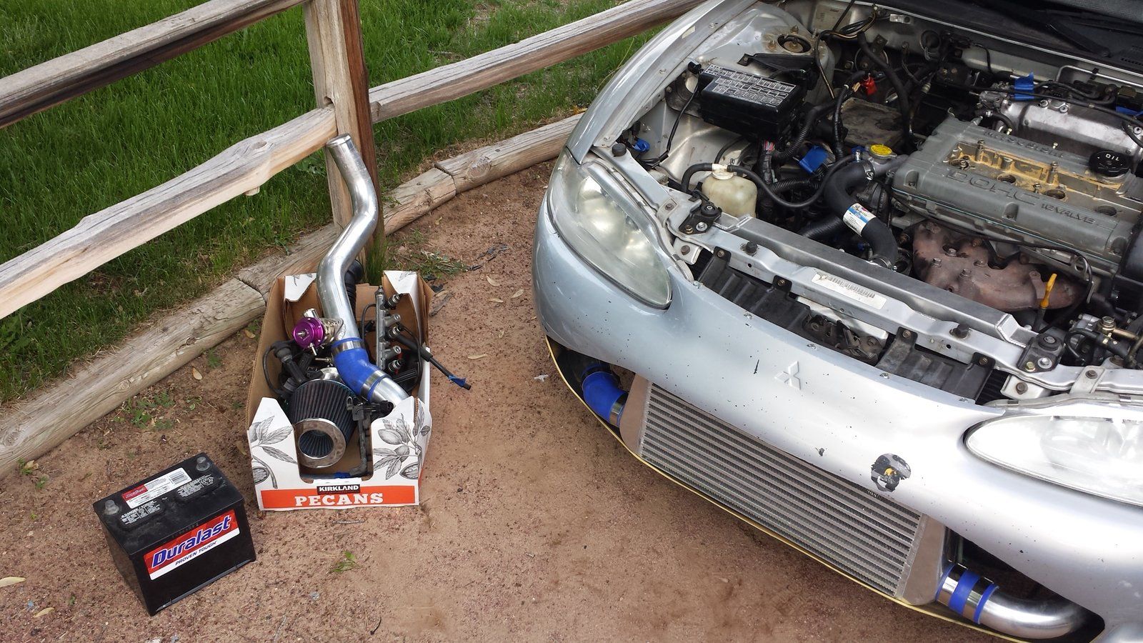

It was a clean shell, if nothing else, plus it came with 2 large boxes full of parts, basically everything that attaches to a 7 bolt 4G63, and a straight hood and front bumper that was in decent shape. Already slightly modified, it had:
-FMIC
-3" Intercooler piping
-Big 16G turbo
-Digital (though cheap) boost and oil pressure gauges
-Some kind of BOV
-"Awesome" racing style muffler welded to stock exhaust
More to come, but this was the starting point.

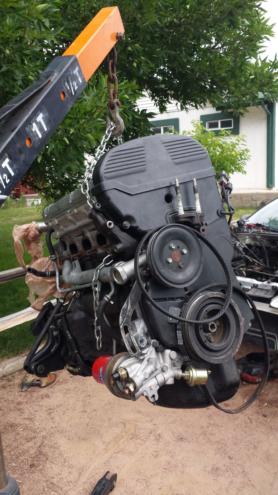

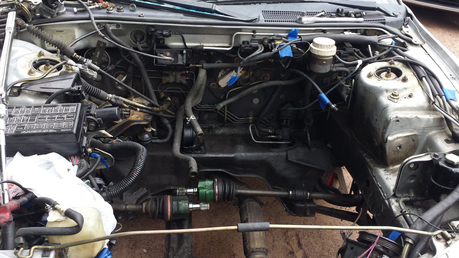

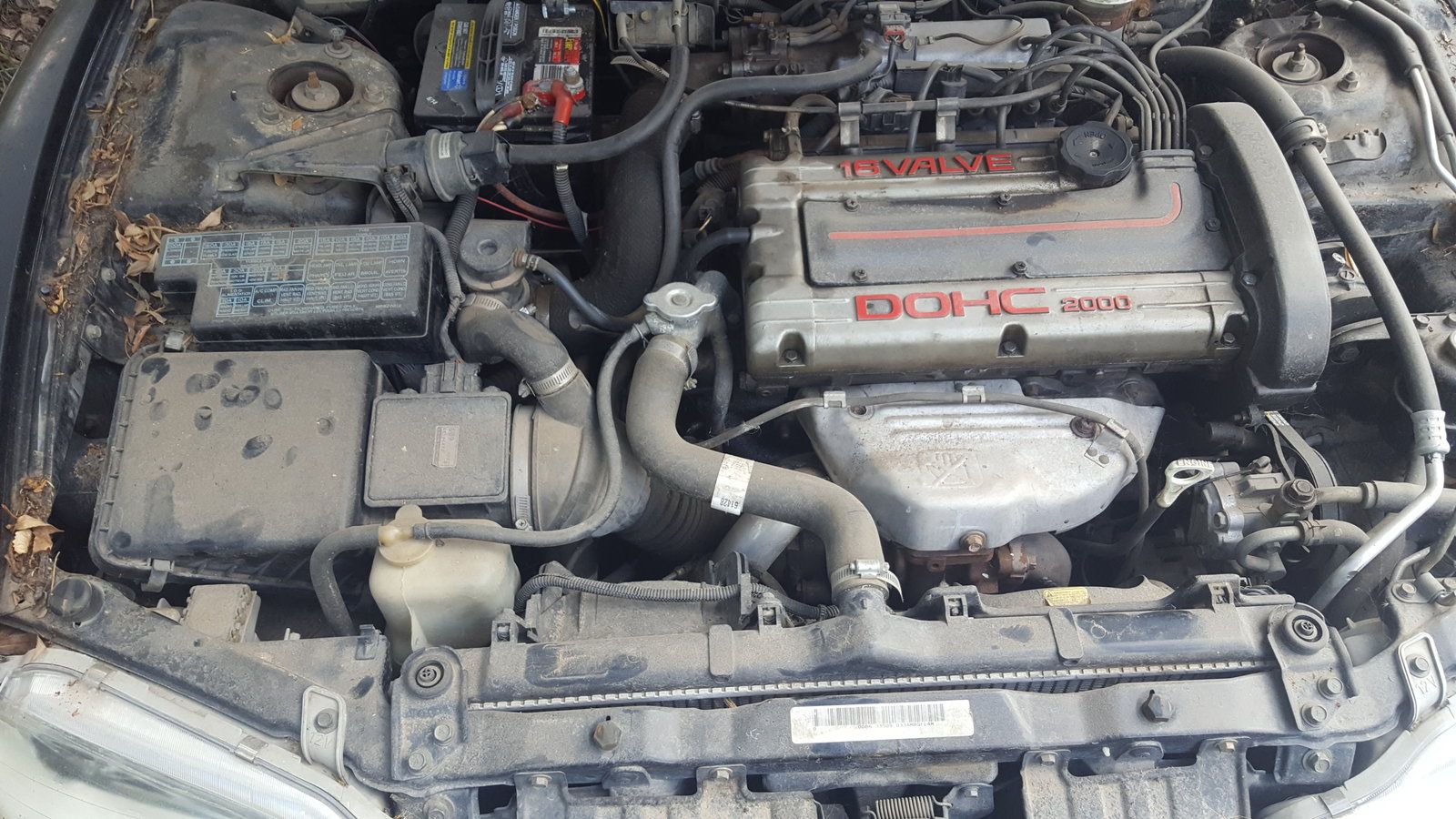

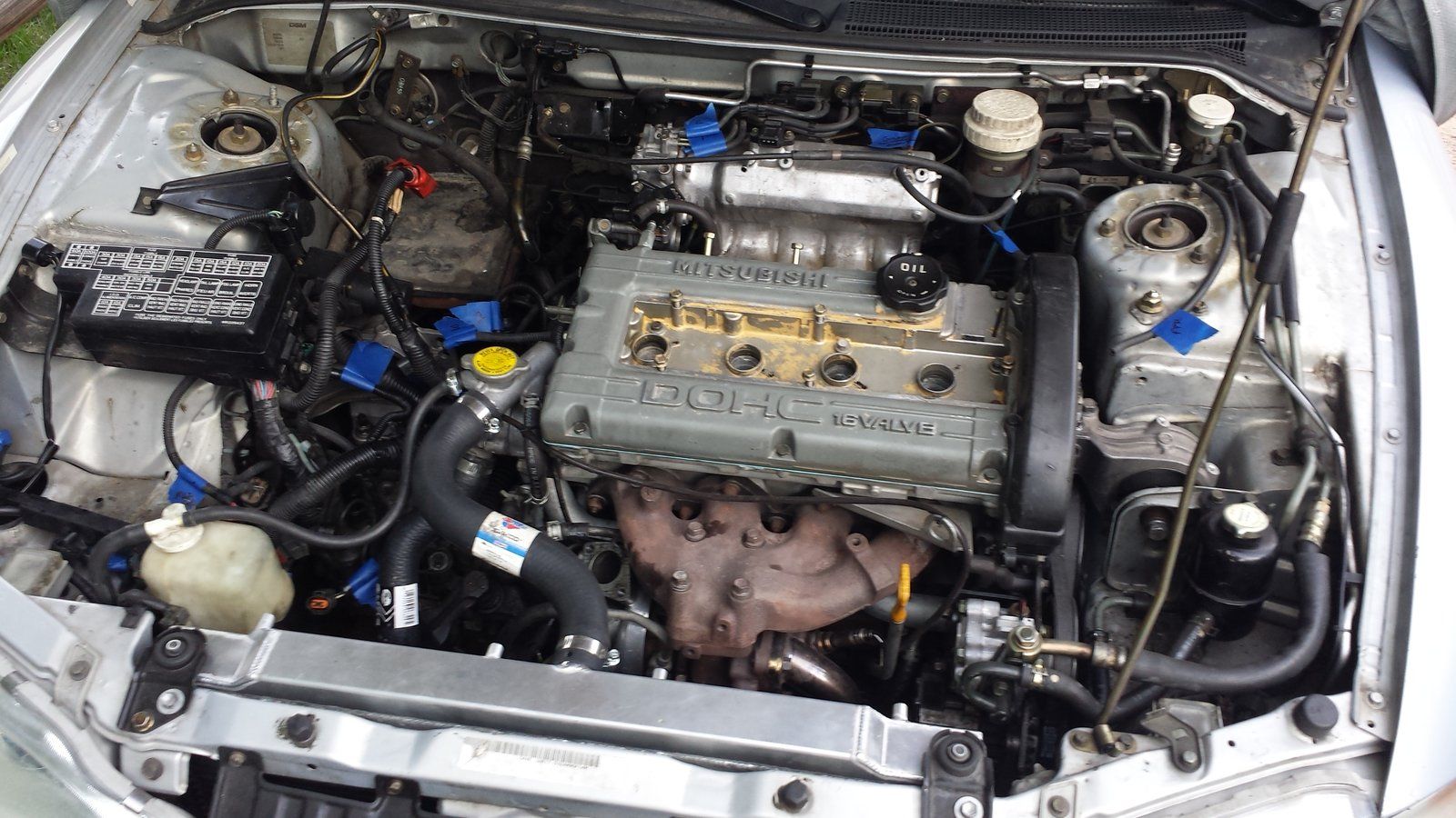

Knowing something was wrong with the engine, I started taking it apart in pieces. When I had some downtime, I'd remove a few pieces or connectors, label everything, try to make so I could put it back together one day without too much swearing and weeping!
Many days later, the engine and transmission were pulled, and it was time for disassembly.

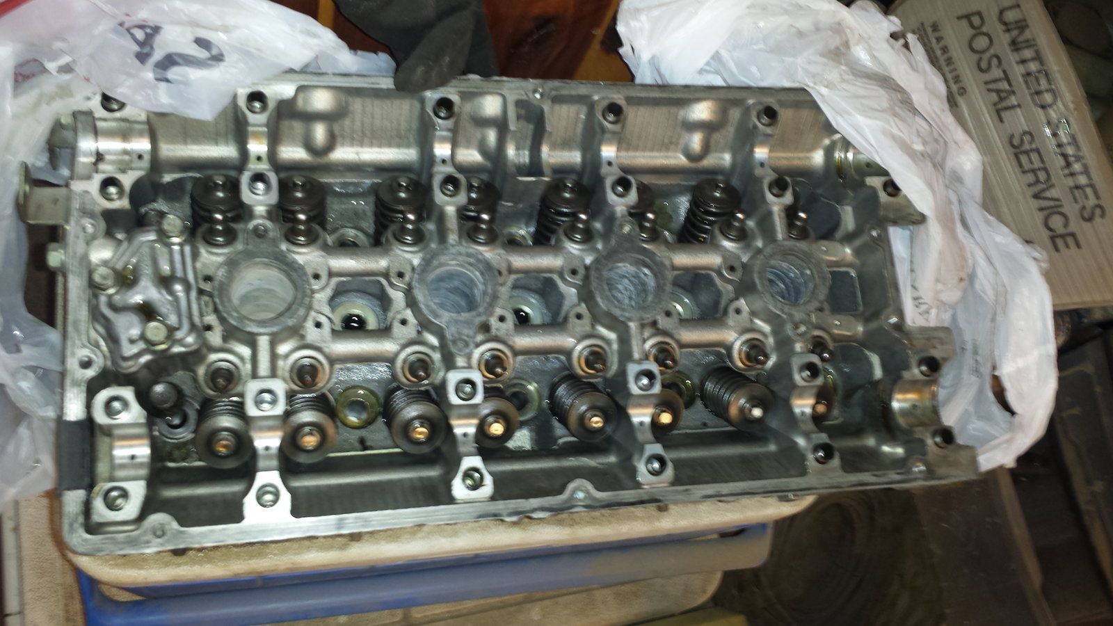

Once the transmission was removed and the engine was on it's stand, I removed the valve cover, camshafts, and head bolts.... Unbelievably clean.

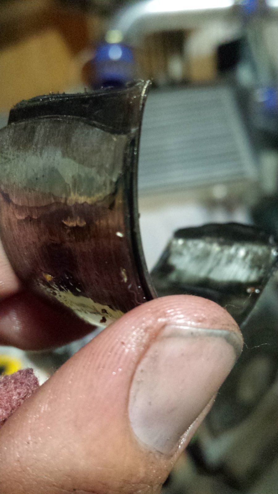

Next, I flip the engine over, and remove the oil pan. Not nearly the carnage I was expecting, just a few copper flakes on the pickup tube. I pulled the baffle, the end caps off the connecting rods, and finally the pistons and rods. No damage to the rods, pistons, or cylinder walls.... Nice. In the end, it was a spun bearing on cylinder #1, and one scratch on the corresponding crankshaft lobe.
Looks like a knock-off Greddy BOV. Wouldn't bet on the 16g being an MHI unit with all the other "cheap" mods. Looks like a good car to start on though.
The mods were definitely done on the cheap, but I plan to remedy all of that! I never questioned the turbo until you mentioned that, but with a bit of research, it does seem like it might be a knockoff.... Has a cheap looking identification plate on it. In any case, it seems to be in ok shape, so I'll come back to that at the end. Also, couldn't help but notice you're also in Colorado Springs. Is there still a DSM croud, here?
Years ago I bought a 16g through Amazon from a place called Godspeed. I though it'd be decent quality since it wasn't ebay. I was so wrong. It failed on the first start up. I found a GSX here that I'm going to be buying and it has a 16g style turbo, but the current owner doesn't remember what turbo it actually is, so I'll find out once I buy it.

Ok, so I took the crankshaft to get machined, they said it probably needs to go .20 over. The #4 rod bearing was also about to go, too, upon closer inspection. Bought a set of Evergreen OEM style rods so the entire rotating assembly can have a nice, fresh start, and I'm going to replace the wrist pins, too. I'm on the fence about the pistons.... They look good, but at this point everything else will essentially be new, so I was wondering what everyone's opinion is on that?
