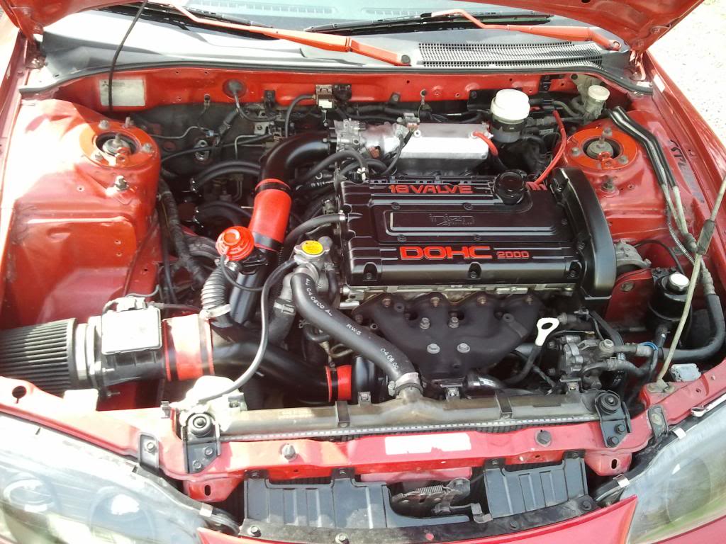

On another note, I had cleaned up the engine bay pretty good before all this happened.
man that sucks about your car crankwalking. don't give up on it though it looks great and u did a very good job on turning it around since you bought it. I hope to see more on this build!
Yeah it sucks but I'm looking forward to the new setup. Thanks for the compliments and there will definitely be more to come.
