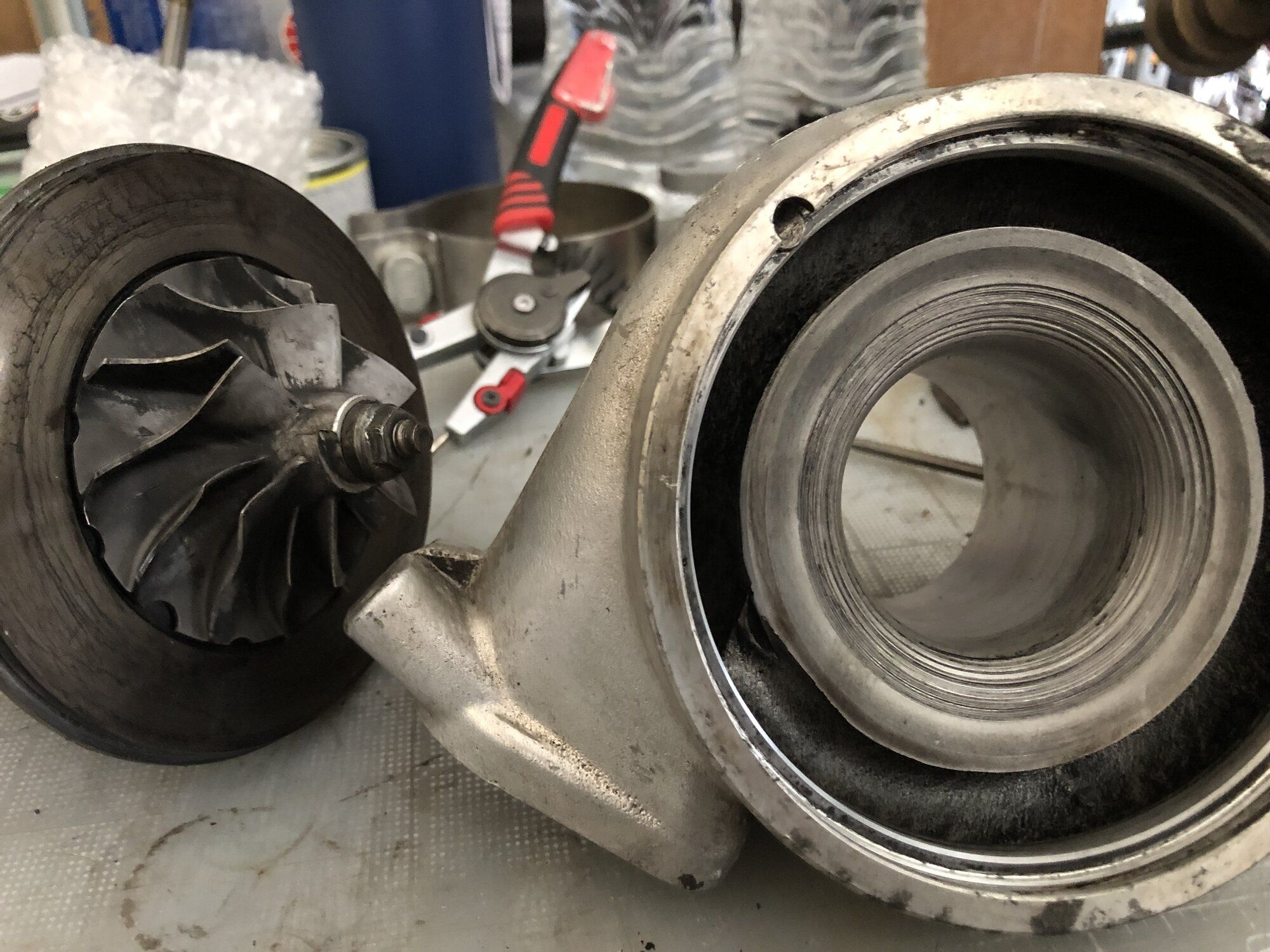

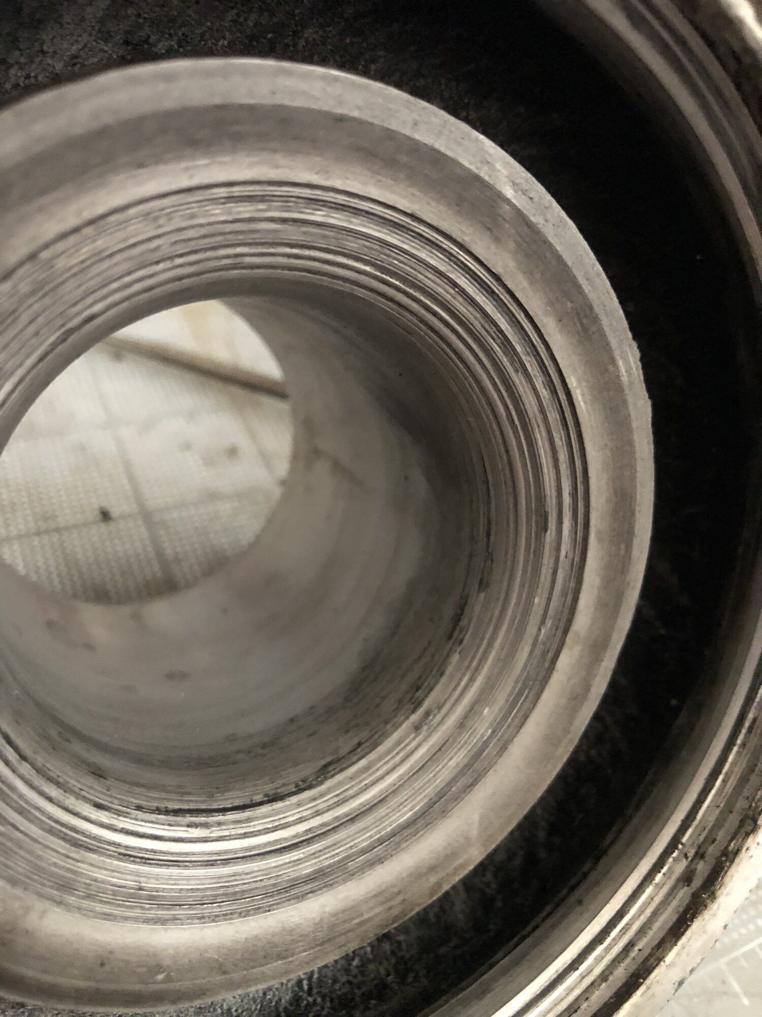

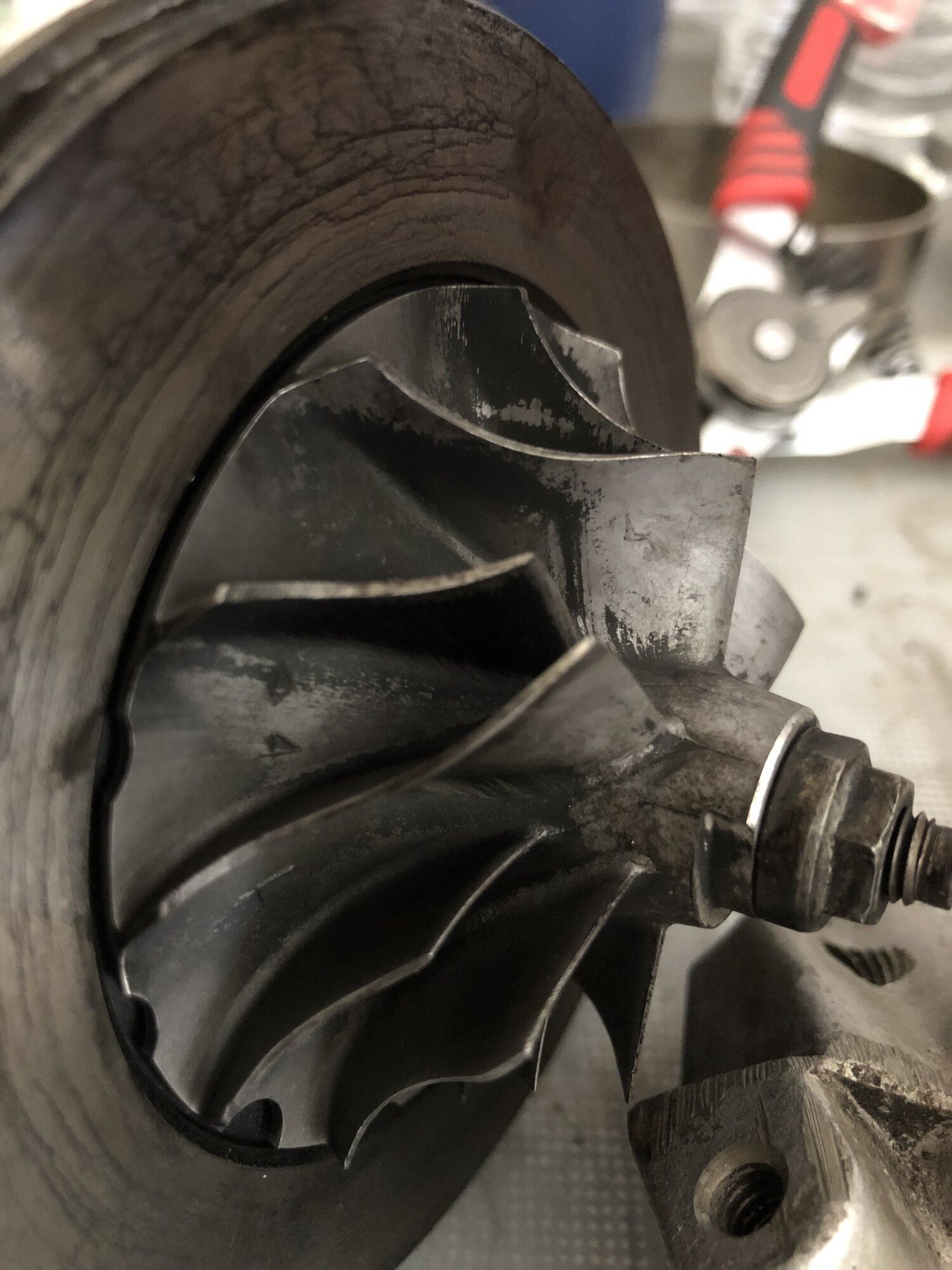

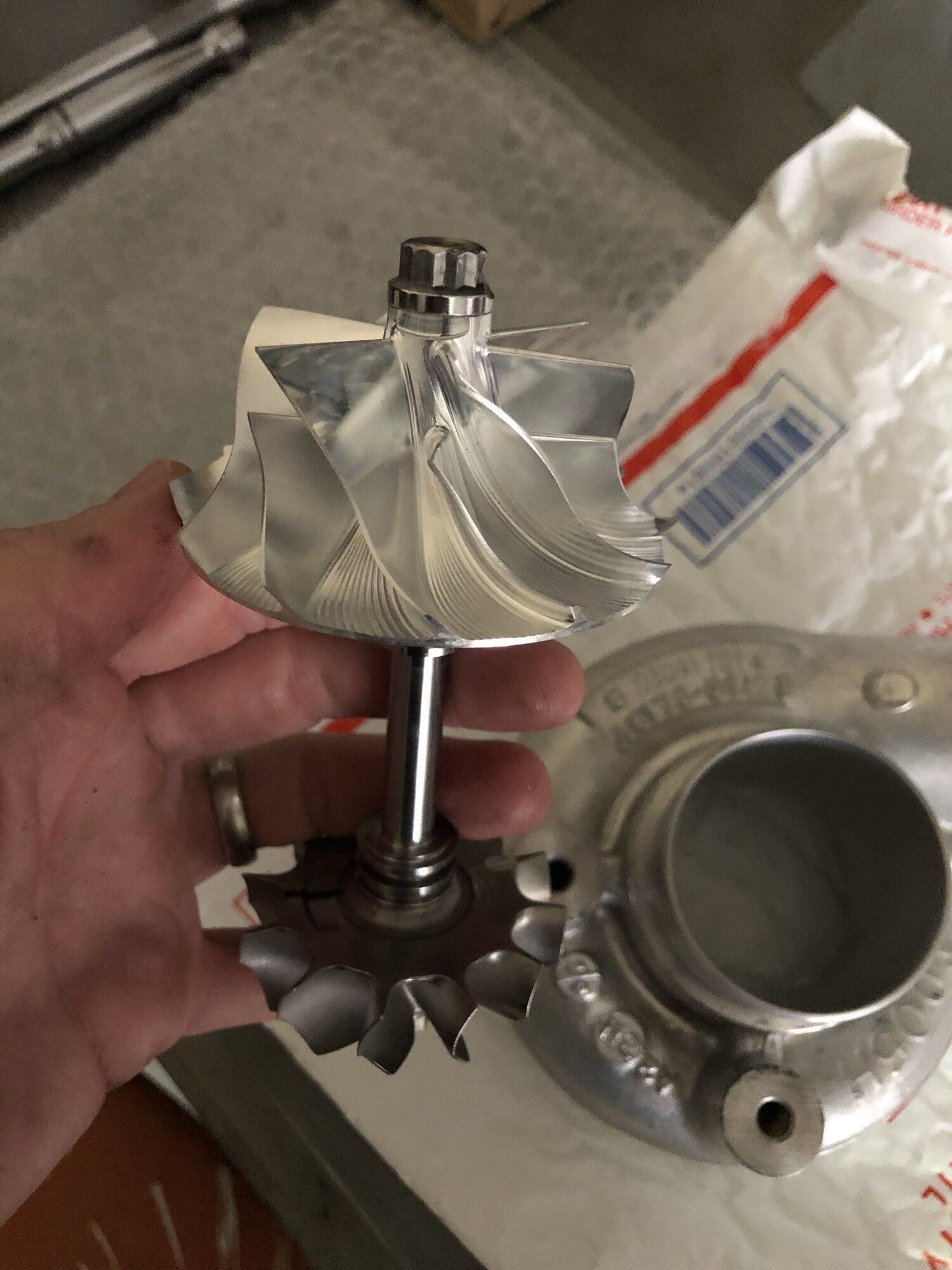

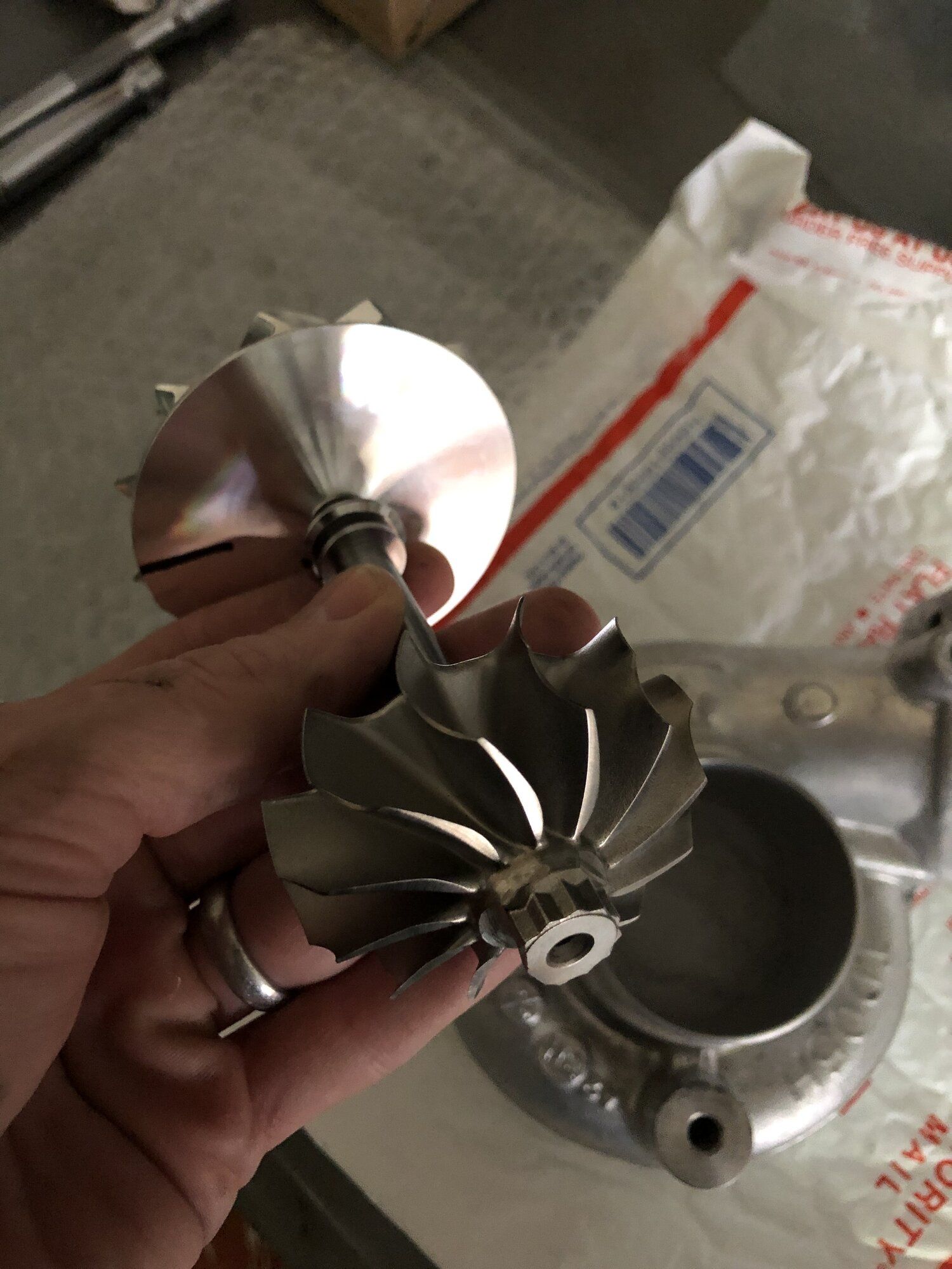

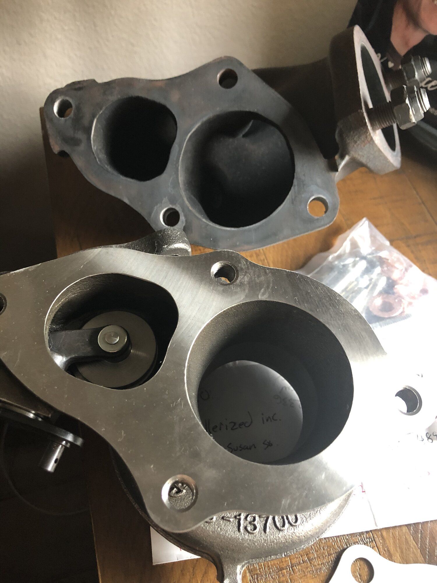

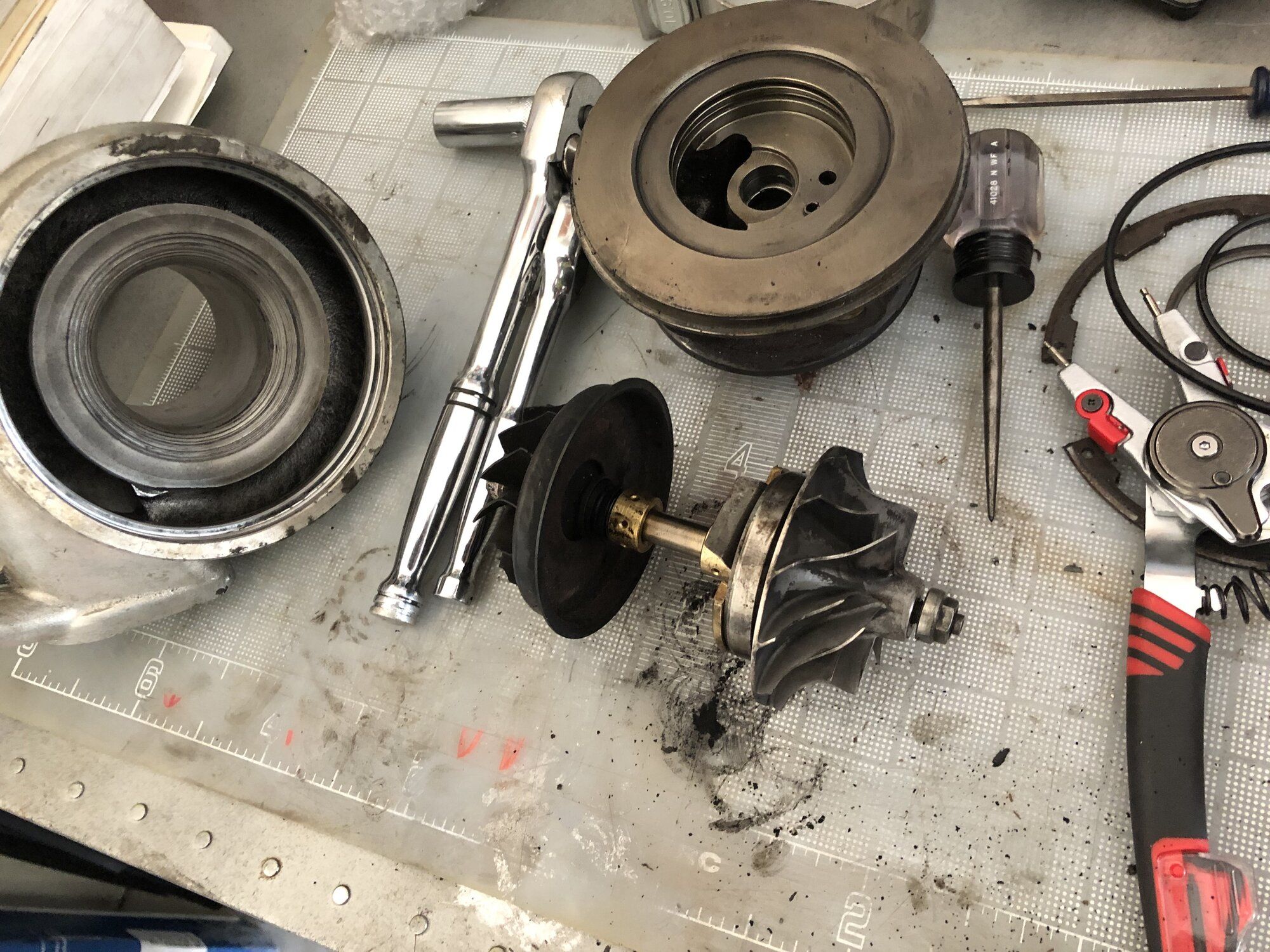

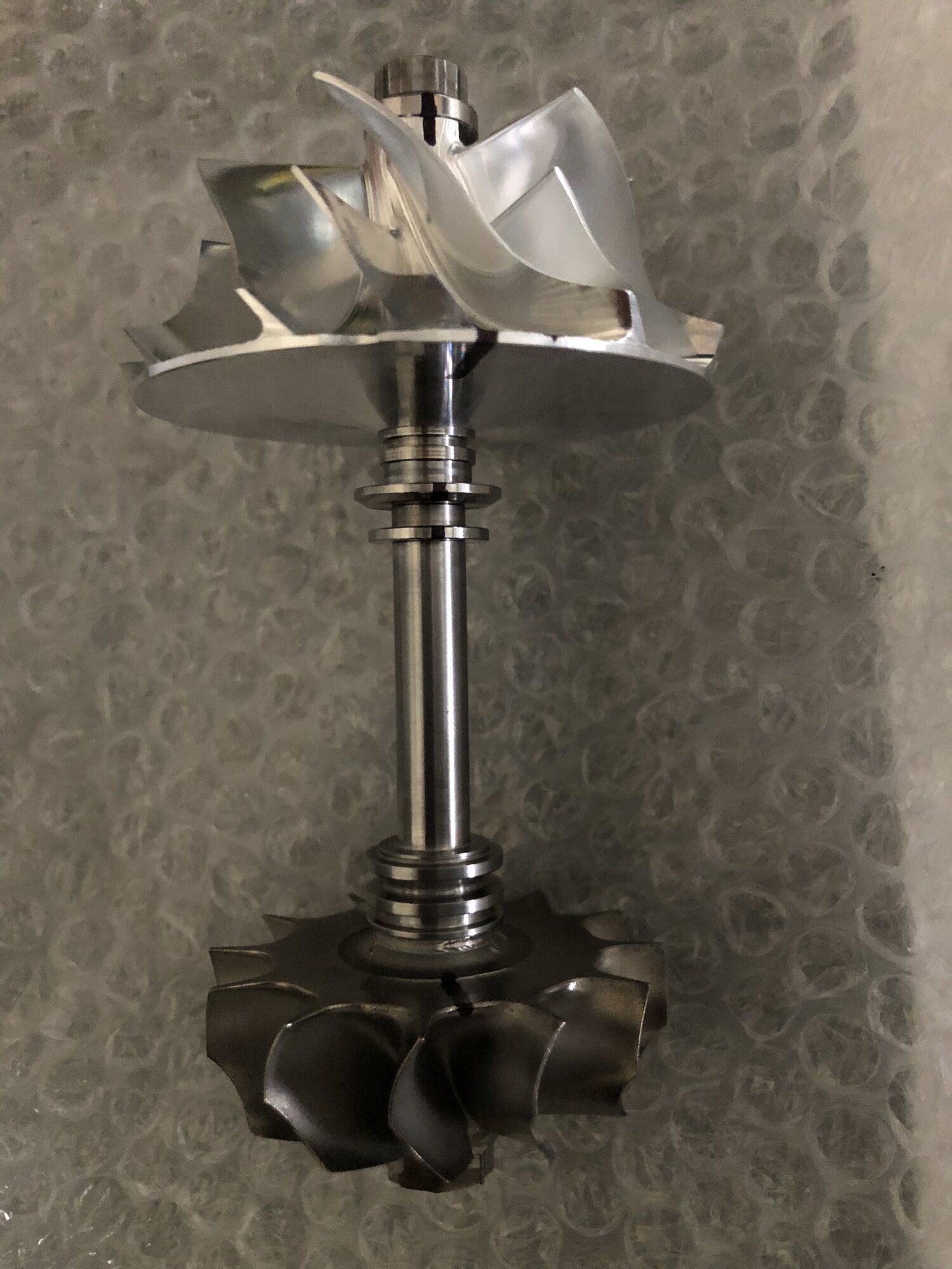

Meanwhile, A TDO5H GVR4 Big16G to tear down, and Woah! Me think this turbo might’ve ate honey comb cereal!
Thats not gonna buff out.
Odly, this compressor wheel is, dare I say .. ok?
The turbine shaft and compressor wheel look salvageable.
Mamba delivered!
E3-02 is a match for the 7cm TD05H turbine housing. 2G-02 will be leaving the setup, and Down-pipe mods will be needed.

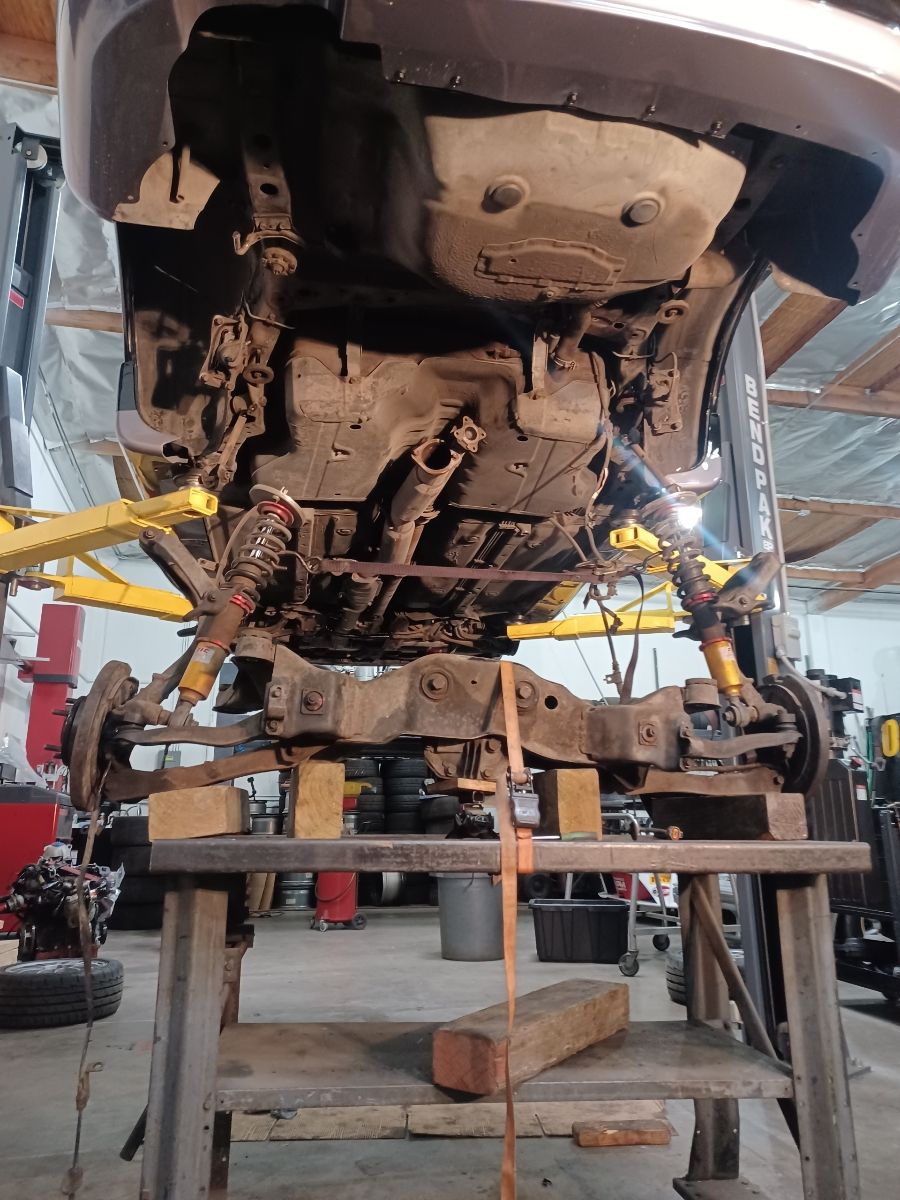

Now I'm in part sourcing hell - trying to decide if new stock parts can be found, reconstructed, or if aftermarket will be less expensive.

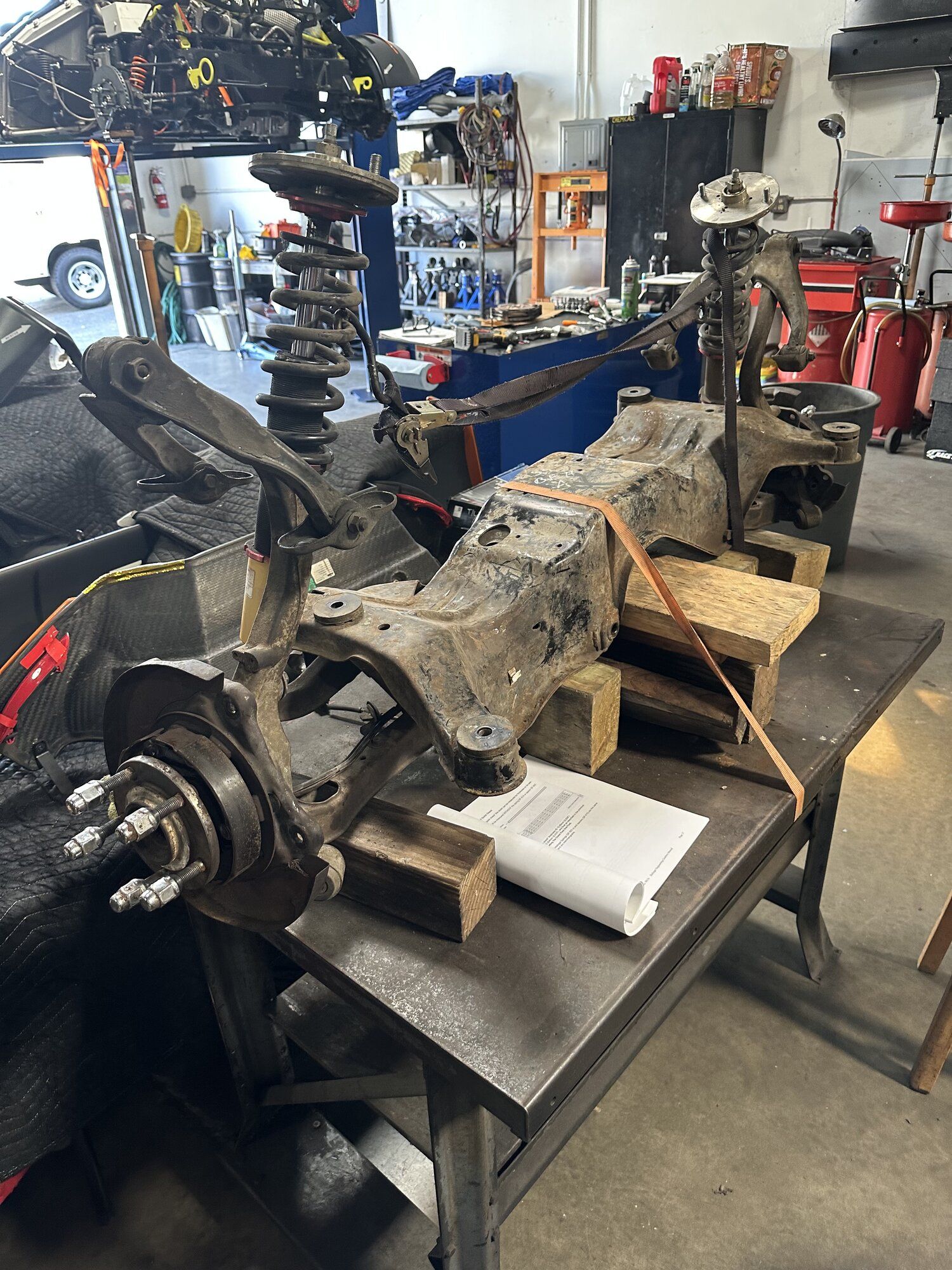

The first big bunch of parts have been ordered for Phase 3:
Not on the list are some items I already had on hand
Front Subframe:
Front lower control arms (left)
Front lower control arms (right)
Compression (curved) control arms (pair)
Front lower control arm hardware (4 arms)
Upper control arm hardware (2 arms)
Outer Tierod Ends (2)
Inner Tierod (2)
Steering Rack Boots (2)
Rear Subframe:
Rear toe arms Rh replace MR162574 with Volk tubular
Rear toe arms Lh replace MR162573 with Volk tubular
Rear Eccentric bolts
Powder coat - Rear lower control arm Rh/Lh - MR131754
Powder coat - Rear trailing arm Rh/Lh - MB914381
Driveshaft:
Carrier bearing f/r - need 2
Carrier bearing mounting bushings
U-Joint spider kit - MB154554 - need 3
OEM Lobro Joint boot kit - MIT-MB505119
Diff - Axels - Hub:
Axel boots (8)

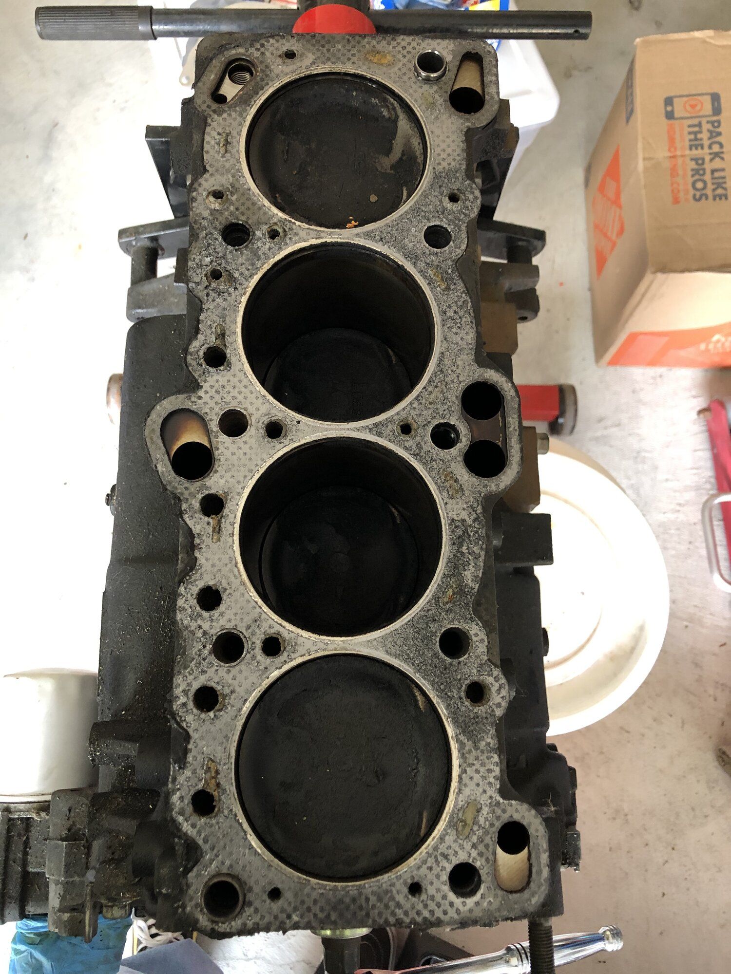

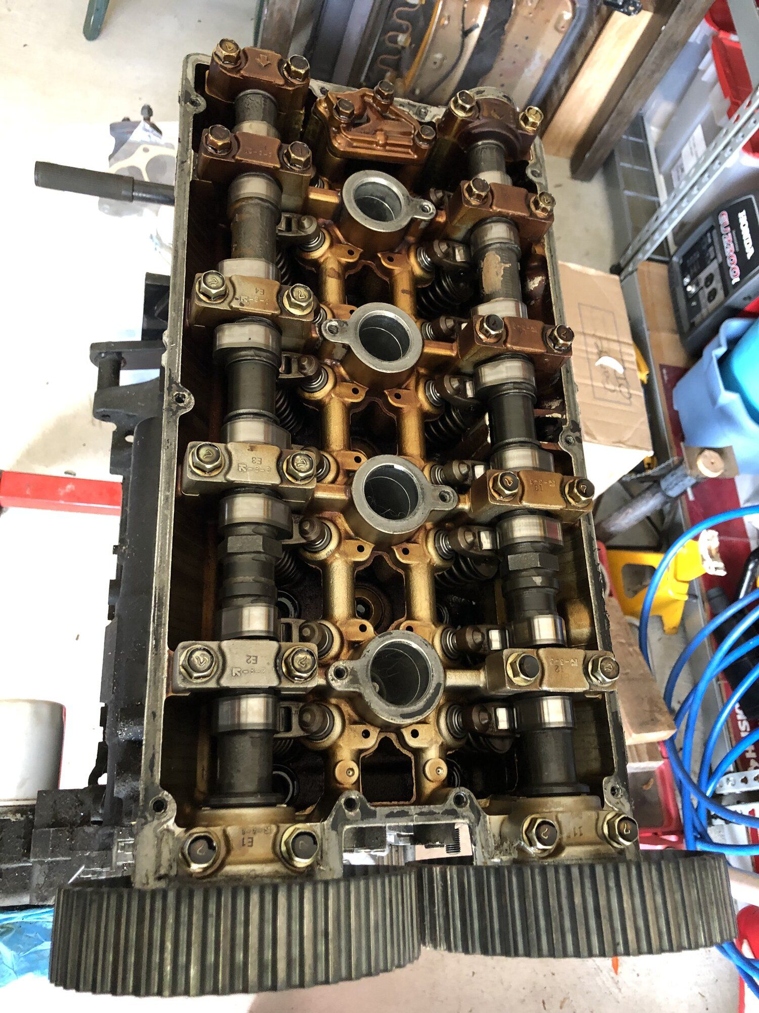

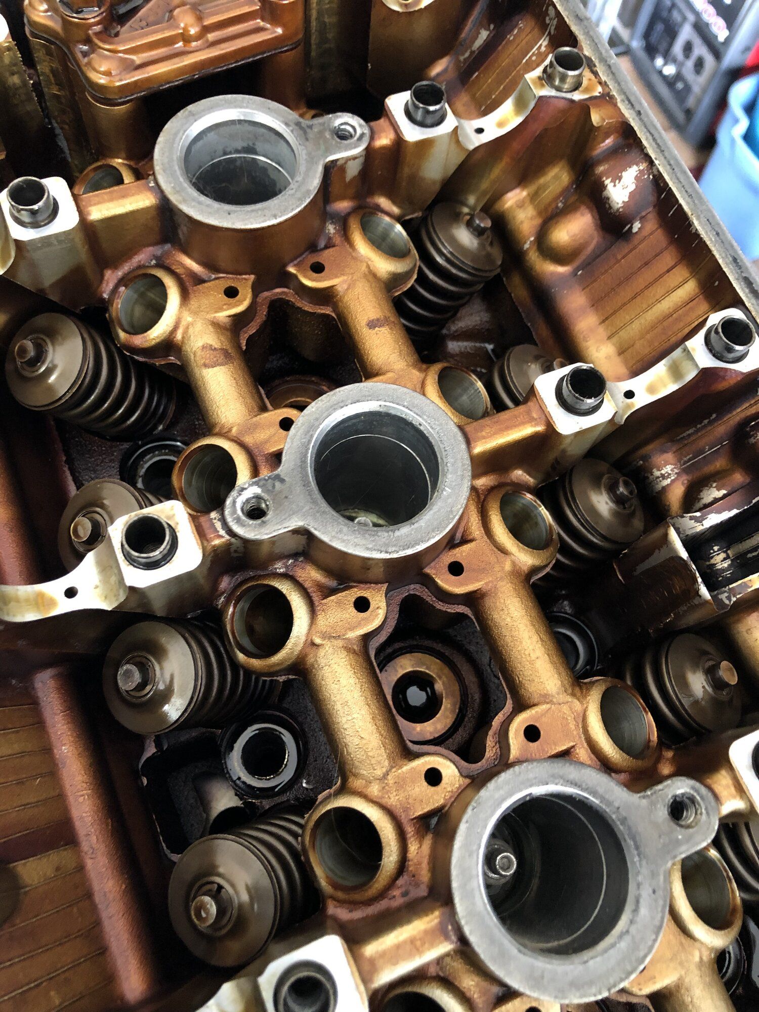

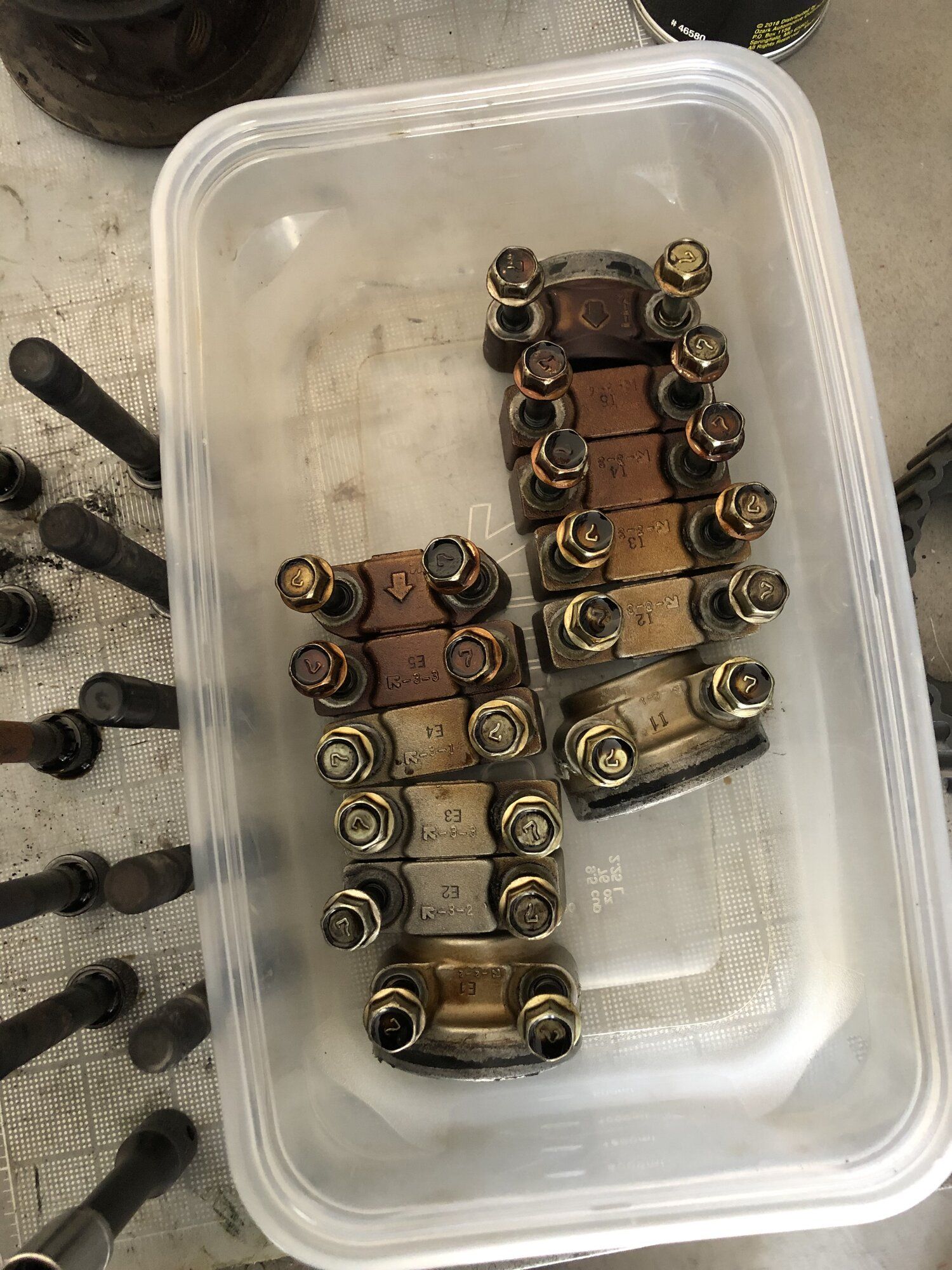

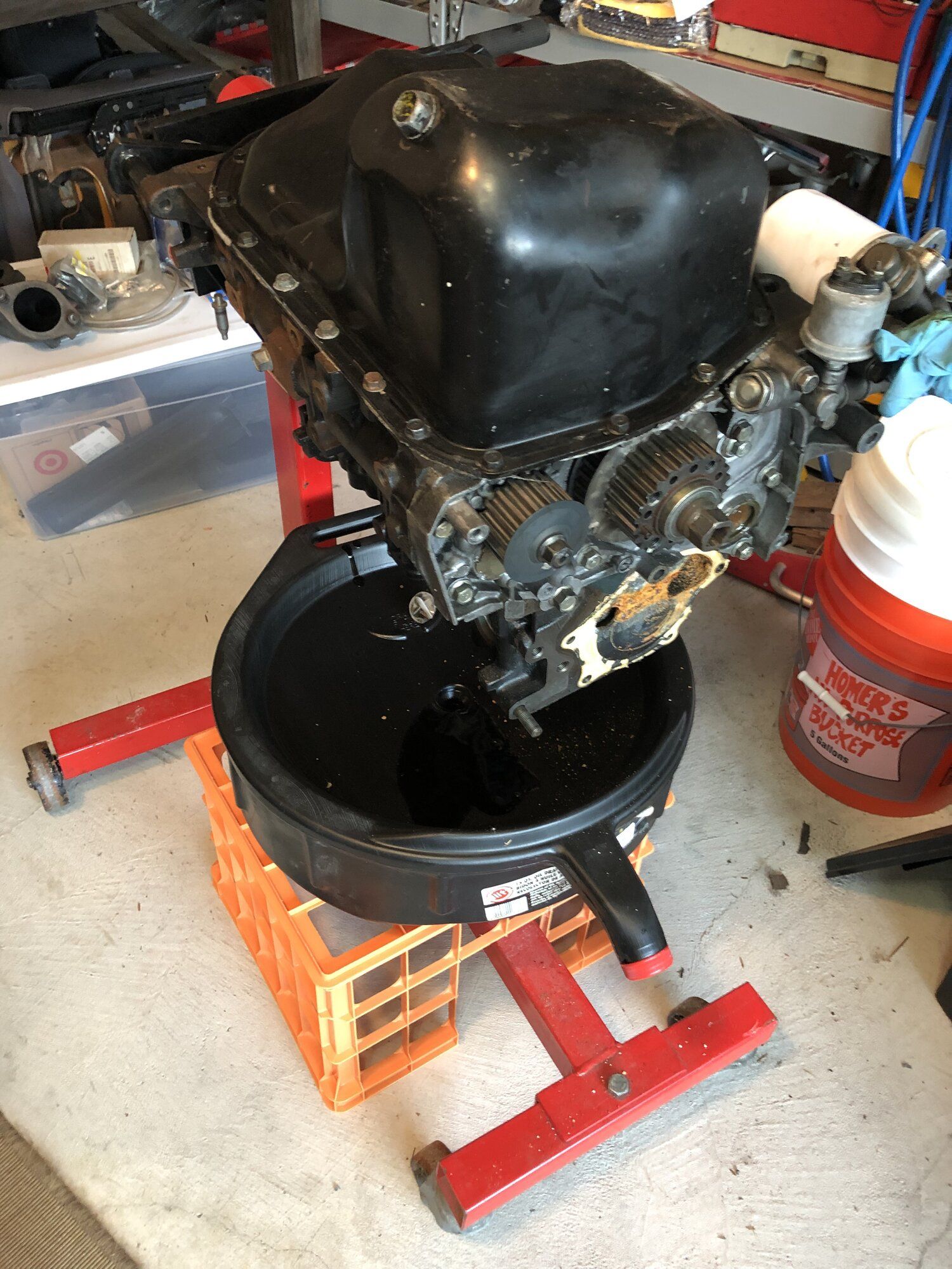

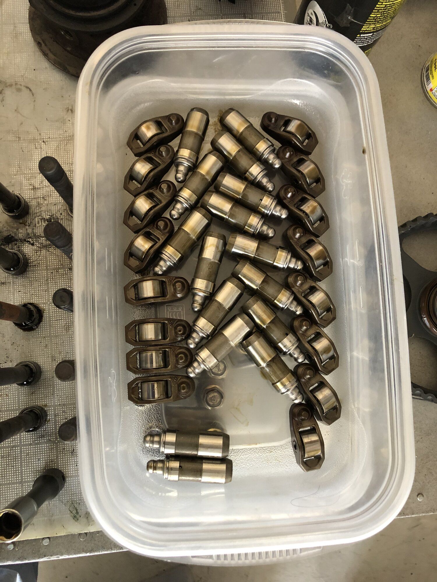

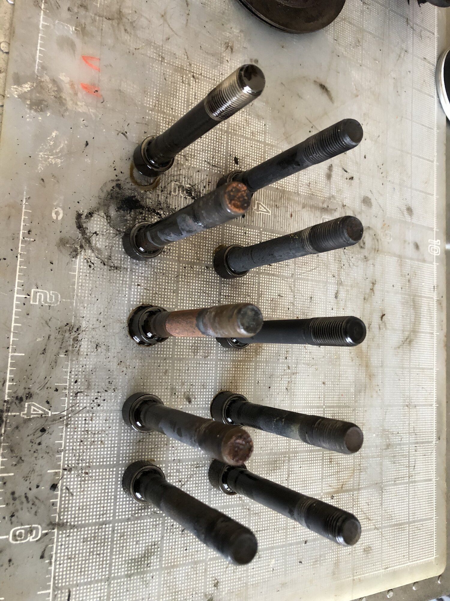

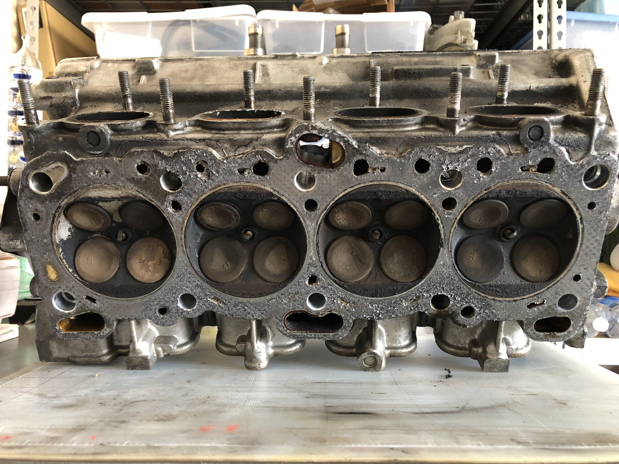

Little time today to lift the head:
D7CAEF14-68A3-4C41-B8B6-1DD0D5BAFB4A.jpeg 59FEEB4B-BE5A-4845-A7BB-FBBA395AC9CD.jpeg
25F31629-4376-4F63-B2F7-AEC193A07009.jpeg 20BC411E-192E-4351-9E6C-28B9C636B239.jpeg

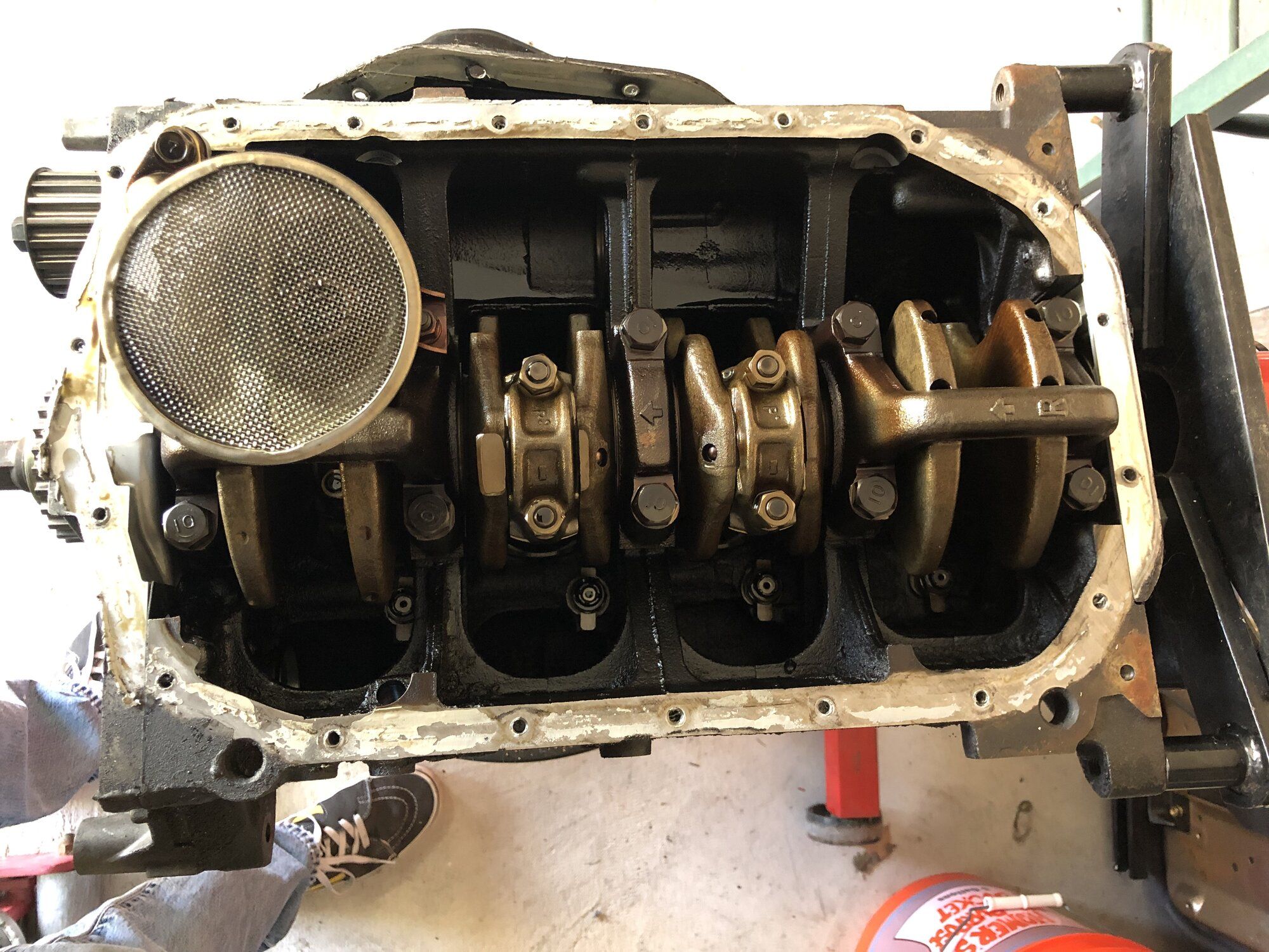

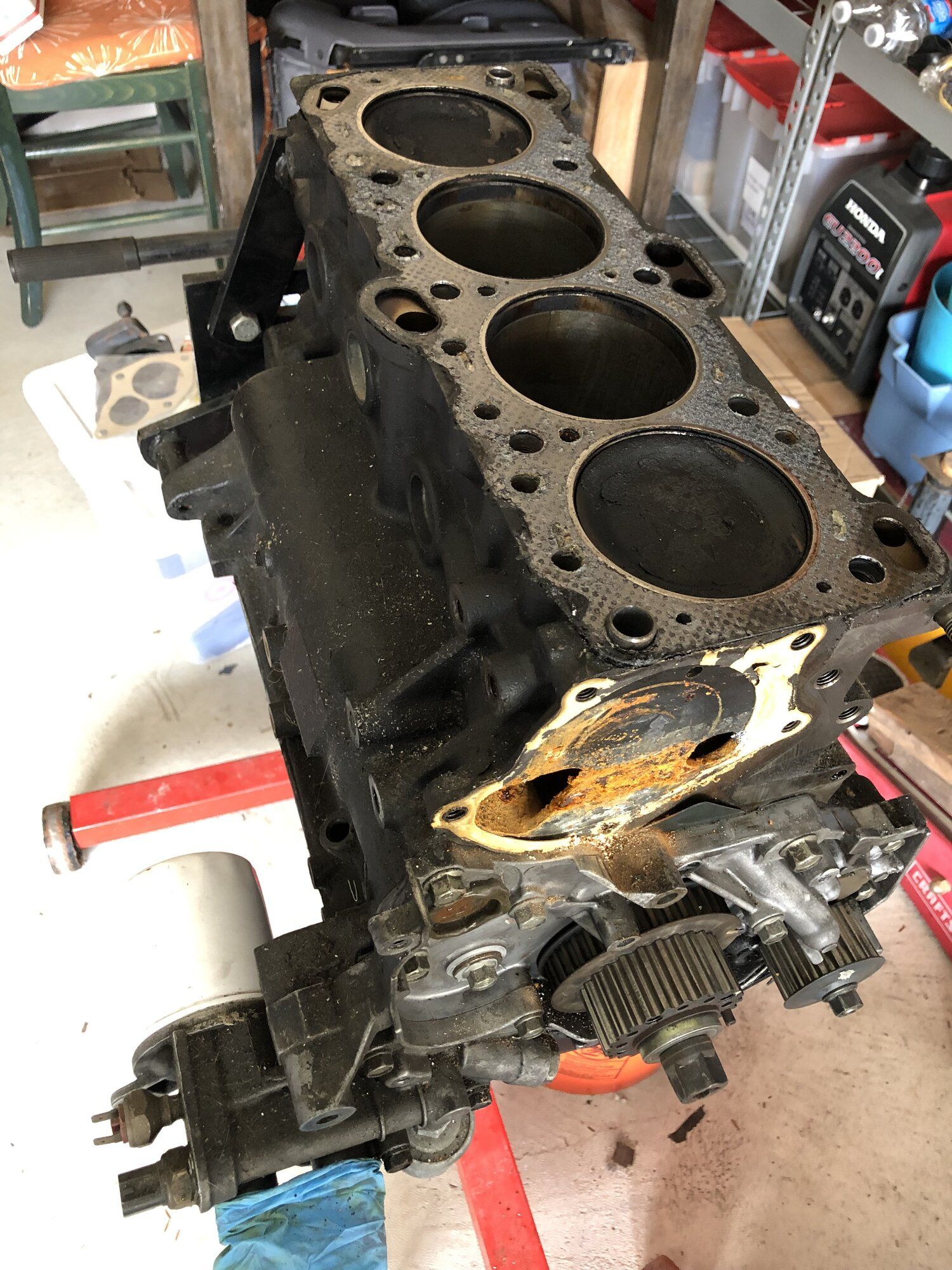

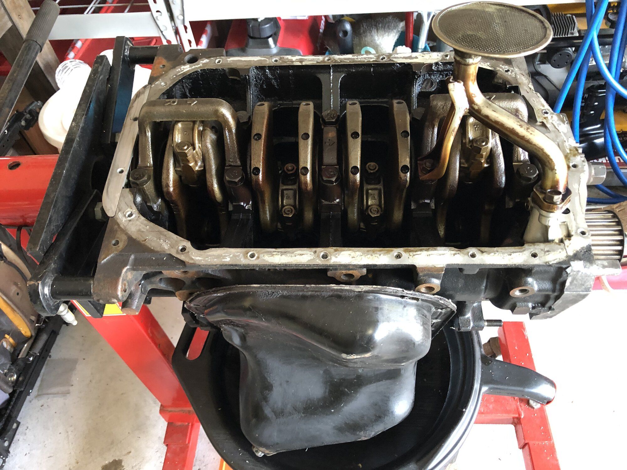

Some pictures you can smell - some of you know what I mean. This engine has been sitting 10+ years after I removed it. At the time it was using coolant. When you break the bolts loose, there is an unmistakable bouquet of toasted oil.
Fiber Head gasket:
This will clean up well:
Short block:
