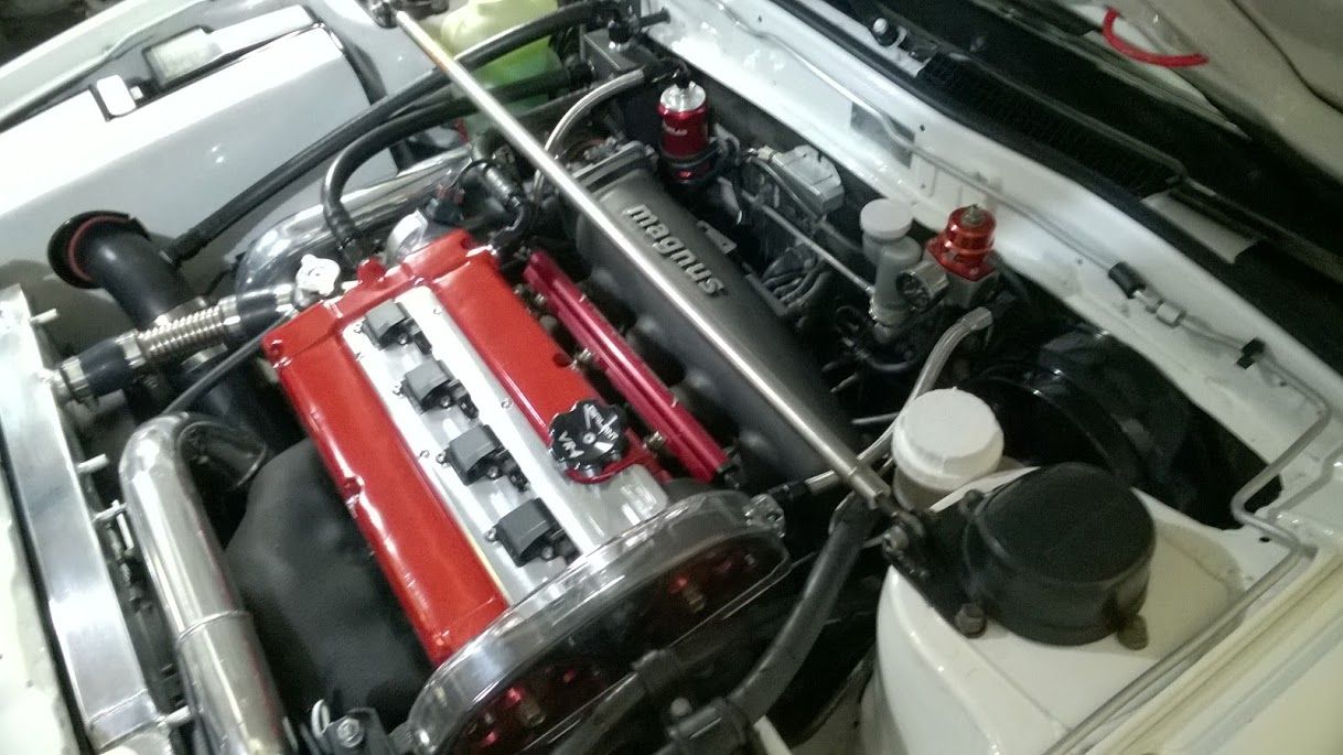

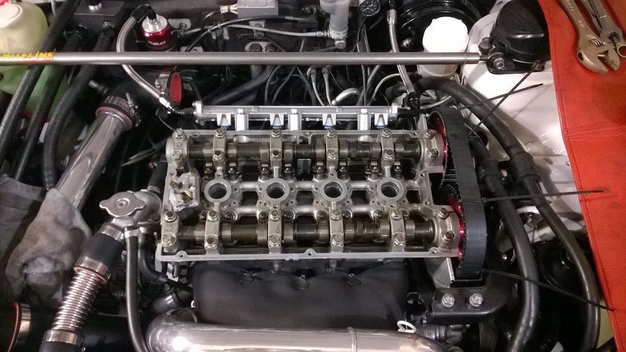

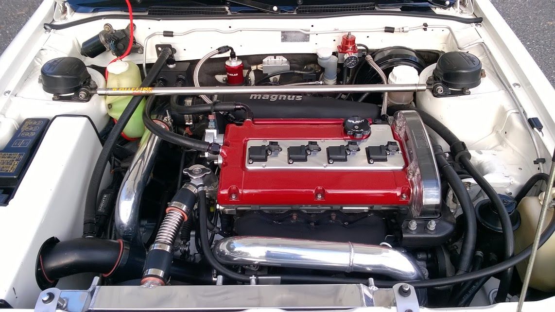

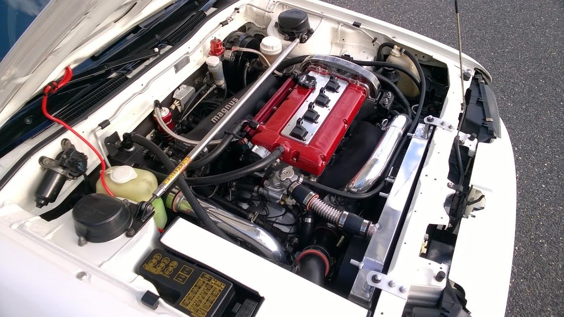

I got some wrenching done on the car recently. Started with an in-car cam swap. I'm on a HKS 264/272 combo now.
lqj_lu9D3AJ5y9BziU4lqB75Kb7z1LGi4R6RKttibl9IqU5wejXiFmZiwHUg_9Lexq7CZOUHSt7HYtLwsw=w1218-h685-no.jpg

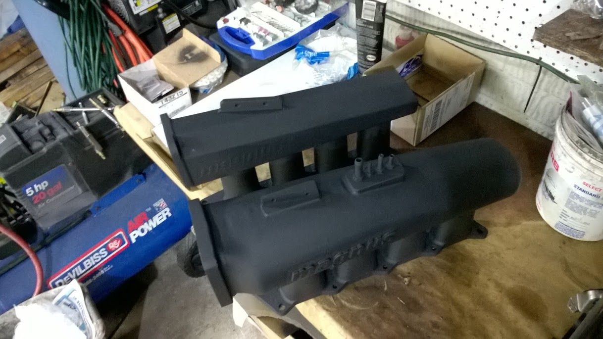

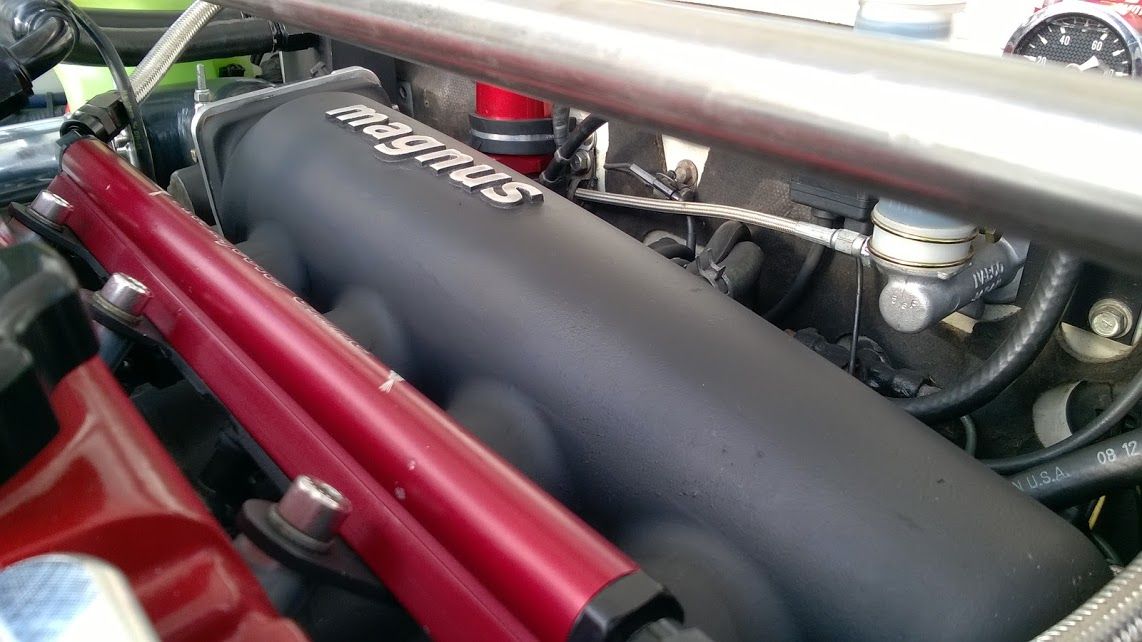

Out with the Magnus SMIM and in with the Magnus V3.
AlKOEXvlEeAttYTUPLTgrgY8NdulHq8IKlXpfPMiU4Hh9iZ_xKgaKcDaPKWAP_M3QA3cEpqTZiQvQudVaQ=w1218-h685-no.jpg
After plenty of ass pain I finally got the V3 to fit. The thing is absolutely huge. I had to relocate my fuel filter because it was too close to the throttle body. As a result, my fuel lines no longer fit, so I've got new ones on order. Once those come in, I should be up and running again.
rxX3vjLLdFfVXKi1fjVauH2g0bdKBKVNzd8IkZ6hmh0mK7_X1FPrzs5XlX766CGcF-2e-eqxlIGbIvO1zA=w1218-h685-no.jpg

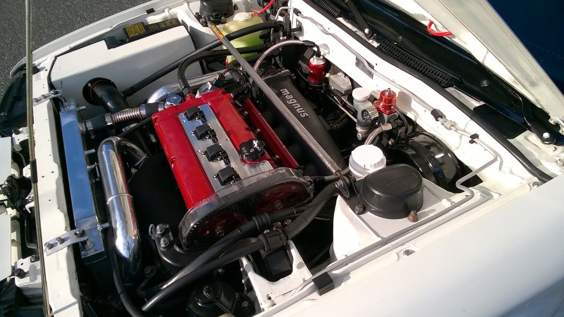

Alright, got the fuel line situation worked out, and relocated the filter. Used the handy-dandy ECMlink fuel pump activation feature to check for leaks and verify base fuel pressure, and was all good there.
Then, I slapped the boost leak tester on and checked for leaks. Fixed a leak at the J-pipe flange, and the BISS O-ring, but after that the car held 30psi solid.
I hit the key and the car fired right up. After it was warm, I made a few adjustments to the BISS and got it idling nice and smooth. I took it out for a drive and it ran just as smooth. There's no loss in low end torque that I can tell, and the top end has obviously improved greatly. With the addition of cams (I was on stockers before) in conjunction with the V3, it's hard to tell exactly how each part is improving top end. However, it's clear the car is much more potent near redline, whereas it seemed to fall off previously.
I need to make some minor adjustments to the tune, but overall the car still runs awesome. The fall weather here has been awesome as well, and driving the Galant around in it is great. Here's few pics I took while out test driving around today:

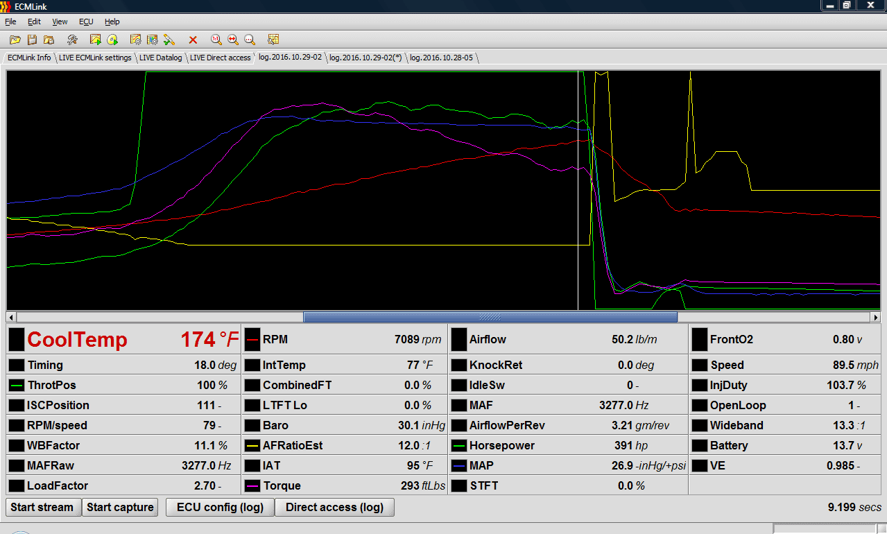

Well, I finally made the jump and swapped the tune to speed density. I've got the car dialed in great at idle and cruise.
I have some work to do at WOT still, though. I'm running out of injector on the top end, so until I can upgrade I'm going to hold out on completely dialing in the car. For now, I just turned the boost down on the top end to avoid leaning the car out. Even on low boost it runs awesome, though. I feel like it runs much better than it did on the MAF.
In the mean time, I'll be on the lookout for a set of FIC 1650 High-Z injectors to get the fuel system back up to par.

Thanks for posting that log. I see 13.3 : 1 A/F from the wideband. Do you think it is really running that lean? Do you have a gauge on your LC-1? If so, do your ECMLink log values for A/F agree with what you see on the gauge?
I am just starting to log with ECMLink and an AEM UEGO gauge wideband (the 30-4110, not the new one) and my logged values for A/F are way off from what I see on the gauge. The values on the gauge look right. The logged values at the same instant look way high (lean). This is with E60 in the tank. Always before I had used an Innovate LC-1 logged by an ECU Plus, and the logged values for A/F seemed very accurate, but that was always with straight pump gas in the tank (E10).
I see that the ECMtuning wiki about widebands has nothing good to say about the AEM wideband and they like the LC-1. So I am wondering, what the heck is going on.
@We're on Boost
Yes, my car is actually running about a point leaner than my target AFR (12.0:1 on E85). I'm running out of fuel on the top end due to undersized injectors, so I need to address the fuel shortage to correct the lean AFRs.
I don't run an AFR gauge, as I think they are pointless for the most part. My WBO2 is just wired into ECMlink. I look at it when I dial in the tune, and that's it.
Regarding the AEM gauge, you're at least the 20th person who's directly asked me that question (@19gsx91 comes to mind as well). The AEM WBO2 reading richer than what ECMlink actually logs is a common problem, which is exactly why ECMlink recommends to run the Innovate unit. There are members here who have successfully dialed in the AEM unit and got it to work, but I always tell people to just ditch the AEM and just get an Innovate setup. They are much easier to use with ECMlink. You can find an old LC-1 dirt cheap, and they work flawlessly.
I still have my LC-1. ER cut the wires and took it off my car, said they wanted an AEM with a gauge in the cabin for dyno tuning. They don’t like the LC-1 because “they go out of calibration”! LOL. I argued with Myles about it a little, because I had heard stuff like you are talking about, plus I know that the AEM is slow responding (laggy) and that is supposedly something they improved with the new “X” series. But I let them do it their way because I figured if there was a blow-up on the dyno, I want it to be all their fault LOL, not mine!
I also still have my ECU Plus. Now that was never much of a tuning device – very limited on that. But it is a very nice logger. That guy, Tom Collins, is probably just about the smartest programmer/electronics person who has ever been in the auto aftermarket. He didn’t have time for it though, and there was really no money in it at that small a scale. He told me that he did his ECU+ work late at night while his wife and kids were in bed sleeping (it was not his day job). Holy cow.
Anyway, he had the widebands figured out to a T, I think. The wideband section in his manual has a short and to the point summary for 9 different widebands. In there he says the AEM uses non-linear scaling, and the LC-1 uses linear scaling. So that is one possible snafu if the logger doesn’t grok non-linear. Another possibility – input impedance. I asked Tom Collins what the input impedance is on his inputs and he told me it’s about 1 million ohms. That’s fairly high which is good. The rest of the circuit won’t even know that thing is there. It will have no effect on the rest of the circuit. That’s what you want in a logger, or anything like a multi-meter or any measuring device.
I don’t know what the input impedance is on DSMlink. I’ve never looked into it or asked. It might be OK, or not. It might be something that is determined by some OEM components on the board that Tom Dorris has no control over with his chip. I suppose finding that out is on my to do list, somewhere way down the list.
My original idea was like yours, LC-1 to the logger, no gauge for it, because I’m not looking at gauges during a pull. Obviously I’m busy trying to keep the car on the road! But now that I have a gauge there I kind of like having it. So I’m going to work this a little more before I give up on the AEM. First I’ll probably wire my ECU+ back in (ER cut all the wires! They could have just unplugged it but they cut all the wires!!!) and use its preconfigured input for that exact wideband, then try to determine if it is accurate.
I will be interested in seeing a log of yours with the A/F curve shown (not hidden) to see what it does through the rev range of a pull. Oh wait the log window doesn’t have scale numbers. Arggg! If you want to see what ER came up with for an A/F curve on my car, I show it in a WinPep7 log in my photos, with a window scale for each curve. They said it came from a different sensor that is hooked up to their dynojet, not the AEM wideband. LOL. To me even 12.0 sounds a little high. When I asked them why their tune was so lean, as I remember, they told me that the A/F numbers they get on their dyno rig are about 5 tenths higher (half a point) than what is probably real. What Lucas told me is “the tune is set for 11.0-11.5 under power”. Lucas is a great guy and I can see why his shop has a good rep.
It's funny you mention this, I was actually thinking about it the other day, my MTX-L is farther off at WOT then my AEM gauge was, granted I haven't made any adjustments with logworks (no cable and I'm cheap) but I actually kind of miss my AEM UEGO setup. I don't notice a difference at all in any lag time between them and if I ever had to remove my pillar pod for any reasons the AEM setup was a lot easier to manage LOL. It all unplugged from the back of the gauge. How are the cams now that you have them in? I know you switched the intake and the cams at the same time, I'm willing to bet your gains were pretty significant. Where do you redline?
The new AEM wideband controller is supposed to be very fast (according to AEM). That is the 30-0300 model.
I don't think the slight lag time of the old one is any big deal unless you are trying to use the self-tuning feature, like on a Vipec, or the series 1 AEM EMS. I don't know if the series 2 EMS even offers the self-tuning feature.
I wonder though if the lag time would be a problem if you are using narrow band simulation from your wideband, instead of an actual narrowband sensor. The OEM narrow band sensors are very fast.

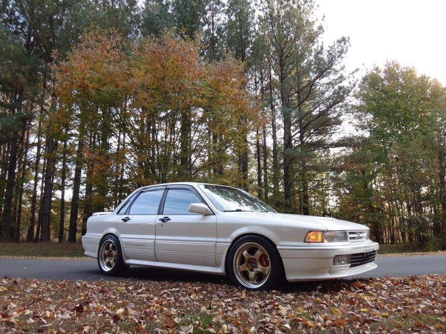

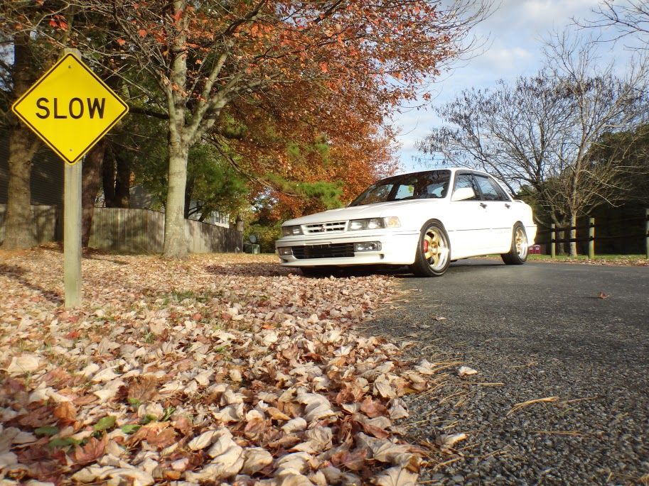

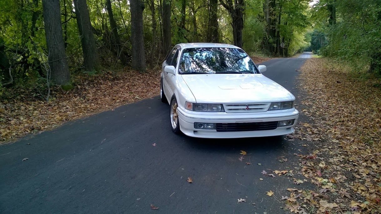

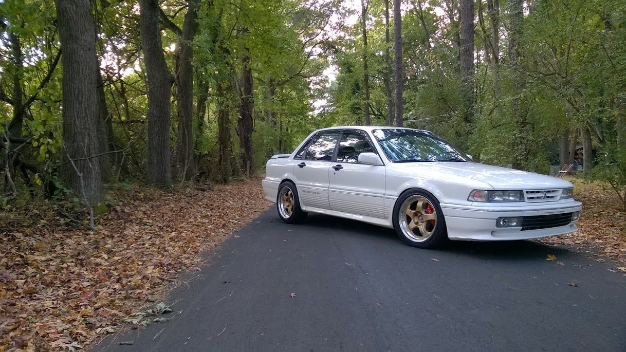

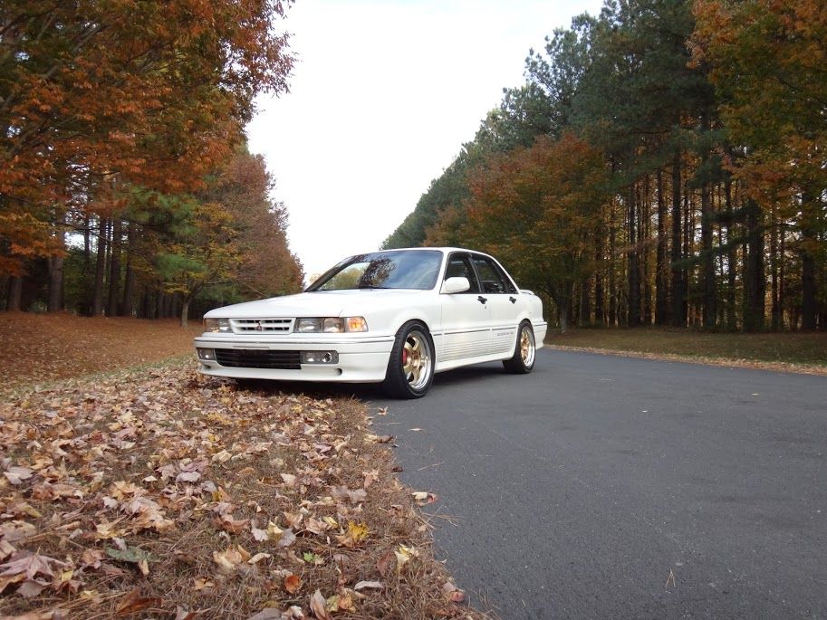

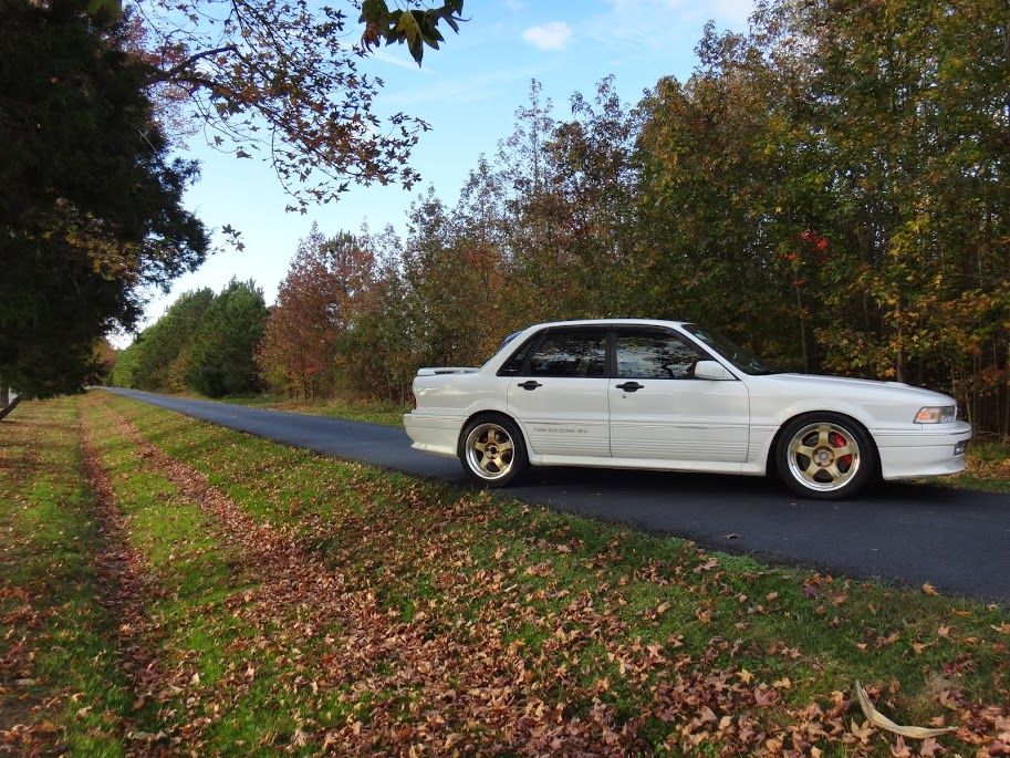

FIC 1650 High-Z injectors are on the way. Took the old girl out and got some nice Fall pics. MD is pretty sweet around Autumn time.

Love the "Slow" sign. Is that your private test strip there? It is really pretty.
Nah, somebody's private road who's way richer than me. It's a really nice area.

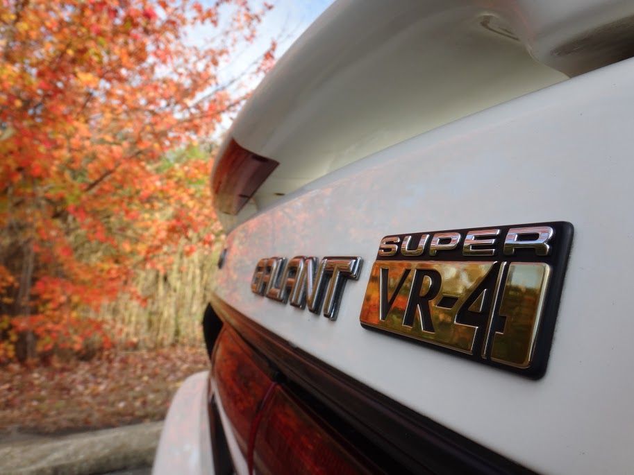

Any idea on where to get a vr-4 badge for the trunk? Searched hi and low but no luck :coy:
You know the first 8 pages of this build thread were cool and everything but now your car pisses me off with how perfect it is!!! J/K LOL
I even stumbled upon you SOLD blue vr4 on the galant forums... you certainly make a mean vr4 :thumb:
Lol. Well, 1837 was certainly no cupcake when I got it. It took time, money, and work to get her to where she is now, that's for sure.
1813 was my first Galant, and a complete ass pain. I learned a lot building that car, but eventually had to part ways with it: http://www.galantvr4.org/ubbthreads...e=&olderval=&oldertype=&bodyprev=#Post1133548
As far as the badge goes, put a WTB ad up on the .Org and see if anyone has one. That's probably your best bet.
