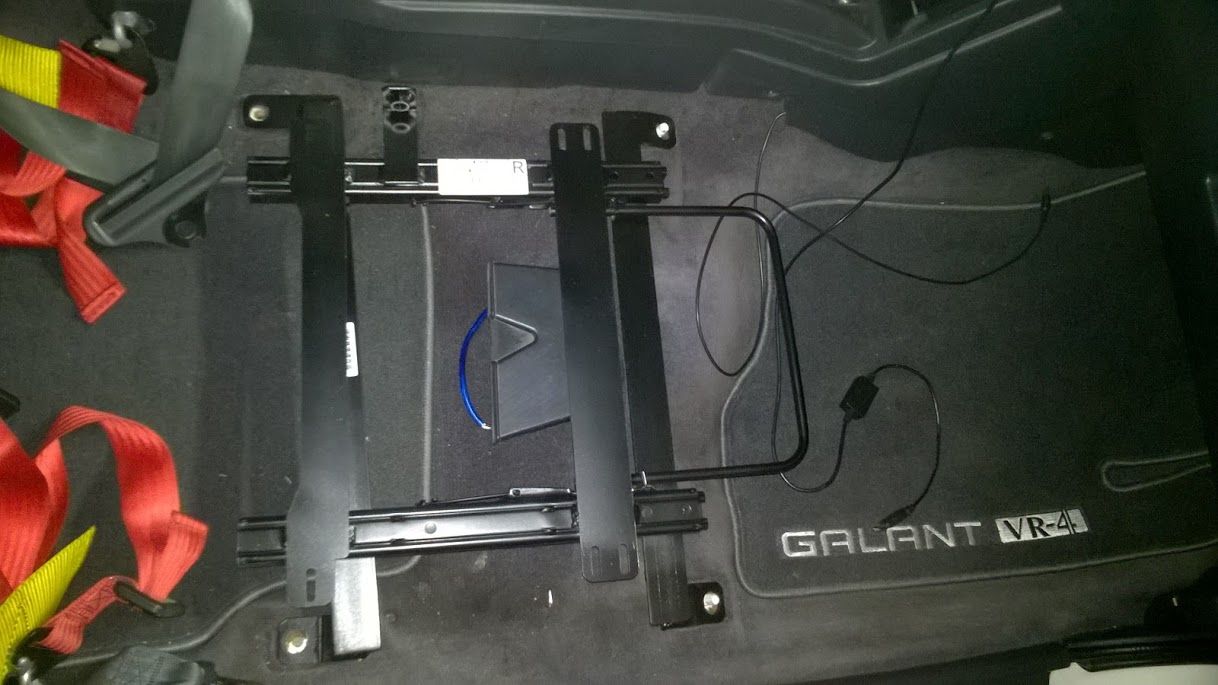

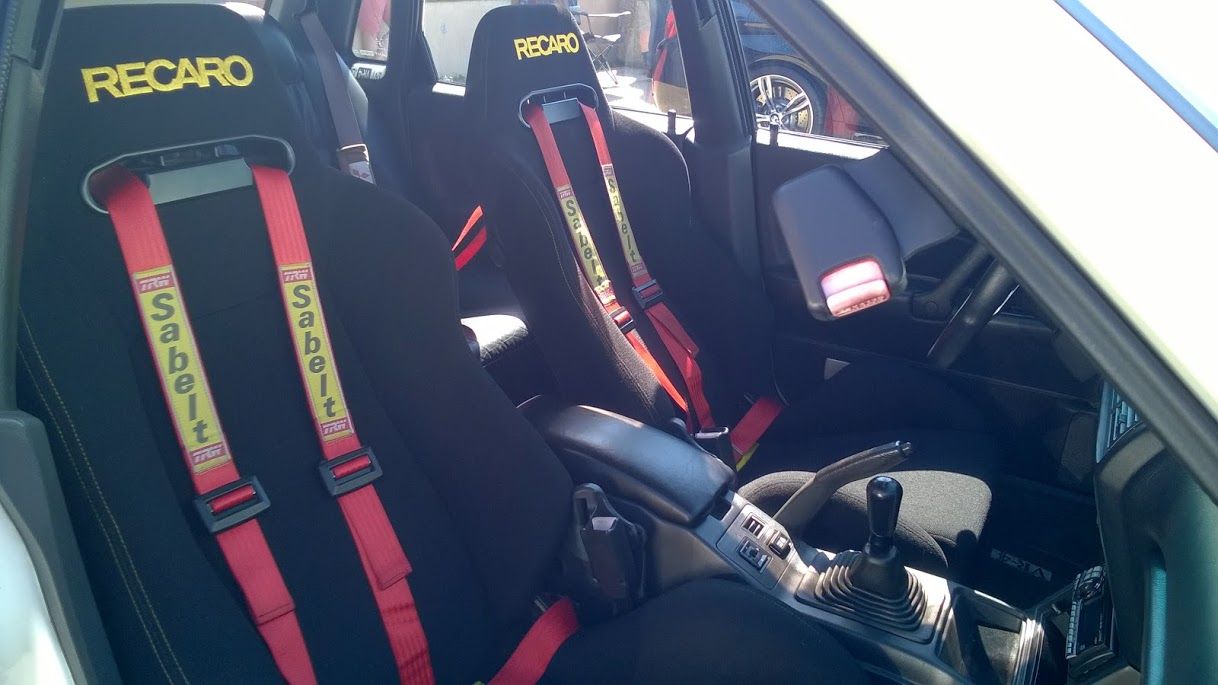

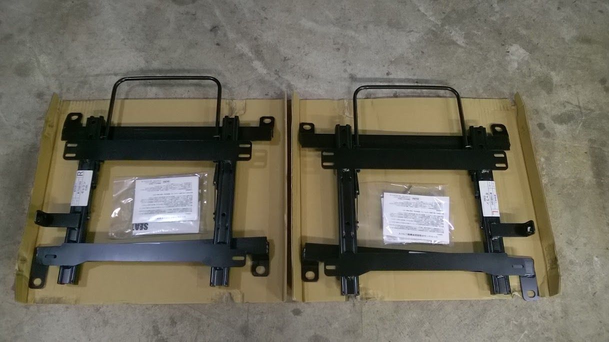

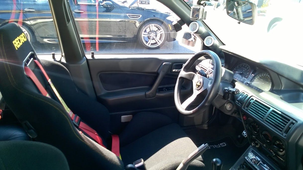

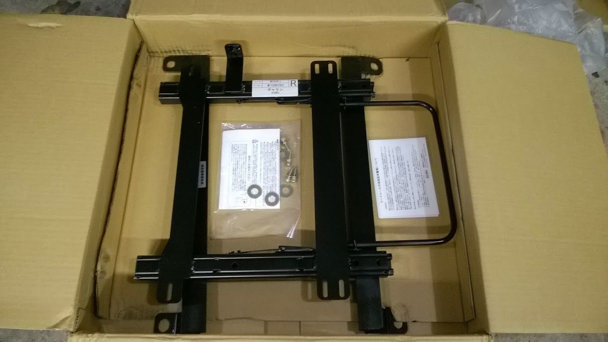

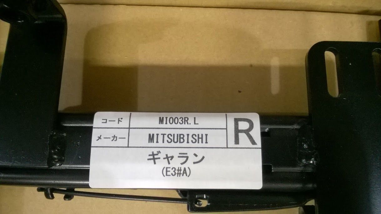

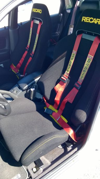

I recently added a pair of Recaro SRD buckets. I ordered sliders from Japan, and they work and fit awesome. They basically make the Recaro seats plug and play, and you can even retain the stock seat belts if your prefer to. I opted to go that route, since my Sabelt harnesses are out of date, and alone probably wouldn't pass tech at most tracks.
The brackets are made to order, and it probably took almost a month to get them:

Installed:
4j3xAt4aOD0rqf1IUnCIpqnYf3FlrsMttHd4C89fNCgshZcpOt1enuDZsK0QtjCDHcc_vQga_lrWFx3u0tS=w386-h685-no.jpg
gNz4H-kBNAlHEC1lj51GrCCQ7ox4UMN_HRISZJ_n2SoMTQvLU_eIFQJ5XCmVGycO2jsFjQb2uNO9x4HeGy=w1218-h685-no.jpg
N6fndooPO4AgpW-1YjHexNQmXOrICGaHSFe7ub_3q6i7YjhhGp5_obwfiIdpgHnn9A2SFY_Lr18QDntzll=w1218-h685-no.jpg
To sum it up, the new seats are awesome. I saved about 10 lbs per side compared to the stockers. The thing that's probably most noticeable about them is how much lower they locate the driving position. I'd guess you probably gain 2-4 inches of headroom with these seats. You definitely sit significantly lower in the car.
Of course, they feel and look great too, and are probably one of the nicest creature comforts I've ever added to the car.

The new Recaros are awesome. When I first installed them, I was worried about how comfortable they would be. For starters, the seat cushion is narrow, and your legs are locked into the driving position. The ride height is also significantly lower, and you're literally sitting on the floor in these compare to the stock buckets. Once I drove the car around a bit, I got used to both, but I was still on the fence about how 7 hours in the Recaros would feel. I can confidently say these are the most comfortable seats I've ever driven in. After 7 hours, my ass felt just a good as it did when I first got in the car...No bullshit.

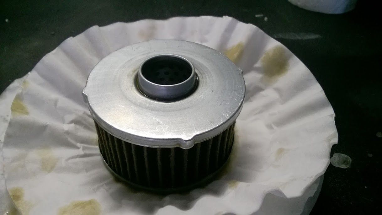

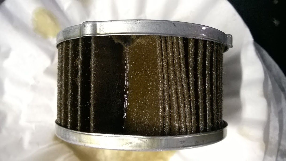

After I got the car home I gave it a good wash, and figured I'd change the oil. It was far before it was due, but I wanted to pull the filter and chop it open to inspect after the long drive. Zero metal, and really zero contaminates overall. The filter element was spotless:

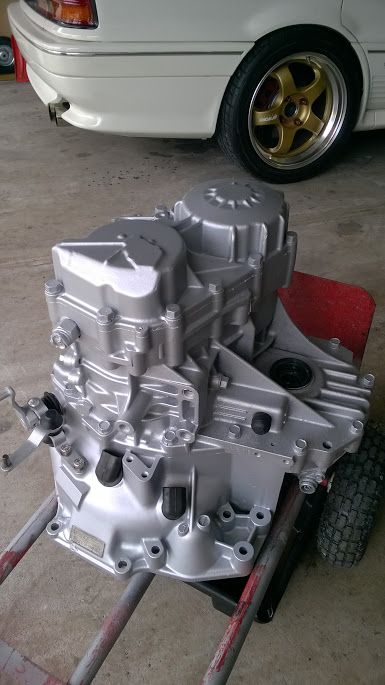

Picked up a Stage 2 Shep trans at MOD. A good trans was the last thing the build was really lacking, so I'm excited to get this in for next season.

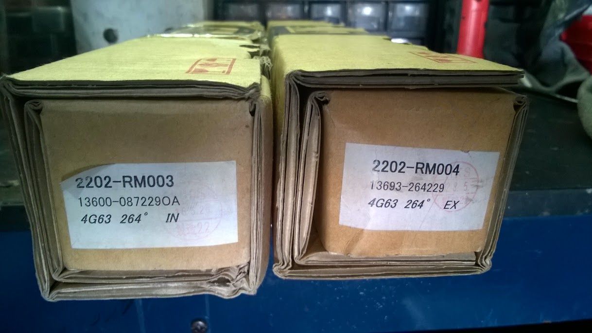

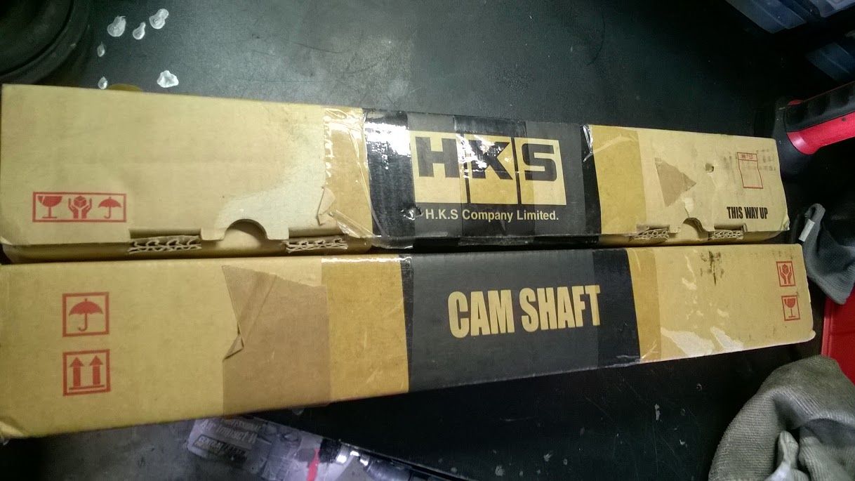

The stock cams will be coming out and I've got a set of HKS cams going in. I've got 264 and a 272 exhaust cams, so not sure if I'll go straight 264's or do the 264/272 combo.

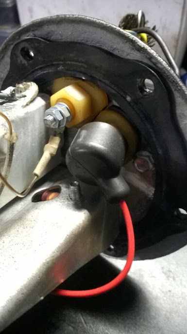

I have a little question about what the home grown terminals are in this post below. Do you mean the small bolt and nut that go through the top plate of the pump hanger? Yours looks shiny and new, usually they are pretty rusty ....
I was pretty happy to see my home grown terminals on the pump hanger holding up great!
All the details are in the link. Scroll down until you get to the part about the fuel pump hanger: http://www.galantvr4.org/ubbthreads...00&page=0&view=collapsed&sb=5&o=&fpart=7&vc=1

Oh that's good, what you did with the fuel pump hanger. Wow that thing was so rusty I'm surprised there was any metal left underneath. Anyway when I looked at mine, I was afraid that replacing the electrical terminals would become a major project and I see it was. Having grown up in the rust belt, I have a great appreciation for things like stainless steel, nylon, anti-seize compound, etc.

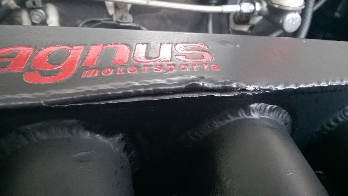

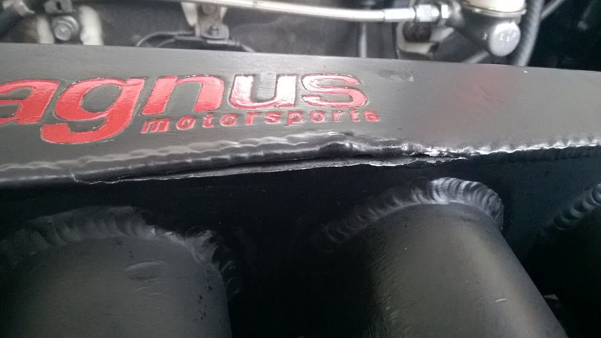

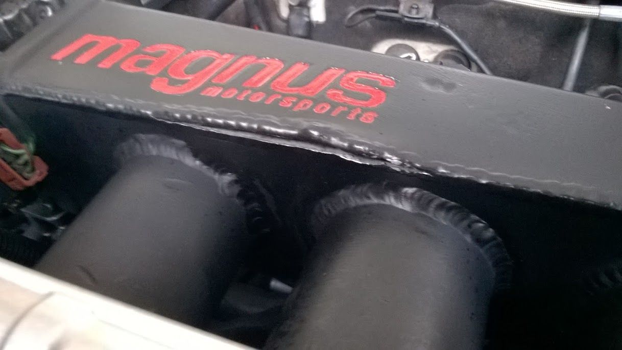

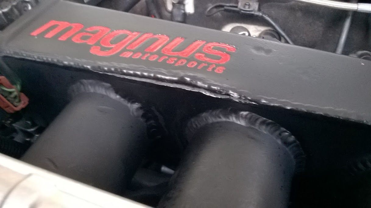

That time I blew the welds on the intake...
iRdv9k6kxZ0AsdcsoER0zJBSrpj7138bxypjACUpNf4hjEna4_j_z0iSTbKdAAmngbyMksA89bBzYWBdpQ=w1218-h685-no.jpg
9Ti-K4yHFyucaig2_hxToL1lqHs_9F1f1WMraVGuaIg8NaprTYNu_xCaaXXqHn0DF-tGC5aetbq6p3SA1g=w1218-h685-no.jpg
Holy cow! How much boost were u running??
Right around 30 PSI. I mashed the gas in 5th coming off the Chesapeake Bay Bridge and BOOM! Shit sounded like a bomb went off under the hood LOL

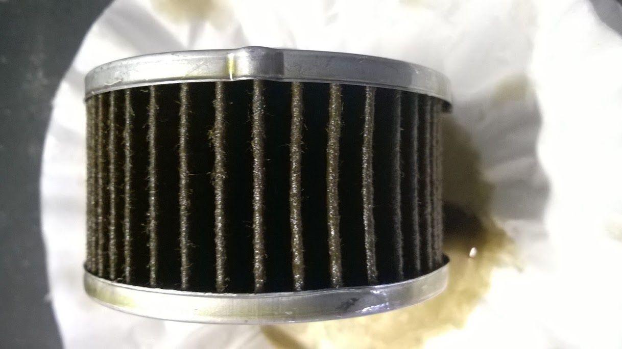

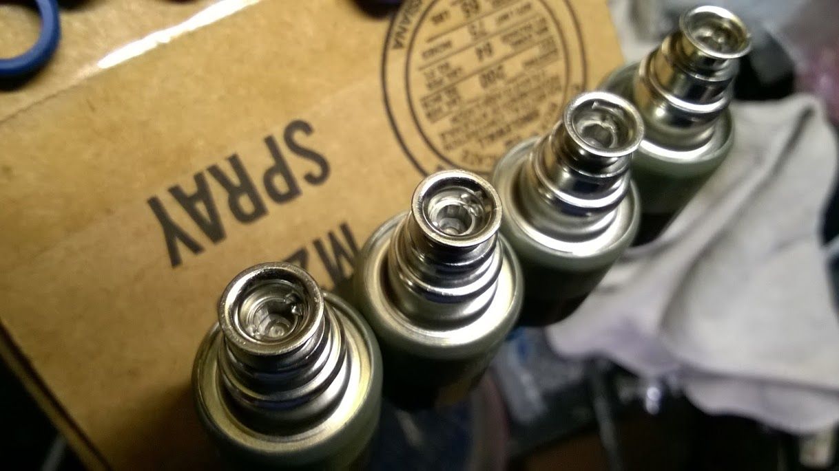

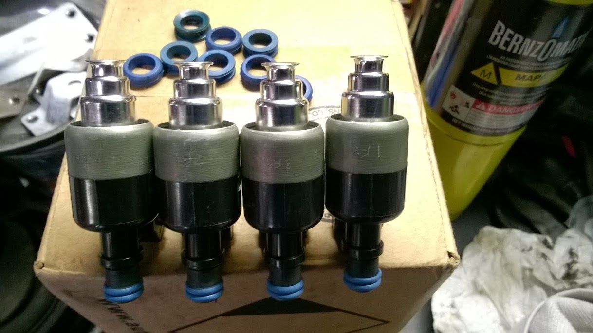

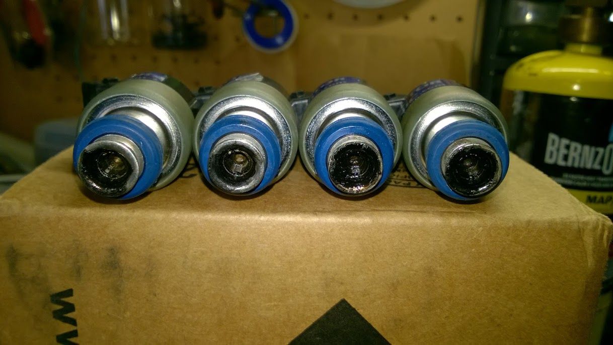

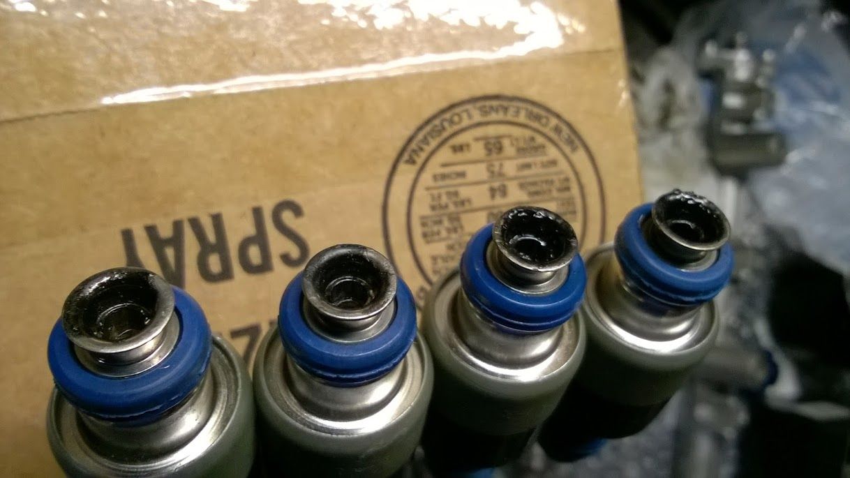

I pulled my injectors tonight to upgrade my fuel rail, and discovered some of the infamous black E85 goo. I've seen some people have trouble with goo, and others who have been on E85 for years and never seen it. Until today, I was one of those who have never seen it.
I've pulled my injectors on numerous occasions over the last year, and never saw a single trace of goo. I believe that's because the fuel in my area is pretty good quality overall. However, I went through about 5-7 tanks of E85 from various out of state locations over the last few months driving to the Shootout, and to East Coast MOD. I truly think the fuel station, and the quality of fuel coming out of that storage tank are what ultimately cause the goo.
I gave the injectors a quick cleaning, and now the goo is gone. I'll pull the injectors in another 2k miles and check for goo again, as I'm curious to see if the fuel in my area is contributing to the problem. As far as ethanol content, the tested levels from my local stations have been great. With winter coming up, I'm also curious to see if the ethanol content drops off a bit.

That stuff looks awful. What did you clean them with? Do the spark plugs look any different when this is happening?
I'm kind of thinking that my plan for the winter is to run straight 92 octane marine gas which has 0% ethanol in it. Plus maybe some kind of injector cleaner in the gas. I don't know.
I have read though that "winter blend" E85 in the cold climate states is supposed to be more like 70% ethanol. Purpose is higher vapor pressure, easier cold starts, when there is more actual gasoline in it. I think it varies state by state.
