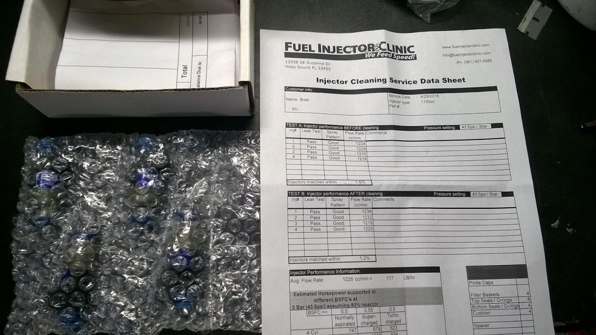

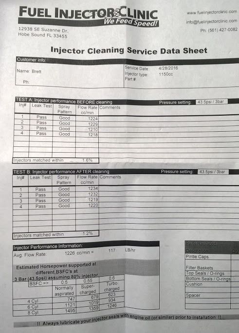

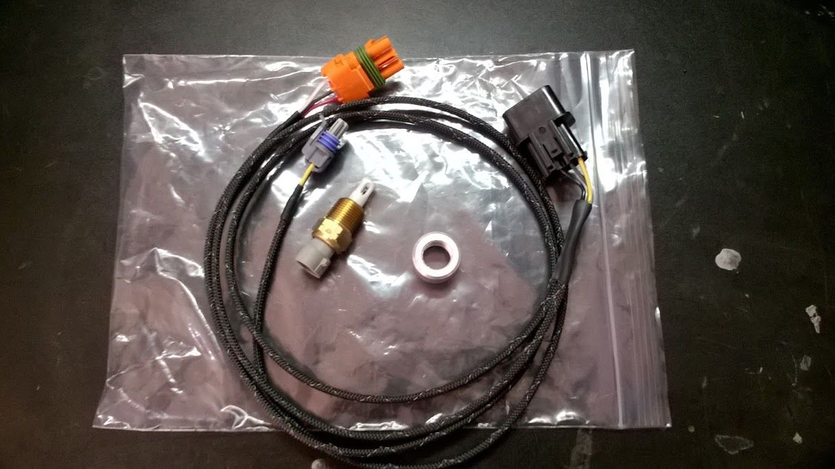

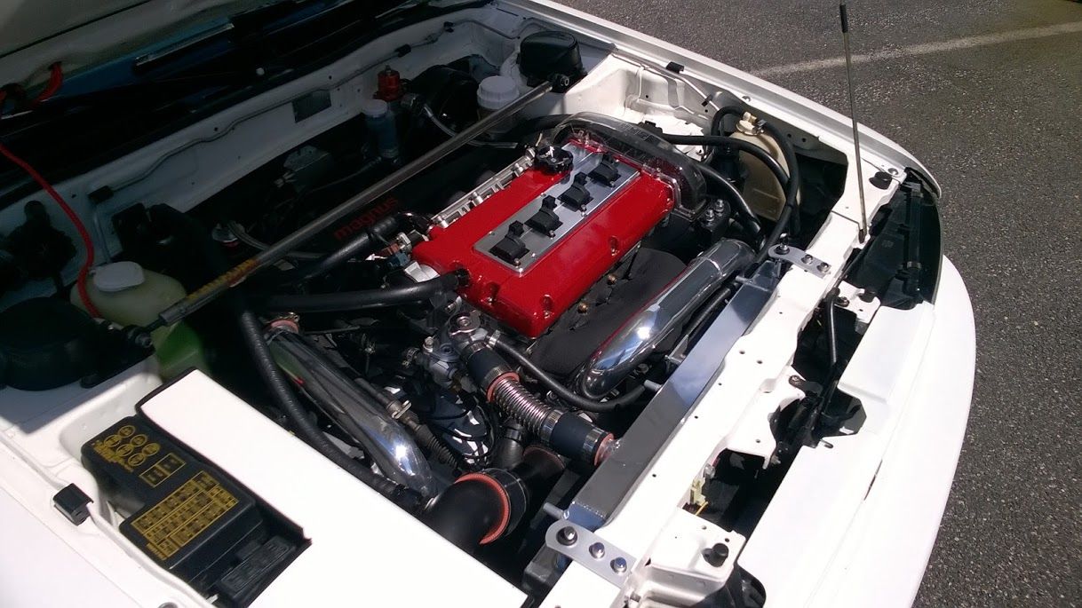

I just finished some updates to the car to support the new turbo on E85. I started with the fuel system. I upgraded to FIC 1150's, fresh from FIC all cleaned and flow tested.
k0K_yVUk5DPKURGOiiyT0wig04sKRFxFhnincIS-N3zysM728gGCtVuc-QorK78wCuxIn1PDH7EF3OcW1o=w1218-h685-no.jpg
0GYWC6Y0VV-mvEXa5oF7dj-oBJo4706FsoPcnc7gCoLXwrHv8yf5gQINIc1IjoTDM7rCGZRK27LLRIs87P4=w491-h685-no.jpg

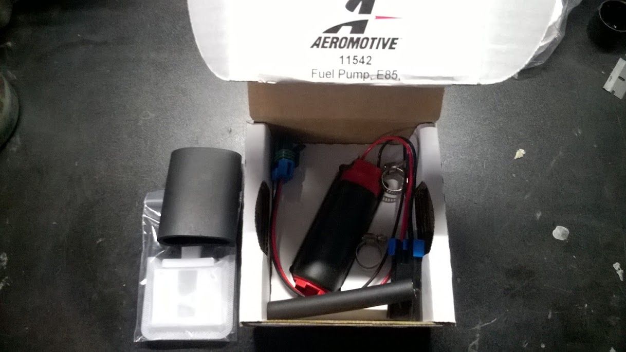

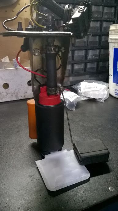

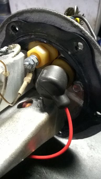

Then, I replaced the Walbro 255 with an Aeromotive 340 E85 stealth pump. I was pretty happy to see my home grown terminals on the pump hanger holding up great! There was no corrosion in the fuel tank, fuel rail, or the lines. Also, the FIC 1050's I pulled out of the car were super clean. No black goo whatsoever.

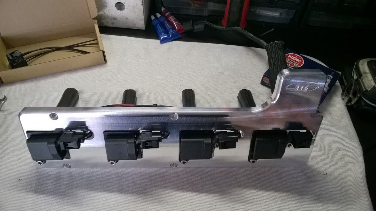

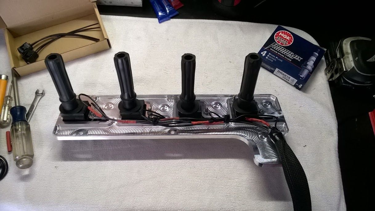

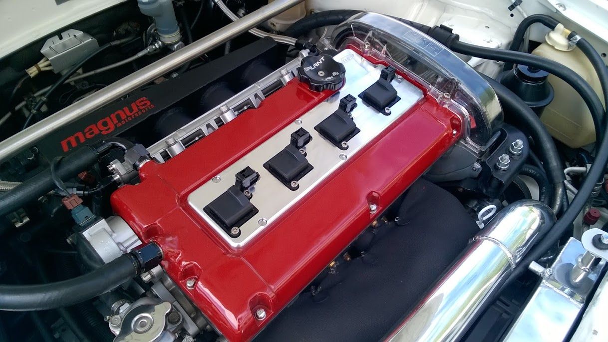

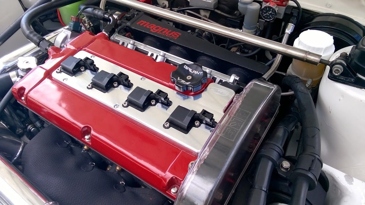

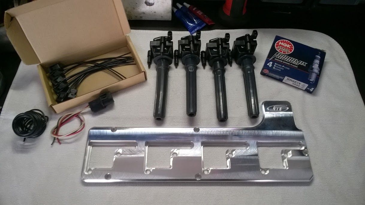

I've been experiencing a tiny bit of ignition breakup at redline on the new turbo. I figured my tired junkyard coils and old COP setup could use updating. So, I ordered all new stuff. Apparently there are some guys running iridium plugs on high boost cars with great results, so per their suggestions, I figured I'd give them a try. I think the last time I used iridium plugs was like 2007, and have sworn by the copper cores ever since. Results TBD...
bI7HDNH3GfWYps67woh0dGPuLx3wI-WoyNdnstp4tnCnJzyifVdyX2r7qkPVV60uk2ZmeFhXX1eH9jB4ds=w1218-h685-no.jpg
vPMY9Y5AvQKQG1LPHjkj-017y-gKUT1Uo7_cWHbnJ3tR-MaZdtXy-nfxw1v9rP3pBWxa76JoL5j4fRz-78=w1218-h685-no.jpg
Dz0zd6pOxO7ggCPmw3QoAZn3HLukJ0DUt3xZzTX1KGv9_GJcykZiXEJMtg0yJtCLN9MGE_HnvOtxRAzXNQ=w1218-h685-no.jpg

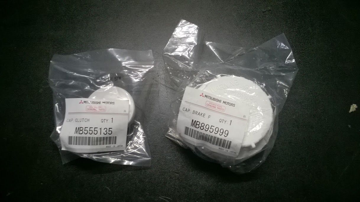

I got everything all wired up and slapped the new COP setup on the car. I also installed some new reservoir caps to go with all the bling.

Looks great bro. So your running cop with no cdi? Let me know how it all turns out ;) also where did you get the galant vr4 oil cap? I want one ;) help a brotha out LOL
Thanks, man. No CDI, currently. I'll see if the recent updates I just did to the ignition system clear up the issues I was having. If not, I'll pick up an ARC-2.

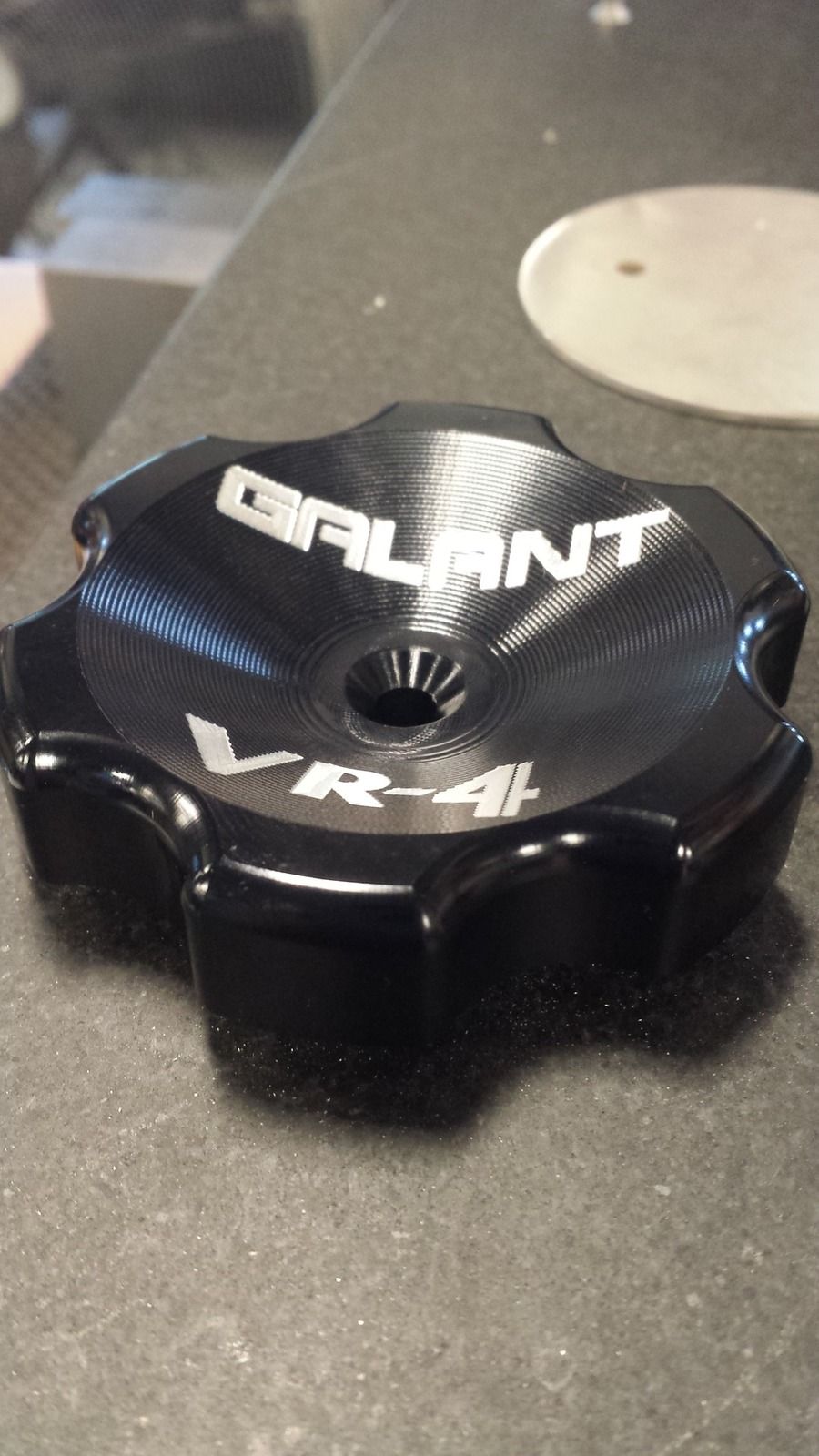

The oil caps were custom machined out of billet aluminum. I got one as part of a group buy over on the Galant forums. There was only a small batch of them made, and they aren't available anymore to my knowledge.

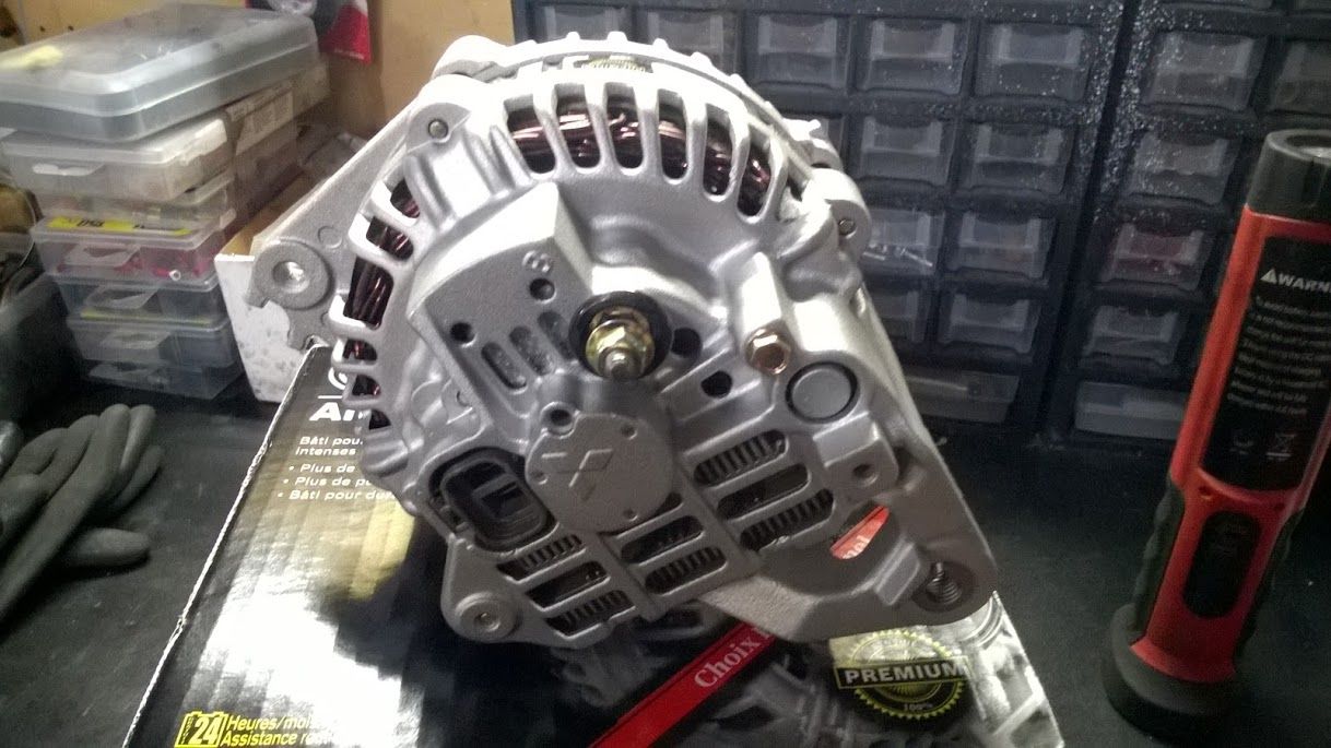

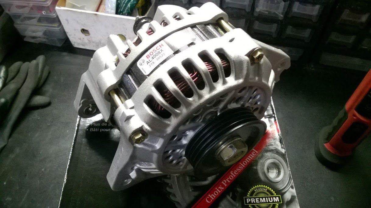

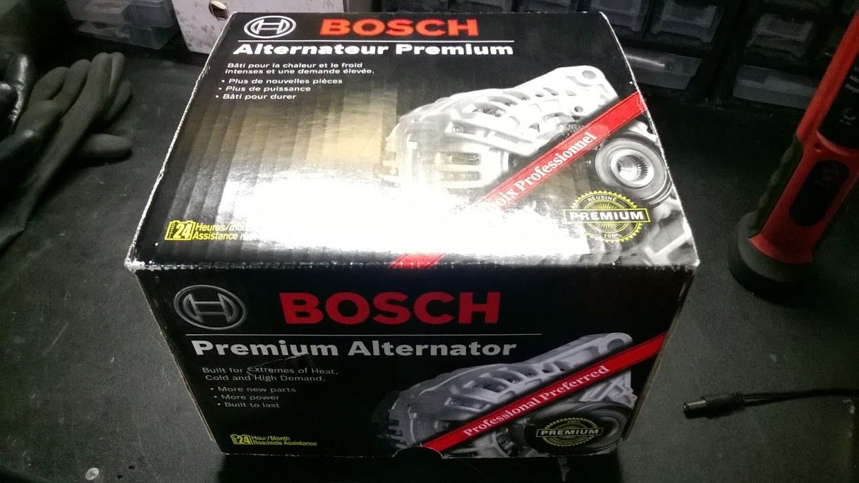

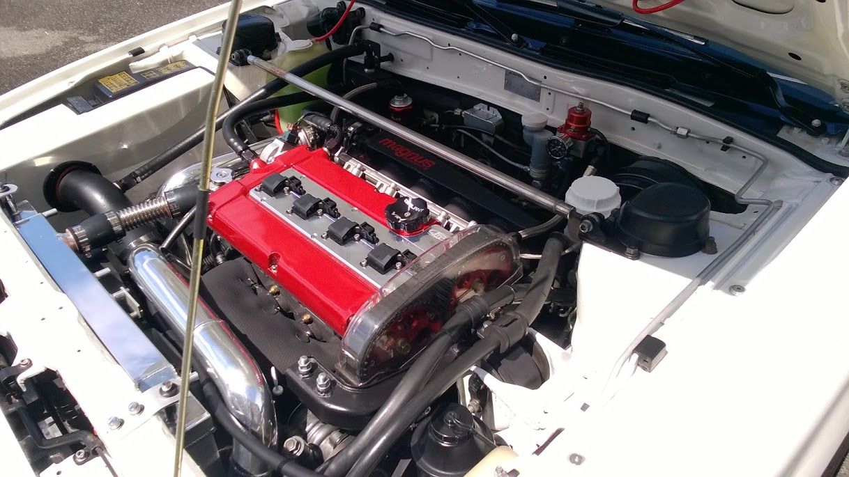

I got the new alternator installed today. I decided to go with the 90 amp (AL4008X) Bosch unit, since my old one was crapping out. Once I got it in the car, I noticed my voltages were much more stable than before. They stay right around 14V all the way to redline.
1BpjKdLoa4XLfikyhr4wEhmhMc-jT624aDIYHBqQpXU5iKXwAyPBSFhbqBWK8Dw1X2iflmiSN36OGydFmA=w1218-h685-no.jpg
lwtD8UuUFxAumKuGYOYUWRJ4T65AAwCsIovj4a81_63GAzU-XOTkp7rNnXaPHjy3pXQQTaWnKL-bvPUjbM=w1218-h685-no.jpg
qVRDoBADZJhmEpr1X-LT-XLx6YD0r1RhFJsfPsMQ3UgNJVMGQNkeip_Ts3fL4HORum55x2BedOP3byMQi8=w1218-h685-no.jpg

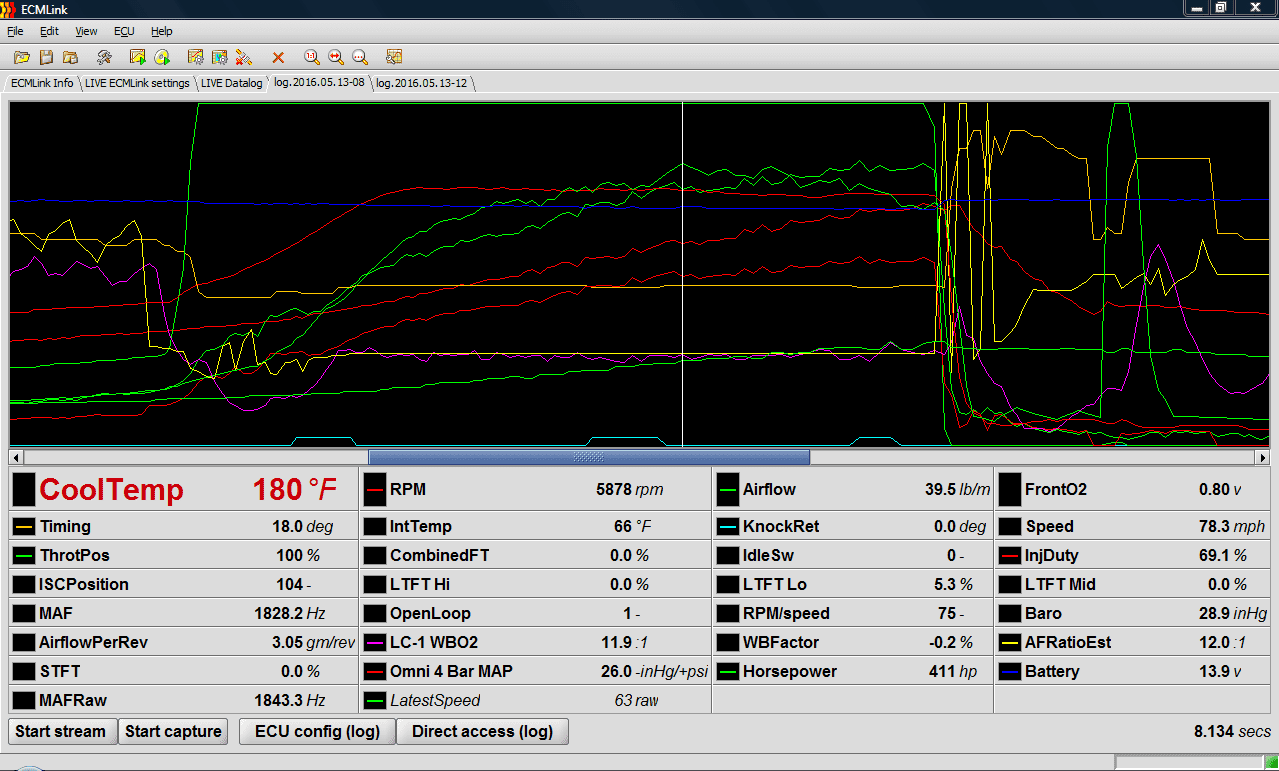

After I was confident the car was charging properly, I went out and did a few pulls to dial it in a bit better. Between the new alternator, and working with the tune a bit, the car doesn't seem to be breaking up anymore. It's on about 25 pounds of boost currently, and feels really strong. I think tomorrow I'll pull the plugs and close the gaps up a bit, and then try and get to 30 psi. I also need to work on the spool up tuning some, but overall I'm happy with how it's running.

Where did you get that Alt? It looks really nice. Also, I love that JMF COP plate. Such a good looking piece. Keep up the good work! I'm glad the 68HTA is working out for you.
I found it online, and was able to order it locally through Advance.

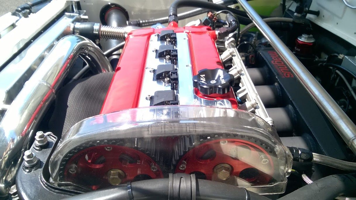

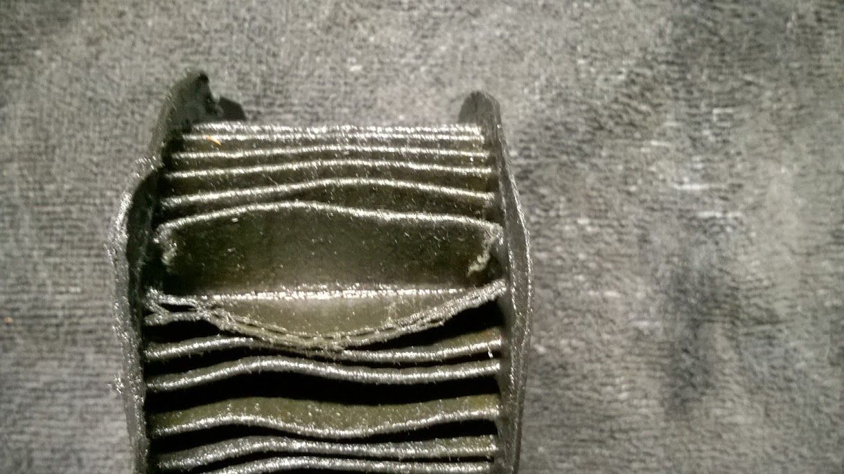

Rolled 600 or so miles on the new build, so figured it was time to do another oil change and see how healthy the motor is. I drained the oil into a clean pan, and it looked good. So, then I pulled the filter and sliced it open for an inspection. The filter looked great, metal free and super clean.

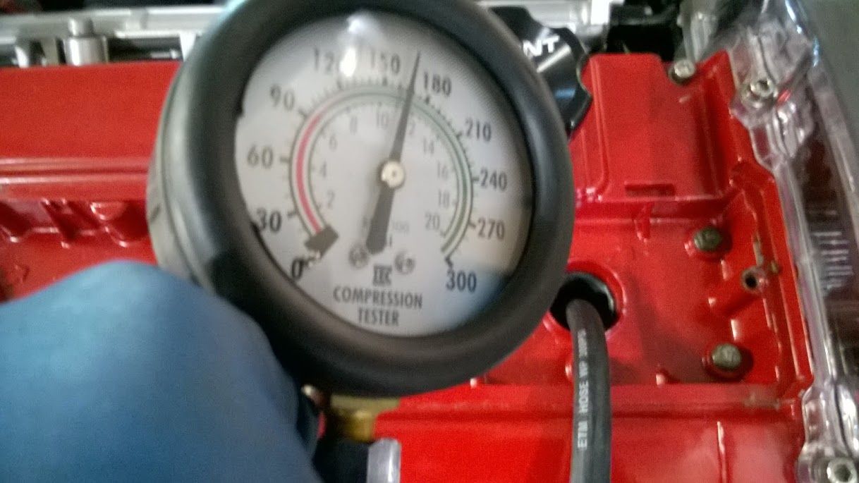

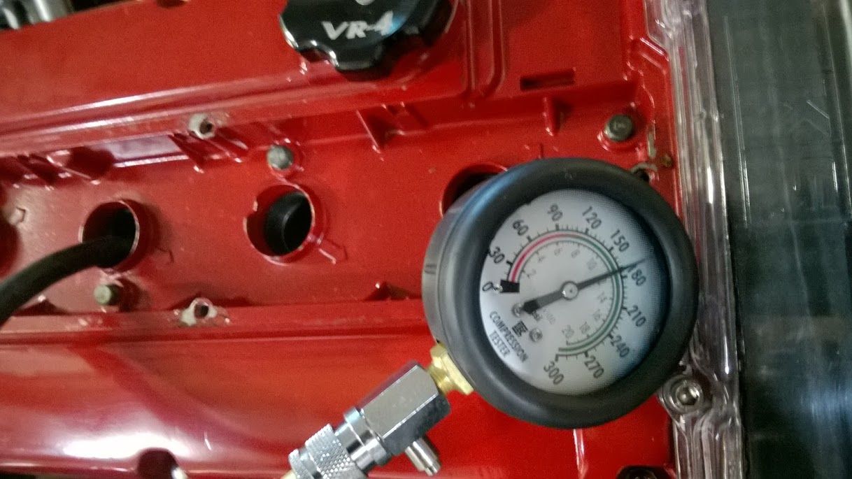

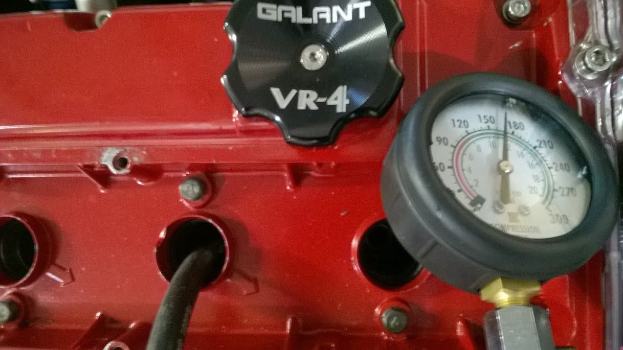

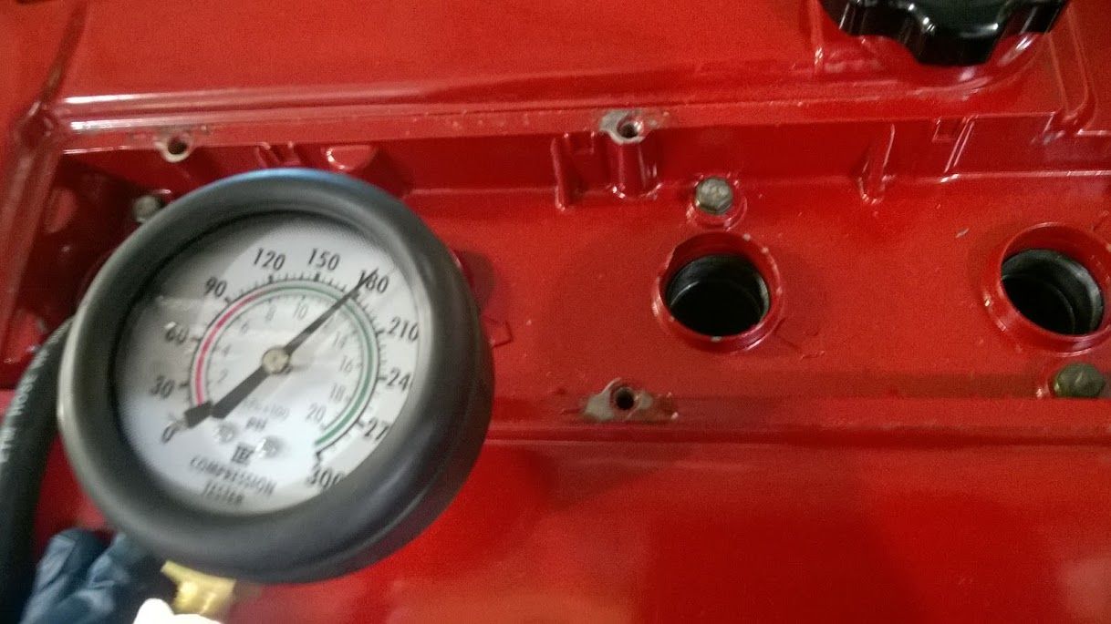

I also did a compression test, and was extremely pleased with the results. 175-180 psi across the board on a cold motor.

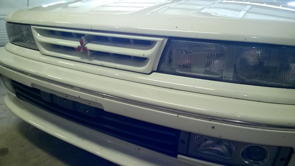

I regaped the plugs to .018 and put the car back together. It runs GREAT. With the car in good shape mechanically, it was time to scrub off all the bugs I slaughtered doing 3rd gear tuning pulls.
QZa__FiKJ0hNjoKJV-rVfyEFWyjLQLmiOZ5oUe1apzV6cG-WrUWnK7EvVIZzlr4jTbbtARfUAK9tNk9GHQ=w1218-h685-no.jpg
All clean :cool:
