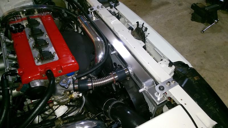

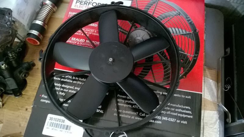

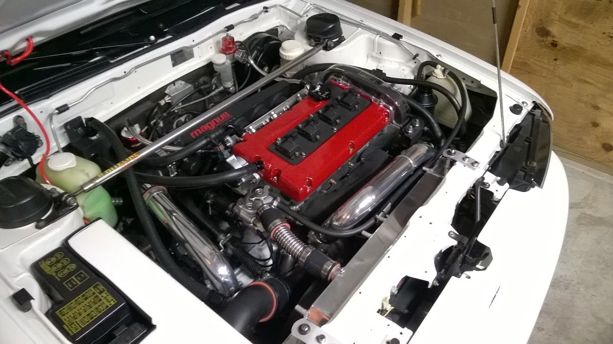

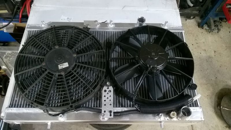

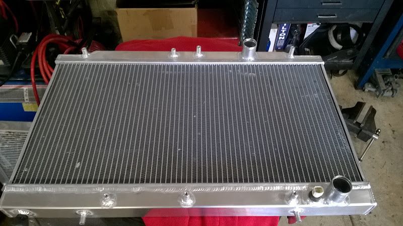

Got the new radiator in to replace the one I destroyed at the track. .

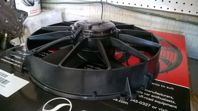

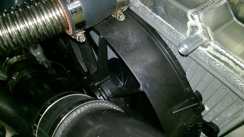

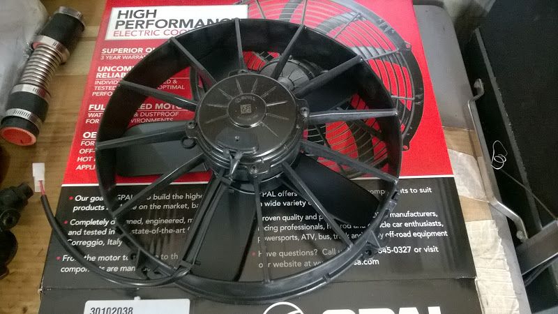

New SPAL "High Performance" 12" fan. This one is rated at 1600cfm, and has a more sturdy design. We'll see how it works out.
I used a combination of solid mounts and the push through ties to install the fans. Everything fits much better, and is much more secure.
First impressions: this setup moves a shit ton of air, but I won't get a real feel for how this performs until this summer. I can definitely tell it puts more of a load on the electrical system than previously, though. I think I may need to look into installing a high output alternator.

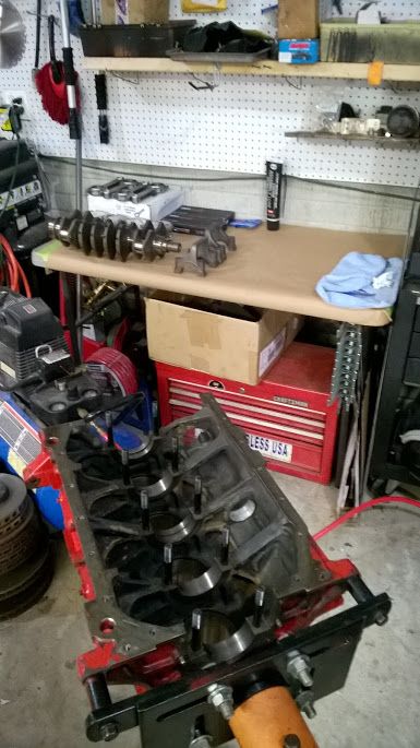

So, let's rip this bi*** out
aFwsqL7Mp8EYmQGAKG2zJPgomg7jgHxGCR7x8Fos5fsDc4eGPUCdG9J7RoLBPI0ipCT4VopRurHezn4Ud3=w1218-h685-no.jpg

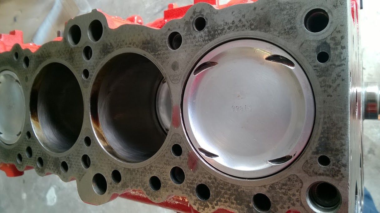

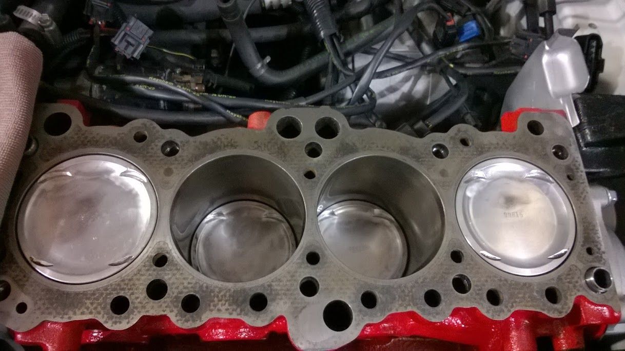

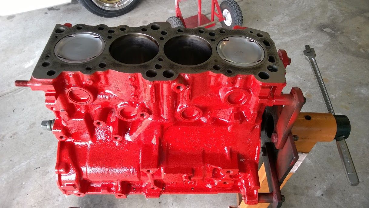

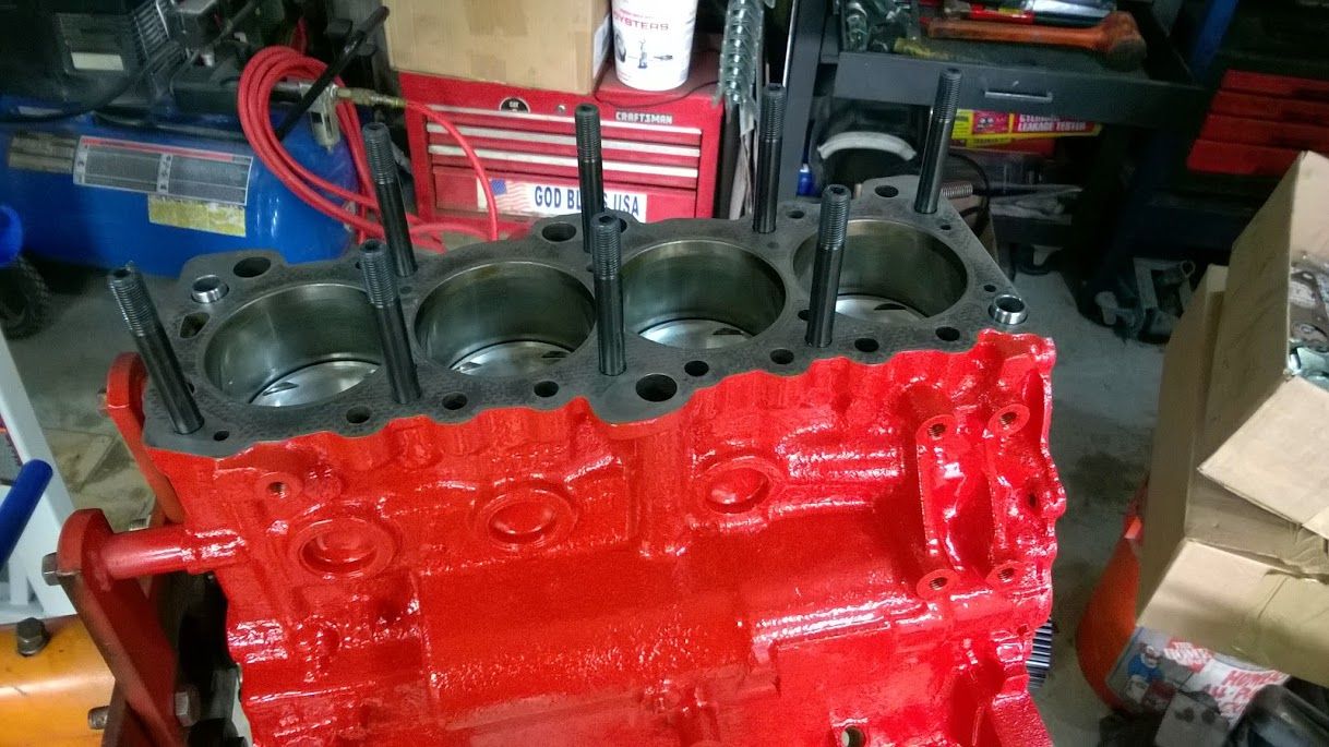

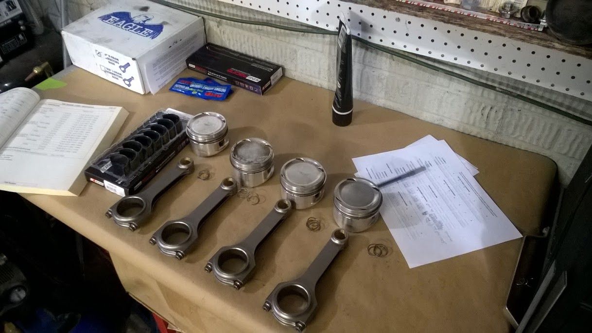

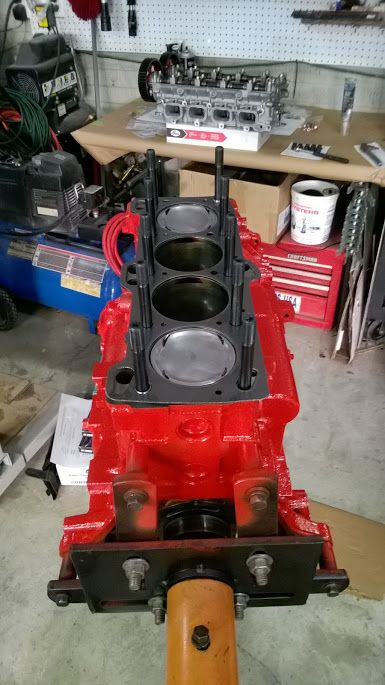

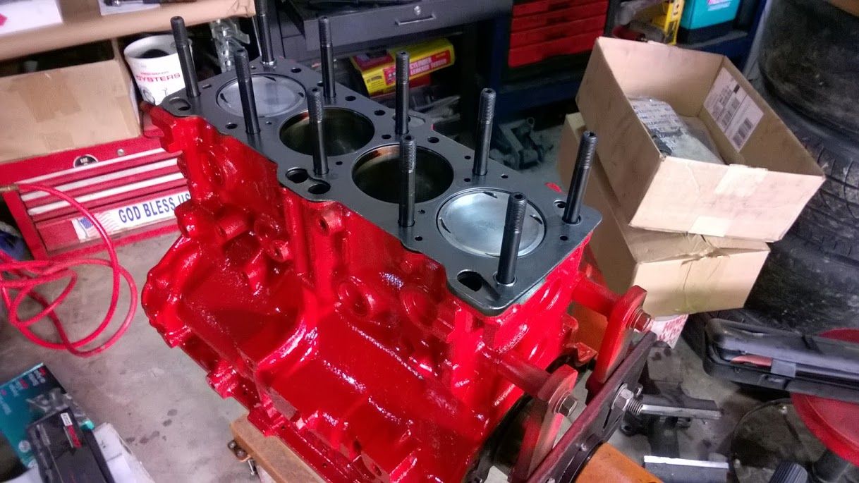

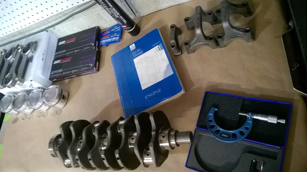

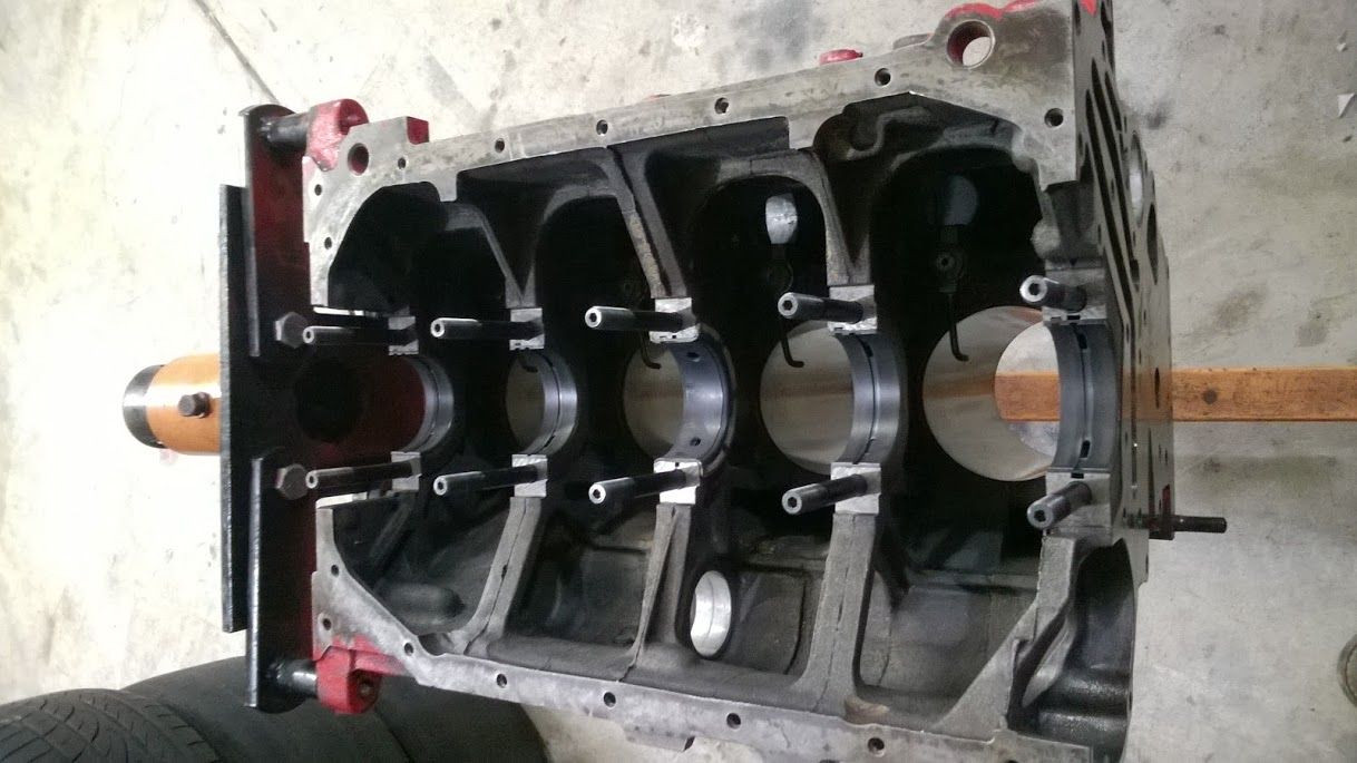

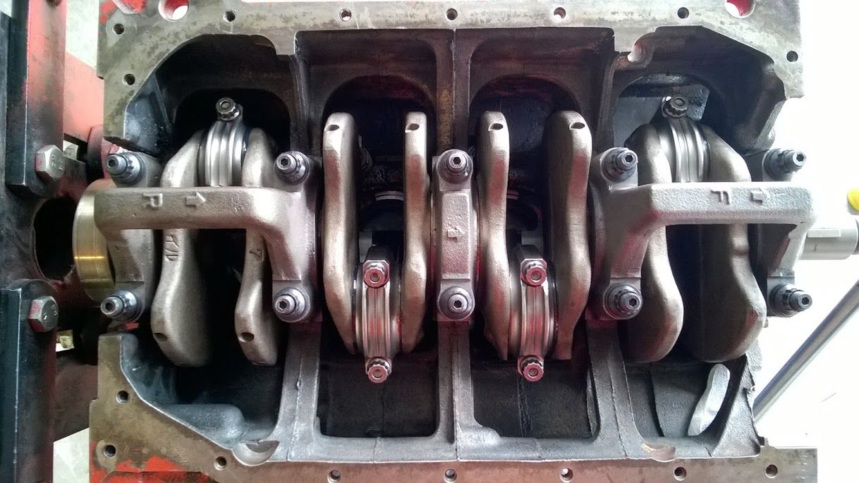

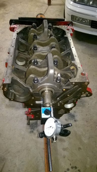

I started the motor build with
6 bolt block punched out 20 over
Stock uncut crank
ARP head and main studs
Ross 2G 85.5mm 8.3:1 forged aluminum pistons

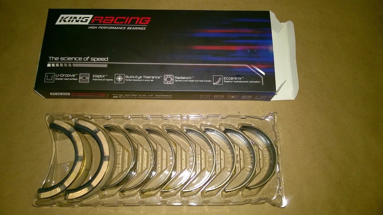

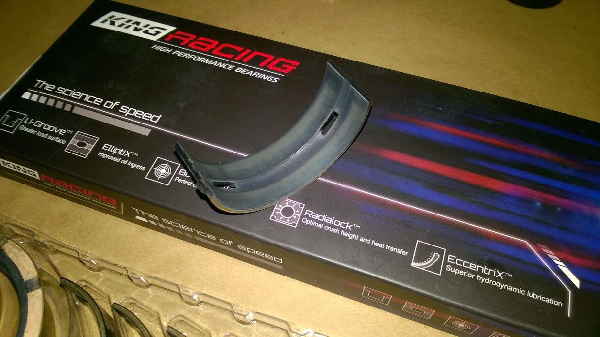

King XP tri-metal racing series main & rod Bearing Set
Eagle H-beam rods sized for a 22mm wrist pin
6Oj4b4qbKkl4SQrY_p_EmMQuJttNmPcFuSM2Yazm1QENs2hIZ9Y_7LJz6aDV9T9YOzW0BXKo2O_8ugjmgG=w1218-h685-no.jpg
kr0E0IOspfp663HYxjXEv8K2aUkBZP5M47LGRVZDBxTXwsk_ojG6WttL47tt5gaGsooqIbhFFvCbhX2zjC=w1218-h685-no.jpg
FIJQRO4zkK5UNDUAhuAltlx6XpC6CtcPEe9Kg2AfPE_dwe4aC7GxlXx-SgWfz3mnfwEM3wvKLi3TW0uFsC=w1218-h685-no.jpg
Tte746_iciulxRmxIPfb_J96qsMCtbZymEud3LuWaABR9Z7VSwWMon3752de5S_sN48wlCOrsnTSQC3_sg1=w386-h685-no.jpg
Uhll3iJrj1colBEZl6oZIlV-NXofbaXAw_DoFn1NKHDEGbzW_xRmOdIkpSDCSoXh2qxJT5qb4Bsf5_gW3A=w1218-h685-no.jpg

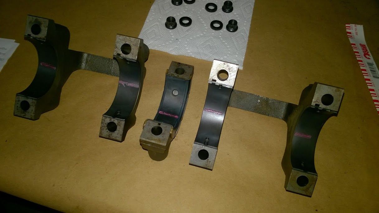

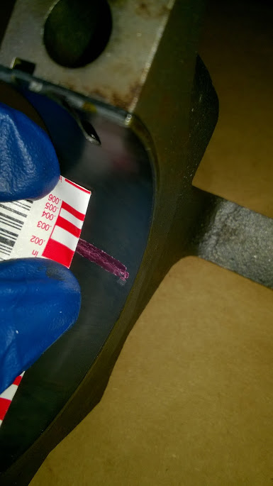

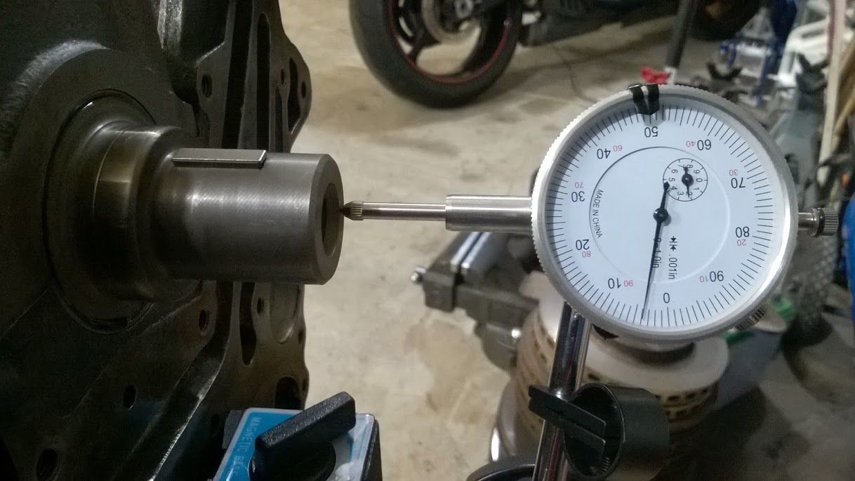

Verified my measured oil clearances with Plastigauge. They're set a tad on the loose side at .003" right where I wanted them. Also checked the crank end play, which ended up right at .005".

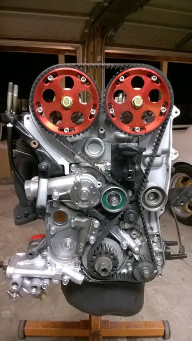

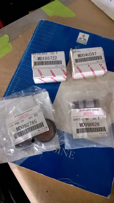

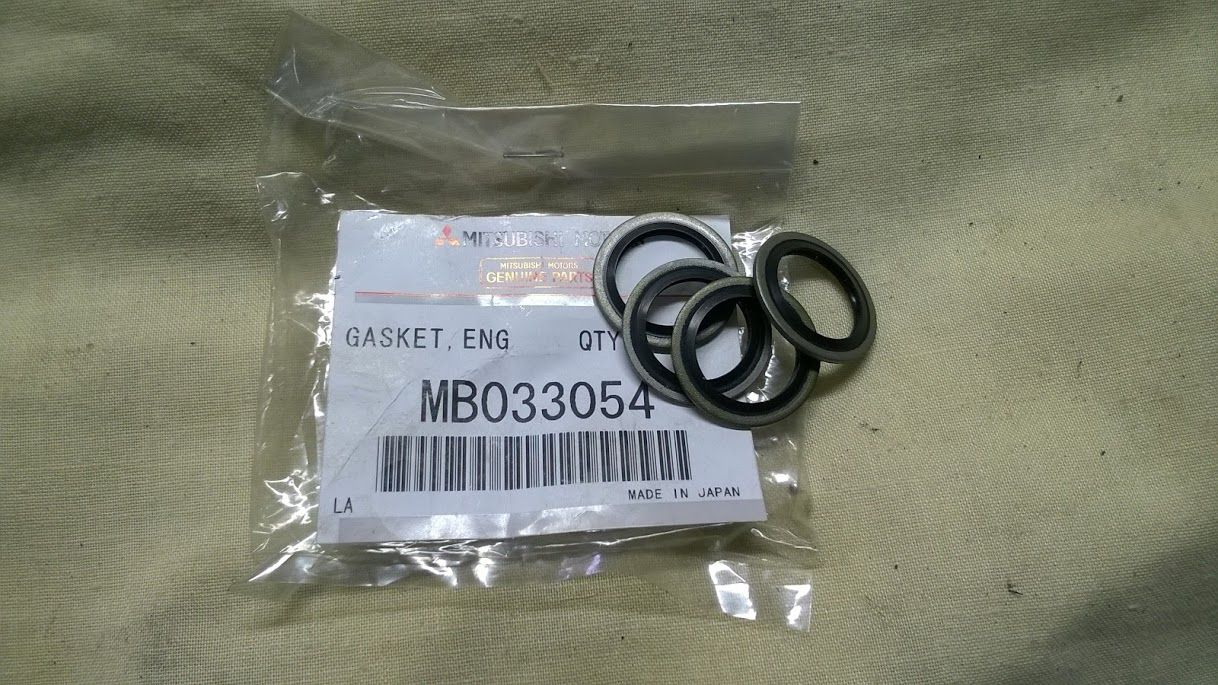

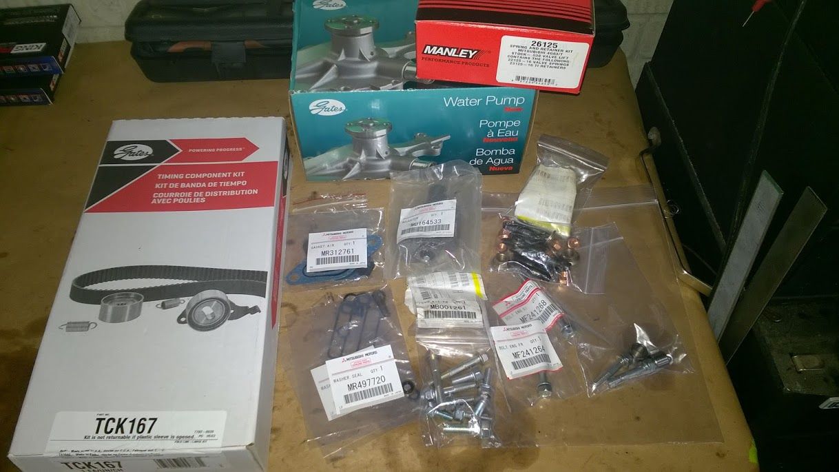

All new hardware for EVERYTHING. OEM BSE, OEM tensioner, Gates belts and pulleys, front case with straight cut gears, etc, etc.

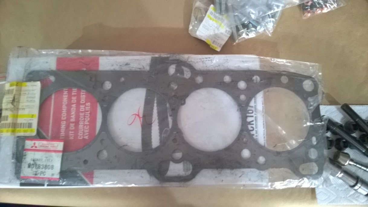

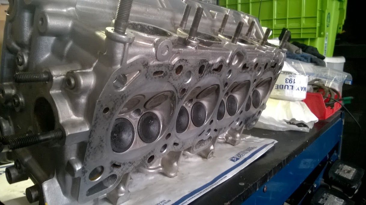

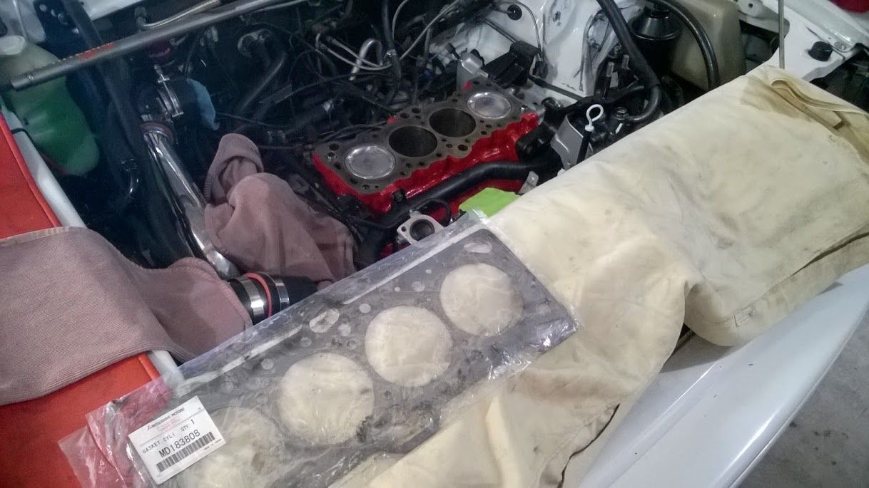

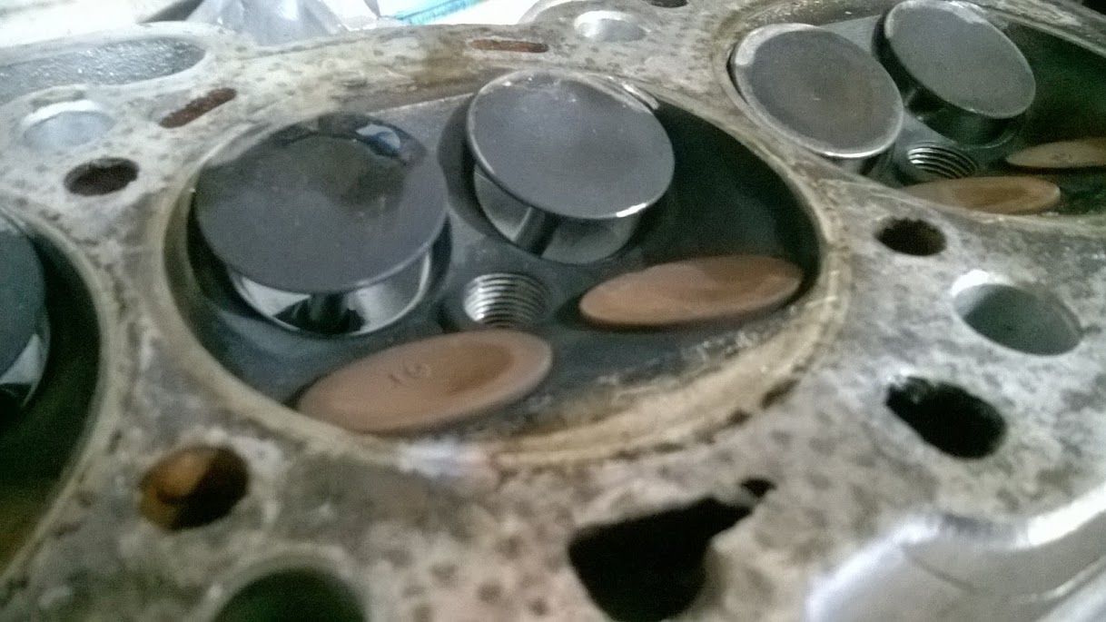

I decided to go with a OEM composite head gasket this time. I also installed ARP head studs and new alignment dowels.

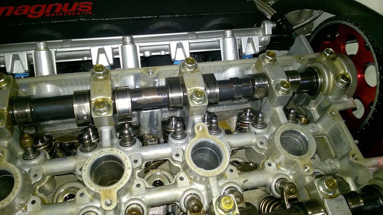

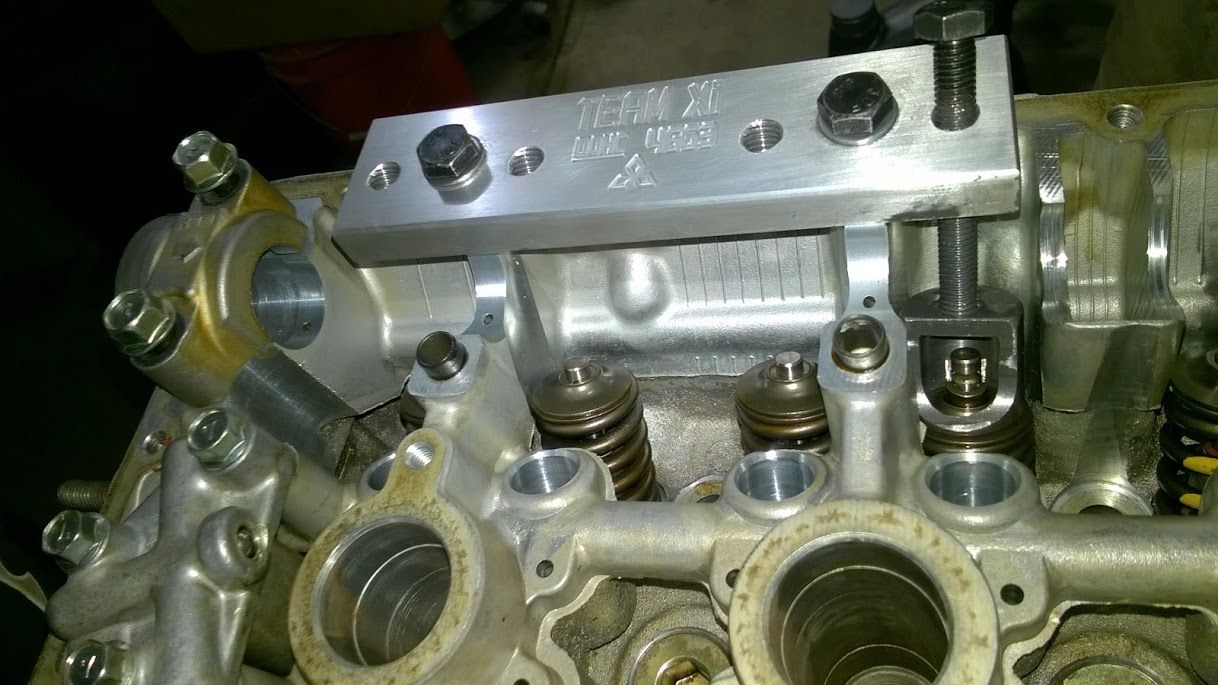

The head is pretty much stock with Manley springs and titanium retainers.

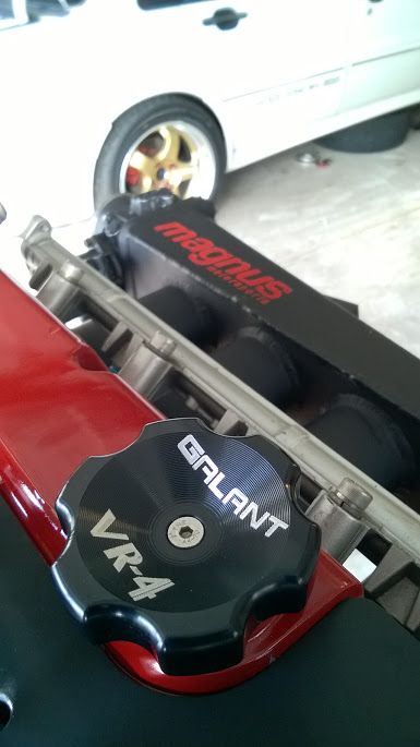

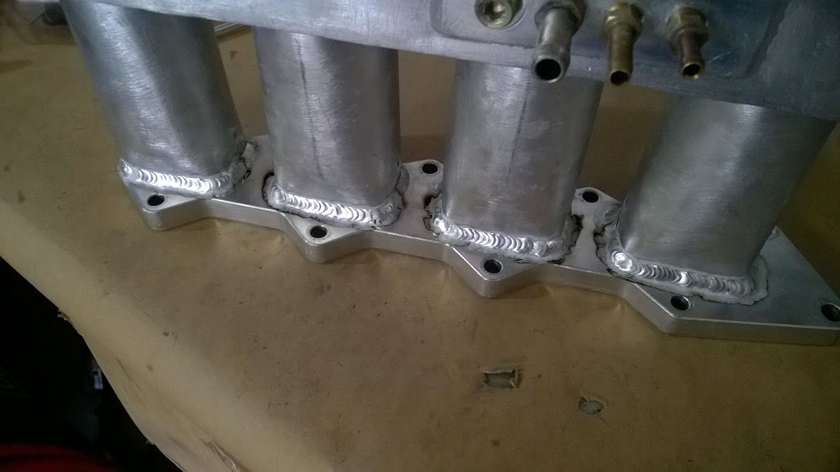

Piece of shit Magnus manifold started leaking again last season (second time since I've had it). So, I had a local shop re-weld the runners. We'll see where it starts leaking next...
7zSJdA9DIAZ-z3aHgeNvECCObpNdJjQ3FpVX49l0mvFpb6WsJQ-zmfNLERx4nlXLAmxn6JA6Rf6j7nJcj7=w1218-h685-no.jpg

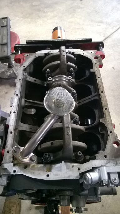

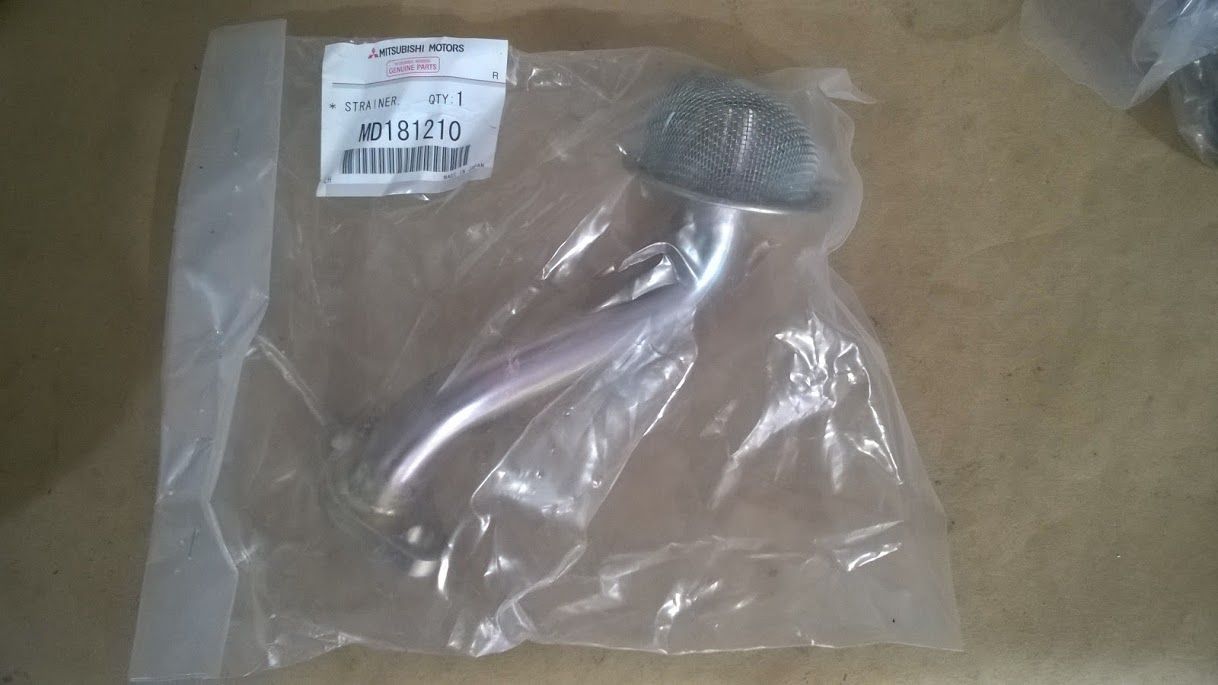

Next, I installed the new 2G pickup tube.

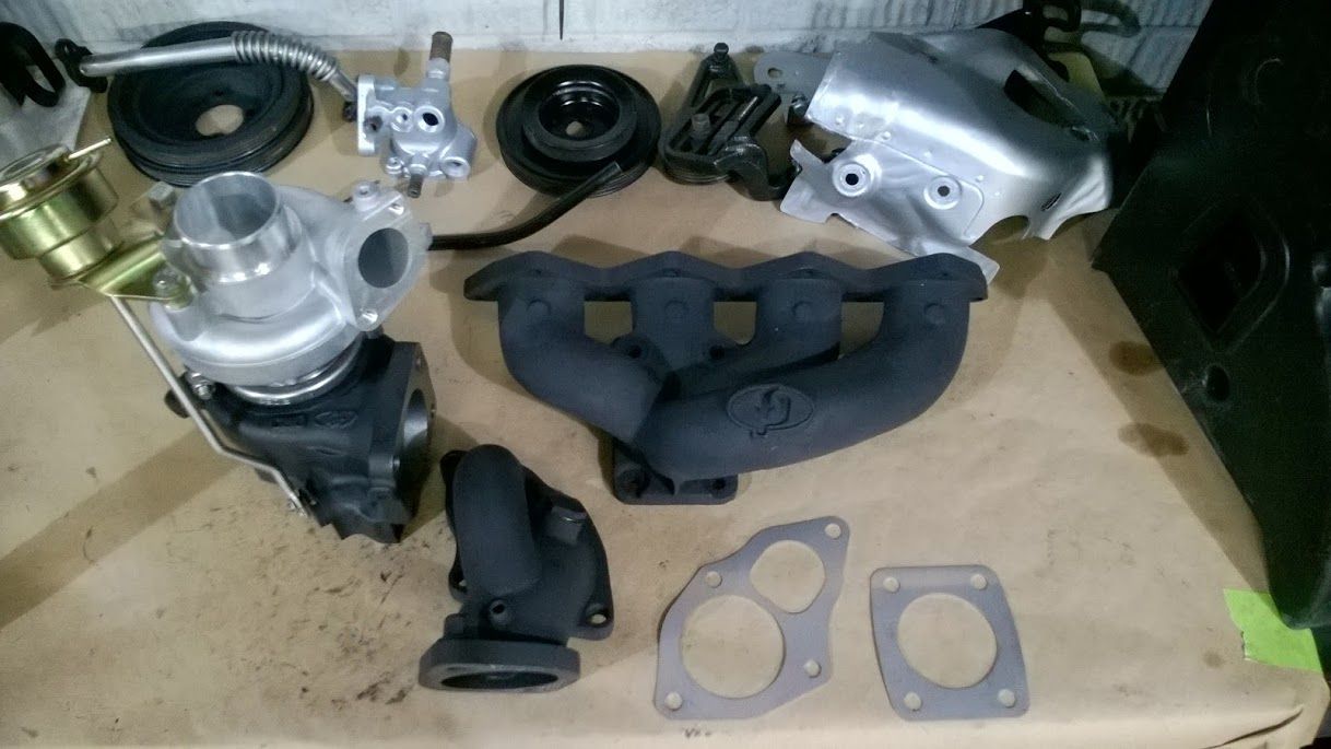

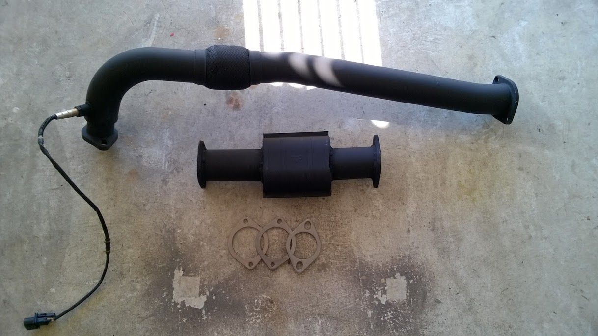

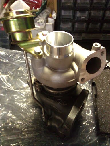

Then, hot coated all the exhaust parts and bolted the new 68HTA setup together. After that, I installed new exhaust manifold studs and bolted on the turbo assembly.

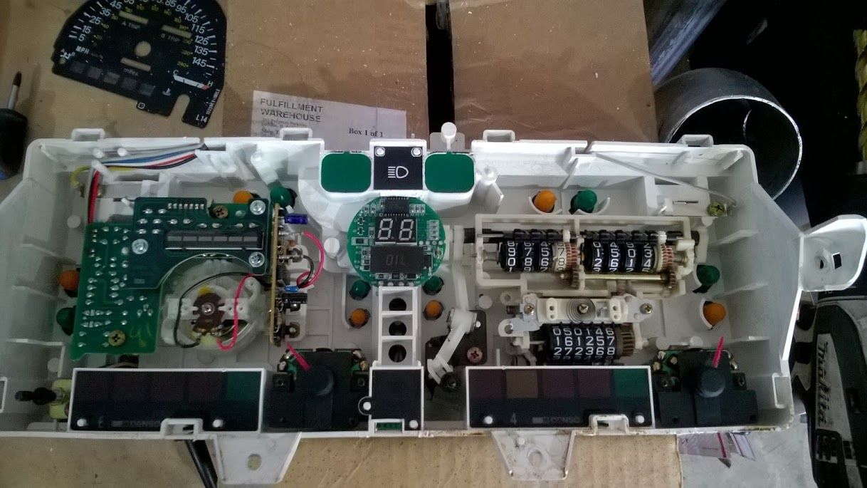

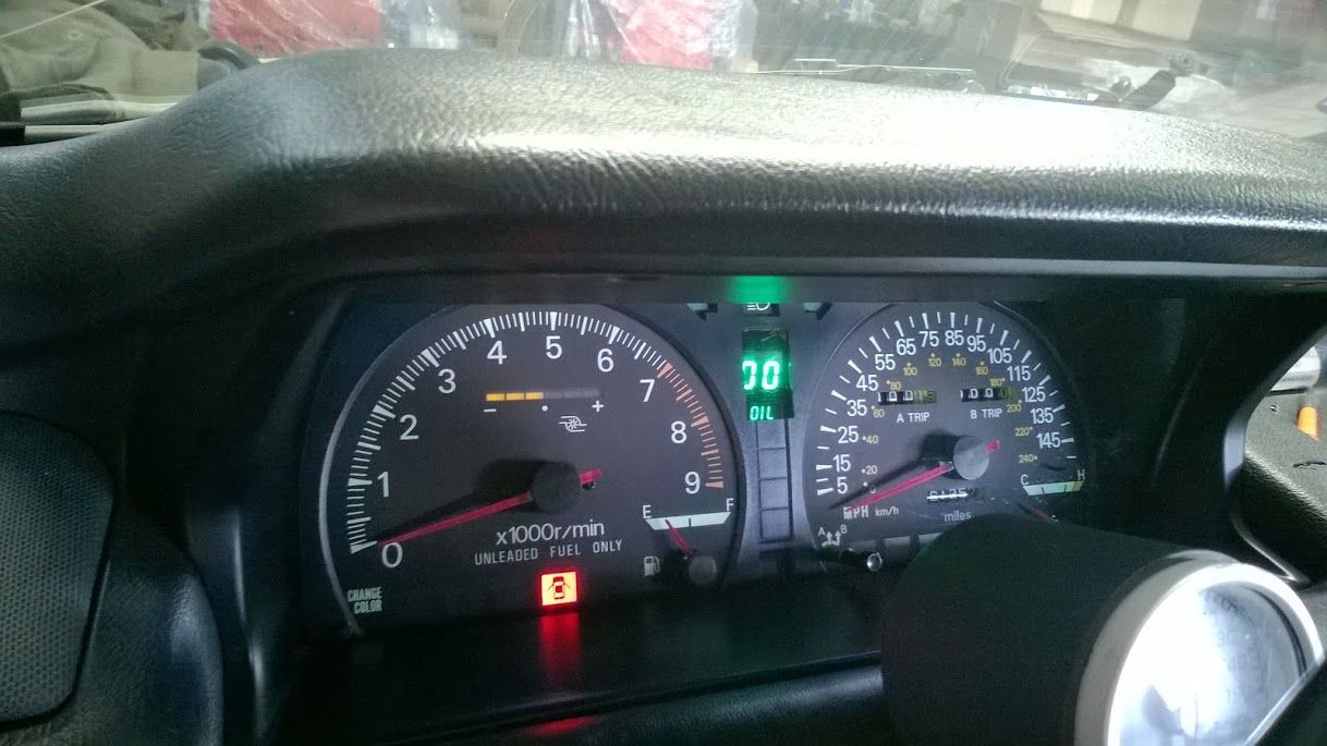

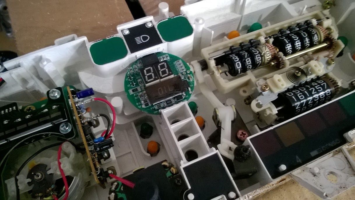

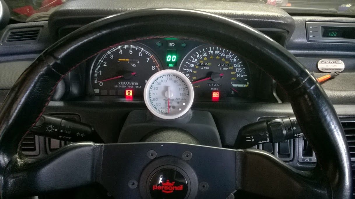

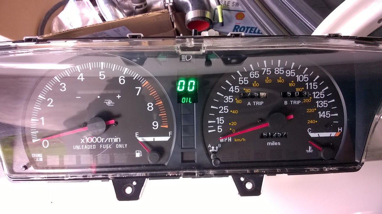

So, I needed an oil pressure gauge, but ran out of places to put gauges while not cluttering up the interior. So, I just hacked up the cluster and put it in there. It turned out pretty good, IMO.

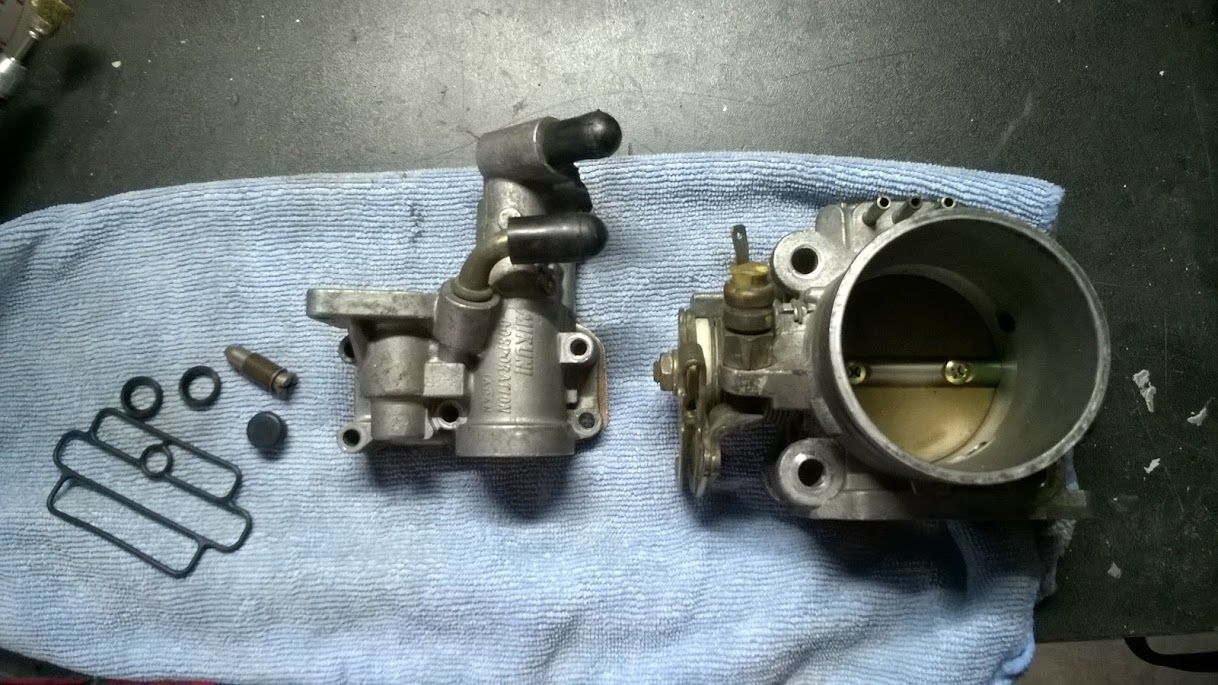

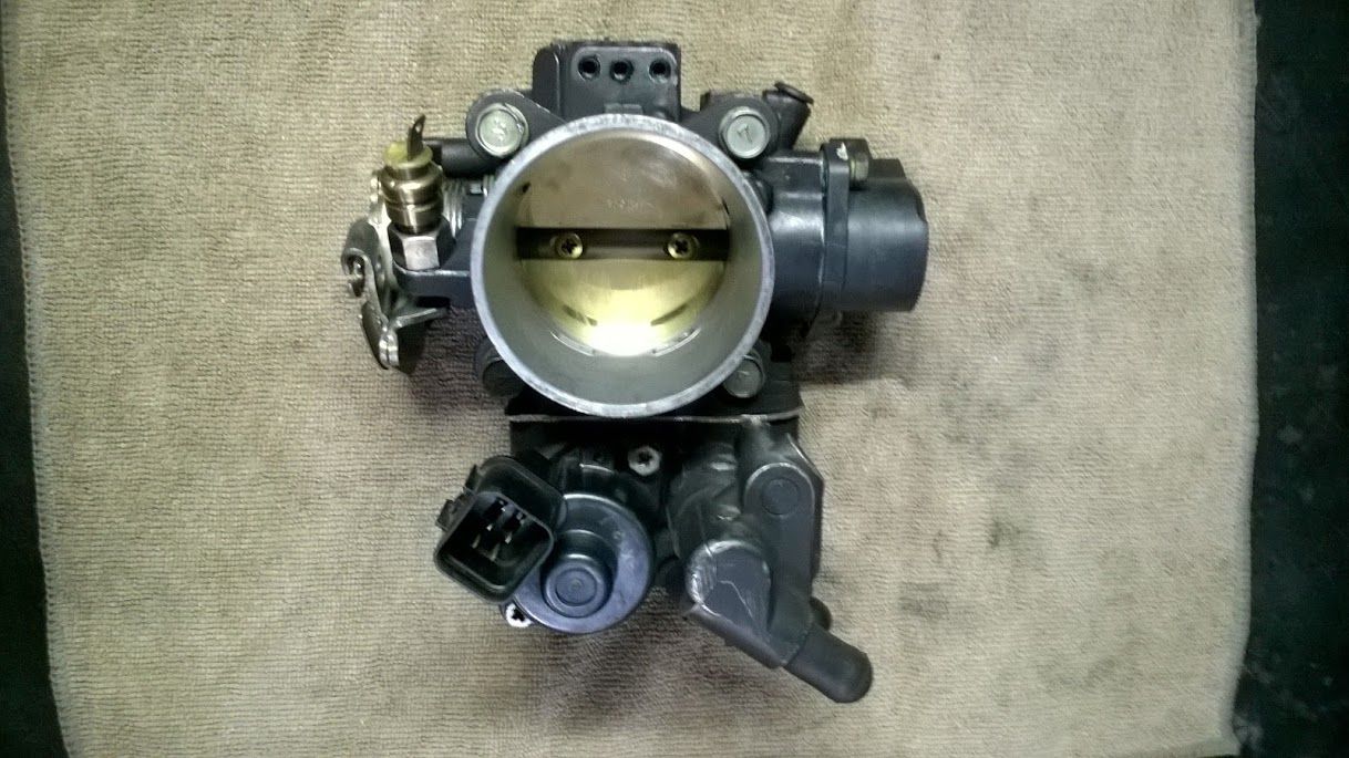

Rebuilt the throttle body.

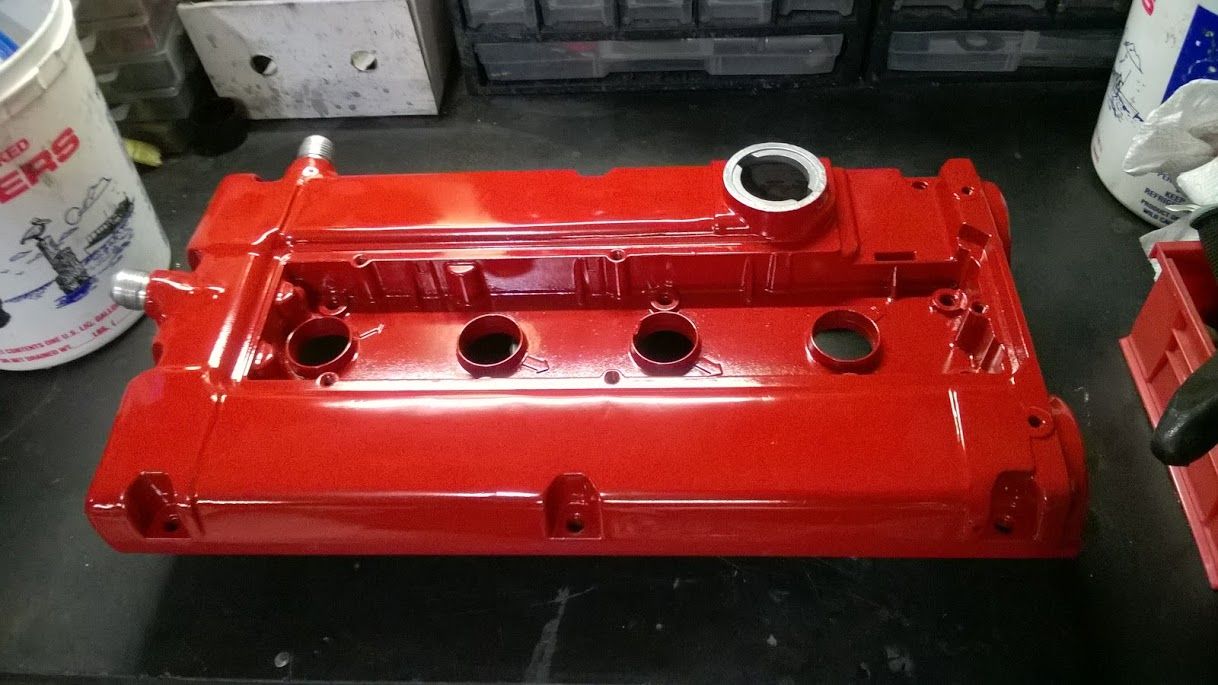

Also spent 1,000 hours sanding my valve cover so the paint would look decent.

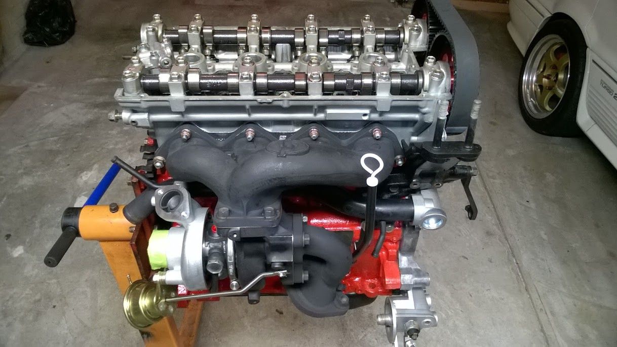

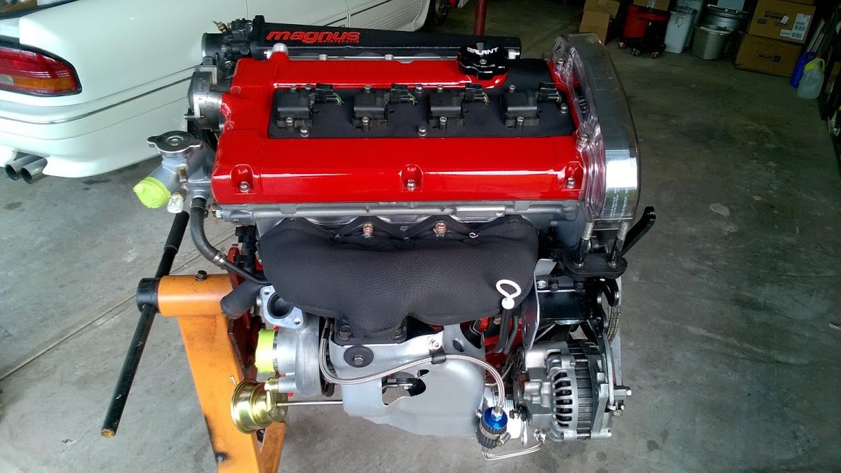

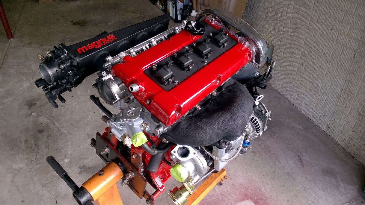

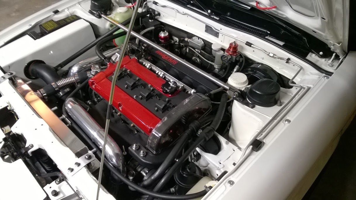

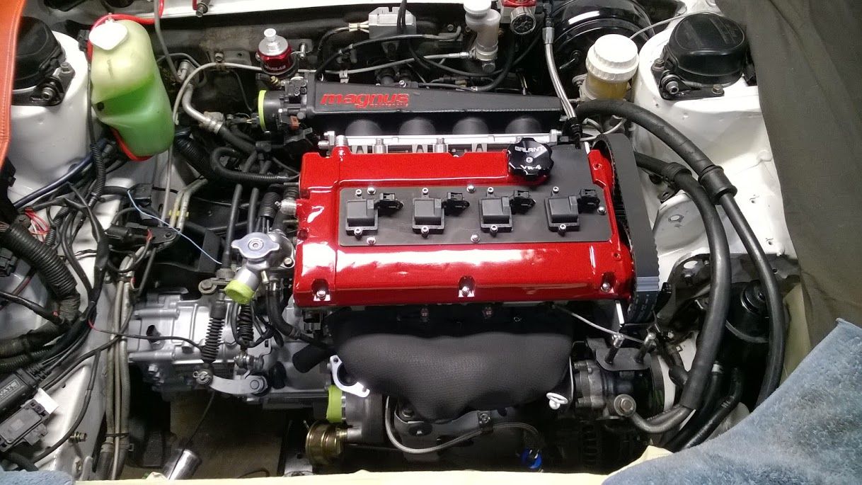

Motor done.
V6_EKAEgtUnagm2V0IB8wIJ4k7QRxiLpFL_1fjJppbR7VVmsVY0QjyFgwMgK76gXJ-A40cl48cYp-LPK9V=w1218-h685-no.jpg
V-2_g2TOGBzddTwNkSNwOyhClr4vxj3rFZqIdklZ2dYPXK1ggq-D9OK1TjSU4n-cJHp-HSPV90Fx6Z3IU0=w1218-h685-no.jpg
VZHEG-W0uWMkY8Z7qPJGA53QfOVtuzr8ny4NA8VRmQH8X_KwRUl9u2lSynvbHrM1hLuTCHFYv5NaQSS-H5=w1218-h685-no.jpg
SYGN3DmzsvDo1fHZUJKKNo9EA37q9MDrA8Hl4yY9Kgq4p-MKcT-IXJS7nyCeK-PdLsLuF7jKMljb252tkjG=w386-h685-no.jpg
m_aM8JrId0HwFgGduSYURbmR9FN3pfe7imwiEeX06rqysdItjoGDNnVZEs_Hsw_s3ihm3ZoZcX9nUhp5du=w1218-h685-no.jpg
p59ip7gKnHblfeghTrpVBSmzQlhEstLXcK0ZbTS5-IEUv9_WyoG7Jb6pAo2MThOEPoOx76xn5YKCFLXYZK=w1218-h685-no.jpg

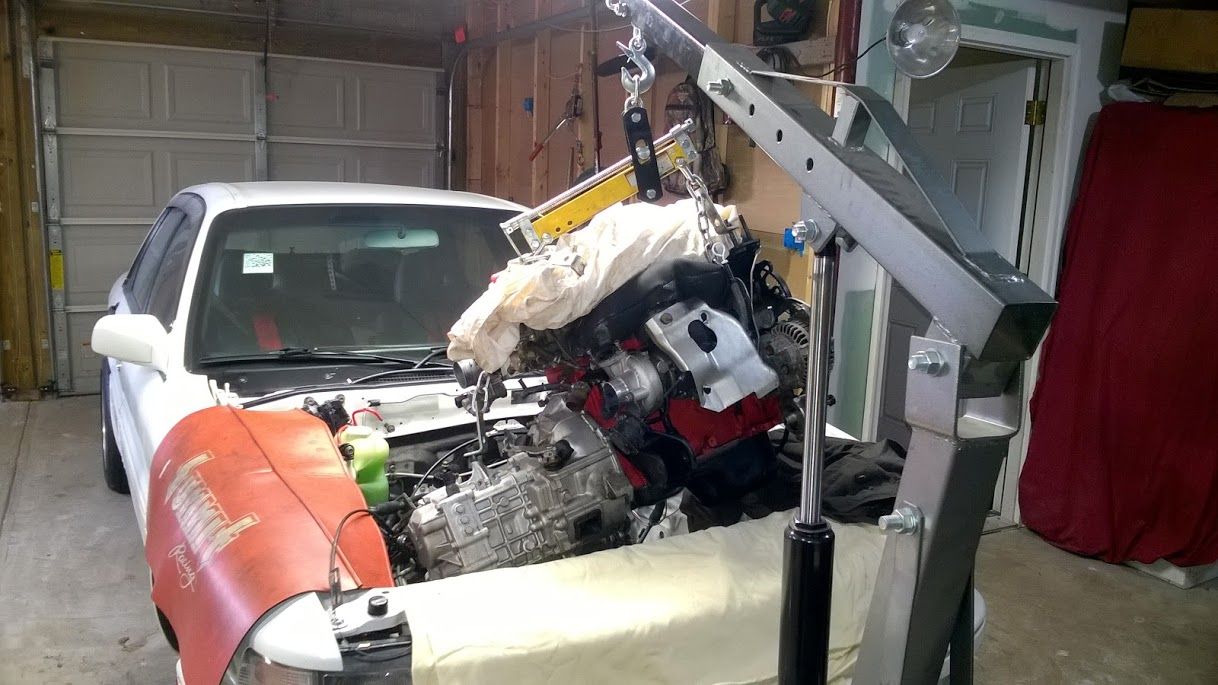

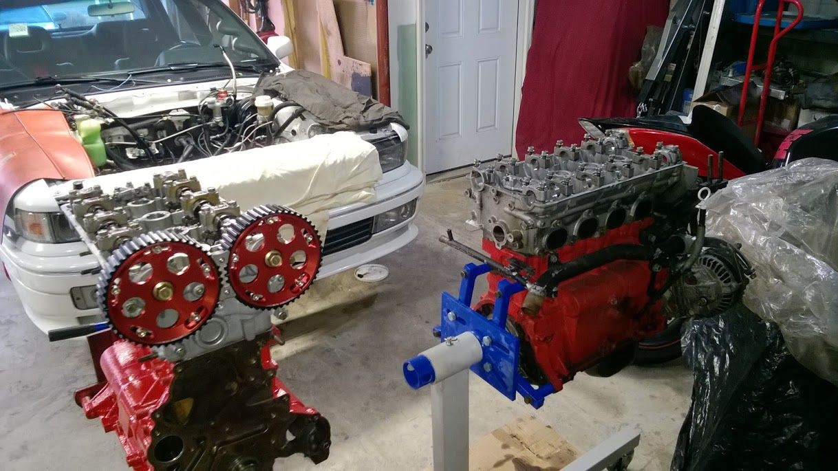

Motor dropped in.

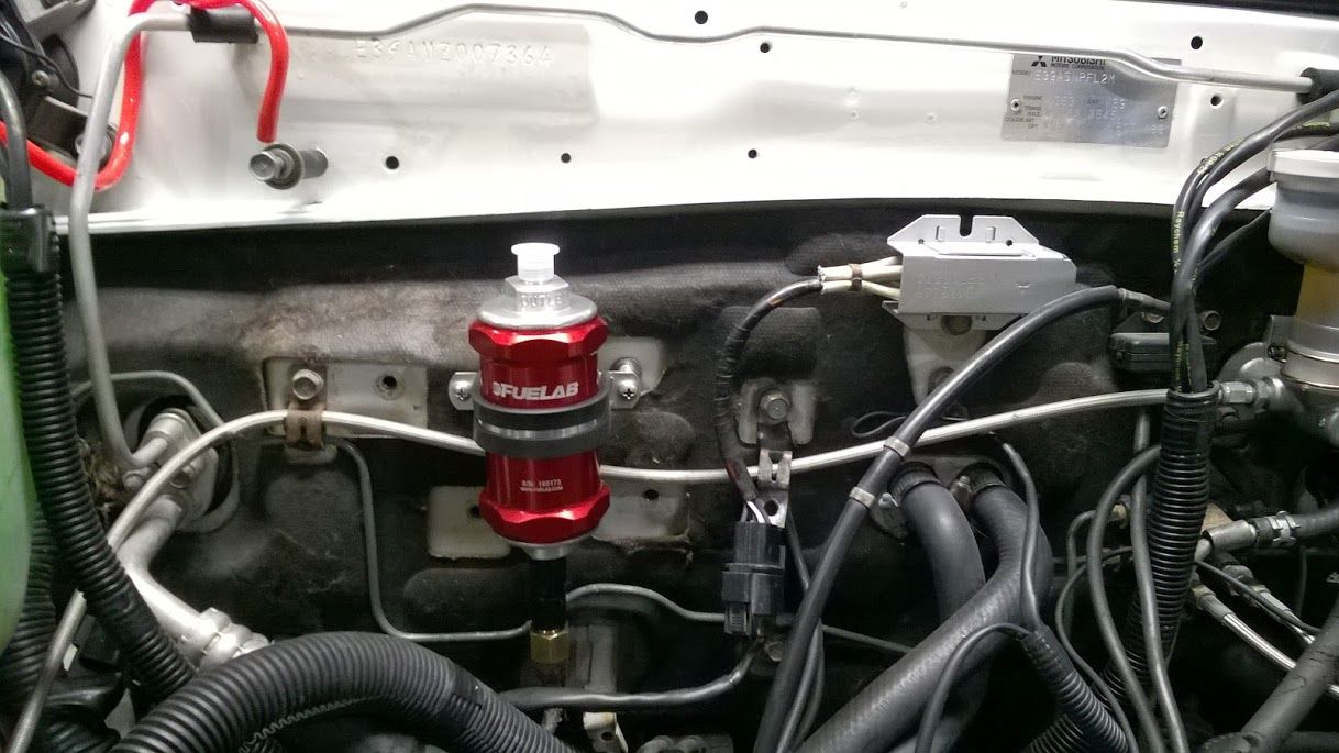

New Fuel Lab filter setup.

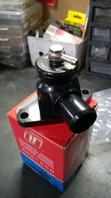

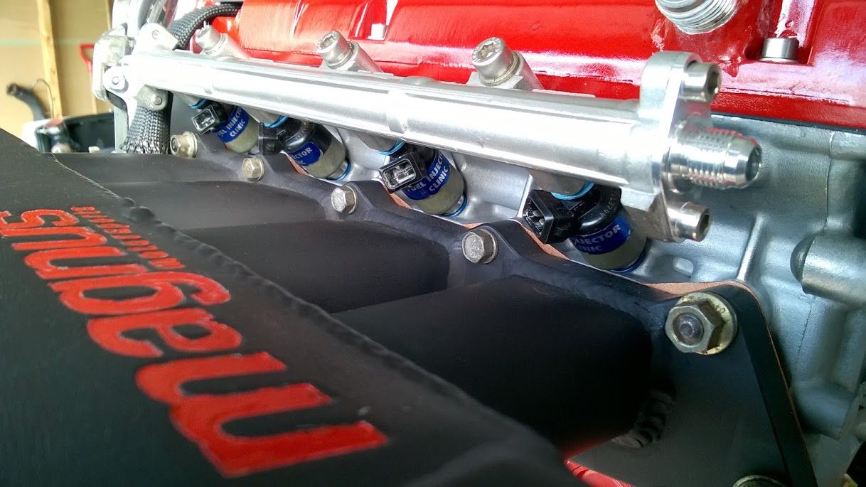

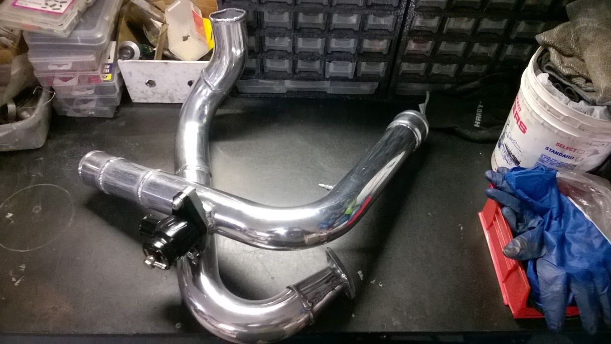

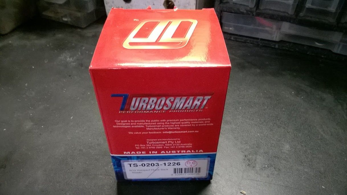

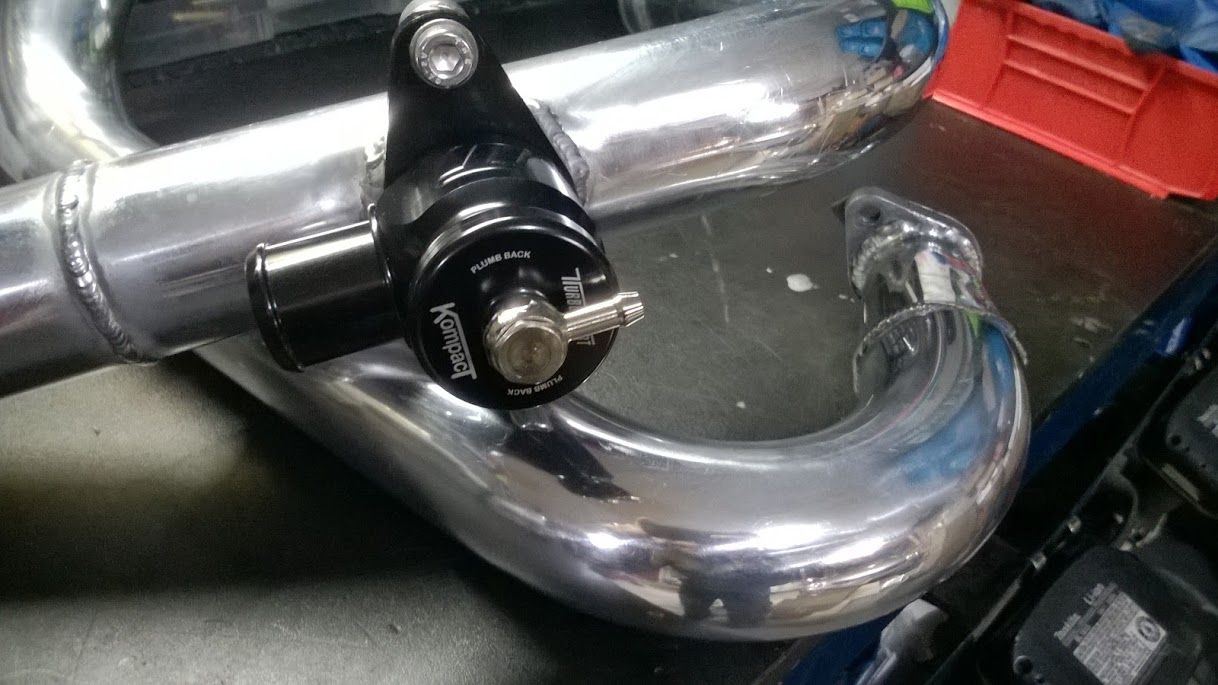

New BOV bolted up to the badass short route piping Sal @ Street Side Motorsports made for me.
d5ayl2YX5oLQfC4fnmxoWK-TKvXrz7v-6PeLfx05H73FMUi0rJfbC-0Me54xG90IHeuhS1z6qAguWbb77O=w1218-h685-no.jpg
c-EFiMm2e5dPbUsKR4cjfheIUDYrKUfLnuP3ArlfPqAdtG5g_BxYc5Mv-Jv448heDQLReyrwhtF7pSx6ygA=w386-h685-no.jpg
AmPWJvQAre-I4EKyB5dID393DFV9kEnISbRfvljBB0t6r2Amwp4qH3RDZKZ5SBMEDVGQZhm0x3O2LCMriG=w1218-h685-no.jpg
2XQ6cHgzDAy3dPI9QUPEiyRjQp1XZNfGPT3yf9okoK2X3IrWkuEQ33Vl21jTIJdB8FepS6HKh1XuVR_TRk=w1218-h685-no.jpg

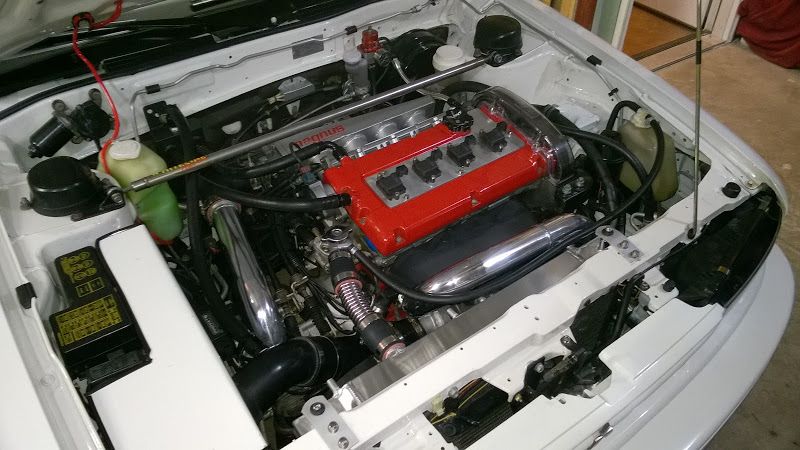

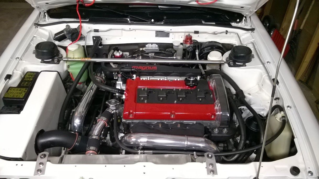

Final product.
uEGoOWPtQqwBUV51D1B3a3n2VmWPWqBRTbfQlspe3JCrxyla2jLpJIt924wHJyef3nILIb261j8tApwK28=w1218-h685-no.jpg
Onw8YEB1vEFRvt8wqSsH3P-EVQ9sn_k3aYojuG6aGdI-6D_fC8wl3iP_9bo1E_fX4rAKb3Jv1fEYliKh-_=w1218-h685-no.jpg
4OcZs_vabbBRvzWkqZIrcoiNghY9XbAybLFilf0KOX00Pskn6gfCQitC6hLo2IB_QO479R2VJNE4_yFON7=w1218-h685-no.jpg

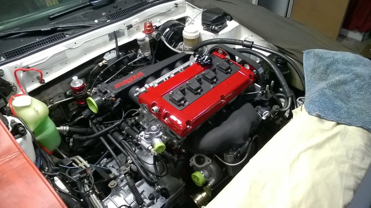

Sooooo after all that, yesterday, I primed the motor, topped off the fluids and did a preliminary compression test. I got 150 psi on cylinders 4 and 3. In the process of testing number 2, the compression tester hose exploded. I guess that's a good sign. I finished the test with the little stopper insert, and got 150 psi across the board. I kicked on the fuel pump via ECMlink to check for leaks, and all good there as well. So, I cranked up the motor and it fired right up. The car ran great! I wanted to finish the breaking today, but it rained. Go figure. I'll update this again soon when the motor either blows up, or breaks in just fine. Least if it blows up, I'll know who f***ed something up :|
The car isn't done, and I'm not sure it will ever be. But I'm happy with the current status of the build. As long as it end up running as good as it looks, I'll be satisfied for now. Additionally, I needed to get done with 1837 so I can shift my focus to 820 and 1546. Both of those builds need some serious work.

Awesome broskie!! Any reason why you use a 2g oil pick up instead of a 1g? I'm currently building and had the choice of either, so I'm curious.
The 1G pickups have been discontinued. So, you're stuck either finding a used 1G pickup, or buying a new 2G version. Additionally, since I have ARP main studs, I'd need to hack off the bracket on the 1G pickup. The general consensus from the "in the know" crowd was that a 2G pickup on a 6 bolt wouldn't hurt anything, so taking all of the above into consideration, I opted for the 2G version.

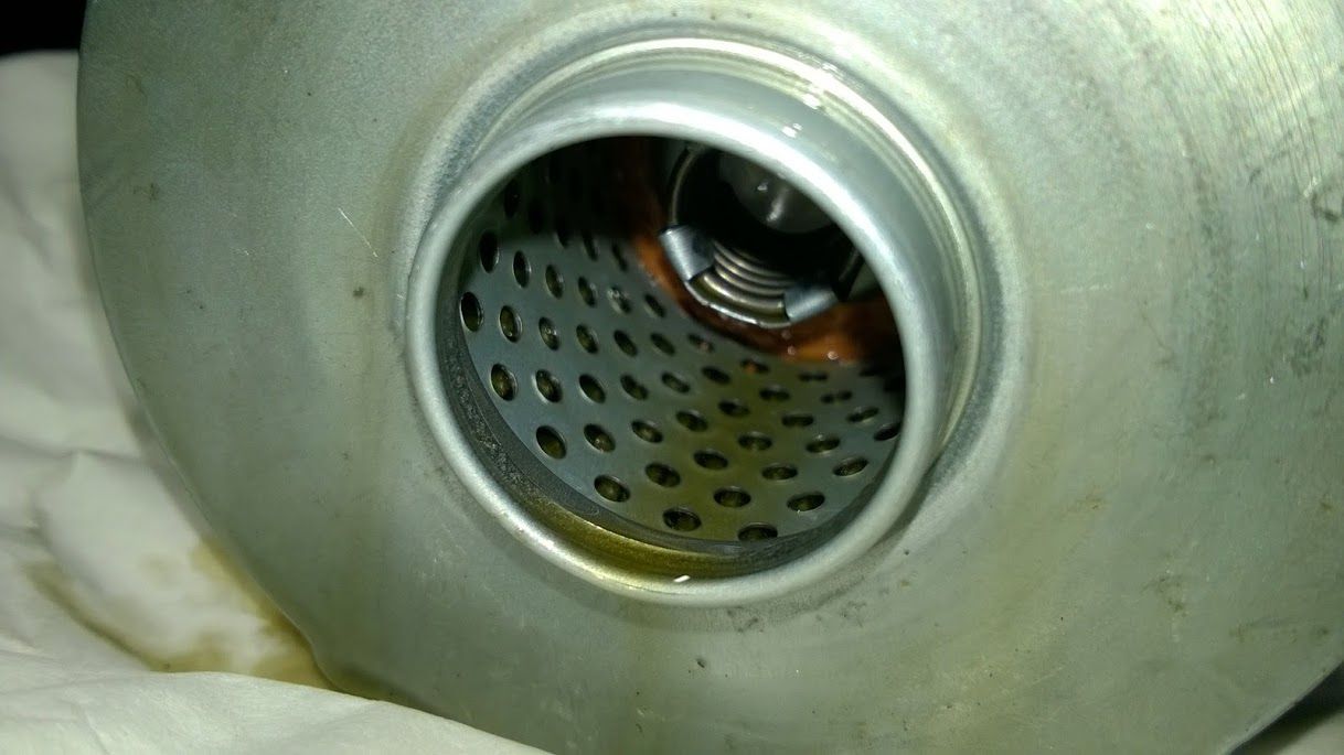

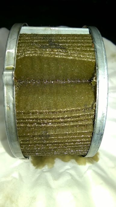

The oil looked great, and I cut open the filter, which looked great as well. No metal or any other shit, just super clean.

She sounds great!!!:thumb: Also, loving the oil gauge mod into the cluster.
Thanks!

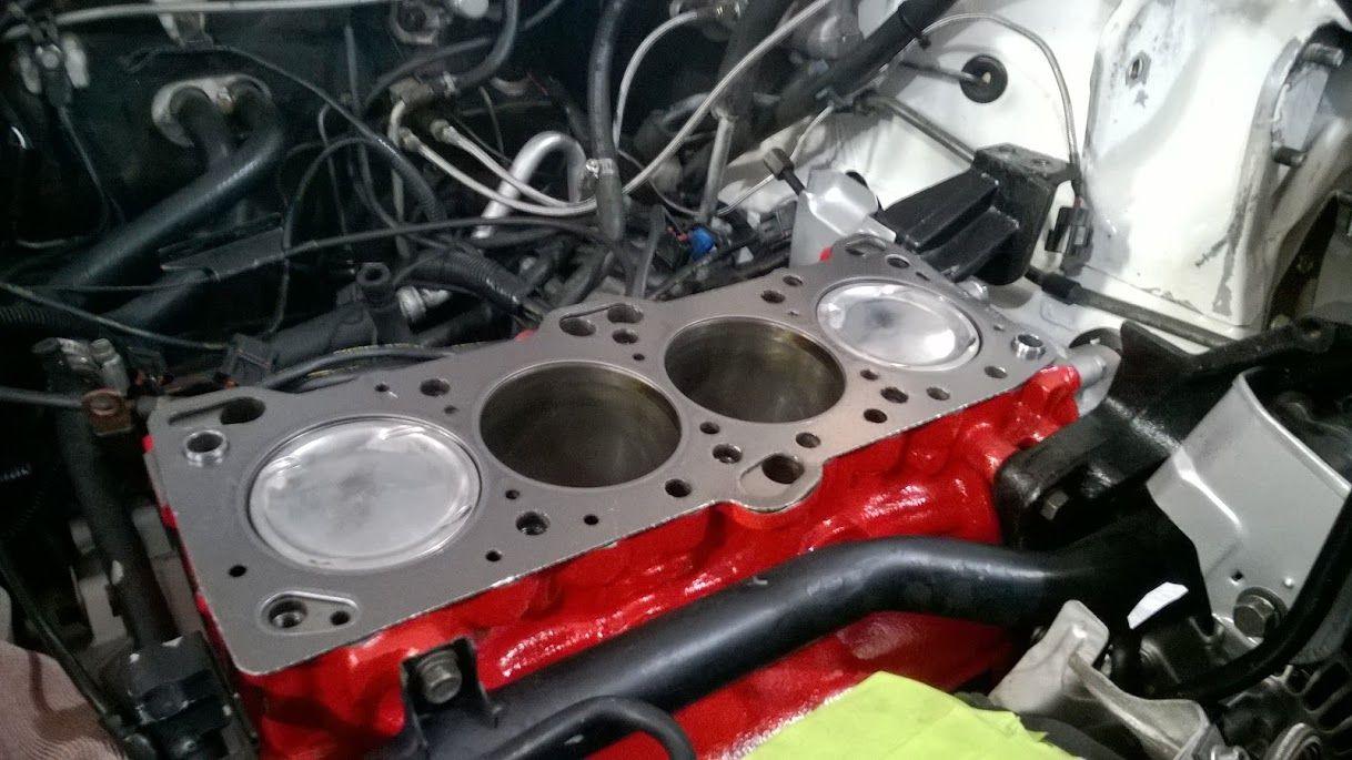

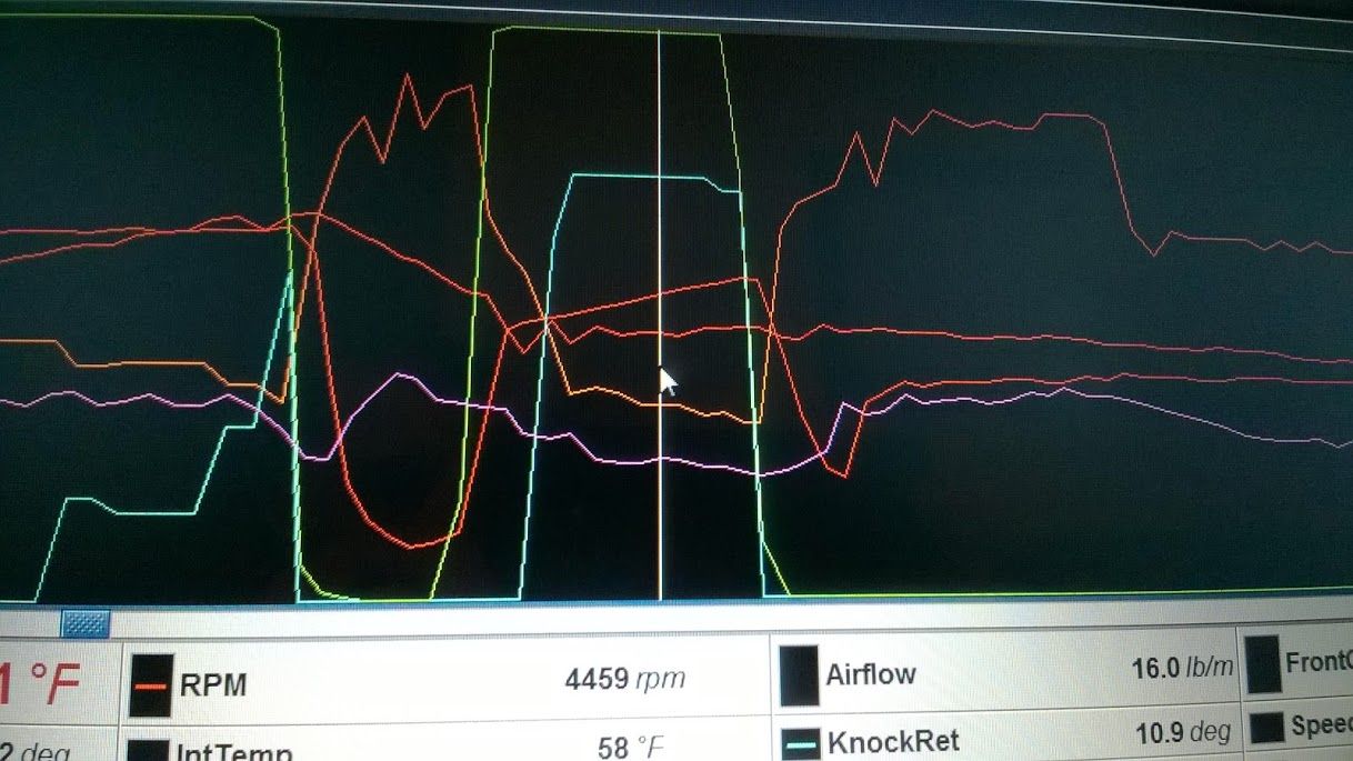

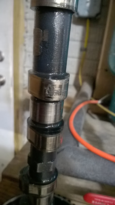

The motor was running great, so I decided to do a little tuning. I needed to start with adding some fuel, since my WB was reading around a point too lean. I set my knock light to two counts, and made a pull. The car pulled clean to redline, with no knock. I zeroed out the boost controller, so the car was on waste gate pressure, which ended up topping out right at 17 psi. Even at 17 psi, my first impression was the 68HTA wanted to pull way past redline, whereas the 16G variants I've had on the car previously would choke up top and drop off peak boost. The car felt really strong, and I was super happy with how it was running.
That's when I had a little hiccup. Mistake #1, not paying attention to the dash...
fDGv9uPvNcr5c74fZUZEitd9fmK0rQvtgSPSCZ-fMRPV3CbEgSasU6JNxdDU_GNR8tRTAvFMduHkWGv5VQ=w1218-h685-no.jpg

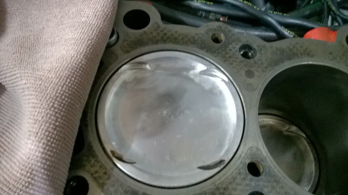

Next thing I know, the car dies, and I coast to a stop. I cranked it over, no compression.
So, I towed it home and roll the motor over by hand. The cams line up perfect, but the crank is way off. I pull the head, and as expected, I got 8 bent valves out of the deal. Cool. Here are some pics of the carnage.
MS8B4MkNnZu9rLjrXqG6EaMyWMFzz5LkMHSvroEATw6TNugfAfNcuYaRIzIGq9OIMCIxISB3L69L8GOgFg=w1218-h685-no.jpg

The pistons were alright. I cleaned them up a bit, and said f*** it, since at this point I had nothing to lose.
Q9c25a80RPtbXFNiA7P_zdeAkGCG110r1j3ugdreJ-4DS0Pzr_kIRpHYAwwNYZE3AikyeliOWzuG7584Tc=w1218-h685-no.jpg
SN_SSbXIJhETCKFsVg2ORzl99d5vFShTYy6w1zeATZl6O0-Jq0SL11y0ASQZiMJG8o2bQOVA-d3bVIsZxI=w1218-h685-no.jpg
Then, pulled a spare head off the shelf and swapped it in.
Y2BU9Rh8CH5jYVSRmel1W2j3gbNvsQgdOACNJMVzNU-R2TYhzsqO4xV-f3rjRoj4z9-1eiK064VeKgIY8e=w1218-h685-no.jpg
bHNxACttOiS6QrkkEAMJYKMIw8xYI_O4SgHnjNF3p6NNnWCebubn_3LIy_iCcPYFHEAdCqmvq6nIVShnhI=w1218-h685-no.jpg
UksvlavNKPYEnQ6j3siIXipCPGwgzT2HCqINLIOBdQ3cttP3OX3ZCZ-tLyTRbWhkRA-1dQ7RcQmOAc5zZ4=w1218-h685-no.jpg
I couldn't source an HKS intake cam on short notice, so I decided to swap a stock set back in. Jesus, I forgot how good the car idled before I swapped in the 272s! It purrs like a kitten.
Anyways, after a short hiatus after the long hiatus, the car is back in action.
Next up, making the swap back to E85, and seeing what the 68HTA is capable of.
By "dash" I mean I should have been watching the CEL warning me that the car was detonating.
I can't wrap my head around what happened. I suppose PTV clearance could have been an issue. Admittedly, I didn't check it when I assembled the motor. In addition, my intake cam wound up being 4 degrees advanced after I degreed the cams, so whatever the PTV clearance was inevitably got reduced. Even if that was the case though, I don't see how the car can run perfectly one minute, and eat all 8 intake valves the next. If PTV clearance was the issue, I'd think it would have bent all 8 valves on first start.
Regarding the timing, I'm positive the car was perfectly in time, and the belt was tensioned properly. I can say that confidently because A) I've done more 4G63 timing belt jobs than I can count and B) I verified it was good when I degreed the camshafts. There were no failed timing components, and nothing to suggest something failed and caused the belt to lose tension. Hell, even after the valves got bent, the belt was still tensioned perfectly. And, if the belt lost tension I think the cams would have been out of phase as well as the crank. But, when I lined up the marks after the incident, the cams were still in time but the crank was out.
There's only one event that sticks out between the car running fine and the valves getting bent, which was a shit ton of knock. How that causes what happened, I have no idea. All I know is it was good before then, which leads me to believe the detonation either caused a problem, or exacerbated an existing one. Those are pretty much all the facts I know, which I fully admit, still don't add up to bent valves.
Taking what I've outline above into consideration, I'd appreciate everyone's input. I'd would just be nice to know what happened at this point. This forced me to go back to stock cams in lieu of being able to find a replacement HKS unit on short notice, and honestly, I like driving the car a million times better now. Much like I despise my welded diff because of how it kills driveability, I'm feeling much of the same way about the HKS 272s...
...I'm wondering if the natural willingness to sacrifice performance for driveability is the true sign of getting old
I know for damn sure if this car was used for a DD and didn't sit in the garage 99% of the time, I'd get rid of both.
The car is currently back up and running great. I drove it around for about an hour today without any issues.
Yikes.. Well as you may know I'm still building. And I won't be relying on the notches for correct mechanical timing, instead I'll be using travel dial gauges to calculate actual vs expected.
I fear the probability of such an event to much.
It's difficult to say, but your knock may have propelled your rotating assembly out of phase.. Yes its a stretch but how else do you account for mechanical disproportional timing? Unless you floated? What RPM were you in again? If at the 4.5k range I see then perhaps back to my first hypothesis.
Or............
Your ptv clearance was within spec not accounting for thermal expansion... Maybe you heated enough to expand past limit.
