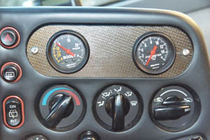

I've had a few different setups over the years. This is the current setup but I'm about to change it as I am going to add the heater system back into the car and reinstall the HVAC dials into the OEM locations. The new setup is going to use a dual carbon fiber center vent from eBay seller NiKoCarbonWorks. What I really like about this one is that it bolts in vs having to glue it in like some I have used in the past. With the new setup am planning on only running AEM wideband and boost gauges and a small voltmeter in the factory AC switch location.
resized_20240323_140833-jpeg.726099
I had the upper vent method myself for a while but I made my own plate out of 1/8" Lexan and painted the screws black. Cheap and saved me from faux carbon fiber.
Perhaps I should have cut vent holes in the middle, but I didn't have A/C and didn't drive in the winter, so an open window moved more air anyway. Just blocked the duct by stuffing a clean rag in it. I'd say it was a reversible mod but the duct had to be cut back quite a bit to fit the gauges. Probably should have removed the section instead but I was young, impetuous, and not like much else could be reversed to make it a regular passenger car anyway LOL
That clip is a great idea but I always found those A pillar gauge pods blocked my view so I went the vent route.
I had a carbon fiber test panel from the F-117 Nighthawk my brother-in-law had given me and I cut out a bezel from it. There is a possibility that is the most expensive part on the car, thankfully I didn't pay for it.
I was going to drill some holes to let the vent still function but never got around to it.
