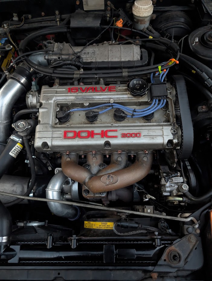

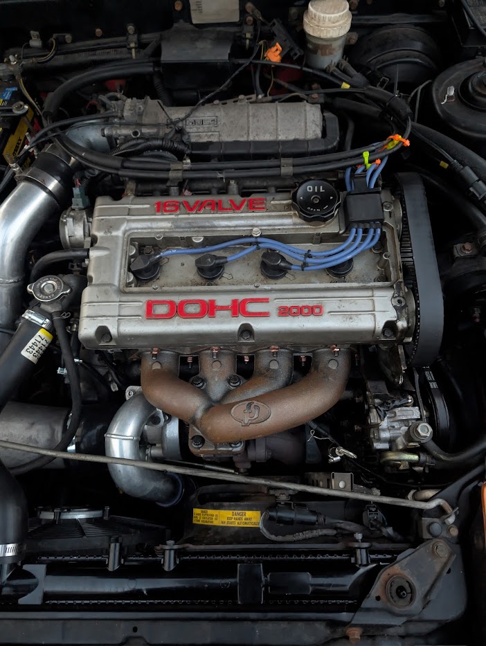

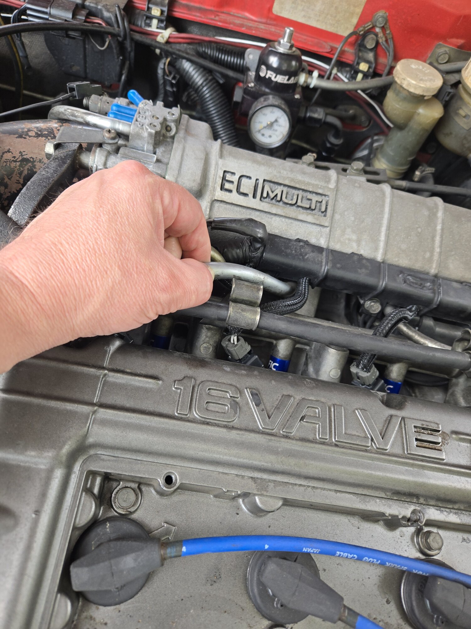

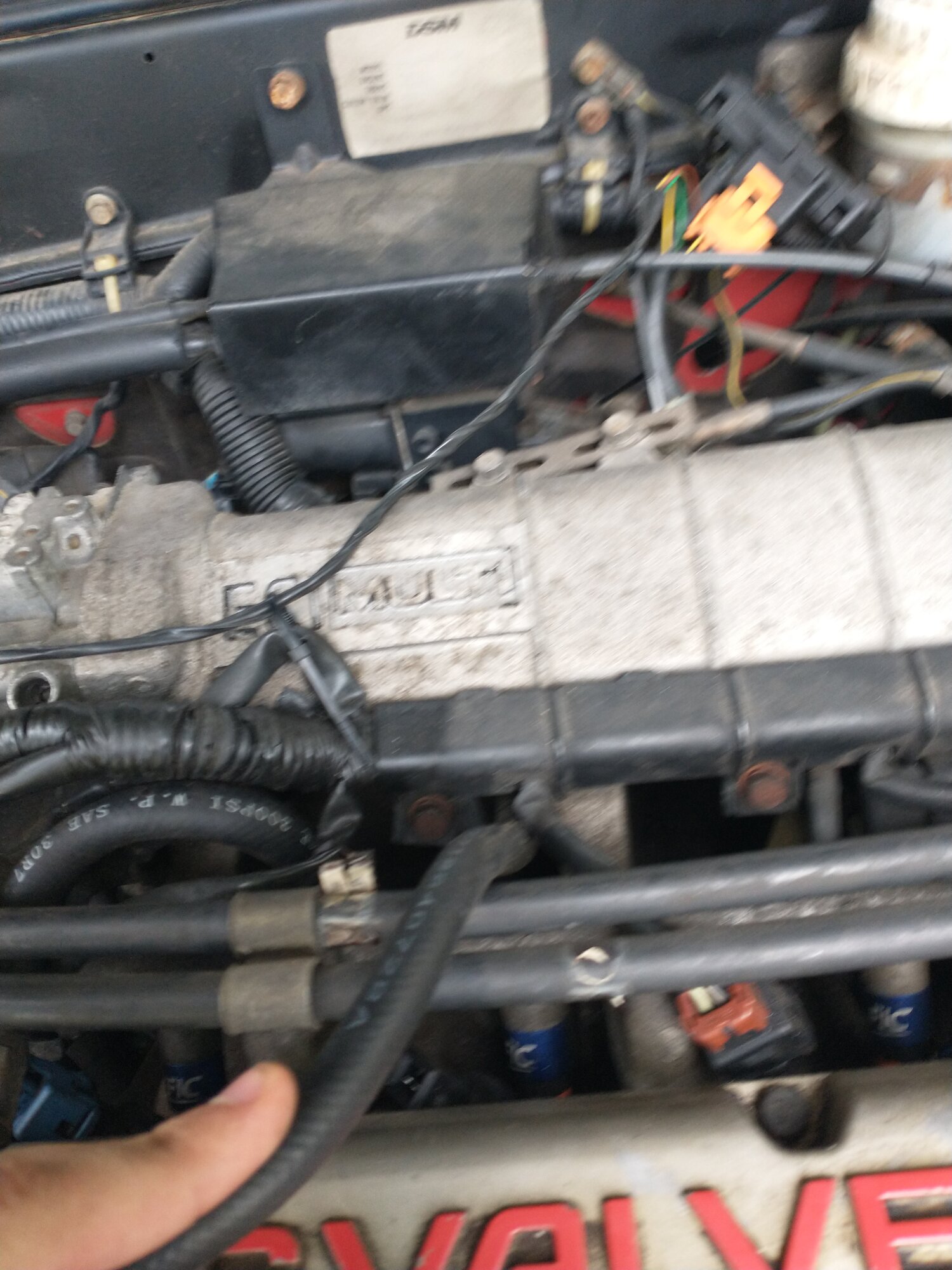

Yo I'm genuinely losing my mind over here. I'm trying to find the nipple for my BOV since mine was NOT hooked up properly. I think it was hooked to the EGR system? I don't really know. I just know it wasn't correct.
But I can't find the right nipple to attach the line to. I've read "oh it's behind the throttle body" but I only see one line and it's attached to a mountain of stuff and I dont even KNOW what it is (I'm still new to working on cars).
So does anyone have a photo of the nipple and it's location? That would definitely be the greatest help.
I also discovered that there are a ton of missing lines and things that aren't capped off, so. gonna have to do some research and figure out what each is and if I should just cap them off.

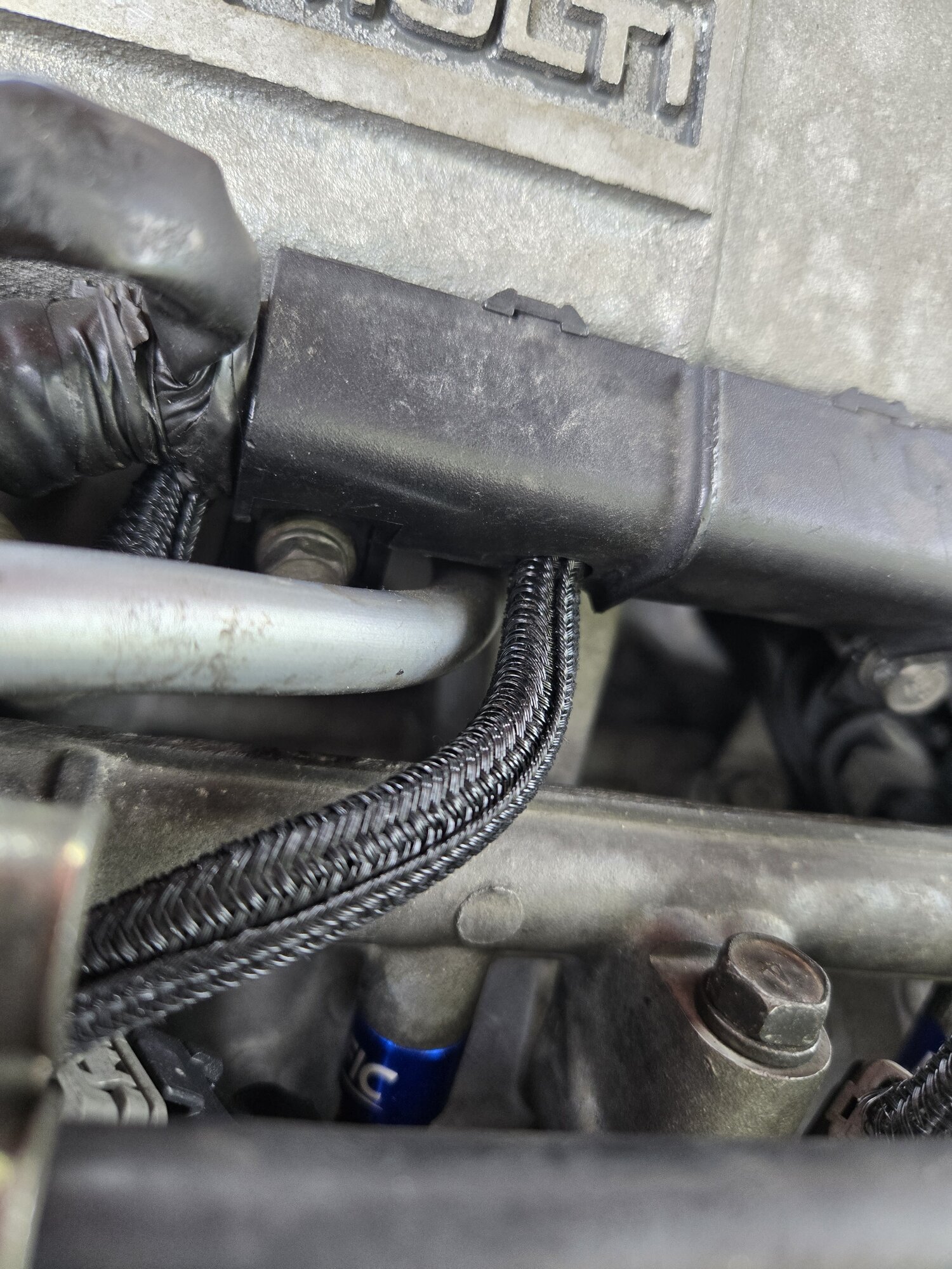

This silver silicon hose on my 1g is the BOV line. The nipple can't really be seen because it's under the wiring harness on the intake manifold directly behind #3 injector.
THANK YOU!! I've been going in circles and looking everywhere. Once this rain clears up, I'll start digging around there tomorrow! :thumb:

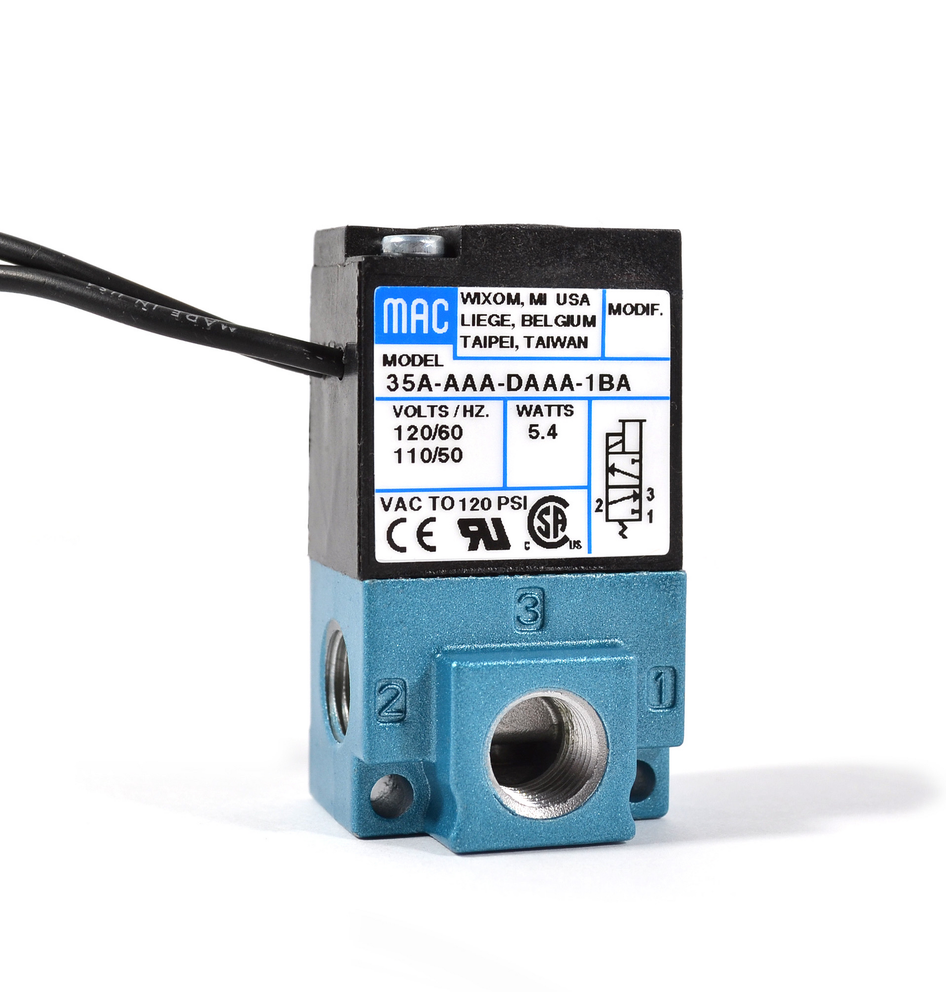

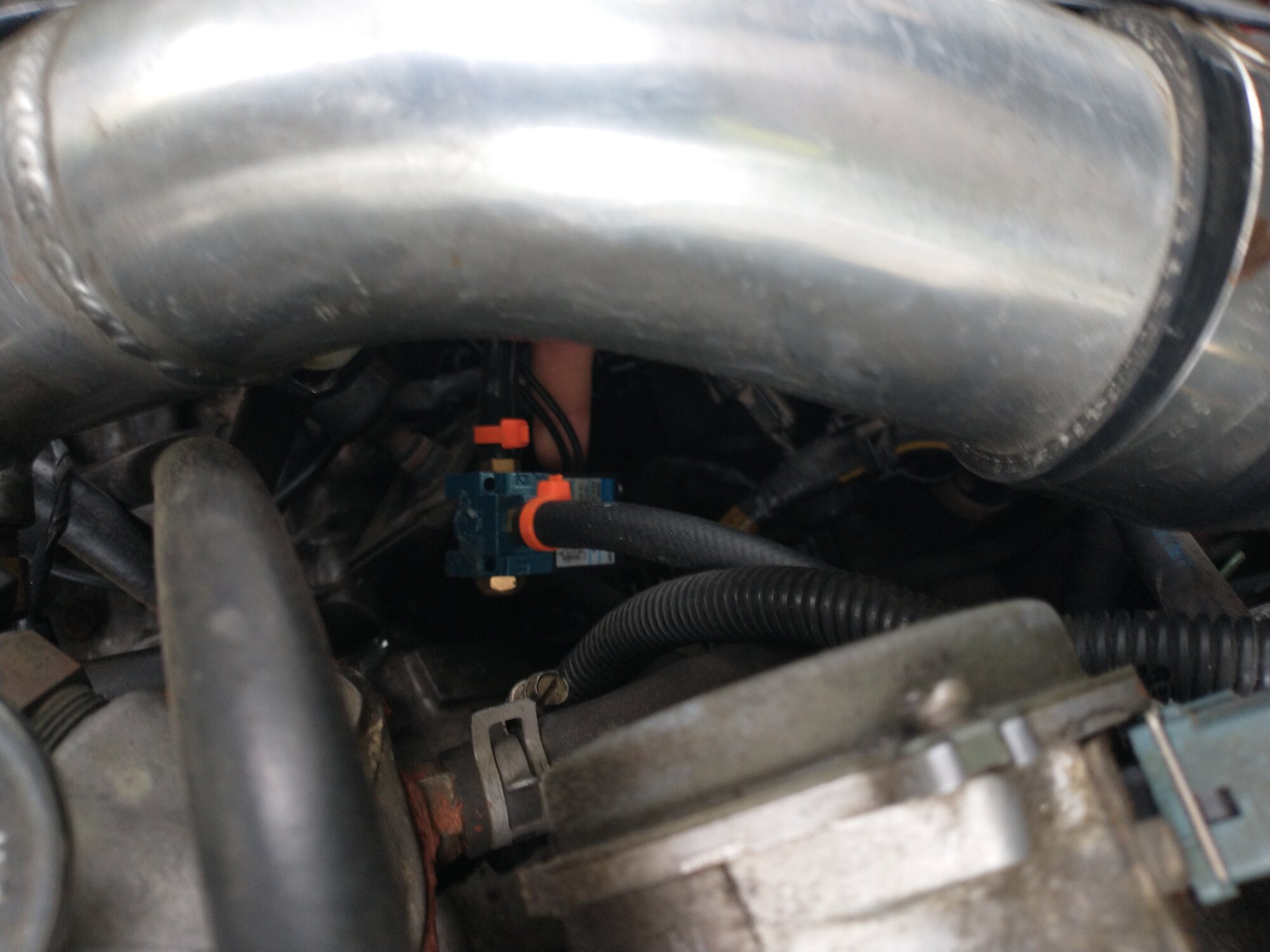

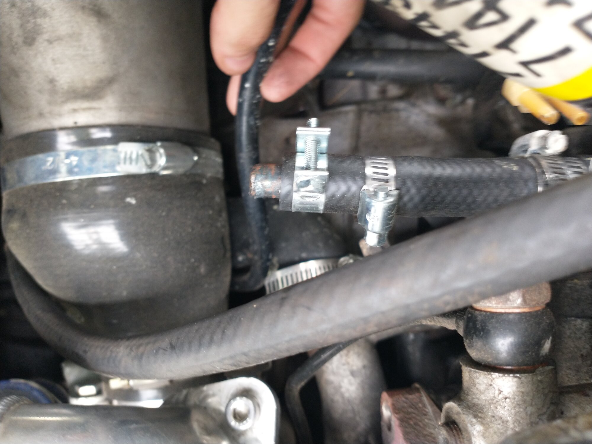

Okay so by any chance do you guys think the reason I can't find the nipple is because it's already being occupied?
Is that blue and black box for ECMLink or maybe the EBC? Is the line going back towards the turbo recirculating the boost??
I'm losing it, I'm new to turbos :cry:
Okay so it seems to be hooked to the boost controller and logging, and the other line leading to the turbo seems to be part of the wastegate or something.
Should I T the line leading from the throttle body to the EBC or is there another nipple I should attach the EBC/wastegate to?
Your boost controller should be on the turbo side of the throttle plate. The stock location is on the j-pipe directly off the turbo. That's what I use.
The boost gauge should be after the throttle plate, so intake manifold or throttle body so you see vacuum too. Not all ports on the throttle body will work. I have mine plumbed into the "P" port on the throttle body. I've eliminated the EGR so I have all the rest of the throttle body ports capped.
BOV should be the port directly behind #3 injector like I showed previously. That's the only thing I have feeding from that port.
Fuel pressure regulator should also be connected directly off the intake manifold. This port is similar location to the BOV port, but closer to the timing belt side of the IM. A lot of people T off this line for boost gauge, but I prefer to keep this for only the FPR.
To me it sounds like you need a new source for boost control, so maybe A1 or A2 throttle body ports if you don't have the stock j pipe. You could keep boost gauge on the BOV line, but on a T.
Yeah three of the four are capped. The P port was what my BOV was originally hooked up to. I unplugged it and then the port started sucking air in.
And when you say boost gauge, do you mean stock boost gauge or aftermarket? I frankly don't know what my boost gauge is attached to or where the line is. :cry:
Gauge line or controller line? (Sorry if I'm asking dumb questions, I'm just genuinely new to this :p)
The stock boost gauge is just an ecu calculation based on airflow. It doesn't actually have a boost source. Do you have an aftermarket boost gauge, and if so, what is it (brand/model)? It might be electronic with a sensor somewhere. If you don't have one, you really should.
You could T an aftermarket boost gauge on the BOV line that I pointed out previously, but preferably it's own source if possible.
Investigate that blue/black box you found on what should be the BOV line. Might be boost controller. Does one line go down to the turbo (wastegate actuator)? It looks like a label in your pic hidden behind the line that could have a part/model number.
Do you have any ports on any of your intercooler piping or or somewher near the turbo that could be used for boost control?
Nah, just stock.
I'm saving for pillar pods, but I don't make a ton of money so it's taking a while :cry:
I'll poke around tomorrow, but I haven't seen a port that I remember.
Yep! TB -> Boost controller -> wastegate actuator.
And just to recap... I should plug the boost controller into a port on the intercooler piping if possible (does it matter where?) and run a dedicated line from the TB to the BOV?
