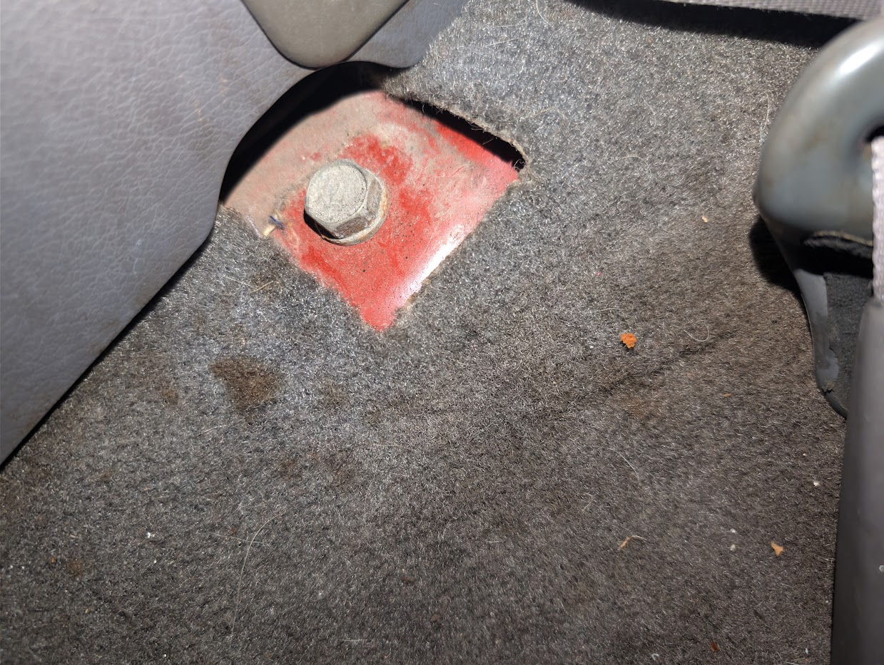

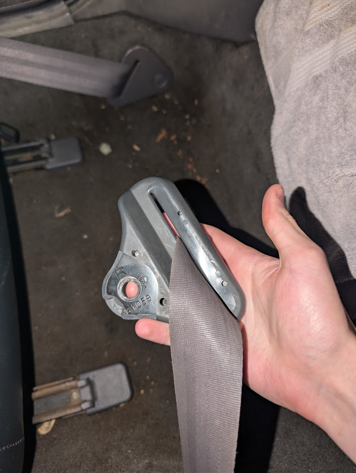

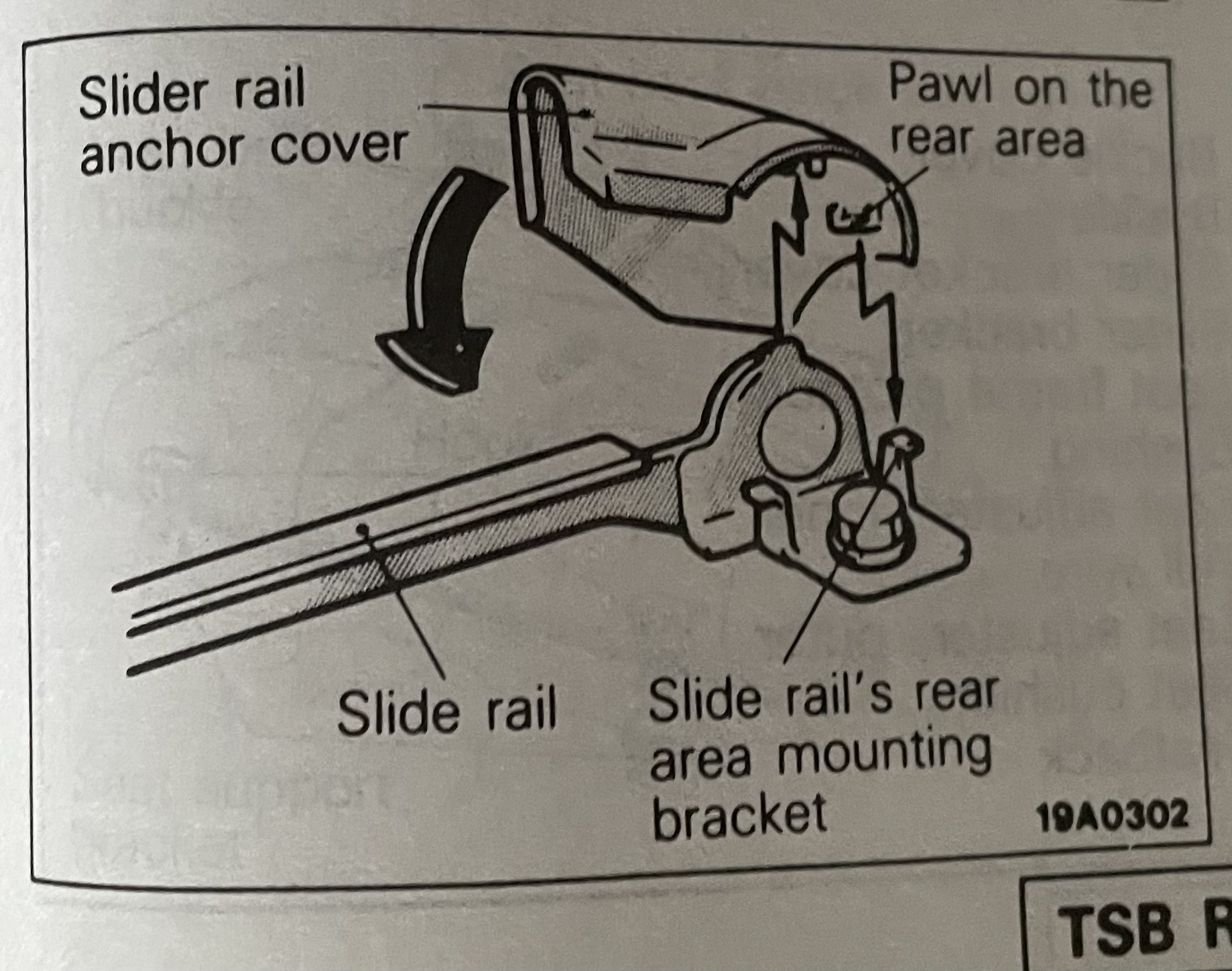

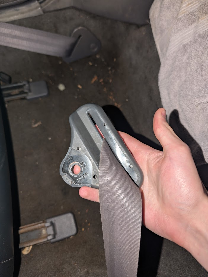

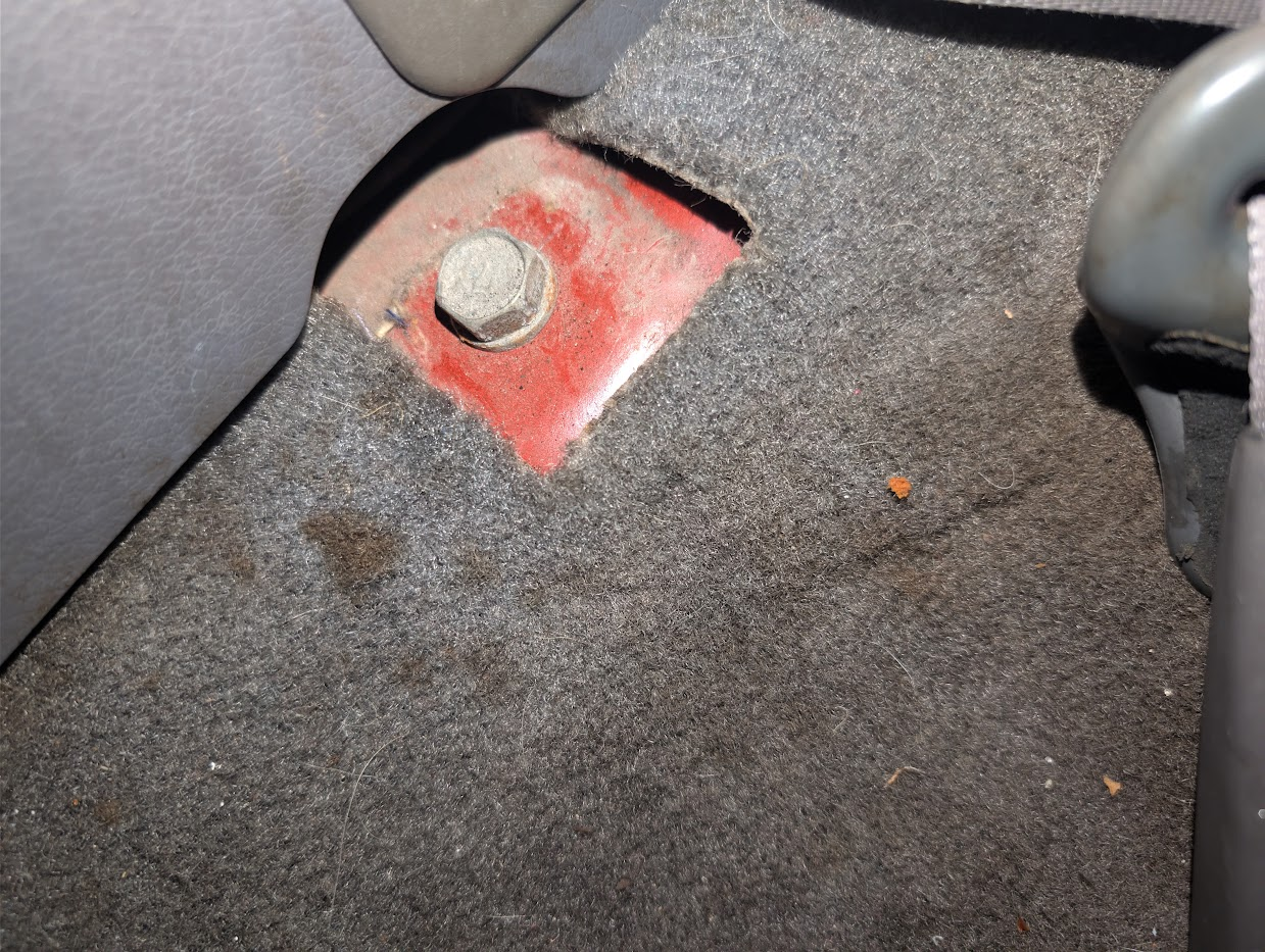

Also, the auto seatbelt bracket/anchor in the rear is unbolted... I have literally no idea where it goes. There's a bolt and cut out piece of carpet that looks like it's where it goes, but it bends the belt in weird ways when being placed there. Gonna do more research and try to figure it out, but hopefully I don't have to remove the seats. :hmm:
Below is the passenger side, but it's the same for the driver side. :idontknow:

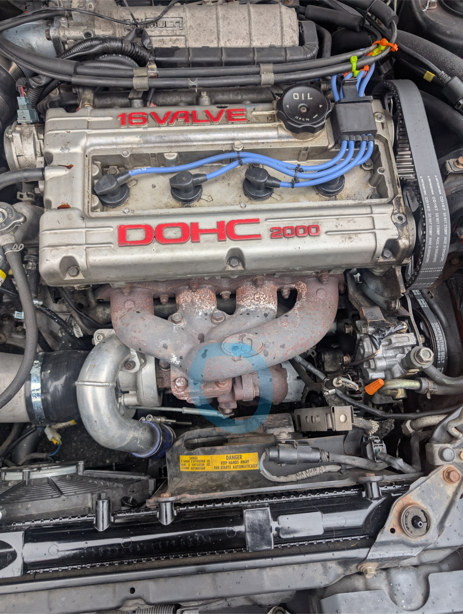

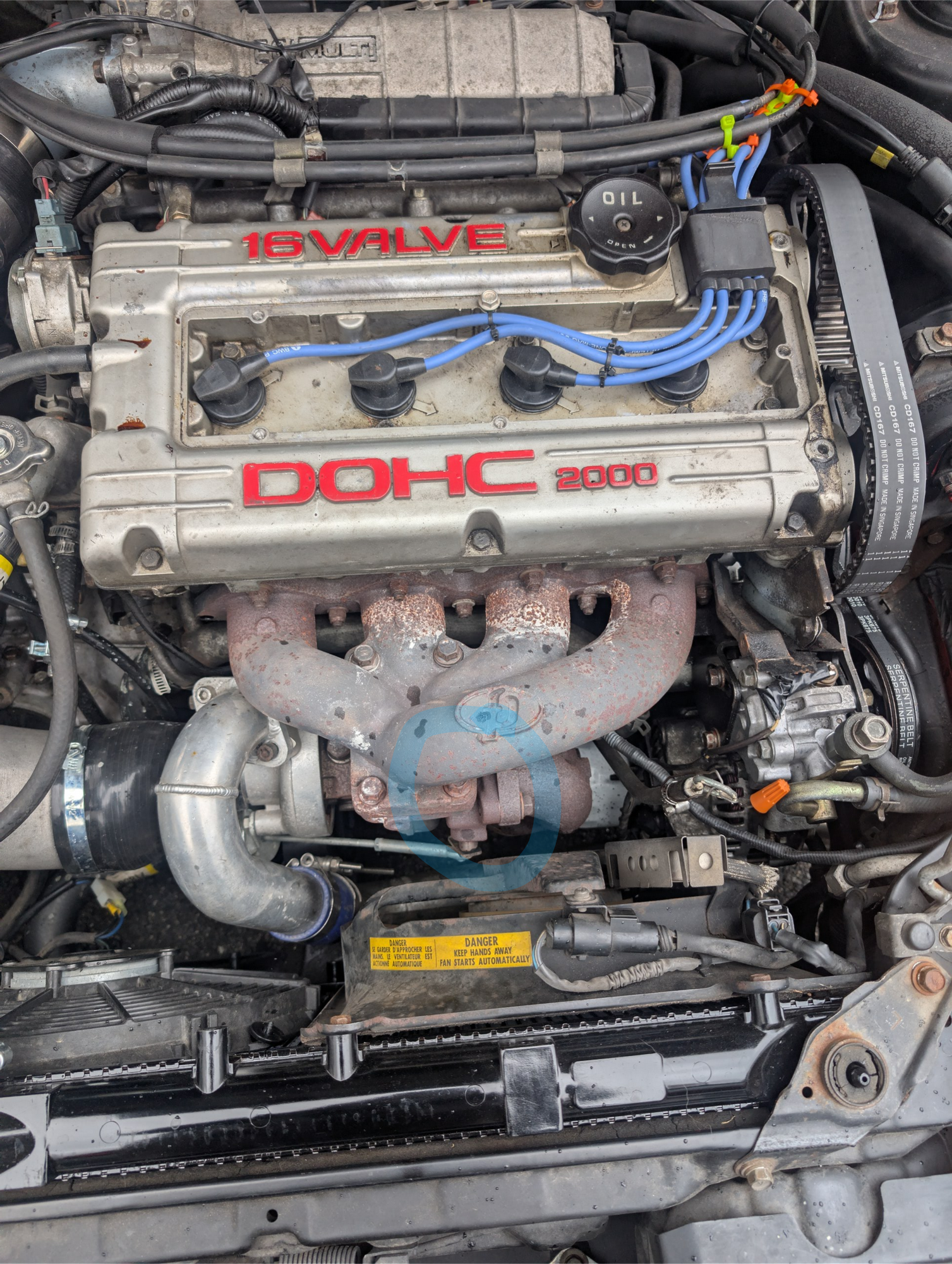

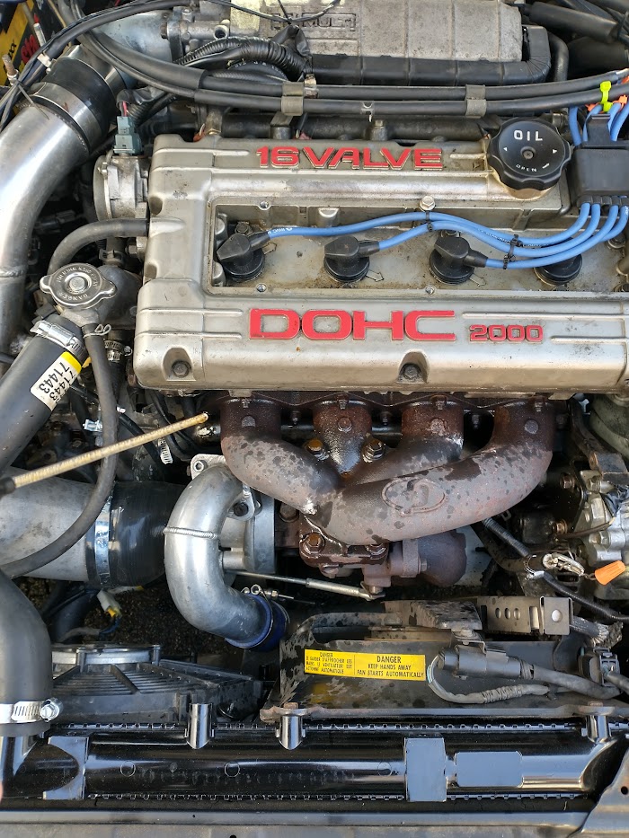

Missing a bolt on my exhaust manifold. Soot is covering that part of the block. I'm hoping the manifold itself isn't warped in any way, but if it is I'll have to replace it. I spent all my money on the car, I forgot how maintenance heavy DSMs can be. It's also blowing white smoke out of the tailpipe, but I'm almost completely sure it's NOT a blown head gasket.
Once I have some downtime where I don't need to travel, I'll pull it apart and figure out what needs to be done. I might have just enough money to afford the parts I need, but I'm just praying that I don't uncover more once I start fixing stuff. If there's anything else I need to replace, I won't have enough for my insurance (which is stupid high since I'm 17 with a sports car) :banghead:

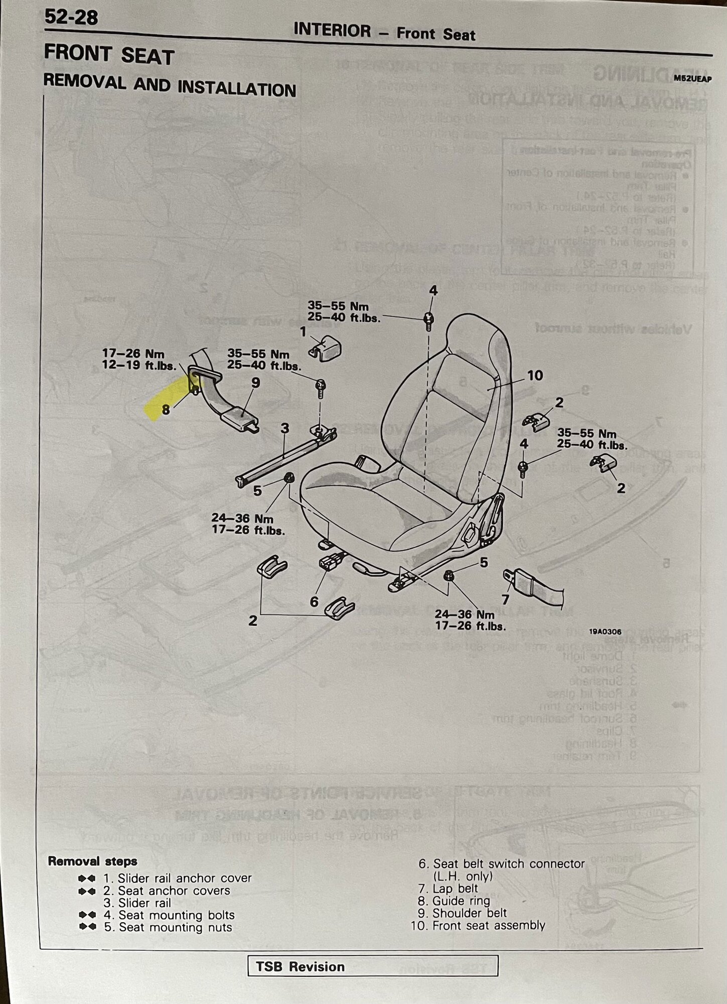

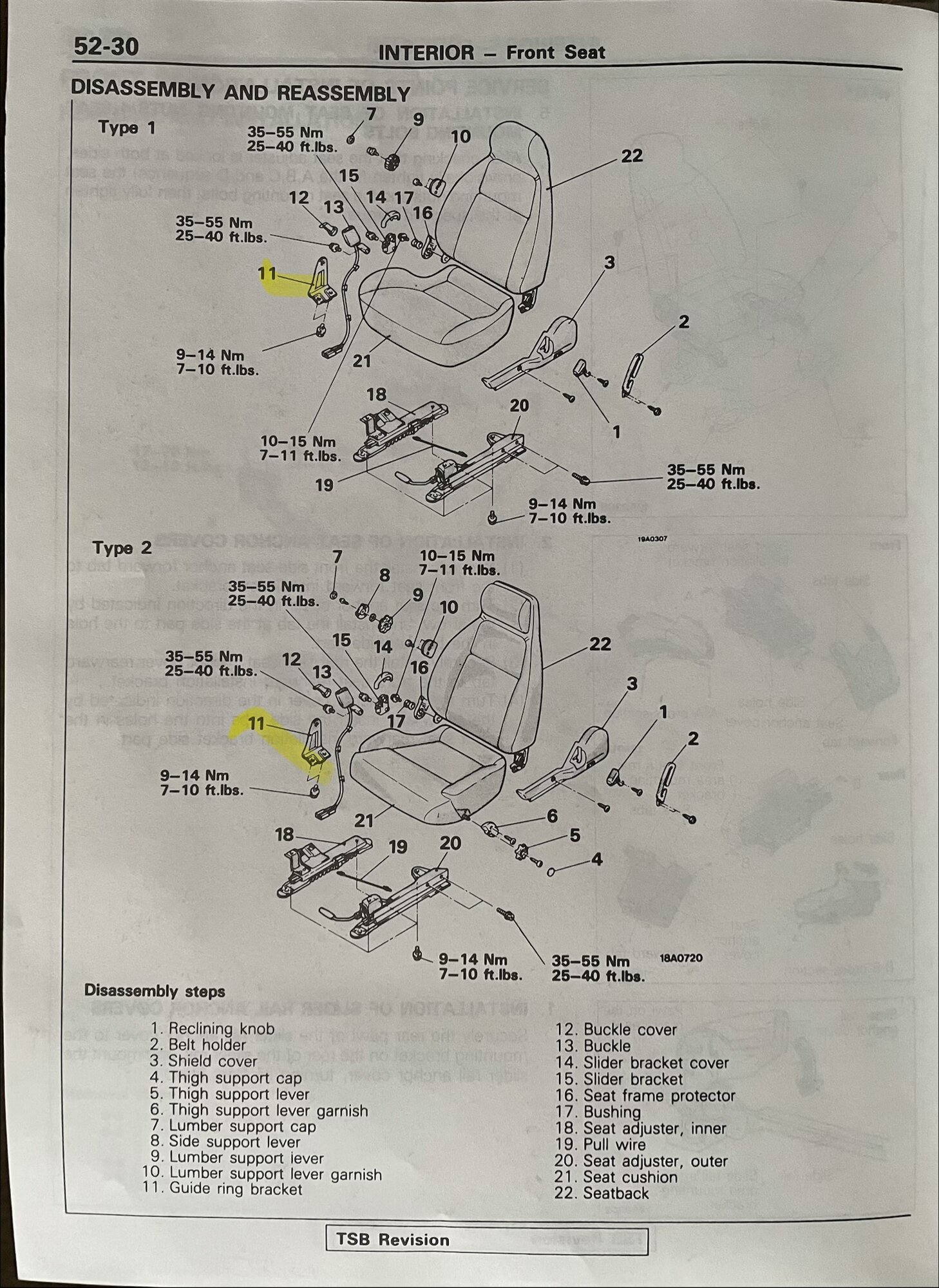

You probably got there already but in case you haven’t…
The part in your first picture is the highlighted #8 in the below. It attaches to the highlighted #11.
The bolt hole you pictured is to anchor the slide rail, #3 in the Front Seat Removal and Installation page above.

I have a bone to pick with whoever put a bolt underneath the headers of this exhaust manifold.
I don't have any way to get it off because we barely have any tools in this house. I got 3/4 off from the turbo to manifold, but this last one is driving me up a wall.
I don't have photos of the bolts off because I was in a rush and didn't think to take any photos, but this is the bolt I'm talk about.
Literally how do I get this off with basic tools. :|
Any and all advice/input is ridiculously appreciated. The new manifold needs to be on before Saturday. I know I didn't have to replace the entire manifold, but I chose to. I'd be removing it anyways to throw the new gasket on, so I figured I'd replace it while I was there. That way, I know the condition of the parts I put in; no mysteries there.

Can you get a box-end wrench on it to crack it loose then use an open-end wrench the rest of the way? You'll have to loosen and remove the other 3, and somehow separate the manifold from the turbo, either manifold up or turbo down, to get that bolt out.
This looks easier than dealing with the OEM stud and fire ring.

I'll see if I can. I don't have a ton of clearance with the radiator, so I might have to pull it. The fan is probably coming out, if nothing else.
Unfortunately, I'm a scrawny 17 year old haha. So even if I can get the box-end on it, I might be physically incapable of cracking it loose. We'll see, though! :p
Thanks for the insight! :thumb:

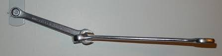

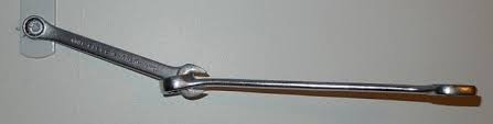

It's all about leverage. If you don't have a pipe that will fit over the wrench, you can lock two wrenches together like this:
Sometimes a dead blow from a hammer will do the trick on a single wrench. Penetrating oil is also a good idea on exhaust parts.
I've used a ton of penetrating oil over the last few days. I've been soaking it regularly.
If I can't crack it loose with one or with a hammer, I'll give this a try!
I appreciate it! :p

We’ve also had good results reinstalling all of the removed bolts so the pressure is less on the last, stuck bolt. And then we concentrate on removing the stuck bolt first.
