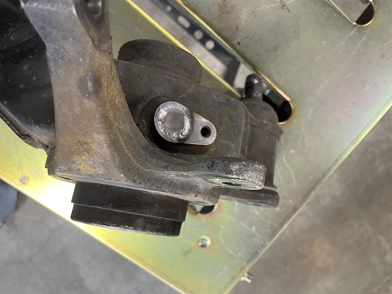

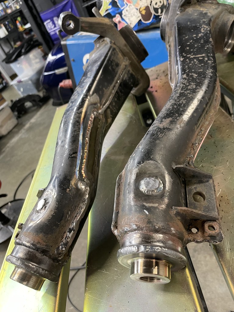

Got the rear control arms done, or at least the fabrication part. Still trying to decide if I should get all the rear suspension parts powder coated or stick with epoxy paint.
I got a rear toe eliminator kit from whiteshedspeed.com and I'm really happy with the quality. I cut off the pinch weld on the outside edge of the arms to make room for wider wheels, so I added some reinforcement to that area to cover the hole. It's probably overkill, but now I know I can fit any wheels I want.
I also plugged the ABS sensor hole while I was at it to keep water out of there.
Looks good i had to do the same thing when i installed my volk parts back there, looks good etch prime it and paint, or powder coat if you can.

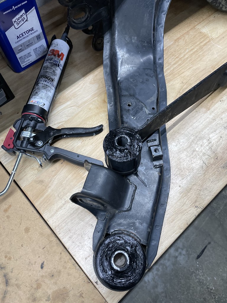

This weekend's project is addressing the rear subframe mounts. All the aftermarket options were too expensive for my budget for this car so I decided to make my own with good ol' fashioned 3M Window Weld. It has a hardness of around 60 so it should stiffen things up but not be too stiff.

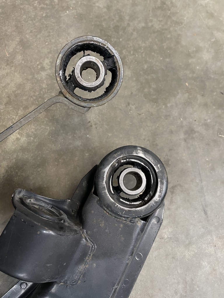

First step was getting all the dry rubber out of the old mounts but leaving just enough to hold the bushings in place. This was done with a combination of a drill, jig saw, and some stabby action with a flathead screwdriver.
Then it was time for the messy part. Wear some thick gloves if you ever work with this stuff, it's messy and is so sticky it will rip your gloves if they're thin.
Now we just give a few days to cure then I can sand it down a bit to look nice and get the subframe ready for paint.
It's a really popular thing to do with motor mounts, people have been doing it for decades. All of the pre-made options for these cars are $200+ so I figured for $30 and an hour and a half of my time I'd go this route. The Window Weld sets up pretty quickly (especially since it's raining so the extra humidity in the air speeds up its cure time) so I'm hoping to get the subframe wire wheeled, sanded, and ready for paint today.

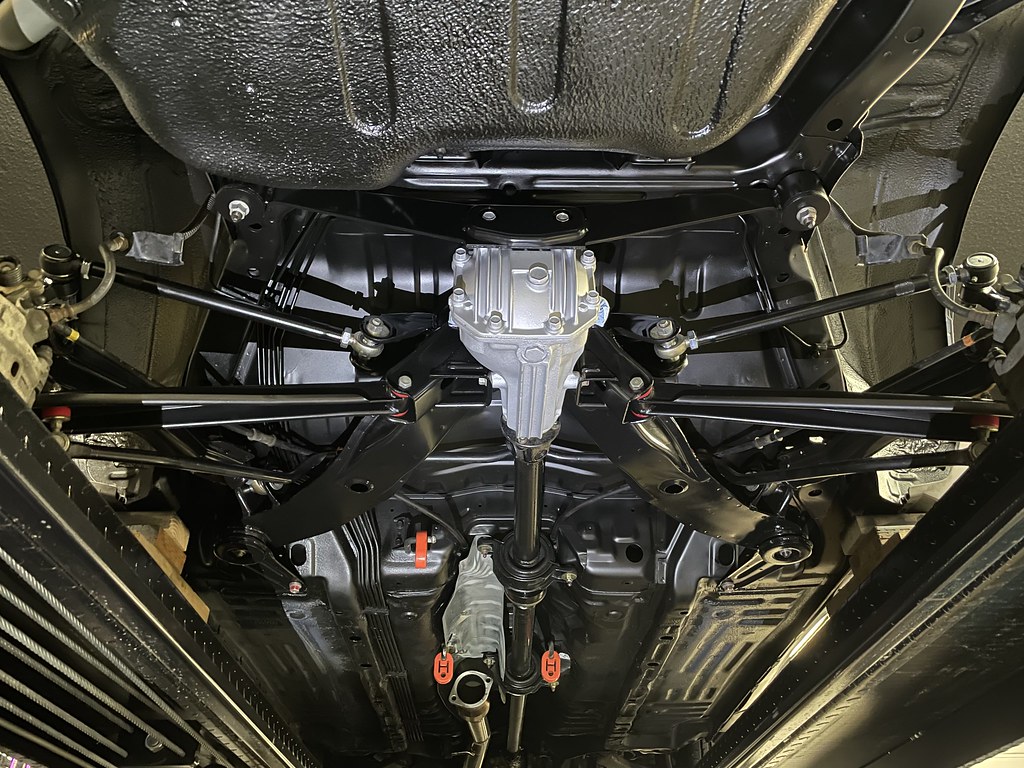

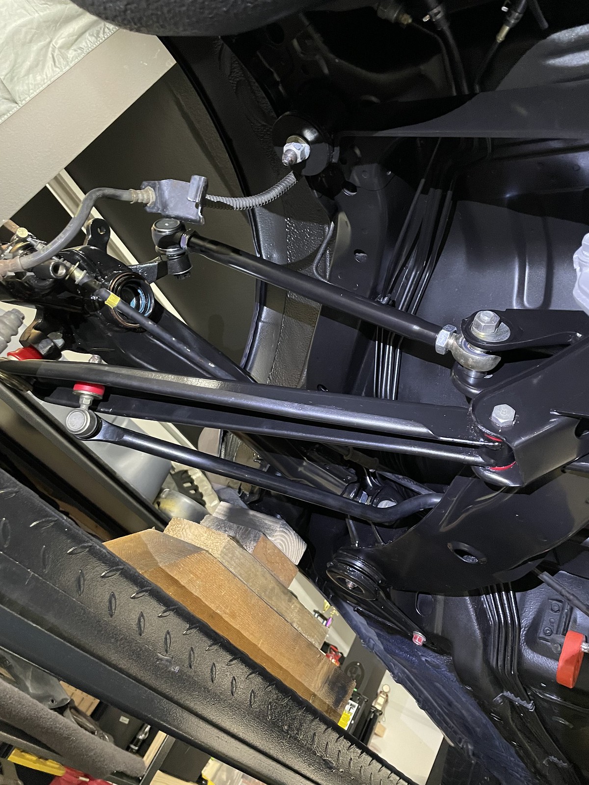

Everything is painted finally and I was able to the get the subframe back in the car along with the "new" 4-bolt rear end and the control arms. Holy hell, getting the sway bar hooked up was a pain in the arse.
Good progress, bad pictures.
Next up is cleaning up the rear brakes and rebuilding the axles.
I feel like such an idiot right now, but I'm also disappointed in all of you for not catching this: my sway bar was a huge pain in the ass to reinstall because I installed it wrong. I just realized it goes on TOP of the control arm. :mad:

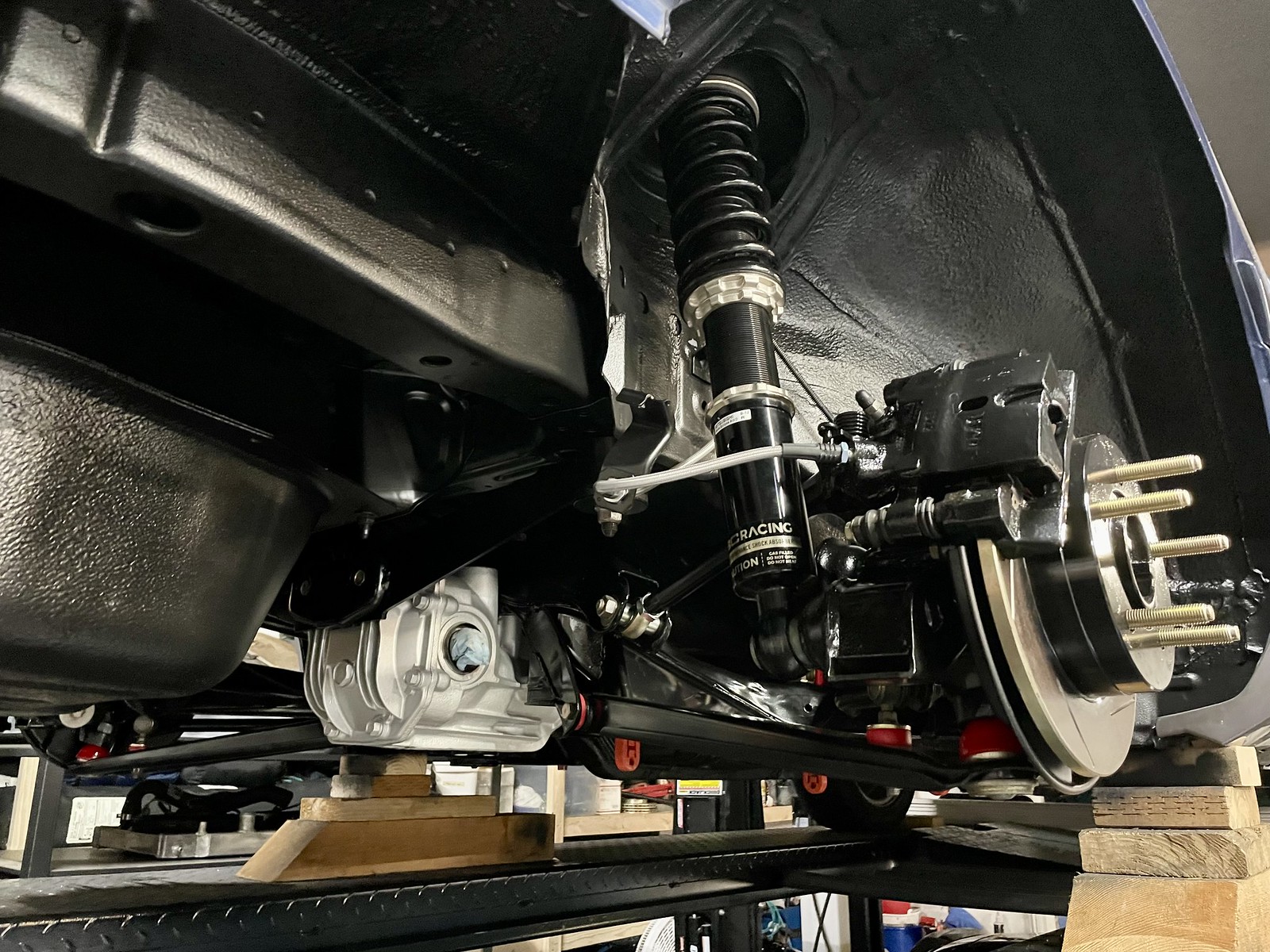

I had them on the car for around 400 miles before I tore it apart. For the money I'd say they are the best suspension option out there for these cars. BC has been around for quite awhile and have established themselves as a solid mid-tier option.
They are a popular option in the VW world, with most of the tuner brands (Subaru, Honda, etc.) and have been getting more popular in the Porsche world recently (I may even swap out my very track-focused JIC suspension in my 996 Turbo for a set of BCs to make it more comfortable for street driving).
It has since made me change my parts list from Feals to BCs.
The Feals get a lot of good reviews too, though I don't have any direct experience with them. Based on what I've heard/seen on other forums if you plan to use the car for track duty it might be worth the extra money for the Feals. If it's purely a street car or you aren't super concerned with ultimate track performance the BCs are a good choice. Considering the only other real coil over option for these cars now are the Megan coils, I would (and did) absolutely choose the BCs.
I think my only complaint about the BCs so far is the spring rates are a tad too stiff, but that could be because I haven't set them up correctly yet.
