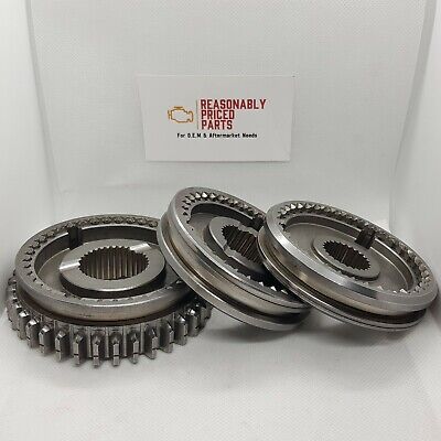

FYI (I was wrong about Europe, it's Australia). Full Evo 3 set of hub/sliders.
Received hub/sliders. They're so shiny I don't want to put them in a box where I can't see them. Measurements taken with my no name brand cheap verniers. They matched the matched an old factory set I compared them to within 0.2mm or less.
1/2 pics.
3/4 5/R pics

Not sure about the exact details, but the evo ones are designed to work with double synchros, and they are forged steel rather than powdered metal like DSM ones are so will handle more torque before failing.
Guessing there has to be some dimensional change.

Time for an update, finally. Meek Automotive is building my new box and is happy with how everything is going together. The diff in the EVO 2 box I got was wrecked because it was put together by a butcher and didn't have any shims so the ends got mushroomed. Luckily I had a spare clutch type amongst my part so we are using that.
