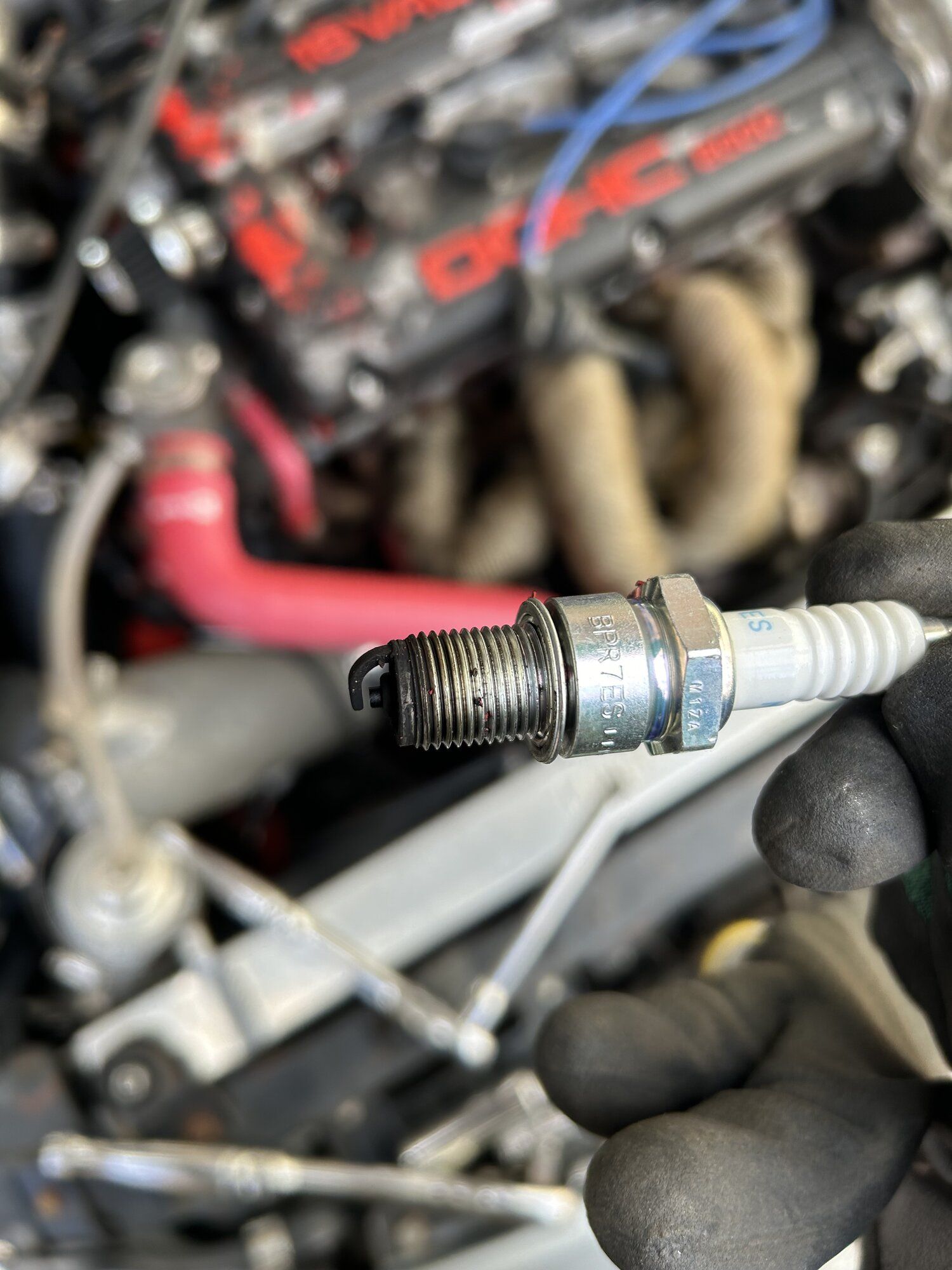

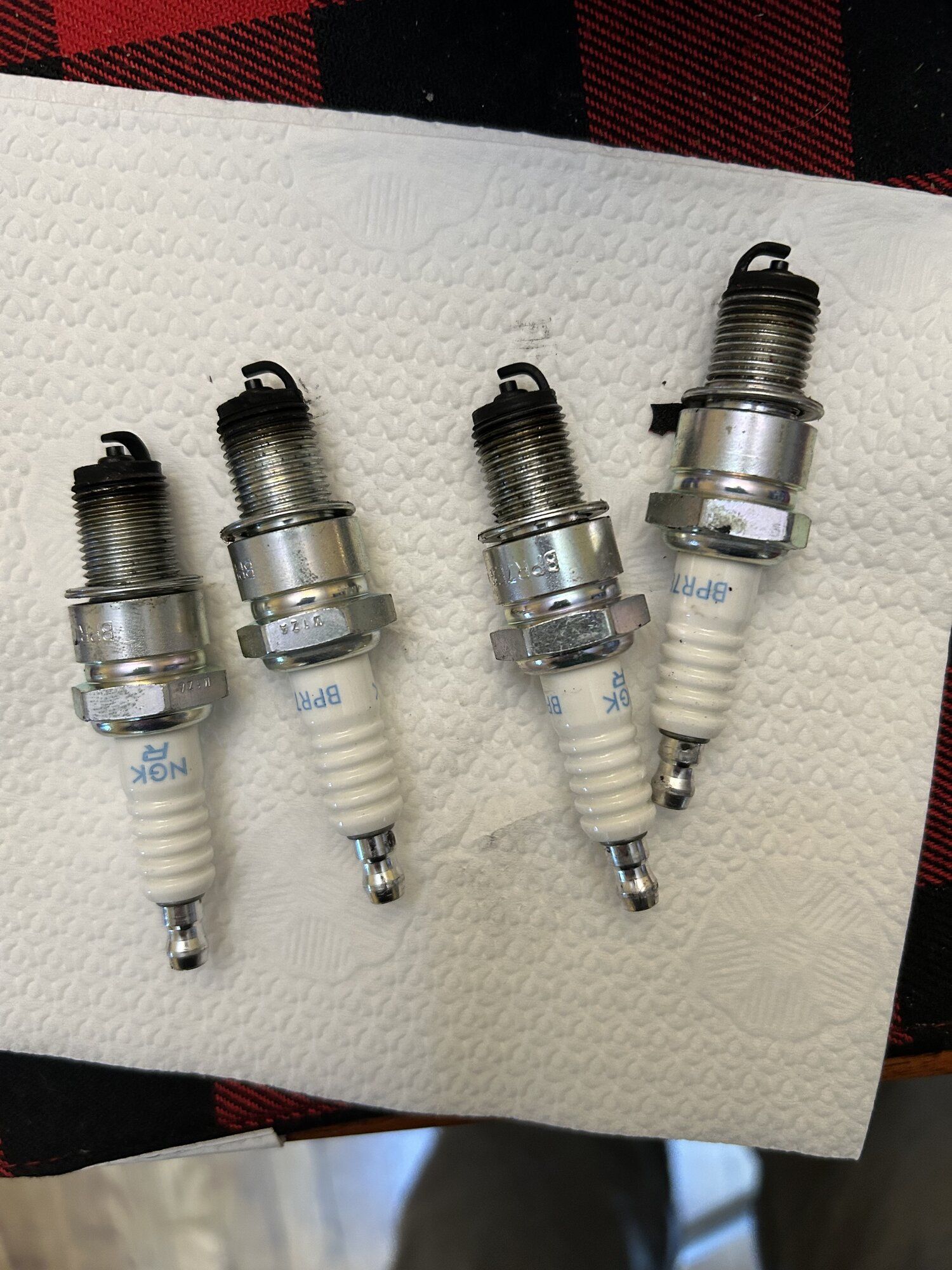

Are bigger turbo 4g63t’s with big injectors known for fouling plugs and flooding engines easily? Does anyone know an ideal plug for my car or should I just go with oem? Threads here said oem was the way to go but they were pretty old, didn’t know if there was a knew type out that was better for my set up
Get a couple of sets. If you don't used them near term you will later and it is better to save a trip when you need them.
So guessing fouling plugs is common and just something you gotta change often in this type of car?
I’m coming from a life a stock cars, so replacing plugs twice in a month makes me concerned about deeper issues (even tho I did have the no start issues flooding the engine with old gas). But maybe that’s just how it goes with these?
Plugs are cheap enough and couldn’t be easier to change so that wouldn’t be bad news
So guessing fouling plugs is common and just something you gotta change often in this type of car? I’m coming from a life a stock cars, so replacing plugs twice in a month makes me concerned about deeper issues (even tho I did have the no start issues flooding the engine with old gas). But maybe that’s just how it goes with these? Plugs are cheap enough and couldn’t be easier to change so that wouldn’t be bad knews
It's not common on an engine that is running well. I've been running the same plugs with 1000cc injectors for months. Fouling is a result of incorrect burn. Glad you are changing out the gas. If the Gas is in this bad shape, I can only guess what the condition of your Fuel filter and Injectors are at this point.
Spark plug purchase questions
Ideal Ohms resistance- gap size - ignition style- bore depth ?
I was thinking of going with a high ignitability sprak plug, anyone familiar with how they perform in a modified 2g dsm?
img_0466-jpeg.717290
Refering you to your prior thread. Here's what you had which is one range colder than stock. NGK bpr7es spark plugs.
img_0467-jpeg.717291
For cold starts and idling, the bpr6es plugs are hotter and work better. Swap to 7’s when you get it running better.
It's not normal to be fouling your plugs but when you keep flooding the engine it takes it toll on them. Bad tunes don't help either.
Stick with NGK copper plugs, they have been proven over and over in this engine and plan on changing them every 20k miles or so.
