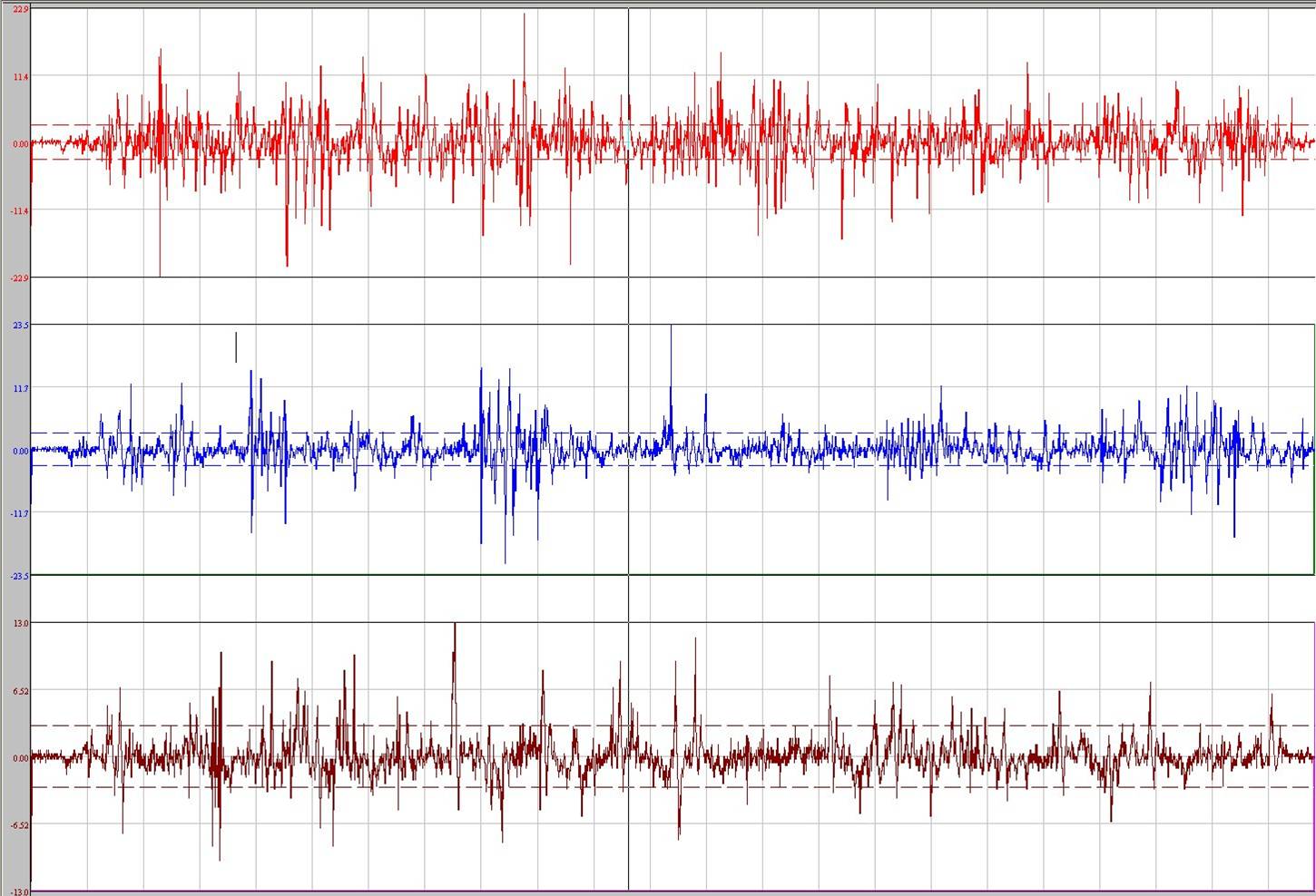

edit: I will now attach an image of the transmissibility curves. There are three levels of damping ratio (expressed here as percents). Note how higher damping ratios reduce the tranmission of low-frequency inputs (left end of plot), but increase the transmission of high-frequency inputs (right end of plot). Humans are particularly sensitive to vibrations in the 4-8 Hz range, so assuming a natural frequency around 1.8 Hz, the part of the curve that matters to ride quality are in the range of 2.2 to 4.4 relative frequency. These are all above the cross-over, which is why higher damping ratios make the ride seem worse.
I do NOT believe in overdamping. Quite the contrary. I believe that most people are WAY overdamped, and that the car will be faster with much less damping.
Experience has borne out this observation. When the rules permit, use more spring and less shock, and go faster.
Besides, I don't have to guess at this stuff; I measure it directly off the car.
http://farnorthracing.com/newimages/suspension_velocity.jpg
Those are the live suspension velocities taken off the right front corner at three different National events - and one of them is Topeka. There are techniques that analyze this data and directly report on the suitability of the shock valving.
If you post these in ascii with a time index (or course), I will conduct the analysis and post the results.
- Jtoby
