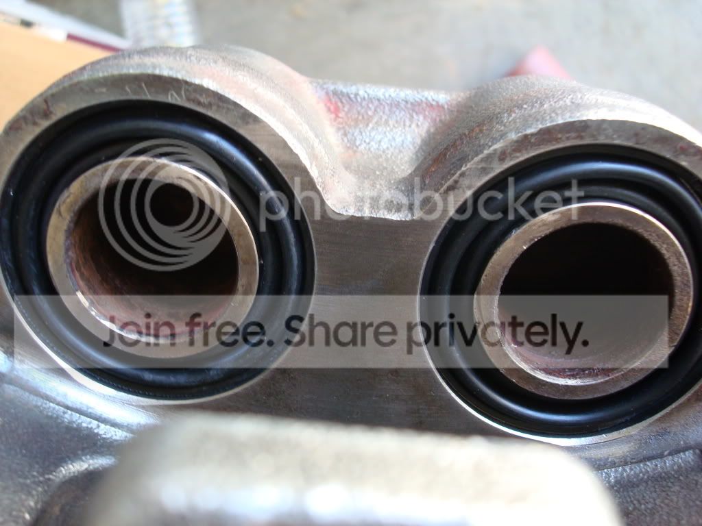

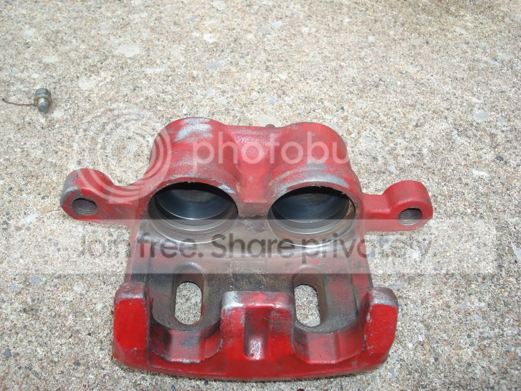

While i have everything apart i decided to rebuild the calipers. Have one done and painted!
Thanks to calan for the guide to help me along.
I used Beck Arnley 071-7888 rebuild kit. It comes with everything to do both fronts.

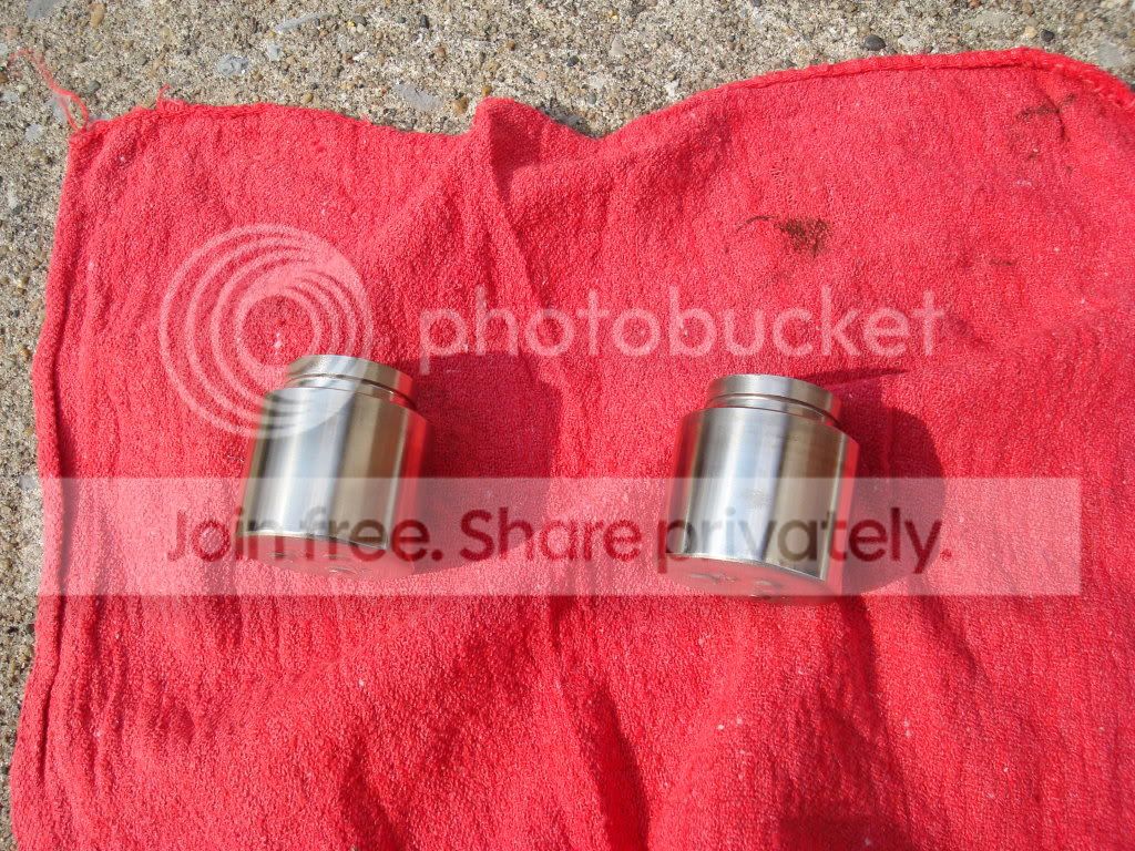

Caliper with pistons out.

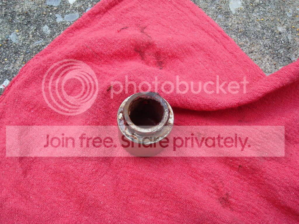

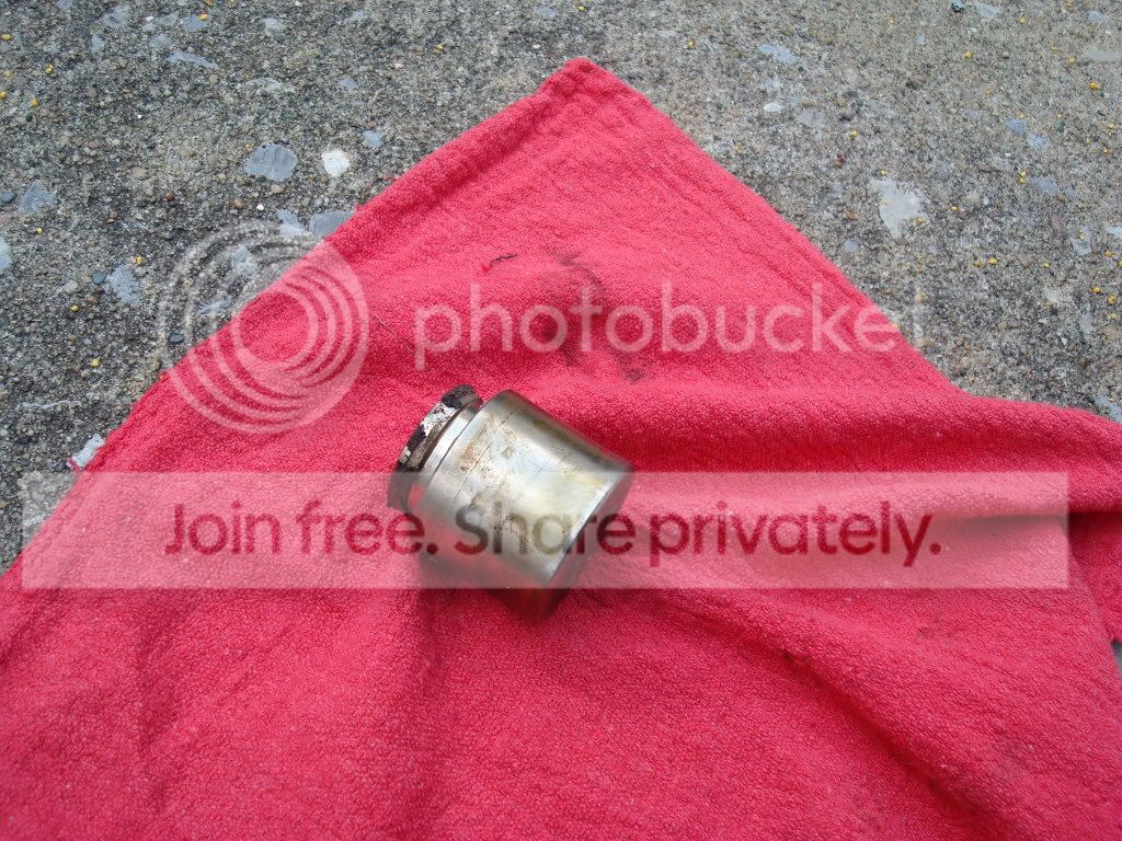

Pistons before
Cleaned them up with wire wheel.

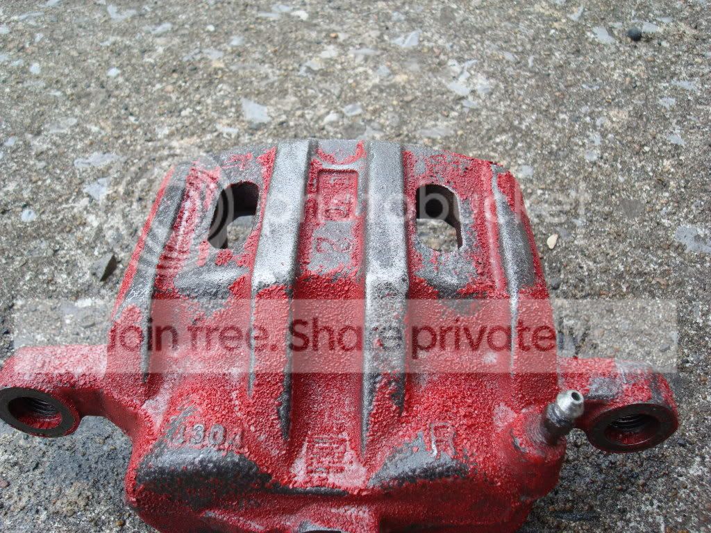

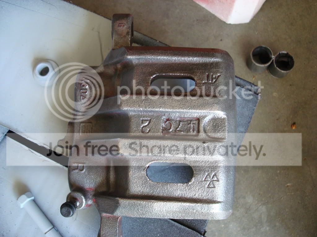

Cleaning up Caliper
Caliper rebuilt

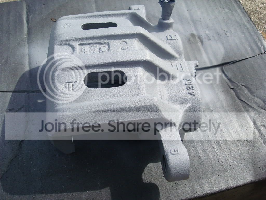

Primed

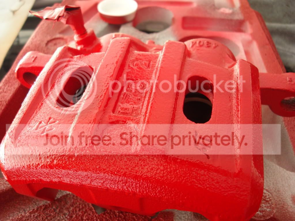

Painted

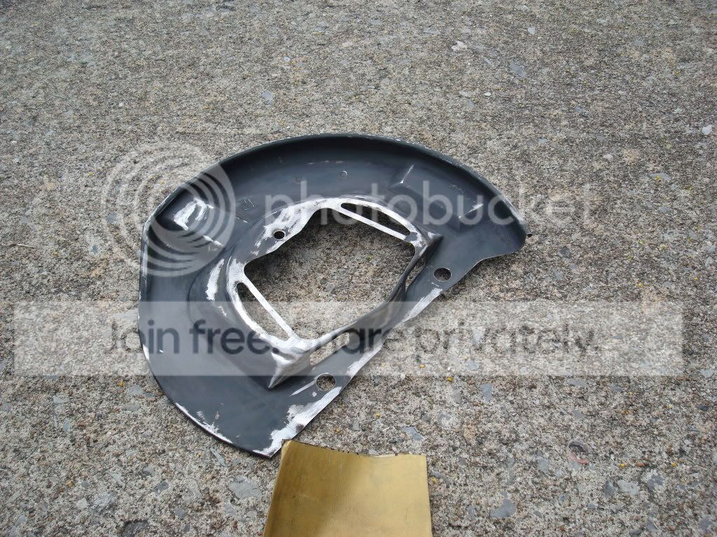

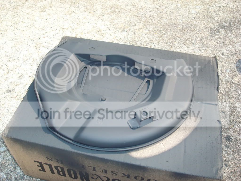

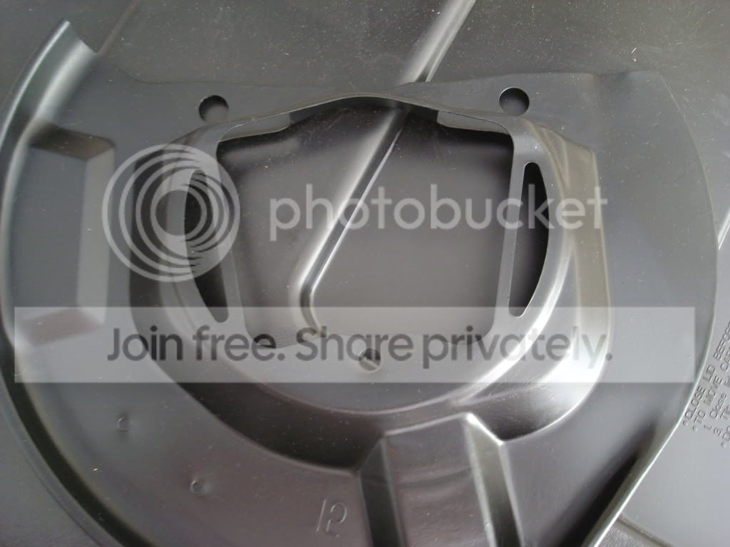

Also cleaned up and painted brake dust shield.

I would say roughly ~1 hour not counting waiting time for everything(paint to dry etc). Longest part is cleaning the old paint off and getting the surface ready for primer.
Also i have yet to do the clear coat that is supposed to help make the paint last. I will be doing the other caliper first then clear both.
