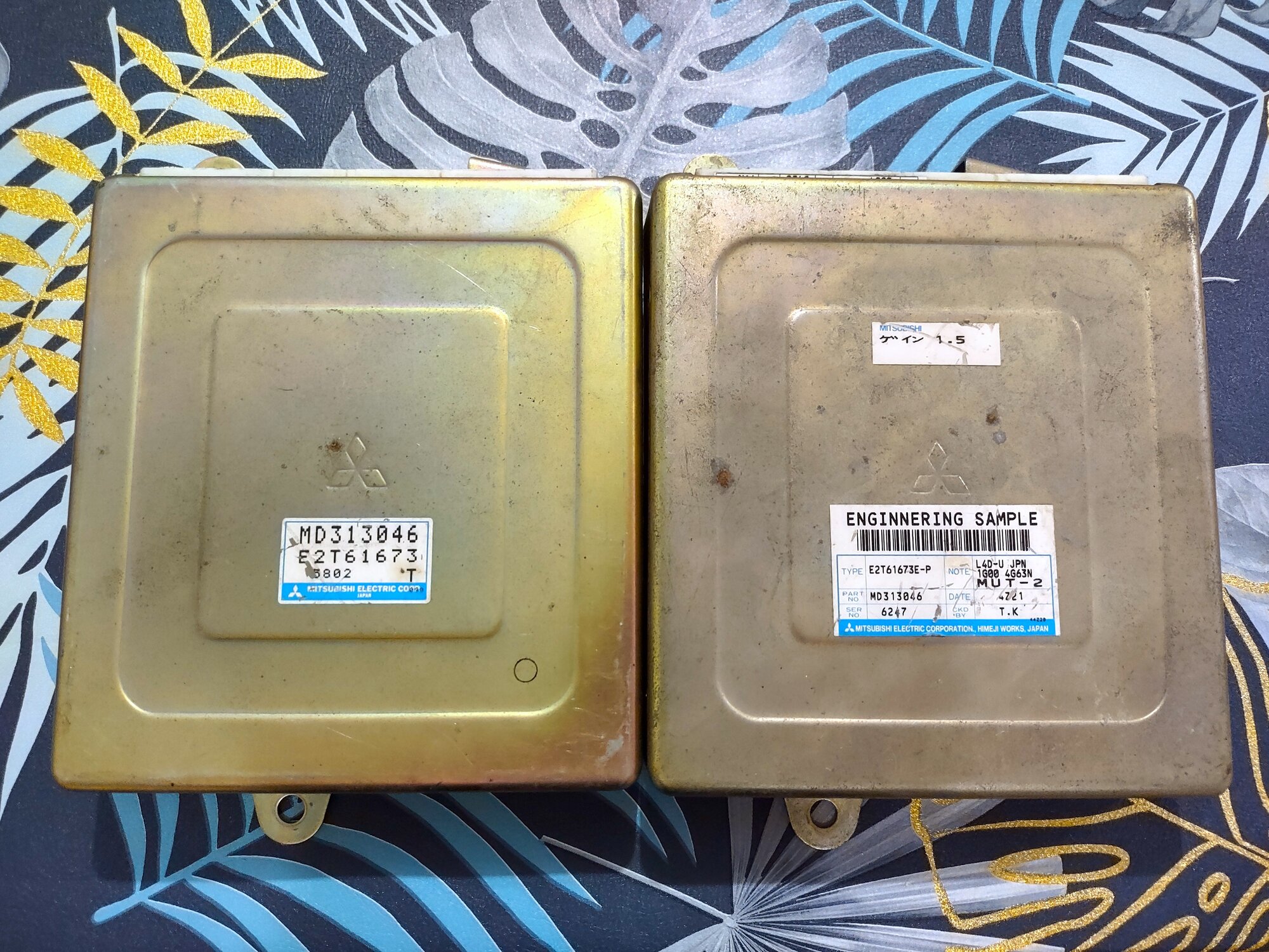

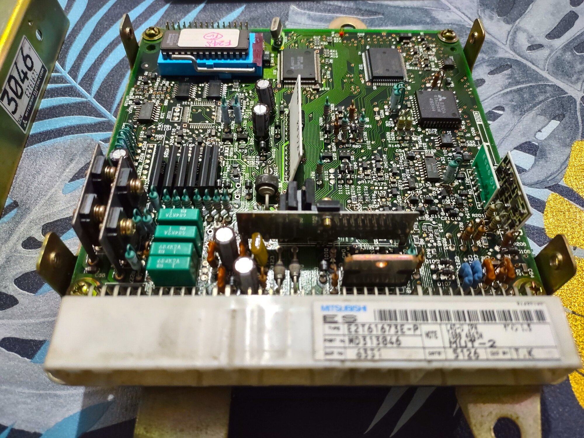

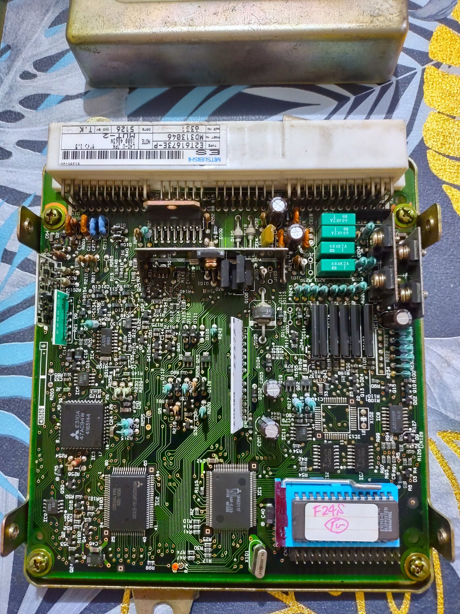

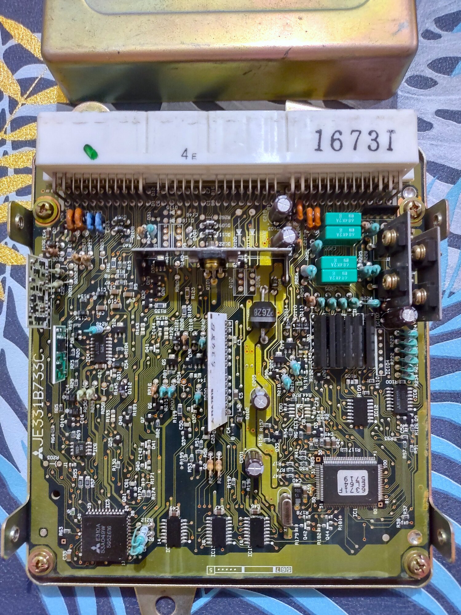

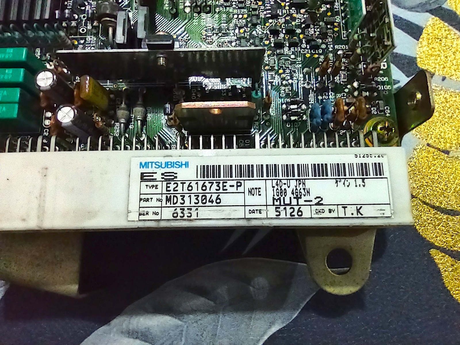

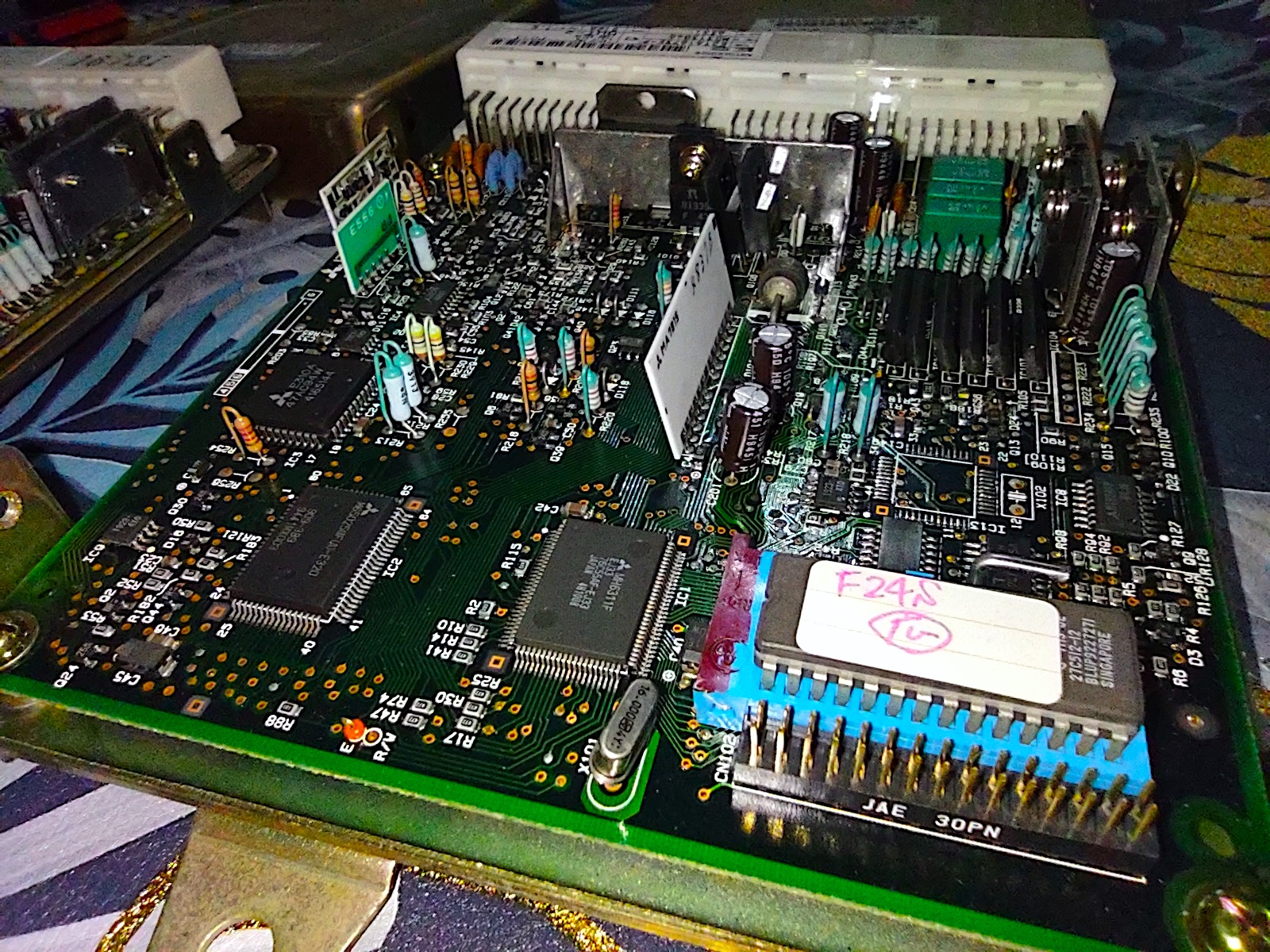

Engineering Sample 2g ECU.
I have seen some engineering sample ECUs for different Mitsubishi cars before but this is the first time I see one that is DSM specific.
This is a prototype of MD313046 which is the Japan spec turbo 95-96 ECU. I have a MD313046 as a spare and by comparing both, it's interesting that the motherboard is totally different. And I know that the Japan spec ECU is non eprom and has the same motherboard as EVO 4 ECU, but this one has a totally different motherboard with EPROM and a 30 pin connector. It's labeled as "Gain 1.5", I have no idea gain for what, and unfortunately I have no method to read the code. But the ECU itself seems working as it should. It just started my 2g.

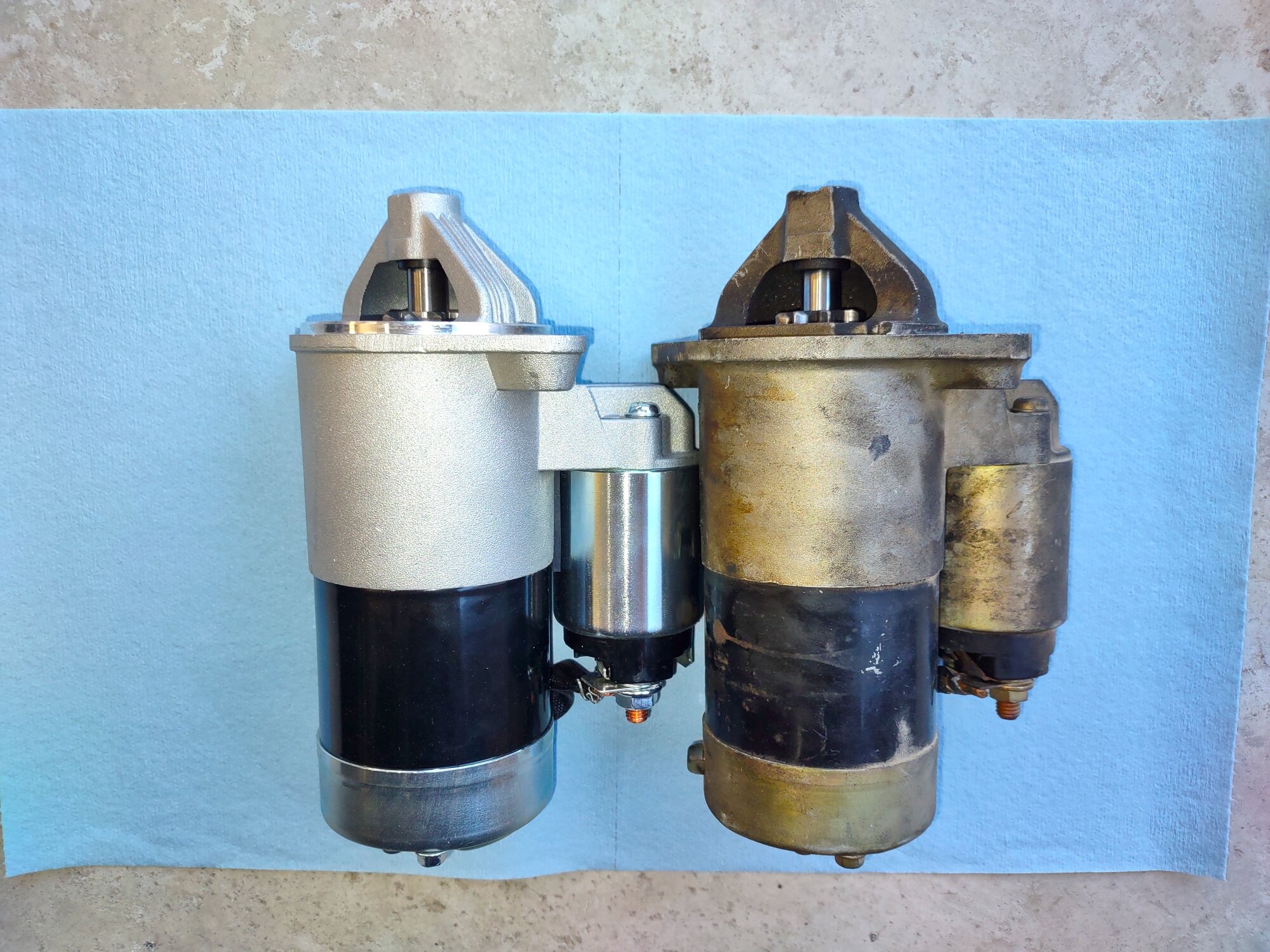

It rained unusually a lot last summer and it destroyed the streets and still terrible condition, so I haven't driven my DSMs. A few days back I moved the 2g to clean the garage. Nothing happened at the first attempt to crank, just heard the fuel pump priming while cranking. At the 2nd attempt, it cranked and started but I felt the starter spun a bit slower than usual like with a weak battery. Next day when I checked, it didn't crank at all, even no clicking sound. Thought the starter relay went bad but the starter was getting the signal while cranking. It was simply time to replace/rebuild the starter.
Found a cheap new starter at a local parts store, the store told me that it won't fit with a turbo 4g63. Because the manufacturer doesn't show GST or GSX. but it showed 2g Eclipse 2.4 auto. I was sure that they are the same, so I just bought it and removed the old one and compared. Yeah they are the same and it's strongly cranking again.

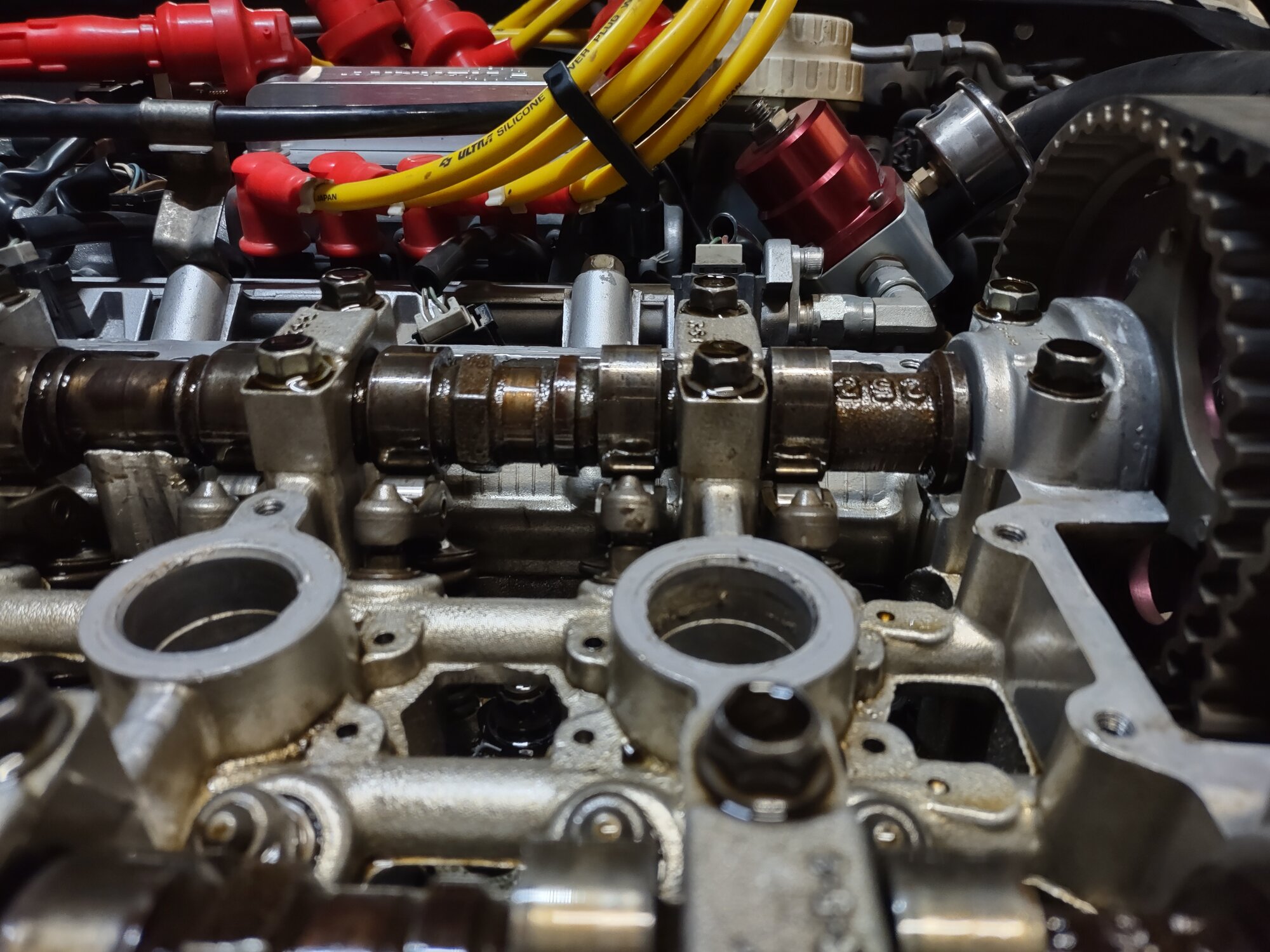

Next thing came up to mind was valve train components failure, like something is wrong with lifters, valve springs or valve guides. I removed the valve cover and found some cylinder's intake side lifters that are in the base cycle were pumped up which mean those intake valves were open for some reason when they should be closed.
I was gonna to remove all the lifters by the removal tool to clean and bleed down. I found almost all intake valves don't go down naturally while I was prying the springs down. If I heated the valve stems by a heat gun for few seconds, the valves started to move. I guess that something is wrong with valves to guides clearance, mostly the valves and worn guides are gummed up by tar or so. Seems like the sound I heard was from compressed valve spring snap back and sudden valve shutting in the middle of base cycle. Anyways it's time to rebuild the head.I will remove the head soon.
It's also time to try to use a 2g 7 bolt tensioner on the 1g 7 bolt. And I will report back.
We can see only one of cylinder #1 intake valves is slightly open. This now happens randomly in any cylinders but the valve will naturally come back to shut by time or when gets hot. It was good that I could find before smashing some valves.

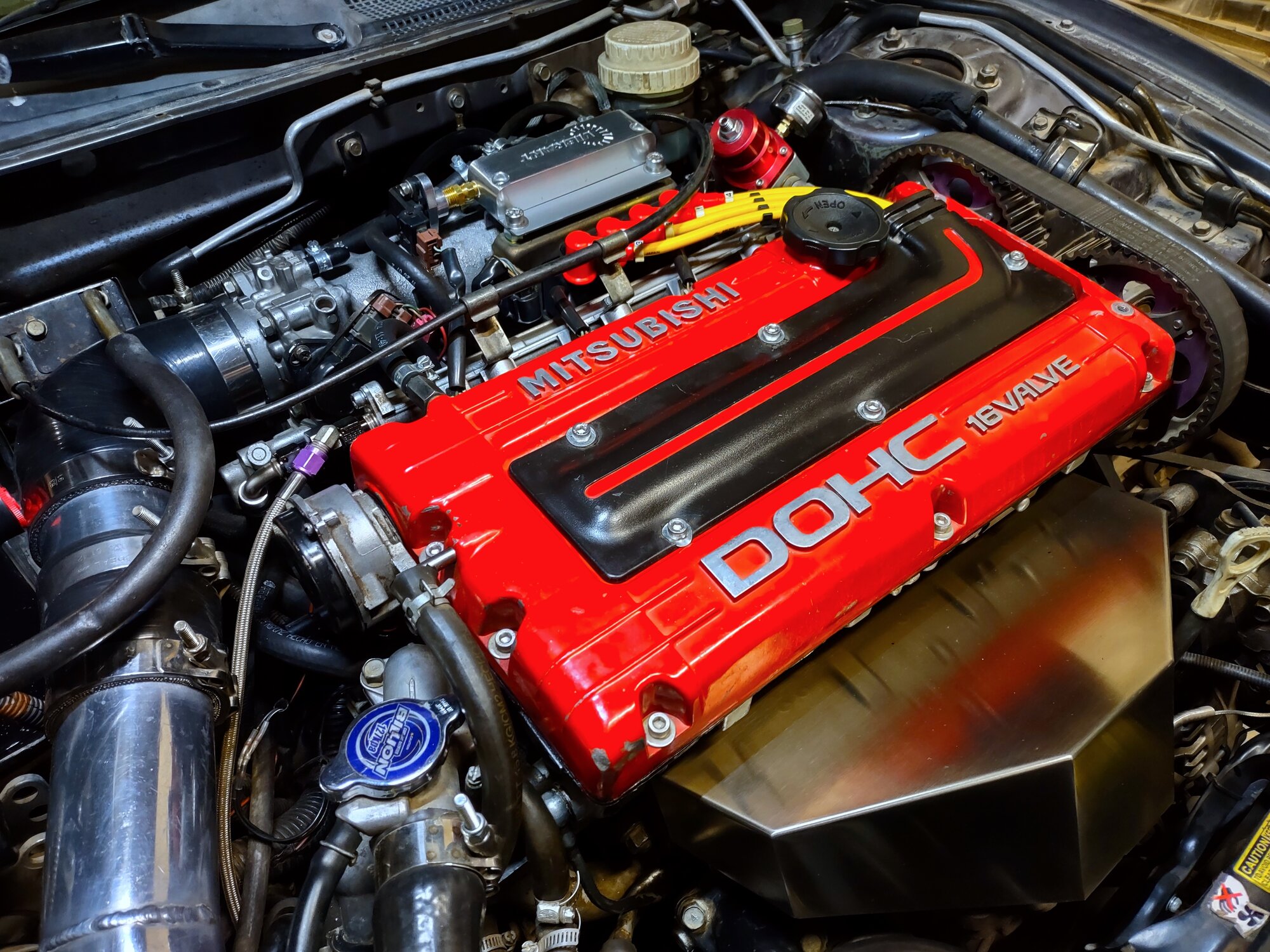

Removed the cylinder head and did a quick inspection.
Most of intake valves are kinda more or less stuck, I couldn't push down the intake valves flawlessly by finger even without valve springs but they moved if I heated a little bit by heat gun and lightly tapped. But sure not smooth as they should.
All intake valve guides have excess carbon deposite buildup inside as expected and causing the intake valves gummed up. Removed the excess carbon inside of few guides by a reamer and the valves started sliding smooth as they should.
All valves are straight, so measured the valve to guide clearance. Some are slightly in loose side but almost all are within the factory spec range like when I inspected last time when I built this engine 10 years ago.
Looks like a good cleaning would still be ok, but I would fully rebuild for another 10+ years of use. I think it's a good time to do the things I was planning.

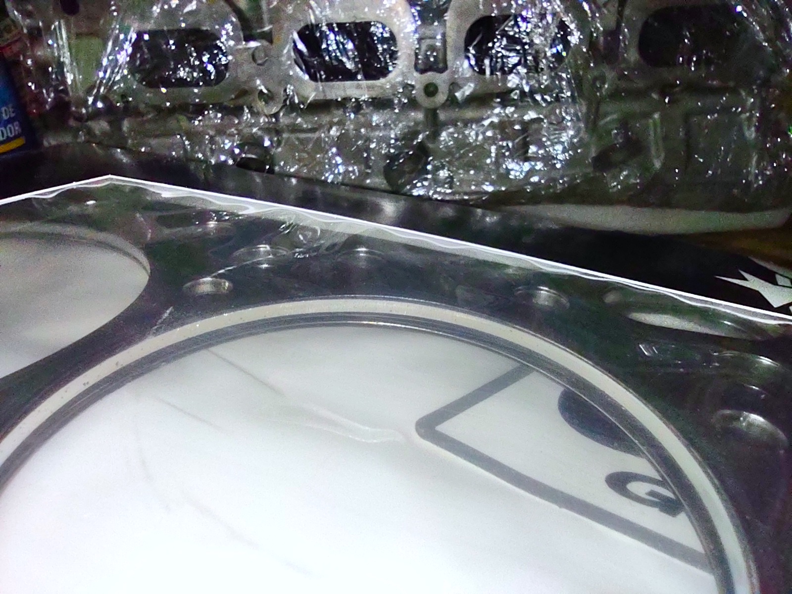

- I will go with much thicker head gasket to give more piston to valve clearance to allow me to run higher lift aftermarket cams in the future in case if I would want.

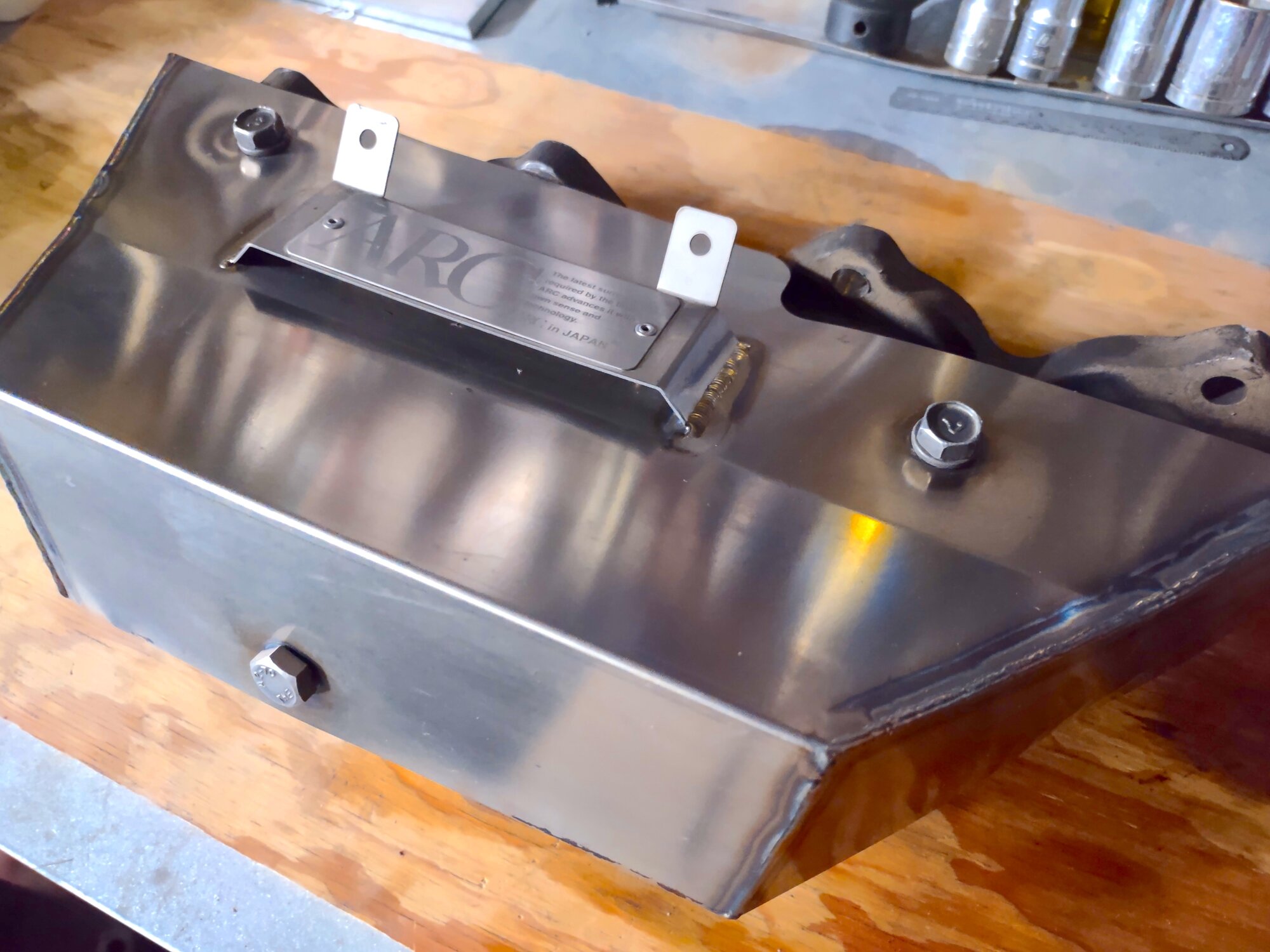

- Change back to the stock 2g exhaust manifold and ARC exhaust manifold heat shield from the FP exhaust manifold and the Extreme PSI exhaust manifold heat shield

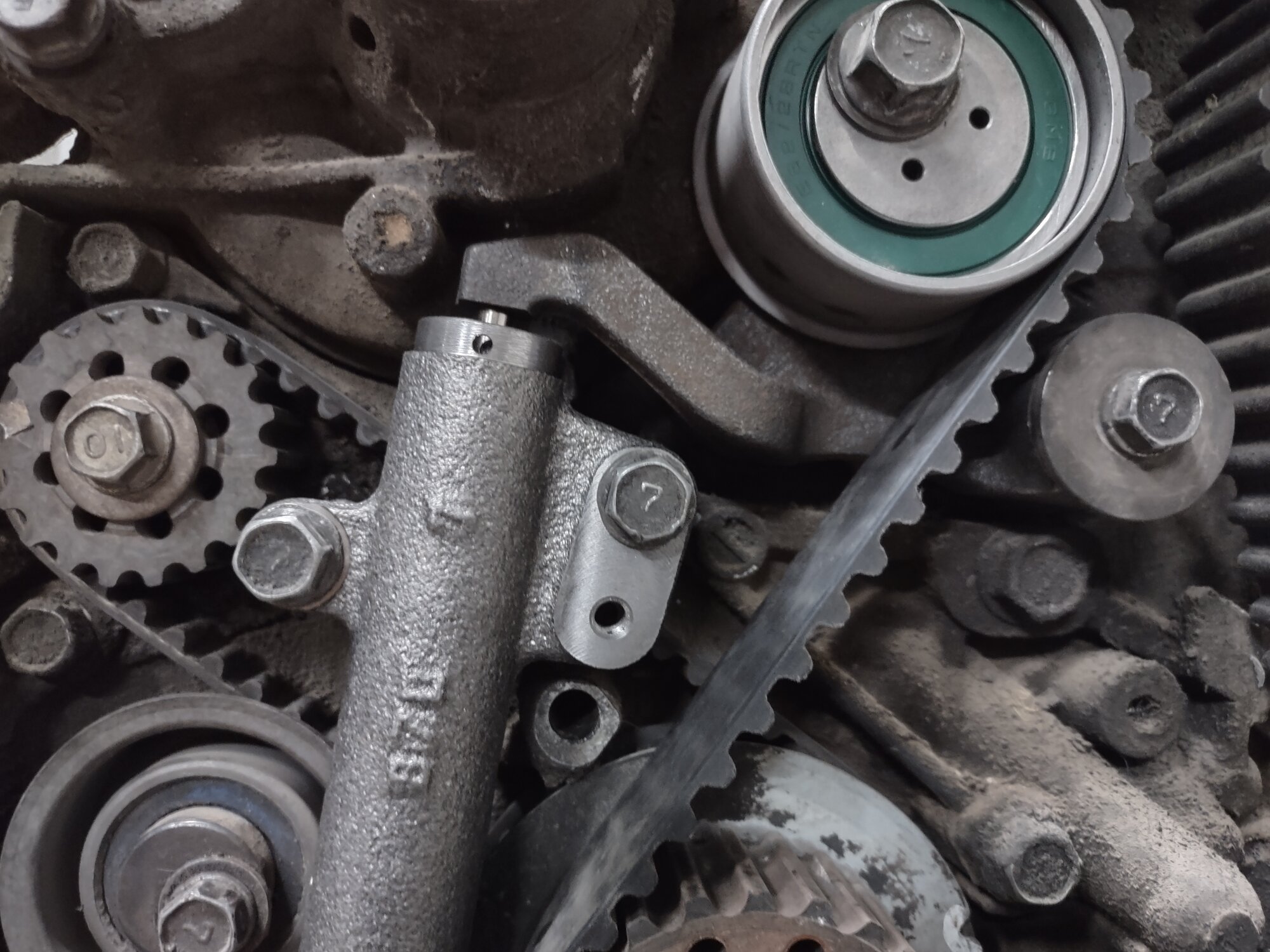

- I will try to install the 2g 7 bolt tensioner and 2g arm.

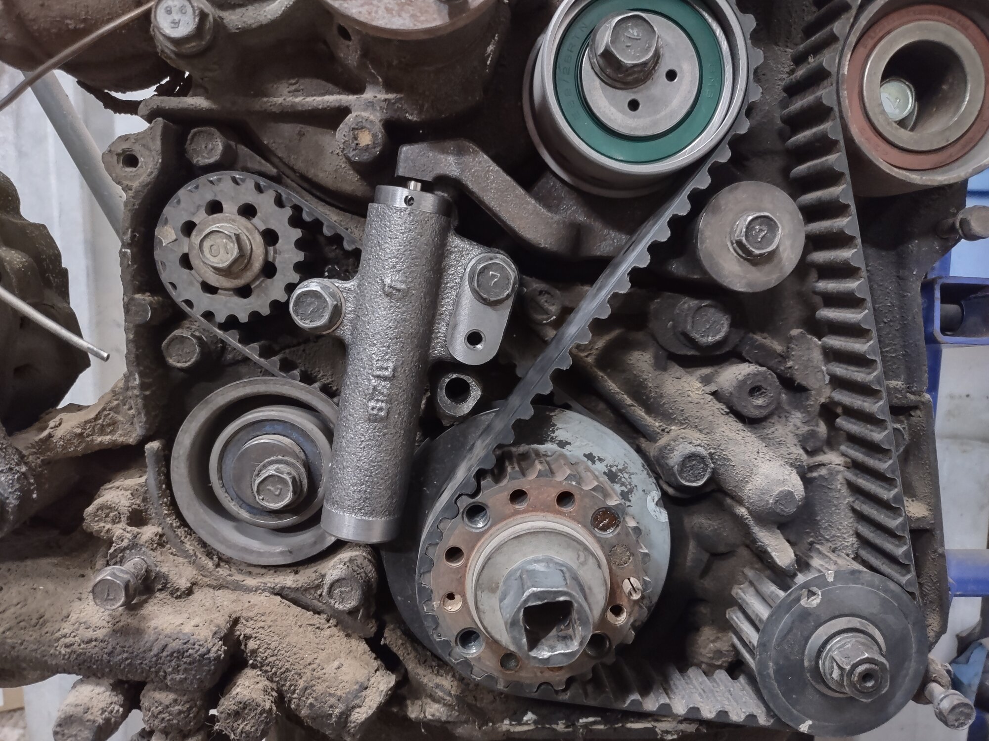

I just started working on a 2g/EVO 7 bolt tensioner in 1g 7 bolt.
While I was mocking up the 2g tensioner arm in the 1g engine, I used a 6 bolt spare parts engine that has been on a stand because it's easier and the 1g 7 bolt and 6 bolt use the same 1g water pump, so I can check interferences. Not a direct bolt on but it seems like we would be able to make it work in a 1g 7 bolt.
And I actually realized that we could make the 2g tensioner work in a 6 bolt like the pics too. In case if a 7 bolt tensioner would work in a 6 bolt engine, we wouldn't need to be worried about the 6 bolt tensioner gets discontinued. (I am not sure but perhaps it wouldn't work if you have the Kiggly crank trigger)
I can't be sure about anything yet until making the engine actually running. I will report back once the cylinder head comes back from a machine shop.

The pic below is the thickest Cometic off the shelf head gasket. It's like 3 times thicker than the factory thickness 😂 I will use it this time.
