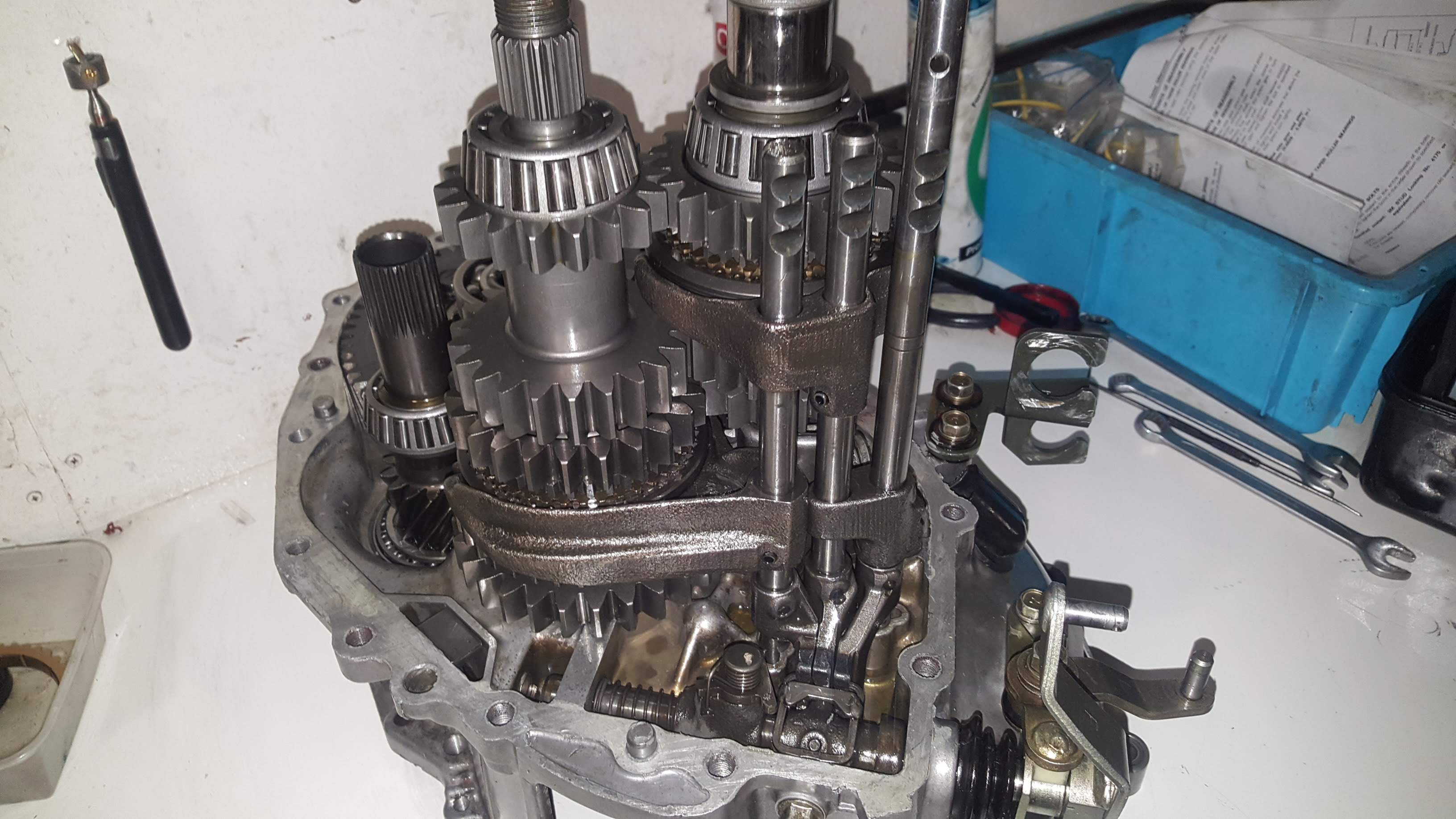

Recently got my new gearbox built. Its a PAR straight cut gearset, using synchromesh engagement from Evo2/3 in an Evo3 gearbox casing. The double synchro 3/4 gears makes shifting much faster, it just slips into gear without any complaint. They rate the gearbox at 740ft.lb, and at my 500hp level Im around 475 ft.lb so there is a bit of head room in their rating meaning it should be a good strong gearbox all going well.

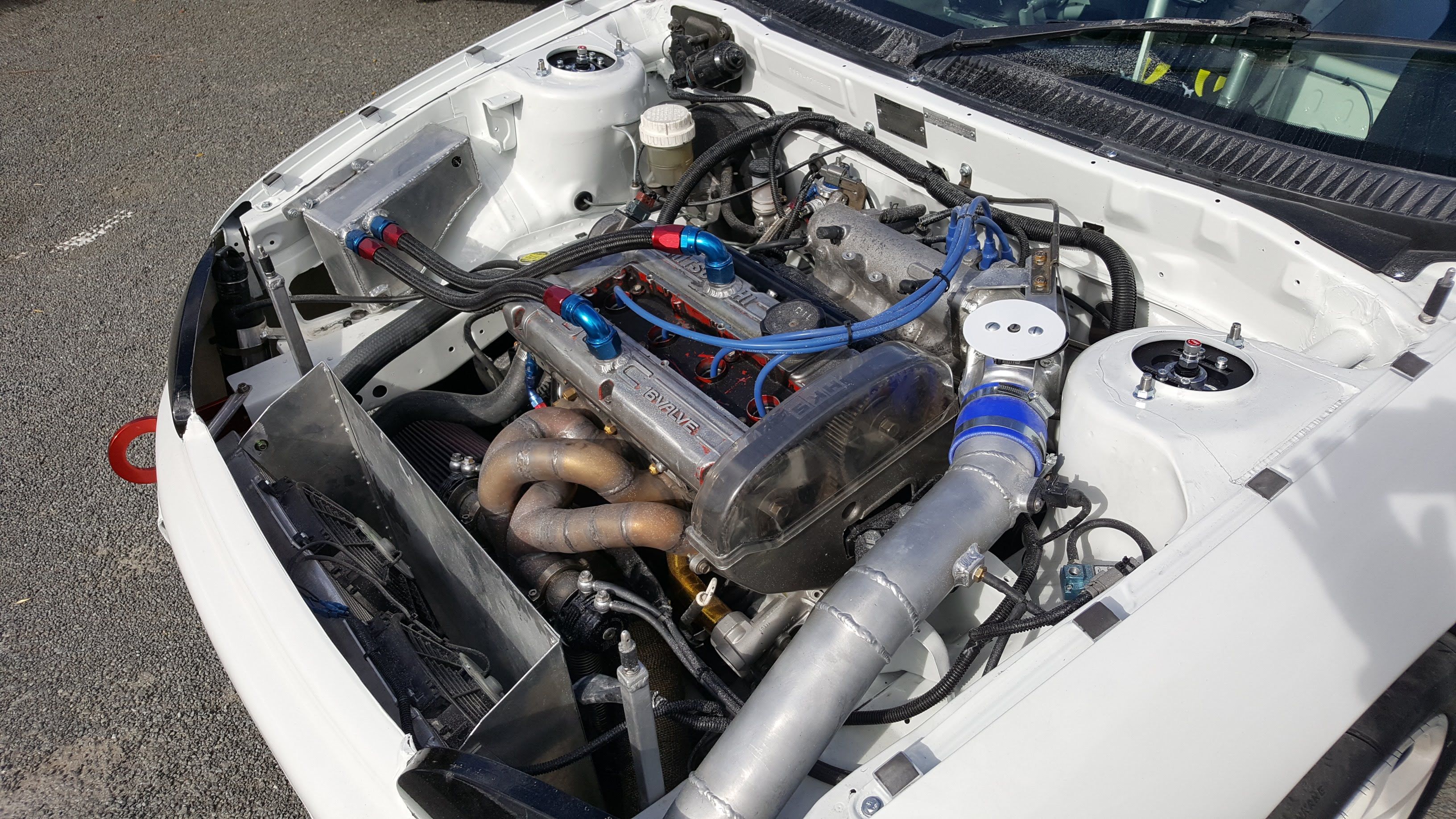

Now that I can wind the boost up a bit more the car certainly comes alive, its a different machine compared to being on low boost, quite addictive. Now I am starting to work on some other pieces like improving the oiling. The extra speed is now placing more and more strain on the oiling system and I would rather not wait till I damage a motor to fix it, I will make some modifications and then look at the oil pressure data again.
