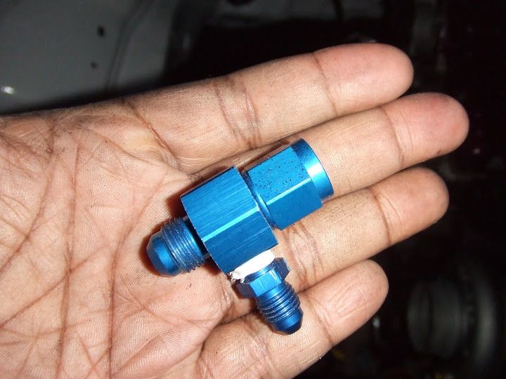

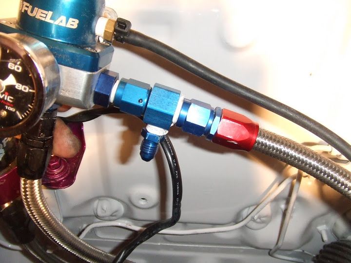

Had my wife put my nitrous fuel fittings together.. Forgot to tell her "no toilet tape on fuel fittings..." Oh well ahahah.

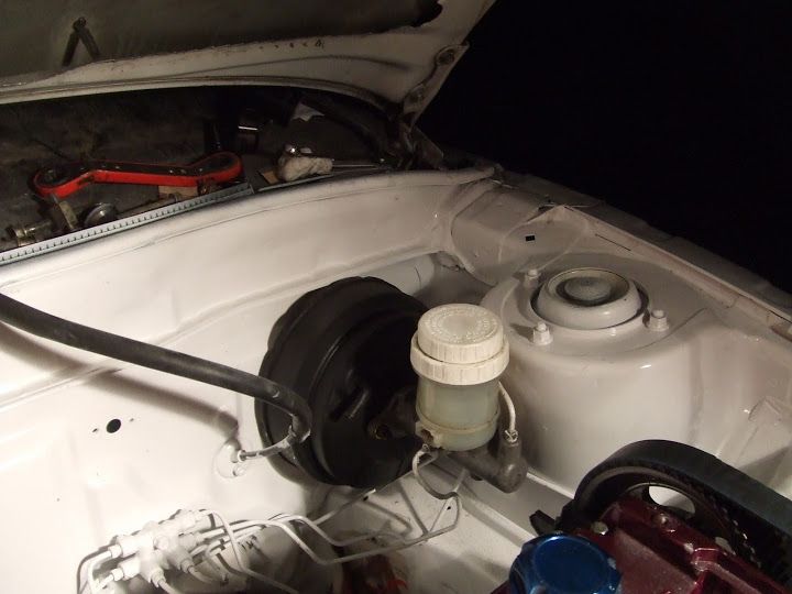

Another random pic of my 3rd gen eclipse master cylinder and res setup..

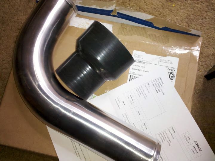

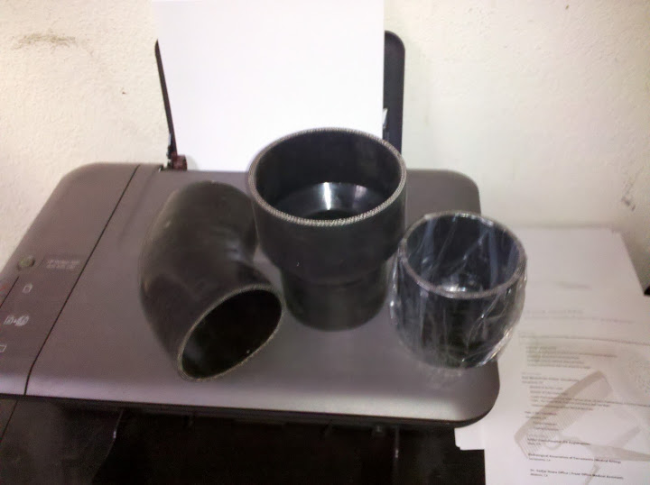

Got my 3" 'L' in and the rest of my couplers to finish up the ICP for the enw IC.
Thats a 3"-4" reducer coupler they sent me and it was suppose to be a 3"-3.5" so it can be mated to the 90mm Q45 TB.. They got another on the way so all is well.

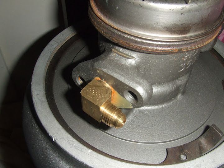

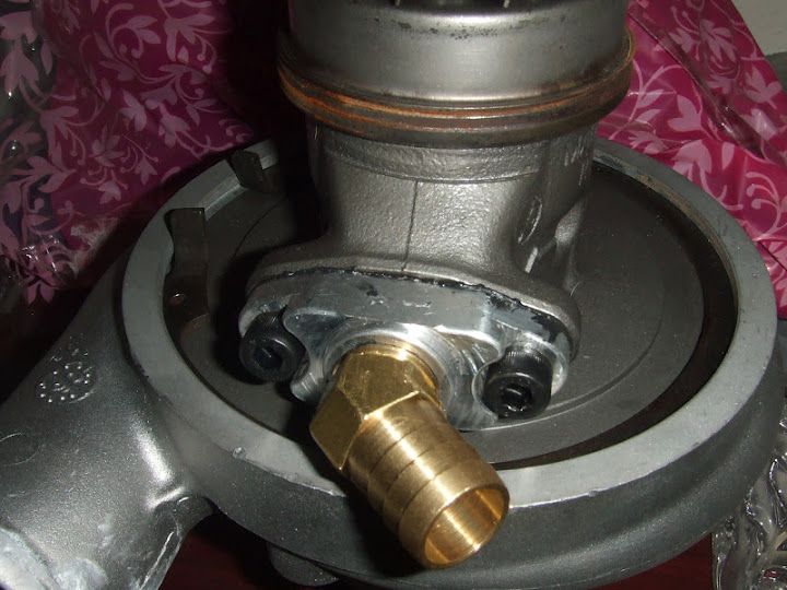

My oil return is -12 and and I finally got the pieces in for that as well-
Also with my oil feed fitting my restricter is running Justin's custom specs, the same used in Dave's 9s setup.

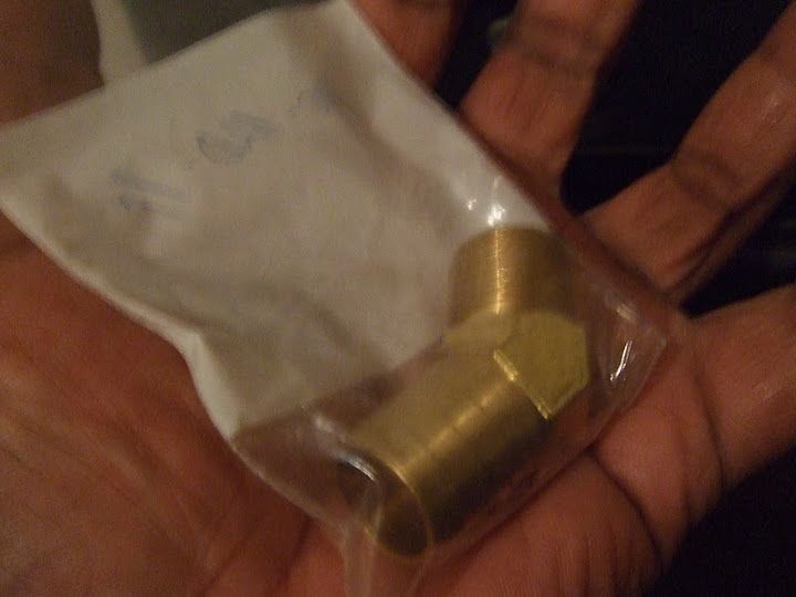

Huh? I just see a 45* hose barb fitting.
Unfortunately when customizing things like this, its never that simple LOL.
I actually found it on Ebay. My fitting is a -10an to -12an which is VERY close to a 1/2 NPT to a 3/4" barb. A hard size to find but I found it and cost around $10 or so.. That link Calan gave you wont help at all because like most places they don't have it listed. I got lucky but if I can find yo the actual part number and or company I got it from, hopefully I can help.
I saw the teflon tap on an fittings and it almost drove me crazy hahah. Women hahaha... Nice build man, looks like you have alot of pride in your work n it def shows.

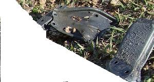

Are you gonna keep some of the braces to support the steering rack ? This is what I left after the Vassil bar install..Nice build BTW..:thumb:
I didn't even pay attention to the barb size. It was a long day. :)
What size restrictor is that exactly? and is it built into the 90* fitting shown here?
Are you going to be running -4 AN Lines?

The exact specs are a little blurry in my mind but they are the racing/performance specs specially done by Justin, the same used in Dave's record setting setup. He's the best guy to goto for your Holset needs!

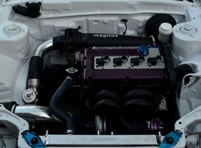

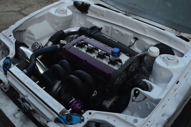

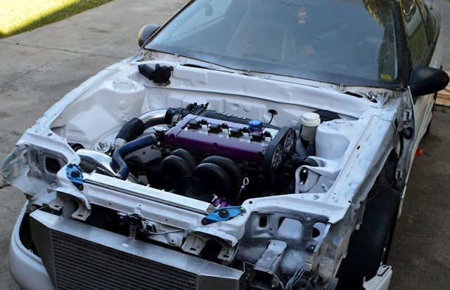

In the mean time I decided to switch the colors up. WAY too many white and purple engine bays now so I figured I'd spice it up a bit with a splash of blue. Its all about coordination IMO, I have seen some engine bays where they are nicely done but the colors clash. Reds on purples on blacks on blues in off colored cars etc, just doesn't finish right.
Its not a show car by any means but I figured I'd have some fun with it. Do you guys like the color scheme? If not any suggestions? Right now I need to send all the purple stuff out to be coated like the blue items were but I need to add the breathers to the VC. Also the BOV will be Purple as well. Right now I am on the look out for new hoses, I have the new gates belt and I'want to find the Purple/Blue HKS cam gears to finish it all off.
There is an event coming up on the 10th of July which gives me exactly a month from today to have this bad boy up and rollin. Still had plans to get a TC restalled as well as a forward facing manifold built by the RJR guys but that will have to wait since I'd have to send my turbo in for the mock up.
Thinkin about getting those countersunk washers in either blue or purple to put the fenders back on. The towers are the stock units so I sprayed over them but the tops on the GC/AGXs are black (It looks tacky to just spray over the covers and leave it) Still haven't found a place that carries the grommets I need as well but all in due time!
More in depth stuff to come now that I have parts on order and a new deadline, this should be interesting...
BTW the engine bay is 2 toned Gloss/Satin white and does have a SMALL hint of pearl added to it, just to make the color a bit more rich rather than super bright.

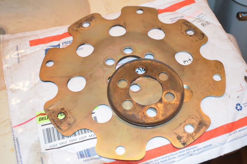

SFI Kiggly Flexplate:
I sold my last one and planned to run my dual plates like I did before but got a good deal on this one and once my ARPs come in tomorrow I can hopefully mount it up since the trans will be installed this weekend. Only thing left on it is to weld up my center diff but that's no biggie.
Keep sending those PMs, I appreciate them. For those that asked before, I really don't know what else I can remove from the engine bay. Swapping to auto and moving the coolant and breather catch cans out of the engine bay are about as far out as I can think of. The brakes could go but removing them makes little difference since they are hidden under the MC and UICP.
Always open to pointers. Been preaching wire tucked DDs forever and I guess it was finally time to show what extremes I was talkin' about. If you find a cleaner 1G bay PM then to me or post em up cause I am always lookin' for new ideas.:hellyeah:
