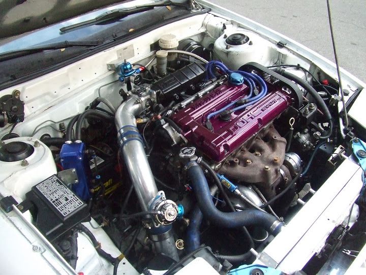

'92 GSX The 'Baby Beast' - 2.3l HX40 Wire tucked Auto

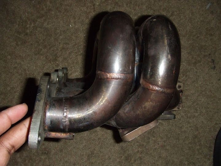

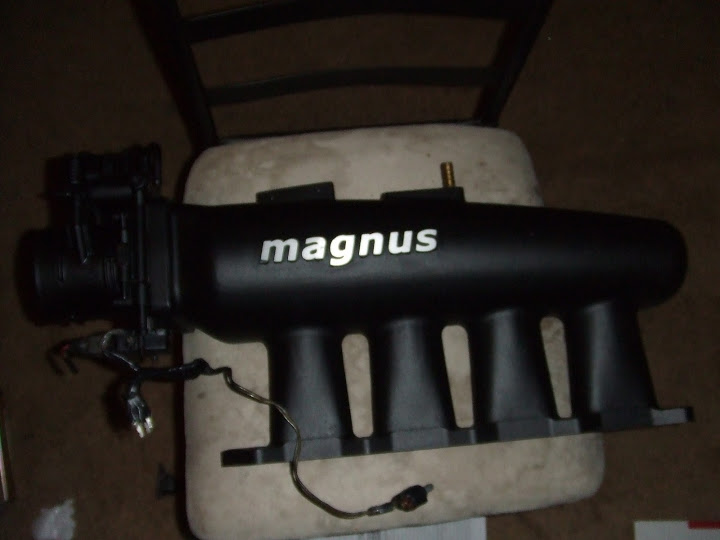

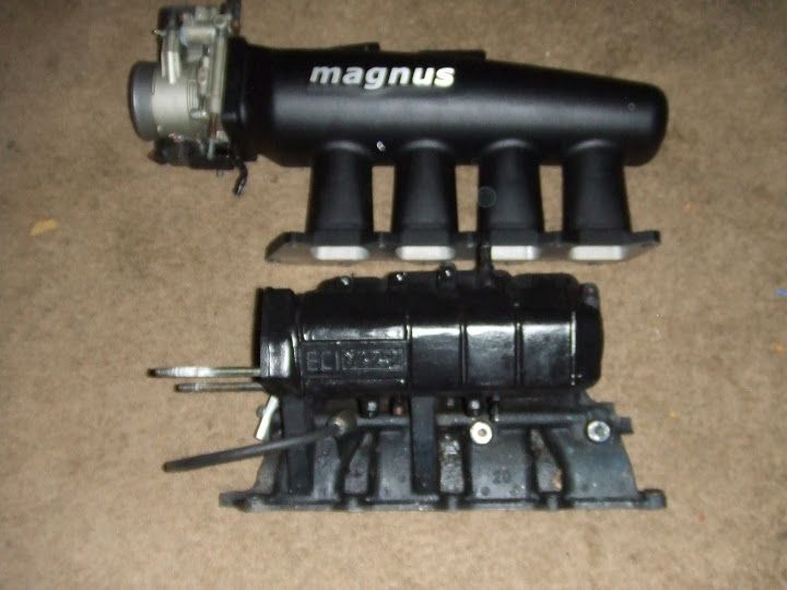

For those who love that manifold, here are a few more comparisons between it and the stock 1G intake manifold-
I color matched the Q45 with a textured paint that is also used on a few other items in the engine bay.

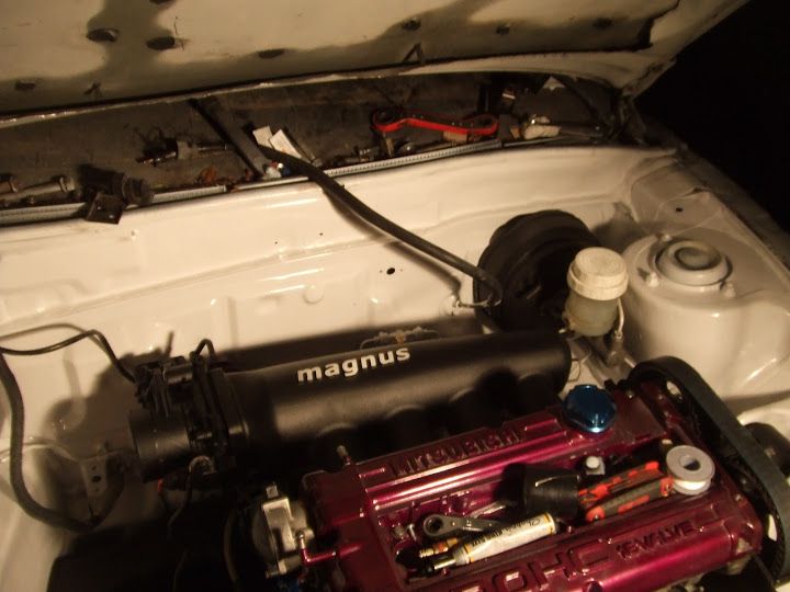

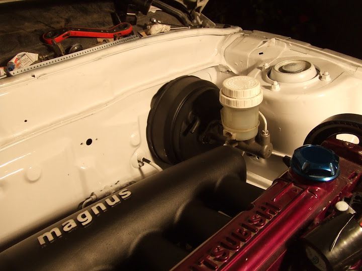

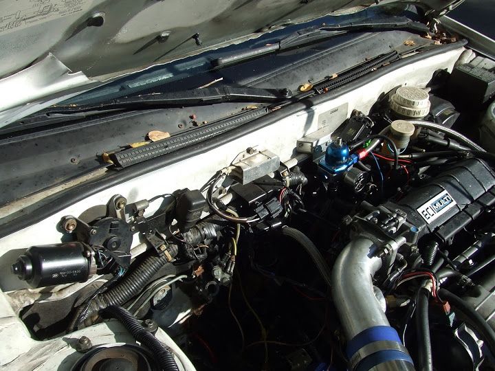

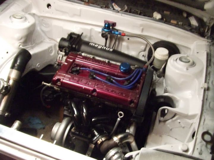

One of them has to do with getting your wire tuck to be THE cleanest possible. For the extremist such as myself that would mean making sure NOTHING is on the fire wall and the biggest eye sore can be the brake booster due to the way the reservoir sits (I don't care if you add fancy braided lines to it, its still ugly) On an all out project like the Raven, the entire setup was relocated into the interior of the car (pics will come when I rebirth that build thread) BUT if you don't want to goto that extreme and or want to retain your booster THERE IS HOPE!
I'm out of town right now and don't have access to all of my pics but here is a sneak peak of a SIMPLE mod that I have been doing for about 5-6+ years that I know a few people have caught onto lately as well.
How make beauty from this:
Even after improving it once before:
To this:

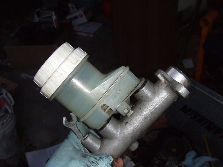

What you are looking at is the master cylinder for a 2003 Mitsubishi Eclipse. (I believe 2000-200?) 4 cylinders all use the same ones but I am not 100% positive. Anyways, this piece fits our boosters for those of you who want to keep it and will eliminate the UGLY offset reservoir we have. (If someone can post a pic of a firewall that looks good with that thing on it, I'd love to see it?) Most of the time you'll spend around $30 or less to get it and it is a great piece. Finally the last touch for me to ensure that very little remained on my fire wall. After converting to Auto it was even easier.

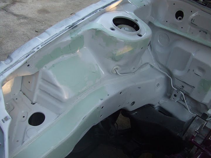

So from those pics before, you could tell there was paint as well (this build thread is a bit back dated) but no previous mention of it.. Well Once I finished it looked great but because I was fishing under a time crunch it wasn't as good as it could have been to me and the funny thing is that most of the stuff I changed 99% of people didn't really notice before so I guess it was just me over doing it a bit again...
Here it was after the first go around-
And in case I forgot to mention, in that pic the wiring harness IS installed and the car is roughly 90% plugged in and ready to go. (I'll be getting more in depth of the wiring later on after I switched harnesses for the second time from 5spd to auto then back to 5spd.) At this point I should have just stopped but I'm a glutton for punshiment and after the opportunity came by again for me to have the time to do it I tore it ALL apart again and went back to town. WTF (Pic above was taken the same night I started pulling the transmission to go at it for round 3 :toobad:)

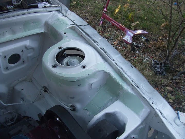

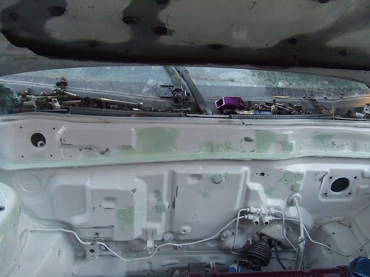

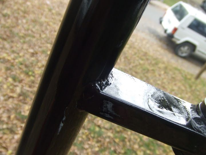

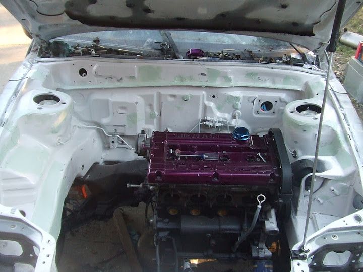

Well round 2 on the glassing... This time I went i a little farther, getting rid of any dimples or other simply markings that were factory to begin with..
So from-
Back to-
:rolleyes:I'm a glutton for punishment. :tease:
There are a few other nice touches added however and I'll post those up next.

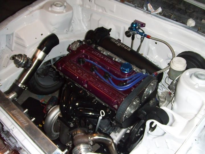

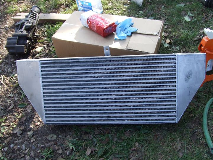

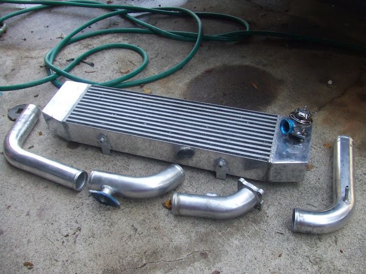

Intercooler-
The original intercooler the car had when it was running the 3065 was a Punishment Racing street unit-

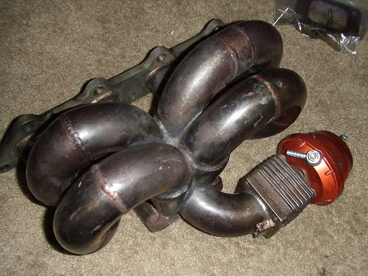

That intercooler was good for about 600hp which was about where I figure I was with that setup, 8" tall 3.5" thick 2.5" piping etc etc.. Now I am looking to go for 600whp on the auto which is equal to about 700 on the 5spd and Over 800 on anything other than awd SO I figured the safe spot was a 800-1000hp rang intercooler and I found one by switching to a Kinetic Racing mammothunit with 3" in and out.

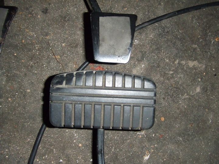

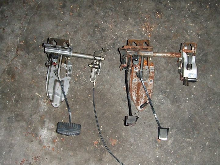

I got rid of the 5spd pedals (something I never got around to doing in the black car) and I can assure you that it makes a HUGE difference..
My modified manifold was awesome but my custom V band DP was built to be used with a Full Race Ramhorn manifold. I am sure I could have made it all work but once I got a chance to get my hands on one it was a no brainer:

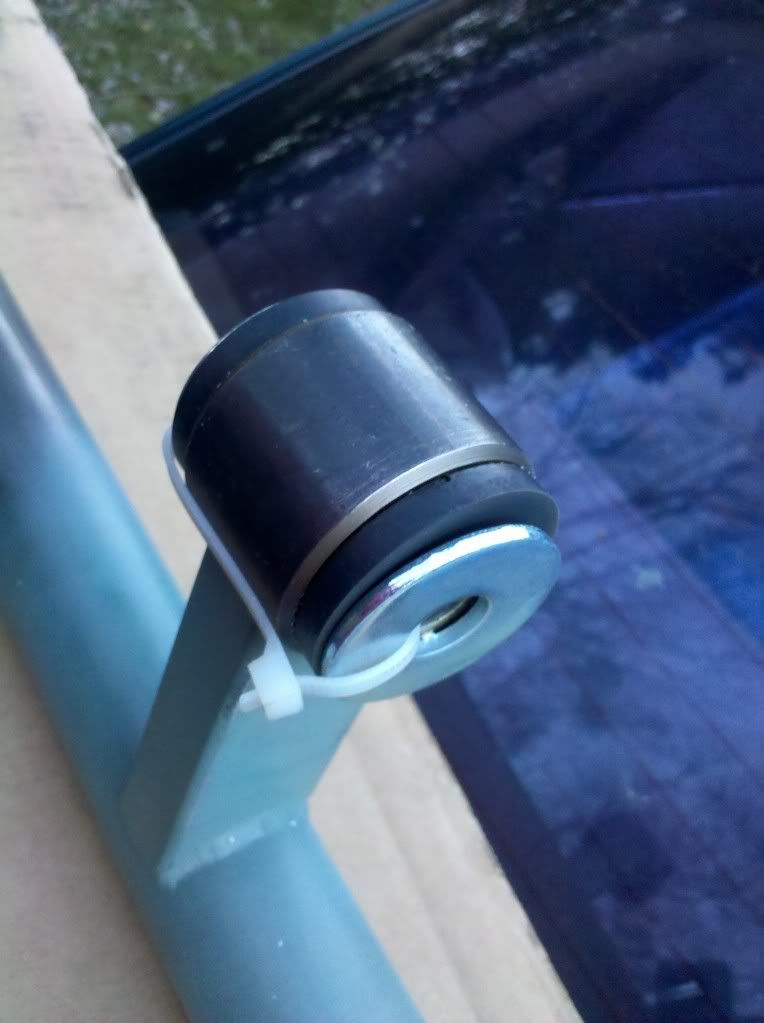

Another upgrade is the use of a chromoly roll stop that I had custom made for autos by a member Vassil. Hands down the best roll stop on the market.
