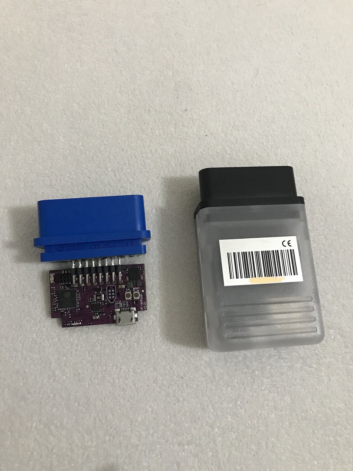

Thanks for reply I have attached the picture pls let me know. Do I need flash port🙏🙏

thanks steve god bless youLOL so you have seen the pictures and Do i need flashing port? i mean do i have to use headphones stuff?
If you mean this picture, I can't say. I don't know what's on the left and I can't tell of the one of the right is a real Tactrix openport 2.0 adapter or some clone.

Anycase to the best of my knowledge the MD359402 requires the programming voltage on pin 79 so you'll need to provide it one way or another.

i think it s not clone by the way i don t know left one alsoLOL Seller sold me as a free:) but it looks good toolLOL i got it about 79 pin but how to provide the voltage on pin 79? Is there a information about that i don t want to waste your time thanks
