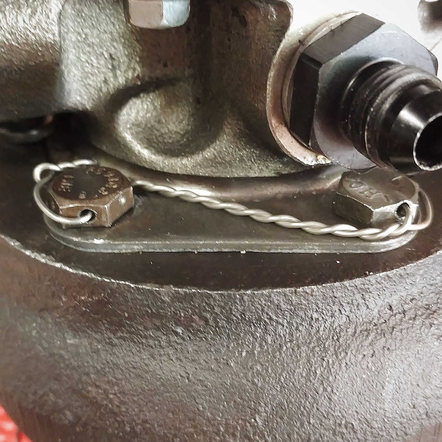

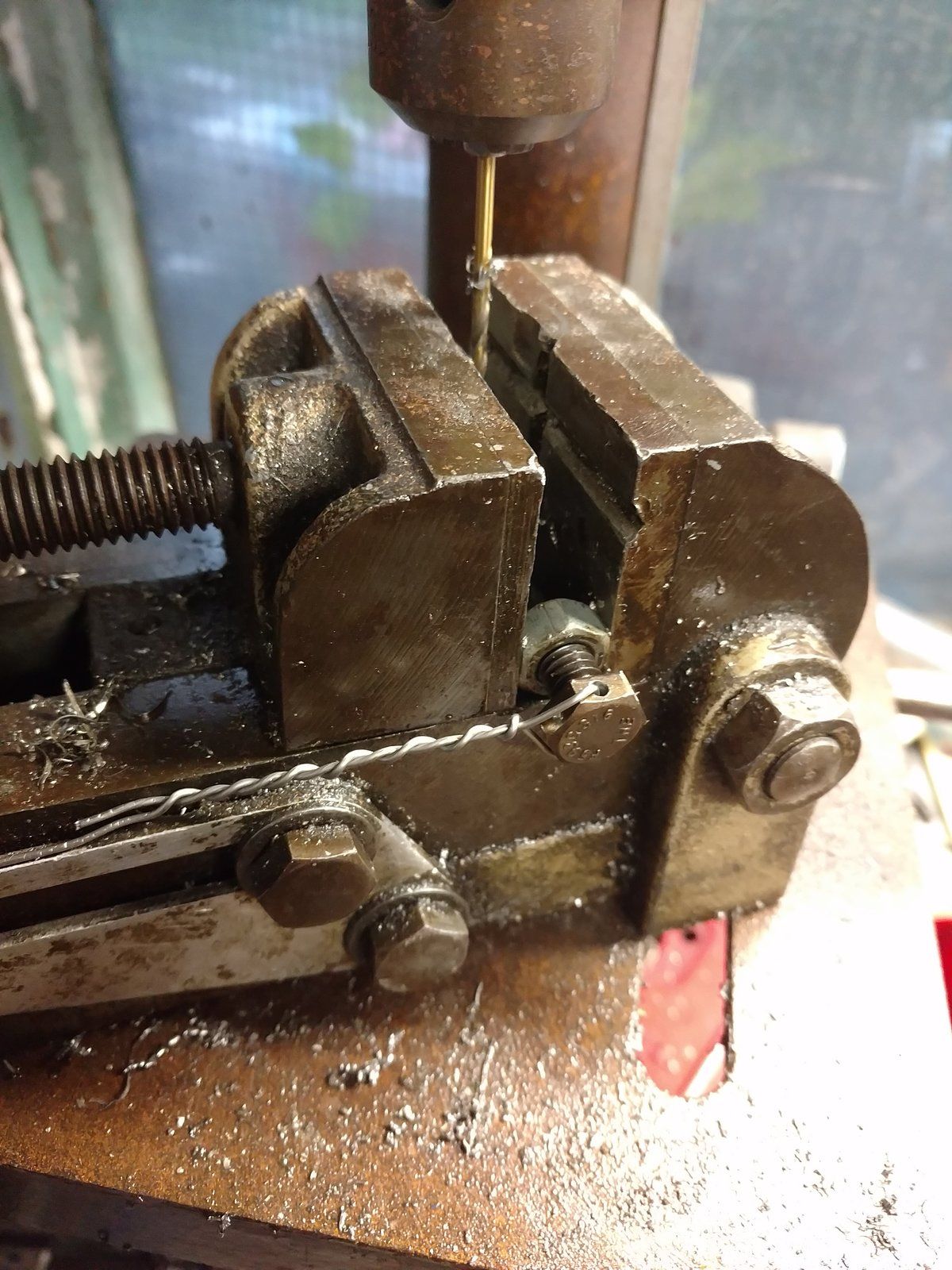

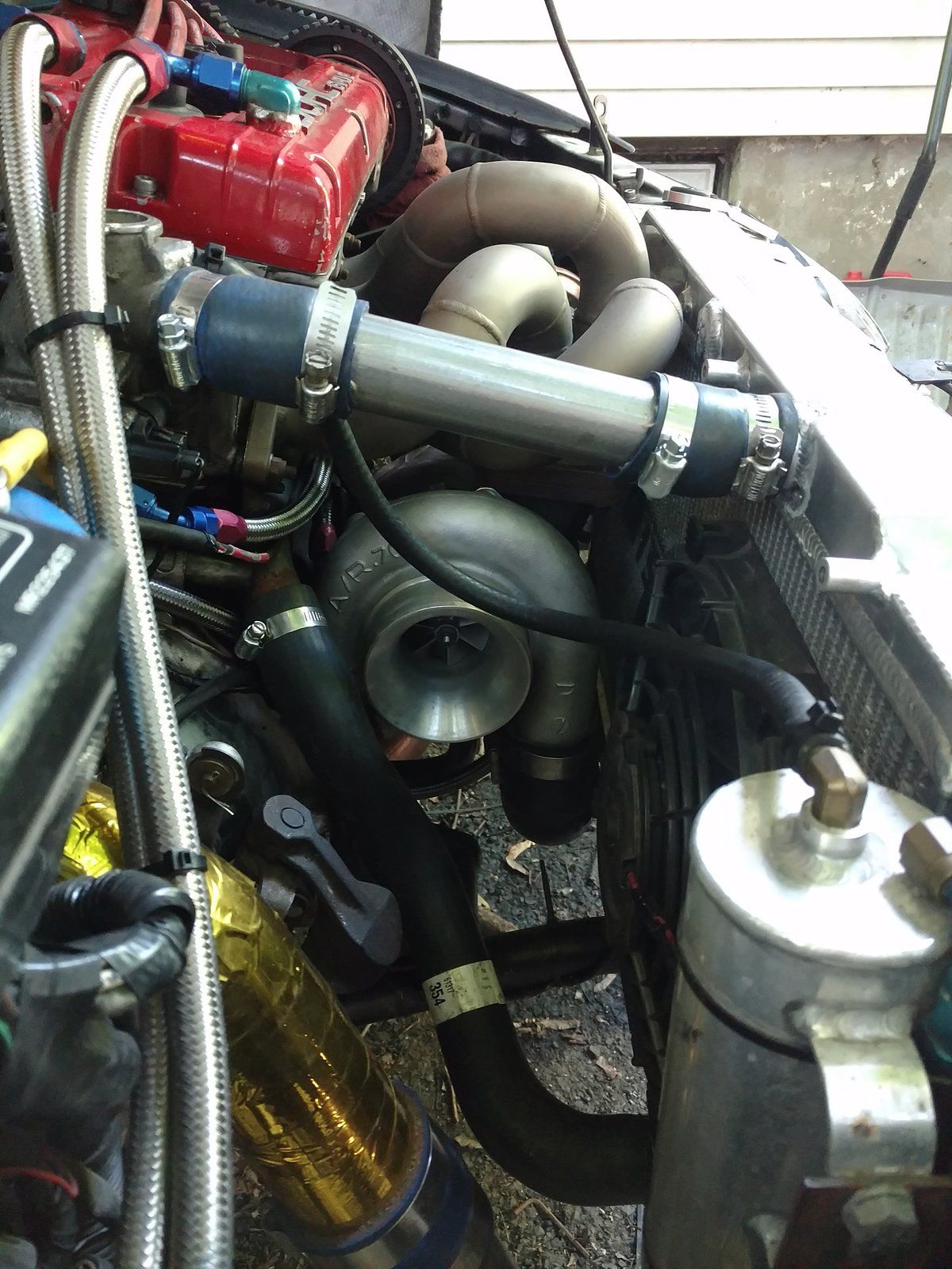

So, not much to update with the car. The Tahoe ruptured a fuel line so I've spent the last few visits at the garage dropping the tank on the truck and cleaning the garage. I DID experiment with a little safety wire situation that I'm gonna run on the turbine housing bolts. That should take care of the bolts loosening up. Also got new studs and picked up a nice copper gasket that should keep from blowing out lest this situation should happen again. But I think we figured it out.
Got to put some work in yesterday. Got the turbo out, and safety wired the turbine housing bolts. First time doing it, and it came out ok. Gonna take doing it a few times to get it good. Also discovered it's way easier to get the turbo in and out from the bottom. So put the new studs in, new copper gasket, and got it back together. Still got some work to do before the last race of the season at Lime Rock.

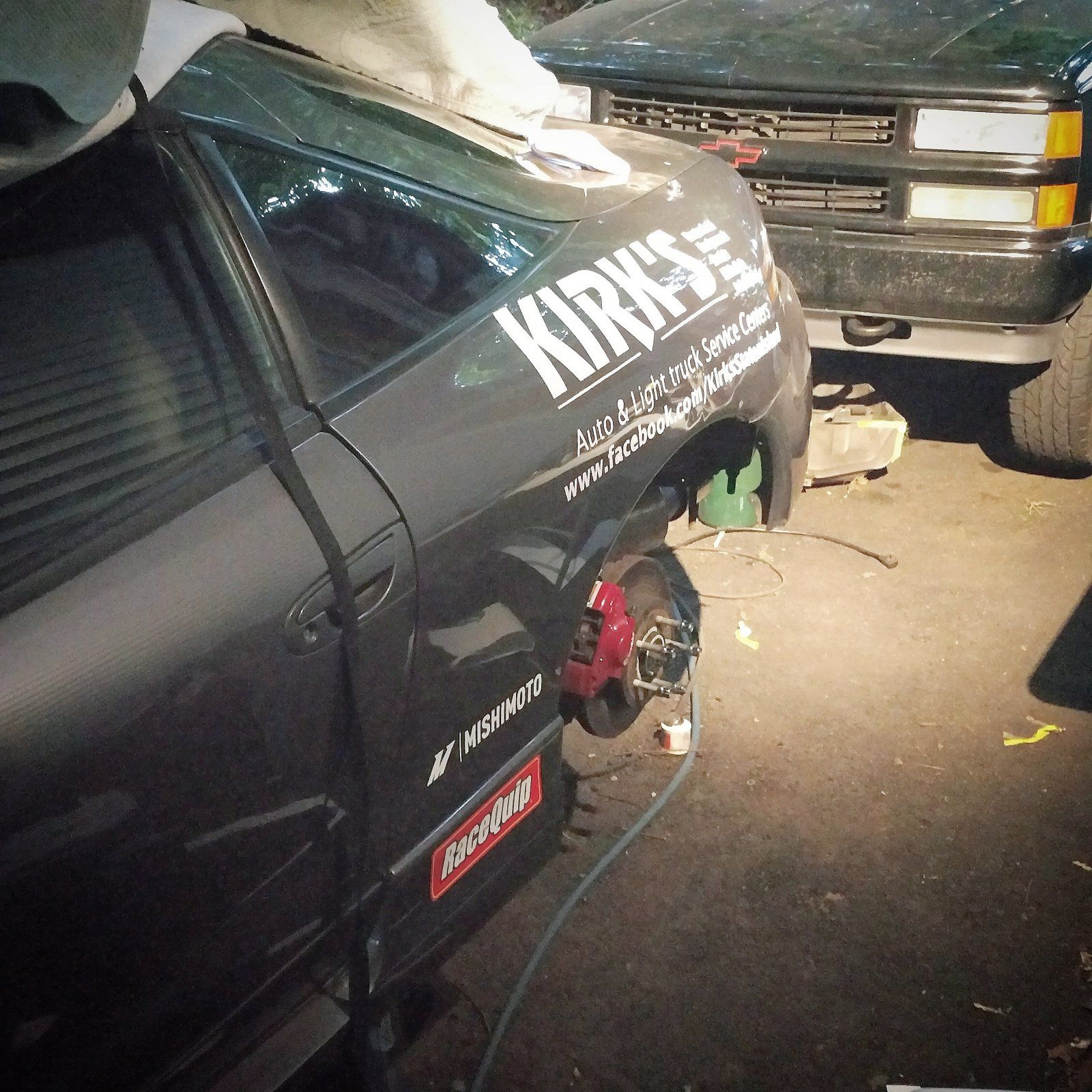

So another issue that I had, was the rear brakes were operating at WAY higher temps than the fronts. So I went over the brake system and found out that when I did the ABS delete kit *cough 7 years ago cough*, I plumbed the prop valve wrong, and had the primary (rear port) going to where the secondary (front port) was supposed to go. So I had rear pressure at the fronts, and front pressure in the rear. So, while that much rear bias would help rotate the car, I didn't have enough front pressure, so now, when it's back to proper, I should be able to go a bit deeper into the brake zone. Now, We just got to work on being able to carry more speed through the corner, which is gonna be tires more than anything.
Also, I wouldn't have even thought about the braking issue, just would have contributed it to insufficient brake pads getting fade, but the rotor temp paint I put on showed how much hotter the rear rotors we're getting which led to some investigating. I had always assumed the front outlet port on the master was the primary port, since most master cylinders work in that manner. But. I was wrong. Live and learn.

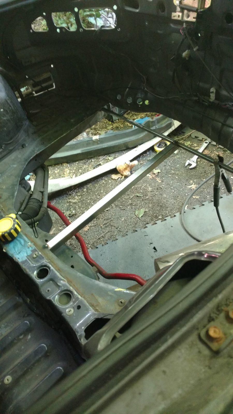

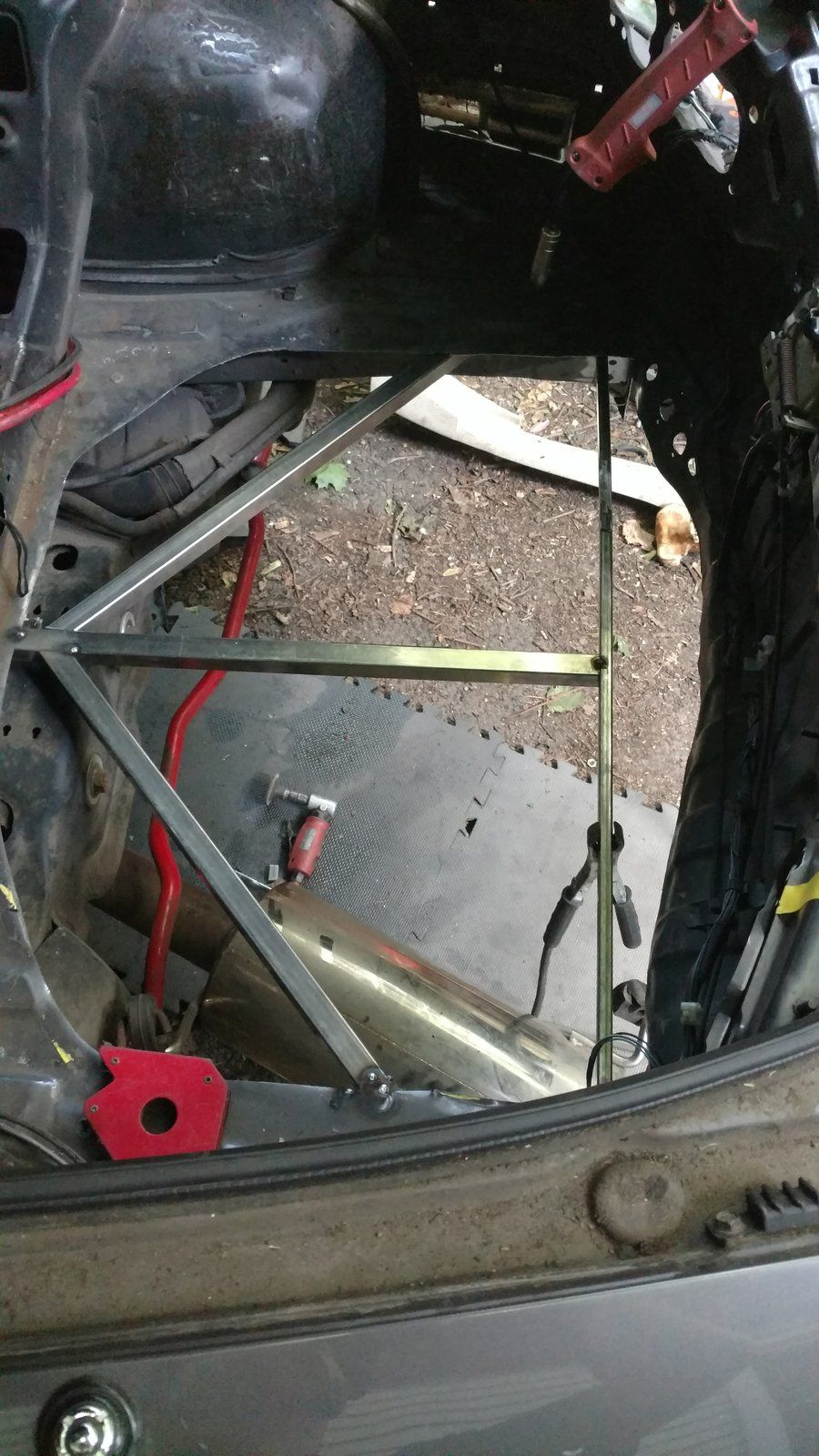

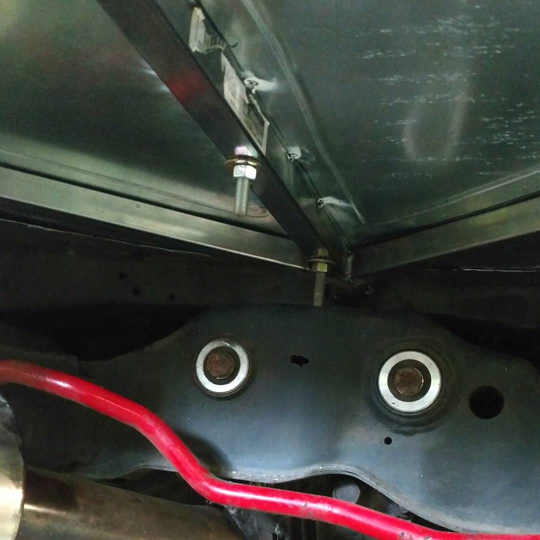

Whata the bracing for? Have you got a panel yet to cover this or you going to make one
Bracing is just to put a little structure back there and the battery is gonna be back there as well. Making a panel today. Well.....two panels cause I don't have a enough metal to make one panel LOL.
If the battery is there then thats cool, makes sense,

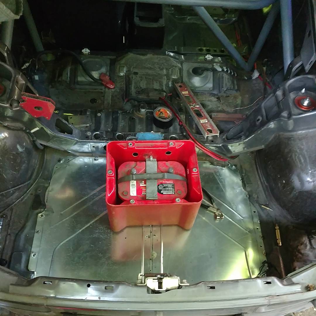

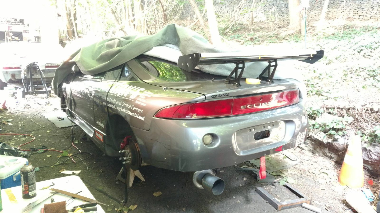

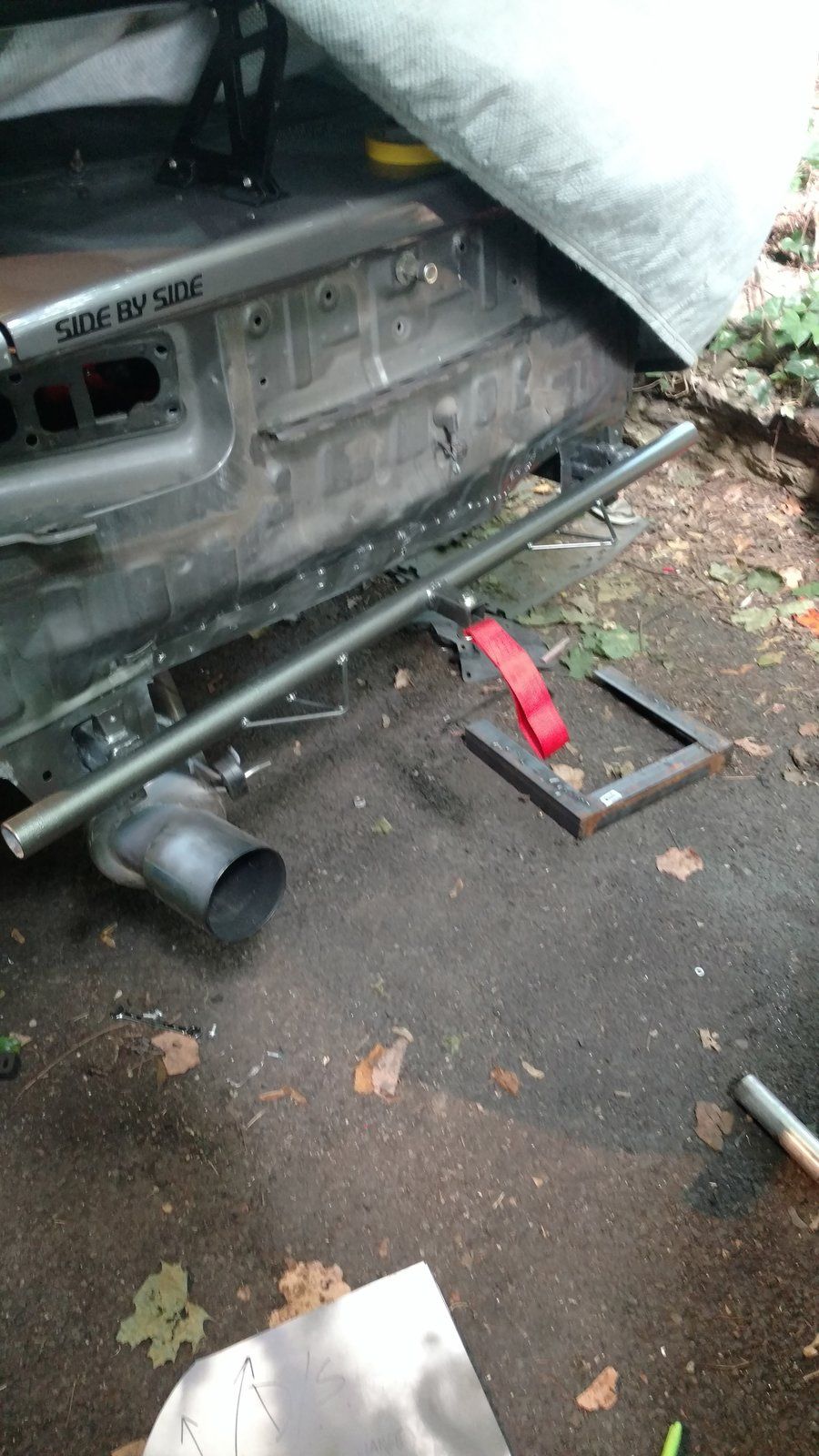

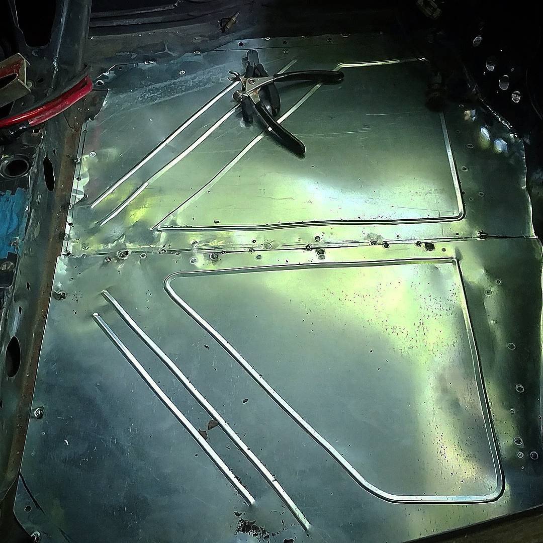

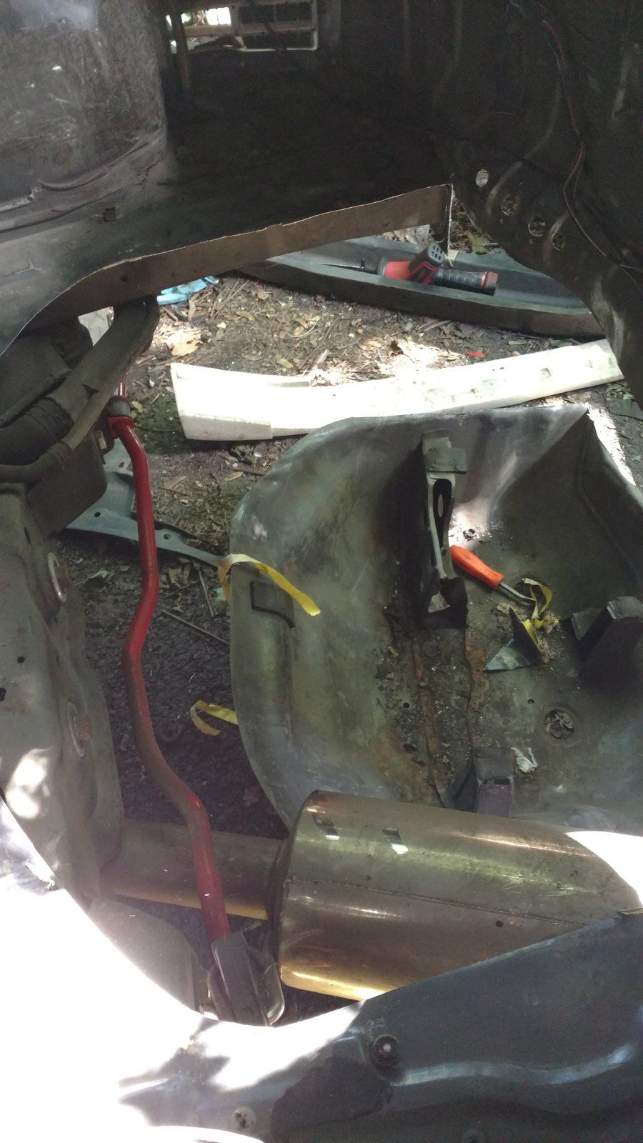

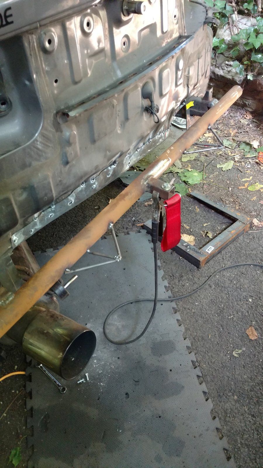

So day two of operation sparetire well delete. Not super happy with how the floor came out, but it'll have to do till the off season. Also had some old roll cage tubing laying around, so I made a bumper, or bash bar as the drift guys call it. Also mounted my tow strap as well. All in all, not a bad weekend of work.

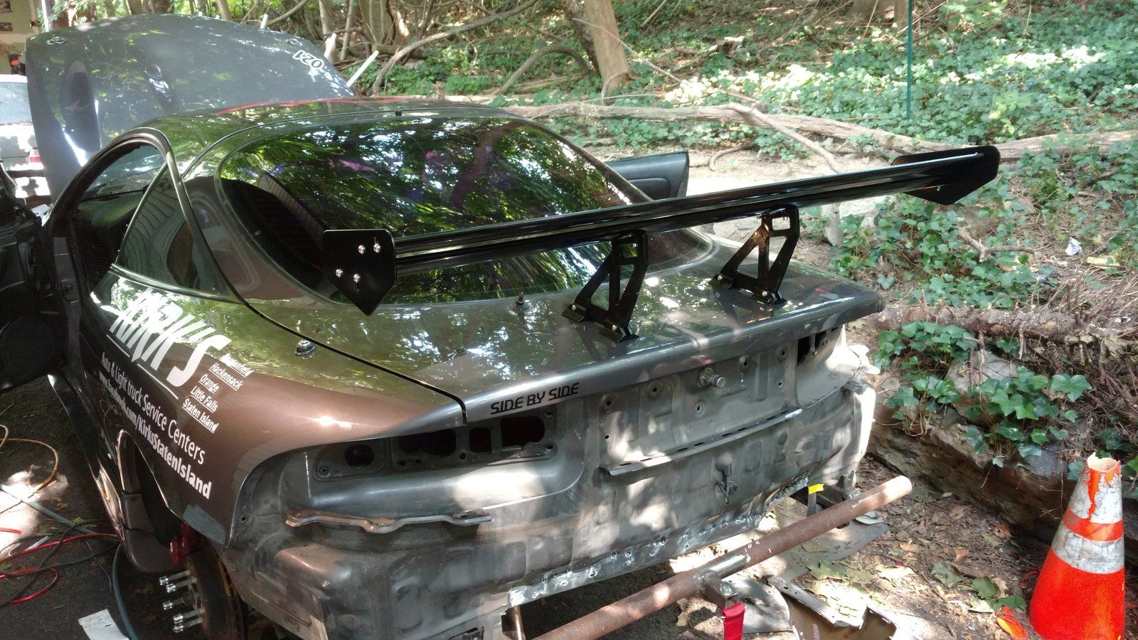

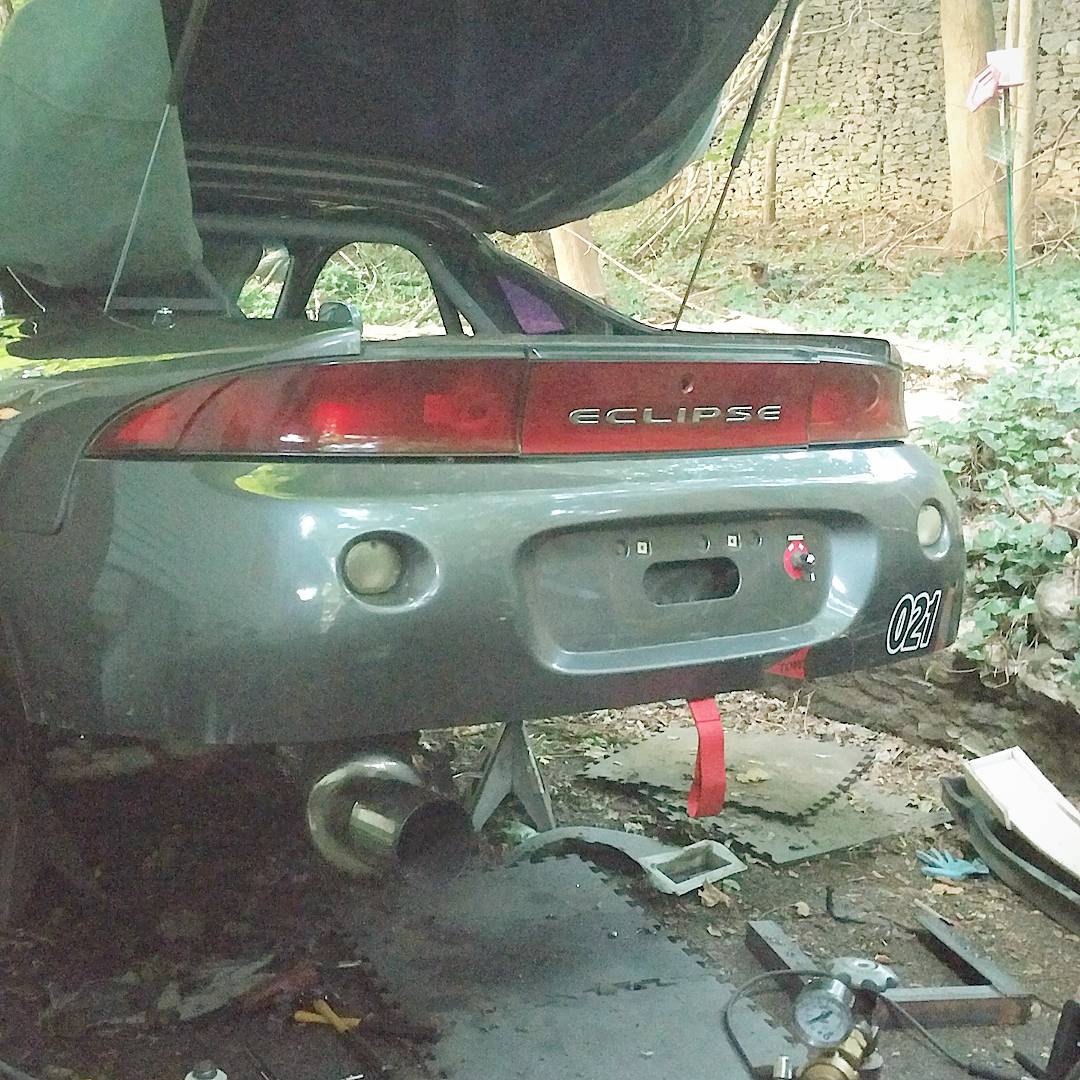

A little more work over this last weekend. Made some rear bumper brackets. Painted it all up nice. Relocated the master switch to inside the car. Installed a wing I bought. Not the best wing as it's not chassis mounted or anything, but I'm going to make some modifications to it to hopefully make it perform better. Also rerouted my wastegate dump back into the exhaust since I got pegged for being too loud at Lime Rock last time I was there. Hopefully this meets the requirements. Got a little over two weeks before the race, so still a lot of work to do before then. But most of it is on the truck at this point.
