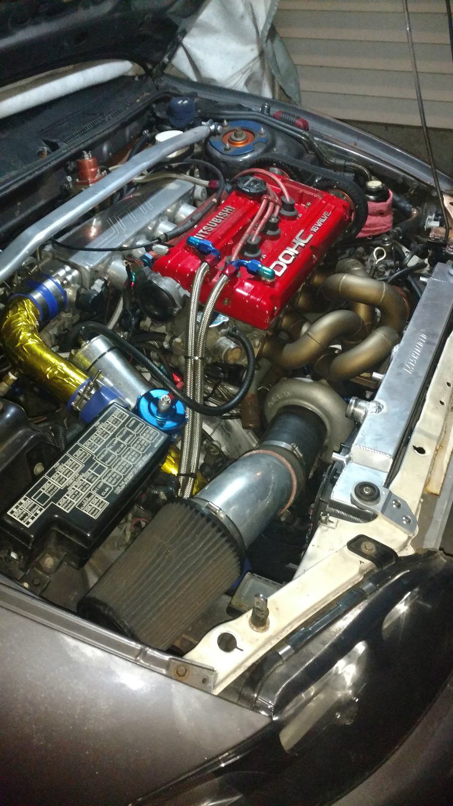

I actually have two fans already. The one on the driver's side is a pusher (obviously LOL). But I was considering leaning the rad forward a bit to aid in removal. We'll see what happens.
it will help you alot in space and time so will be a great idea to do, good luck on the progress and keep the good work up

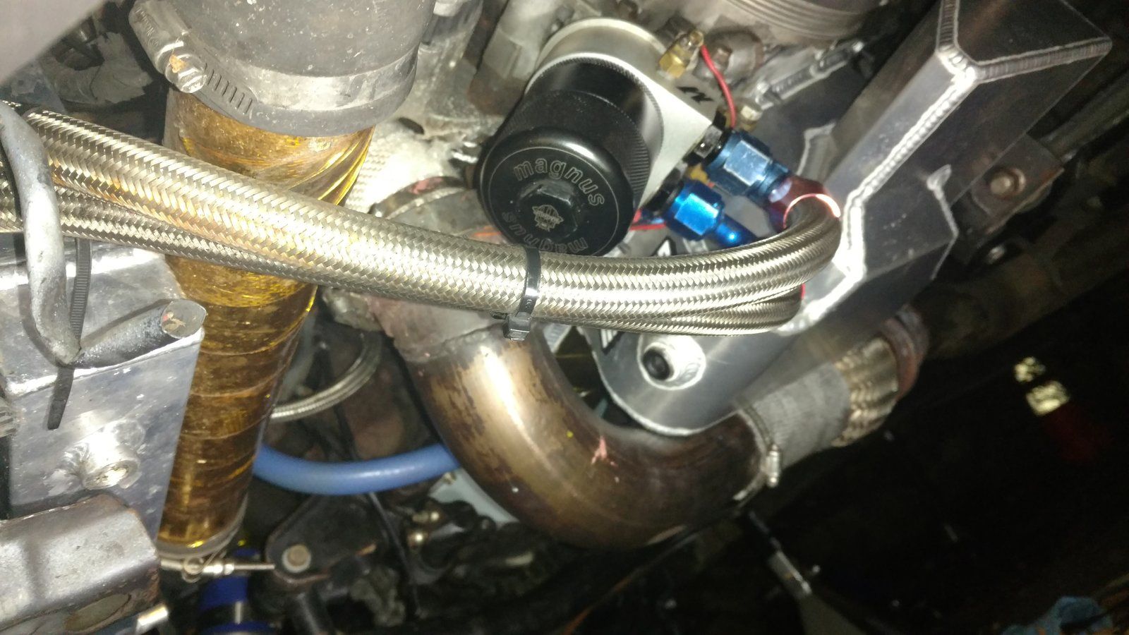

What's your impression of the magnus reusable oil filter?
My magnet came out, the glue did not hold the magnet and ended up flosting inside the filter but not the pan, magnus do not make it but rather sell it with their laser etching on it, other then coeaning out the filter its a good unit, you have to make sure its tight as i have had it come loose before even though i had it pretty tight (or so i thought) haha
Really? Wow. I've had mine a long time and never had a problem. I'll be extra mindful of that next time I take it apart.
I dont know if i am the only one or not. Just be cautious incase, the glue got hard for the heat and just broke up,

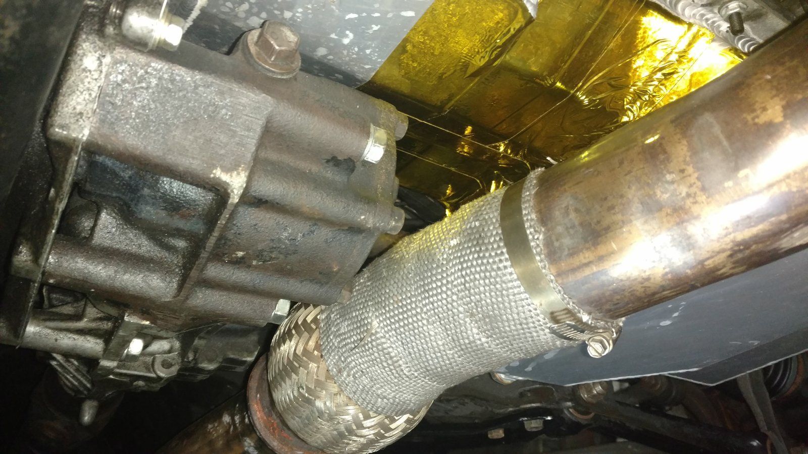

Small suggestion:
Your downpipe passes very close to the oil pan. It may be a little tight to wrap it, but perhaps you could reduce oil temps by putting reflective tape on the pan on any areas that come close to the downpipe. I just had to do this on the Evo.

Small suggestion:
Yes! This I know. I've gold foiled the pan (tough to see) and I'm also going to have to "mod" the downpipe some more with BFH LOL. I want to wrap the downpipe so that's something I going to work on next time I'm over there. Thanks for the insight! Much appreciated. Always like getting ideas from people. It's Definitely too close as it sits to wrap, and without further modding it actually rubs on the tcase as well. So a little more heat and a little more beating LOL. I took these pics at the end of the day when I was getting ready to go home.
