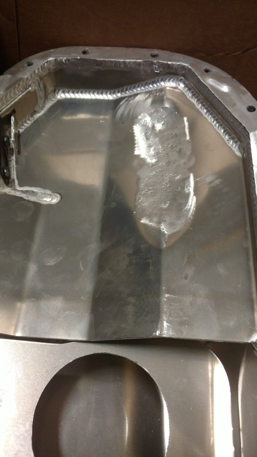

Welp. Two weeks out from the first event of the season. Fired the car up for the first time since November today and apparently, the stroker crank and Moroso Oil Pan are having a disagreement over space. So tomorrow after work, I get to go to the garage, dump all the fresh oil I just put in and take the pan off. Hopefully, I can persuade the pan to stop arguing with the crank and put it back on, otherwise it's back to the stock pan for now. #racecarproblems LOL

I thought these tanks were adjusted and designed for strokers so this did not happen?
That sucks though but it should be a somewhat simple fix, many use a hammer and tap the area down if its just a plate or something

Hoping that's the case. Since I only have this one event then don't go back out till August, I'll probably just put the stock one back on just cause I know it'll work. Then over summer get this pan to work. I'll know more when I pull the pan later. Gotta love doing things twice!!

Yeah better safe and work now then damage parts,
I still cannot believe it dont clear, like what company makes a pan stock and not consider different options! Like hello resewrch before you build idiots

What drives me crazy is my buddy's G4CS has the same pan. No issues. Now, I don't know if the flange for the pan on that block is further from the crank, but that was not what I wanted to have happen so close to raceday LOL

I thought only the deck height was different so it should work, maybe the crank centerline to pan flange is different. Maybe you can measure it and get your friend to check aswell,

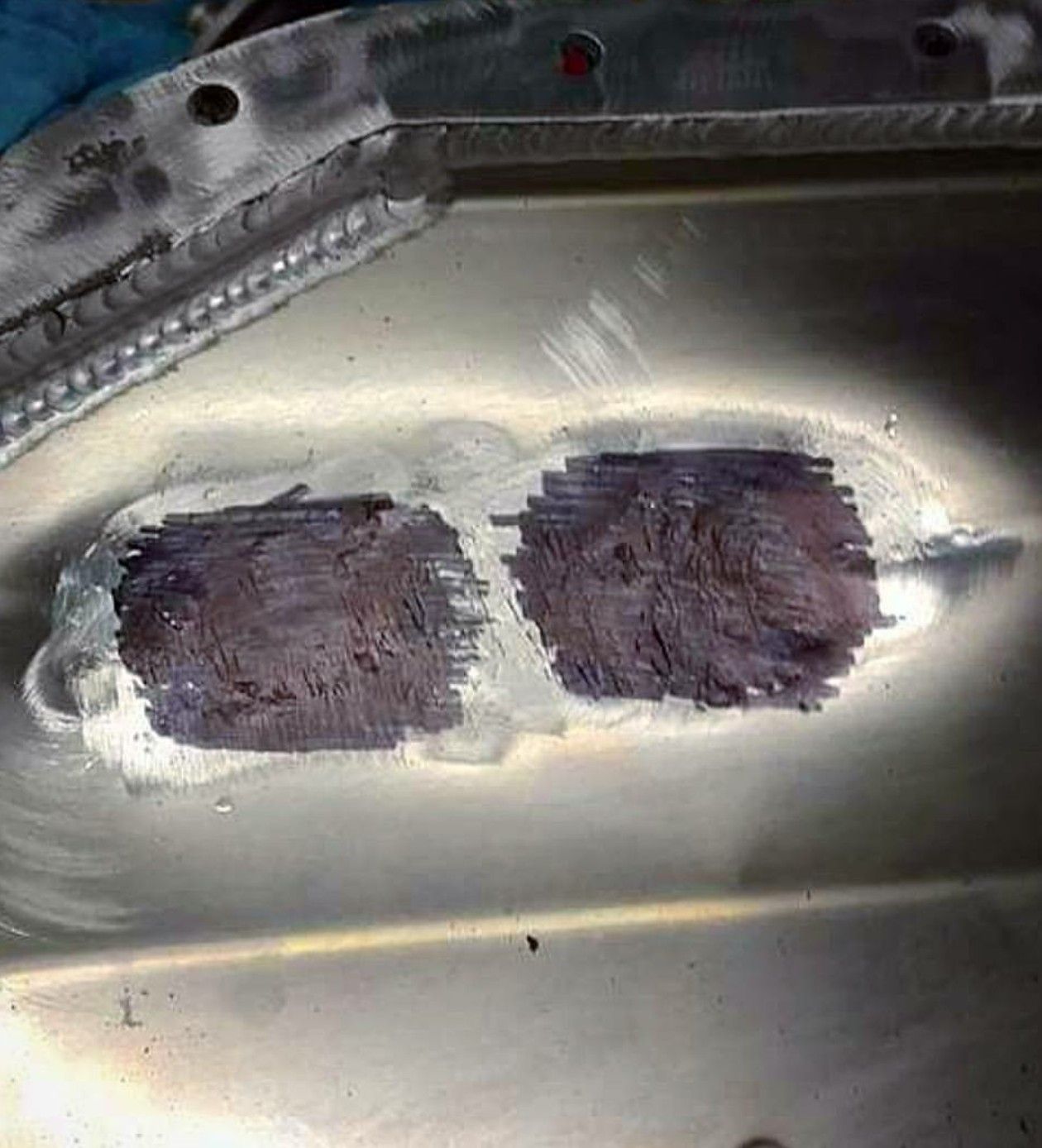

Got the pan down yesterday. And as I thought........El smacko. Looks like the counter balance was hitting. So while my buddy cleaned off the bottom of the block, I took the hammer and massaged the pan a bit. Marked the pan with a sharpie, put the pan back up with a couple bolts, spun the motor with the plugs out, and double checked that it wasn't hitting. Thankfully it wasn't. Brought the pan to work and cleaned really well in the parts washer. Now, to put the pan back in....Again, and get ready for Pocono next weekend.

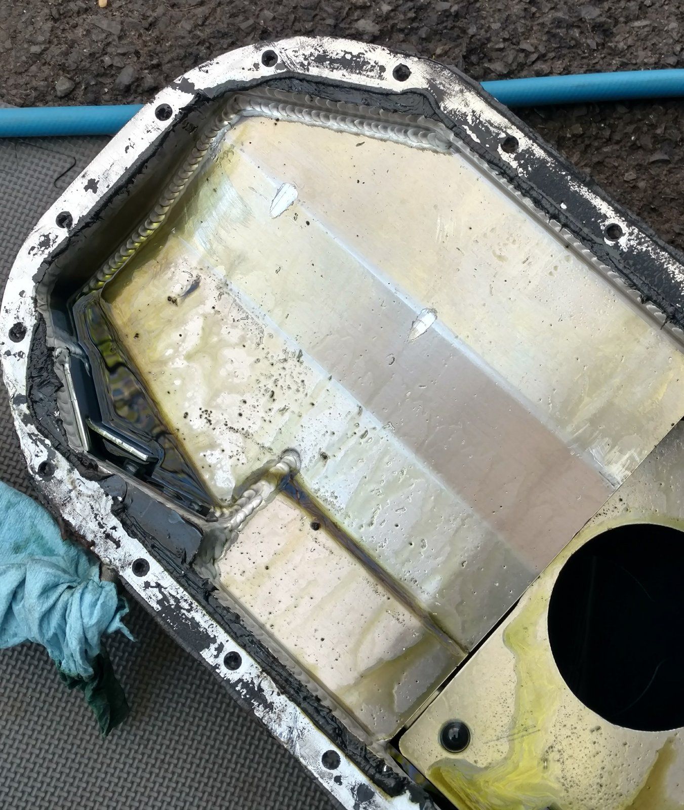

Wish I had a definitive answer to that. As you can see, it was just grazing the pan. If you're still using the 2.0 crank, I imagine you'll be fine, but I have absolutely no data to that effect. If you do decide to go with the pan, do yourself a favor, and do a dry run before sealing it. I use the right stuff which is the best sealant in my opinion, but god help you if you need to get the pan off after it sets up.
Well, spent some time on the car Saturday. Put the pan on, spun the motor by hand and it was hitting lightly somewhere else. Couldn't even hear it, felt it when I was spinning the motor. Pulled the pan down, "adjusted" it and put it back on.....No hit. Put everything back together, fired it up and let it run for a good 45 minutes. All good! Pocono bound this weekend!!

I apologize if you've already answered this question, but what aftermarket oil pan are you using and is it any larger in fluid capacity than stock?
Not a problem. I'm running the Moroso aluminum oil pan. Got trap doors and increases capacity to 6.25 quarts. Apparently, these pans don't like stroker motors, but it's been corrected.
