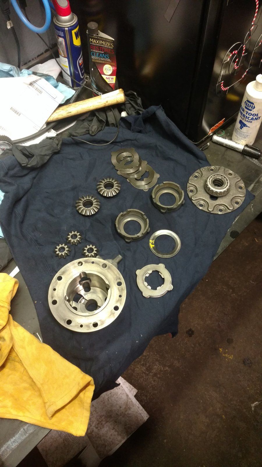

Also, took it apart today at work, cleaned it and reassembled it. I think I'm in love LOL

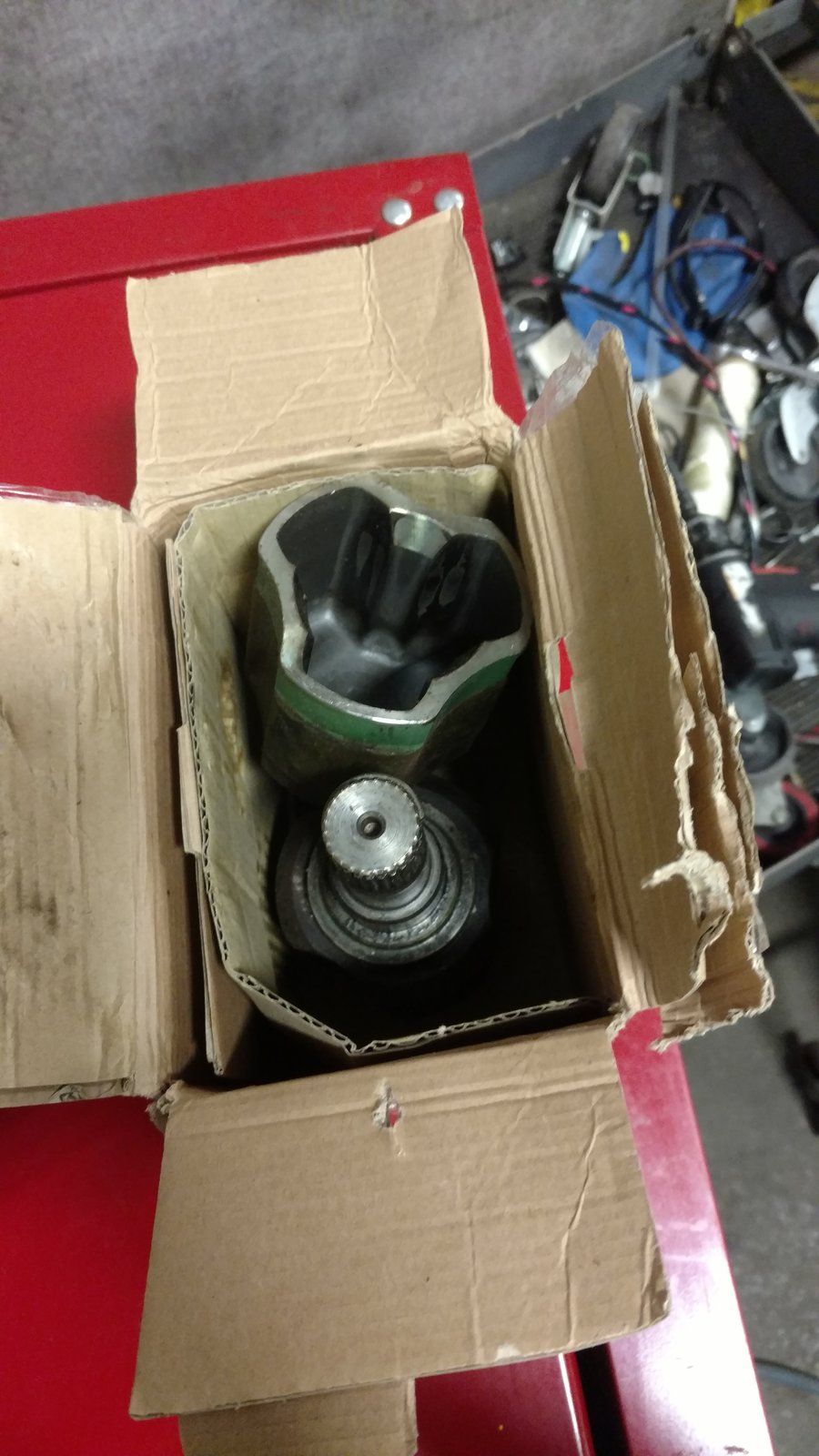

I bought mine from a guy parting out an Evo. Have to keep an eye out almost everyday as they usually go quick. Also, check ebay as I've seen Australians sell evo 3 cups.

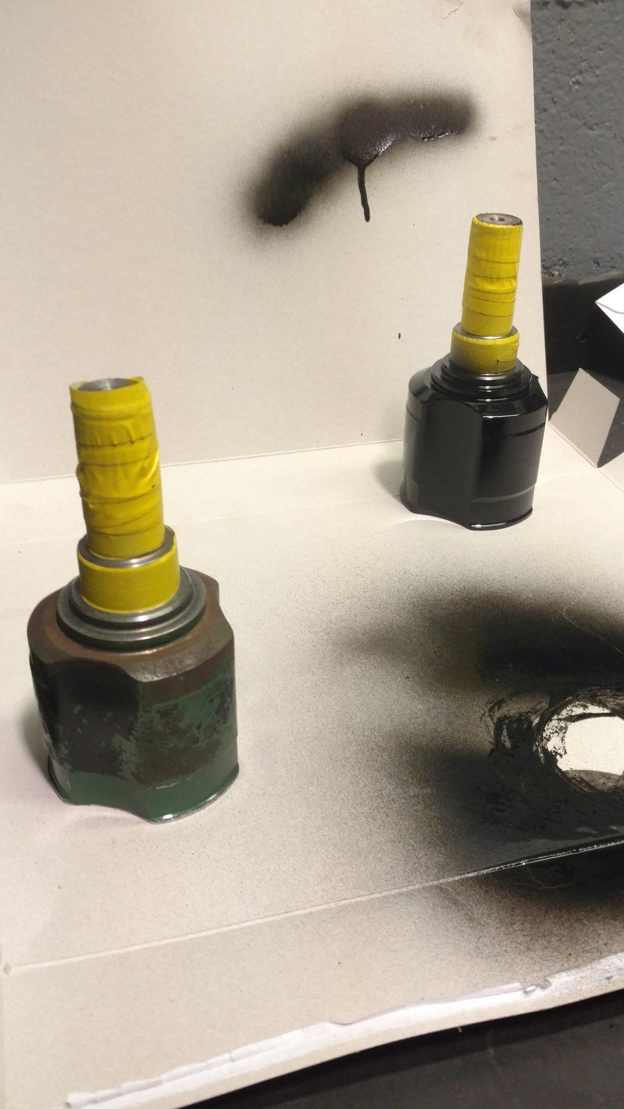

Our tripod bearings measured only a few thousandths different than evo bearings. I literally just bolted the evo cups to my axles and all is kosher. 7 months, about 1500 miles, and over 150 autocross runs with launches and power sliding and they're still fine. (Enough abuse to trash my center diff.)

I found mine on EvoM...same thing tho. Was watching for a couple weeks and then had to snap em up quick. I got the axles and a evo 8 diff in the same deal. There out there....they just go fast. :)

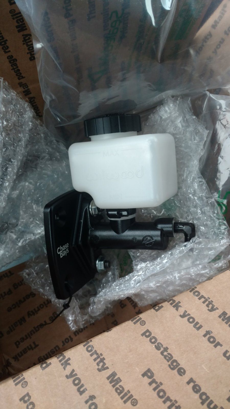

I also what to get your feedback on that ChaseBay MC. It will free up a lot of space in the bay!
This was just the cheapest option for me. My racing budget for the year is pretty tight as it is. If this works as well as an Evo8, as I'm inclined to believe through what I've read, it should do fine.
And absolutely. I'm really excited to have brakes that give some feedback LOL
Just wanted to say that the Evos 2-9 all use the same rear mechanical LSD - MR166619
The only difference is the Evo 3 is an older unit.

They are all 1.5 way clutch type differentials. The only thing I can think of is if the actual discs are a different size, but that would be a minimal difference. Set them to 100% lockup and have fun!

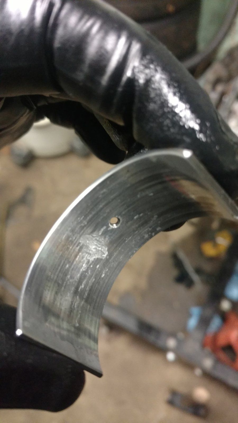

So today I pulled the motor apart. Measured the pistons and cylinders, everything is still in spec. .005" piston to wall. Looking good. Did find an issue though. Looks like a couple bearings were starting to cavitate a bit. The pic I posted is from cylinder 4 lower rod bearing. Trying to figure out what caused it. From what I'm reading, it's air bubbles in the oil. Not sure how I'm getting that. Maybe an update to the oil pump. Not sure. Any ideas?
Sloshing causing the oil pick up to become partially open to suck air?
But if you can wait it out. The Frontline fab oil pump is about to be available or is for 6 bolt motors. Might be good to look at for consistent oil pressure.
Well, I'm running the Moroso oil pan. Can't see that it's sloshing to the point of aerating the oil. Also this was the only bearing that showed signs of this.
I'd love to get that Frontline oil pump, but I do NOT have the money for that LOL. Maybe eventually. But not now.
