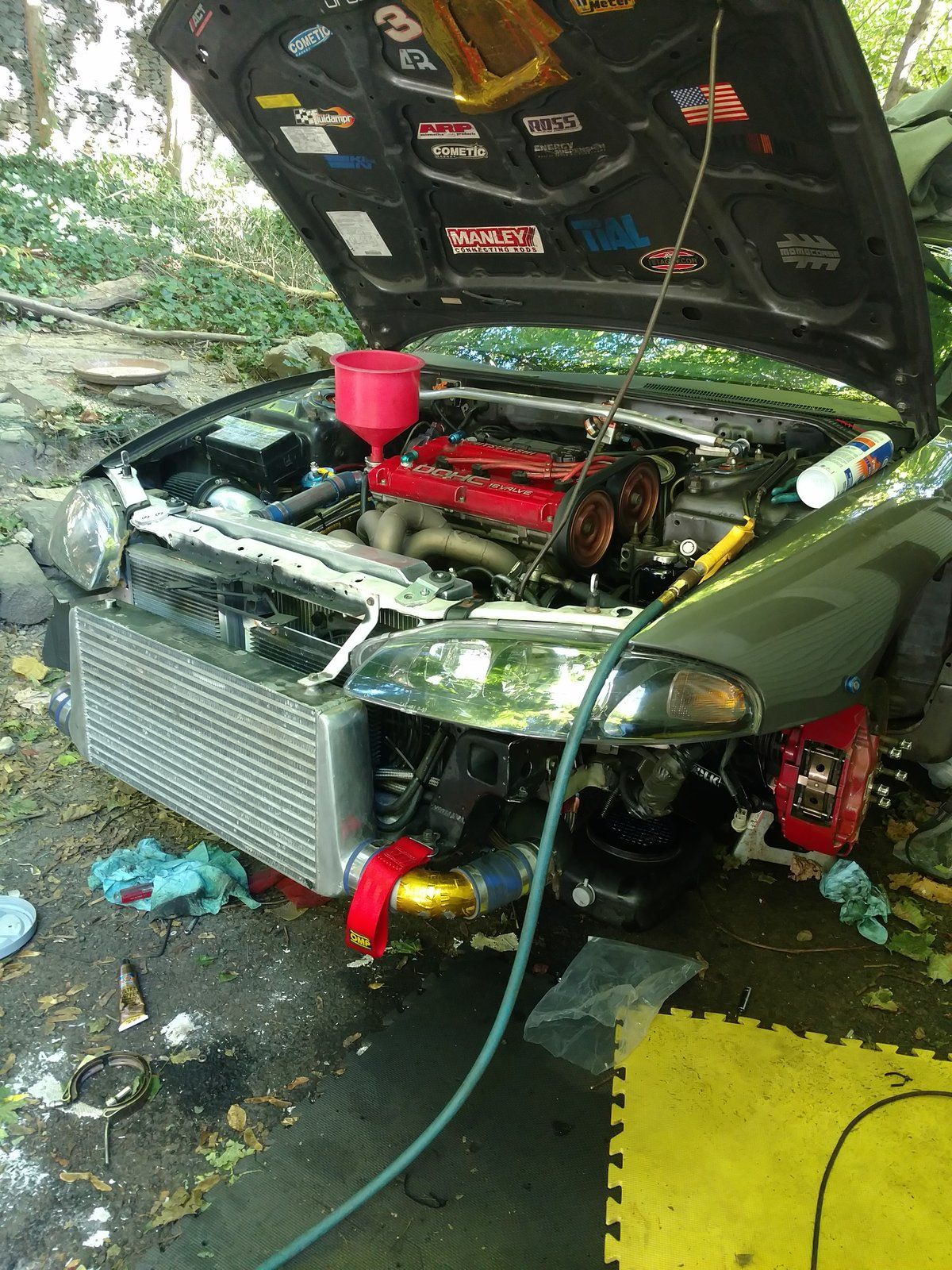

So. Just about two weeks out from the last event of the season. Got a lot of work to do this weekend to get ready. Fired the car last night. Bled the cooling system. Going to put fresh oil in it tomorrow. Still have to make a front air dam. And then I have to turn my attention to the truck. Put the new fuel lines in. Put the fuel tank back in. Do the RF hub and the B1S2 O2 sensor. A lot of work to do. Gonna be tight.

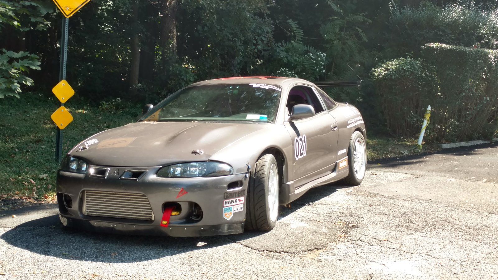

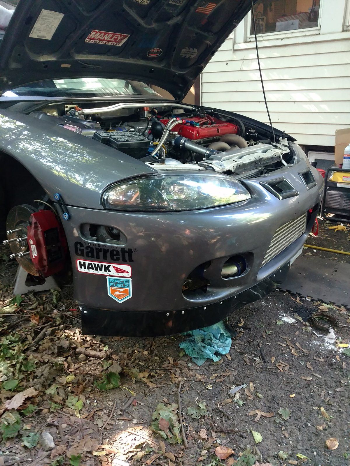

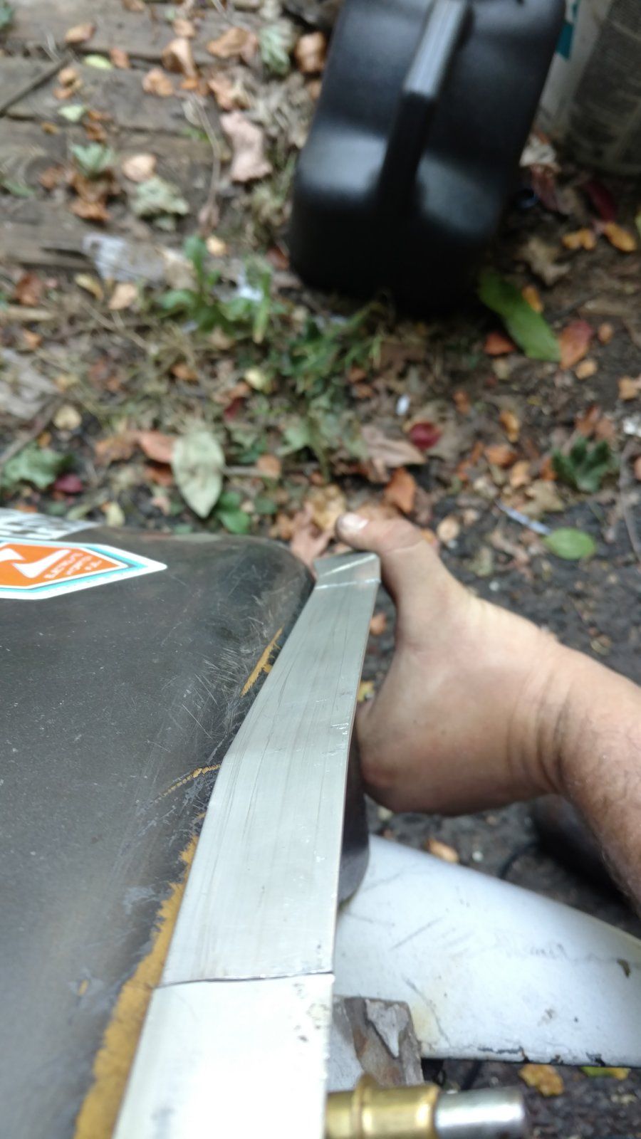

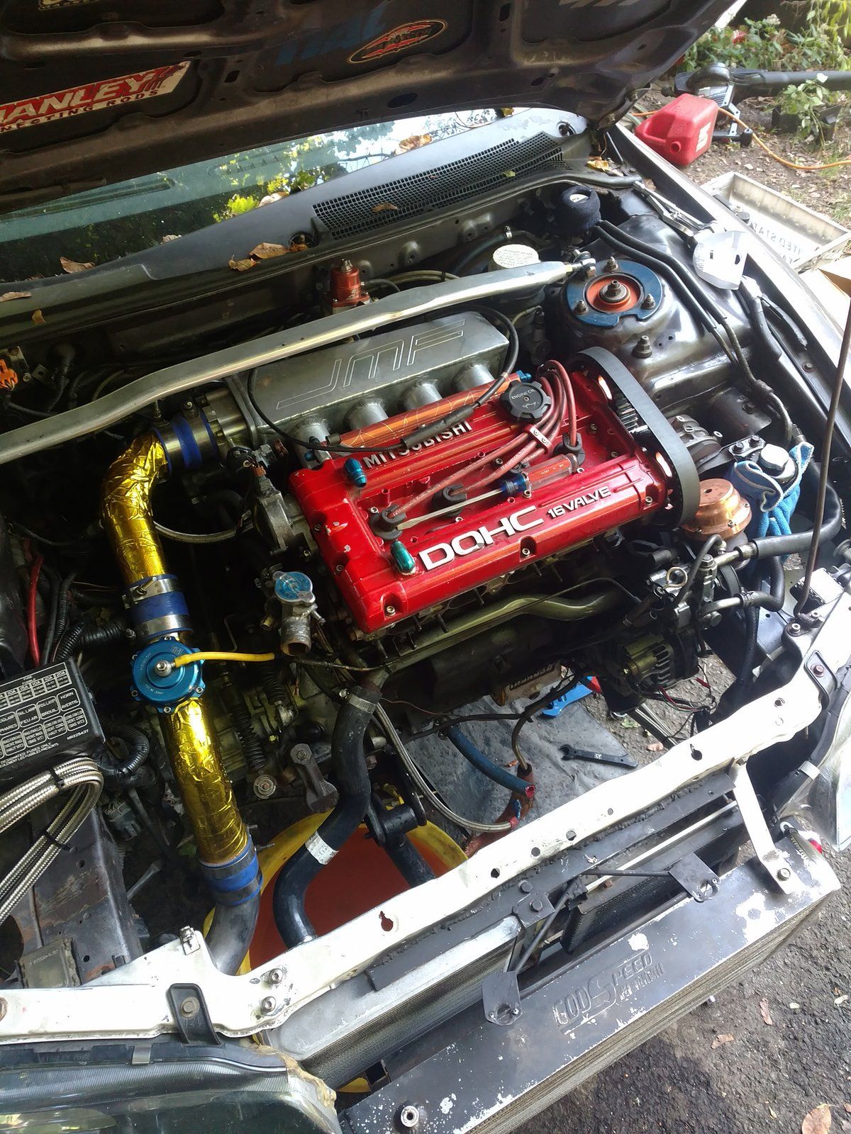

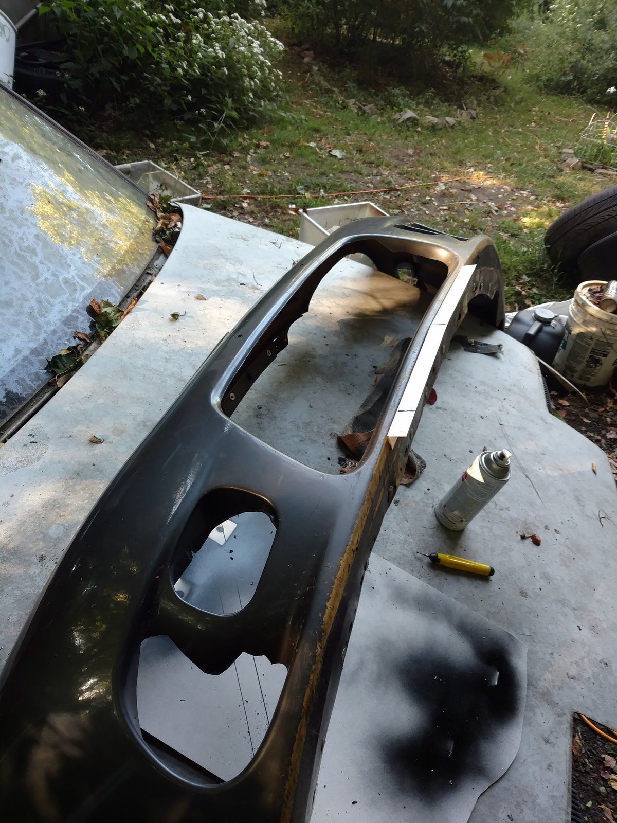

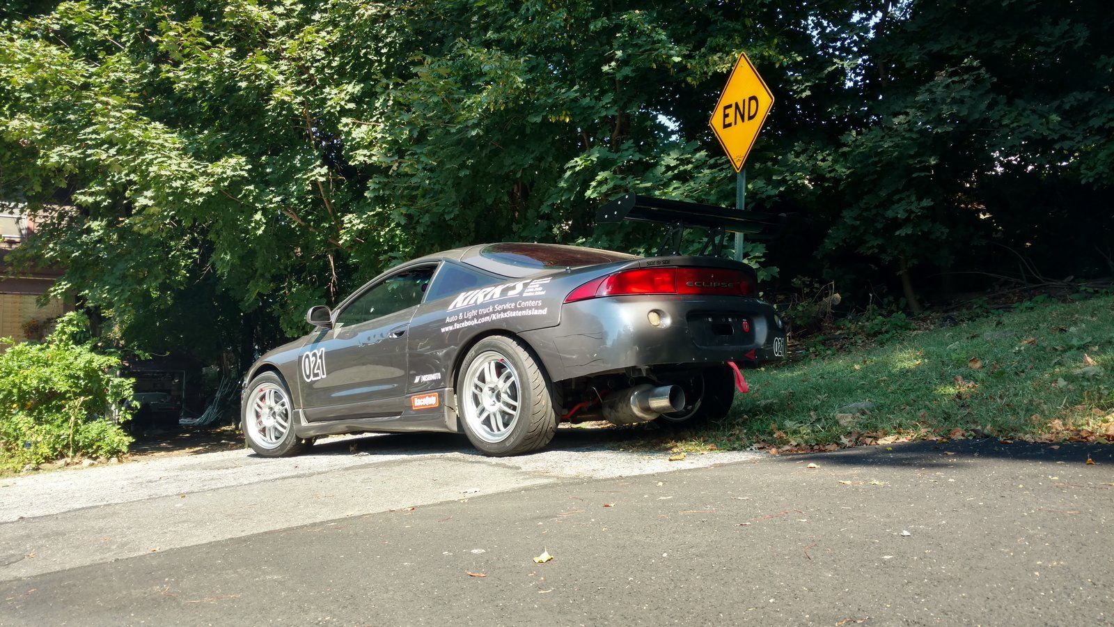

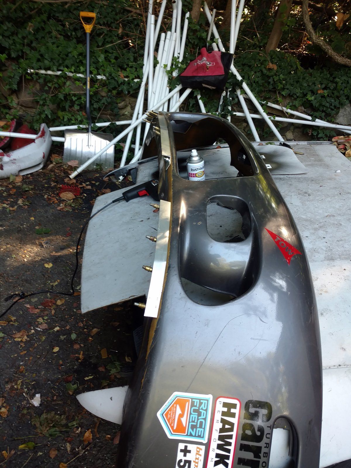

Had a great/busy weekend. Got the fuel tank/lines/sender, hub bearing and O2 sensor in the tow vehicle. But the big work was on the eclipse. Exhaust is back together, changed the oil, started the car up, bled the cooling system. That was all Saturday. Sunday, I made a front air dam, got the car on the ground and drove it down the street. Actually starting to look like a real racecar!

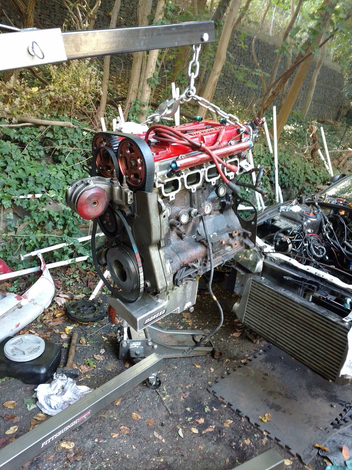

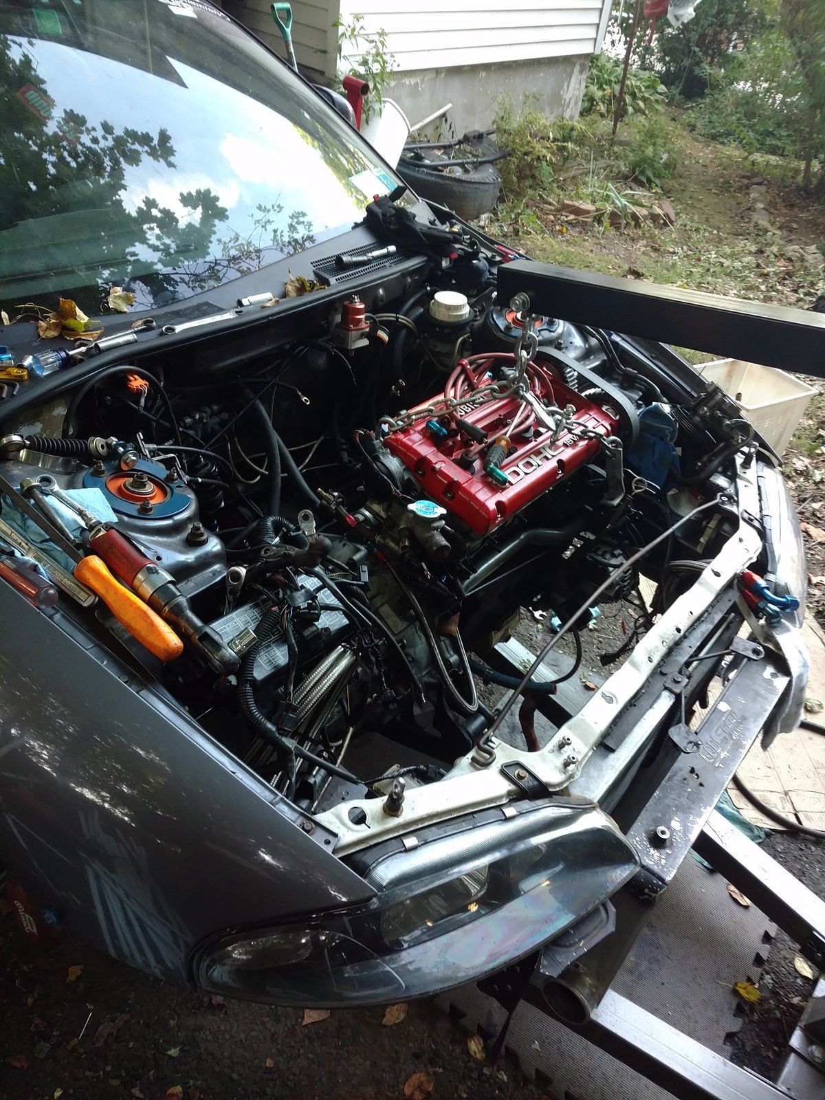

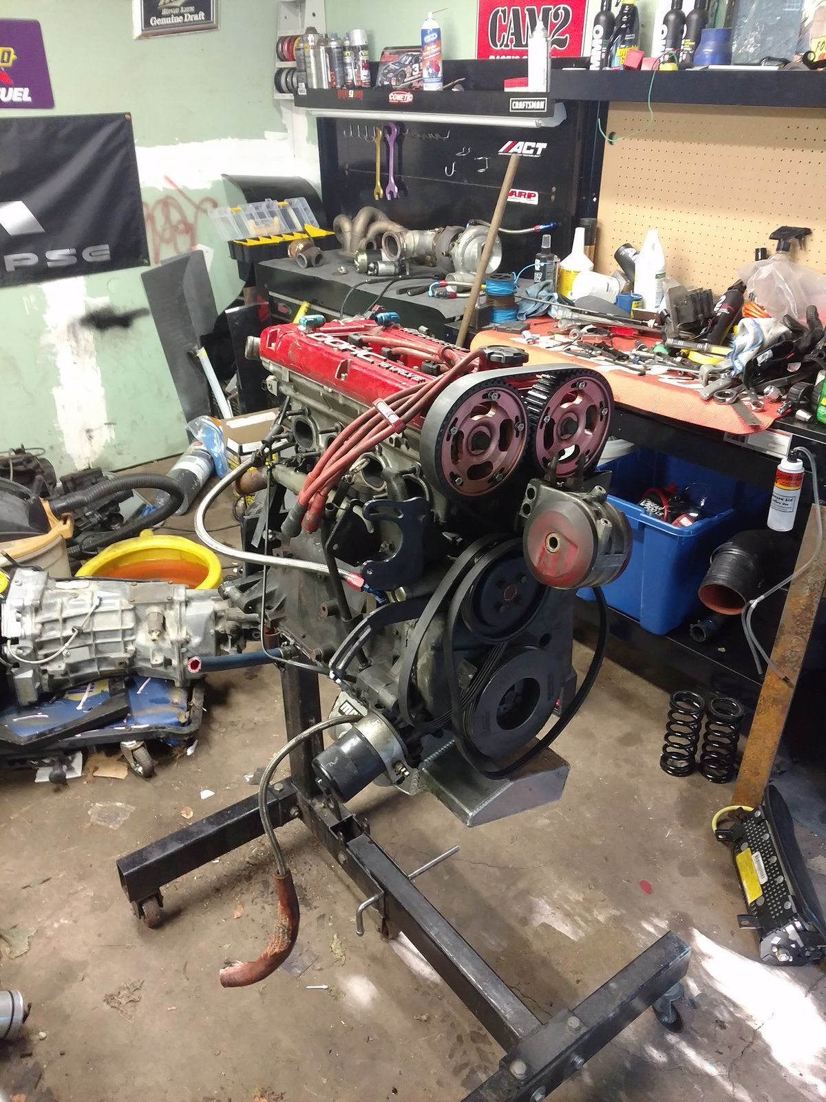

Pulled the motor this weekend. Right away, noticed the exhaust valve seals have started to leak. Also found out that a bolt that holds the engine/trans plate came loose and was bouncing around inside the bell housing. Not sure if it was what was causing my loss of clutch action, but we'll be changing the clutch out anyway just to be sure. Also sending the manifold back to Archer to get recoated and hopefully get the stud issue figured out.

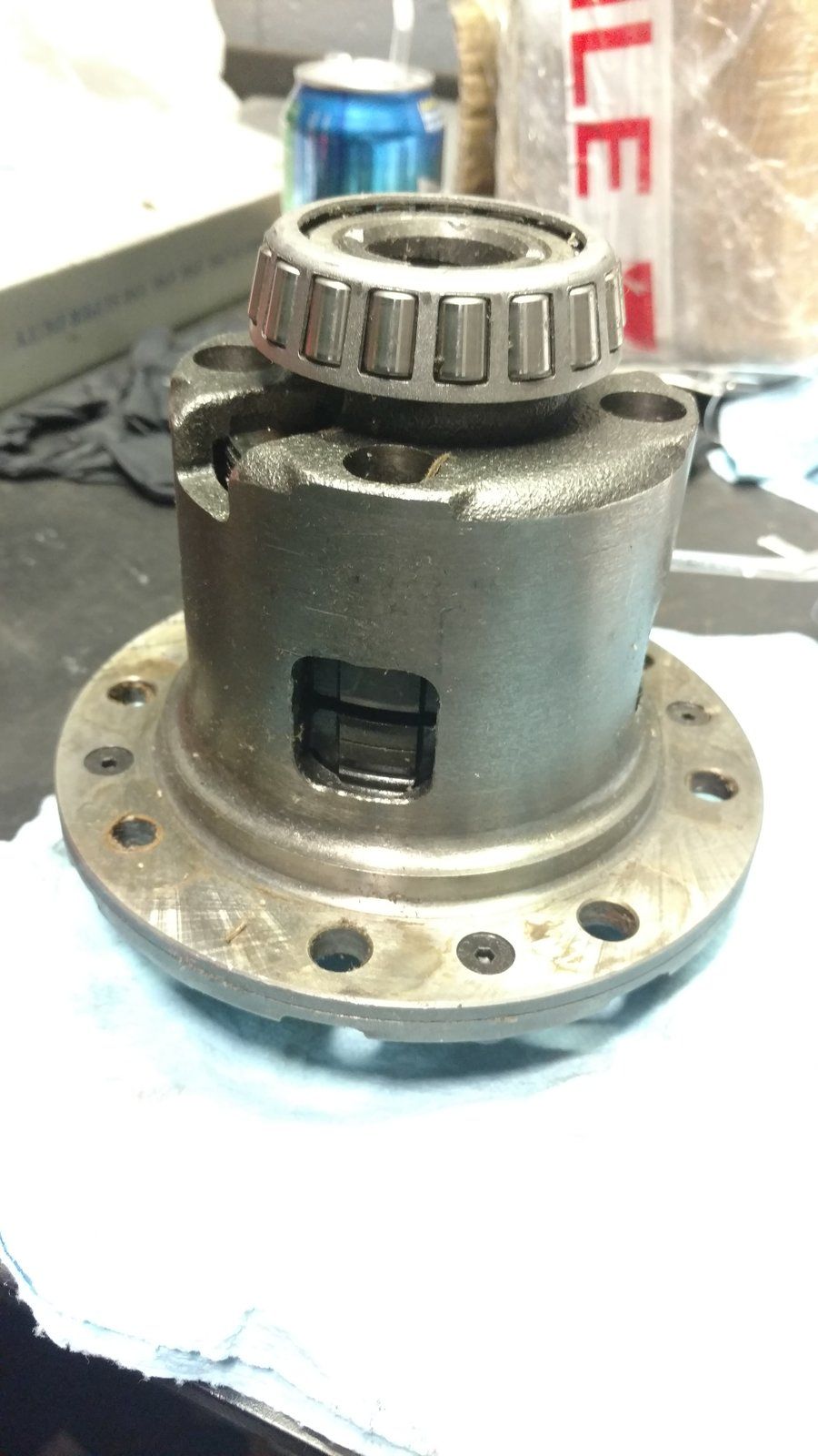

My Evo 3 LSD came in yesterday. DHL decided to ring the apt while I was out walking the dog, so THAT was an interesting text from my wife. "what did you order that's 10 pounds from Malaysia?!" Lol. So another step towards getting the car a bit better. Just gotta figure out what axles to go with. I've heard Evo 8 is the only axle/cup that will work. Then I read that 2G non LSD inners work. Then I rear they don't. I need to figure out a definitive answer.
