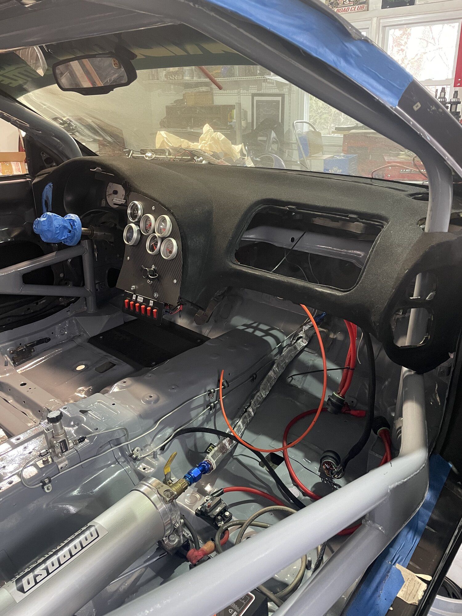

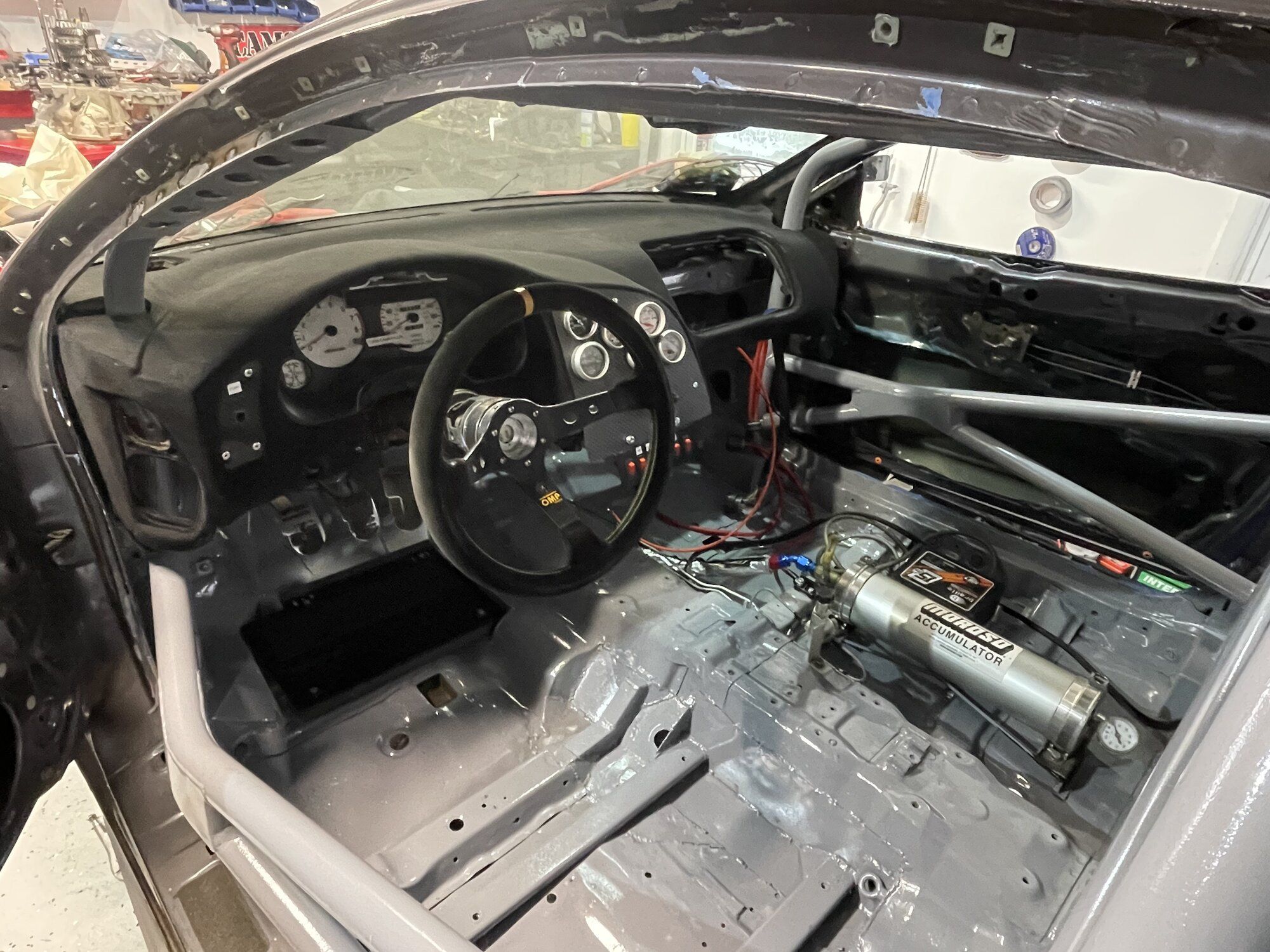

Electrical is done for the most part. Got a cool little belt hold down/reel thingie that wraps up the belt tails really nice. All that’s left is wiring the brake lights and cool down light. Next up is getting the suspension baselined in the rear, pressing some bearings onto the output shaft, doing a new 4th gear blocker ring in the syncro, measuring preloads and getting the trans back in the car.
