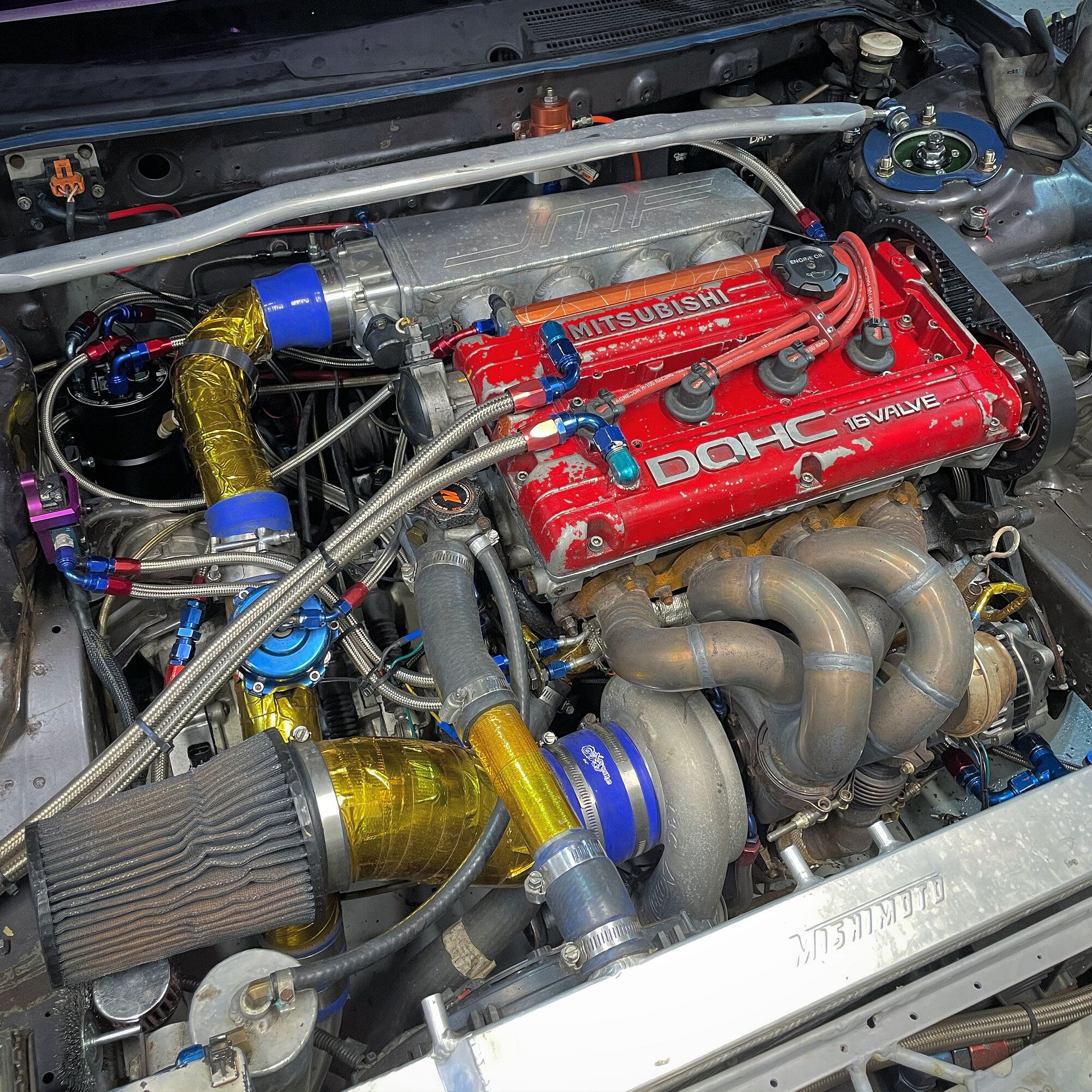

Going to work on getting the car fired up today, and possibly on the trailer so when we get back from vacation, the car will be ready to go to the dyno. But’s coming along. Gotta change the oil, finish the wiring for the surge tank and tighten up the clamps for the charge pipe. Don’t see why I wouldn’t be able to fire it up today though.

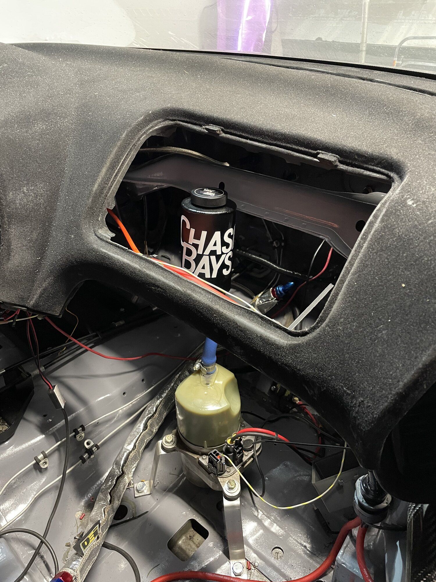

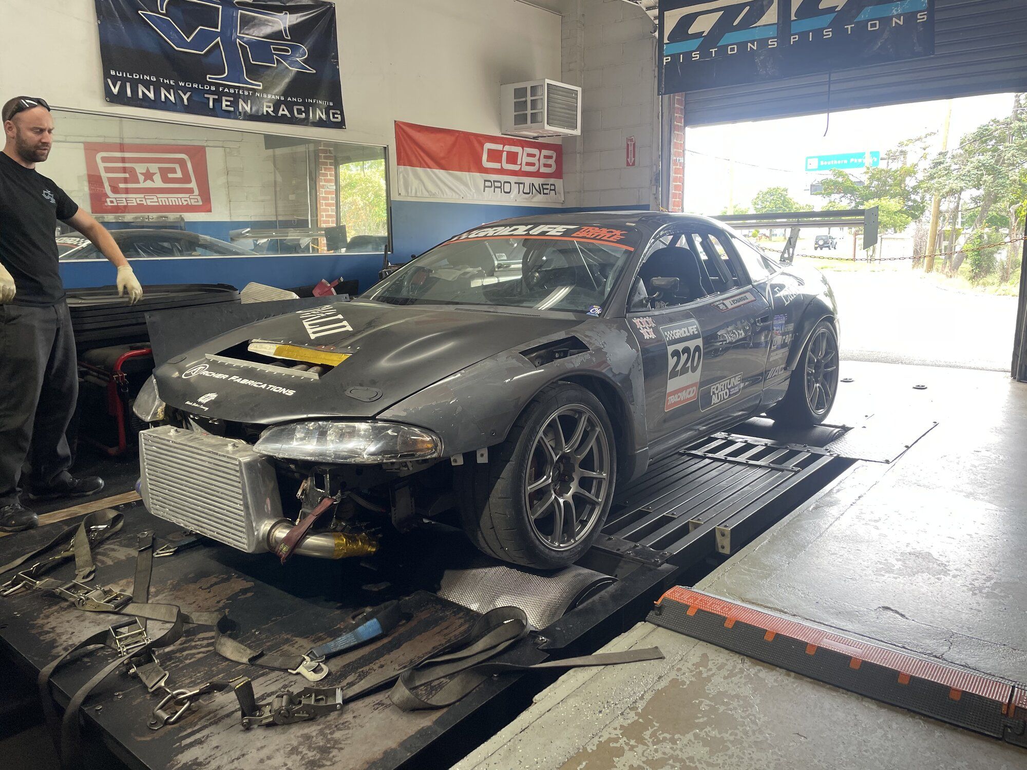

Dyno session the other day. Went well. We weren’t looking for numbers, but more so to try and figure out the throttling issue we had at the Glen. Ken at Black Sheep Tuning was linked in, remote tuning the car and I think we got it figured out. After a several pulls with changes, we were able to get the car to pull to the limiter at wide open. Final number were 380hp/318tq. Not massive numbers, but the goal was reliability, drive ability and a good foundation to build off of at NJMP. Excited to really push the new setup in a couple weeks. Going to make some ignition changes, and then turn up the boost and see what shakes loose. Most likely will be the last event of the year for us, which sucks, but I have some family obligations that I can’t just push aside. Oh also, we picked up a new sponsor. We now have Chase Bays onboard for the rest of the season. So I got their power steering reservoir on the car to help with the EPS. Which, by the way, I love. The EPS had been great. I bought a controller so we’ll be able to adjust the pumps output. High output for the paddock, lower for on track.

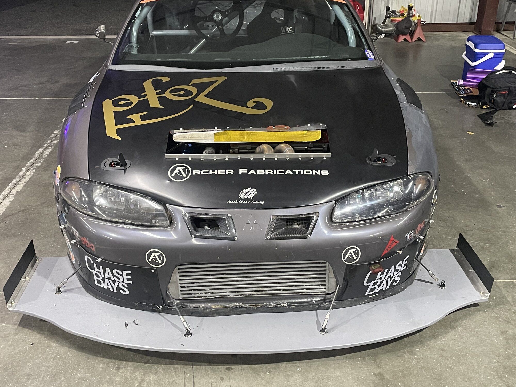

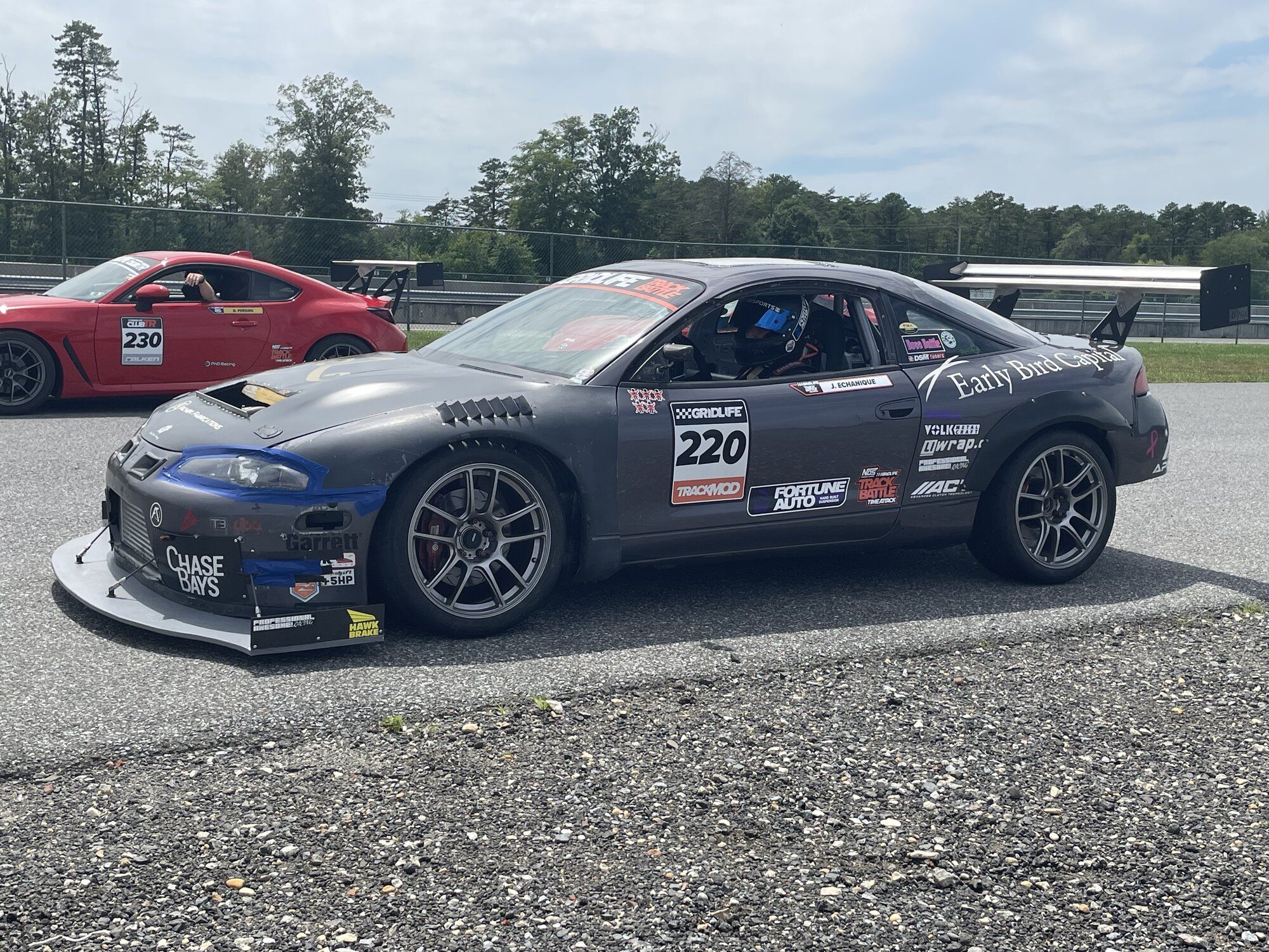

Alright. Recap of GridLife New Jersey. We arrived Friday evening, unloaded and started getting set up for the weekend. We tried to do some vinyl on the car but it failed. A nice low key evening. Saturday morning was the same old. Drivers meeting, trying to eat something through the nerves. Set tire pressures and went out for the first session. Car felt awesome. On the third lap I could hear the splitter scraping so I pulled in. We lost a splitter puck and clevis anchor. Missed the next session trying to secure splitter parts or come up with a solution which required a couple runs to lowes. Luckily, Dewey had spares and hooked us up. Got back out 3rd session, car felt really good. Finally starting to get the Fortune Auto 510’s dialed, and Bobby’s rear Evo bar adapters with the Evo bar really woke up the rear end. Car was giving great rotation on T5, which is the slowest corner on the track. Final session of the day, we clicked off a 1:28.5 which got us within 5 tenths of the leader. Feeling confident about Sunday mornings session, we prepped to put a spicy tube in the car. Saturday night after the final session, we found that the left rear was flat and discovered a bad tire valve. Found a shop open at 7am on Sunday morning and got it fixed. Uploaded a tune from Ken at black sheep tuning, but the car didn’t like it. The rest of the day we struggled with speed and just couldn’t find the pace we needed to catch the leader. So all said and done, came home 2nd, but more importantly, we held on to the track mod AWD track record. Something I’m very proud of. A great weekend all around. Saw friends, had a few good laughs and discussions. I love racing.
Tedward caught you on his IG while talking about the Civic behind you.
Ha! Yeah I’m friends with Eddie (the civic sliding). That was a good time.
