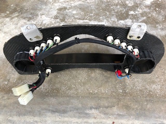

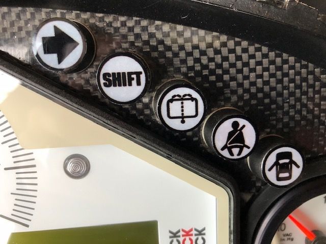

Ok. Good progress yesterday. Got the dash back in. Took a lot of messing around with the dash to get it to actually go back in, but it’s there. Now it’s time to start making all the connections and wiring up the plugs I want to do to make the dash easily removable. Not that I think it’s going to be going in and out all the time, but just to make life easier in the future if it does have to come back out. Nearing the firing up goal. I want to fire the car up March 4th, that way I have some time to diagnose any possible issues.
If anyone has any tips on how to make the dash easily removable, while not looking like junk, let me know. Cause right now the passenger side is all hacked up from trying get it around the cage.

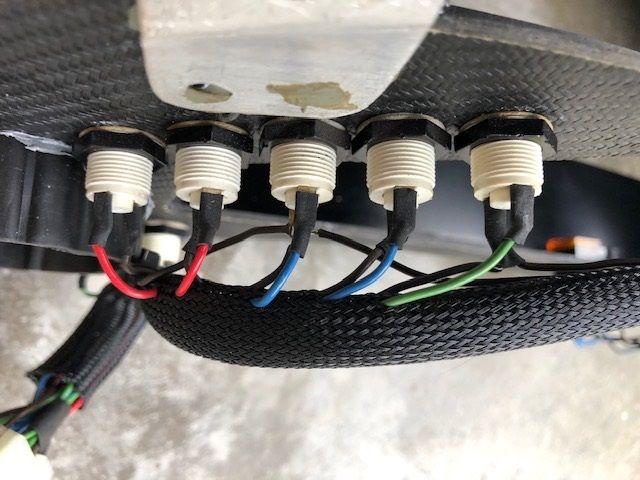

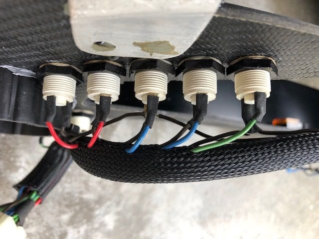

Ok. Good progress over the weekend. Dash plug is wired and the bulkhead at the fuse box panel is done as well. I did the bulkheads for the power and ground in the firewall as well. Going to run the alternator power to the back of the starter, and then run that back to the firewall bulkhead. Making progress. We’re away this weekend, but I’m getting confident that I’ll be able to fire the car up by my March 4th goal.
Hard to believe just by looking at it, but the motor is pretty much wired up. Have to run two wires down to the alternator, and run the wiring for the fans and fuel pump, and the main power to the starter and alternator, but it’s really close to firing up! Very excited. Going to start prepping for paint in the interior next week. Hopefully I can meet my goal of firing up the car on March 4th. Then I get to pull the trans so I can install the quaife front Diff and boostin’ bearing plate. Still a lot to do.
Good progress last night. Intake is bolted up. Harness is ran to the engine. Only thing I’m trying to figure out is the boost controller. But coming along. Maybe about two or three hours left to get the car wiring done. Then paint the inside of the car, then pull the trans to install the diff and bearing plate. Plugging away.
