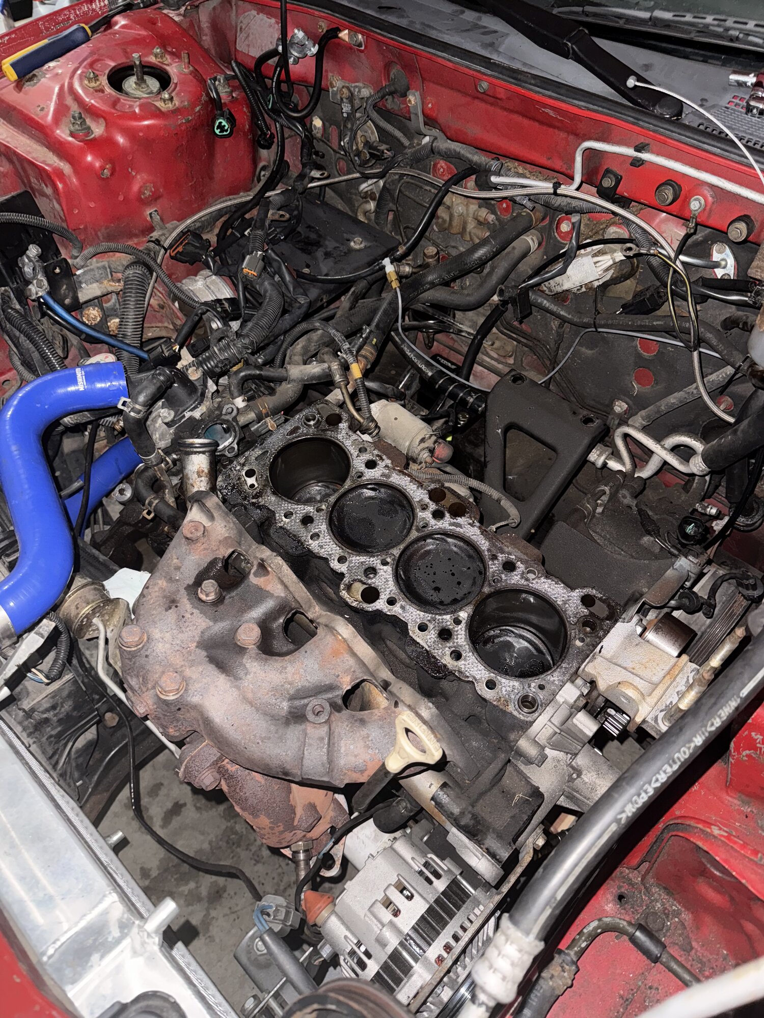

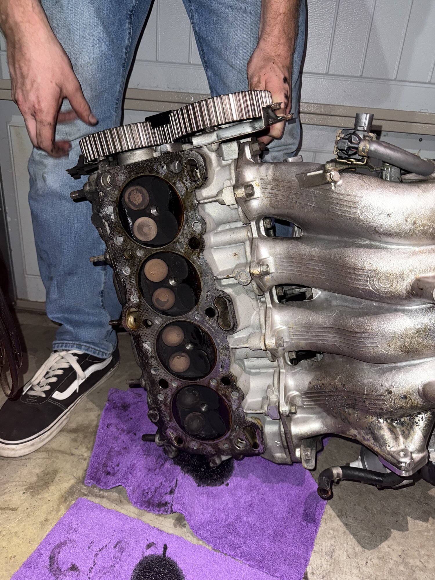

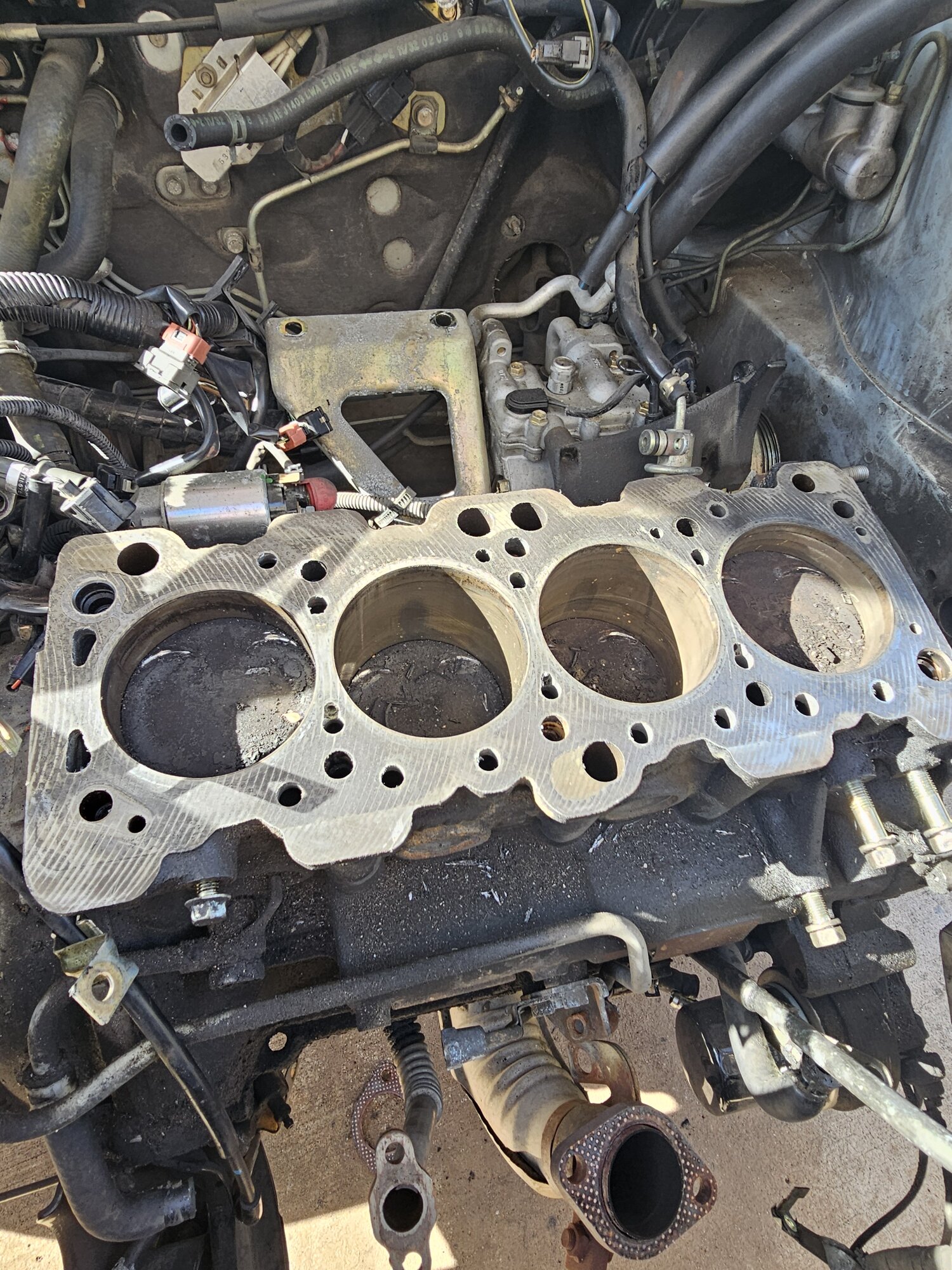

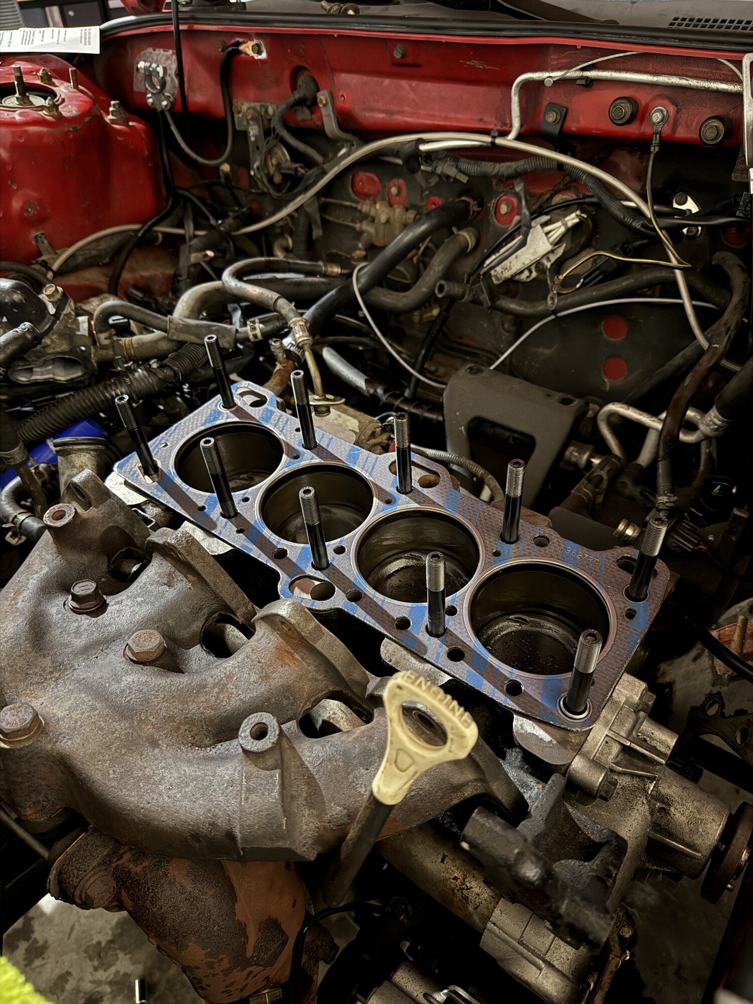

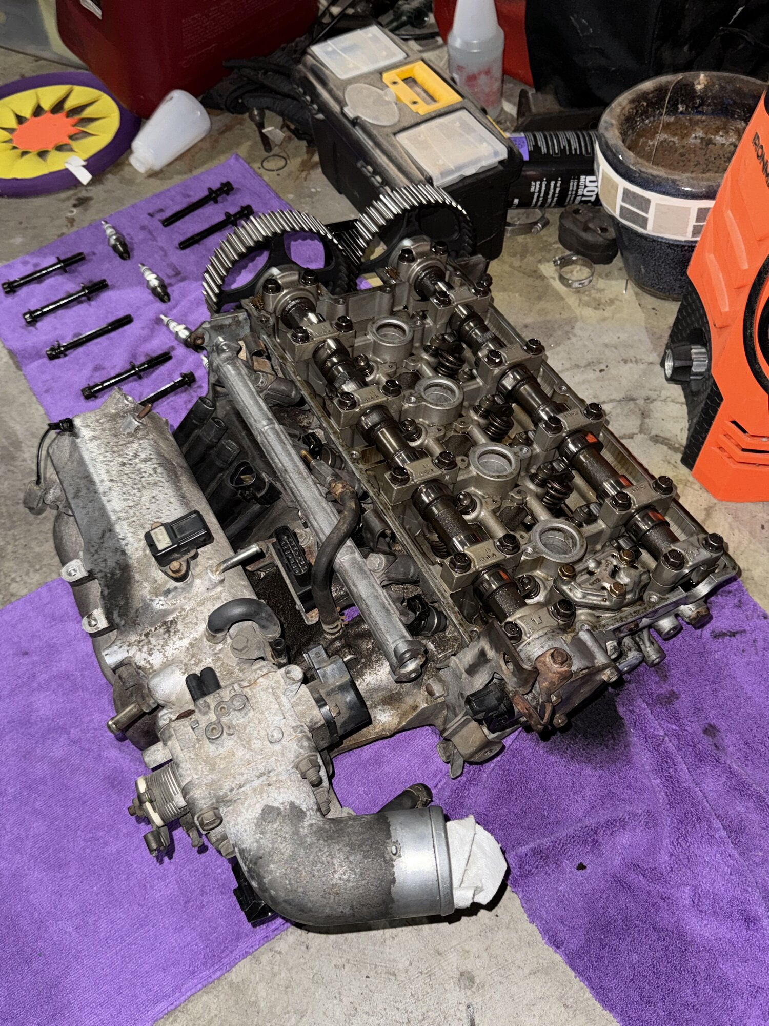

I'm pretty excited today because a couple of friends and I got the head off last night. My goal was to just get the head off and the surrounding area torn down in one day and we did it! If anybody has any recommendations to replace something while I'm in here let me know! I also found out the block in my car is from a different car. From decoding part of the vin I believe it's still from a 98, which means I still have the split thrust washer 7 bolt block.
Going to try to get some miscellaneous stuff done today. I have replacement power steering lines I need to fit up and I will replace my turbo drain line that's dripping oil onto the floor.

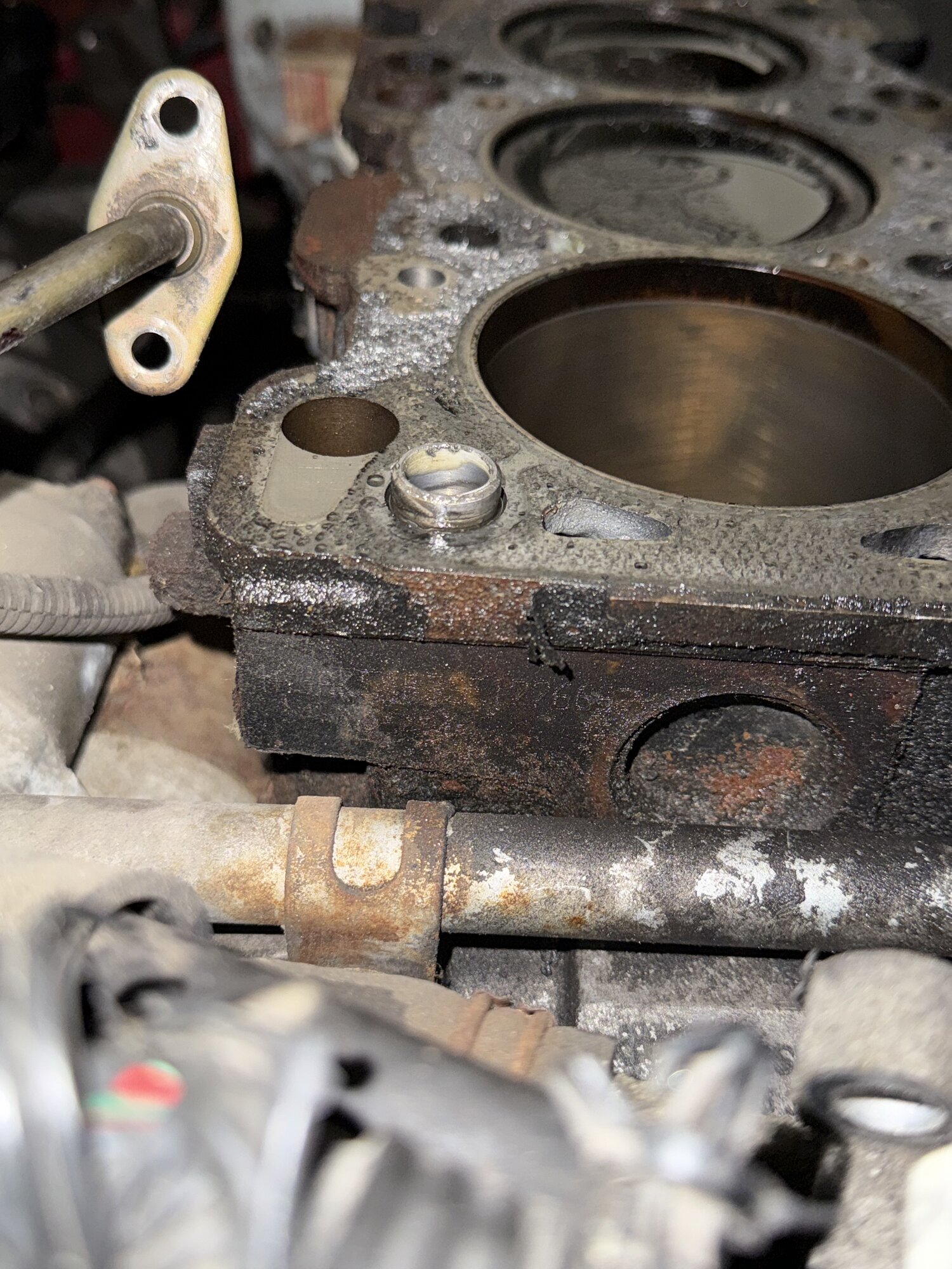

Now is the time to clean stuff you otherwise can't reach easily. NO power tools to clean gasket surfaces. Carbide scrapers work great. If you use them go slowly. They can just as easily ruin a surface.
Remove the block dowels. Done correctly it will look like this.

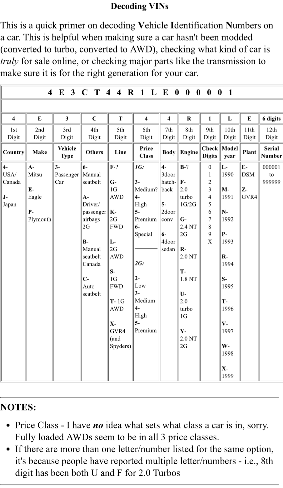

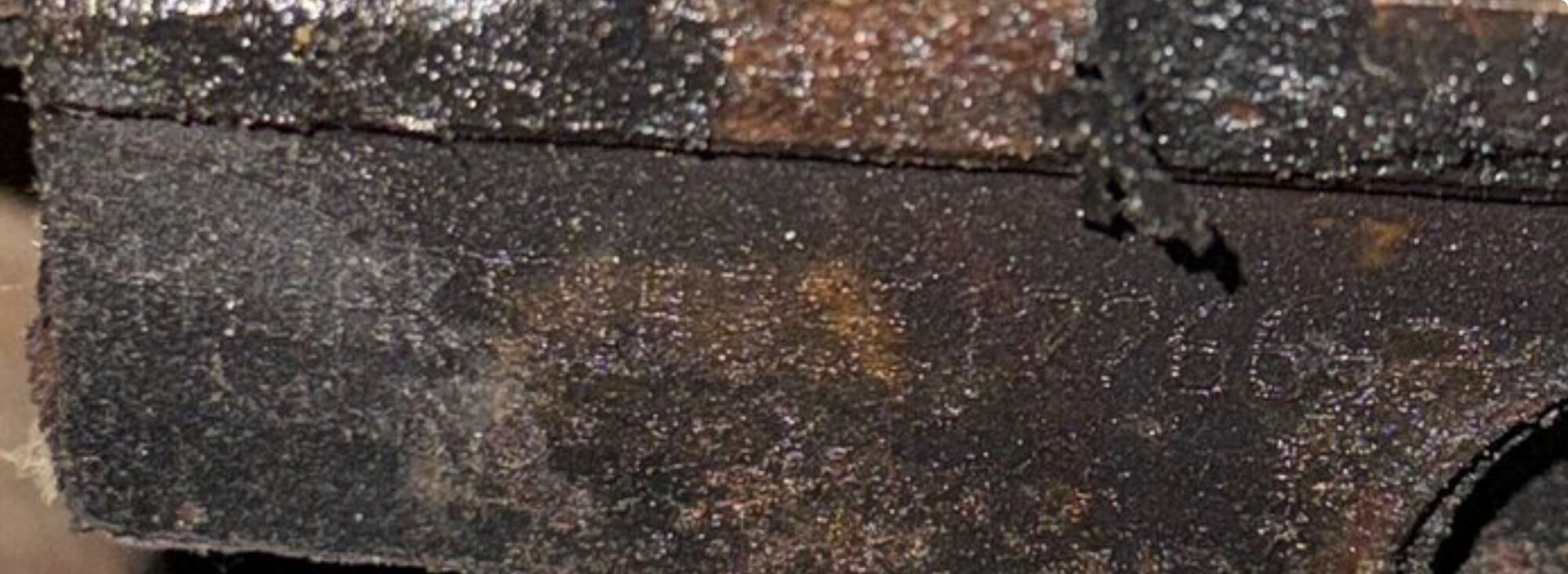

…I also found out the block in my car is from a different car. From decoding part of the vin I believe it's still from a 98, which means I still have the split thrust washer 7 bolt block.
I’m seeing it differently. The last eight digits appear to me to read “SE177669” or something similar. Maybe the 7s are 2s. The numbers don’t matter here.
The “S” indicates a 1995. The below is from VFAQ.com.
I did see that after decoding, I was pretty disappointed actually haha. Originally I thought the S was a 5 because it's super hard to see in there so I thought I got a good block.
After running the VIN, I found that the car this engine came from had 162k miles, and was last registered in 2013 in TN. I'm thinking this was a partout car and my car just happened to end up with the engine. Also, this 95 block came with a 98-99 timing belt hydraulic tensioner, which I found a little weird. It ran fine with that tensioner though.

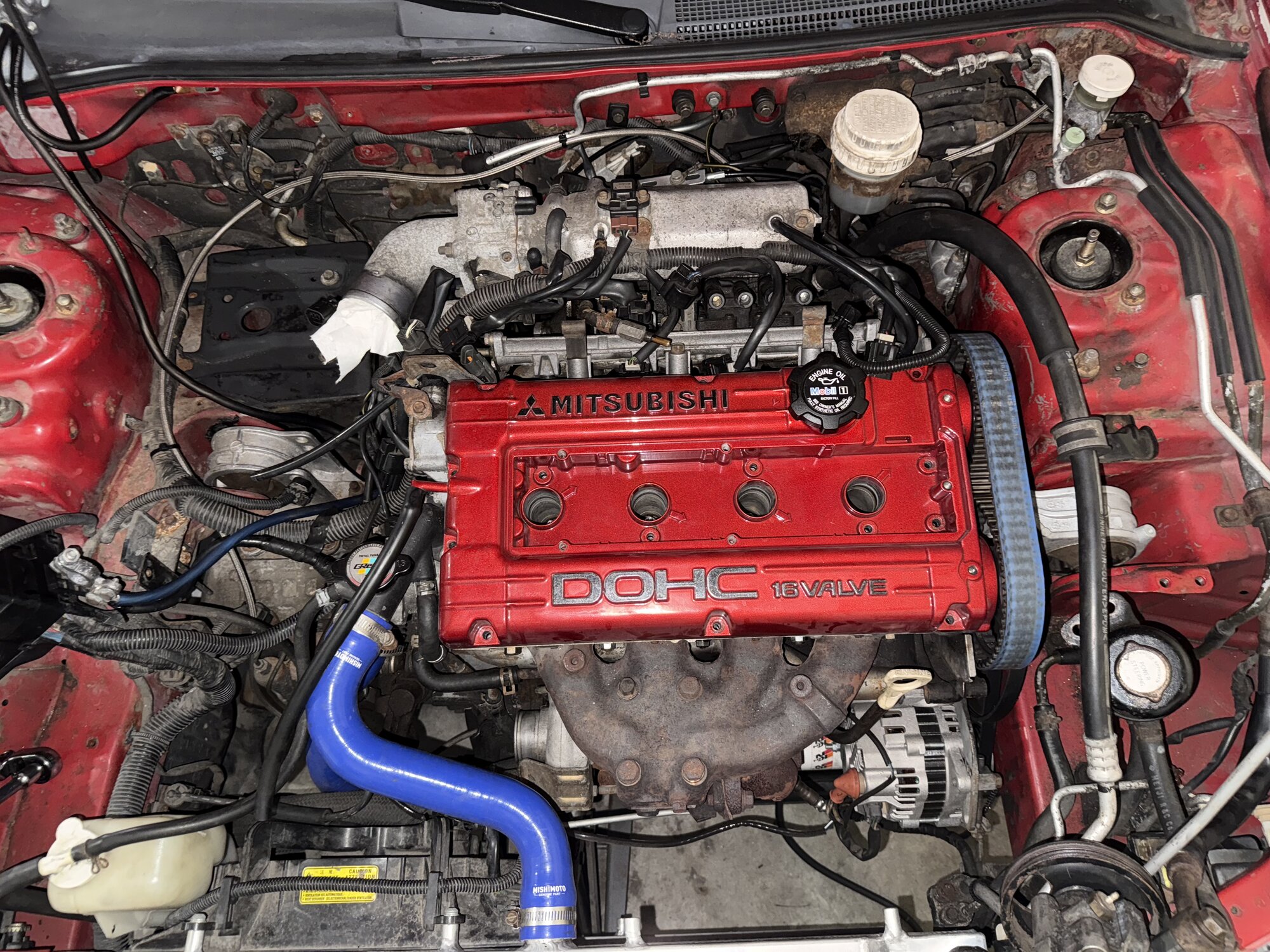

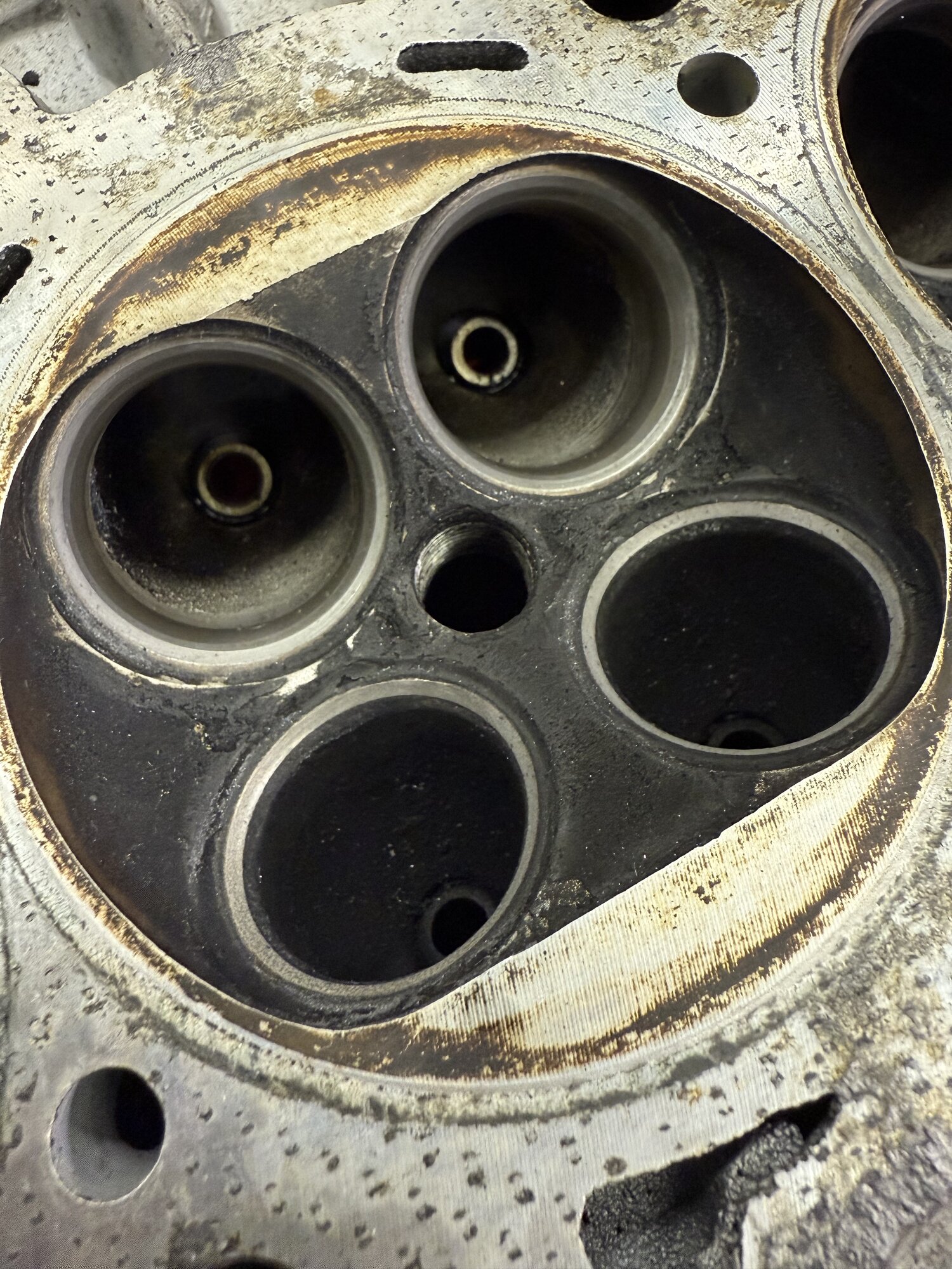

It's been a little bit, but I lapped the valves, rebuilt the head, did the timing belt, replaced the coolant hoses that looked crusty with new black silicone ones, bled the coolant and it still runs!
Not without it's troubles though. The turbo feed line from the OFH was kinking when I tried to remove it from the housing, so that needed replacing. The oil filter housing needed replacing as well because I took a nice chunk out of it when I tried to screw in the mechanical oil pressure gauge all the way in, the filter housing gasket also needed replacing again because it would not seal on the top side where it goes into the timing cover.
So far, I'm just driving it around and looking for any possible water leaks or oil leaks. The car still runs perfectly as it did before (knock on wood), maybe even a little faster boost response but maybe thats placebo.
I had such a fun time rebuilding everything and was very anxious for how it run after the rebuild, but seems like we didn't do too bad of a job!

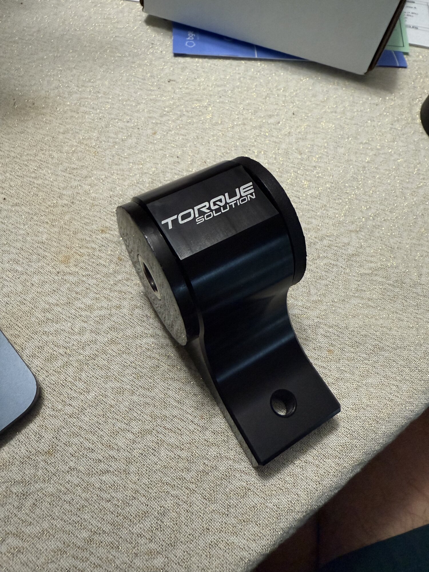

Last night was kind of a nightmare getting that Torque Solutions mount in. Basically, I was not aware that the car had to be fully on the ground and the bumper taken off for the front motor mount bracket to line up with the bolt holes on the trans. No matter what I tried on a jack or jack stands, the bolts would not line up.
Eventually, at around 12:30am I finally got it done and the engine clunk under full torque is gone. I feel like I can fully enjoy this car now as I'm not always feeling that horrible clunk under load. I think that mount is definitely worth the money and time it took to do it, but just remember not to jack up the car while you do it. (I'm guessing its because the car/engine mounts need to be under their own weight)

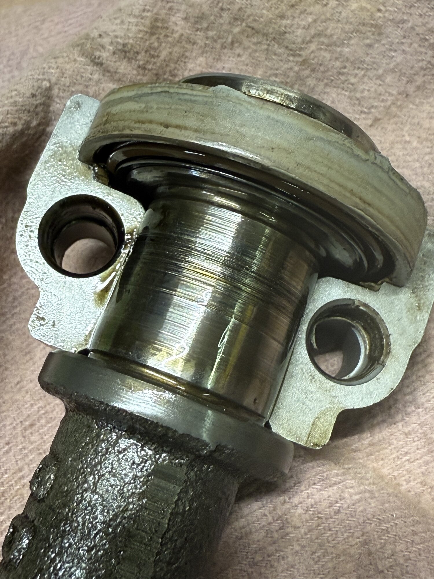

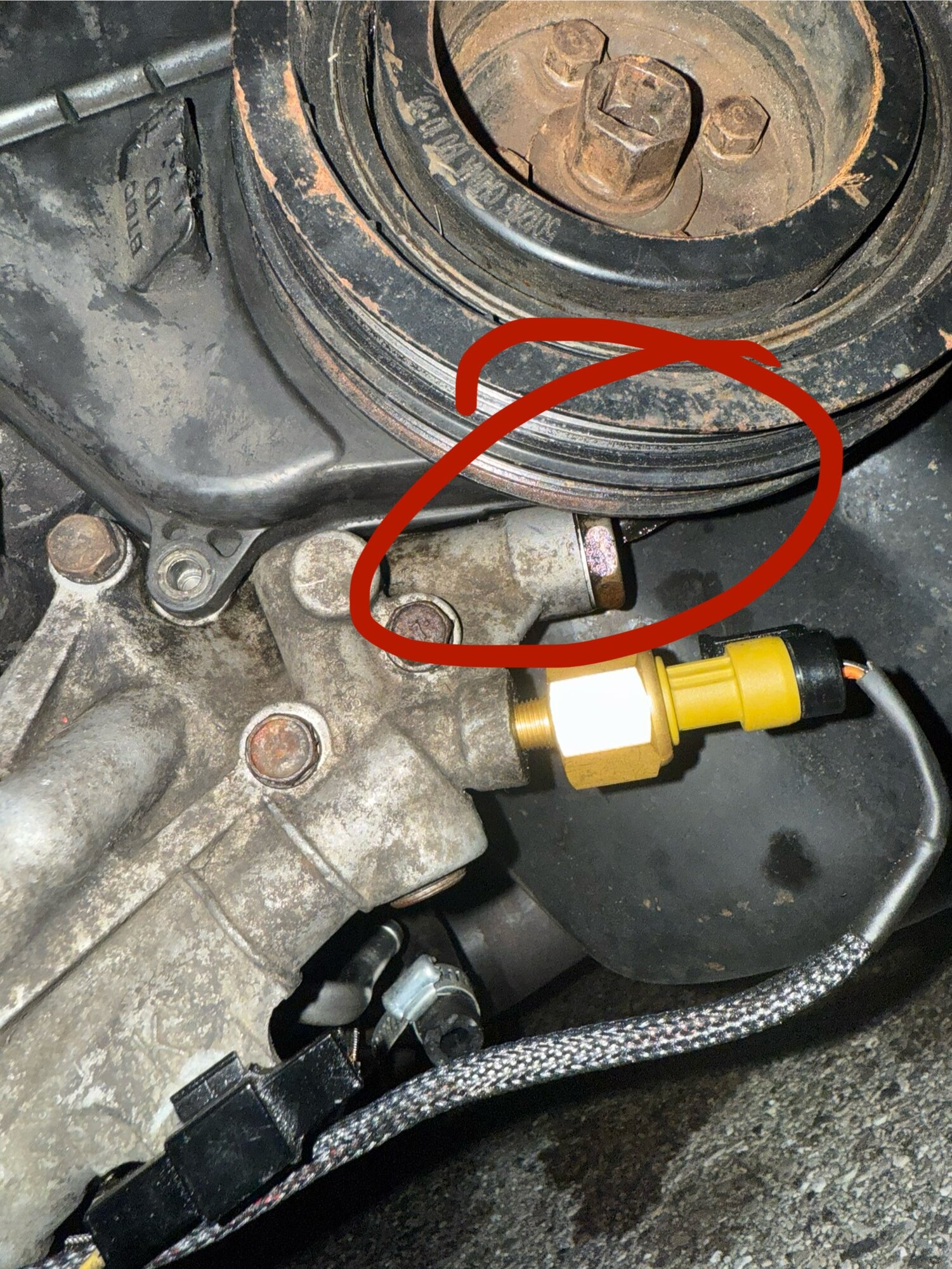

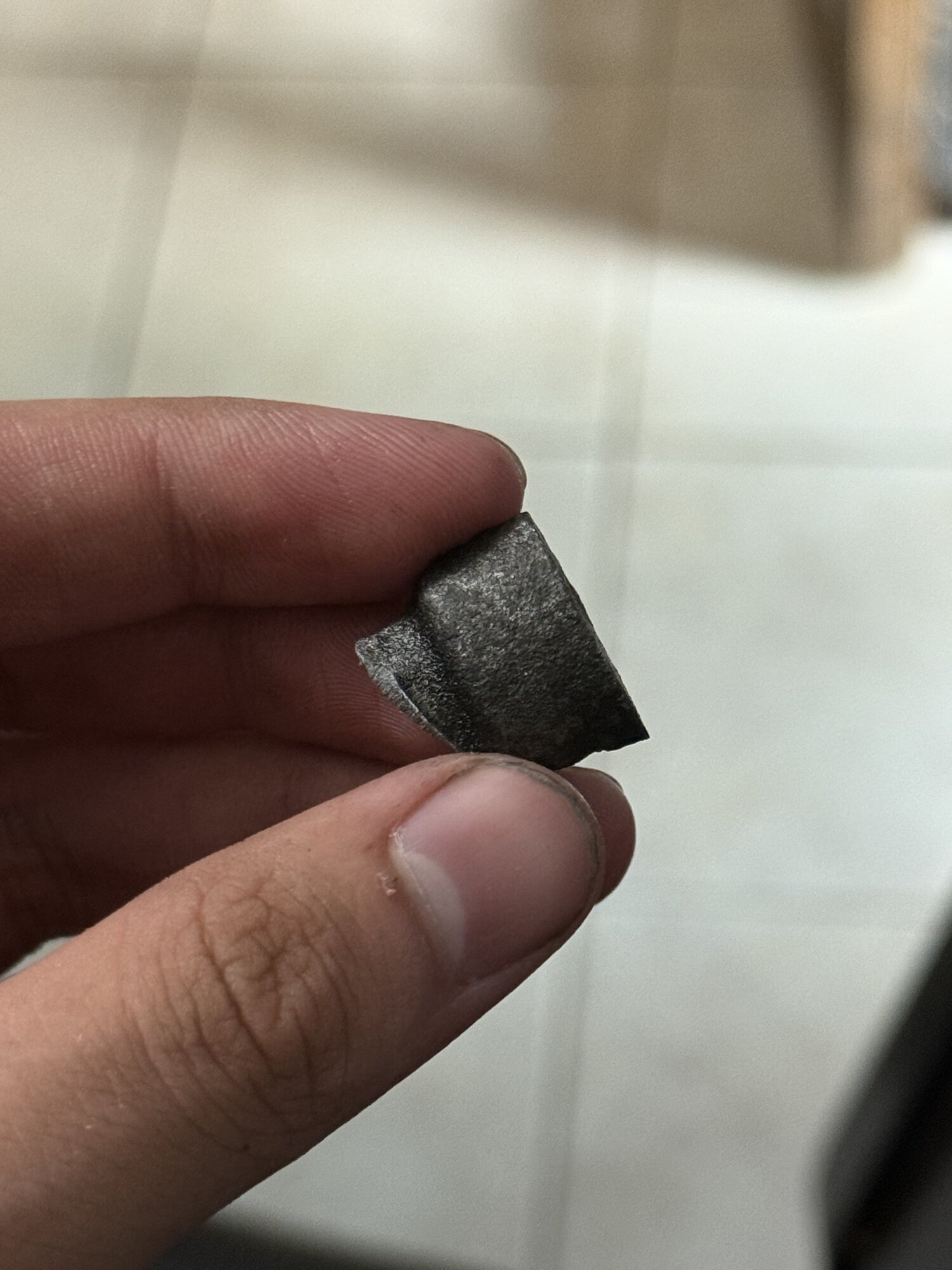

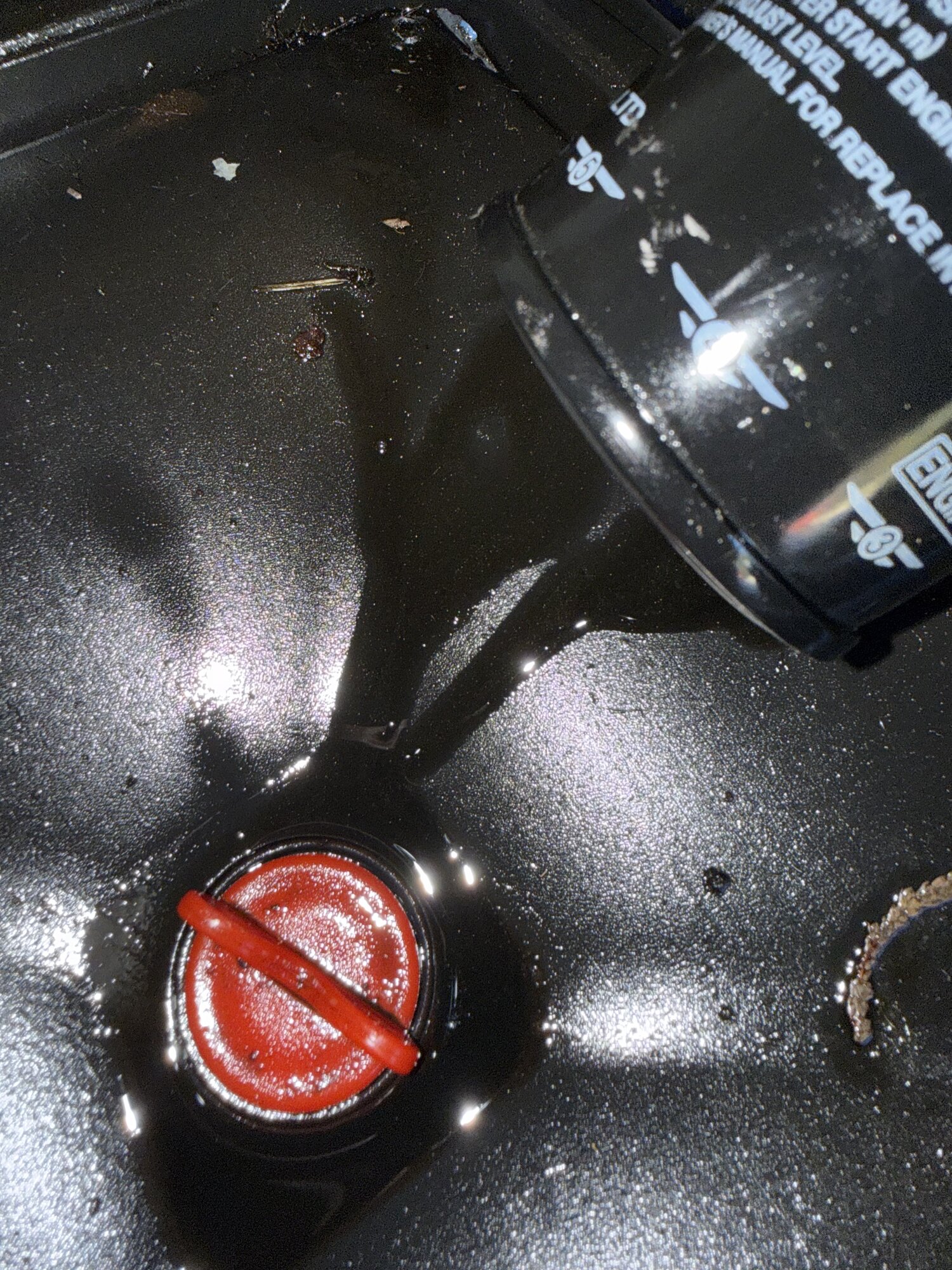

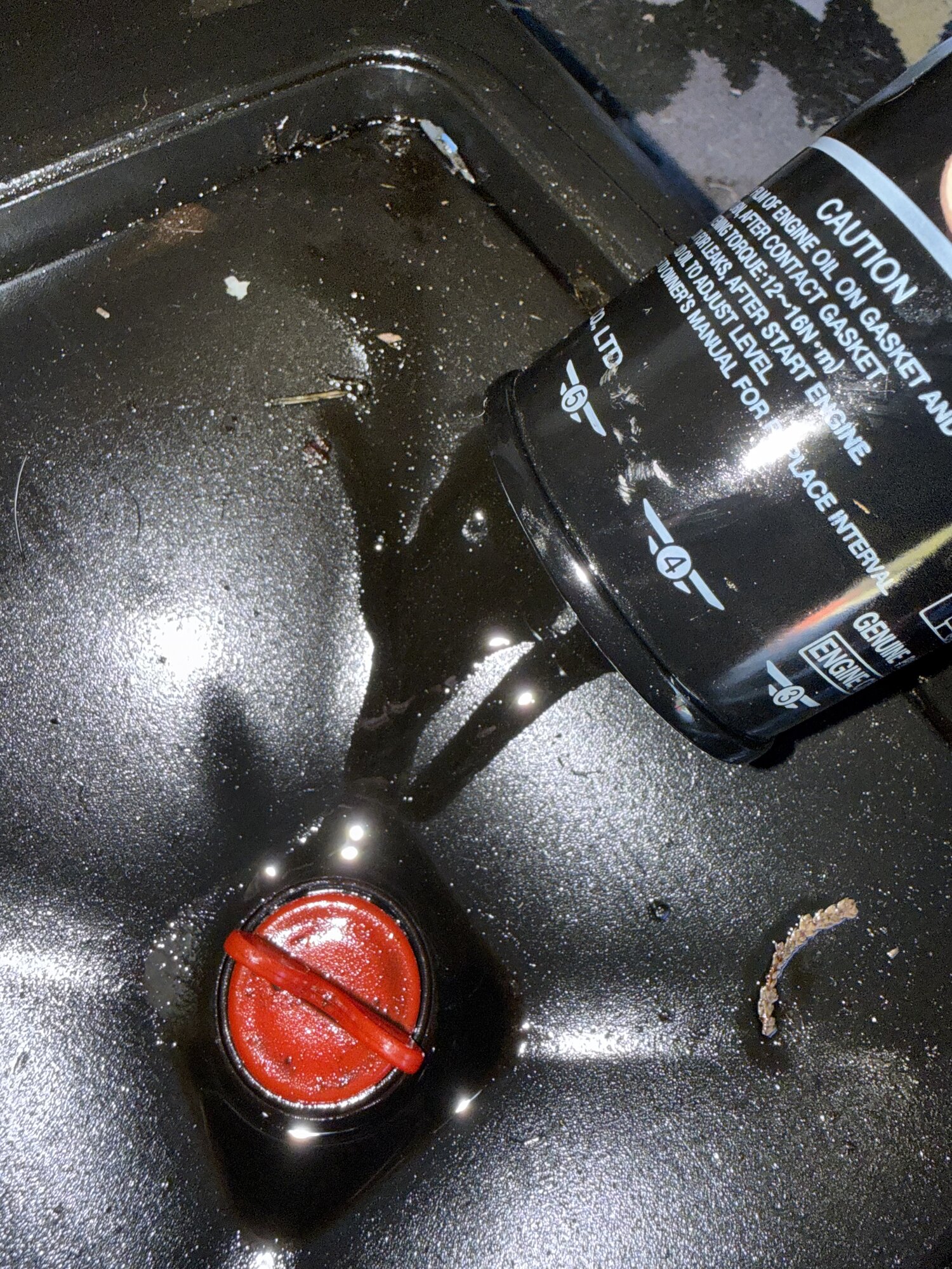

I did an oil change the other day as well. Very bad. Lots of metal. Not good. It may have been from cleaning up the surfaces of the block, but that doesn't change the fact that it was swimming around my engine. The magnetic drain plug definitely helps, but I did see silvery glitter upon first drain. I'm going to do another oil change on the 8th, a day before I'm planning to leave for Ocean City, Maryland for Cruisin' OC. I really want to take this car down, but 200 miles round trip on an engine that's on it's last leg may not be a good idea. I'll decide if I want to take it when I do the oil change.
Great pictures see you next year with mine.
Absolutely! Thank you!
This motor may not live much longer... may be looking for a new short block soon unfortunately. On the bright side I'd be replacing a non split thrust block, but it's very demotivating to see after just rebuilding the head...

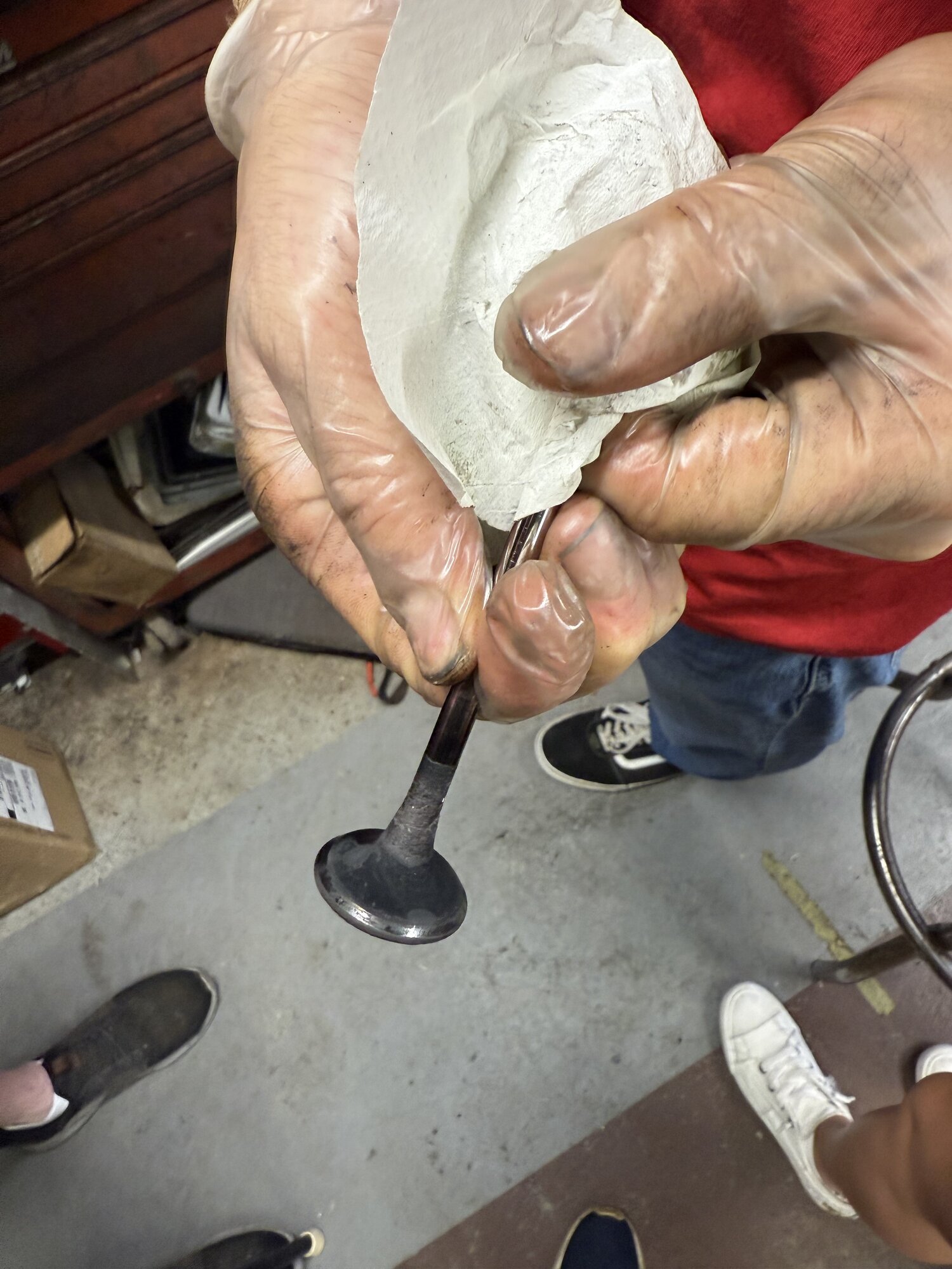

On the way home from my girlfriend's house the other day, I did a pull to 5k in 2nd, then into 3rd, about 30 seconds later, it was misfiring like CRAZY. I mean, I didn't think I would make it home. Pulled the plugs yesterday; cylinder 4 had some weird marks on it. Almost like something was bouncing around in there. The problem lies with cylinder 2, where I think I spilled some oil into the hole while doing an oil change. The plug was covered in oil, so I cleaned it up and put it back in and everything seems okay.

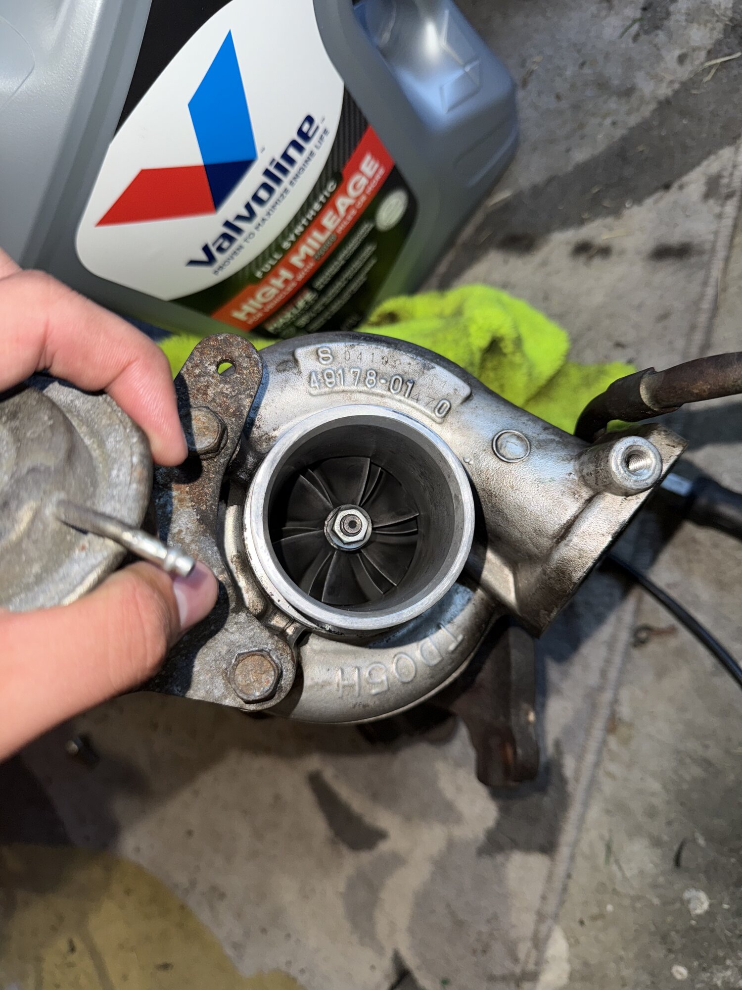

Another problem that just came up, is that my turbo sounds like a turbo diesel after revving it. Gonna take the whole front of the exhaust system off, including turbo, 02 Housing, downpipe. The turbo is also tired I think. It's burning a lot of oil on decel, and it's a noticeable difference on the dipstick after driving it hard.
Good thing I have a 16g waiting to go in. Bad thing is that I don't have a job to fund it.
