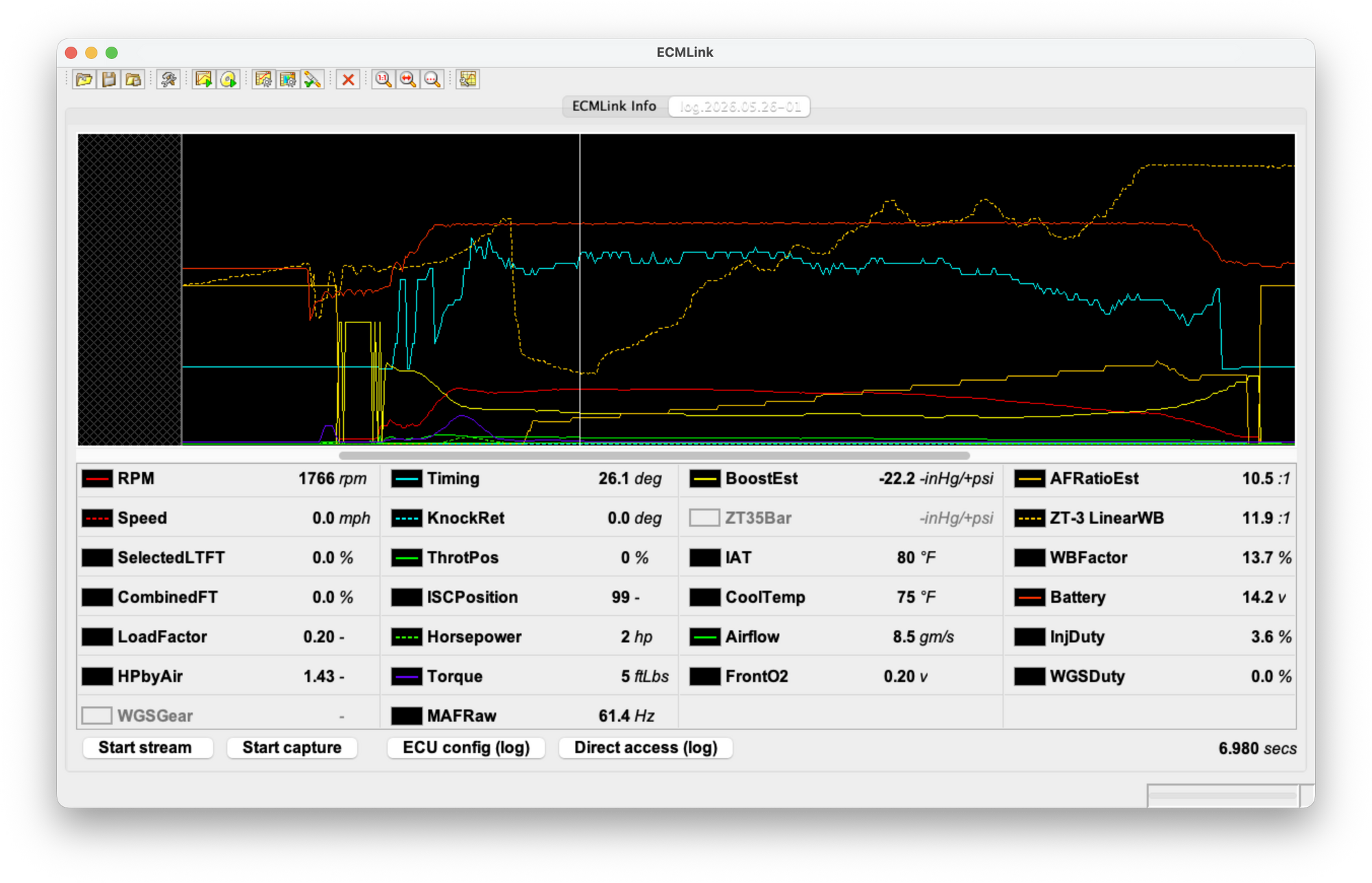

Thank you JustinI can help you here with ECM Link tuning if you have a WB and a MAP sensor wired and logging.
! I appreciate you offering to help. I'll update the build thread once I finish up the piping and all that. I should have everything you mentioned all good to go minus a calibrated WB sensor, but I can look up some videos on that in the meantime.Kyle

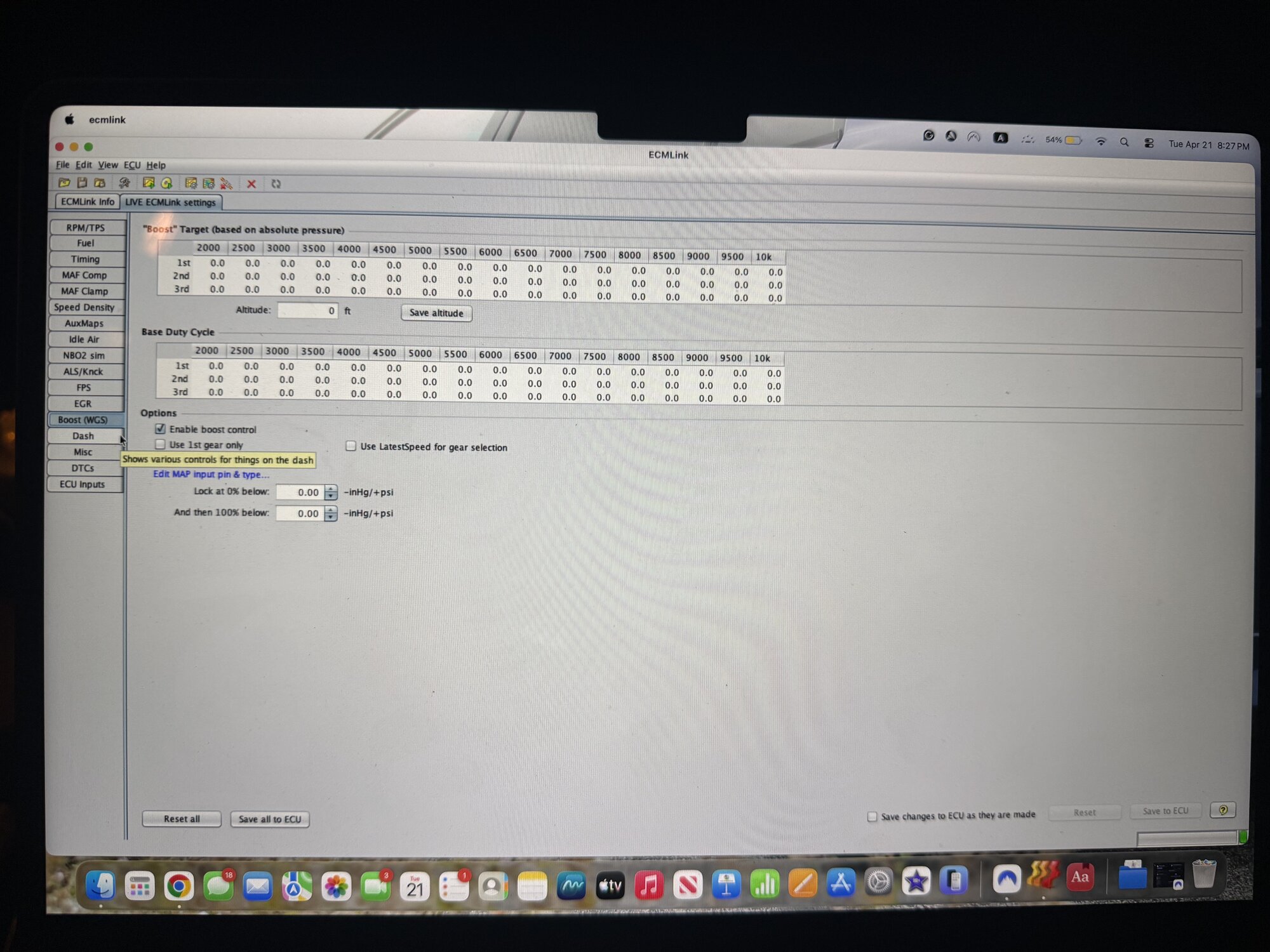

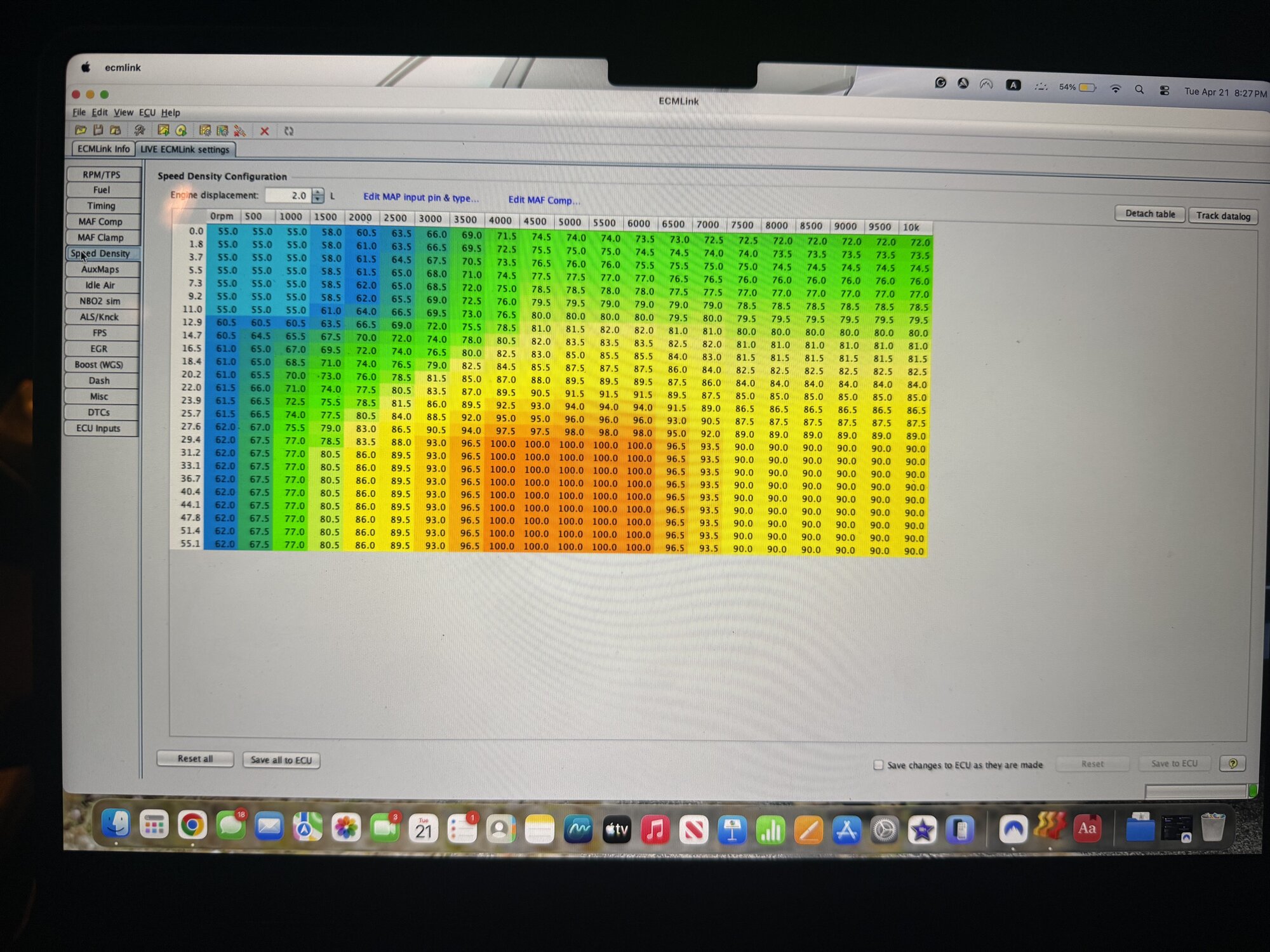

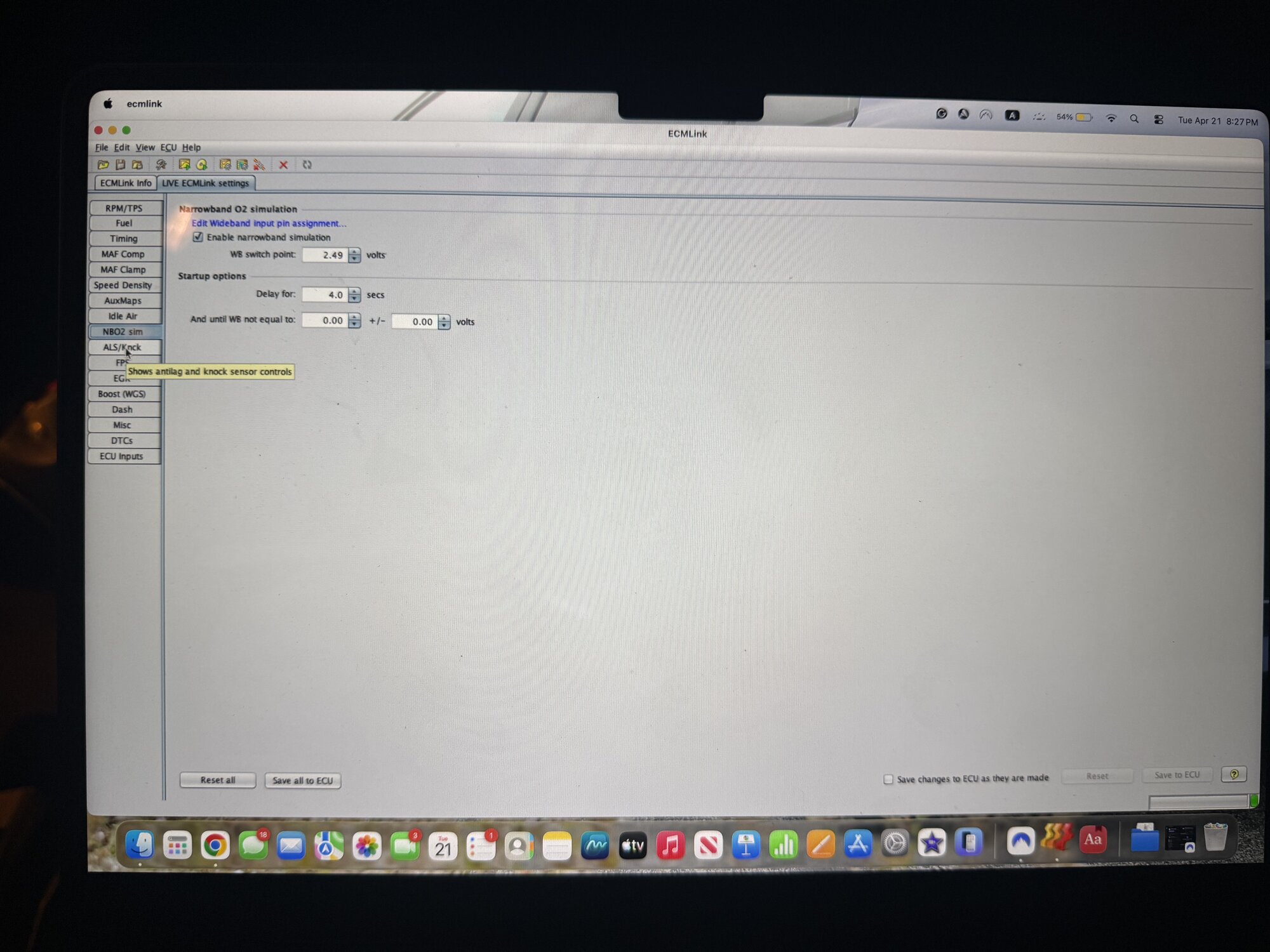

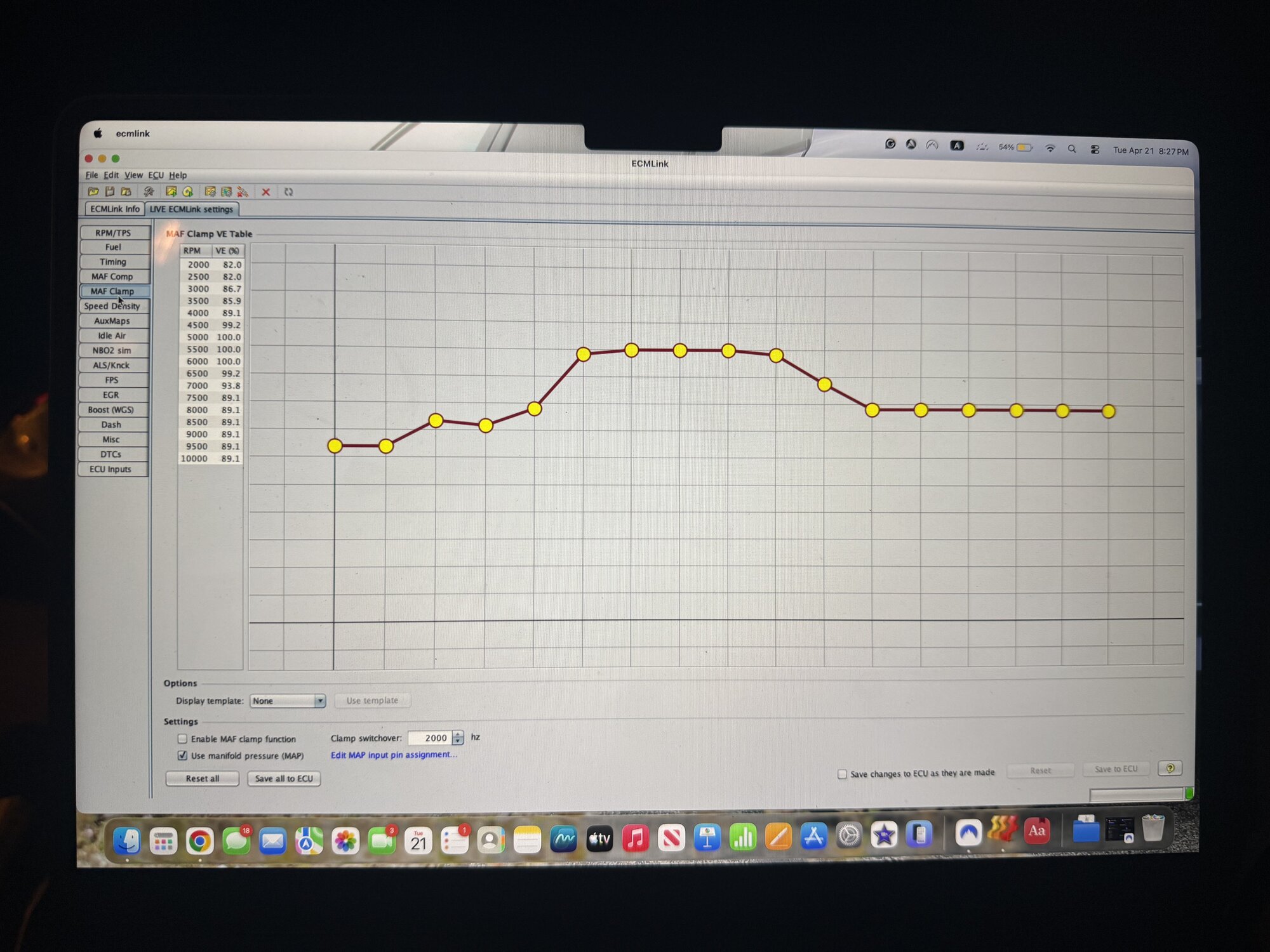

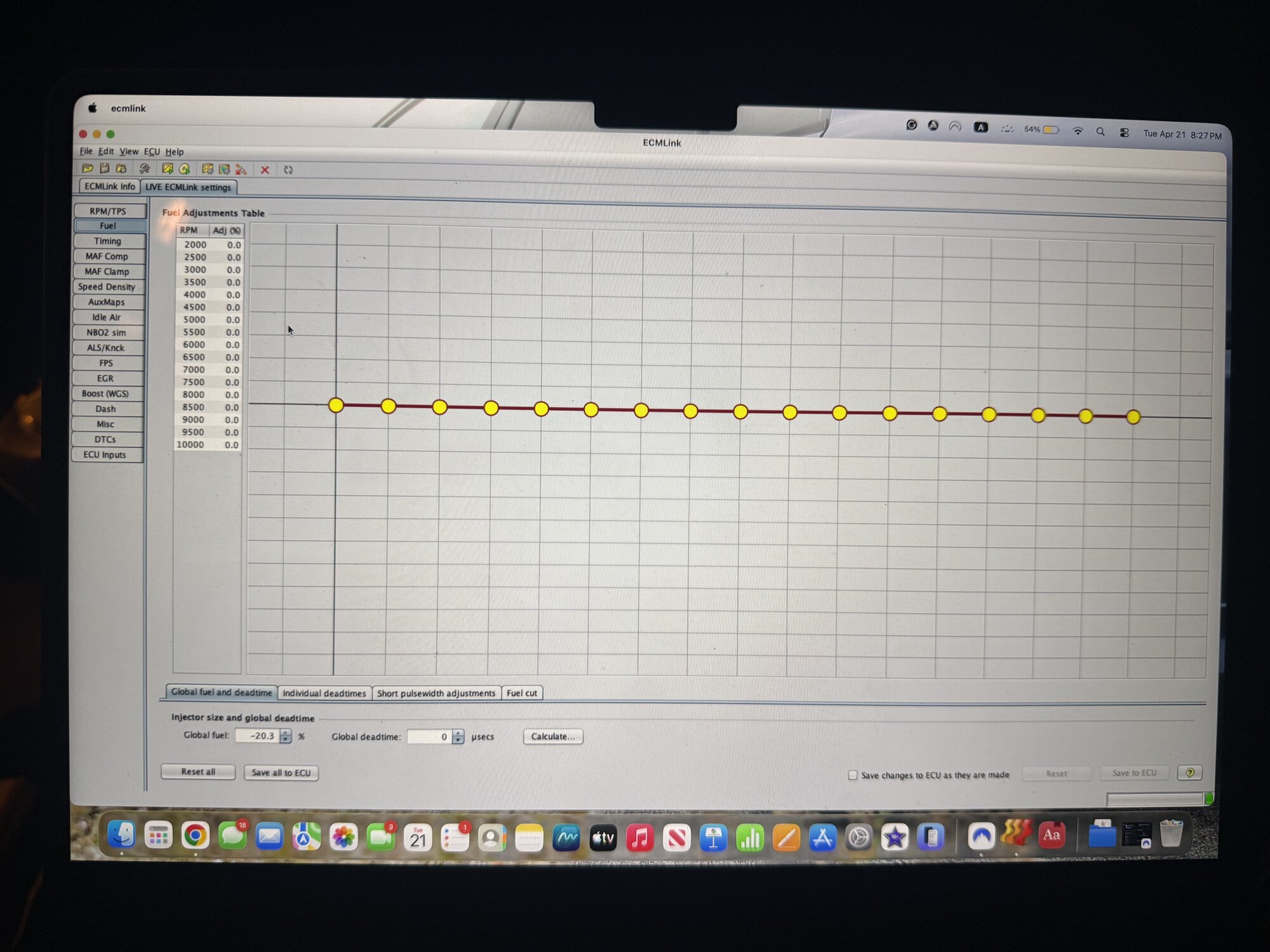

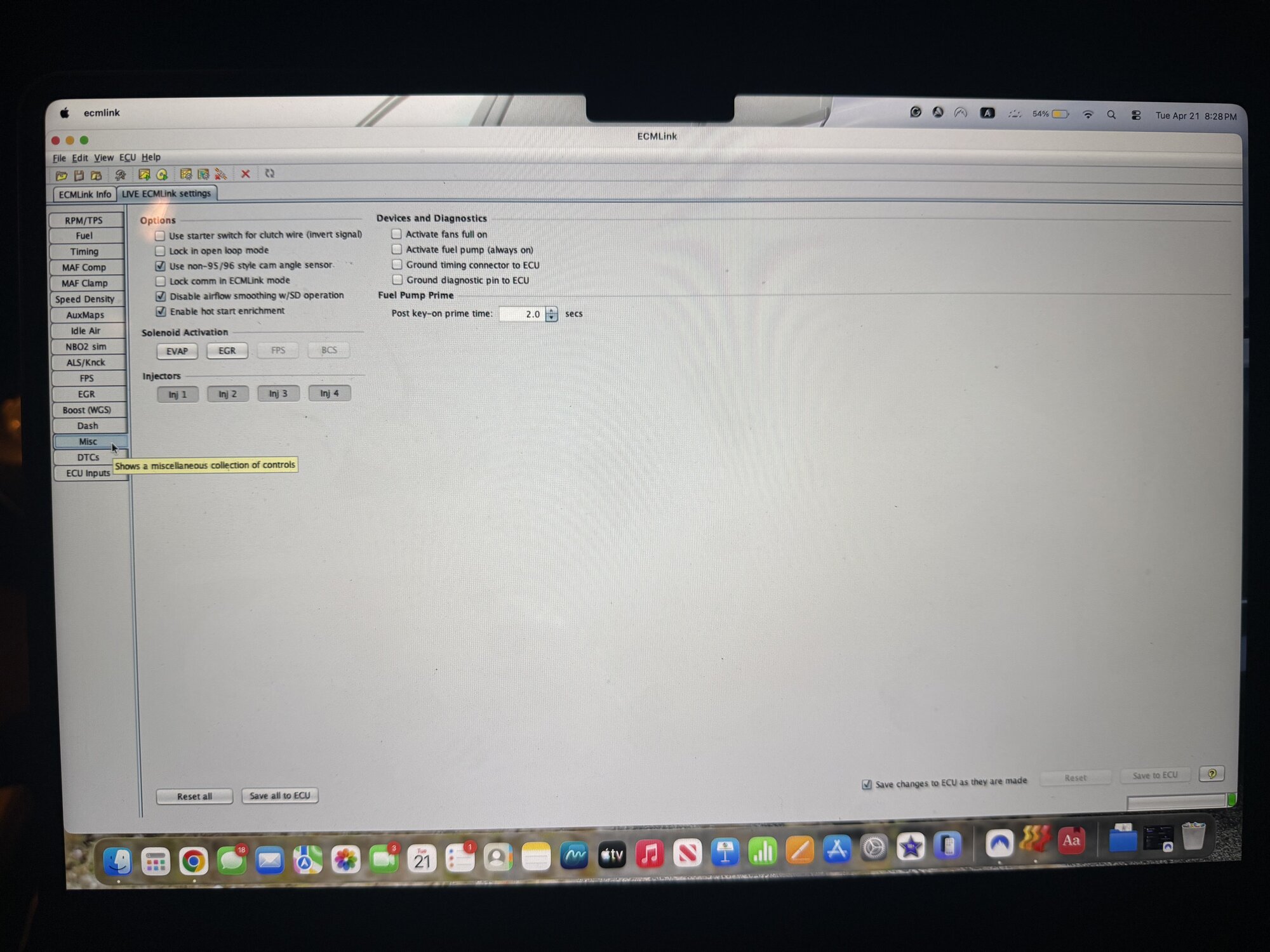

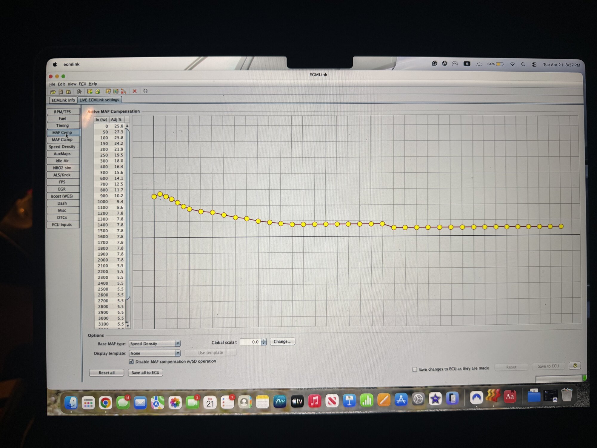

. Unfortunately, I need to get the car idling properly to do all the other stuff I need to do like adjusting fuel pressure, burping coolant, adjusting the ISC etc. Even information on calibrating the wideband is all over the place I'm not sure what to believe. I figured getting the cruise and WOT tunes would be tricky but damn, even the idle tuning I'm not understanding
