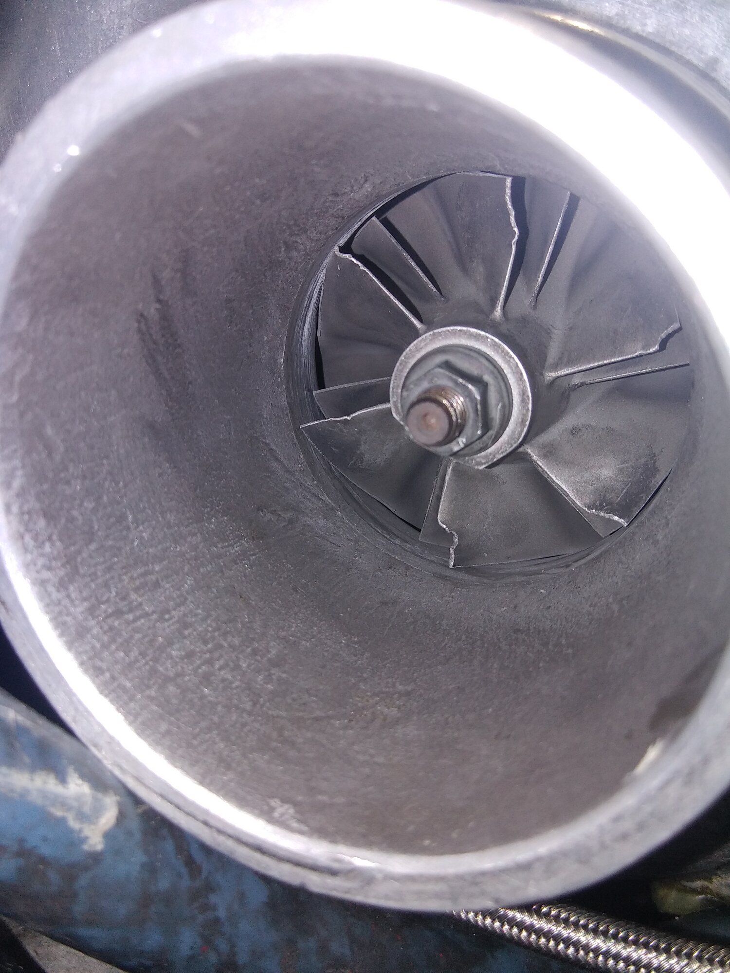

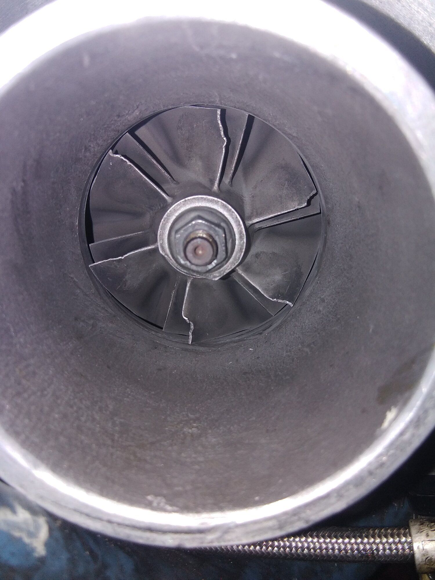

Ah you uploaded pics, I didn't see it. Wow Jeff, yeah you got a blown turbo, you need to rebuild it. You see the cause of noise on the compressor wheel.
Thank you for the heads up. Yeah guess it will sit awhile next couple days off i get ill pull the turbo and start taking it apart. You think you could help me find the correct turbo cartridge? This turbo is pretty old.
What turbo is it? You should ask Justin to rebuild or for parts, or find a good used 16g may be cheaper.

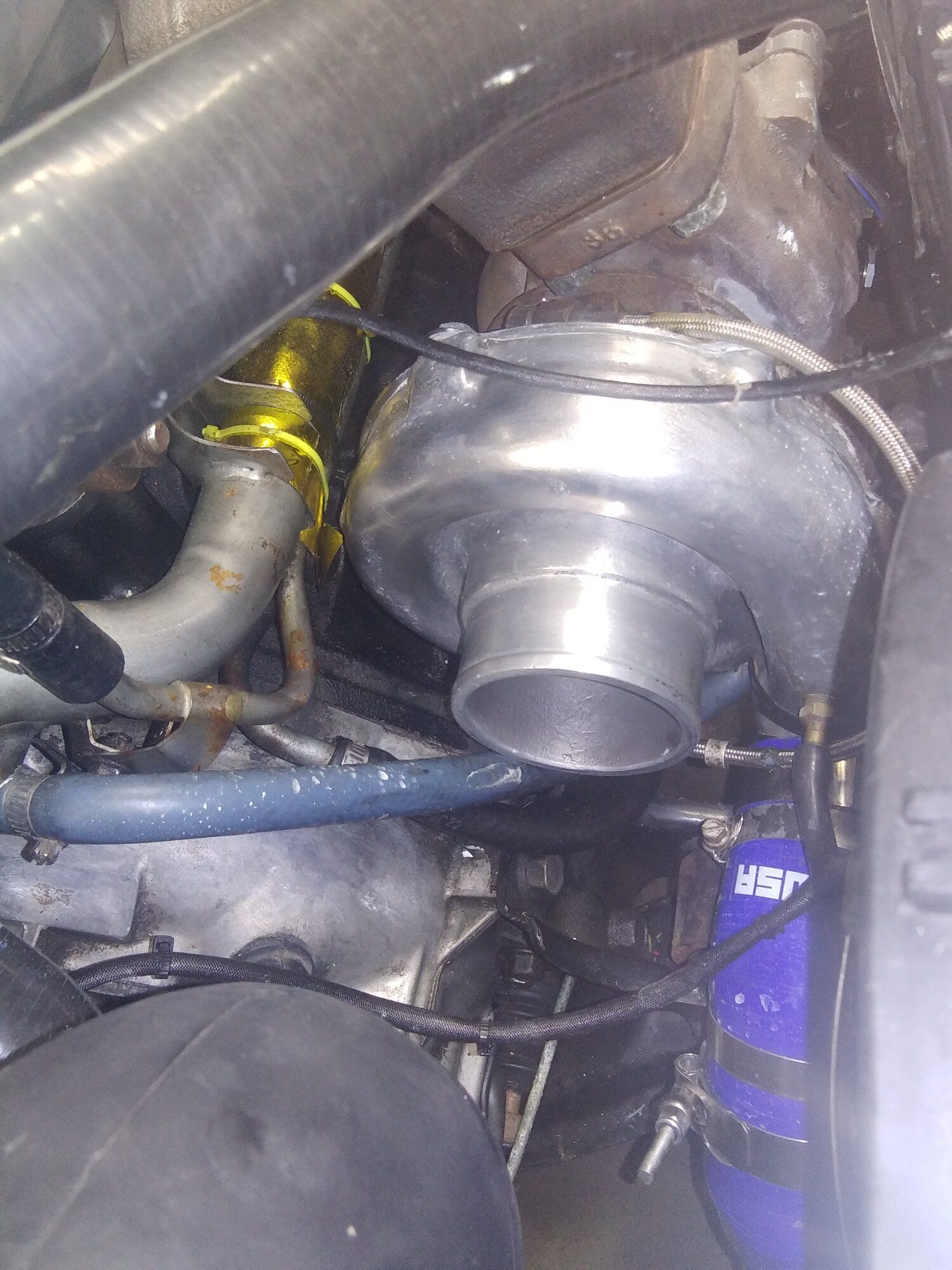

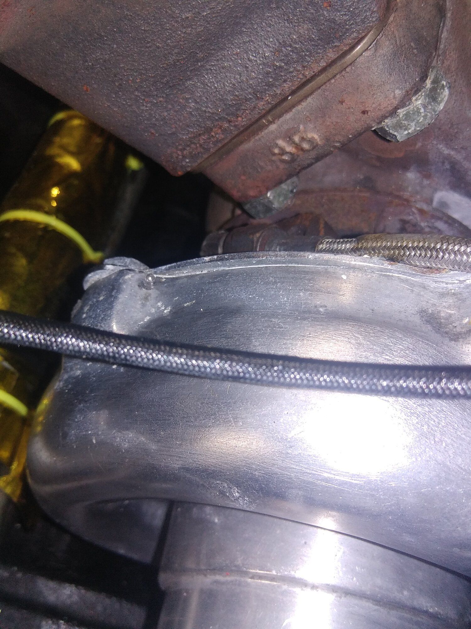

Had a friend tell me what it was and i posted it on my build details im starting to doubt the info in correct. It has a 3" compressor inlet a five bolt down pipe side outlet and the wastegate is mounted to the bottom of the exhaust wheel housing and it is an old HKS waste gate.
There's a 35 on the t3 flange in this pic.
You commented on that wastegate a few weeks ago and said you thought it looked like it was from as far back as the 90's. Cant remember which page of the build thread its on.

Jeff, isn't it a cx racing t04e from eBay? If so, if I were you I wouldn't try to repair, I would look for a good used MHI 16/18/20g or soi don.
I think this is a good genuine turbo, if its based on the blue coupler there it is one i bought to replace the old worn out coupler originally on it. This is no ebay special my friend. The turbo has been on this car since 2004 according to the original owner and it has had the crap ran out of it. Were it an eBay turbo it would have wore out long long ago.
I am however interested in opinion on maybe trying a different set up. This turbo had a bunch of lag and i would like to have a spool time a bit shorter but not give up too much top end. I remember the first time I got the revs up on this turbo and it blew my mind at the time how much authority it pulled with. Those turbo options you mentioned do sound interesting, I will look at those types you mentioned, this turbo might be too old to find parts for, or would take too long to find what i need. Another thing i dont know if it makes a difference on rebuilding it is that it is also a ball bearing set up as well.
I am not sure what exactly the turbo is but since it's a ball bearing turbo and the compressor wheel is damaged, probably you should look for another setup. And yes it would be much easier to find parts and to repair when necessary. You run E85, so you can make a good power even with a 16g.

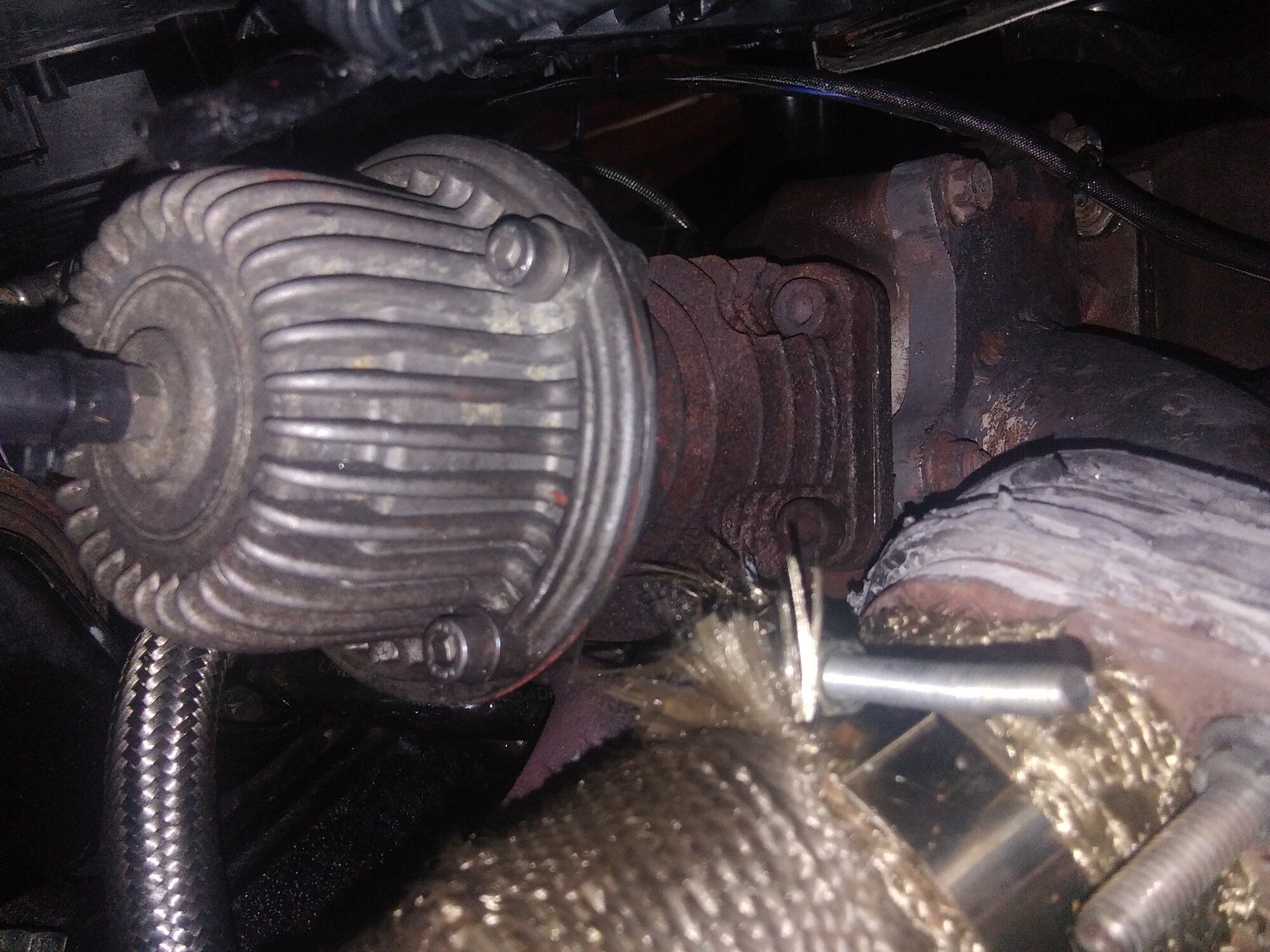

So i was wondering about my turbo and mine is different than all the other turbos i have seen so far on the forum. Why is the wastegate set up like this. This is the wastegate pointing straight down from the hot side housing.
It is set up in a manner that a turbo blanket cant be fastened around the hot side housing.
Maybe the previous owner fabricated it? Like the old HKS cast manifold had the wastegate under runners for JDM GVR4 and early EVO.
