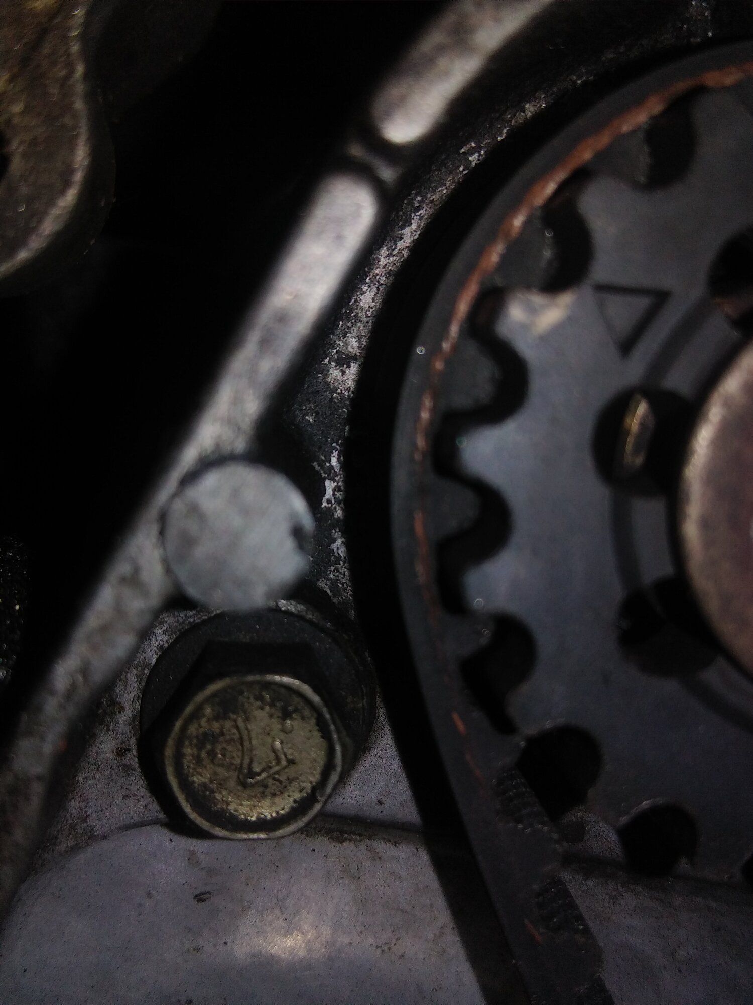

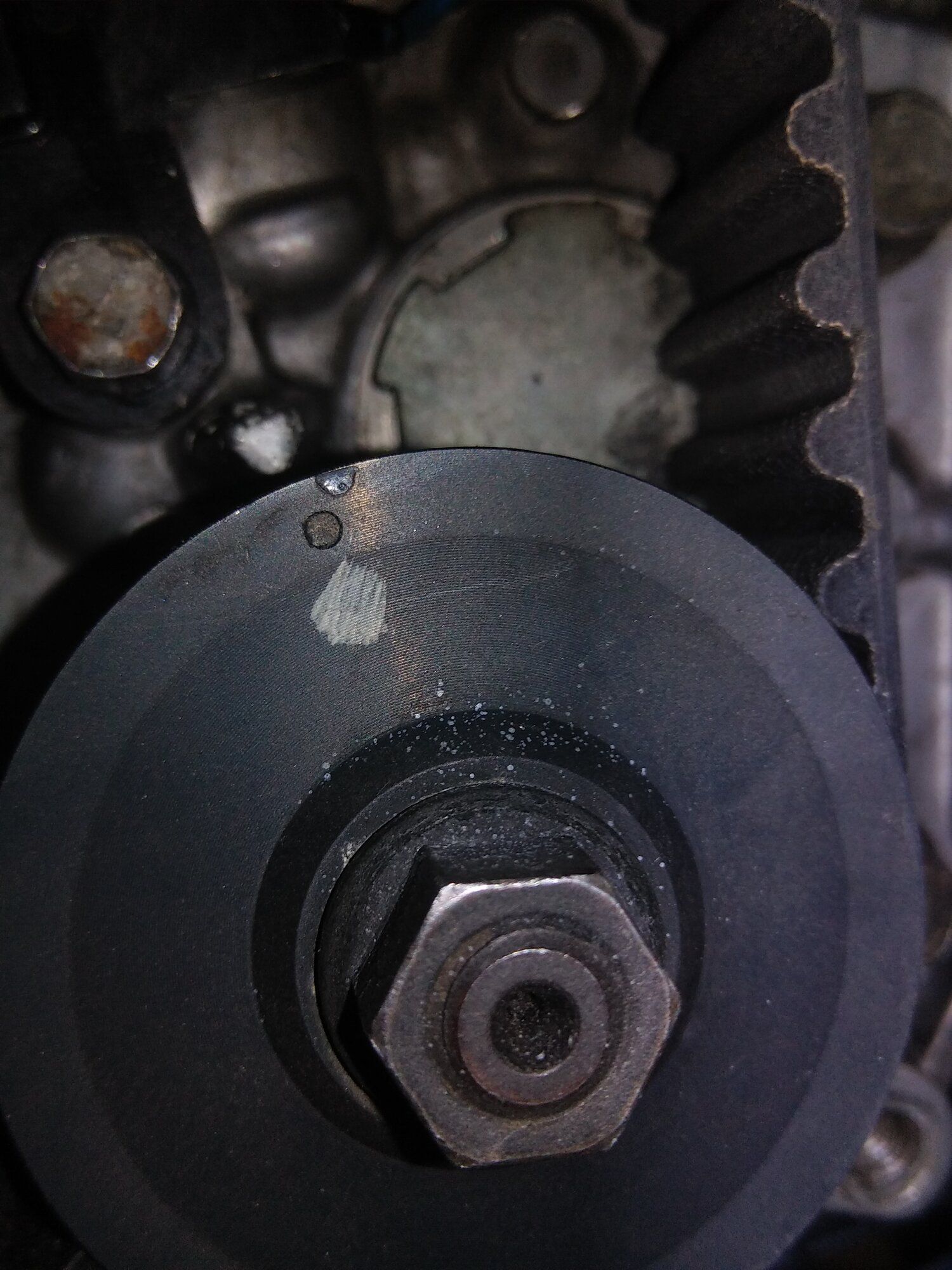

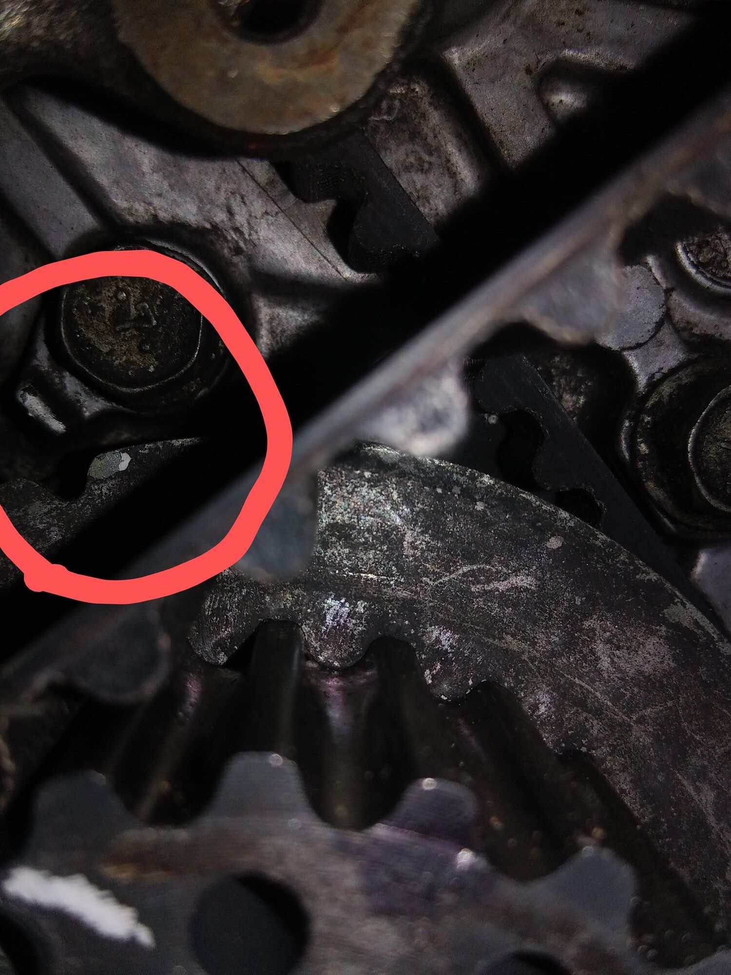

Thank you for the help you guys, i tend to over think pretty much everything to the point that i stop re-do it multiple time and eventually end up in stasis. Now i feel assured to proceed🙏. The screw driver trick works well Tony, always good to have an extra technique in the knowledge arsenal.
Doing the timing over again was a blessing in disguise though, while tightening the cam bolt the gear adjust slightly about 3° R. On the intake. So i reset it and torqued the adjustment bolts over. I figured being HKS they would be torqued to spec from them. They are now and tragedy avoided.:ohdamn:According to my torque wrench they were all under by several inch pounds. Talk about getting lucky.

Timing looks good. When you soaked the lifters, did you pump them while they're soaked? This will fill them with oil and make them stiff.
