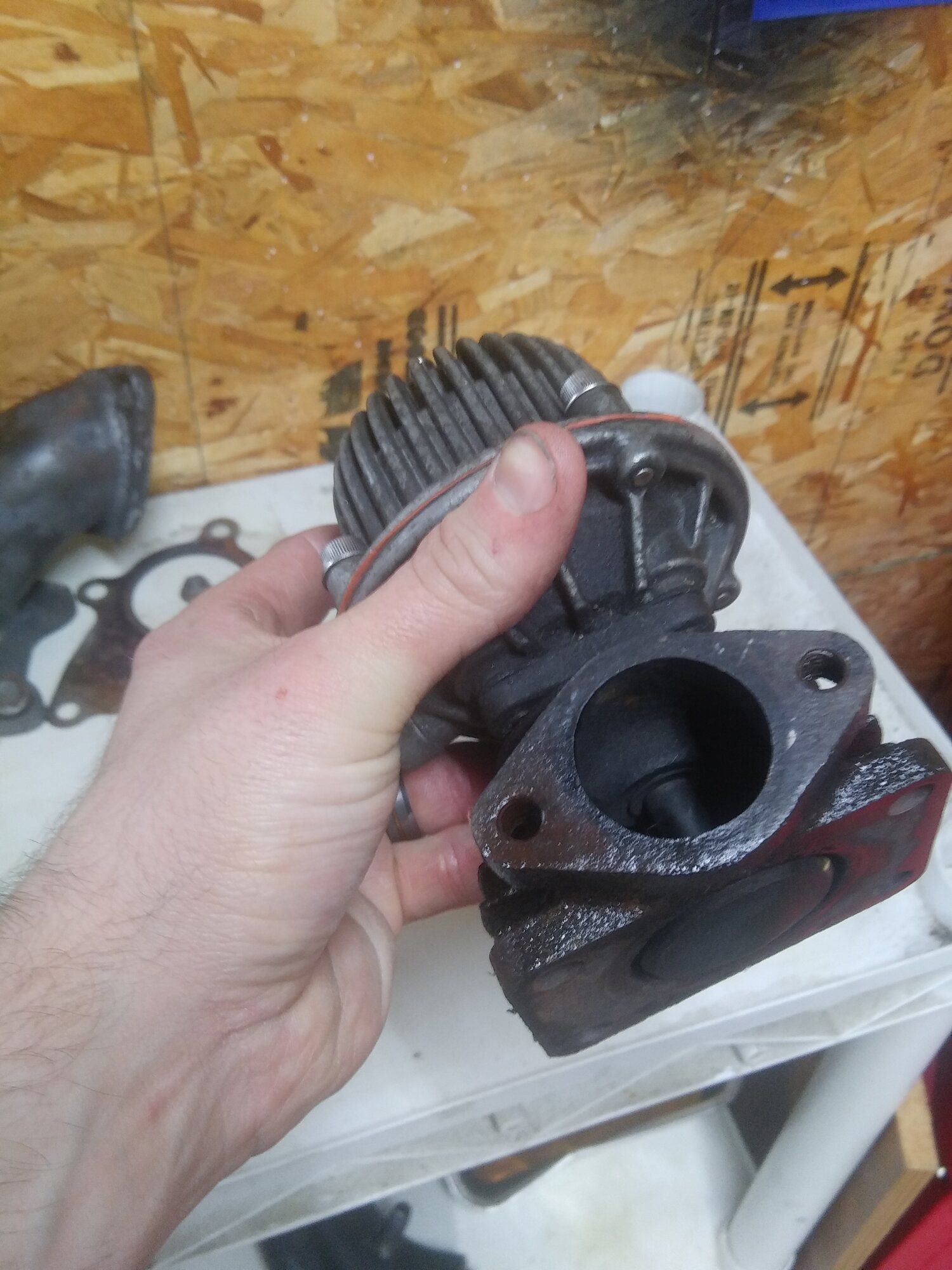

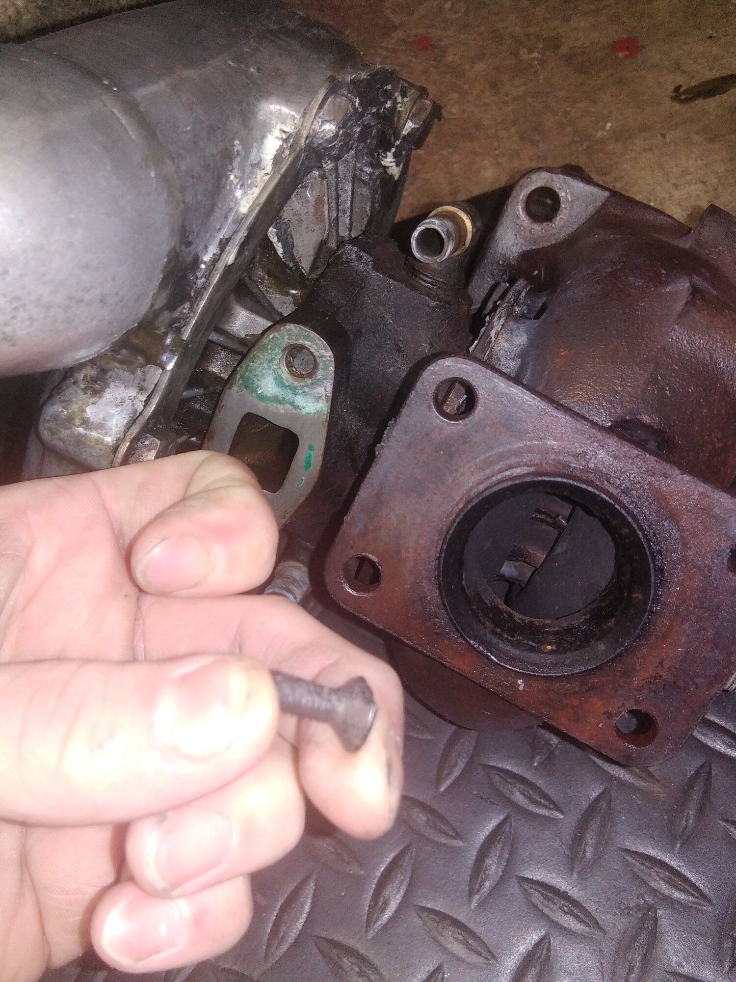

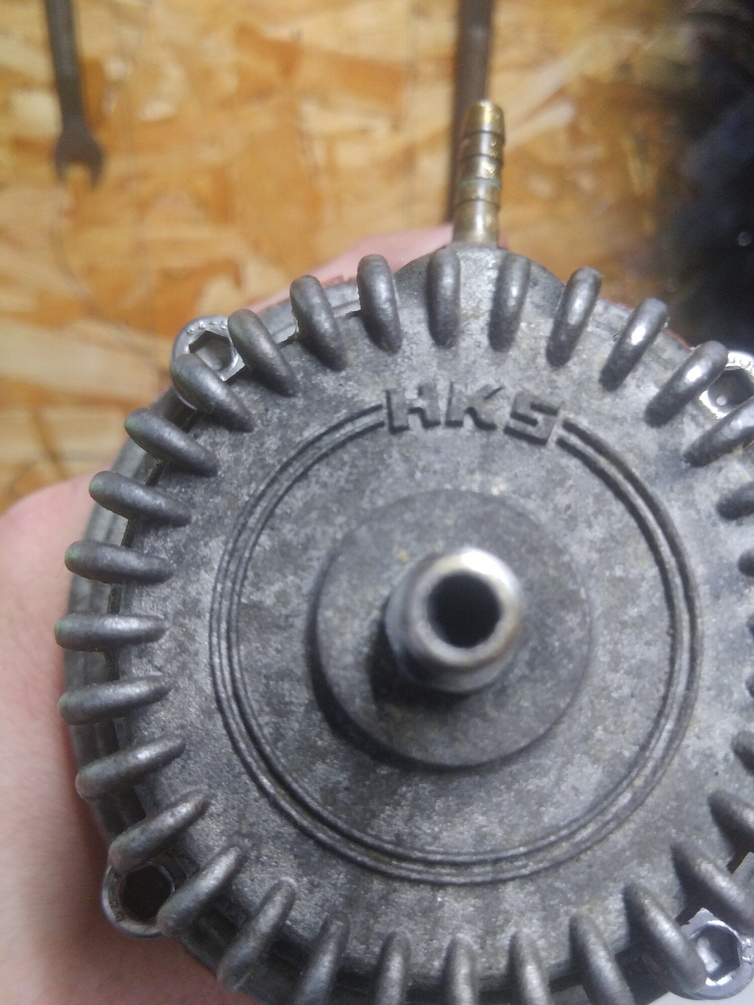

Turns out this turbo is a genuine turbonetics. I circled the emblem on the exhaust side housing. I'm just not sure what size. There is a number on the four bolt flange i just haven't looked it up yet. The old school HKS wastegate is pretty rad. Old as hell but works like new.

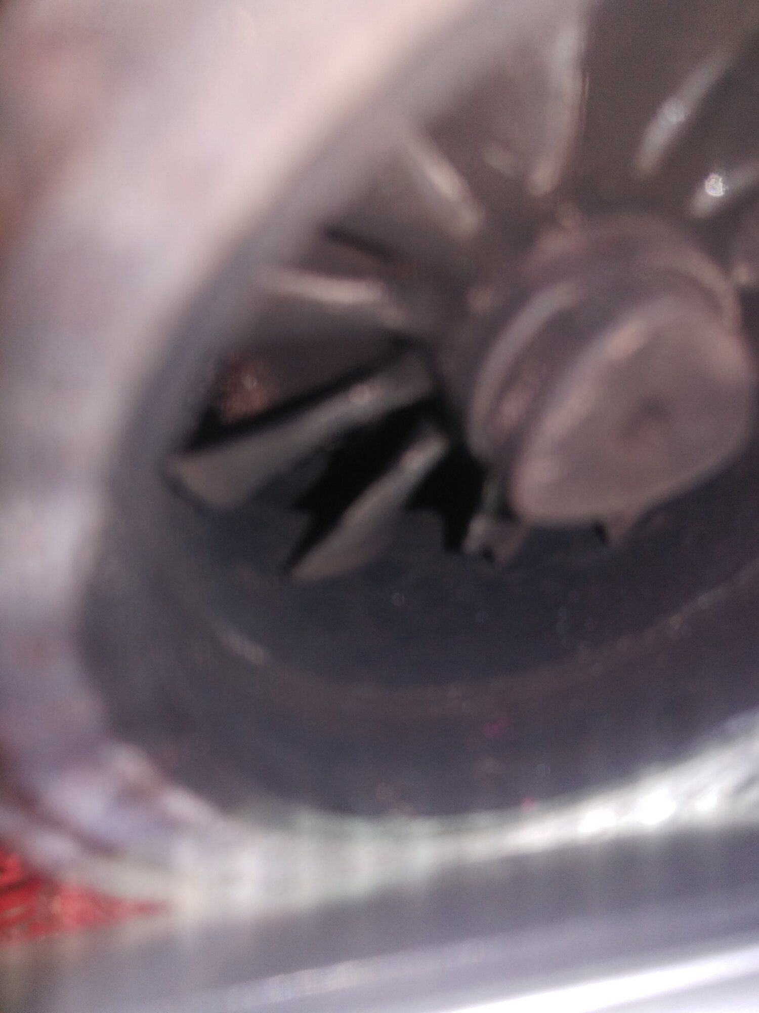

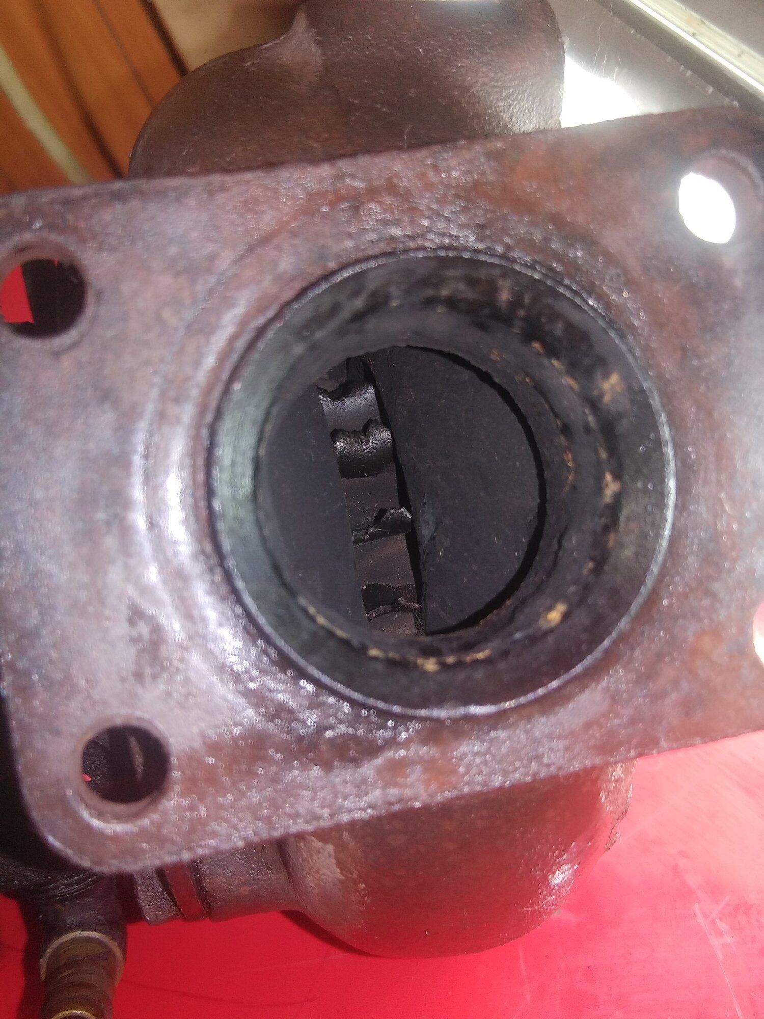

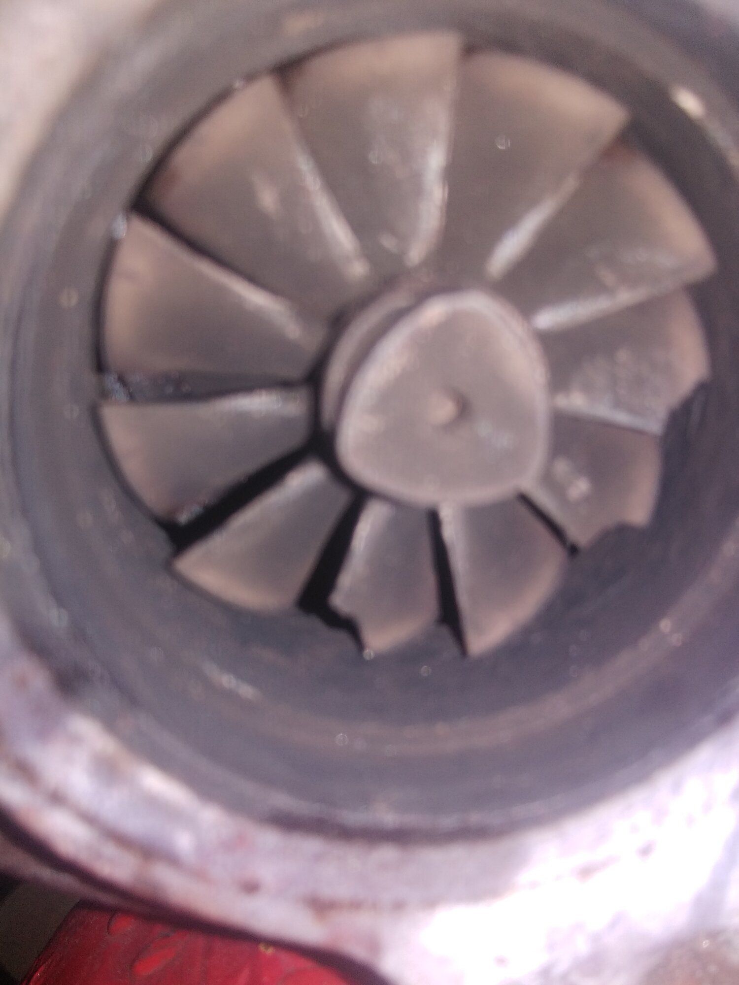

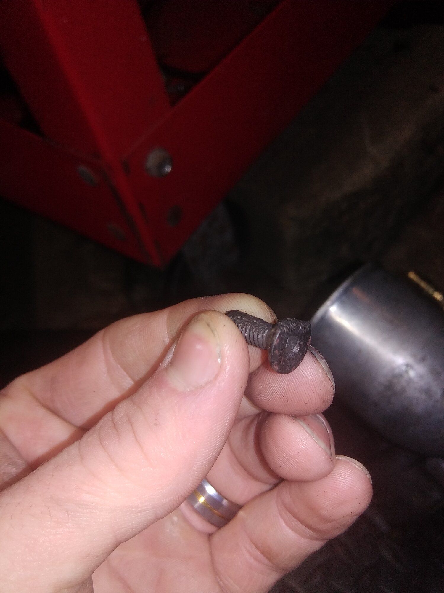

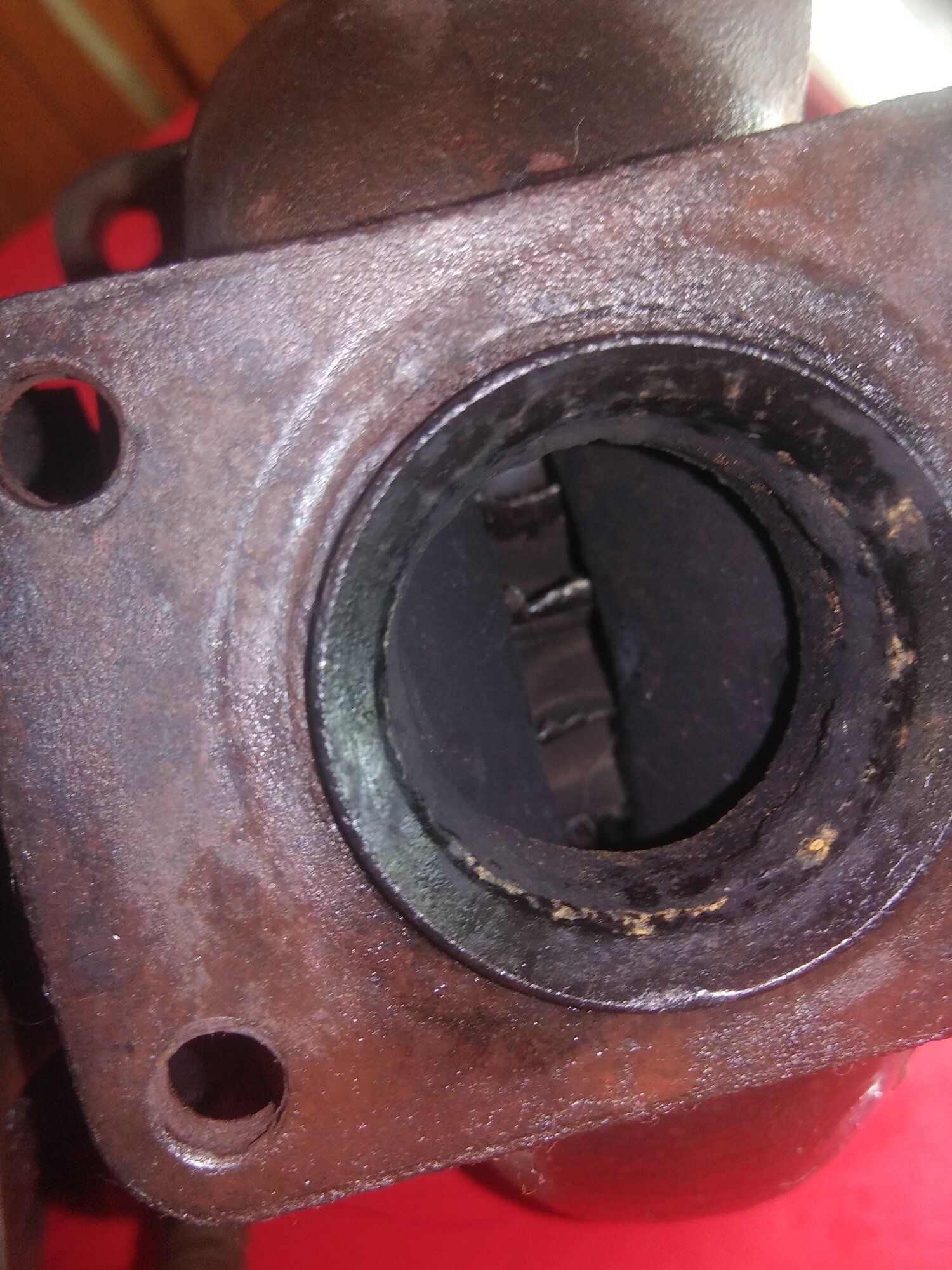

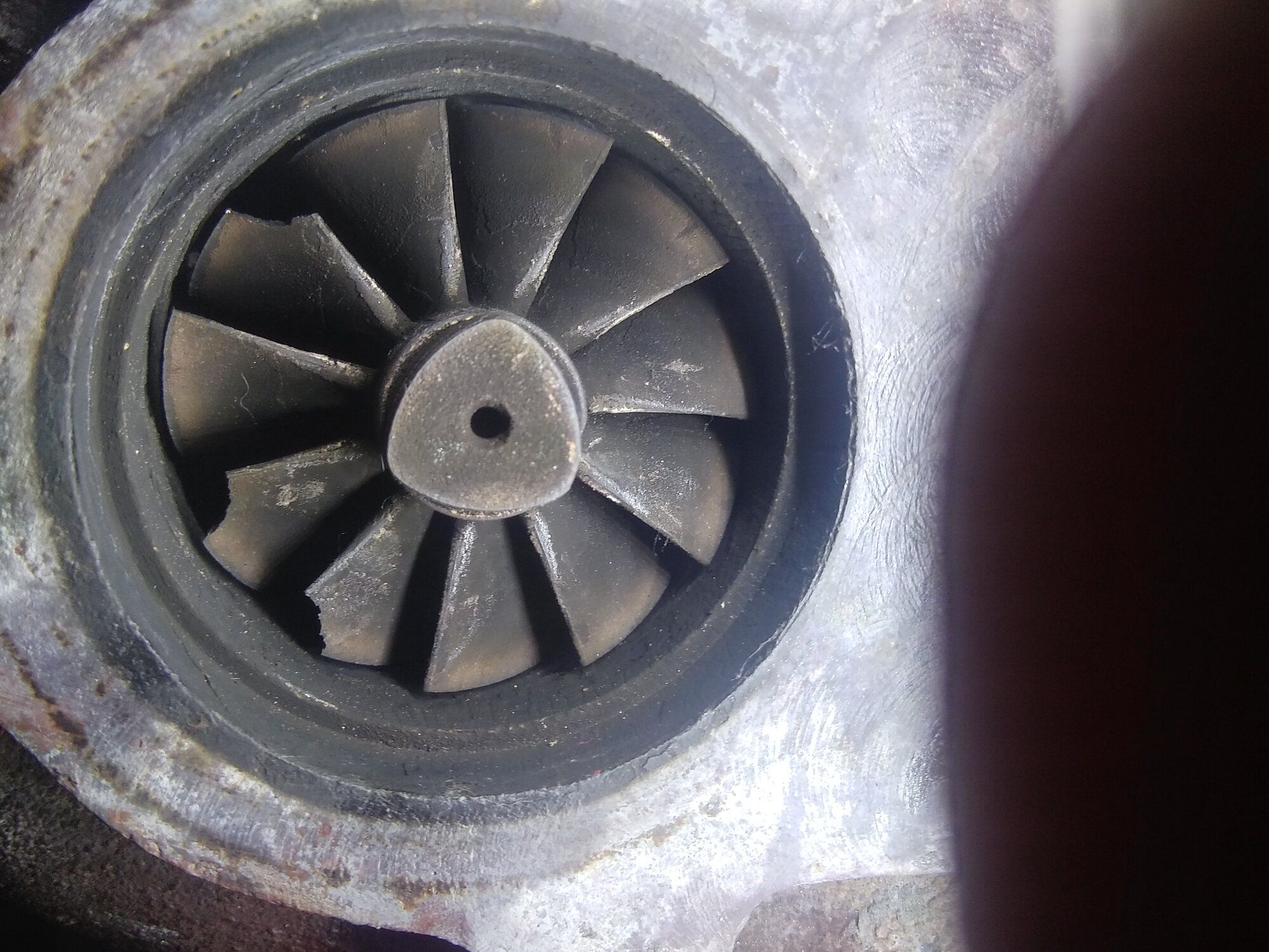

I was getting ready to box up the turbo for shipment thismorning and spun the turbo good and the turbo jammed. I thought i heard something the other day and turns out i did. This guy got in the turbo apparently when i did the head gasket. Every single issue i have had stemmed from this. The intermittent stalling, loss of nearly all power, damage to the hot and cold side blades. This was getting kicked around in the exhaust side. More than likely bent the shaft and and caused the cold side to make contact with the housing. :ohdamn:
