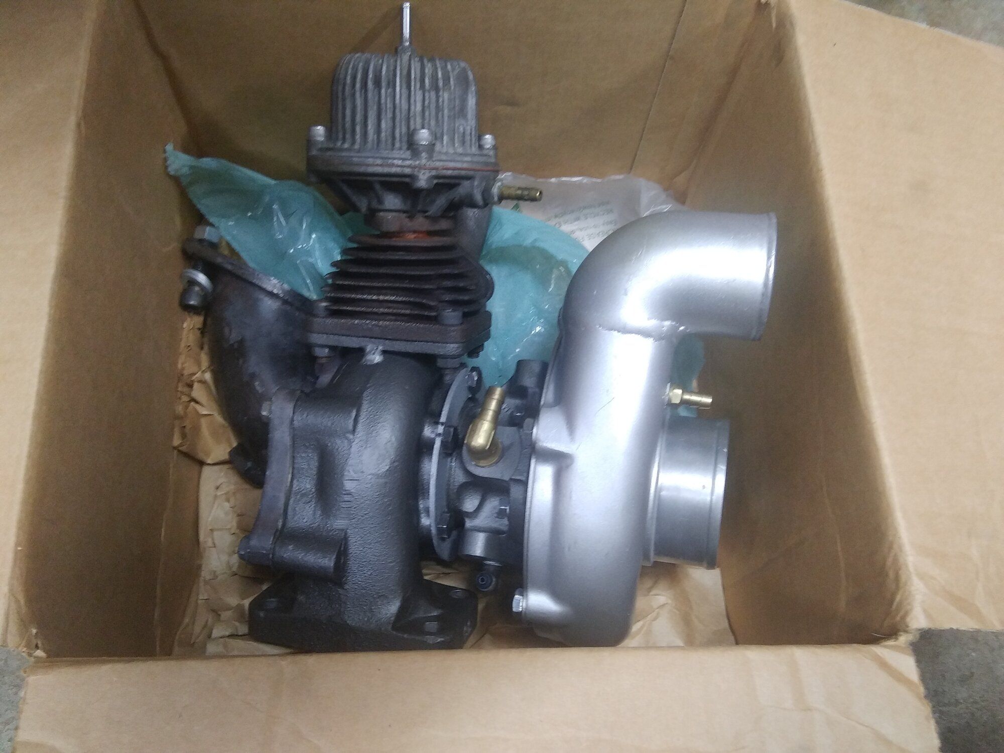

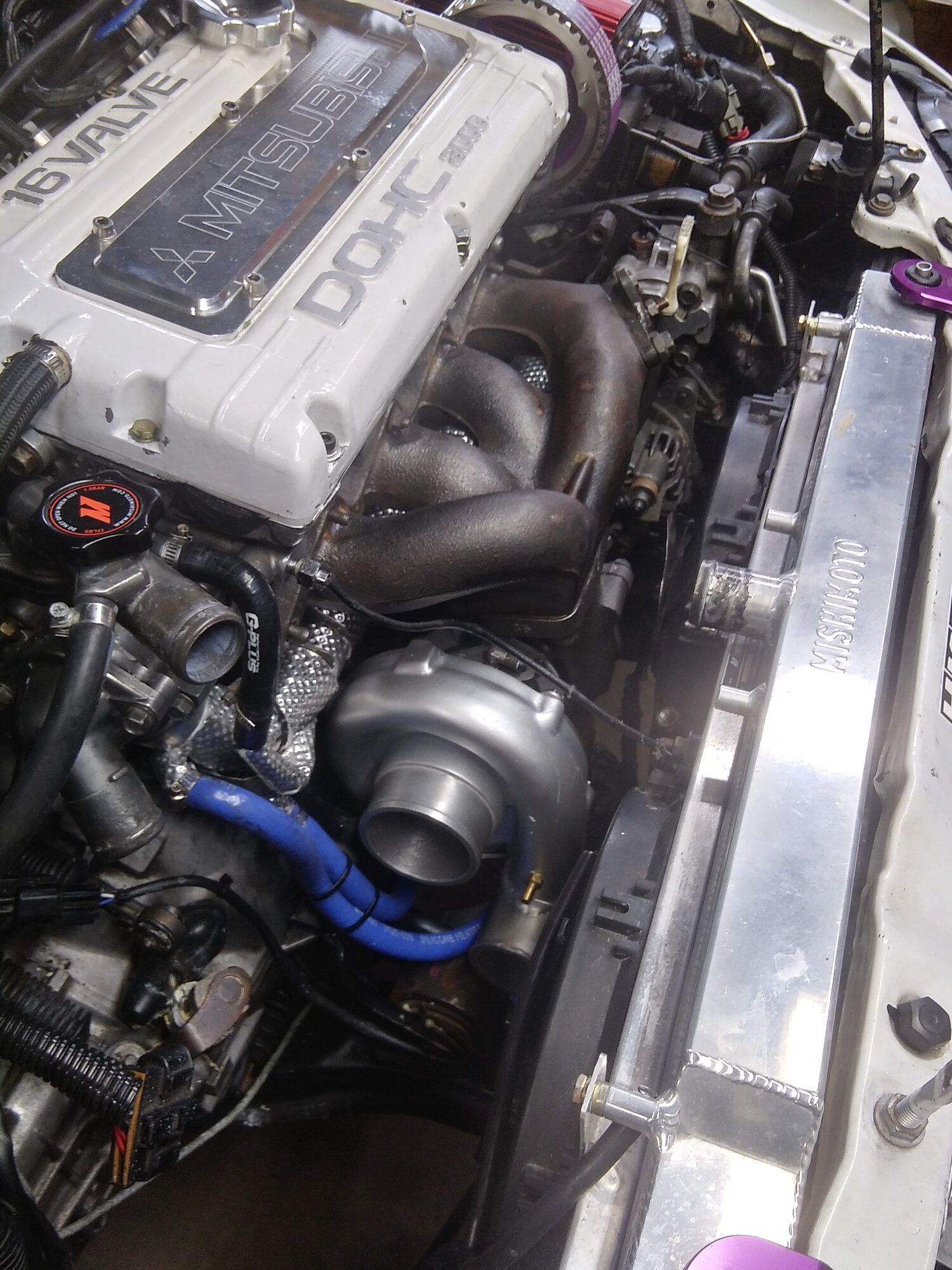

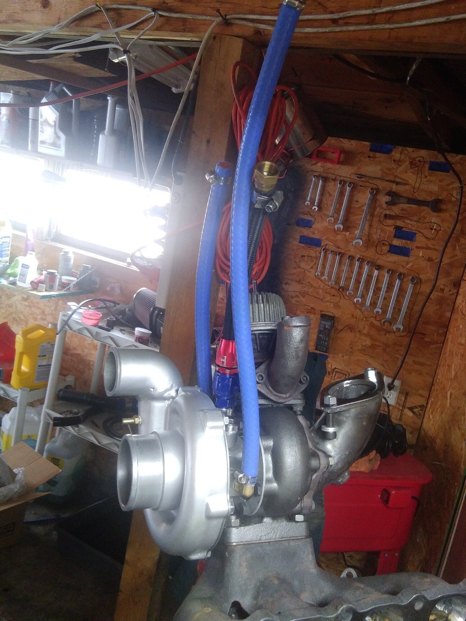

Coolant fittings in and majority of turbo parts attached. Need to clean the manifold thoroughly before dropping the completed turbo unit in. I find it very easy to drop the whole thing bolted up in one piece. Need to change the oil before doing a start. Need some gas too the tank is a little low for comfort.

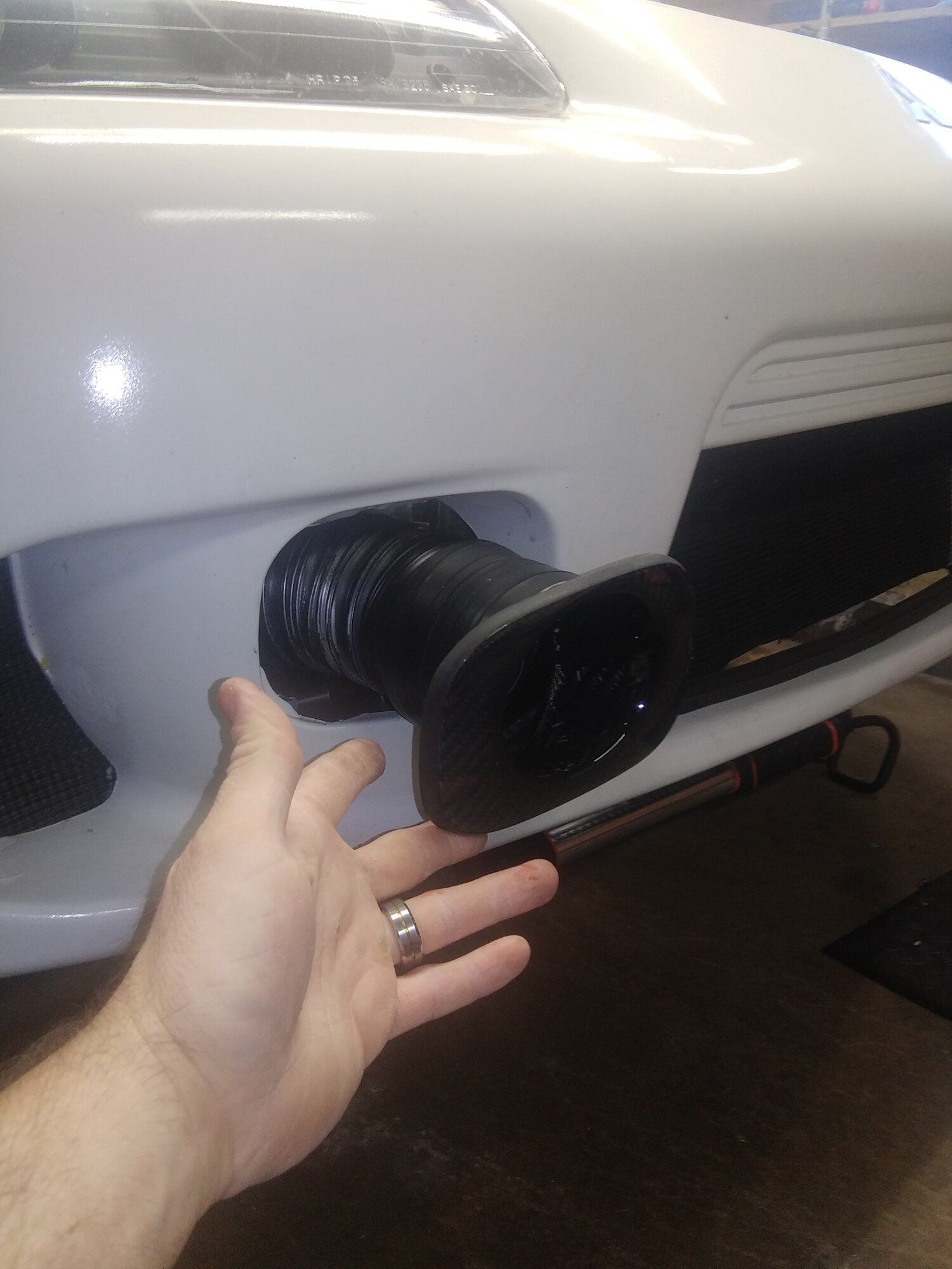

Got a couple light scuffs putting it in and taking it out for dial placement of the compressor housing:banghead:
The 90 on the turbo used to rub the cradle wheel under it finally am able to adjust it to fix the issue it now has 2"s of clearance.

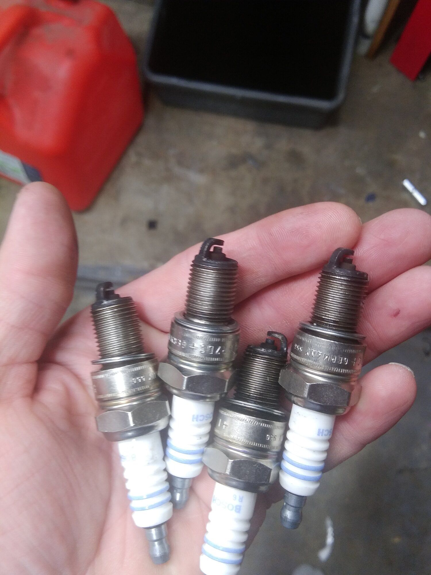

Figured I'd post an update the new ignition transistor came in. Car ran fine for a bit and then it started to fall apart at idle. Pulled the plugs and the gap was messed up on 2 of them and they were all fouled from running rich and misfired i believe. The gap on 2 of them was .19 not quite sure how i missed that. But I'm going to let the engine cool over night and put a new set in. Fingers crossed I think this will be the ticket for sure. Need to do a blt for good measure.
